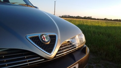

So happy with my purchase I went out to take some snaps at a place I've done before on a few occasions....

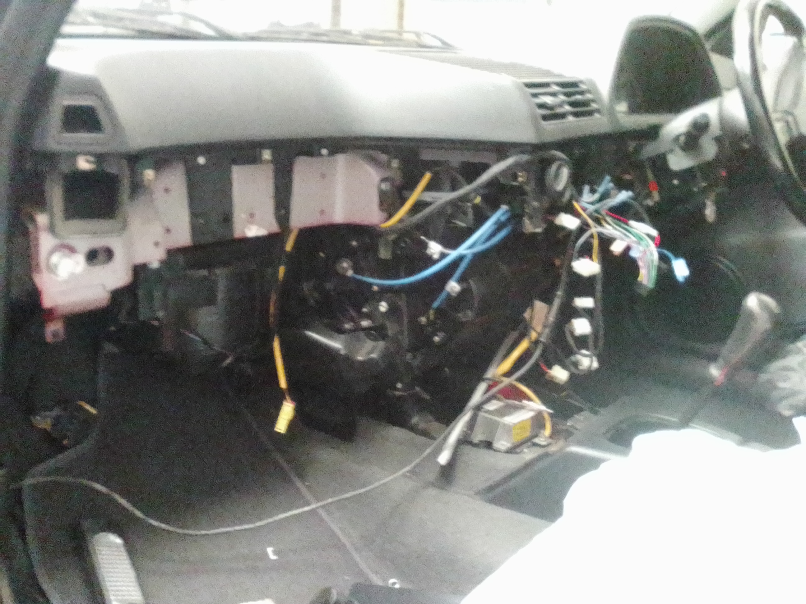

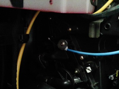

145 back out of hibernation now having had a new clutch slave whilst up at the unit over winter.
Shame I forgot to do the broken heater control cable that went haywire last Autumn, jamming it onto hot was a good solution in the October temps, not so good at the weather we have this week!
SAD tomorrow at Duxford in it so stripped the front off the dash this afternoon.
Problem was a broken fixing plastic clamp that holds the outer cable to the heater box, a couple of washers with curled lower edges has clamped it just fine now. Smooth as silk
At least I won't cook myself on the trip tomorrow
