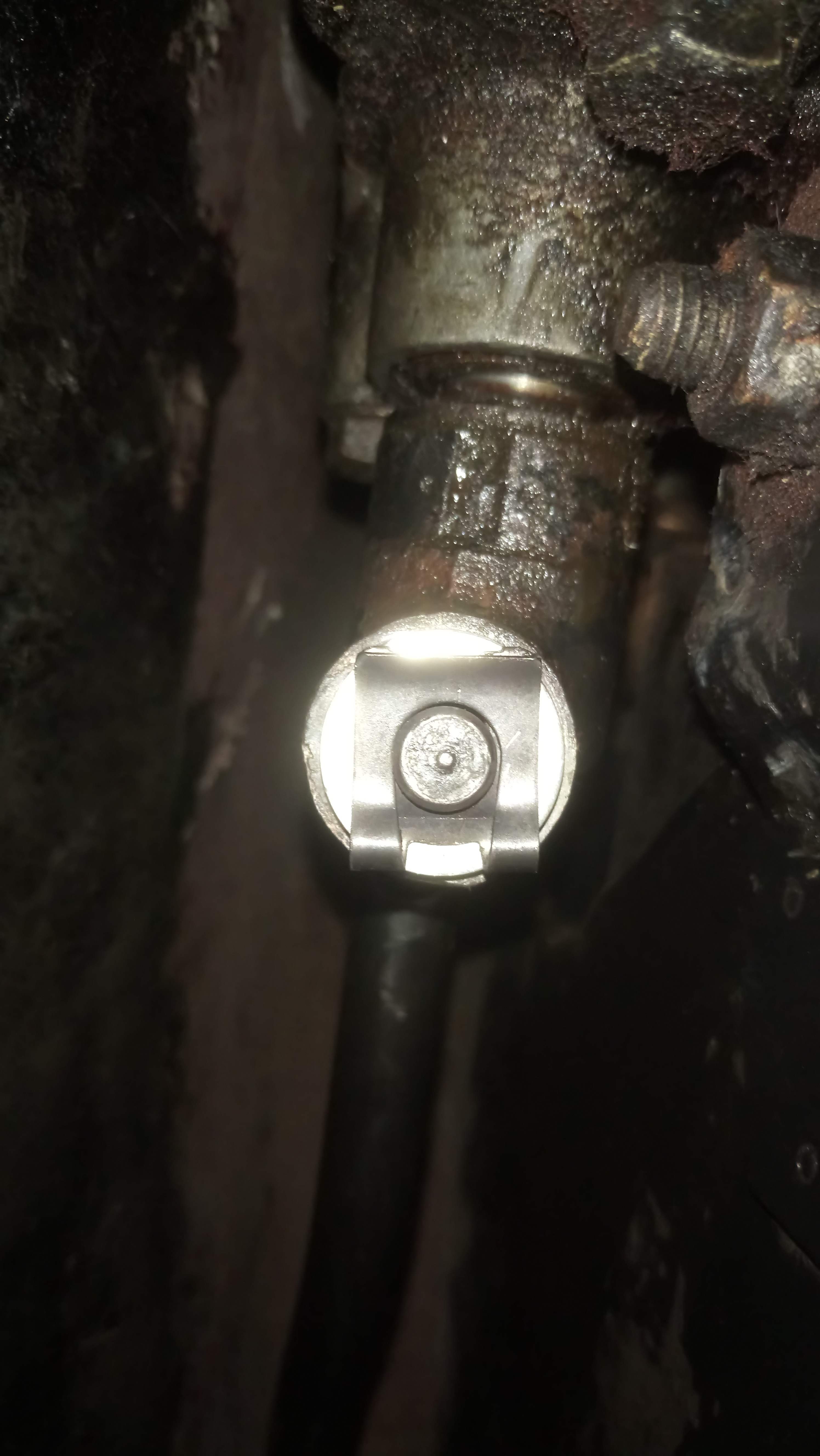

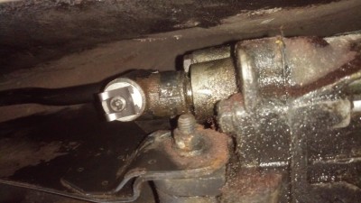

Today, just a mile from work the gear selector rod came out of the flexible joint of the gear box of the 33, Grrr :x , leaving me in third to get to the car park. Up hill start from the car park barrier, that made the clutch smell a little. :lol:
So once there and after letting the exhaust cool I jacked her up to see what had happened. It seemed that the circlip must have broken off letting the rod pop out. Managed to get it back on and put a couple of very thin cycle brake circlips in with a spacing washer and a couple of cable ties for good luck.

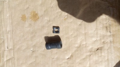

Just been able to get on Eper and found this with part numbers.
http://eper.fiatforum.com/eper/navi?MOD ... &DRW_NUM=2
Quick search on Ebay returned this
http://www.ebay.co.uk/itm/TAMPONE-E-FER ... R#shpCntId
Do you think it will do the job as it says 33 but the image is sud, part numbers look to be okay though.
£20 inc postage for a clip and rubber ouch but if that's my best option then that may have to be the case hopefully here in time to fix it up. Don't really have the time for the permanent fixes at the moment but will possibly get it sorted after returning from Italy.

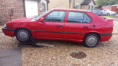

So repair kit of rubber and clip came the other day, won from eBay seller in Italy for 17 euros.
So back up on the ramps she went.

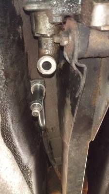

Bit of a struggle getting the rod back with the new rubber fitted, found that the gear lever pushed and held to the left in the car gave just enough clearance for the rod in the tunnel to pop back into place.
Then spacers and clip on and all done. Simples.
