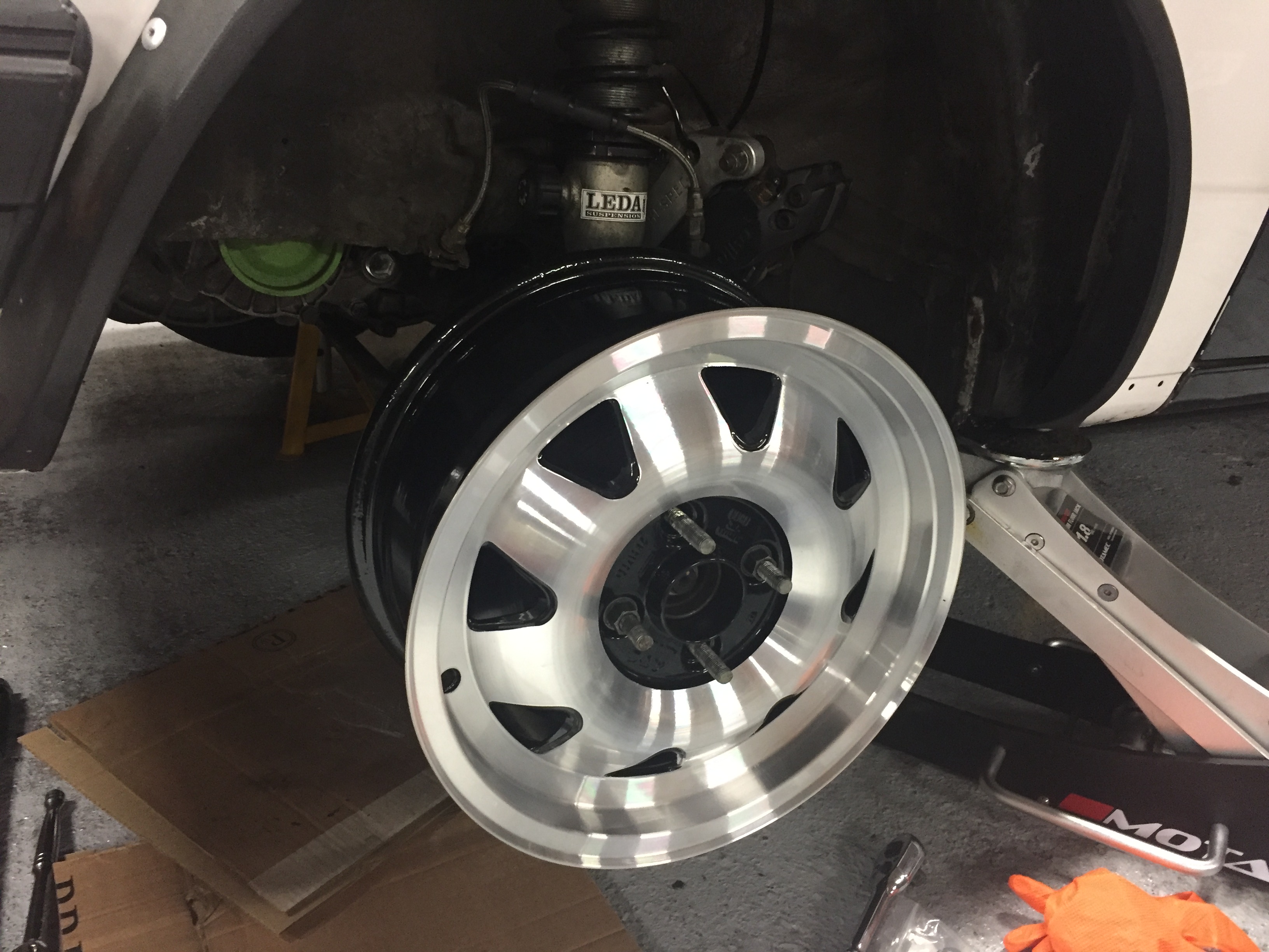

My drawing was showing I could fit a 280mm disc and four pot caliper in the ATS 14in wheel with a 20mm spacer but in reality it requires a spacer of 22.5mm.
What I didn't appreciate is that when you fit the wheel it is going to look very silly with any spacers. The tyre will be proud of the wheel arch. It seems the ATS wheel offset doesn't allow spacers to be used.
This pushes the inside of the wheel closer to the disc and calliper so I have to start again.
This is the wheel with no spacers:
The first thing is to see how far I can push the disc inwards towards the suspension leg.
This is the bare hub:
The current disc offset is the distance from the hub face to the inner disc face = 45mm. As you can see, you can't move the disc inwards any further. The lower knuckle joint is actually slightly inside the arc of the disc!
So with a 21mm vented disc, the max disc offset is 45mm and the disc face bolted to the hub is 7mm which corresponds to a disc height of 52mm.
