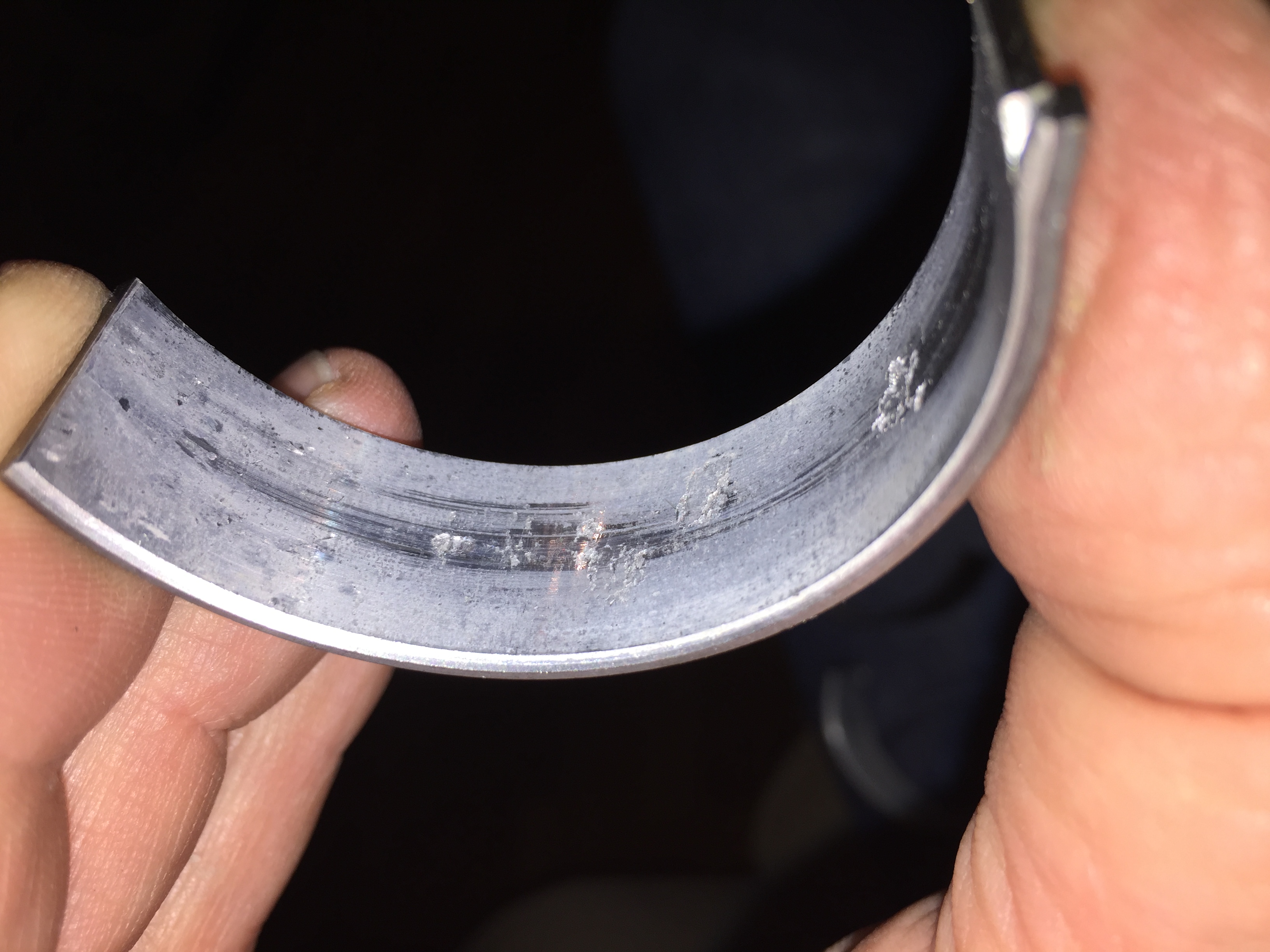

Tom has changed the big end bearings, cam belts, oil, filter, checked valve clearances, new brake pads etc etc.
The removed bearings have taken a bit of a hammering. This was the worst one:
Fatigue cracks in the white metal leading to a bit of material liberation.
This is after 7 races. Tougher bearings have been fitted and we will replace them next time after 4 races and study the removed ones.
It may be that the tougher ones will run a season, we will see.

Re: 1974 Alfasud Trofeo
What brand have you fitted ? I use 'tougher ones', King race bearings but still change them every 4 races.
ACL race were preferred but haven't been available for a while.

A self imposed shift up at 7.5k, max power at 7.8k.
I think Tom will have fitted the Nord spec shells, irrespective of brand I wouldn't recommend a full season at 8.2k on the same shells if they are Nord .
I think Bryan once said he did approx 3 hours on a set, which is about 4 events on double headers, but I could be wrong . Worth asking Tom , let me know if he recommends different.
I have a set removed on this timeline which I will take a photo of.
It is the weakest link on a high revving motor, I have a std crank also so it's perhaps as much precaution as it is necessary on the interval.
I'm aware of boxer cranks ground to use cosworth shells, which are both cheaper, readily available and tougher / longer lasting....but mine is std.

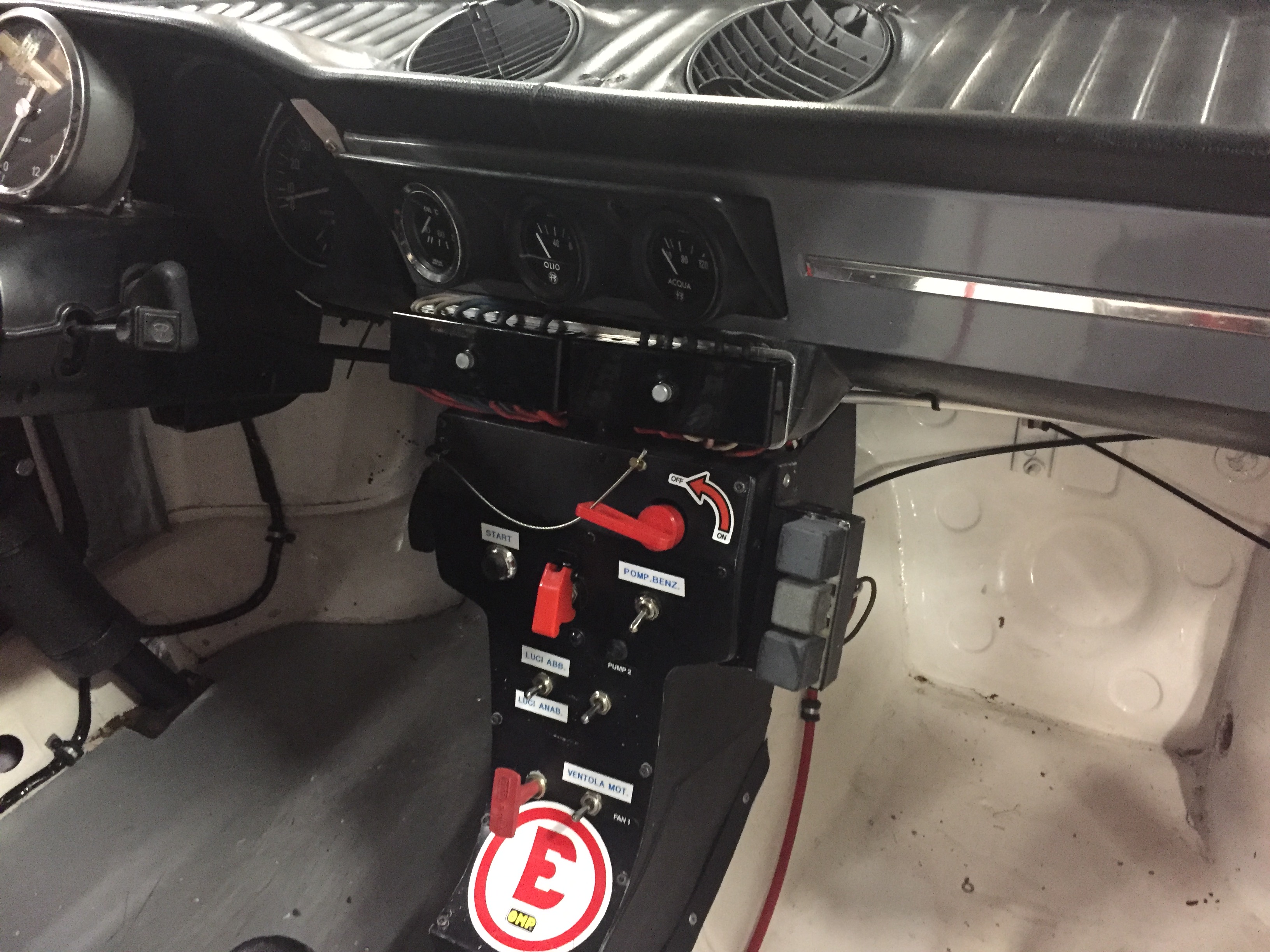

New fuse boxes today chaps. They took a bit of finding and were quite expensive because they are Ferrari ones.
One of the old ones: New ones: I now have fuse covers - ooh luxury: The car is off to be painted tomorrow.

That looks tidier Simon, looking forward to seeing the paint job.
Great looking install .Very clean

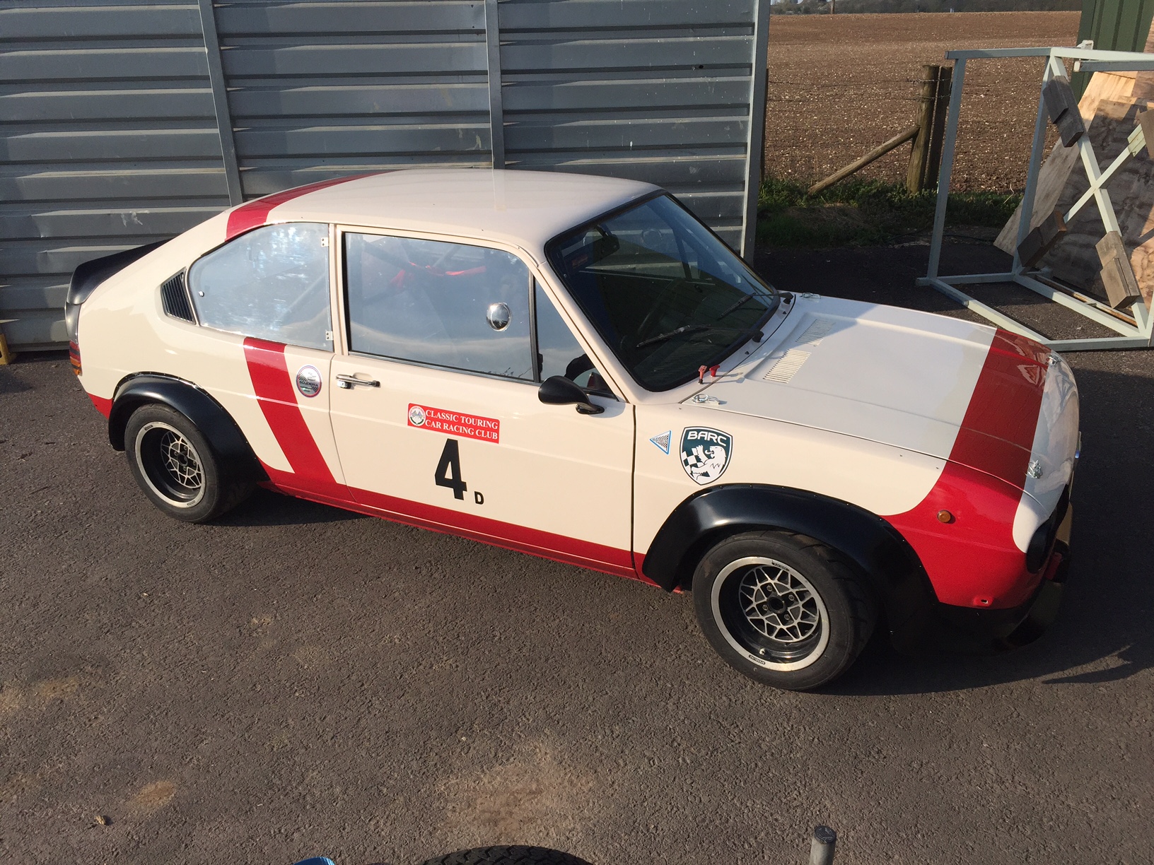

- Posts: 976
Hi Guys,
New paint job is done. I think it looks older which I like.
Rockingham for a practice day tomorrow.
Hi Simon, I can see what you mean about looking older.
It looks more like the pictures "in the day" now.
See you for your first race.
looks more in period with the off white ivory colour, does look superb though

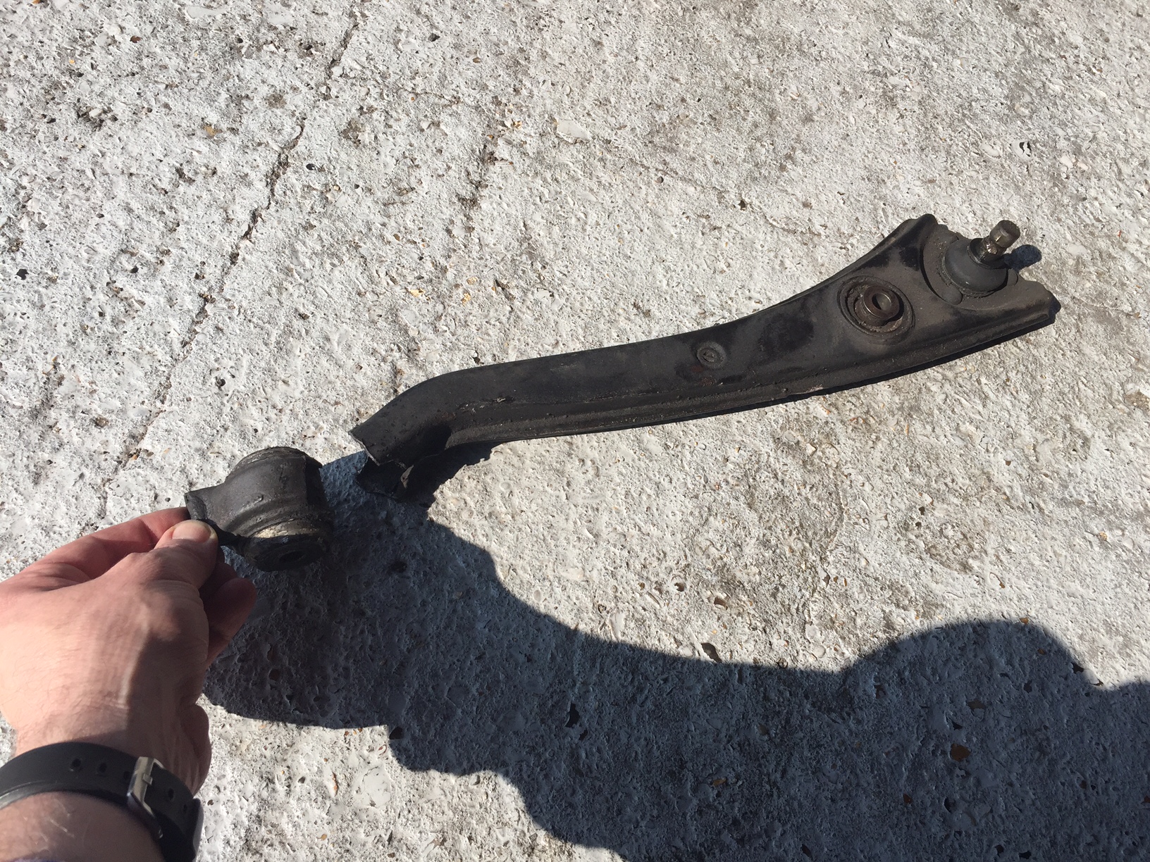

Four 25 min sessions today and I didn't get much done as I broke it half way through the second session.
At the end of the main straight braking hard next to a Ginetta and it all went pear shaped. Swung violently left, right and so on about six times. The guy must have thought I was an utter idiot. Anyway, thankful you can go straight on at that point by blasting through the cones.
I thought something had occurred mechanically but no idea what.
So I left Rockingham about 11.30am today and fitted another lower arm this afternoon. Really quick job.
Ready for tomorrow.

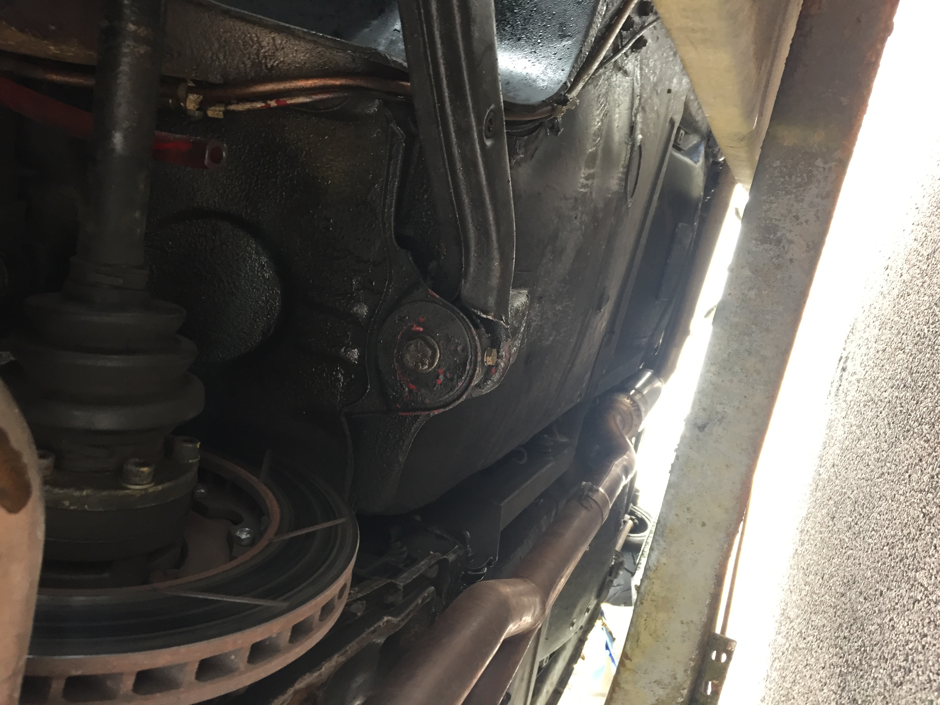

Ready for tomorrow.
Minus 4 sec is some mega improvement. Lucky you had a spare lower arm, must start hunting for bits.
