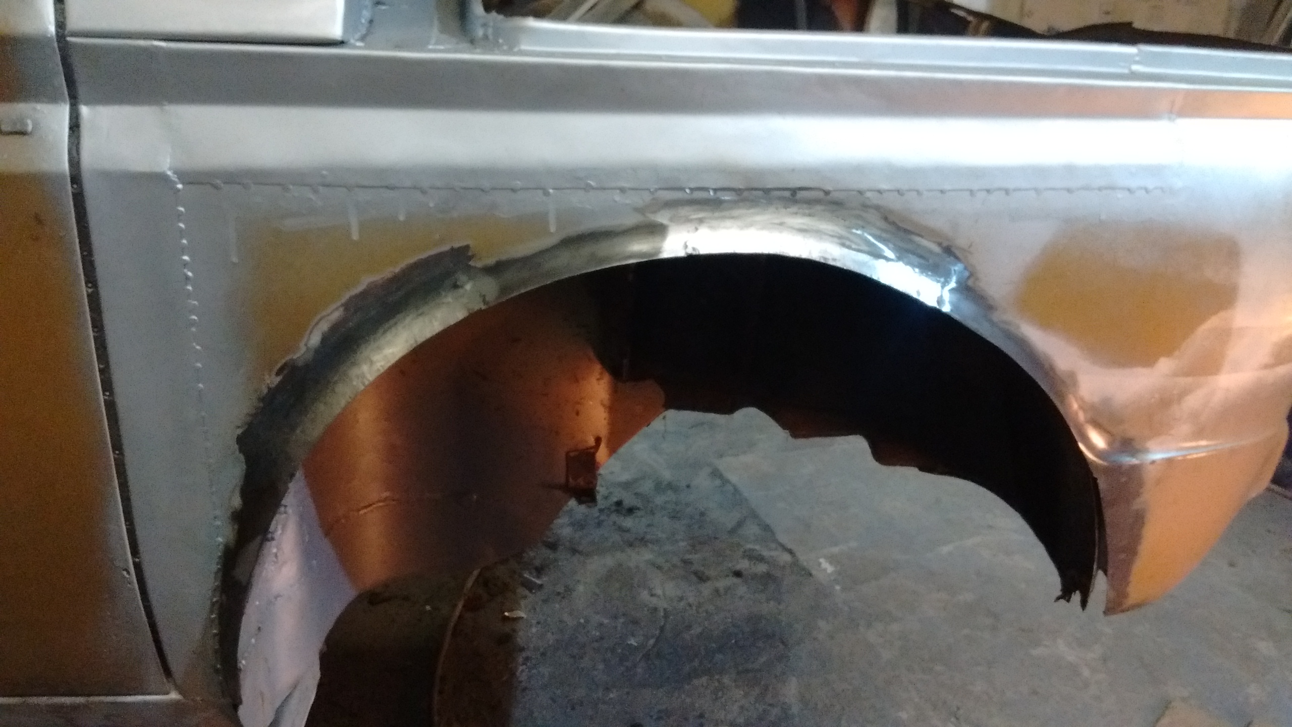

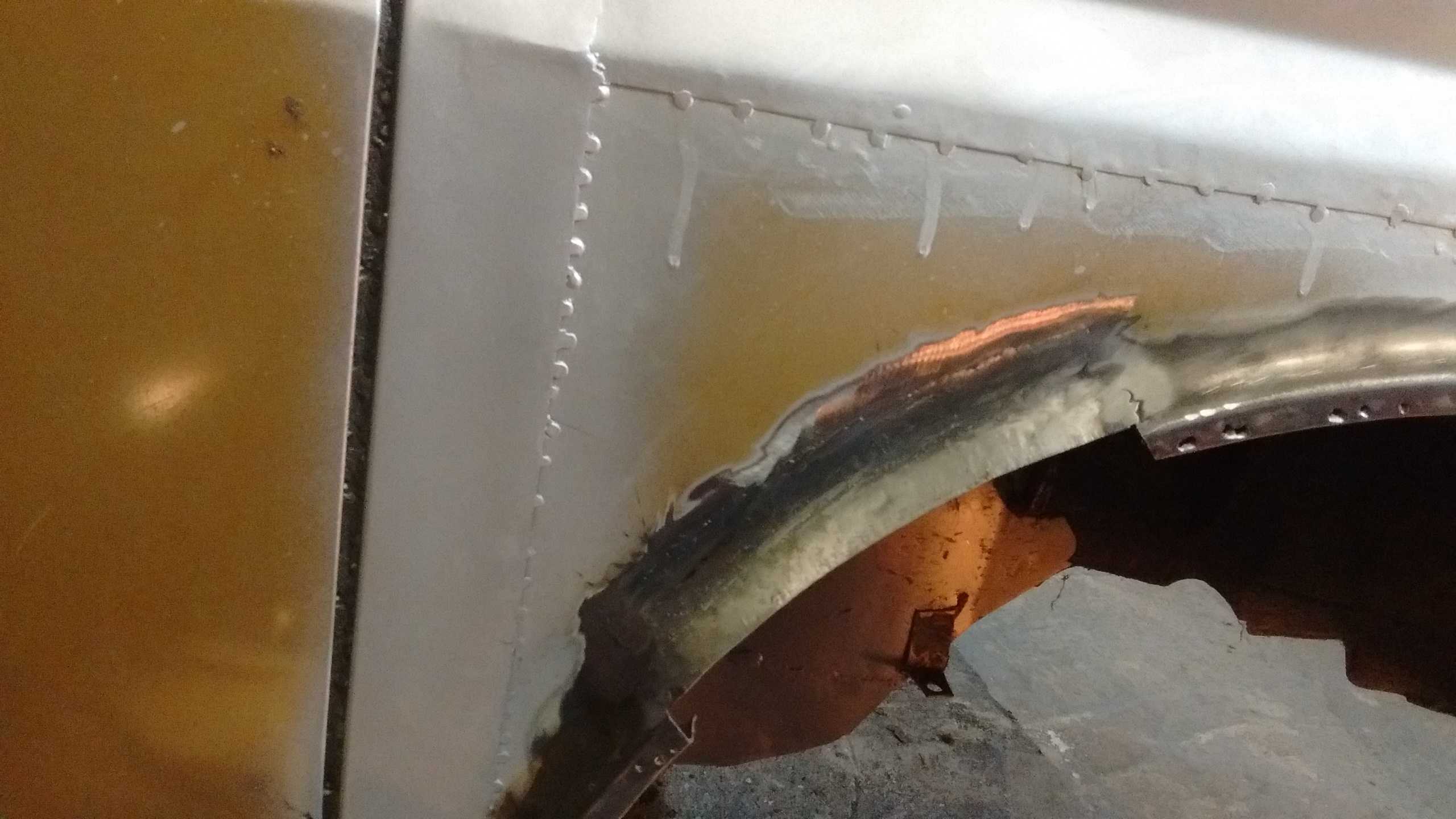

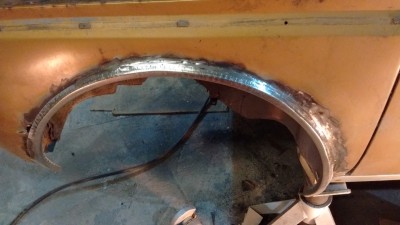

so this afternoon I set to and chopped out the remaining rot from the curved section of the wing arch, a simple enough patch but curves in 3 directions so takes a little manipulating to get right. butt w3elded in to try and stop getting multiple layers

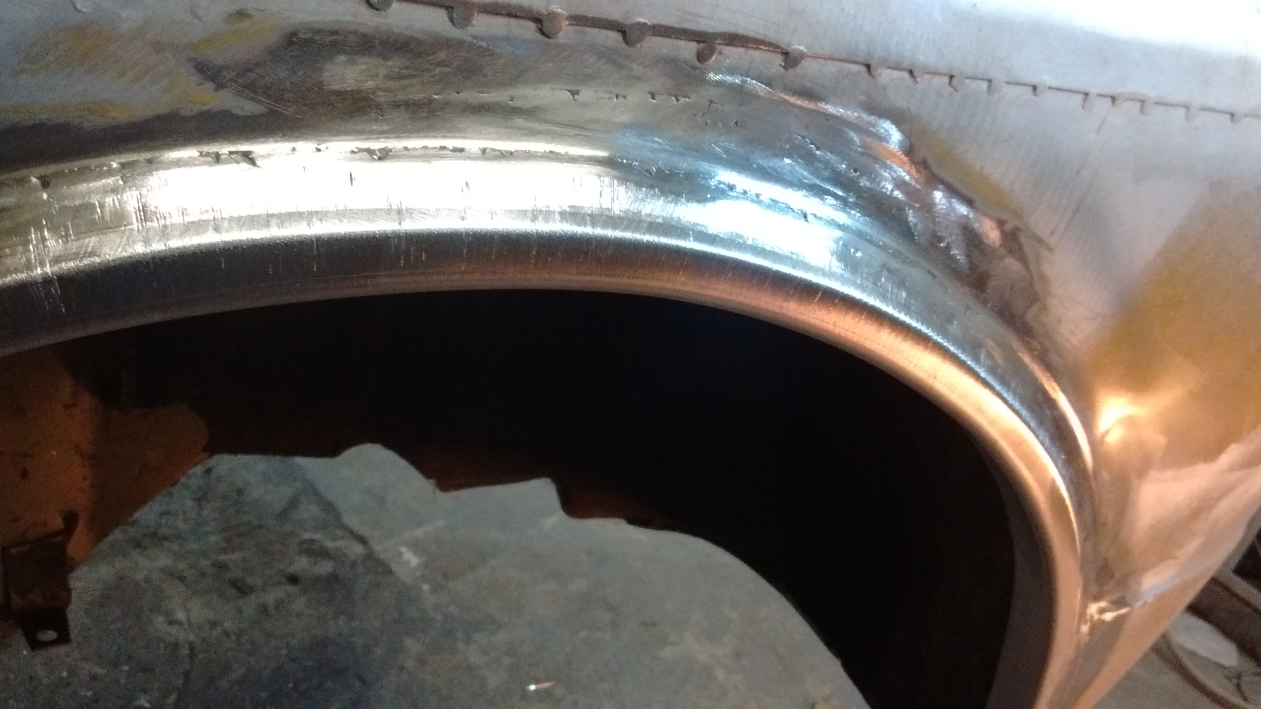

both sections cut out and welded up then the old arch lip removed
new arch being tacked into place, extra length at each end will be tidied later
extremely slowly it got seam welded, done in a series of spot welds.
then all ground back smooth
quite pleased with the results, shouldn't take a lot of filler to get right
welded the underside then a coat of etch, next time i'll sort out the edge to sill and make some repair sections fro the bottom of the wing to front panel

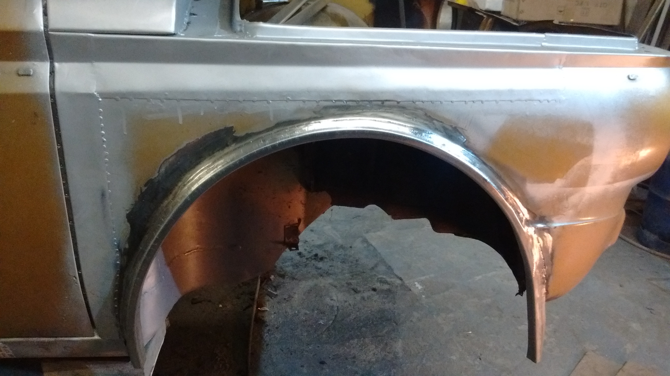

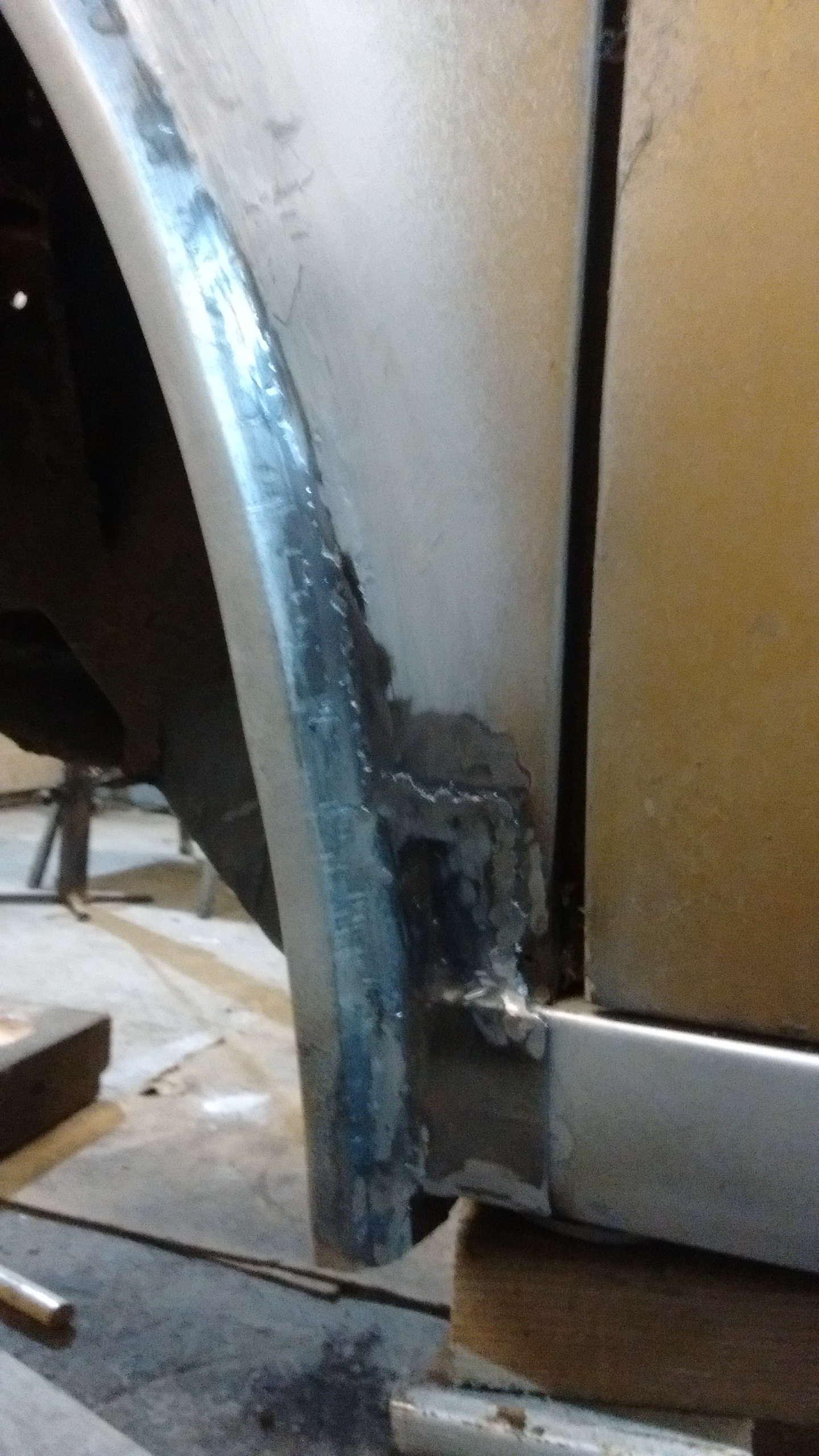

last Wednesday afternoon I did a bit,
sill end of the arch got a repair patch made up and welded in, as near to what it should be like as I could do

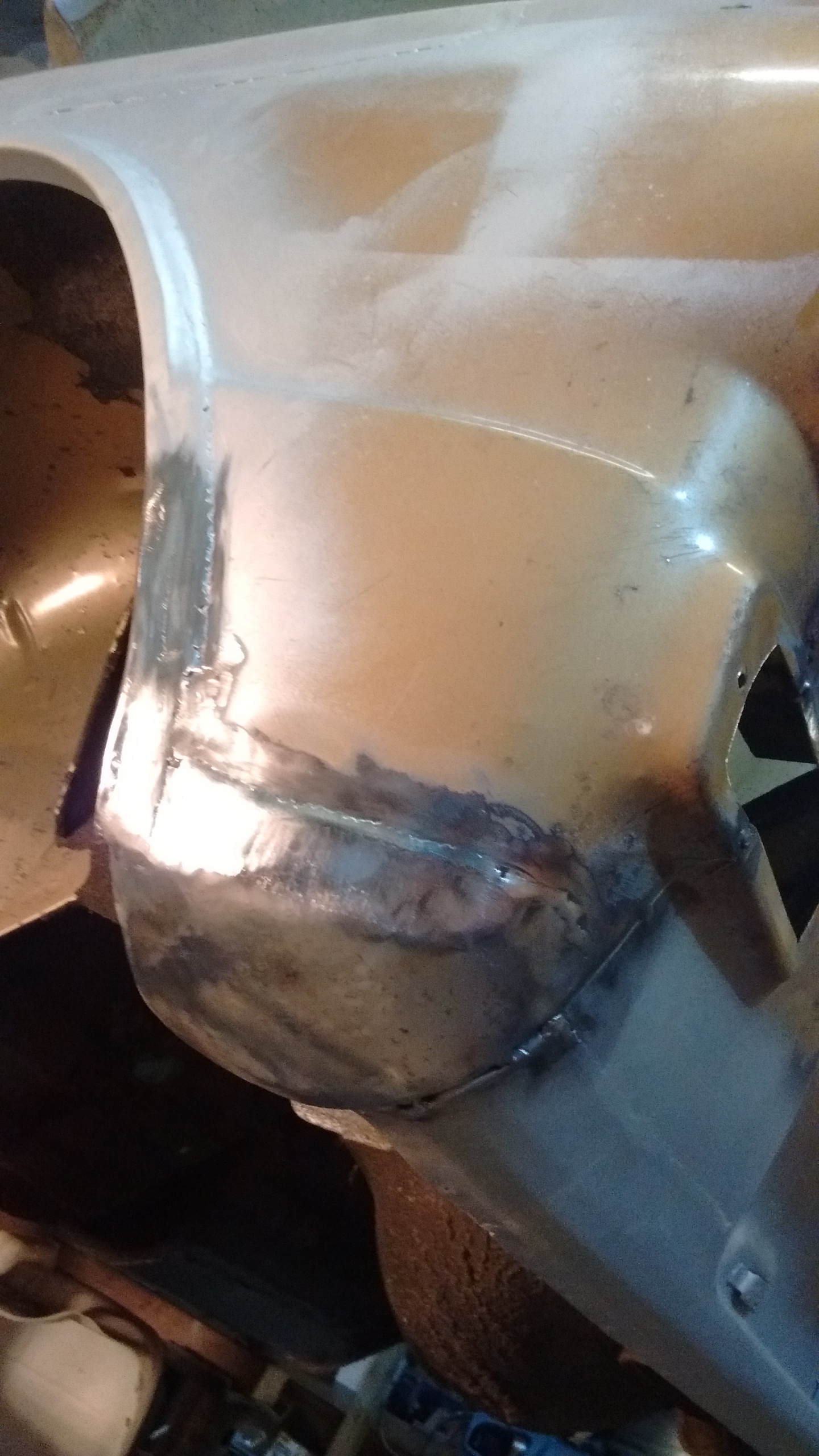

bowl at the front needed a bit more fabricating, luckily i'd been paying attention enough on the course to remember how to make a multiple curved patch from a flat plate!
drivers wing about done now save for a bit around the headlight opening

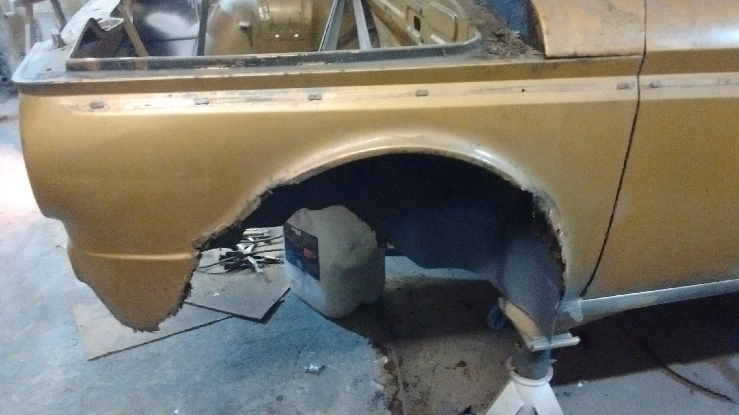

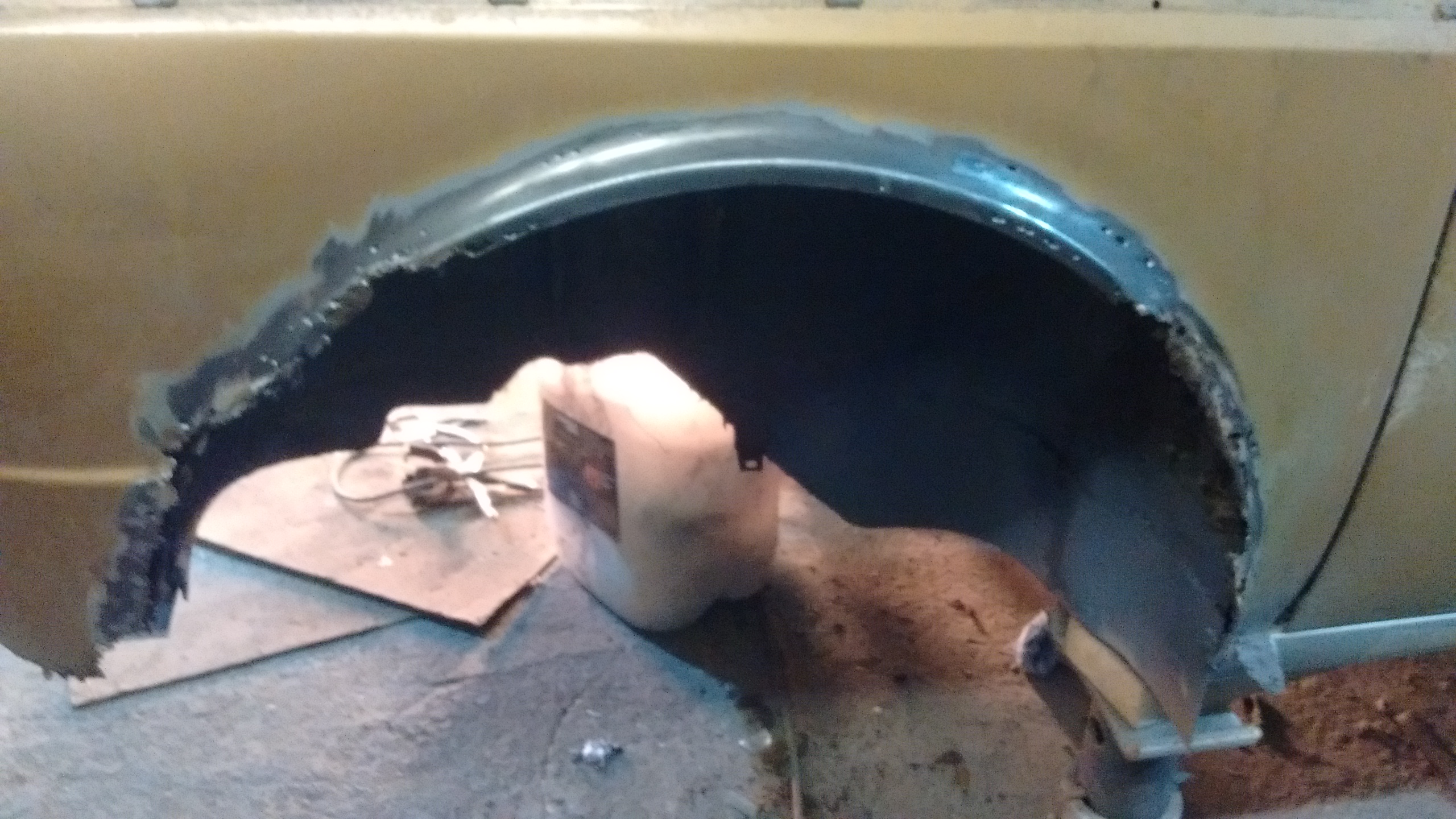

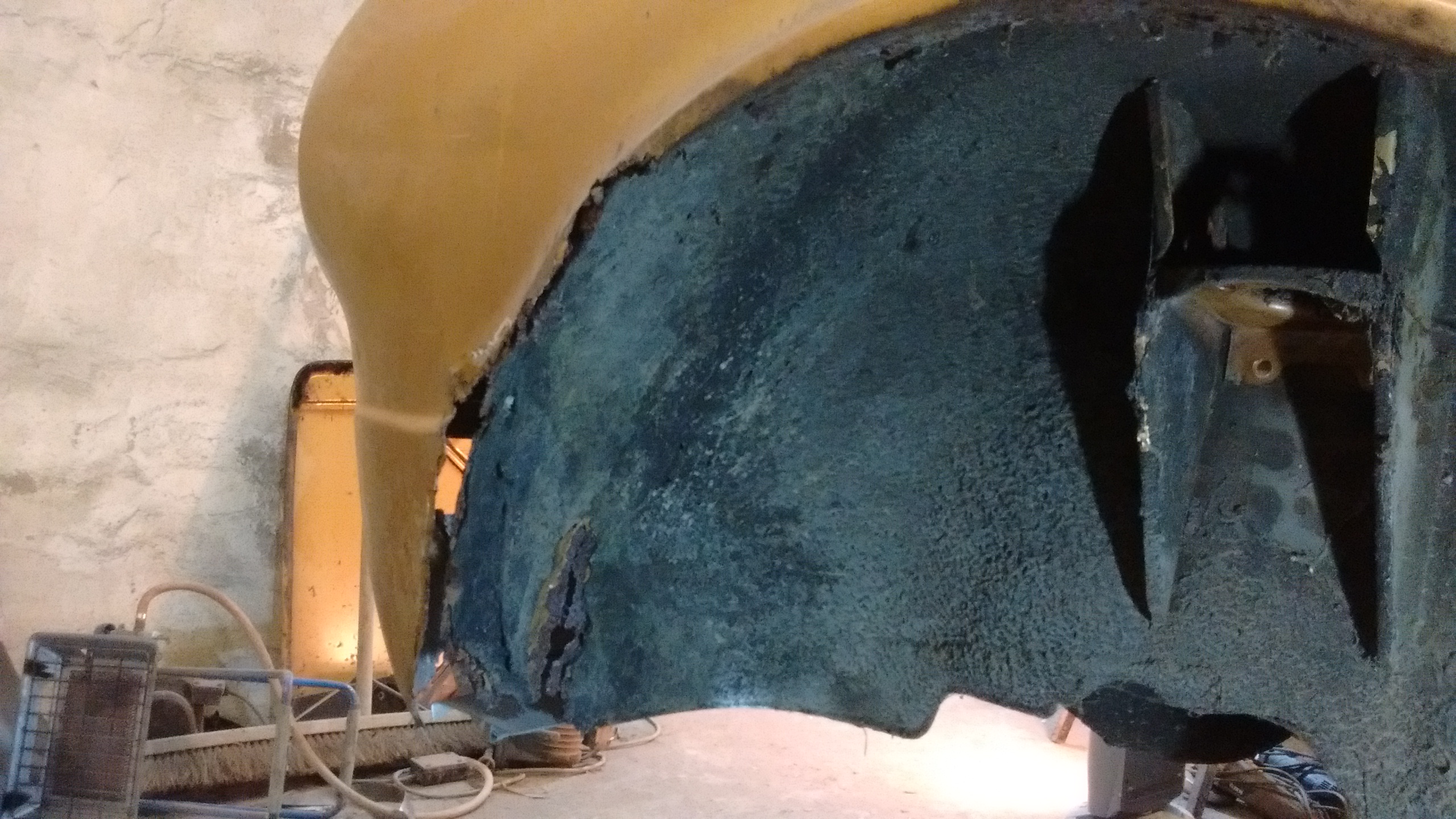

passenger wing I didn't think was as bad, well damage pretty much restricted to the arch anyway...
a few gaps at the front edge..
rear not much better..
doesn't look pretty.... :(

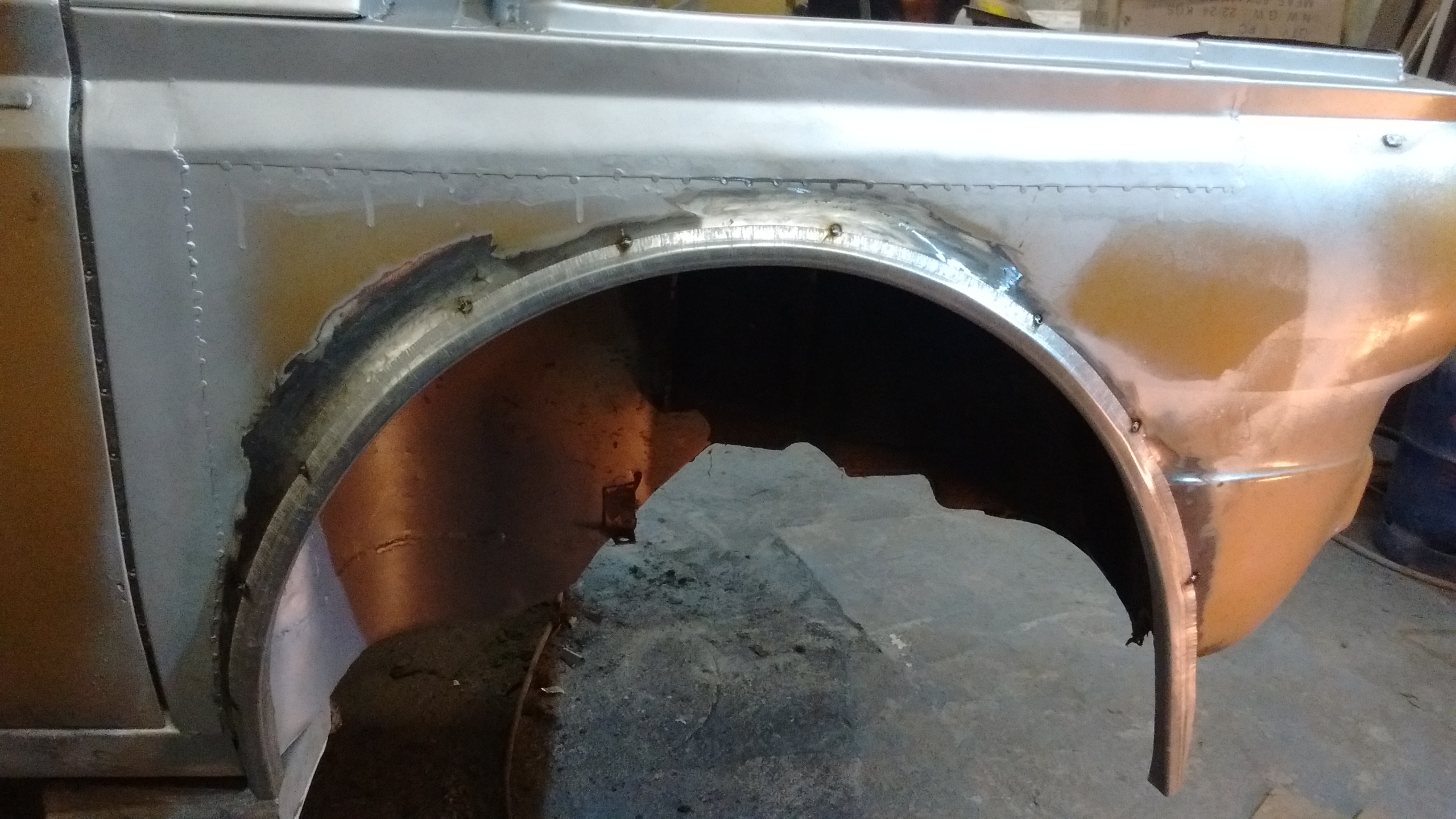

today I set about making another arch repair section
same process as before, start with a straight folded section then make the curve to suit the arch
it then got the return flange put in it and welded to the remainder of the wing.
a repair section was also let in covering a large portion of the back edge.
where it's not yet been welded at the front I will chop that out and make a new section.

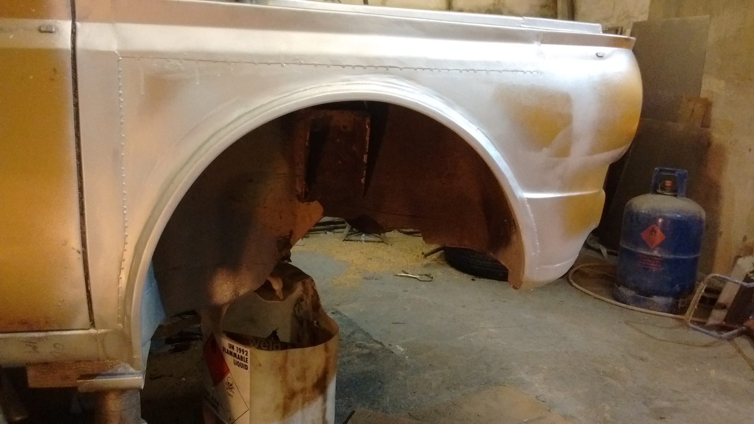

did a little in the week but just so crazy busy with other distractions...
passenger wing almost done

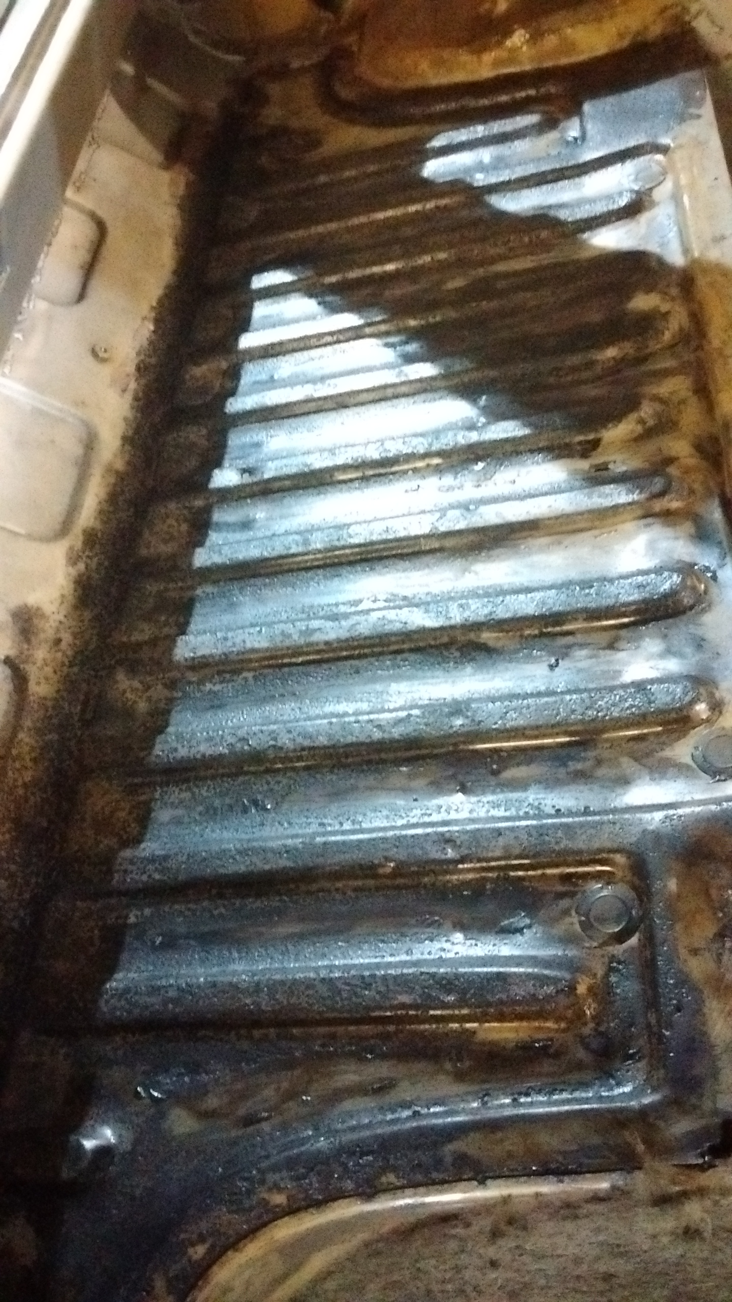

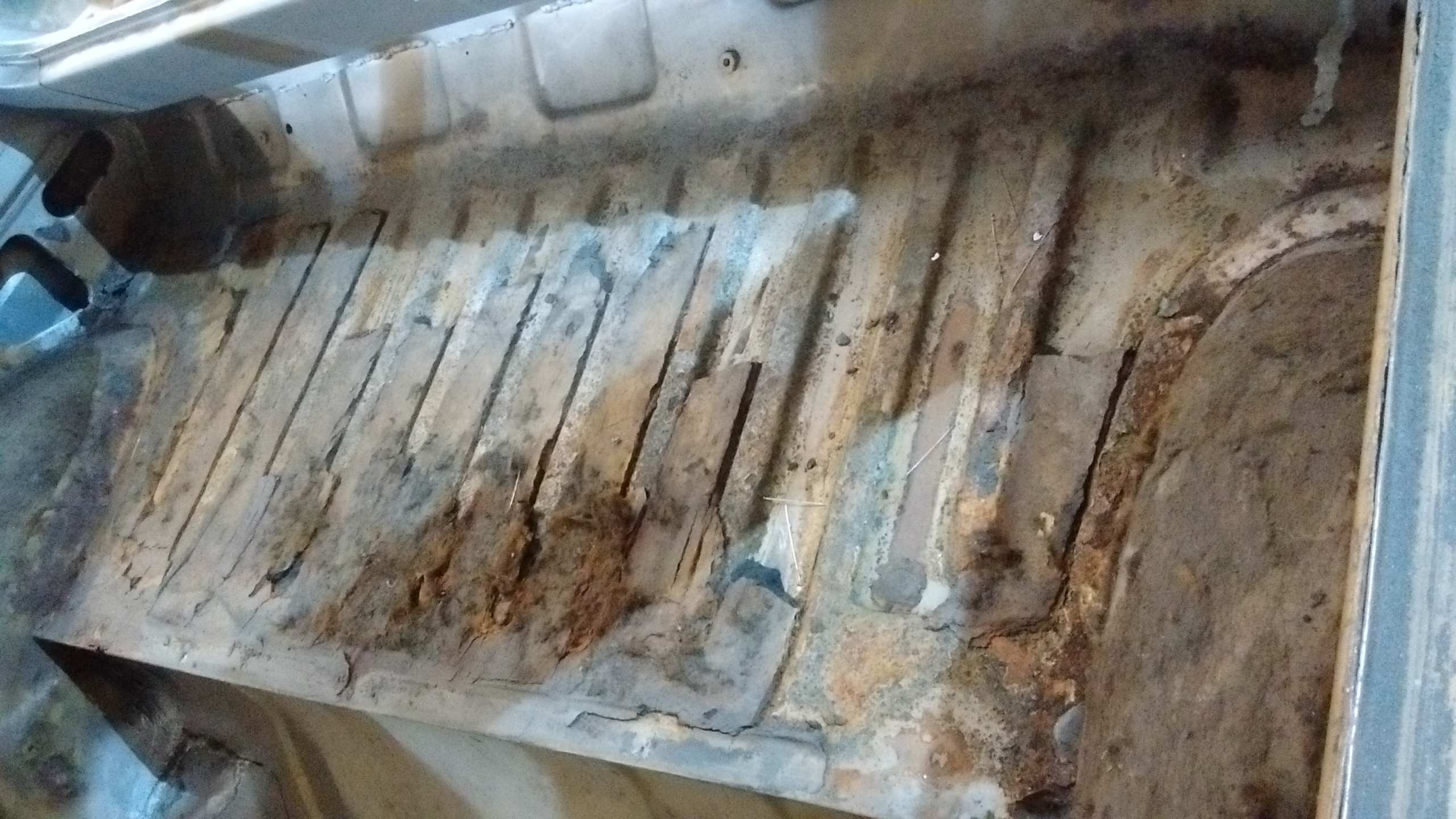

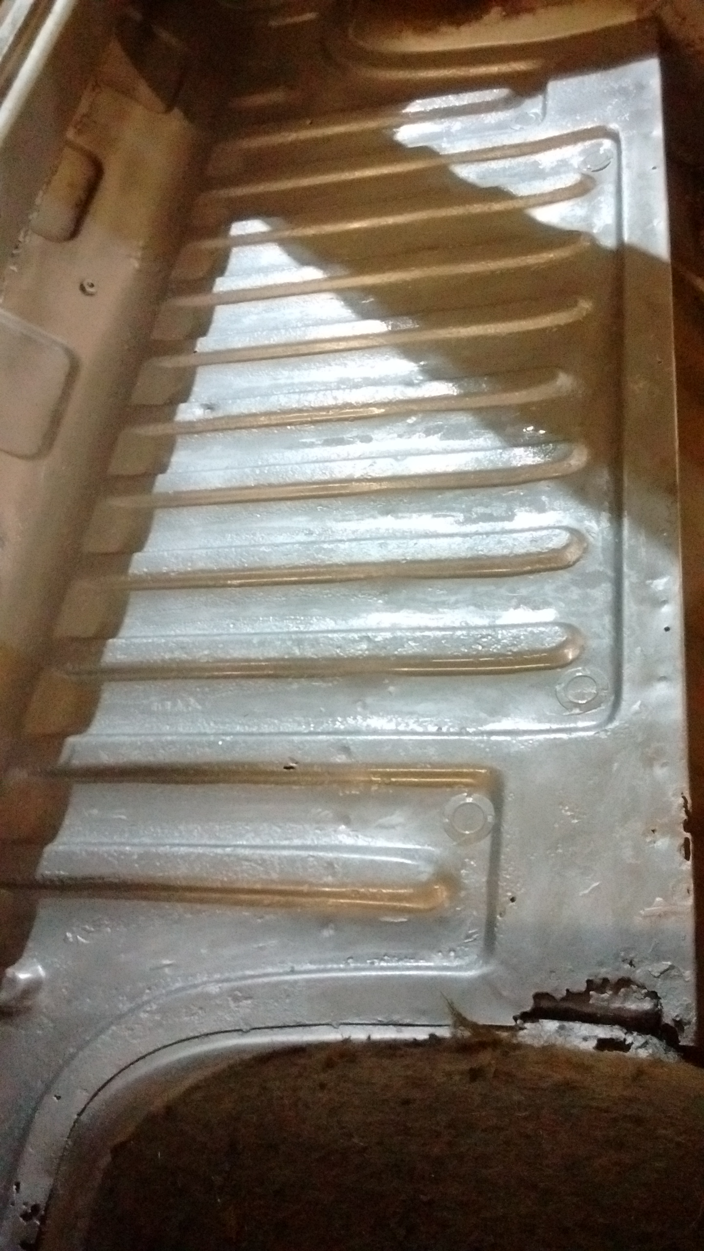

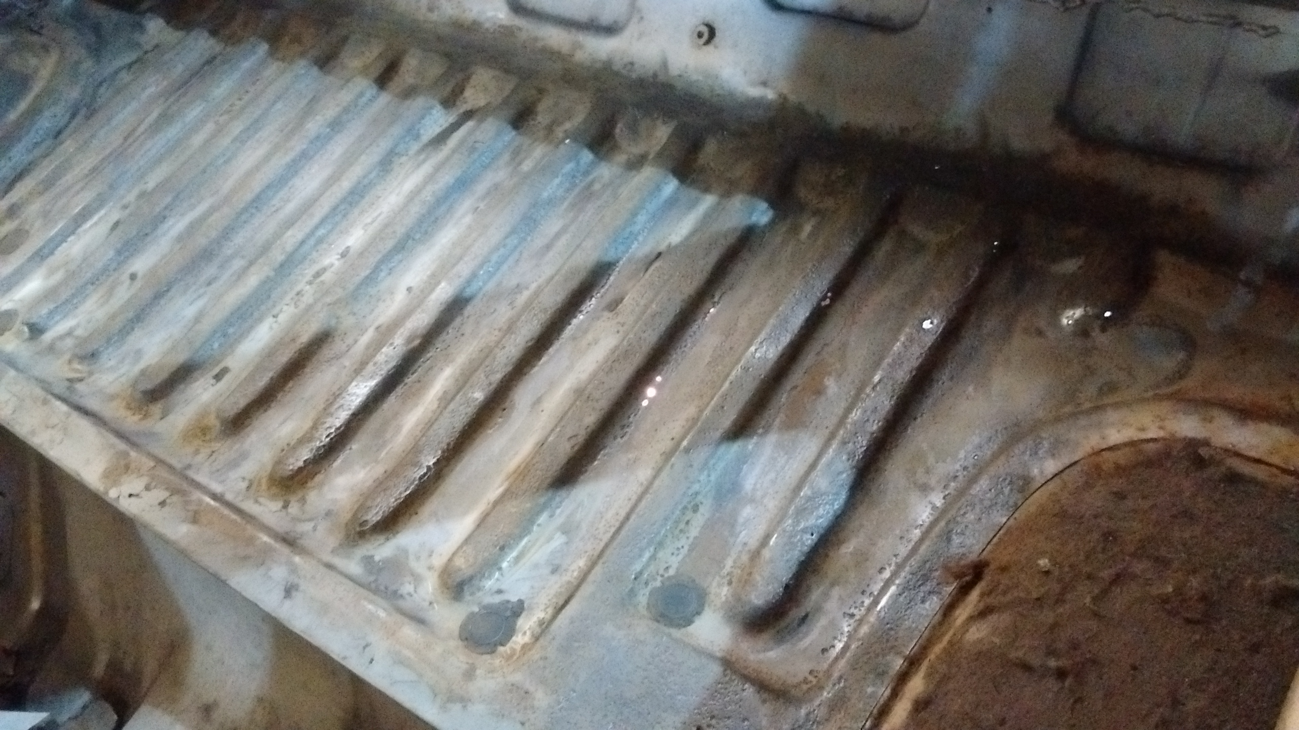

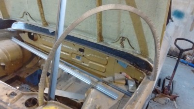

decided i'd tackle one of the jobs that's been niggling me for some time, the shelf under the back window which was covered in thick underseal material
once it was all chiselled out and ground down with the knotted wheel it showed up all the small pin holes, nigh on impossible to repair satisfactorily
decided the best course of action is to treat all the rust with a preservative
once that had cured a good dose of etch would do for now..

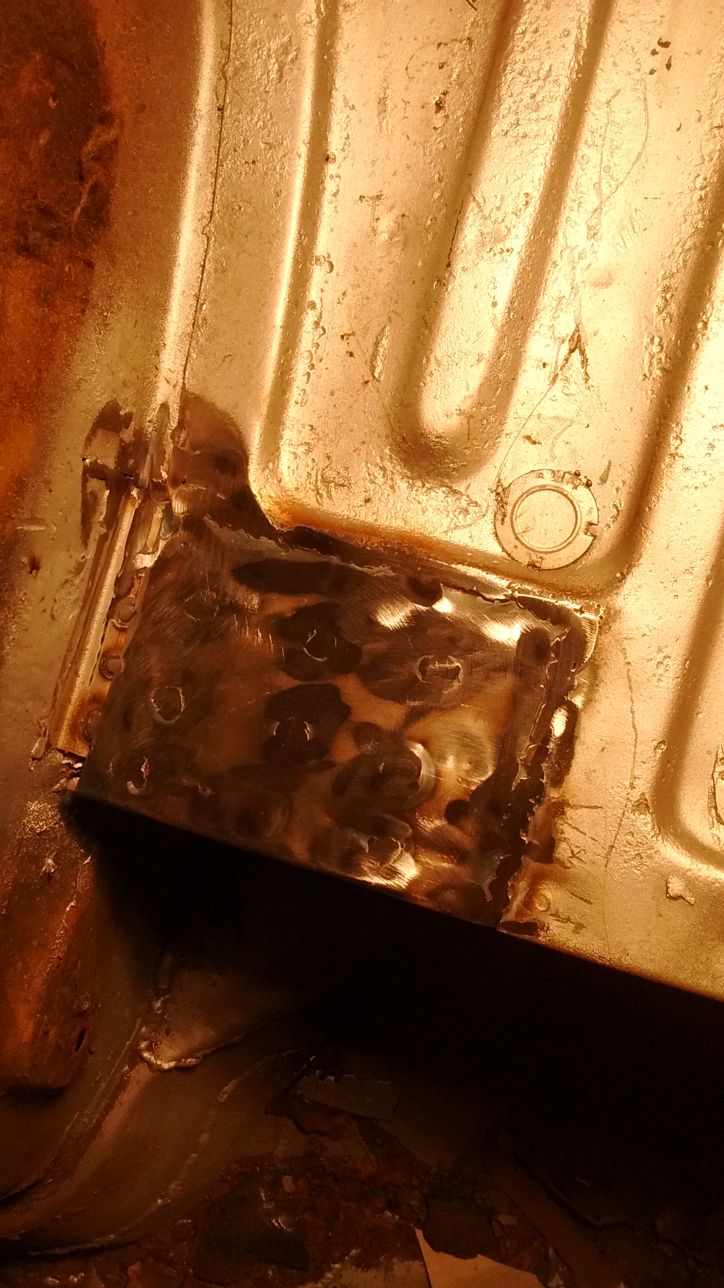

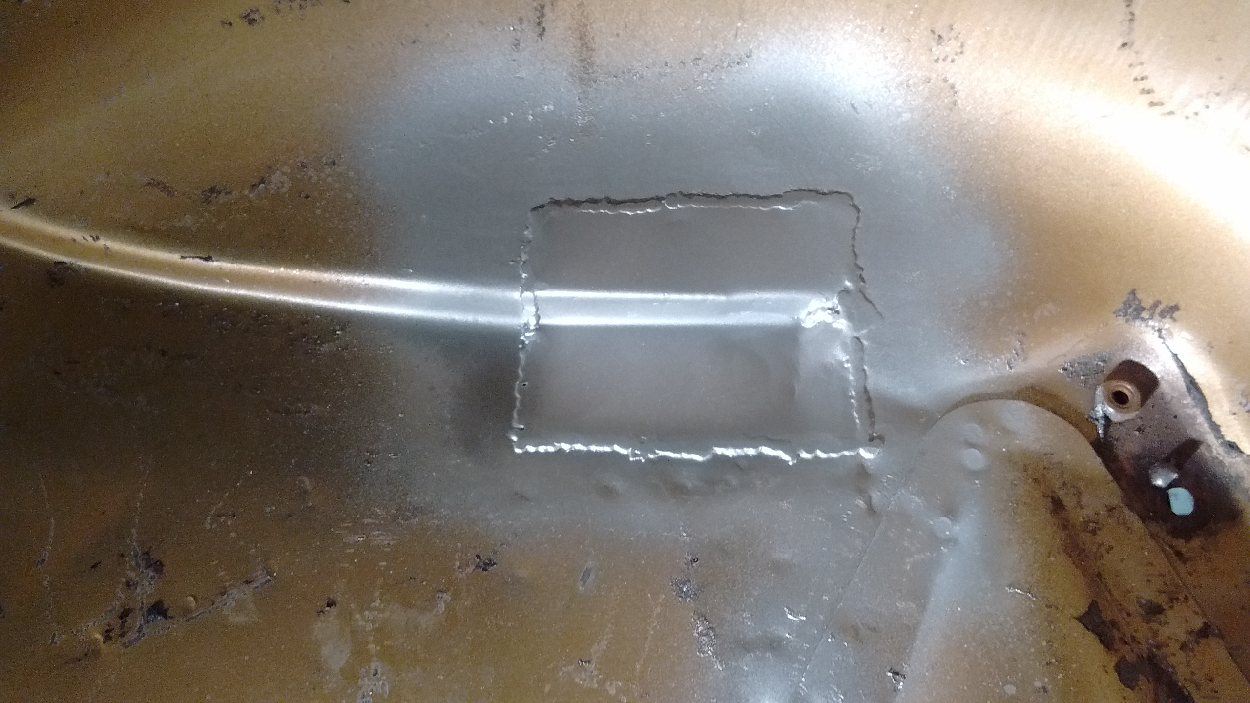

eagle eyed will have noticed in the last picture the corrosion at the bottom which is the drivers side rear shock absorber mount where it joins the shelf and inner wheel arch...
inner arch section made and welded in first
a smaller link section then made up to join the inner arch to the shock mount plate before a new cover for the shelf was made up and plug welded into place
the shelf has now had the small pin holes covered over with seam sealer. these will get a few coats of stoneguard from inside and out then a new shelf will be fitted over the top. I already have a zinc coated sheet ready for this so the cavity will get the best protection possible.

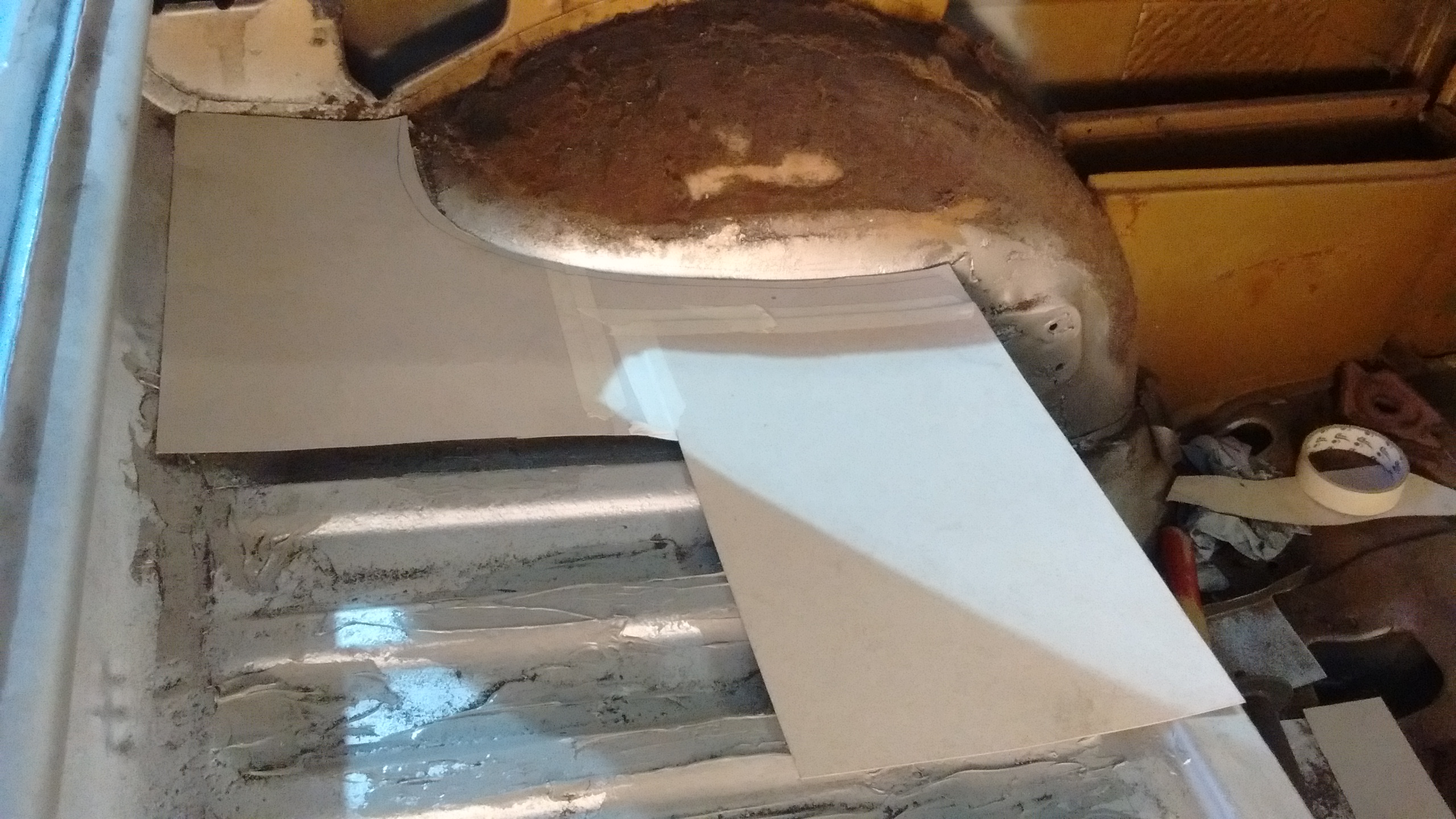

chopped out some more rot from the rear shelf corner, had to be welded in 3 different planes but solid again

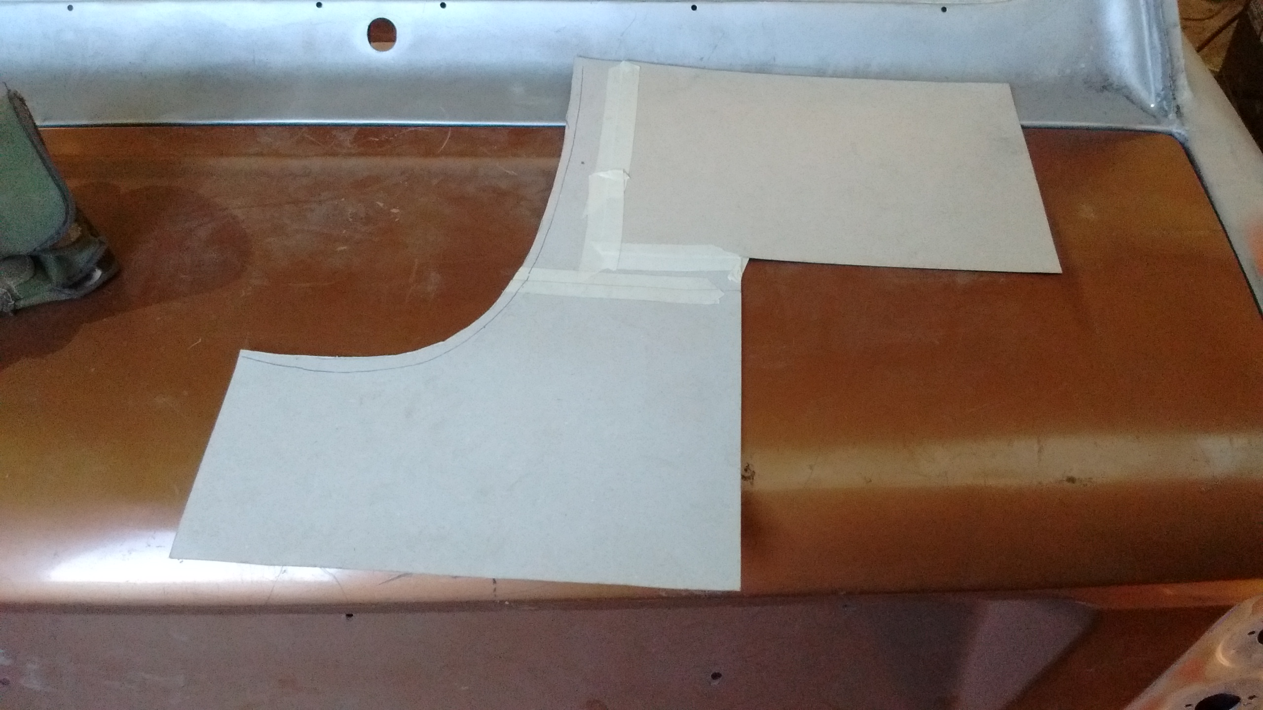

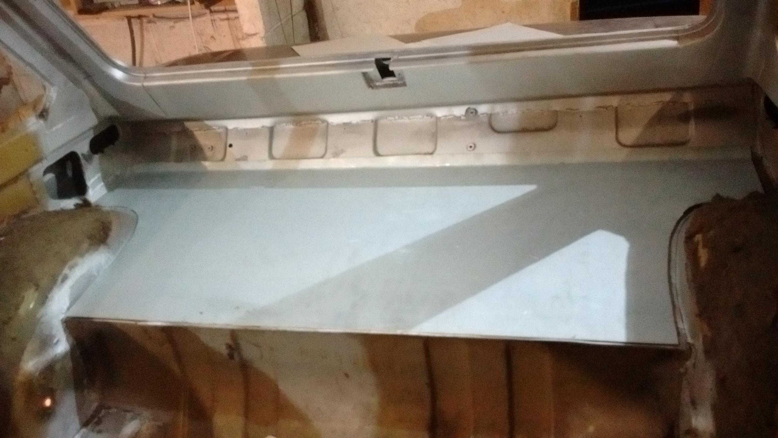

plan is to fit a new shelf over the top of the original so a new one needed making.
first job to make a template of the curve around the wheel arch so the panel could be cut to shape, a few sheets of card taped together is the easiest way to do it
the front edge follows the line of the original panel so it can be transposed onto the new steel
the back lip needs a 3/4" fold but being 4 foot long it wouldn't go in my folder, so trapping it between 2 lengths of wood would have to do

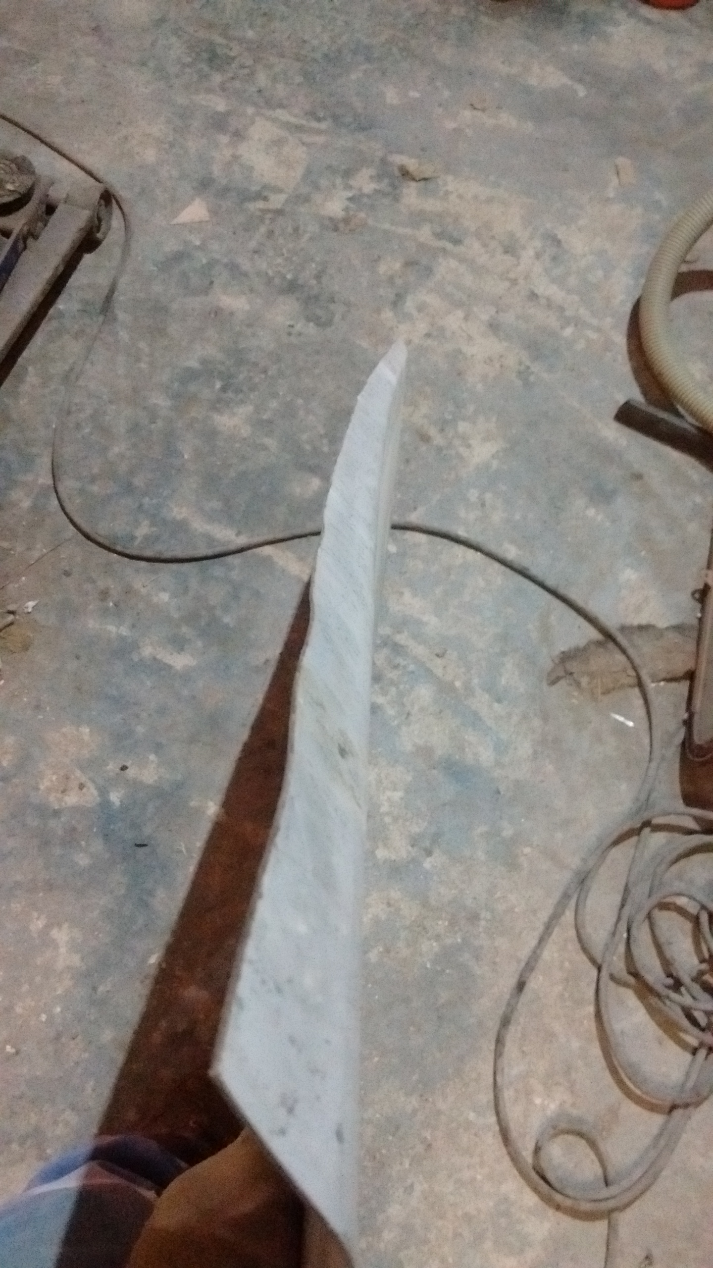

as often happens when manually folding an edge like this you end up getting a curve where the outer edge gets stretched as you fold it over, it can be avoided a bit more than I inflicted on this panel with more care of where you knock the fold over but I thought i'd show how to straighten it back out without resorting to the shrinker
only a bit of a curve but still it's not straight
the method to straighten it is to lay it flat then with a flat faced hammer (a proper panel beating one, the regular ones are too curved) hit directly against the folded edge, forcing it back down in the direction of the fold. this thickens the edge which causes it to shrink. it really doesn't take too much work to straighten it out, you don't have to hammer ten bells out of it. hit it like this...
with half a minute of hammering you end up with a perfect straight fold

the finished repair panel will go here...
before it goes on though a couple of coats of stoneguard will help keep it watertight in the cavity and stop a bit of the sound, the repair sheet is zinc coated from new so the underside should be fine for many years
still debating whether to weld in the panel or use the bonding agent that's used for fixing body panels, probably the latter
