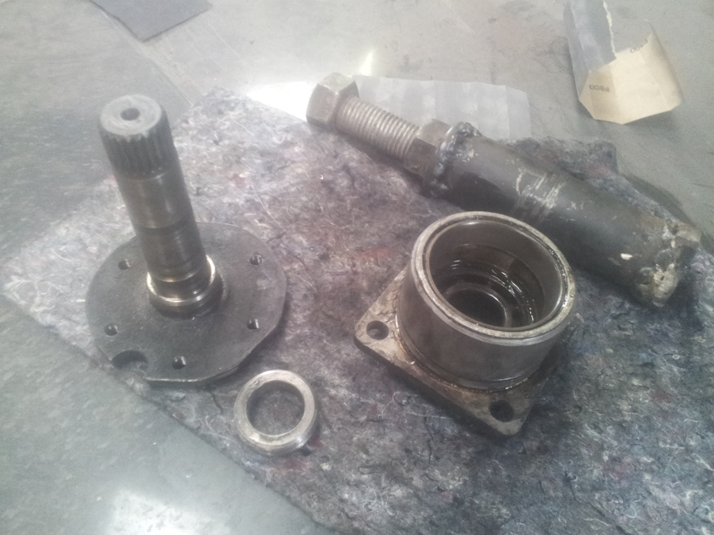

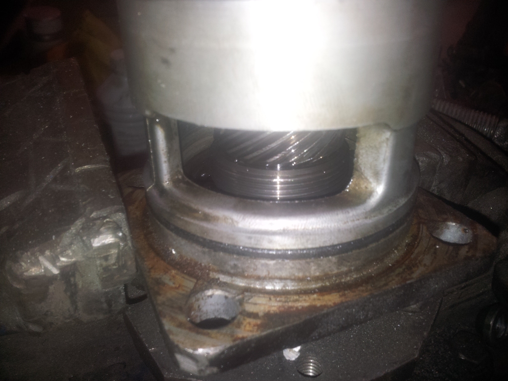

Sud and 33 output shafts and flanges are different (obviously the 33 flange has no mount for a brake disc but is also 12mm longer). The Sud has a helical gear pattern to drive the speedo cable, the 33 has a toothed wheel for the electronic pick up. Secured with a clamped on nut, not a nut actually but it has an outer thread of something like M1x21 or 1.5x22, can't remember. I made a special puller to remove, in my case, the 33 toothed wheel to be replaced with a Sud mechanical wheel. Used a large nut intended for the Sud front wheel baring, made a cut in it and enlarged it 1mm so it could be screwed on the speedo wheel retainer. That was hard to type and probably to understand but I found the pictures...
Re: speedo drives
That's an impressive bit of kit - the retaining collar is a press-fit onto the halfshaft and is used to retain the bearings. In the Haynes manual it is mis-labelled an "oil thrower" but the thread is RH on both sides so obviously would throw oil out on one side if that was its purpose. The thread is actually designed to fit the special puller tool used to get a purchase on it. I believe the same tools are used for Alfa transaxle cars, so you could try a specialist such as Alex Jupe if you don't fancy doing it yourself as Bert has done...
