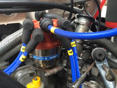

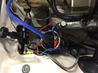

Re: 123 Programable Distributor
Hi Sudman,
I got rid of the Marelli Ignition Completely.
123 ign and a Bosch Blue High Energy coil. Pics as follows:
- Posts: 976
I forgot to say that 123 ign will supply the Bosch Blue Coil and the Ignition leads are Magnecor and the plugs are Bosch as follows:
Hi
Thanks for all the info, from your photos do it looks like you wire the distributor straight to the coil, so there is no ignition module.
Is that correct?
Is that correct?
- Posts: 976
Hi Sudman,
That is correct. The distributor is wired directly to the coil. There is no module next to the coil anymore.
Of course in a racing car I had no need for the capacitor to suppress radio interference and I have no vacuum tube from the manifold to the distributor. The distributor does have a vacuum advance pipe if you want to use it. The instructions for setup are good.
- Posts: 976
I forgot to say that I bought some braided expandable flex sleeve with heat shrink at either end to make a neat little harness.
I picked this up from Toms super neat wiring and wanted to maintain the standard.
