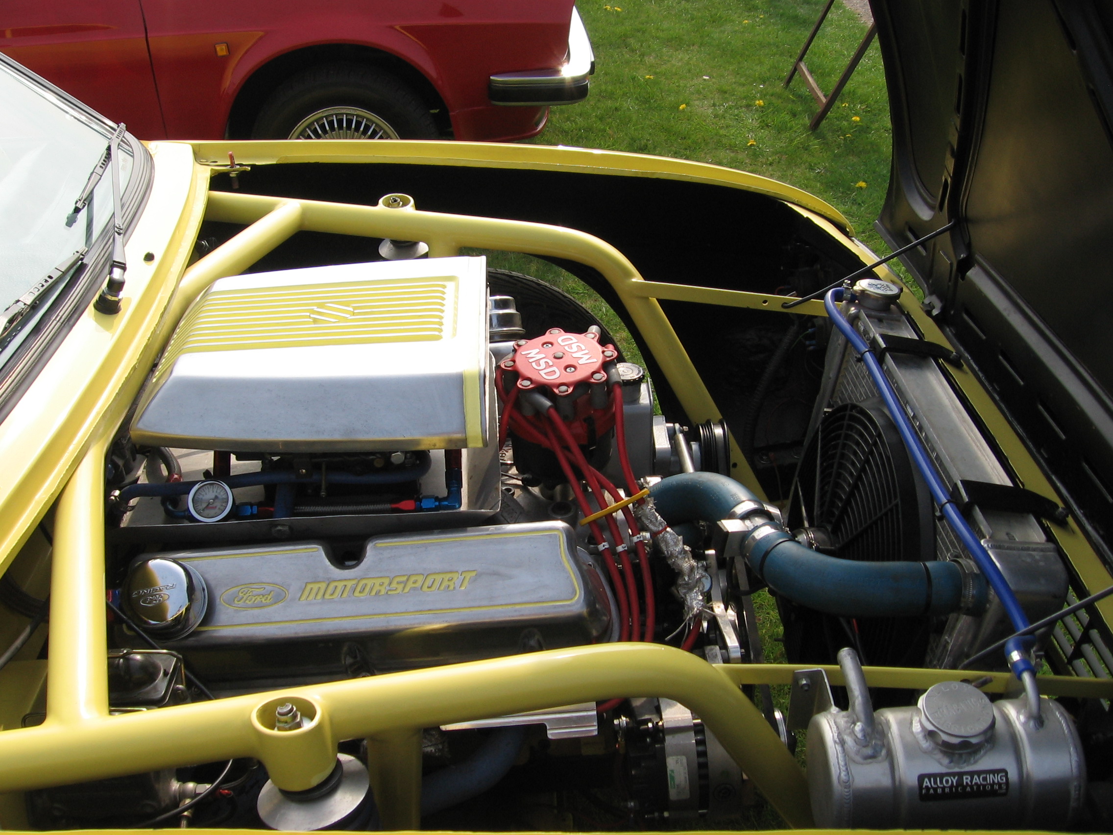

How many remember seeing this?
JetJackson
- Posts: 145
- Joined: Mon May 16, 2016 2:34 pm
- Location: Winchester, Hampshire. UK.
- Contact:
- Posts: 573
Re: 2.0 Twin Spark engine/gearbox into a Sud ?
Re the V8 Sud
On the "Other" Forum Eddie posted on my 6C thread
"Yeh will be on the road this year after 2 years off, new engine (3rd) floor dropped by 4 inch's, new fuel system, brembo brakes, wheels, paint and two stage nitrous kit, yes been busy, see the 6c is still going , will be at the first RWYB at North Weald on May 8th.
Do you or any of the guys on here have a Sud TI rear spoiler?
That was in March 2016.
