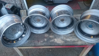

just thought these were worth sharing with you, as they were at one time for sale but the owner, Colin, changed his mind, clearly once he'd seen a photo of what i'd done with them! :lol:

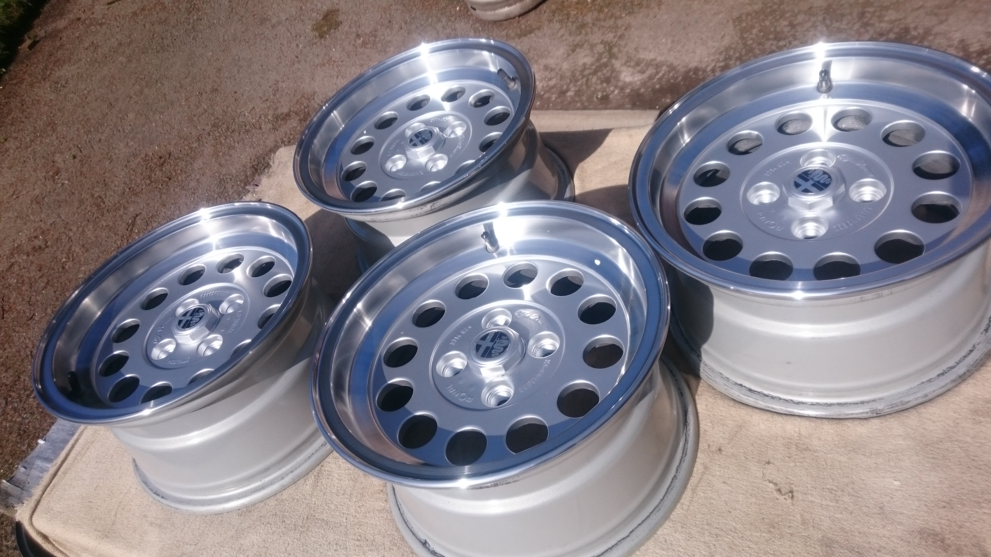

To begin with, they are a pretty rare size of 13" by 7j wide, not the usual 6j's, and are a lovely design, adorning a number of Suds and Sprints over the years. They are as many of you will recognise, Ronal A1's.
They had been previously powder coated, and looked ok, so we agreed that a good polish to the dish and rim would provide a nice contrast, so that was the plan.
So they went from this
2016-03-28 22.20.42-2.jpg (16.46 KiB) Viewed 24624 times

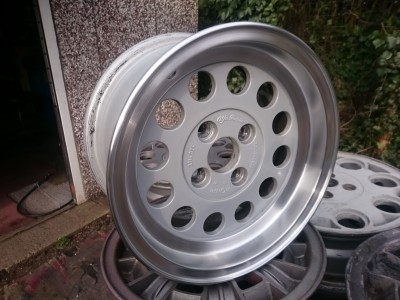

To this
Not bad, but if i'm honest, i wasn't impressed, and the contrast just didn't look right to me, so i convinced Colin to let me have some artistic license and change the centre colour to a nice silver rather than what now reminded me far too much of primer!

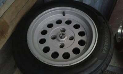

Matching it up on the centre caps aswell, i think they are a whole lot nicer now, looking like this
Now i think they look the mutts nutts, but unless you promise to cross Colins palm with many bits of silver, he';s keeping them i think! :P

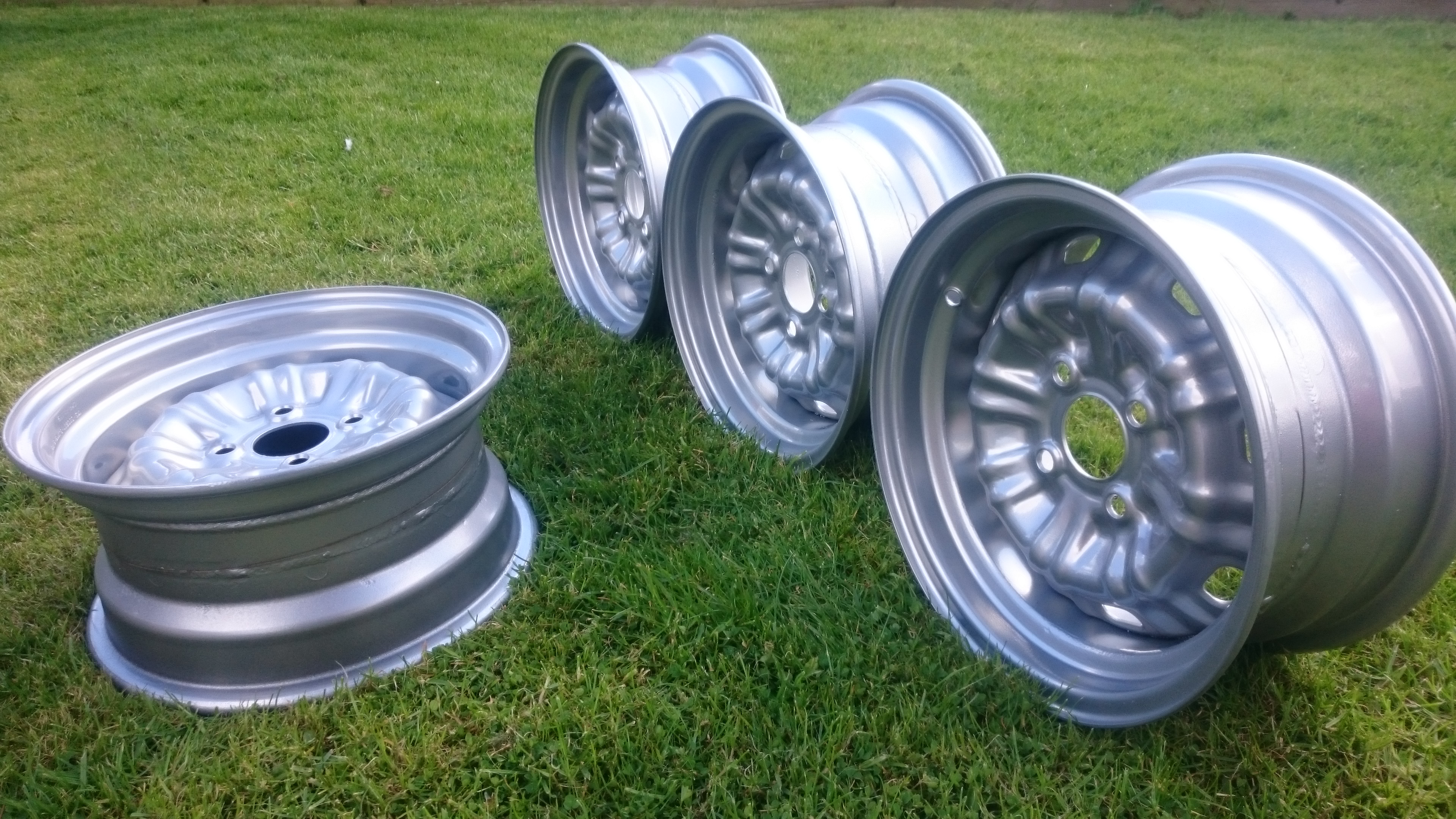

Secondly, another set of wheels i'm doing for Colin, is a set of original Sud steelies, that have had 2" added to them by banding them with an extra steel strip. These are going to be finished now in a good solid silver powder coat, and will look fantastic with some nice dish to them and the better/bigger tyre option is a big bonus too.

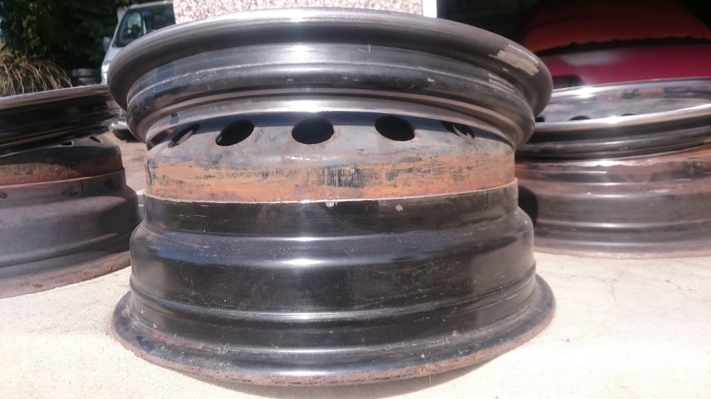

I can't take the credit for the banding on these, and John at Justsuds has already done a few himself too, but its oddly well timed as i'm right in the middle of doing some banding myself on my old van steelies that have been sat around teasing me into trying it now for ages.
Ive done the easy bit, cutting them into sections, and have since shotblasted them to give me the perfect virgin surface to weld back up, so i'm just waiting for my steel to arrive and time to get the mig sizzling!

nice work again mate, loving the polished rims on cols' wheels, smashing result ;)

I've always wondered with banded rims, are they usually pretty decent for an airtight weld or sometimes need a little help?

Beautiful job on the Ronals Shrew. They look so much better with a bit of colour and that lovely polished rim. I can't see Colin parting with them now. 8-)
Also like the look of the banded steelies. Will that give all the extra width, off set with no inner clearance difference ? Can't wait to see them on a car.

Kev, the air tight weld thing will be my own concern too if i'm honest, but i'm going to be using my tyre machine and/or balancer as a welding positioner and try to get as consistent as i possibly can after plenty of practice and machine set up time on the 3mm steel i'm going to use. I'll fit tyres to them and pressure test them as high as i dare, and thankfully someone kindly got me a fresh bottle of leak finder recently too, so that will hopefully come in handy but prove my welding set up is good fingers crossed.
If it leaks, i'd rather do another weld pass if needs be, but with split rims i do, particularly the Compomotives and Revolutions where you can't buy the sealing rings anymore, i find Sikaflex is perfect for the job.

As for the banded sud steelies, yes they should great , and without the usual fitment issues of larger alloys etc as you point out. A good compromise of improvement without losing too much originality,

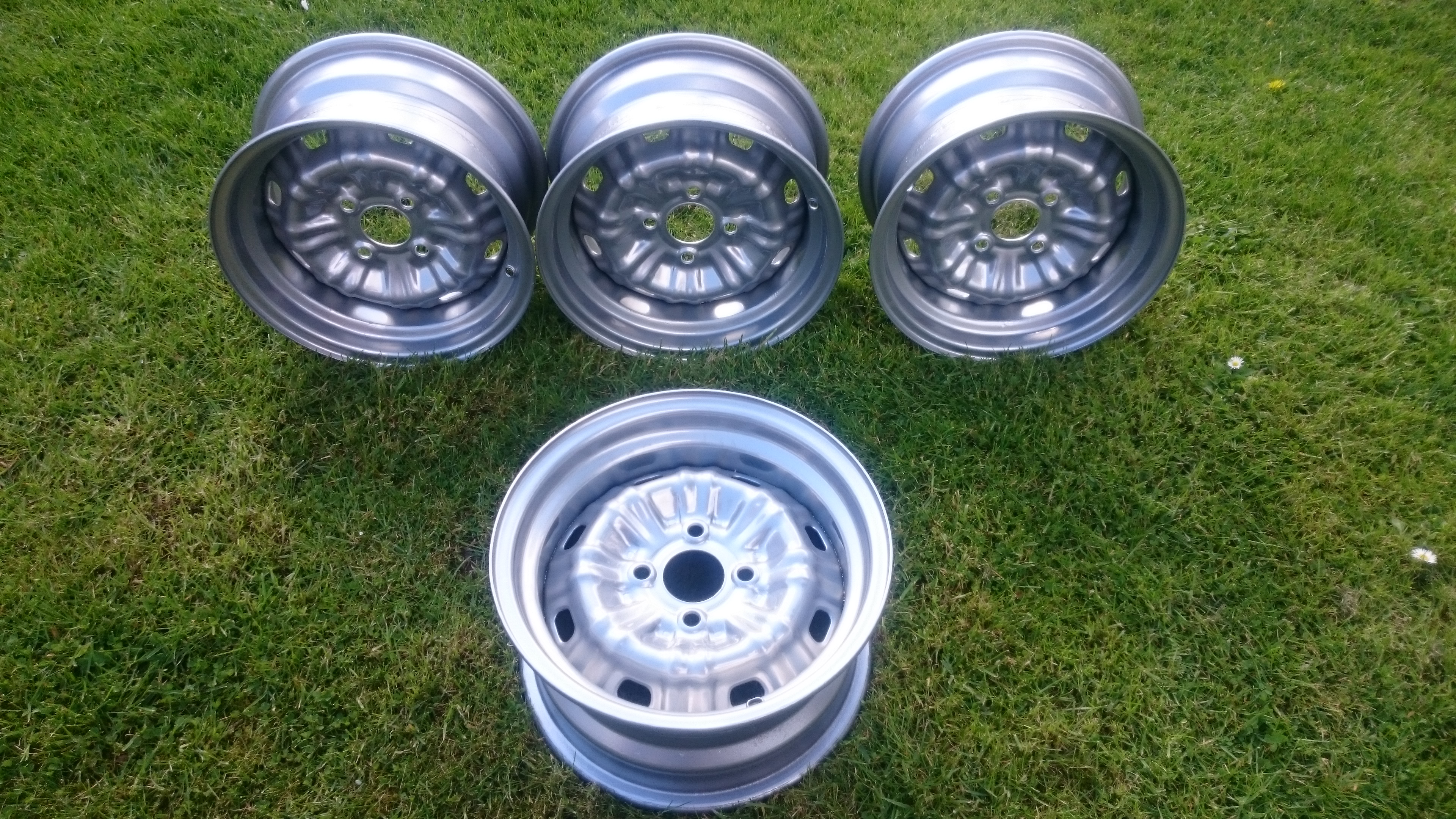

And here they are, finished in the usual silver powder coat and laquer.
look rather tasty i think :D

OH YES !!
They look good as well mate.
Should look great on the car. 8-)
Re: Nice Sud Shoes!
Superb! Always liked this design of wheel - it shows how good you can make pressed steel look.

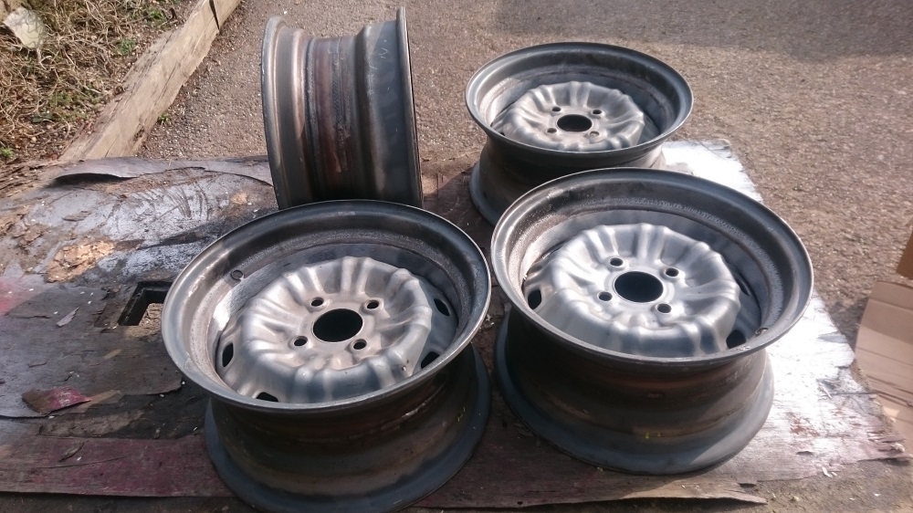

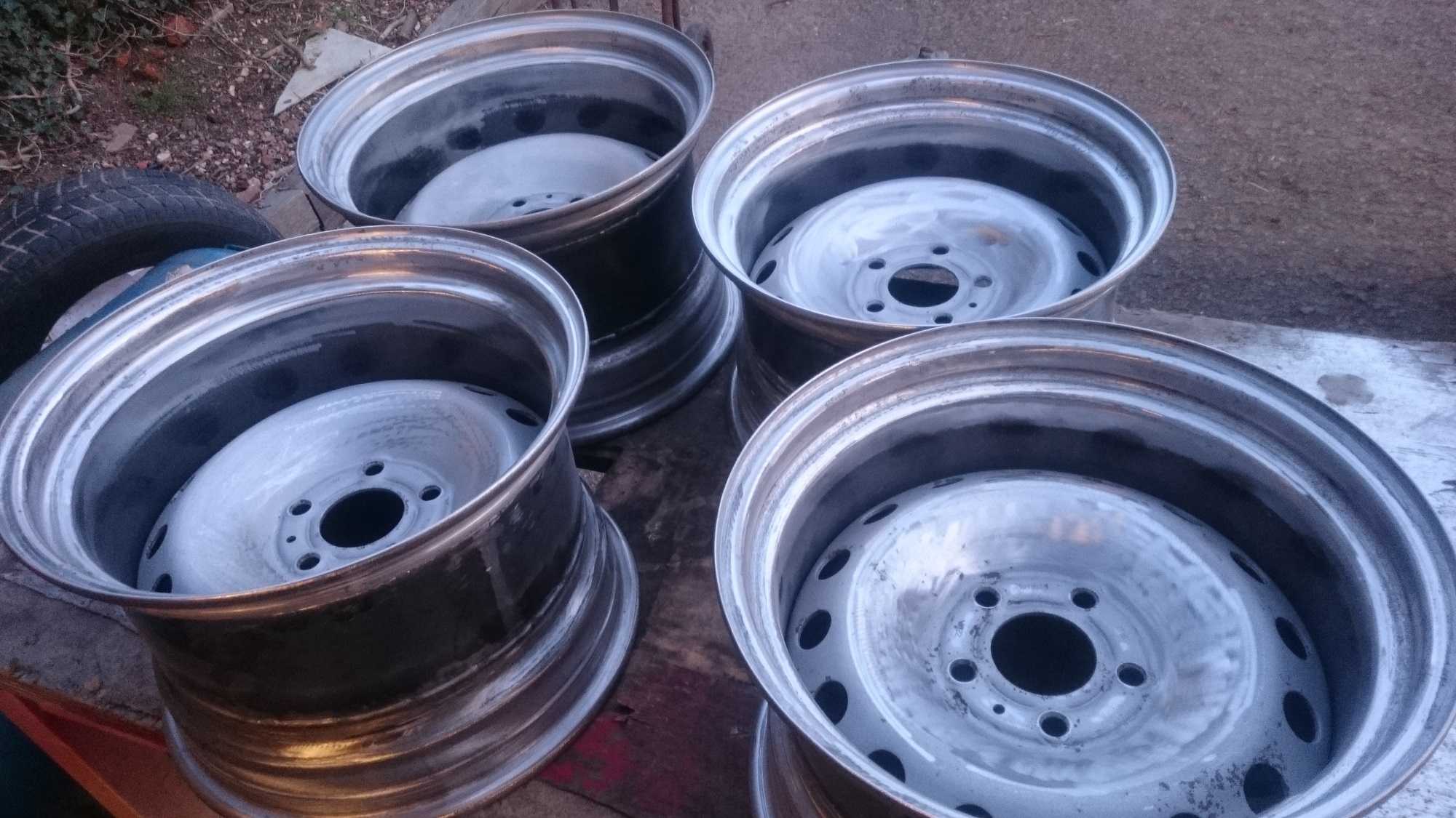

and more for an exercise than any real practical use, i'm done building the Carlos Vandangos!
No, not a typo, which you'll understand once you see what i've done with my original steel Vivaro wheels! :?
So thats a full 10j up front and 11j rears after adding 4 and 5 inch bands :shock:
They won't fit anything without extreeeeeeeme arch modification, so i think i'll just powder coat them in something really showy, and use them as exhibits and adverts.
But, i bet some daft VeeDubber would like the idea of them on their 3mm high Polo! :lol:

bugger me, that's some wide rims now mate.
how long before the veedub boys want some? :D

Bit to wide but I want some

KevJTD wrote:bugger me, that's some wide rims now mate.
it took all of about 2 hours between me finishing them to the point you see them, and a mate of mine, who dips Hydro Graphics by the way, ordered some for his T5 Transporter!
Here is a fresh thread on Banded Steels so's not to overly confuse this thread.
Please direct any enquiries there
viewtopic.php?f=47&t=1375&p=17641#p17641

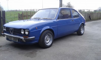

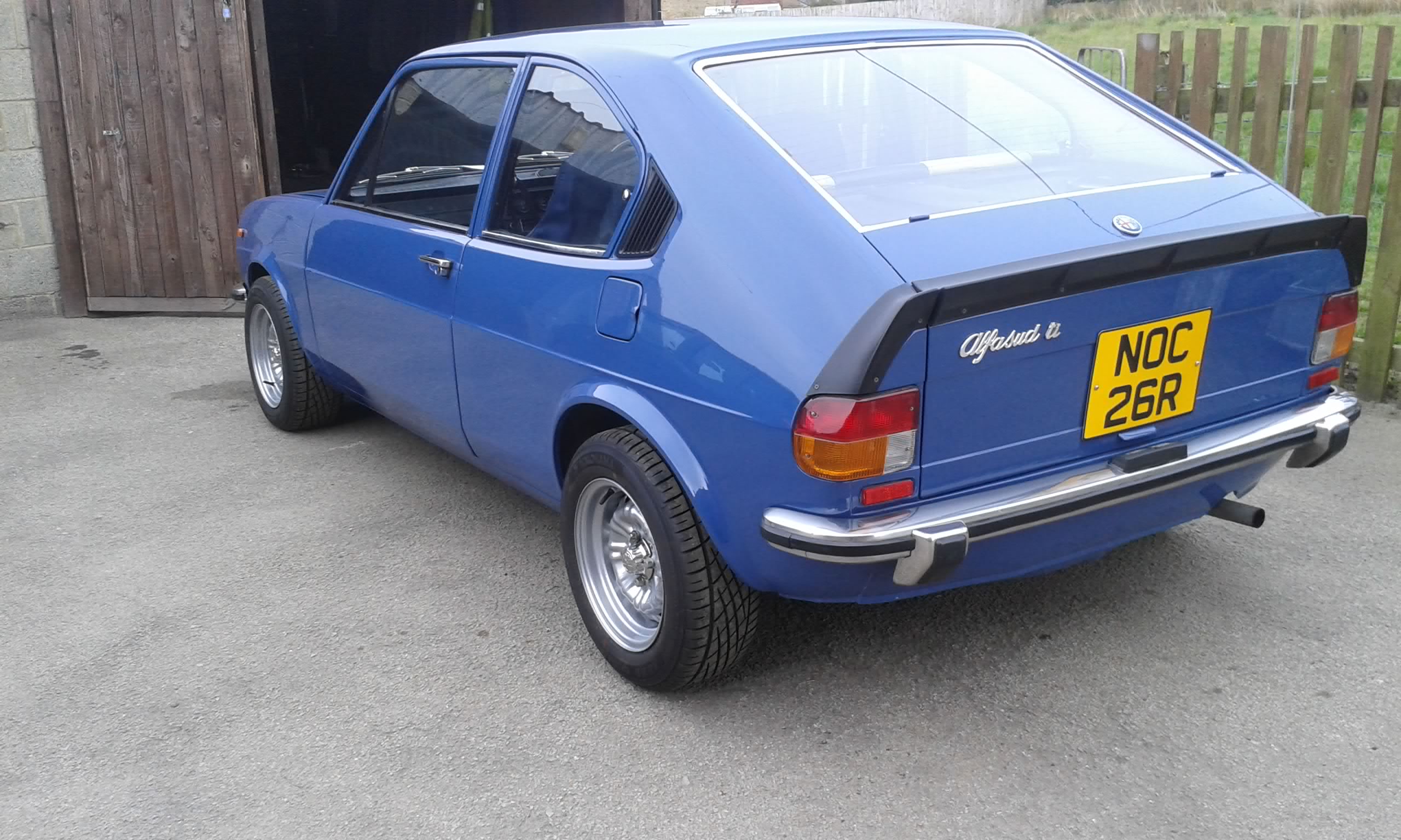

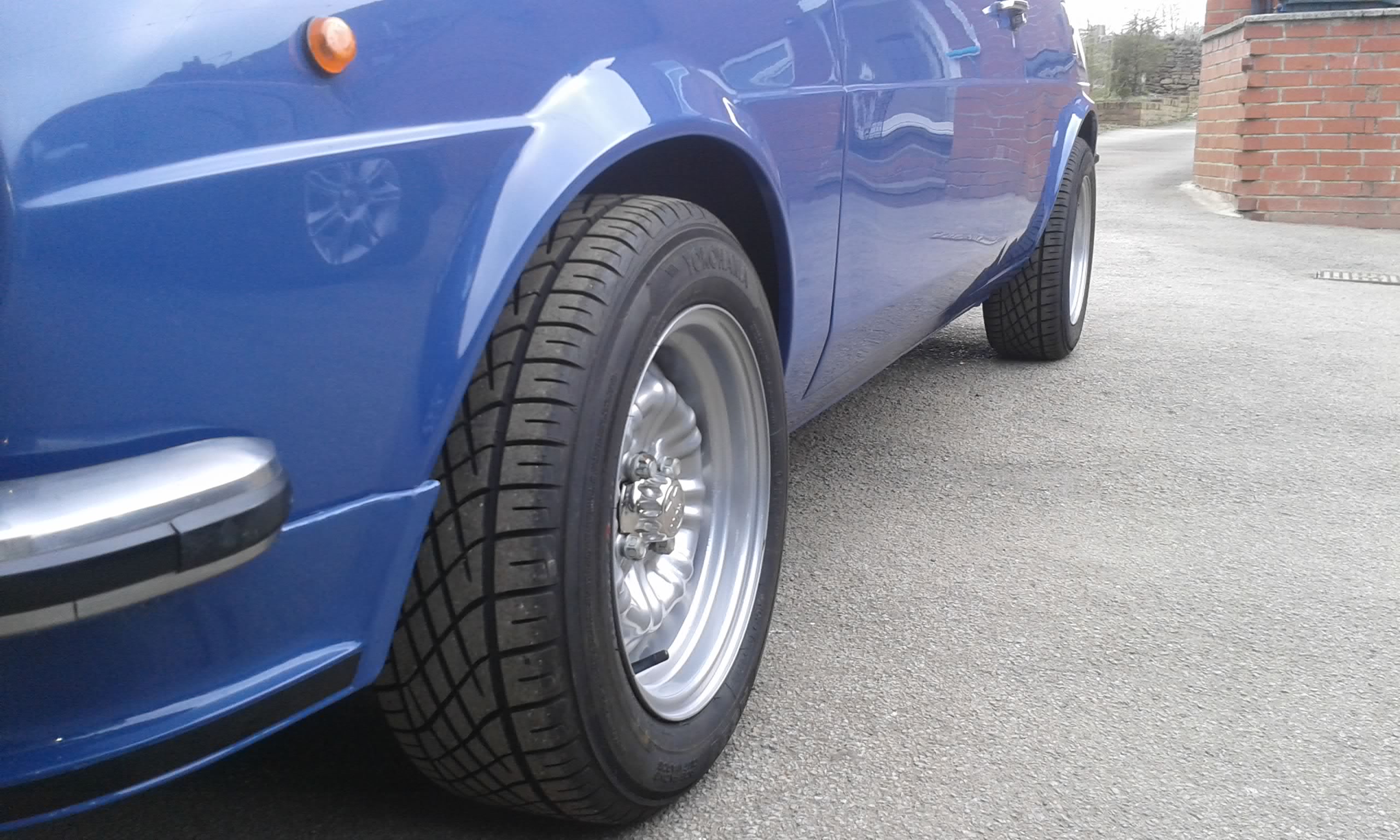

So here are the banded wheels fitted on the sud, they look spot on! Going 6.5" width is just right and suits the car perfect in my opinion ;)
sud_1.5ti
Posts: 84
Re: Nice Sud Shoes!
Post by sud_1.5ti »
Looks Perfect!
Are you using justsuds lowering Springs?
Best regards
Jan
Re: Nice Sud Shoes!
They look great Col.
So 6.5 inch rim, what size were your tyres?
Cheers. 8-)
Re: Nice Sud Shoes!
look like they were always meant to be, nice effort all round ;)
sudboy1490
Posts: 242
Re: Nice Sud Shoes!
Post by sudboy1490 »
Yes jan theyr justsuds springs but i had to put 20mm spacers up front as the drop from them wasnt equal.
hi keith hows things? After much deliberation of what tyres to use i ended up using the 185/60 yokohama A539 i had spare. Ideally i think 185/65 might have been a better choice for a bit more rolling circumference as it revs pretty high on motorways and am lucky to get 25mpg out of it. I even thought about 175/70 but i dont think theyd look sporty enough!

I can't see that there can be many cars prettier than that. Lovely.

This has to be one of the nifftiest S1 Ti's I have ever laid eyes on.
Lovin the colour and the effect of the new wide rims.
Classic 70's auto porn or what?
