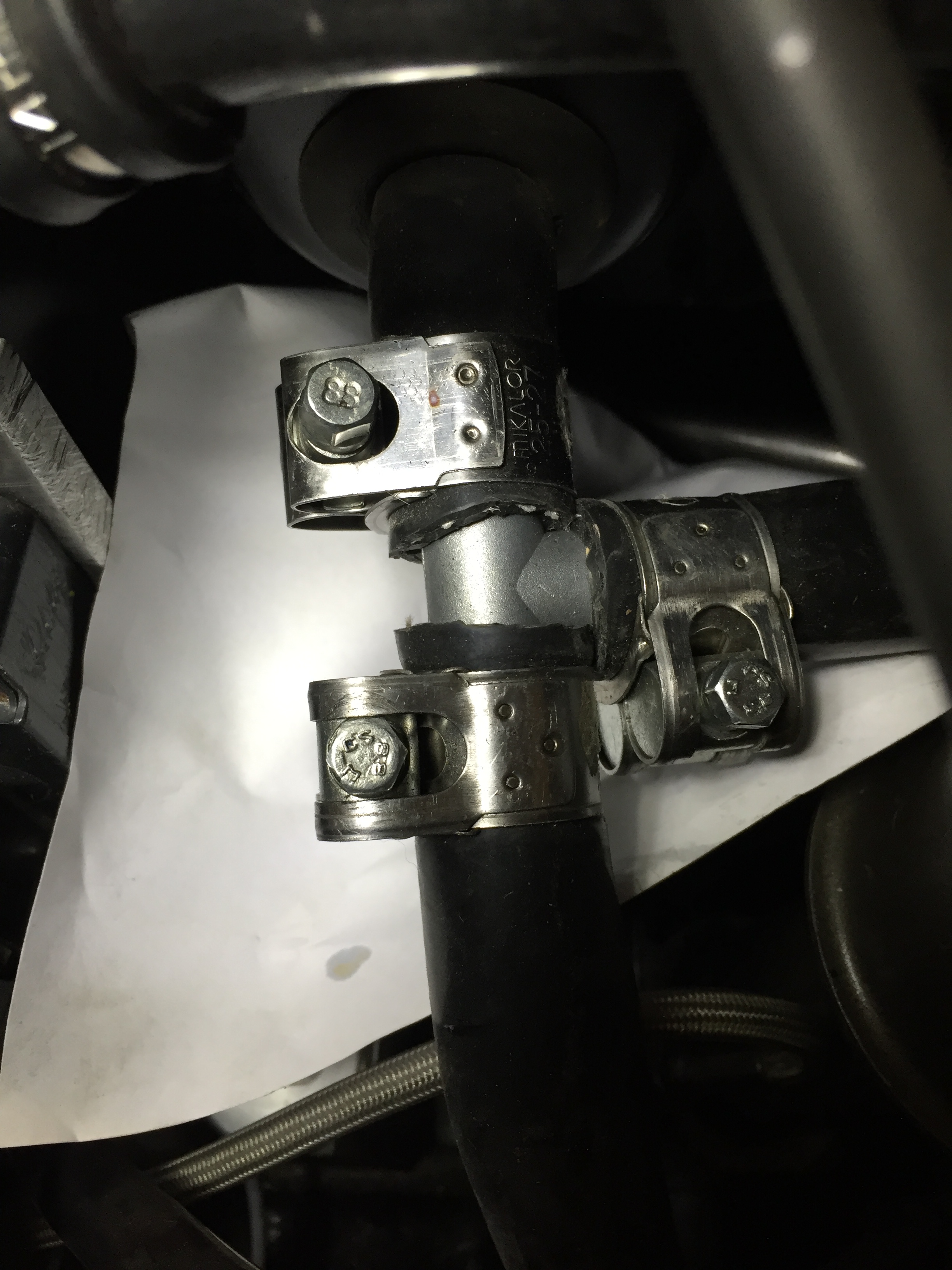

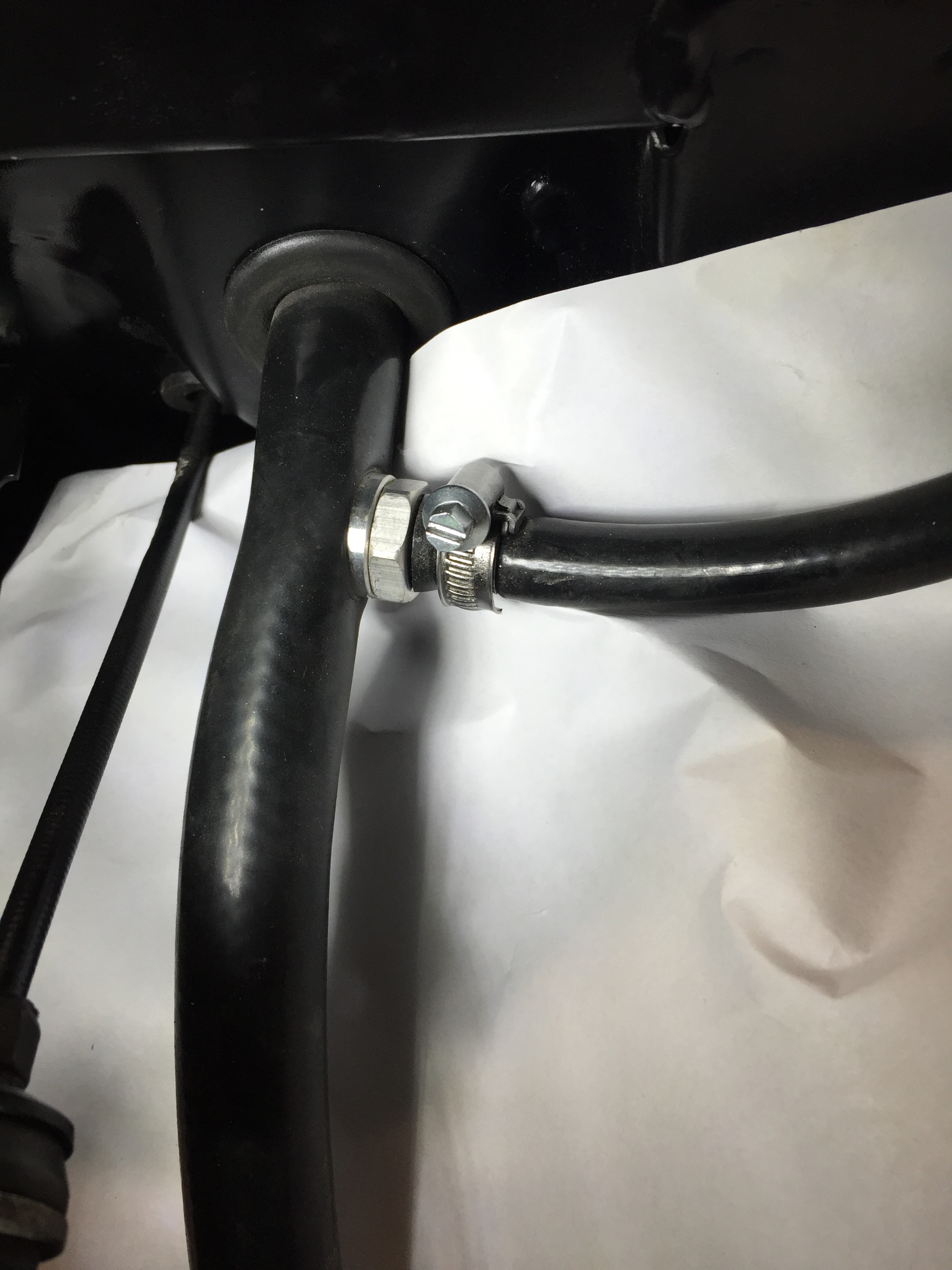

Re: 16V cambelts and hoses
Hello Adie,
Apologies in advance for the photos - black hoses in a black car in a dark garage..
For the stretches that go to and from the heater matrix I used flexible silicone tubing that I bought from ASH in Scotland.
On the drivers side it looks like this:- with one of these to tee off the 8mm bore tubing to the expansion tank as I wanted to avoid using the crumbly plastic tee pieces and Icouldn't find a 16x16x8mm aluminium or stainless one anywhere:
http://www.ebay.co.uk/itm/Revotec-Self- ... XQNOZRC6Rr
On the passenger side it looks like this:- With one of these equal bore tee pieces that is much nore robust than standard.
http://www.ebay.co.uk/itm/LPG-AUTOGAS-T ... xy8F1RFnT0
Thanks,
Adam
