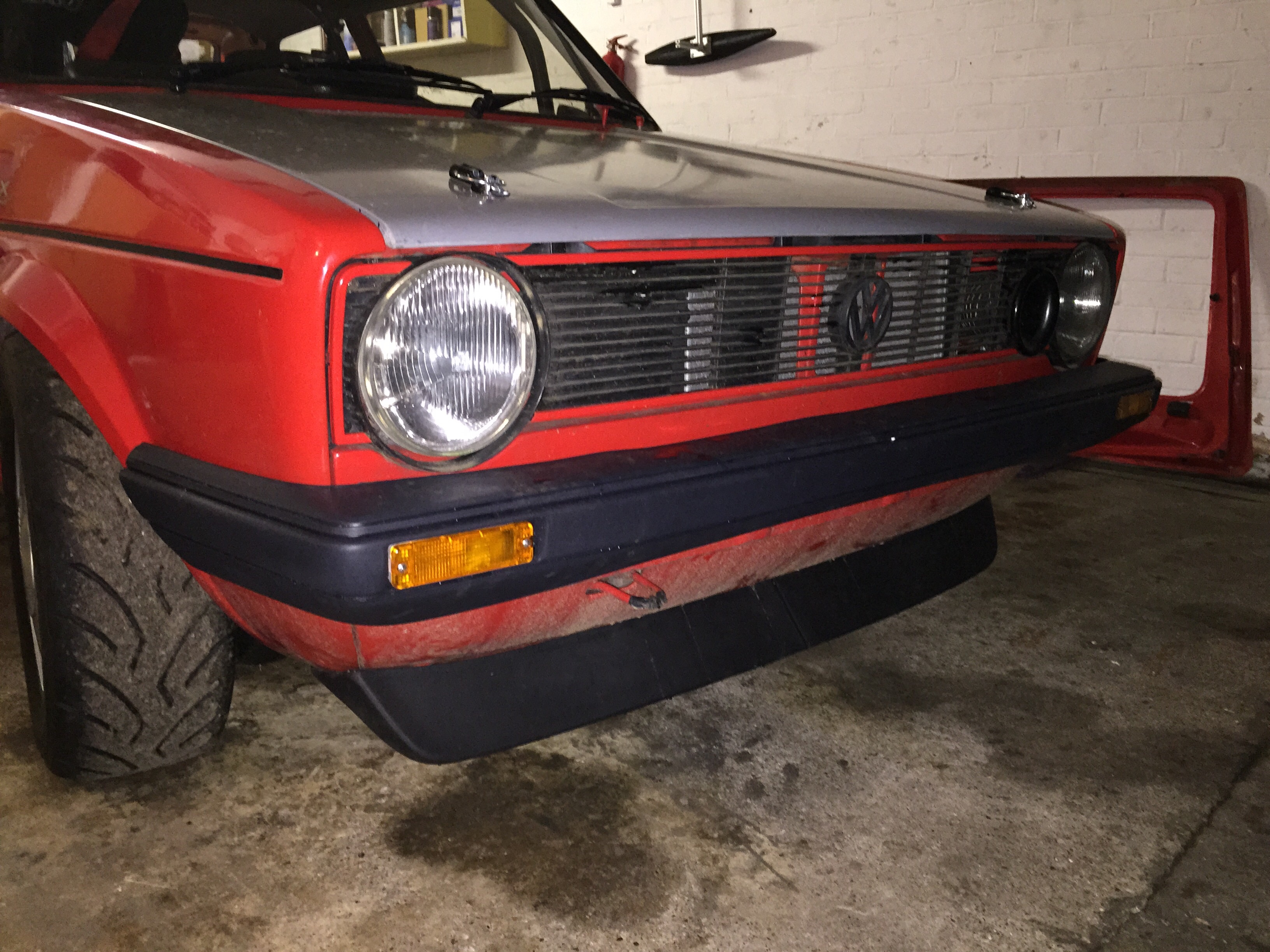

Hi Guys,

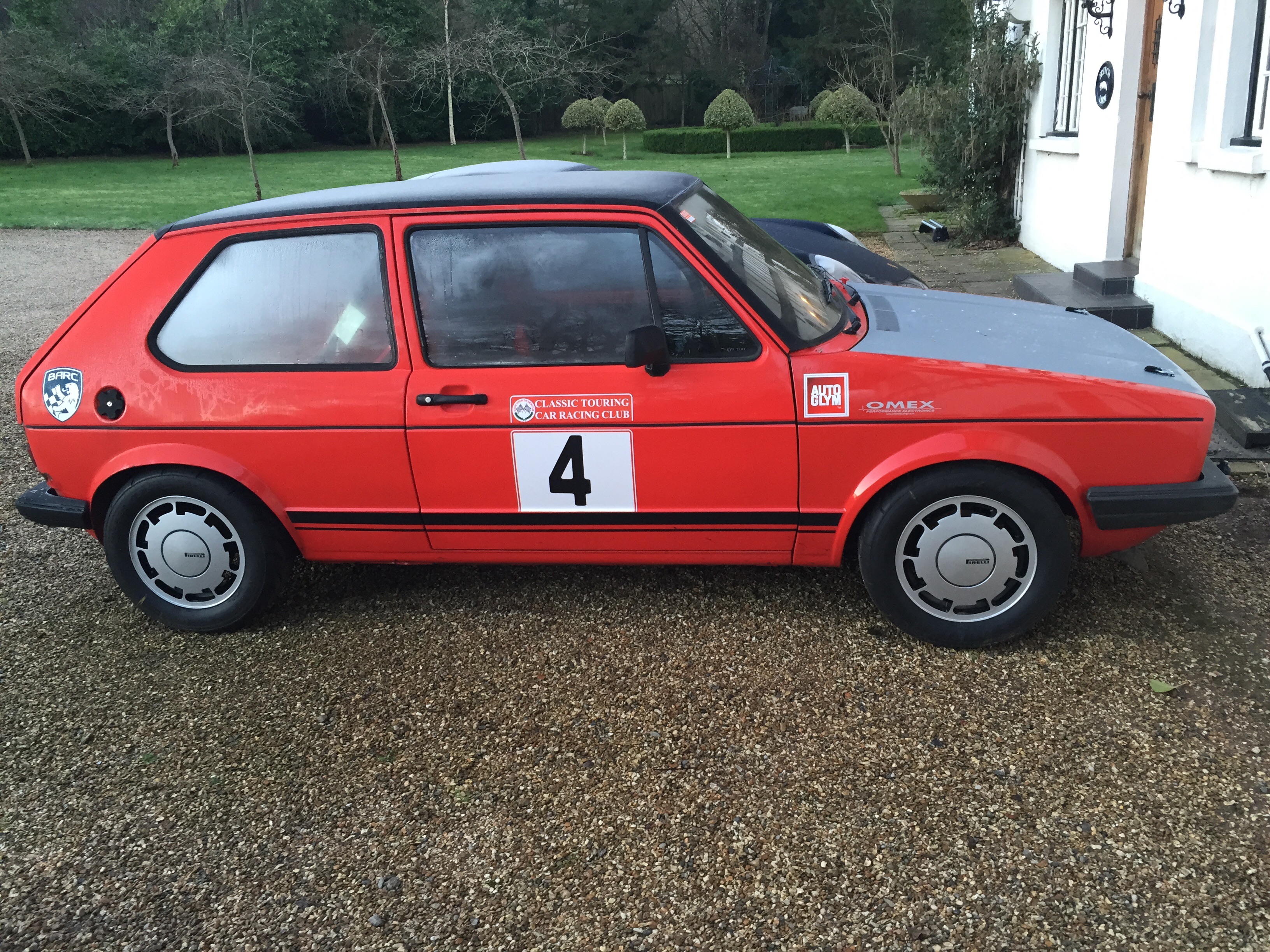

I have been making the Golf lighter and weighing parts as I go. I know it's a Golf but I thought the weight savings would be of interest.
For me, I want it to stay looking like a recognisable Golf GTi.

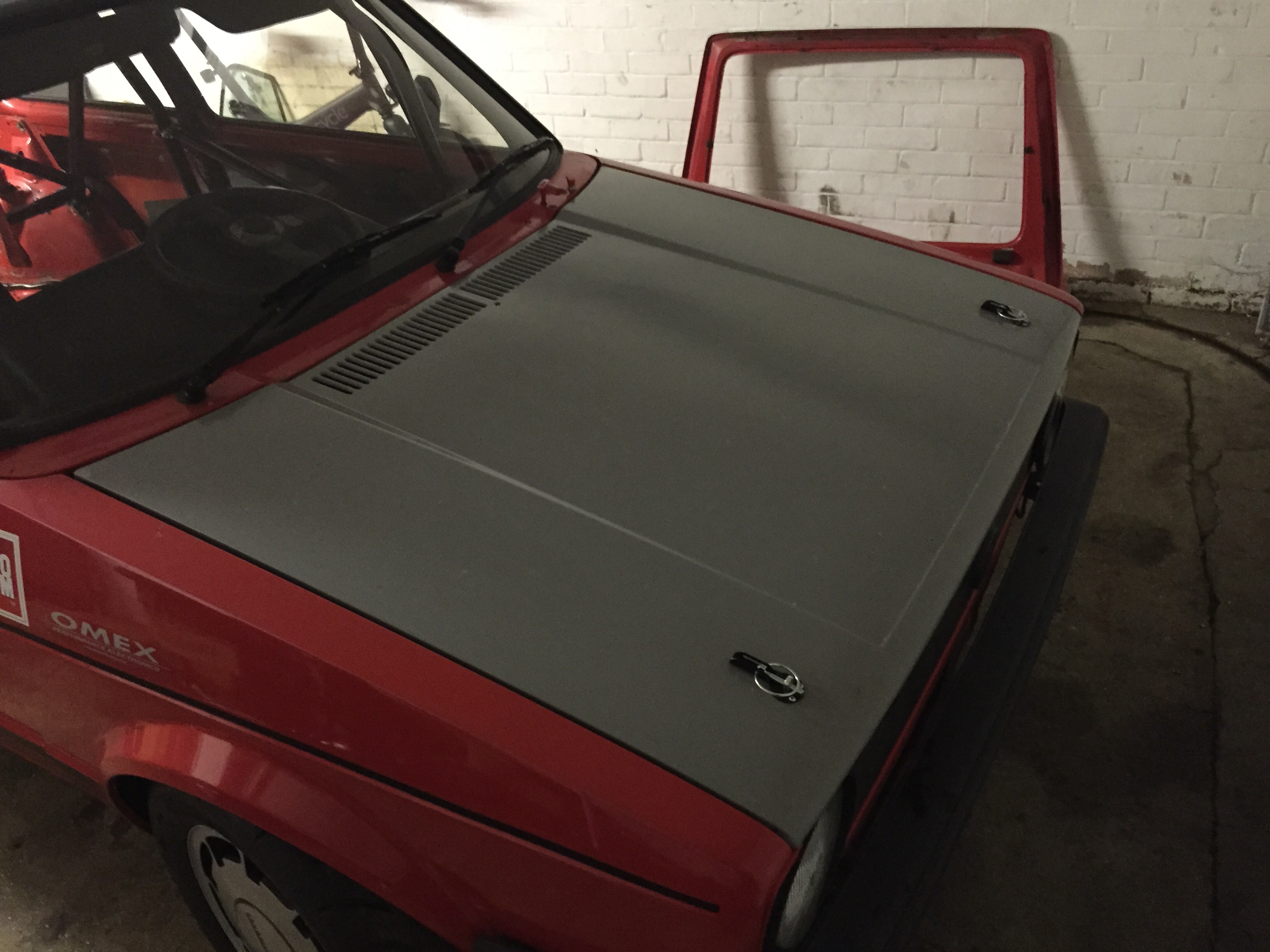

Carbon Kevlar Bonnet 5kg Vs 12.5kg

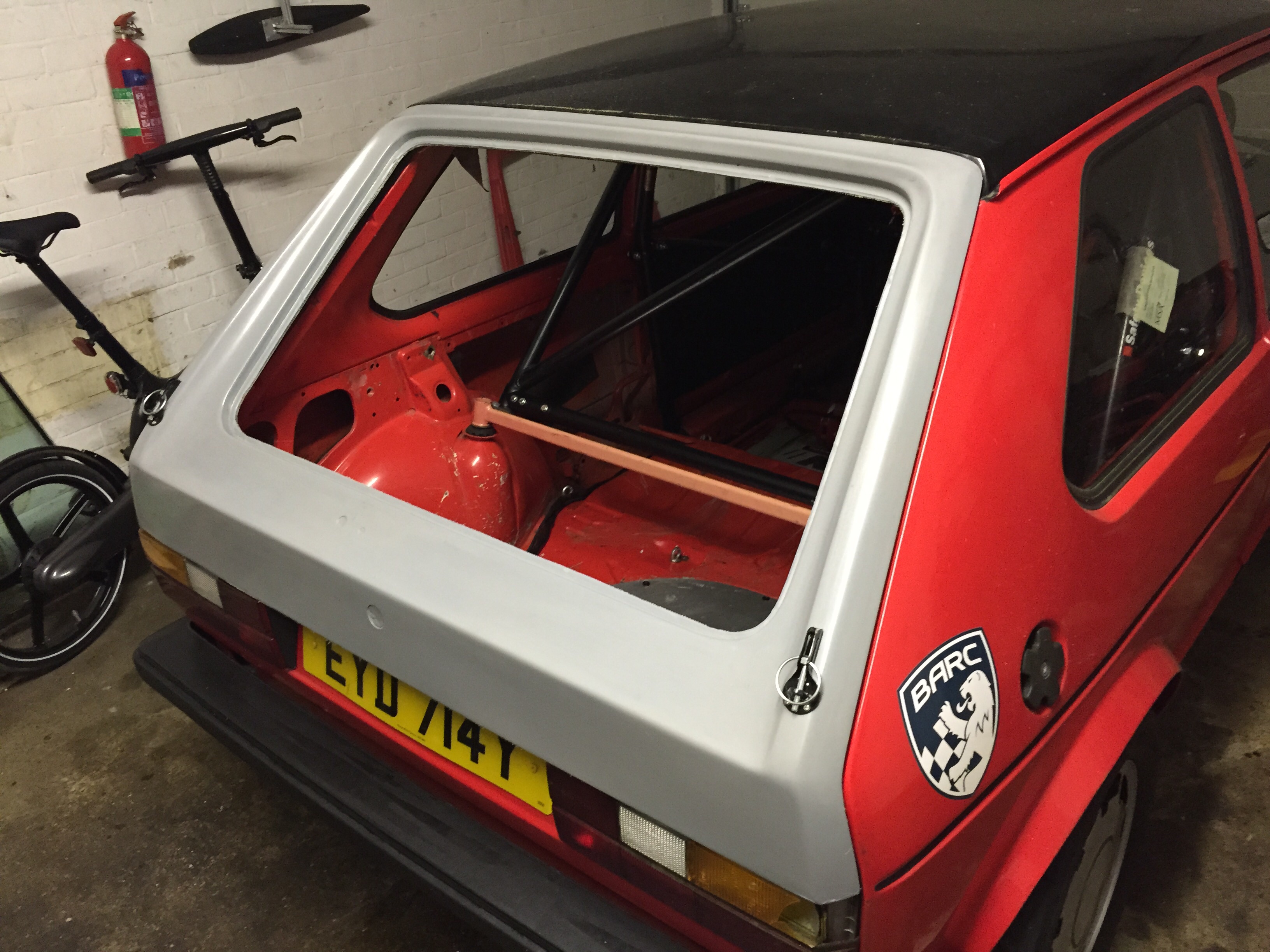

Carbon Kevlar Rear Hatch 3.25kg Vs 7.25kg
New cheap bumpers 3kg Vs 6kg each
Door cards 0.5kg Vs 2.5kg each
A saving so far of 21.5kg.
Next up is taking out the window mechanisms and replacing the side and rear windows with Lexan. Oh. I wanted Pirelli alloys instead of the Ronals that were on it. The centres took some finding.

Re: Lighter Faster?
That is already quite a saving Simon.
You'll be flying.

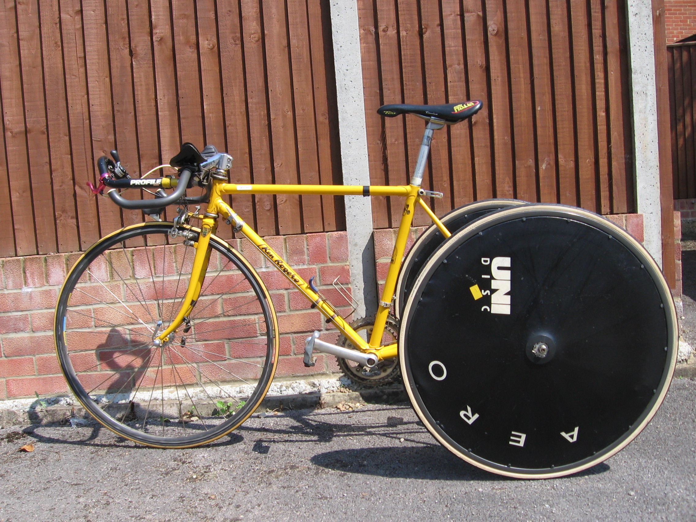

I will see your Moulton and raise you my trusty steed from my TT days.

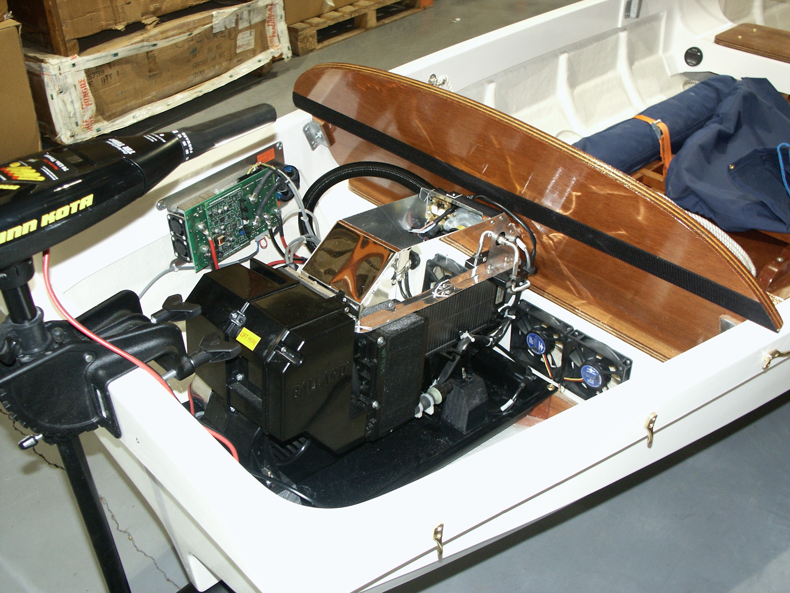

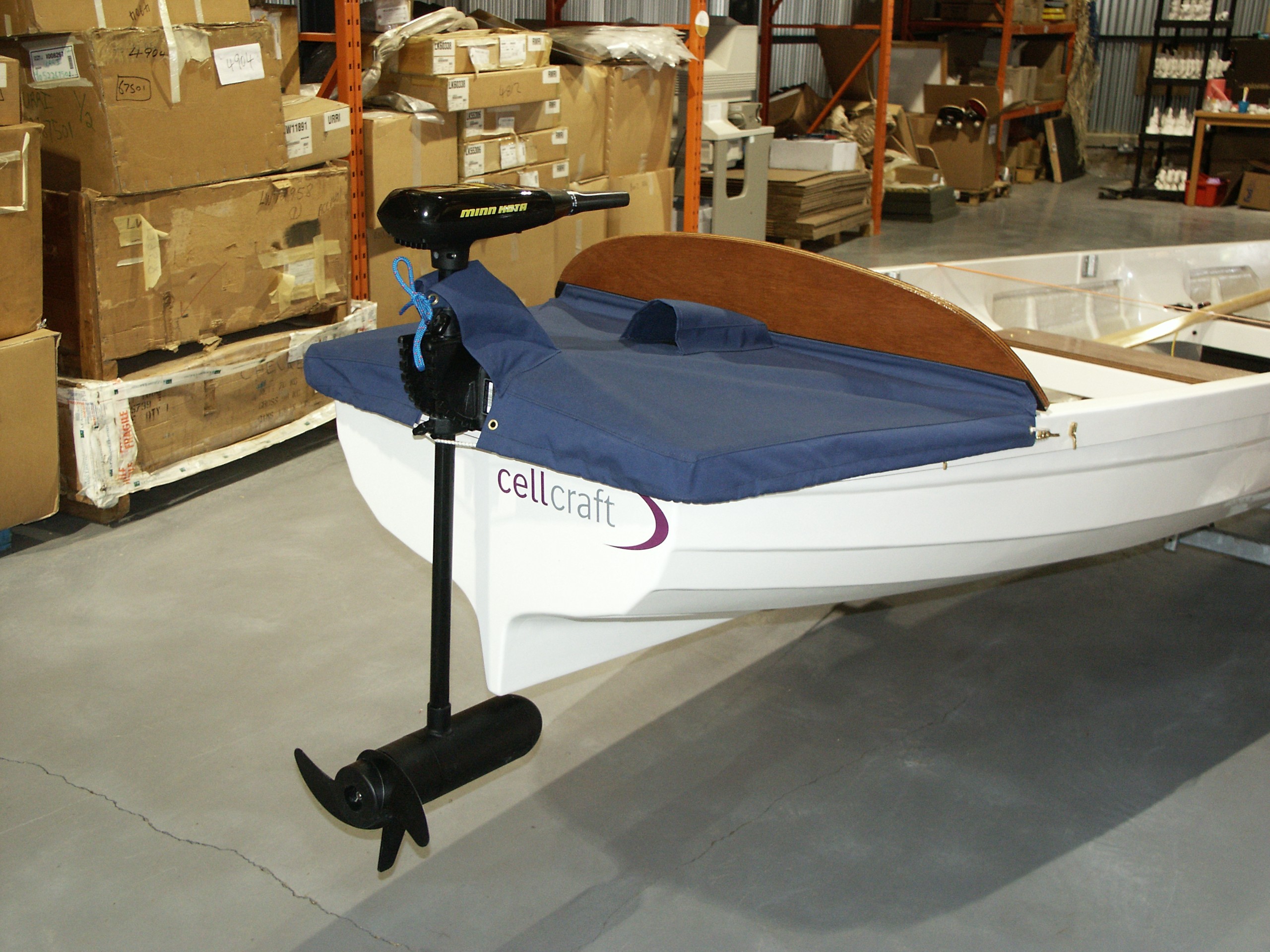

My peak mad professor moment was back in 2000 when I started up a hydrogen fuel cell in a shed for the first time. It was about midnight and I ran into the house to wake up my wife, son and daughter to troop down to the shed in their dressing gowns for a family picture next to the fuel cell.
I fitted it into a river boat. It was the first hydrogen fuel cell powered boat to be registered on the Thames.
No planes stashed at this time. I have owned and flown one in the past and I do currently have a bit of an aeroplane stashed.

The whole cycle was an issue. Electrical power to produce hydrogen, power to compress it. Then the hydrogen is fed to the fuel cell which is 40% efficient, through the voltage regulator that was 90% then to a battery. From the battery to the motor that was 90%? then to a water screw that is not very efficient.
The boat had a 3hr endurance at 4knots with de-mineralised water for exhaust and virtually silent. A fun project.
