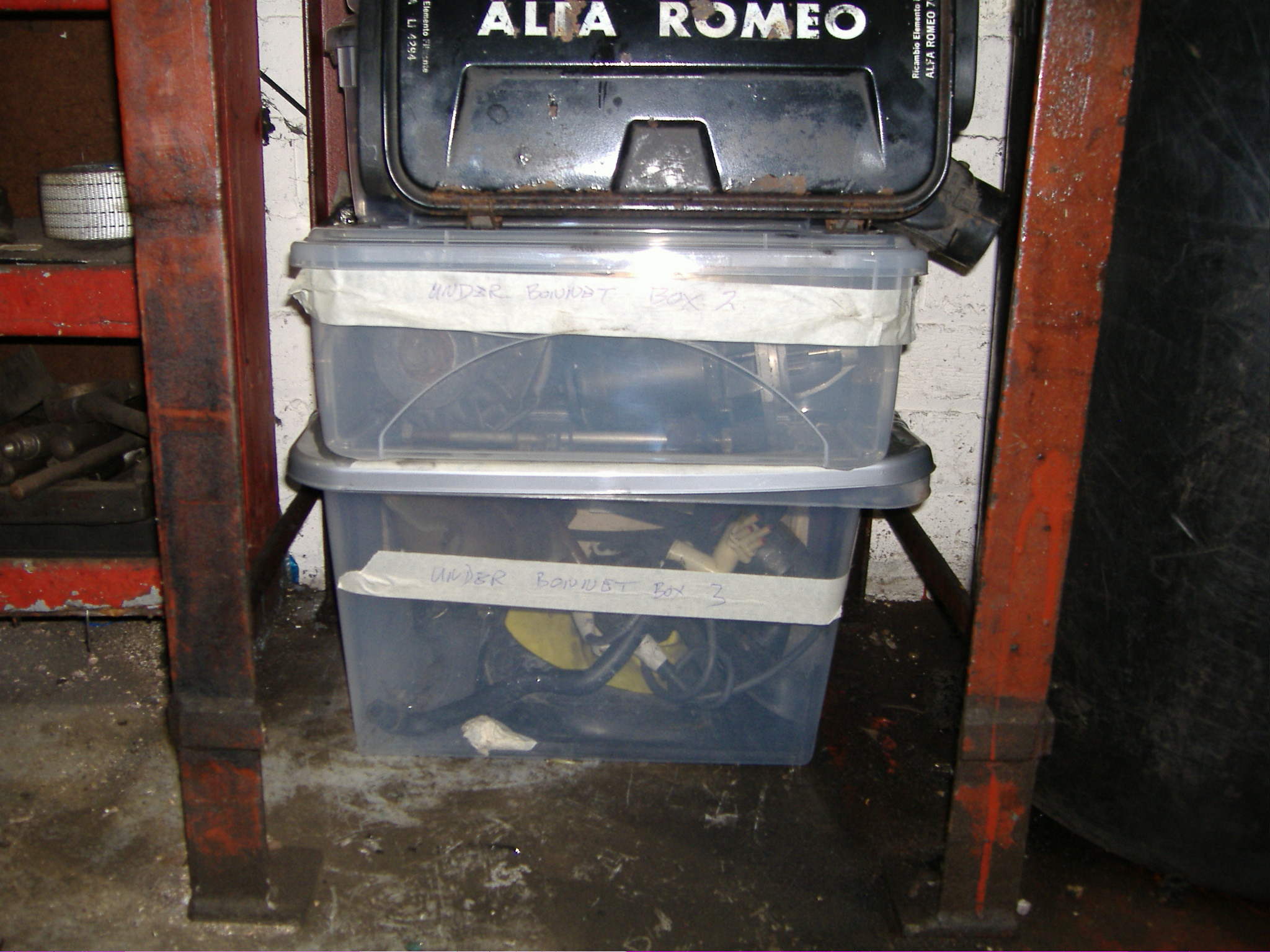

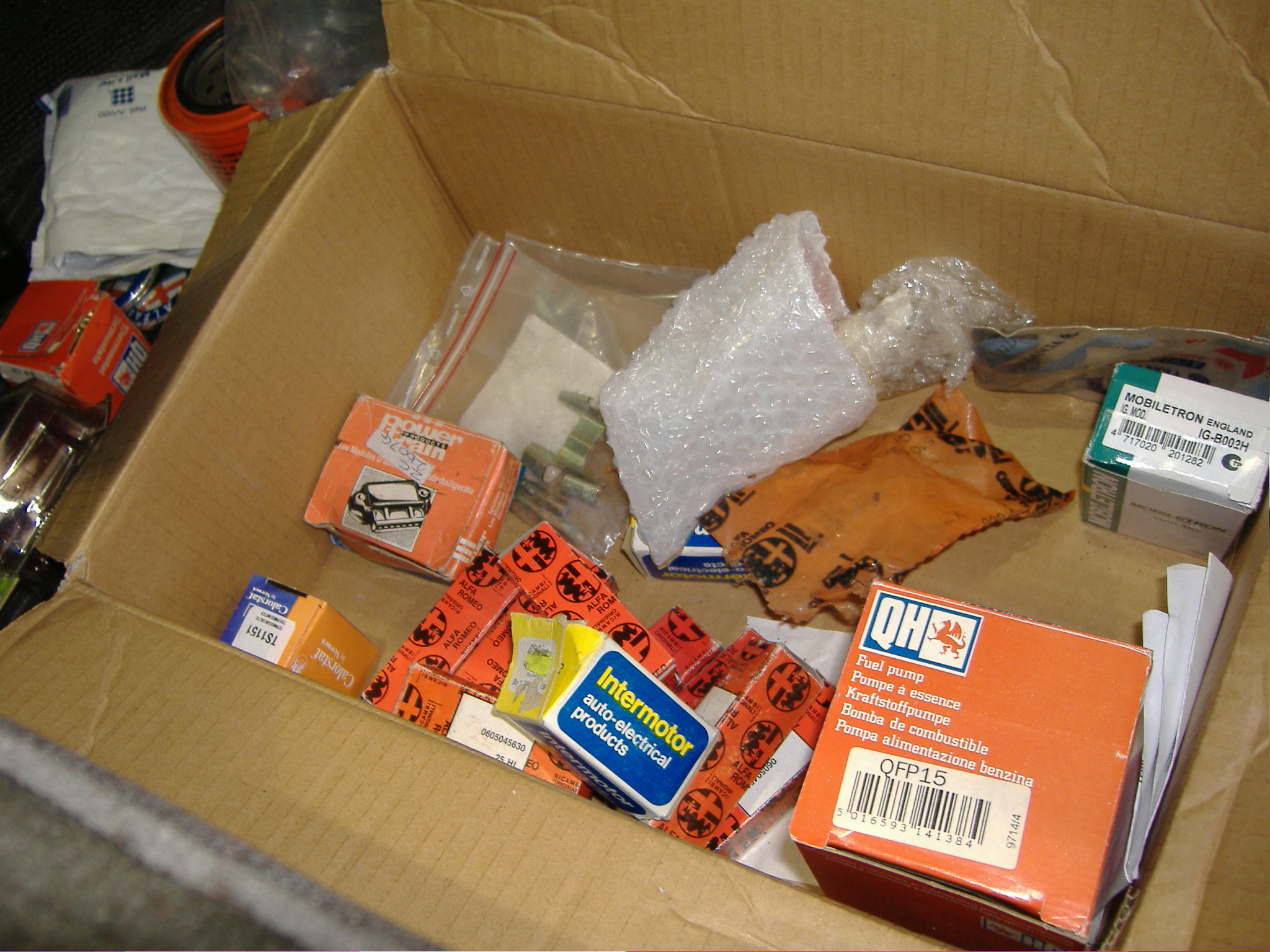

Side stripes? I managed to pick up a set on my travels (I'm an Alfasud spare parts hoarder by nature) and have found a firm that have said that they can make a fair job of overhauling the rear rubber spoiler, which is just as well as I have been unable to source a NOS item.
The car plus an extensive number of spare parts collected by me over the last decade is due to be transported up to an Alfa Specialist in Scotland at the end of this month to undergo a mechanical overhaul and to have a proper respray.
Wish me luck and watch this space for regular updates.
