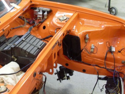

- Posts: 797
Hi There
Car looks great
Just wondering why the steering arm holes have been extended forward?
Also what are the metal beams are for in the passenger front and extending into the rear footwell?
Car looks great
Steering arm slots would be for more castor angle, which gives more stability at high speed.
Ha, well done Vsix you answered that better than I could in a week.
The steel across the foot well is where the insulated cover for the exhaust that went through the cab fitted.
Very neat and fitted with captive nuts. So will keep it in case in the future another owner wants to return it to that spec.
May well fit kingspan insulation across that when I finally get a passenger in there, but a way off yet.
