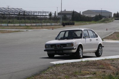

Yes must be my Alfasud you have seen before. Currently the car is fitted with 14" alloys, to accommodate wider tyres for classic cars circuit racing. Steel ones will later be refurbished and be fitted on leaving the alloys for the racing events. I will take a photo of the new carb set-up and upload it in a couple of days. Nice to hear that more Alfa Super are still around. :)
p.s. Shrew many thanks for the rear suspension set-up supplied to me through our mutual friend, Chris. The rear of the car has now outstanding grip and minimum to zero roll.

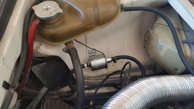

Last Saturday had the opportunity to test the new carb in action when took part with the Alfa Romeo Cyprus Club in a circuit meeting. Well the car had more power and speed on the straight line but around curves the engine was suffering with fuel starvation/flat spots. It looks that Weber was emptying its fuel bowl faster than the mechanical fuel pump could manage. An electric fuel pump will be installed in a couple of days and I will update you accordingly.

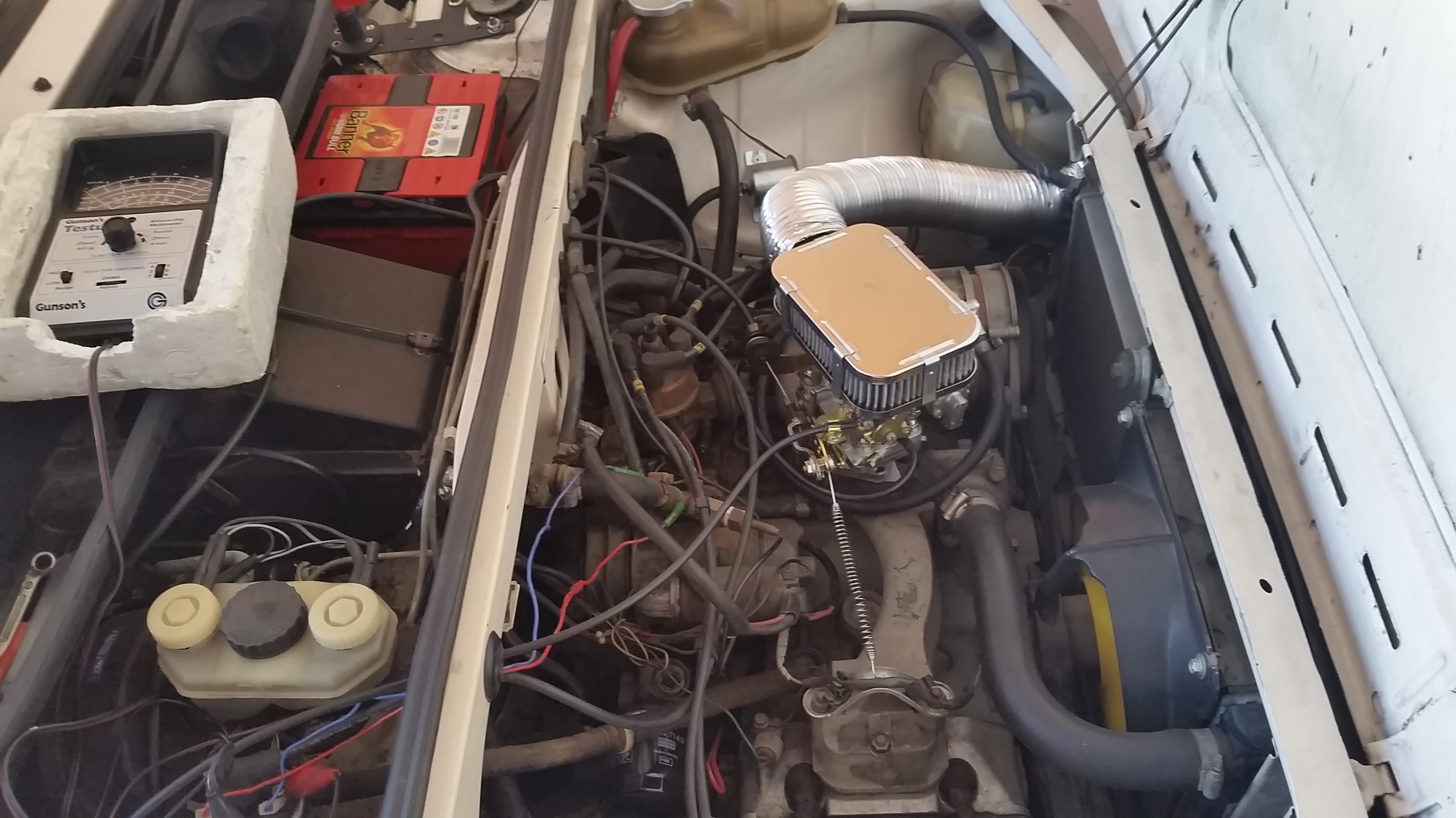

Post by Alfasud1978 »

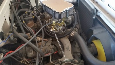

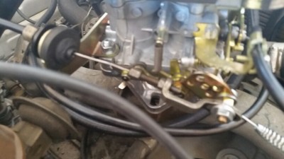

Me again. The new carb set-up was race tested last Sunday and I assure you it is worth the buy. Though you must bear in mind that the inlet manifold needs the 1bbl to 2bbl adapter plate (included in the kit) and must be fitted in a way that the carb's fuel supply is facing at the front (see pics) other wise flat spots will be present when cornering at a speed. You must also upgrade the mechanical fuel pump to an electric one of a low pressure high volume. Return fuel hose is not required with Weber carbs and you should block it. Having in mind the higher air temperatures in Cyprus and that the air filter is now without a housing and that hot air reduces engine output I have installed a front grill air duct to guide fresh air to the filter. Note that the adapter plate is designed for a bit different engine layout and had to grind some bits of it to fit. A bit of a tricky job.
Well the car is now much more responsive around town, choke is now needed for the first few minutes and engine revs more freely at the higher revs. The car is very strong at highway cruising and to uphill roads. Fuel consumption? I don't really know but track one was definitely higher that before. Highway one will probably be the same or even a bit lower.
The vroooom it makes is the best part of the mod. The engine now sounds more racy with more bass.

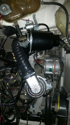

Last update regarding the air filtration. A new intake manifold (from the 1.3Ti) was traced and fitted quite easily. Last mod to be done was to upgrade the air filtration set up in order to avoid hot air coming into the engine resulting to a lower power output. You can either use the stock air filter housing but you need to refabricate its lower side to accommodate the new carb or go for a Weber Plenum and a cool air filter. (see photo). First impressions are positive as the flat spot/hesitation is basically gone, the mid range torque feels a bit stronger and the noise (music for some of us) lowered.
Overall: A must mod irrespective of cost. The car is now much faster and more relaxed in modern traffic. Ooooh I forgot it is more fun than ever.....
