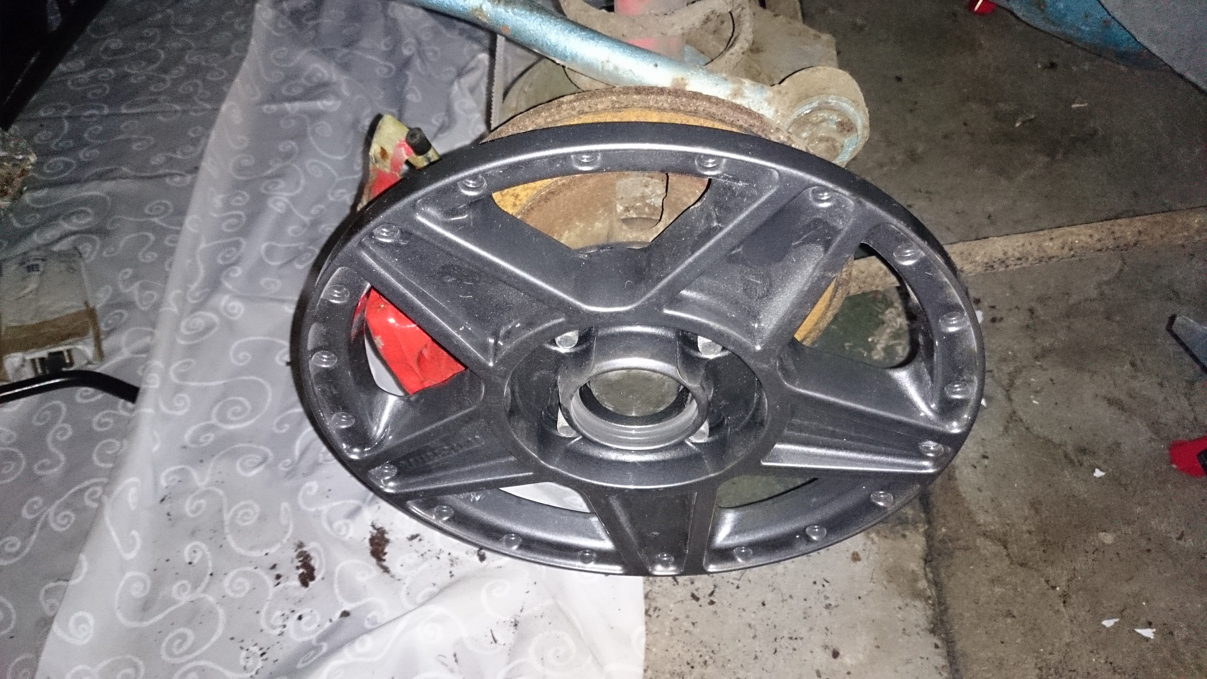

Compomotive FH 500 split rims, making up a front mounted 15" x 8j wheel, and approximately 120mm T inset, were duly purchased, offered up to the car, and the love affair began!
Bit by bit, over the last couple of months i've been shotlasting parts, powder coating, sanding, powder coat again so on and so on, until finally i had all the parts done, and it was time to rebuild them, and so, thats an awful long way round of announcing what my main task for today was, and that was to finally rebuild an awesome old set of rims!
Firslty, i needed to check that the centre bores fitted. They were very small to begin with, so i had them on a lathe and turned out to fit our Suds unusual 58.6mm hub nose, and what do you know, they fit!

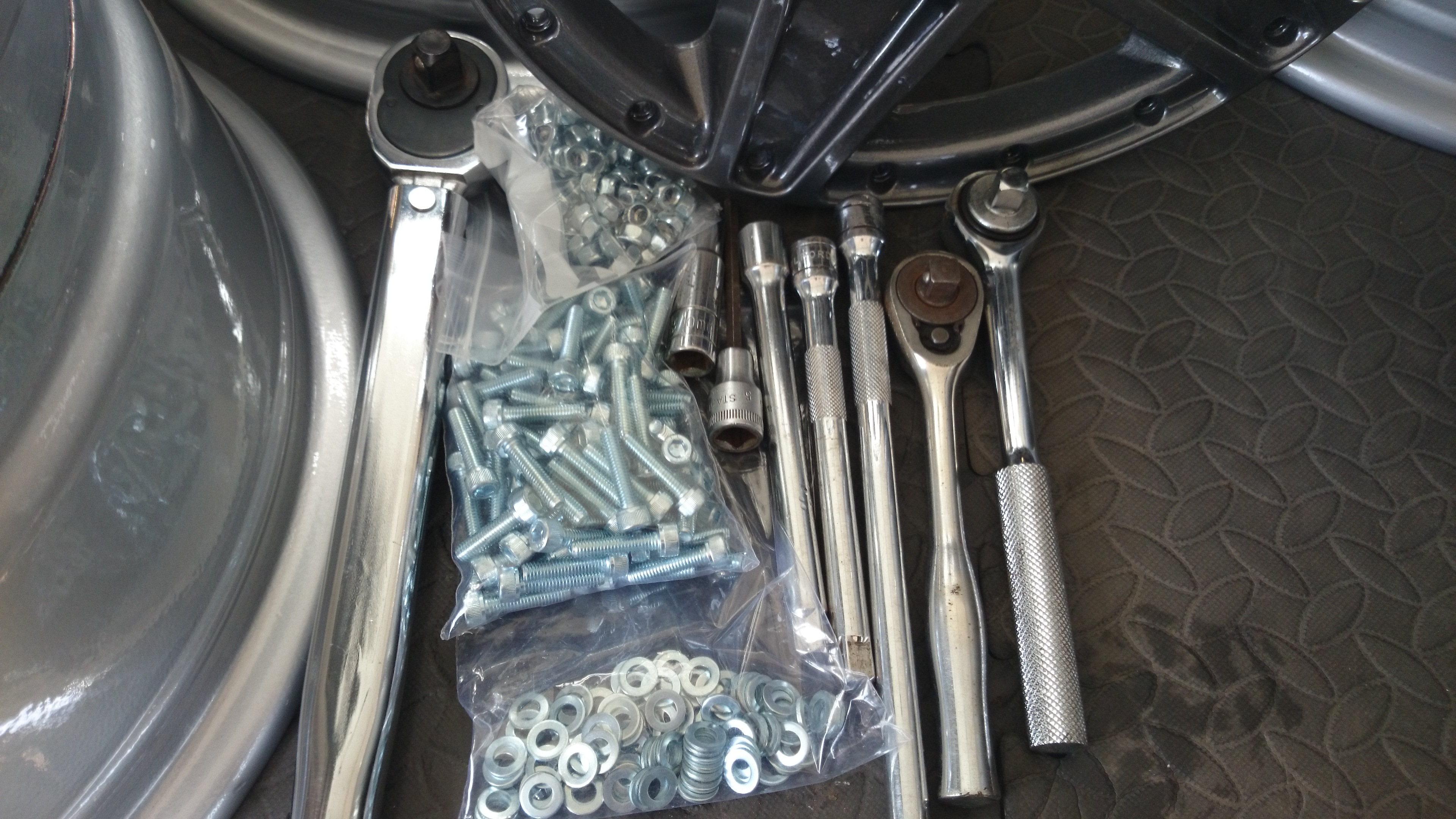

So, armed with the neccessary tools, and a brand new set of high tensile bolts, shallow nyloc nuts and lock washers for good measure, i set about it
Re: My Sud Wheels

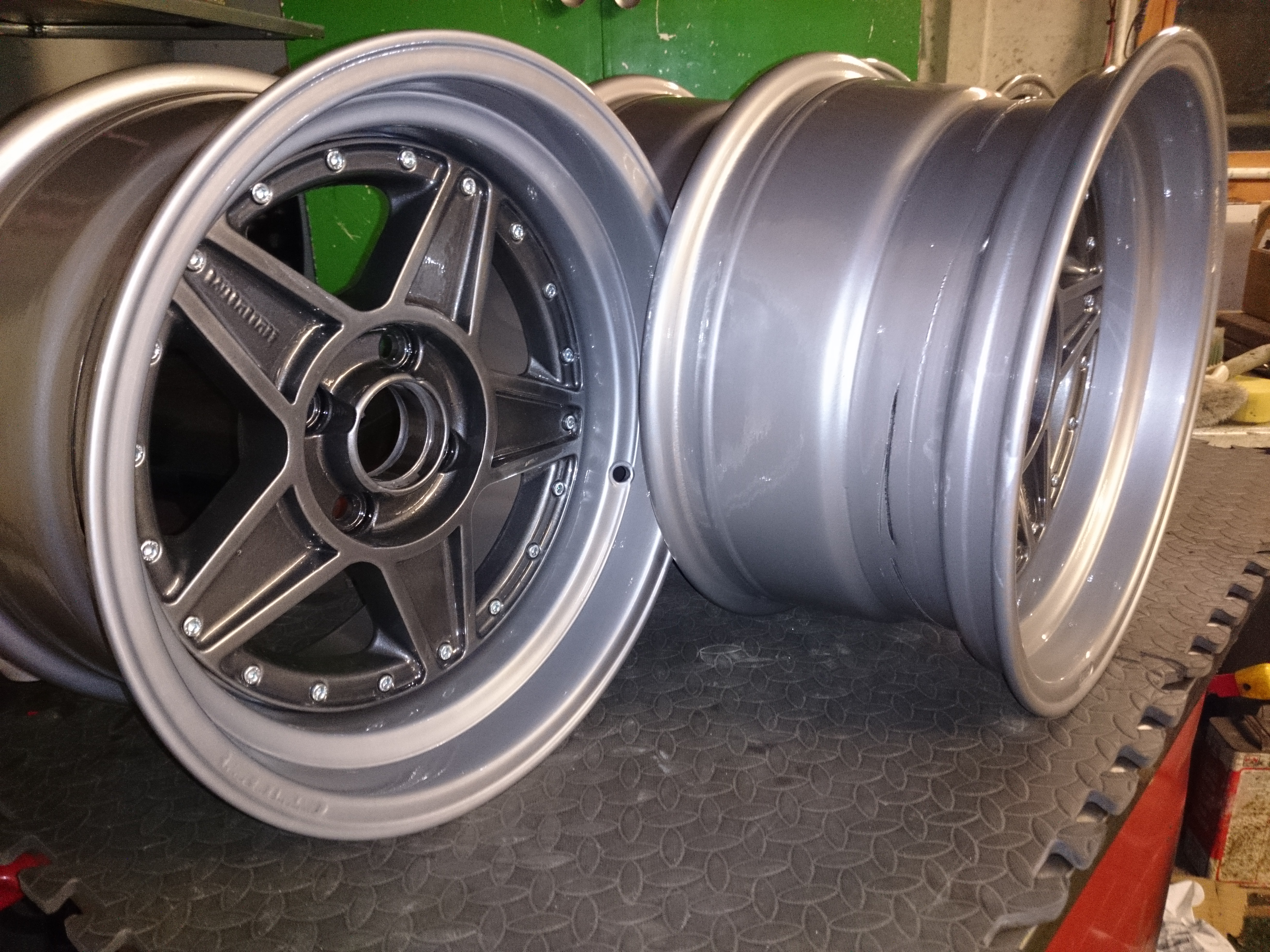

So time to put these bad boys back together!

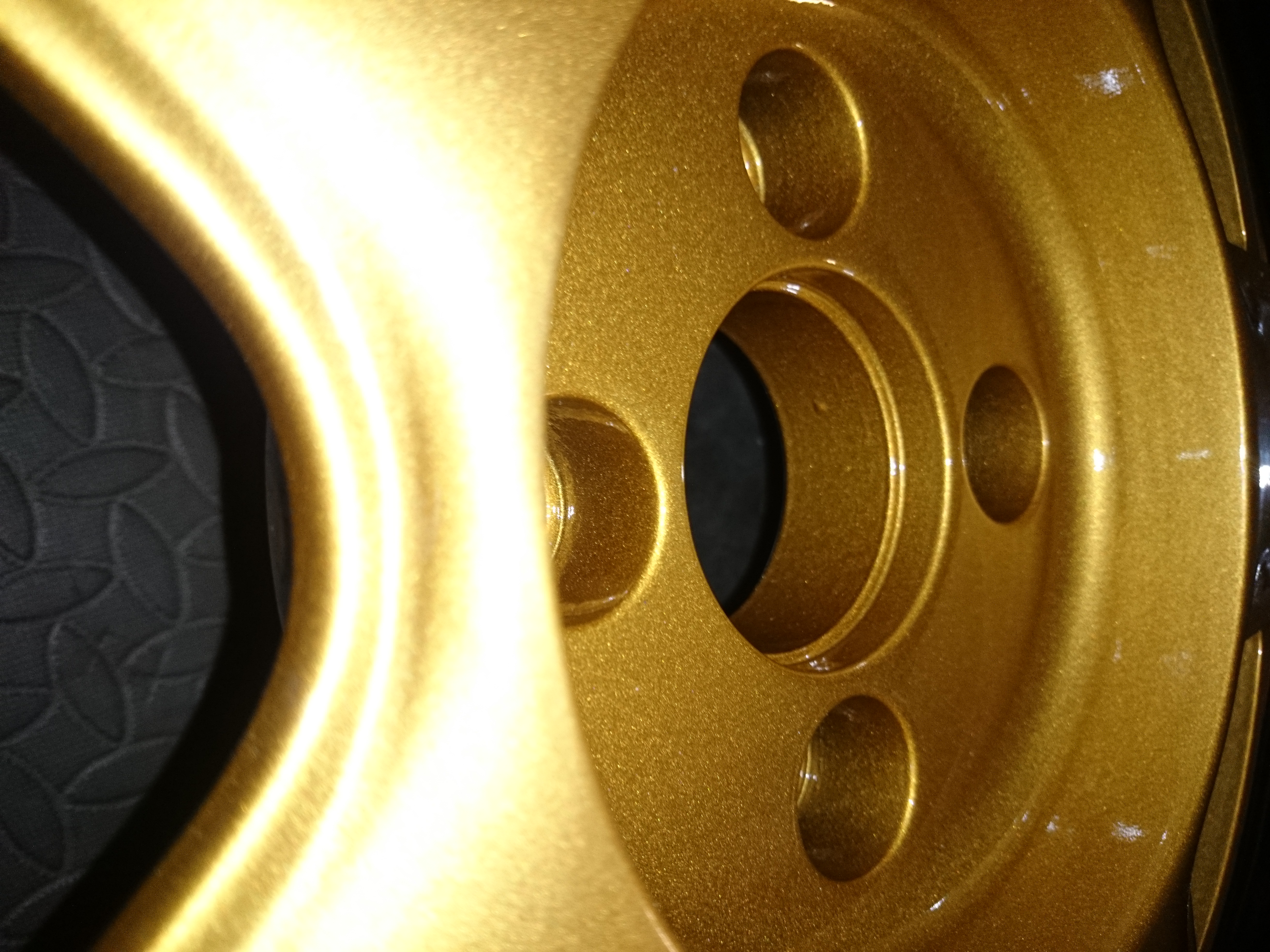

The barrels, i decided, rather than a complete traditional look of painted centres and polished dishes, i wanted a similar contrast, but without the maintenance of polishing. I also wanted a finish good and reliable enough to withstand some tyre changes , as these may well have my slicks on for the occasional track use too, so they have been repeatedly based, sanded, and re based before finally colouring in a chrome silver, and then hard laquering, which takes the chrome effect way down to just a really nice deep solid and bright silver.
So, because the powder coat was nicely built up in the bolts holes, i could start by letting the bolts thread into that for starters, and allowed me to then turn them upside without falling apart, and set the washer and nuts in pace ready for tightening.
All brands of split rims vary, but as an industry rule of thumb, you want bolts of a tensile strength of 10.9 or greater, seeing as these are 15" with just 20 bolts, i opted for zinc coated 12.9's, just to be sure.
Thats rules out 99% of Stainless Steel stuff straight away, to give you a comparison, the 12.9's i used have twice the sheer and proof strength of A2 stainless steel. Its pretty, but it aint strong in this application.
But i think these look just fine!
Again, this varies brand to brand, and design to design, but the torque required is usually around 20ftlb, in this case actually, 22/24ftlb, so a final check of 25ftlb, plus a small tweak, and these are good to go!
I have a new set of road tyres in 205 50 15 lined up to try first, so i'll get them fitted soon, and then see how they go from there.

JB, yeah, lots of powder and sanding inbetween to get them like this, but yes, worth the effort.
Instead of looking like an industrial finish, they now look like a Good wet paint, whuich is exactl;y what i was after really.
I'm getting quite good at it actually, its a shame the oven has to be so hot, i could get a Sud shell in there!
902, lightweight is very hard to come by these days i find, but i try not to get carried away with it too much as my cars are fast road first, track capable second, so i can live with a few kilo even though i know how beneficial less unsprung weight can be.
These compomotives aren't too bad, they are notably lighter than my other set which i'll be finishing next, and the biggest difference is in the centres themselves.

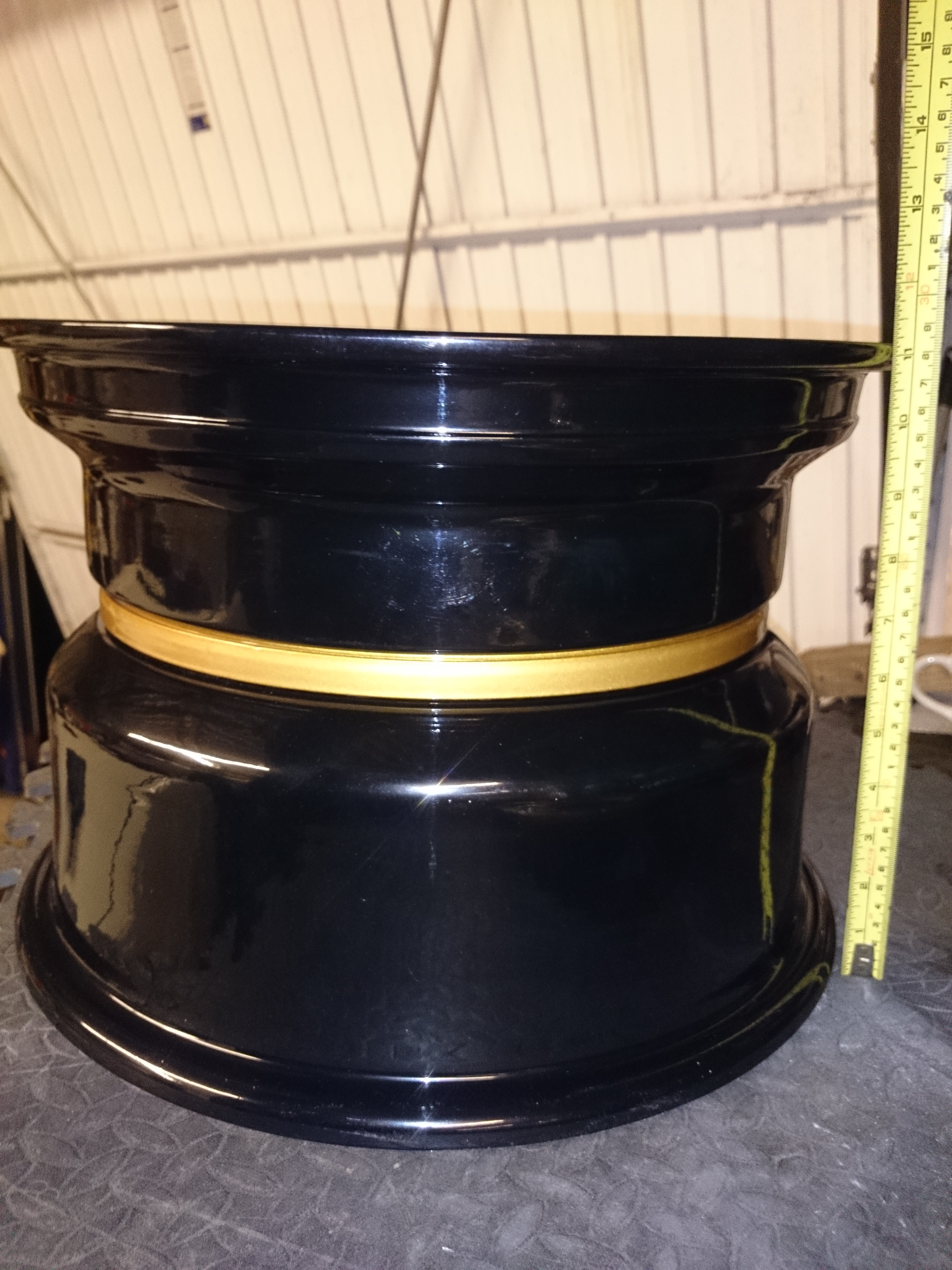

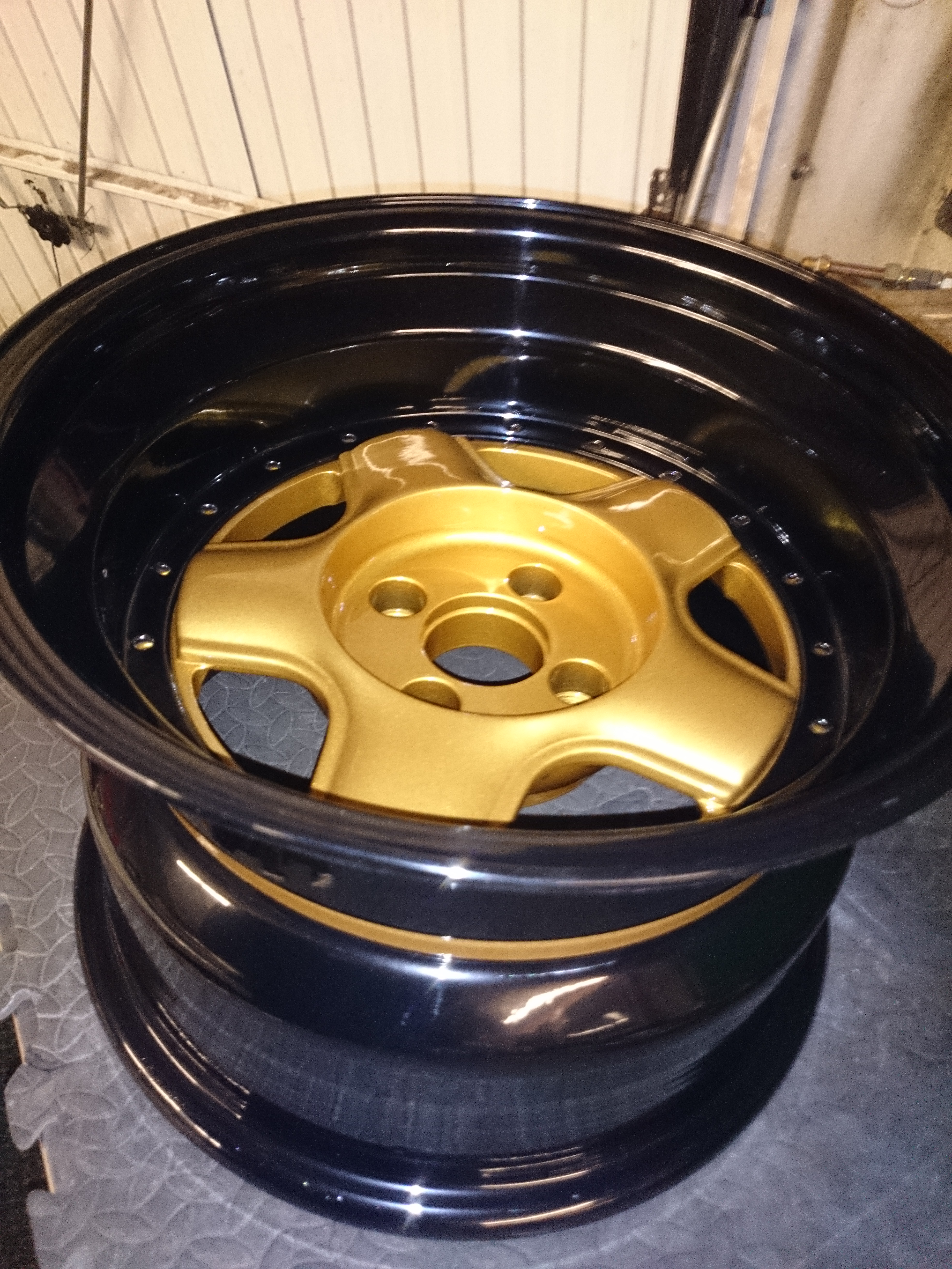

Yeah these took a lot of work, much more than the compomotives.
The barrel sections were all essentially good and straight, but being so wide and deep, i didn't fancy polishing all week after a hours drive! But that also meant that because i chose to go black and gold to be different, there was so much surface, if the black wasn't good, they'd look gash!
The difficulty now is deciding on the bolts. I really want gold against the black barrels, but no-one does a matching colour, and if i powder or paint them they'll be no good by the time an allen key chips it all off again assembling them, and rusty in no time, not cool!
Anyway, no not Turbo's, but i do love them, they are still on the shopping list if i find some 15".
They are.......
Good old English again, Revolution RFX 3 piece splits

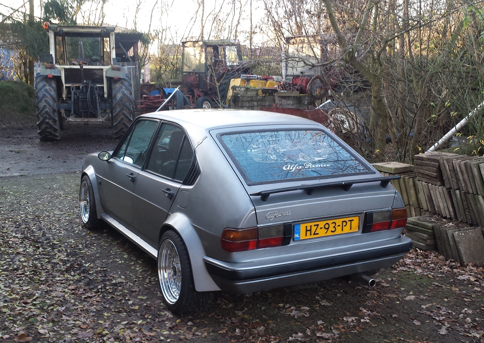

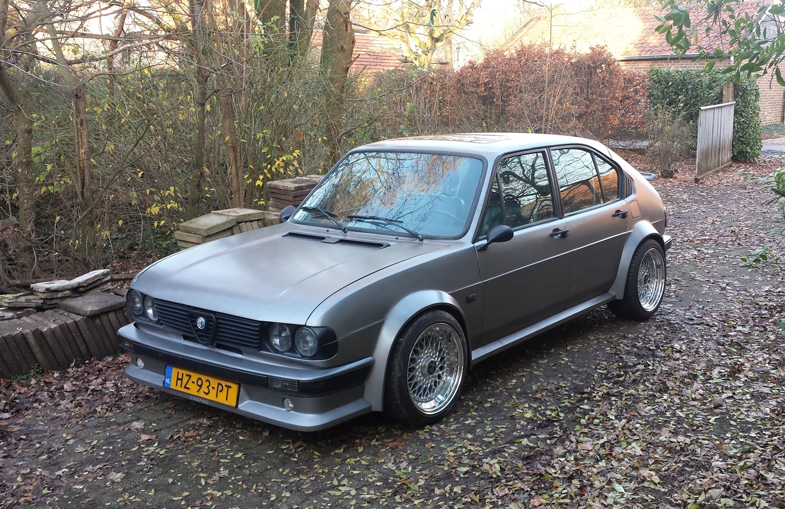

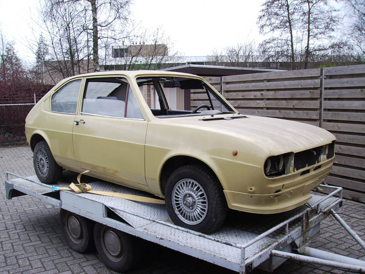

Found you! You're a "wheelwhore" just like me, would love to have 3 piece wheels on all my cars but no such thing as a cheap set of those and don't want "pretenders" like some Zender wheels or SZ lookalikes with fake plastic "bolts". My Sud has 16 inch BBS RS now, originally Porsche 7&8x16 5x130 wheels but drilled the extra 4x98 holes and got 2 new outer lips to turn the 7s into 8.5, now with 215/40 and 245/35 :D Toyo's. Car is currently hand painted in Hammerite as I got wrapping vinyl but it turned too cold to apply before I finished some bodywork needed, in the spring it will be wrapped. For my 4 door '75 L I have refurbished a set of 7x15 RS001 fitted with 195/45. Then I also bought a very good condition '76 TI in Giallo Pompeij and everbody begs me to leave it original, I will but it gets a set of ATS classic 7x13 with 185/60.

Looking great in the grey Bert, like it a lot mate.
Makes your arches and stuff look even better.
