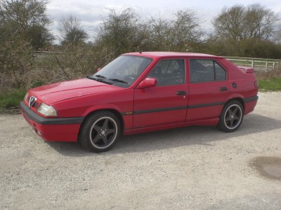

got a few minutes today to try the new wheels on the 33 that i quickly painted up a while back.
was aiming to fit them all but it seems i overlooked the difference in spigot size between the 33 & 155 so need to ream a tad off the wheels. one did fit though just to see how they look, opinions?

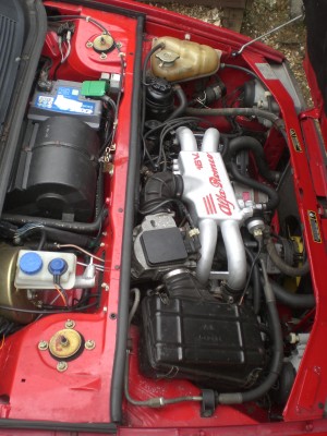

under-bonnet looks tidy still, not seen under there for a year or so since doing the engine rebuild

Look Shite Kev
Best just send them to me for the 75 :lol:
H
Re: My first ever 33
Spot on Kev, they will look great and really suit the car.
Looking good kev 8-)

Very nice Kev, wheels look great.
I see you have a missing jacking point cover, you can still find them new if you want one:

Wheels look nice on that car!
155 Speedlines look bloody good on most cars, they're njust that classic 5 spoke style that works no matter what in my opinion,
and yes, they look fab on a 33, really suit an angular car i reckon.
the 58.1 and 58.6 centre bore has never been written as a hard and fast rule. Its so close, i've had wheels that shouldn't fit that do and should that don't, just a little thick on paint, bit of flash rust dust on the hub nose, a few n and offs of wheels, and it all soon changes from the maths!
nice to see you re-united with the 33 mate,
i hope you're both very happy :D

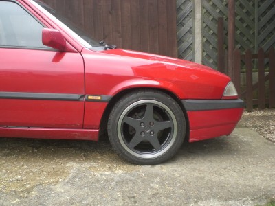

took a carbide burr to the wheels to get the fit right, aided by a spare hub in the shed to check for a nice tight fit, handy having all these bits & bobs lying around :)
realised last week that i needed more long wheel bolts as only found 7 in the shed, luckily the parts stash at the workshop had plenty. painted a set of 16 up so they looked better.
i had previously painted the centre caps the same as the wheels but i thought they looked too dark and got lost in the darkness. so i tried the ones from the original wheels which i think look better, so i've fitted them ;)
had a look over a few little jobs, tightenned the fan belt (has anyone else noticed that we used to have to do that regulalrly but with modern cars using multi-rib belts and tensioners that little sunday job has gone :roll: ....) , checked the levels, oiled the heater control cable (it will be changed for a good spare one in due course...) and generally had a look around the car to see what it will need.
the passenger door bottom now has a hole, drivers rear not far behind. bonnet will need a few dents repairing but not too bad otherwise. lacquer peel in most places, or paint fade where not!
the whole car will get stripped back and repaired where neccesary this coming winter and given a fresh coat of red paint should see it look as good on top as it is underneath.
i'll give it a machine polish in the days before spring alfa day at duxford so it will at least have some shine to it 8-)

Looks good - the wheels suit it very well!
Nice kev 8-)
cheers guys.
i always think darker wheels only suit certain colours of cars, red being the best one.
other than that i prefer standard fit rims but in this case i'm happy with the look 8-)

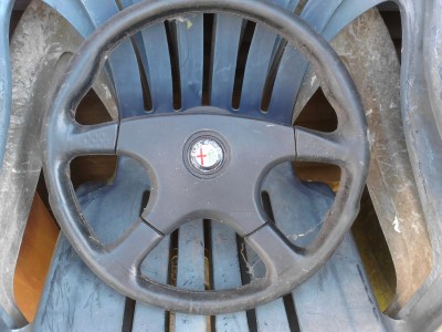

cleared out a lot of stuff this afternoon from johns' unit to my own, we came across this nice momo wheel though which should smarten up the old girl a little.....just need to find a few mins to fit it :roll:
given it a clean up to rid all the dust, will give it some leather food once it's on.

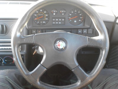

had to repair the horn wiring, thumb presses worked in the top spokes but the badge didn't
all sorted now
with a bit of spare time tonight and the weather ok i fitted it on.
must say the feel is better over the original which felt a bit thin, this momo one has a much chunkier feel

Kev, I had the same steering wheel in my 75 Twin Spark and then put it into a 164 TS. Lovely to use and really set off the interior nicely.
