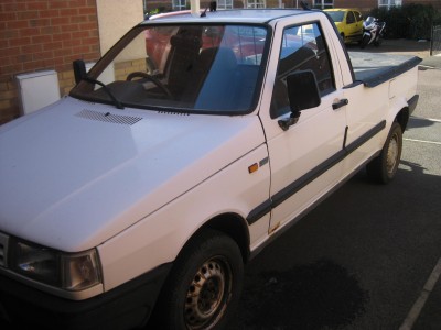

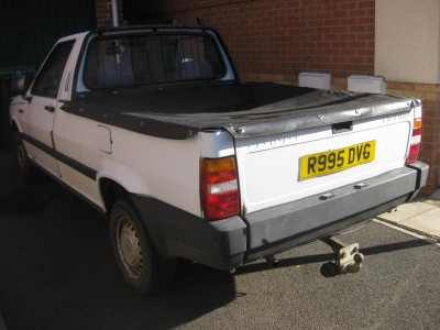

I picked up a Fiat Fiorino pick-up a month or so ago, here are some photos: I have been doing some work on it over a last few weeks, all interior has been out and a couple of floor repairs done, trim all restored, seat were beyond it so fitting some seats from a Fiat Doblo etc etc.
This will be my daily driver so waxoyl everywhere as I go along doing jobs around it. Its a 1.7D non turbo, ex. farm vehicle done about 73K. Apparently these were made is brazil only a few came here and it was based on the Brazilian Fiat 147 which was similar to the Uno but not identical

handy pick up that mate, often fancied something like that myself
One of my mates has in silver he was thinking about putting a coupe 16v turbo in it
Cool pick up, I was looking at one of these too . Be great for jetsking . Uno turbo dropped in would be fun too
Brilliant!
I'd love to stay a little more "in house" commercial vehicly speaking, If only it would pull my car trailer!
Looks like my next van will have to be Ducato i think.
Agree with JB, uno turbo power would be usefull, OR, 2.4 JTD!

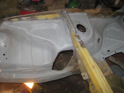

Ok time for an update on this project....
First of all thanks to Gary for letting me have a R/H inner wing panel at a very fair price, thanks mate

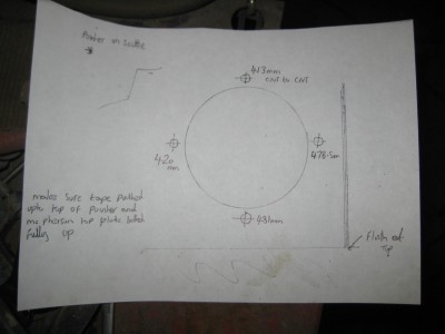

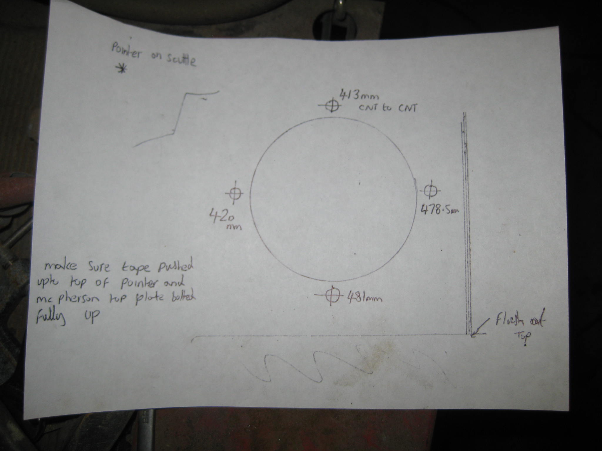

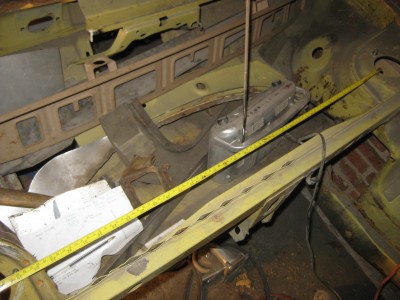

The first job before beginning cutting was to take some accurate measurements at the strut top, I fitted a top plate to the turret top and welded a screw to the scuttle area and took some measurements....
- Posts: 433

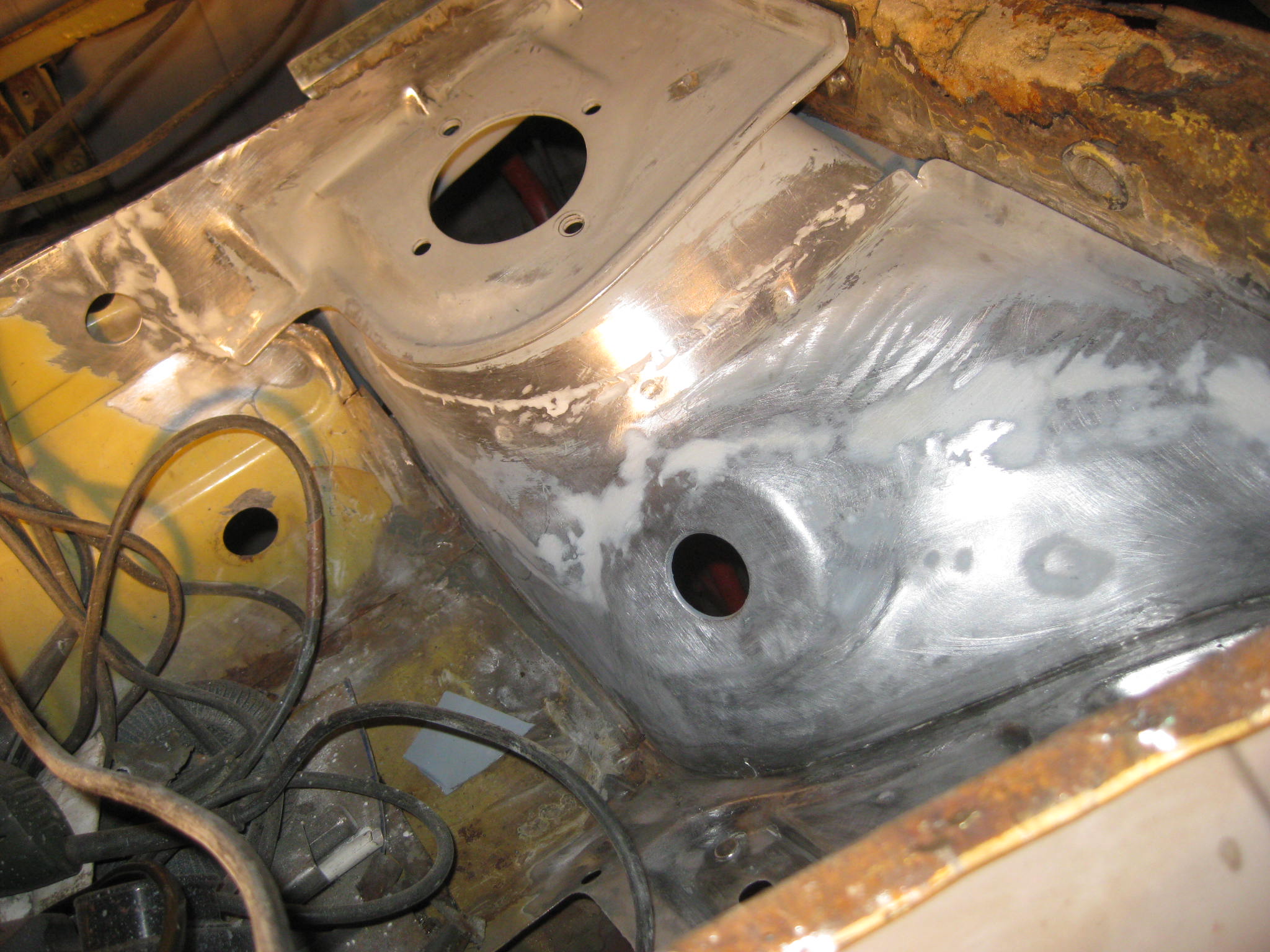

Then time for the angle grinder.......

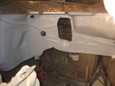

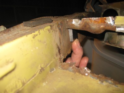

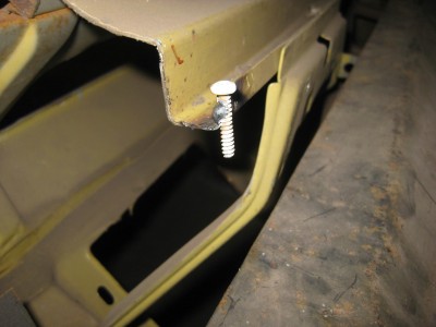

I decided to weld a couple of blocks to the existing wing mounting rail to give the new panel something to sit down onto so the correct height would be guaranteed....
As some of you can remember I had already repaired all the lower areas of the inner wing and I didn't want to undo all that work so a decision was made to join the panel with a jodelled overlap joint, seem welded both sides for strength
The panel had a bit of surface rust on it due to its age so I carefully ground all that off after cutting it and preparing the lower edges with the jodelling tool
Adi, your picture with your hand through the inner wing looks like a nasty crime scene
That panel was a nice find.
Great work.
Great work.

Kegsti66 wrote:Adi, your last picture looks like a nasty crime scene![]()

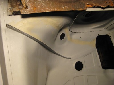

I also took a measurement to the other side strut top before cutting......
New panel etch primed, some will burn off I know but most will be fine after welding-

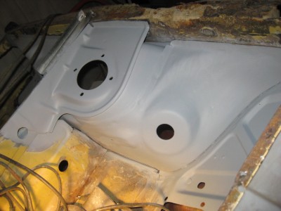

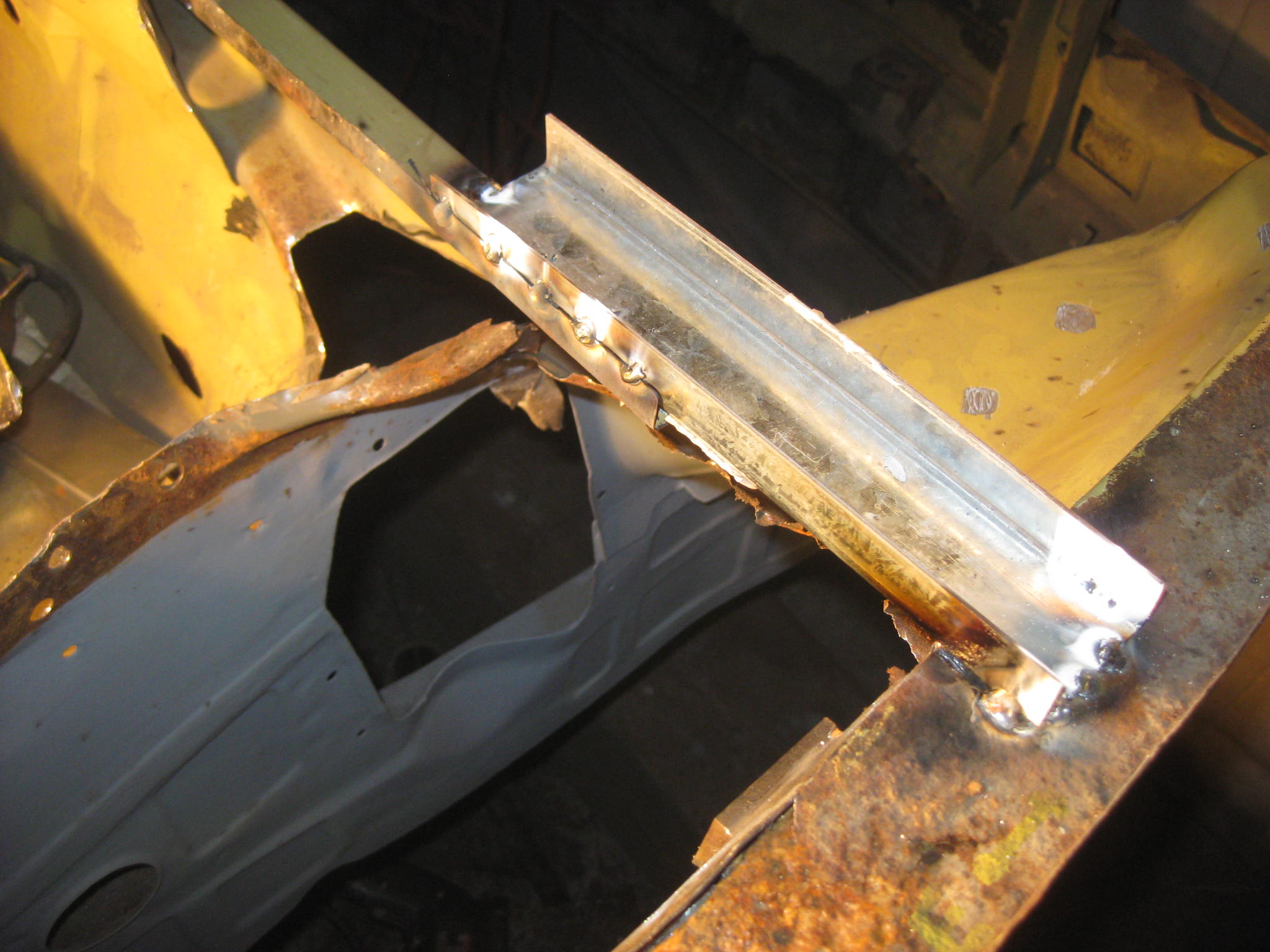

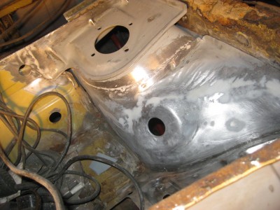

The wing mounting rail was now about to fall off so I had to weld a reinforcing bracket to it

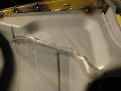

After much messing around I got the panel to fit and I could begin welding it into place
the seam welded joint was carefully ground back to allow for an invisible repair but retain its strength
......then some etch primer
- Posts: 433
Some sealant over the lap joint from the other side....
I also seam welded around the turret
I sanded this down after 24hrs and added some coats of brush on zinc phosphate primer, this was then sanded down and now looks neat and hardly noticeableI also seam welded around the turret

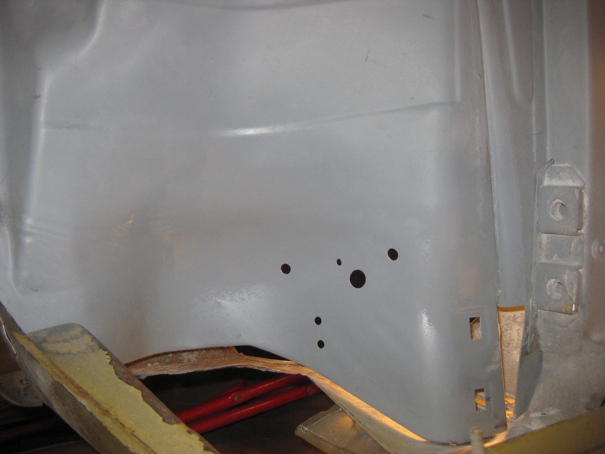

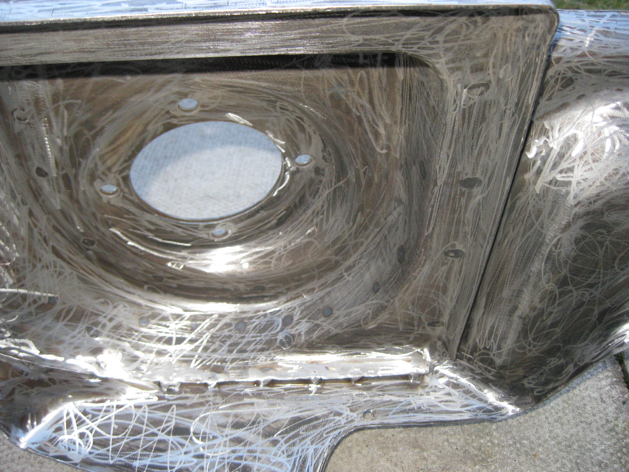

Now the front section...
There is a little area to do beneath the bumper mounting area and new captive nuts to fit and then make a new section to the edge of the centre bulkhead to take it back up to the wing mounting rail
and the job is almost done.....There is a little area to do beneath the bumper mounting area and new captive nuts to fit and then make a new section to the edge of the centre bulkhead to take it back up to the wing mounting rail

ThanksKegsti66 wrote:Beautifully done.
I rechecked all the dimensions as I was doing it and all of them are within 1mm - 2mm even the one from the other side of the car so I am very happy with it
I now need a R/H wing mounting rail if anyone has one? I already have one for the other side but need one for this side
