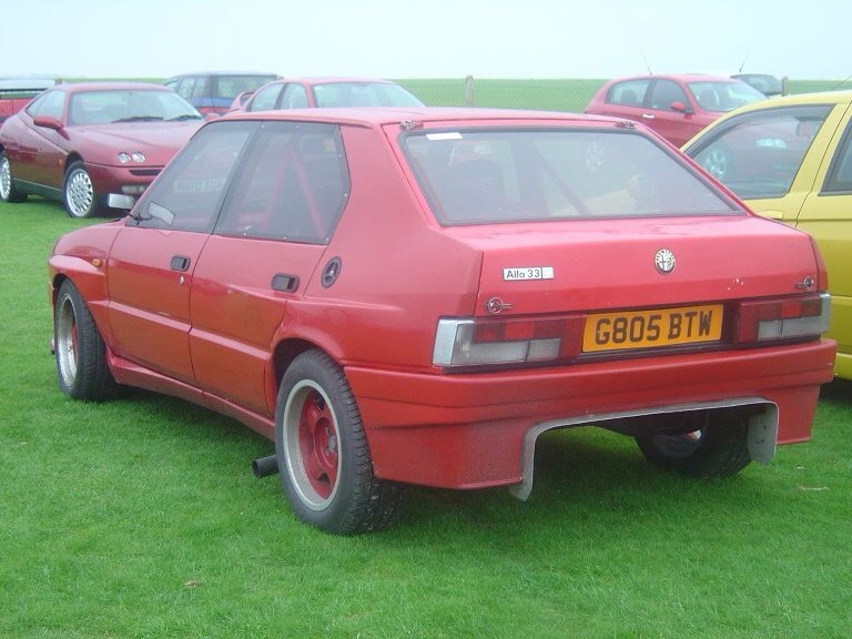

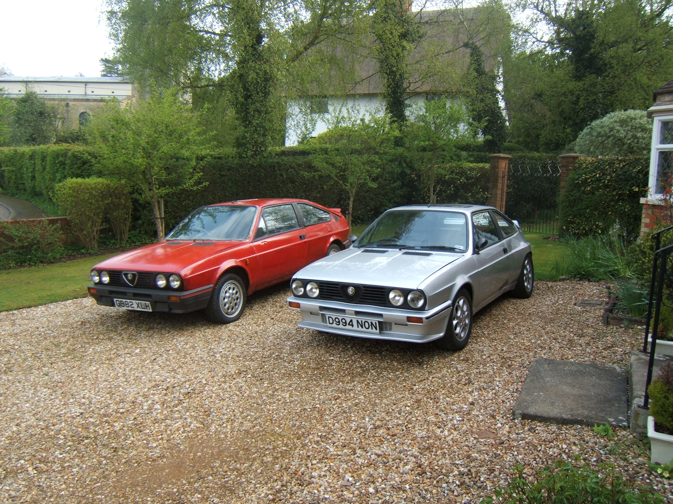

Here are two of my Sprints. The red 8V before its final refurb and the silver/grey 6C version with the midmount 3 litre 24 valve transverse engine.

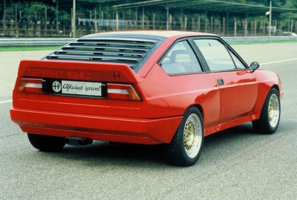

But first - I was inspired by pictures of this.......

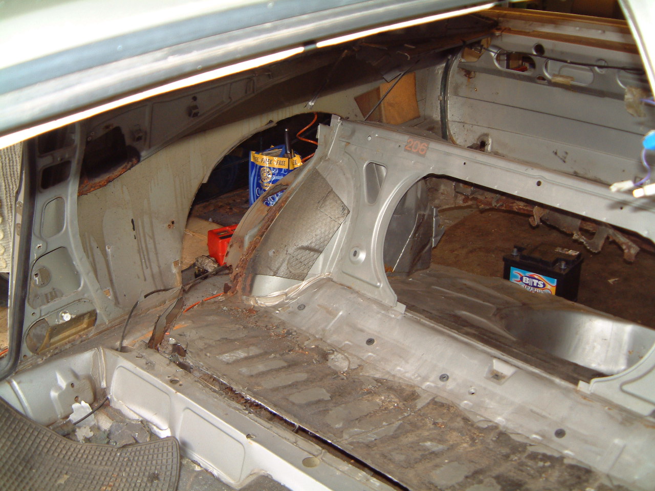

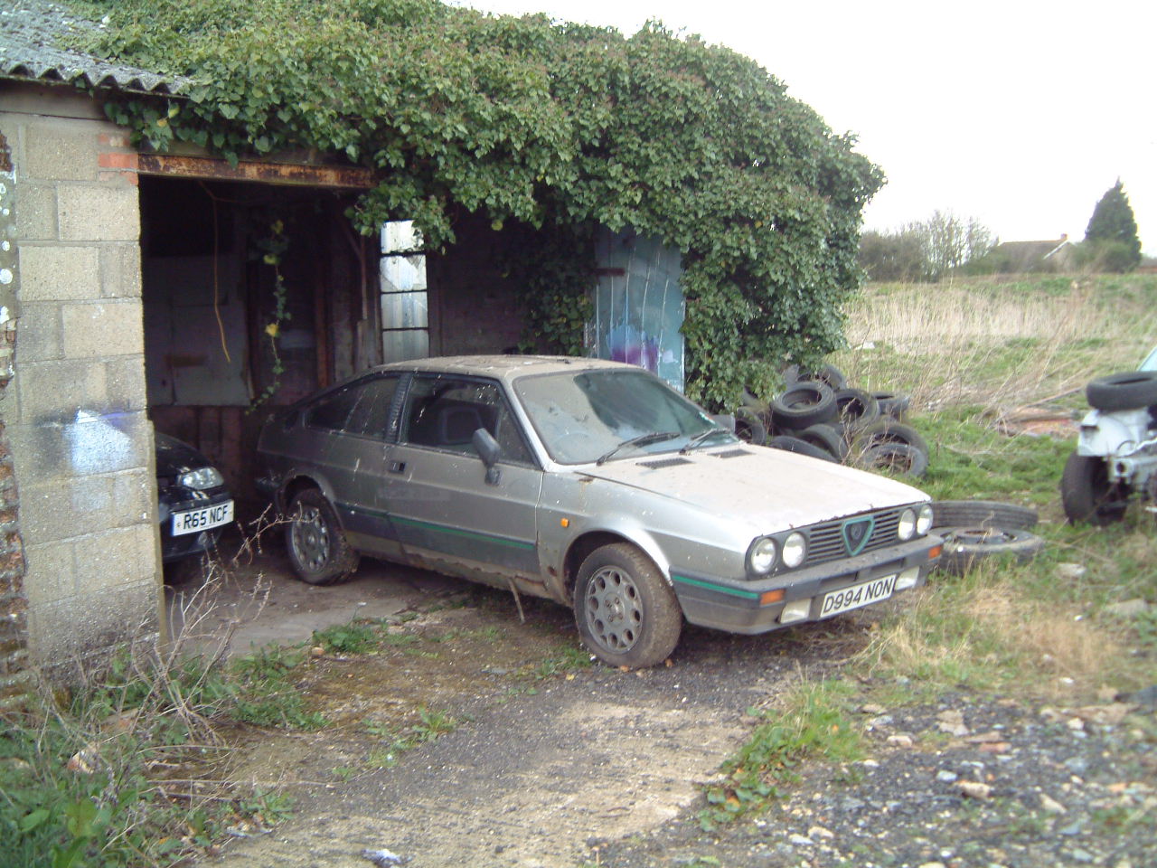

So I bought from E Bay "A Rusty Sprint suitable for Spares"
It was stripped out and the cutting started.....

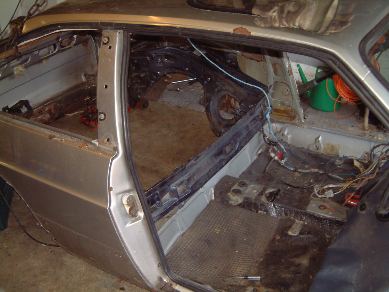

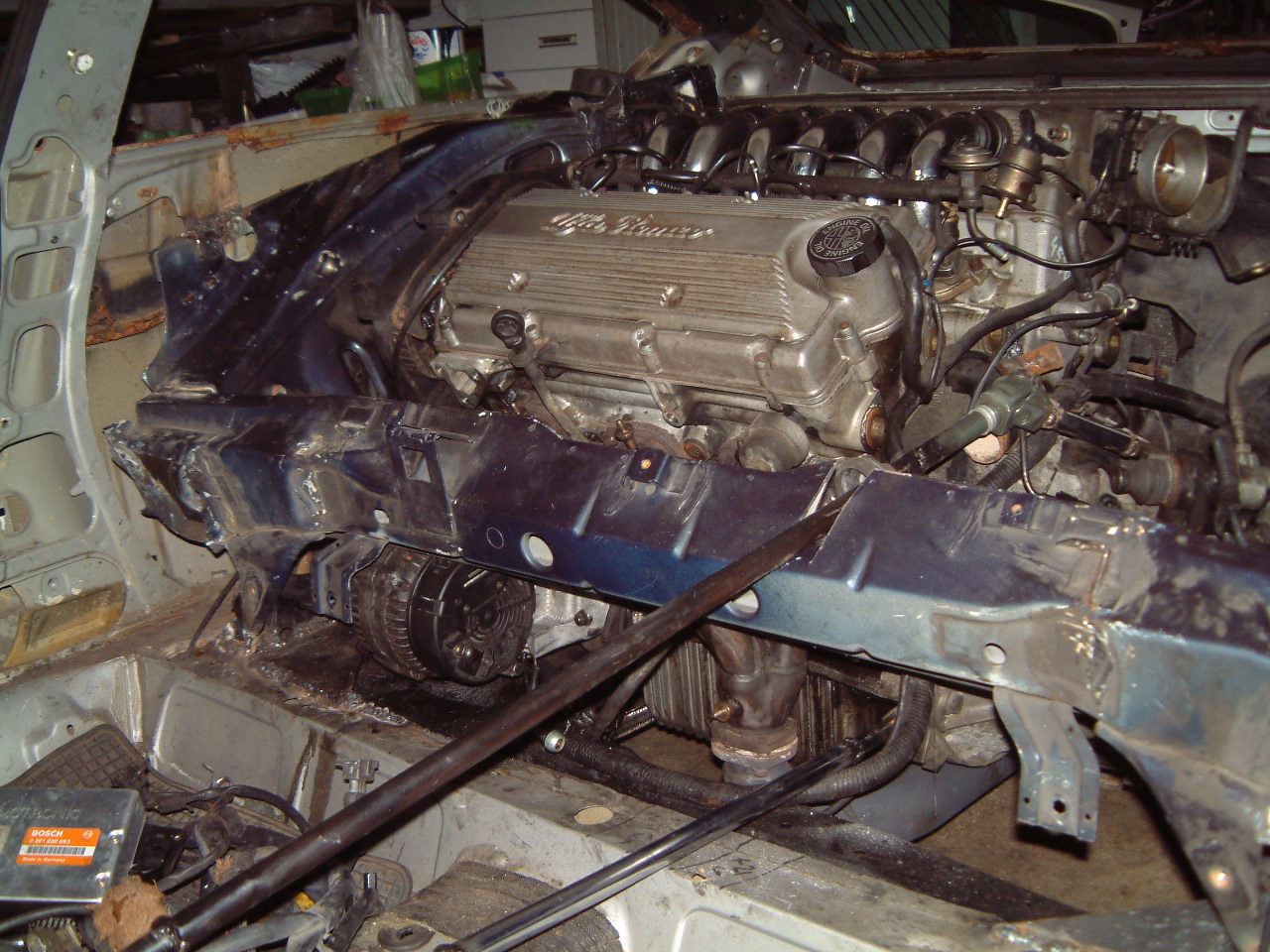

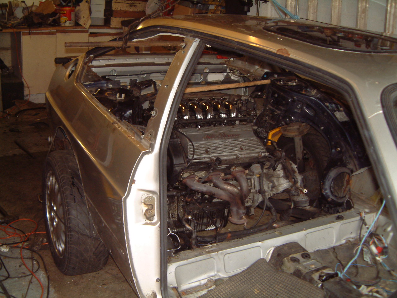

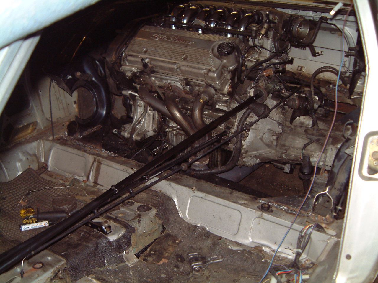

I had also obtained a 3 litre 164 with a good engine and gearbox - I stripped that and cut off the front to give me the inner wings and support for the front subframe. (The original 6C had used a longitudinal mounted 2.5 V6 with a ZF transaxle - far too expensive for my project).
So I started to put the whole front of the 164 into the space created. I realised that the front cross member made the assembly impossible to fit so I ended up cutting it off, putting the two inner wings in place with the subframe and then rewelding the front cross member (reversed to give more cabin room).

I also had to reverse the rod gearchange system - I was able to use the 164 rods lengthened, and with an extra UJ from the 164 steering column!
The selector on the gearbox could be reversed to allow the rod to fix to the front. I needed a steel bulkhead and the silver bonnet was totally rusted on its front edge so I used the remainder.

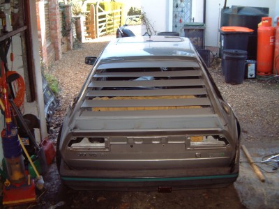

Other work was to widen the rear wheel arches and create the characteristic rear louvres.

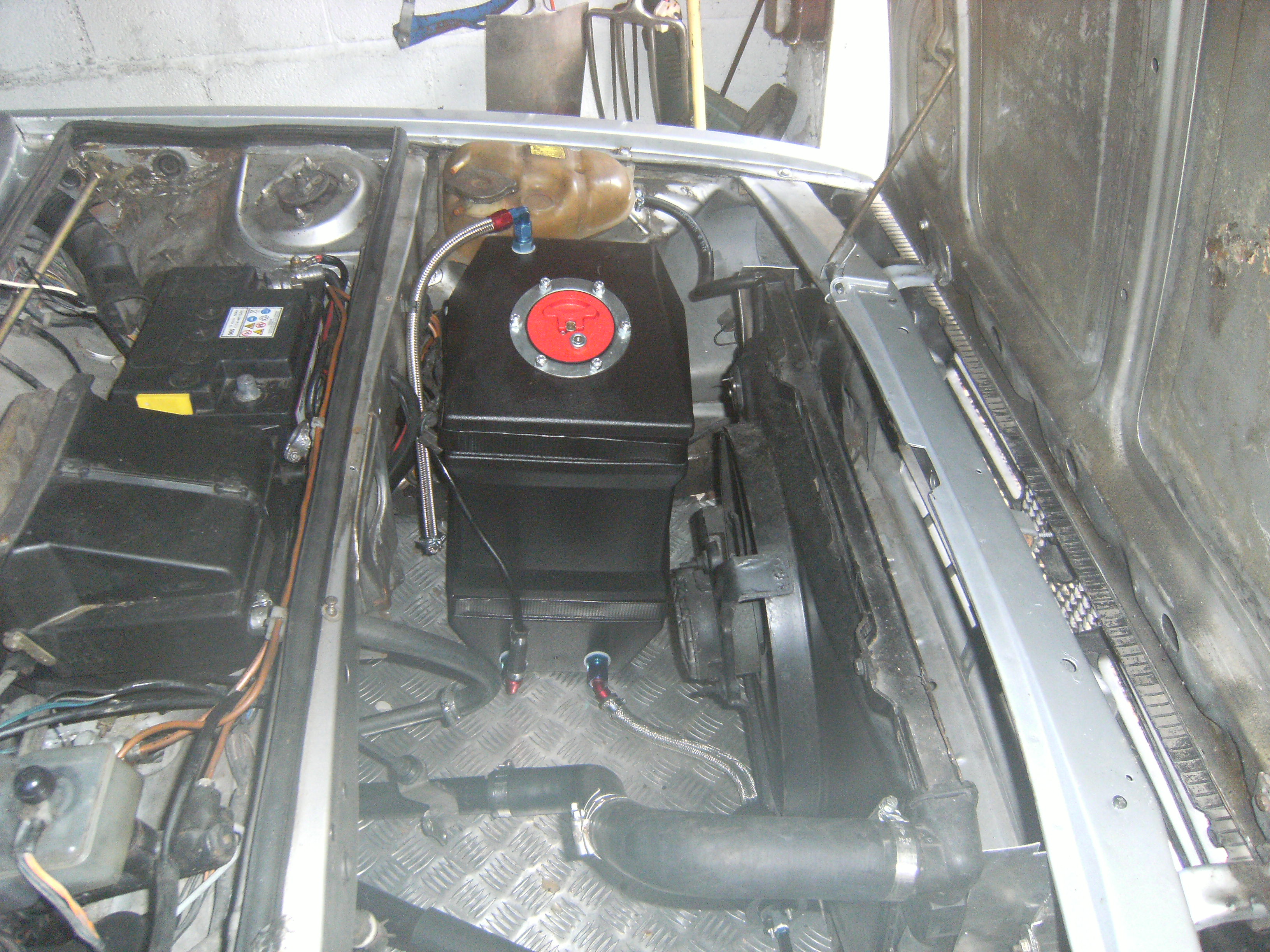

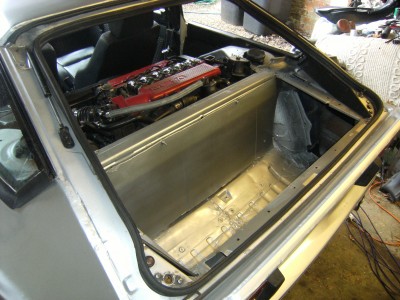

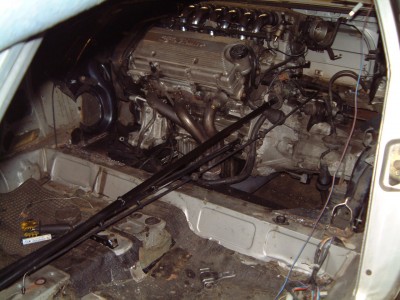

Here are a couple more pics of the 6C build showing the steel removeable bulkhead behind the engine - giving a useful sized boot!.... and the dragster style fuel cell at the front with the pipework to the 164 radiator and electric fan. I had tried to modify and use the 164 fuel tank but I couldn't get the plastic welded well enough to be strong and have no leaks.

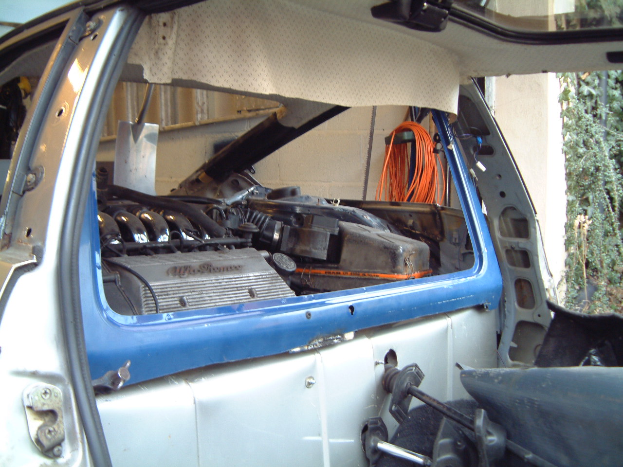

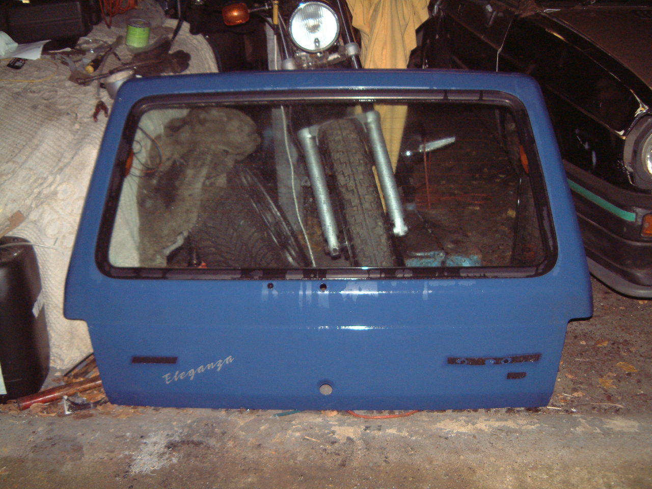

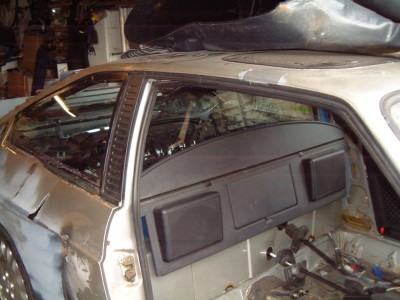

Another job was to create the "Thermo-acoustic" barrier between the engine and cabin. I initially thought of using the Sprint tailgate but it was too big and the gearchange rods would have needed to go through the glass!
Instead I looked at other small hatchbacks and found that a Fiat panda had a suitable hatch. E Bay was my friend again.....

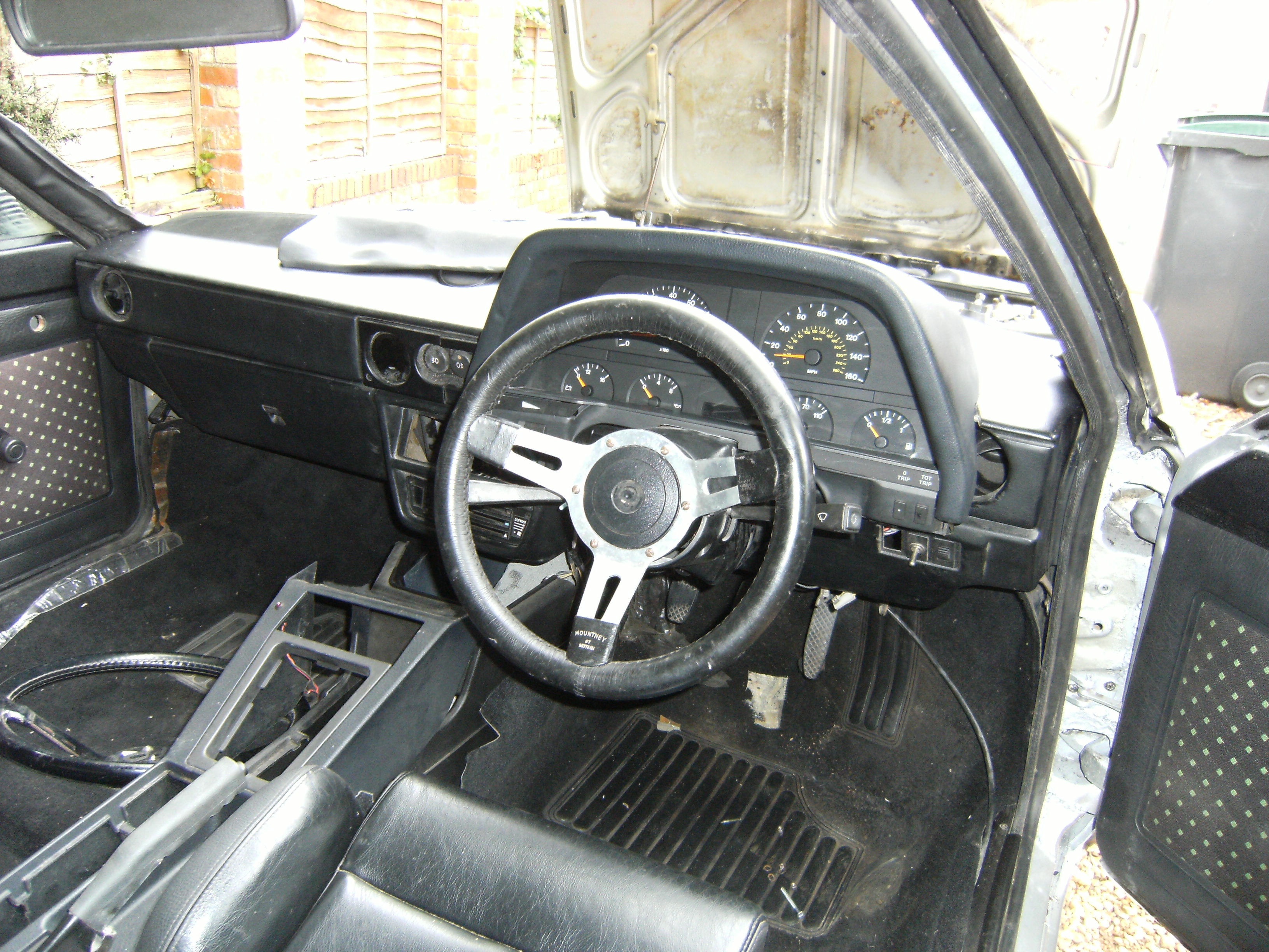

Inside the car I tried to use the instrument binnacle from the 164. By cutting a larger hole in the Sprint dashboard it fitted reasonably well.
However there were 6 plugs to the 164 dash with 64 wires and despite hours of poring over wiring diagrams and fault finding, continuity testing, cursing and soldering - I could not get it to work properly so I reverted to a simpler Sprint instrument panel - and yes I had to change the dashboard to get rid of the big hole!

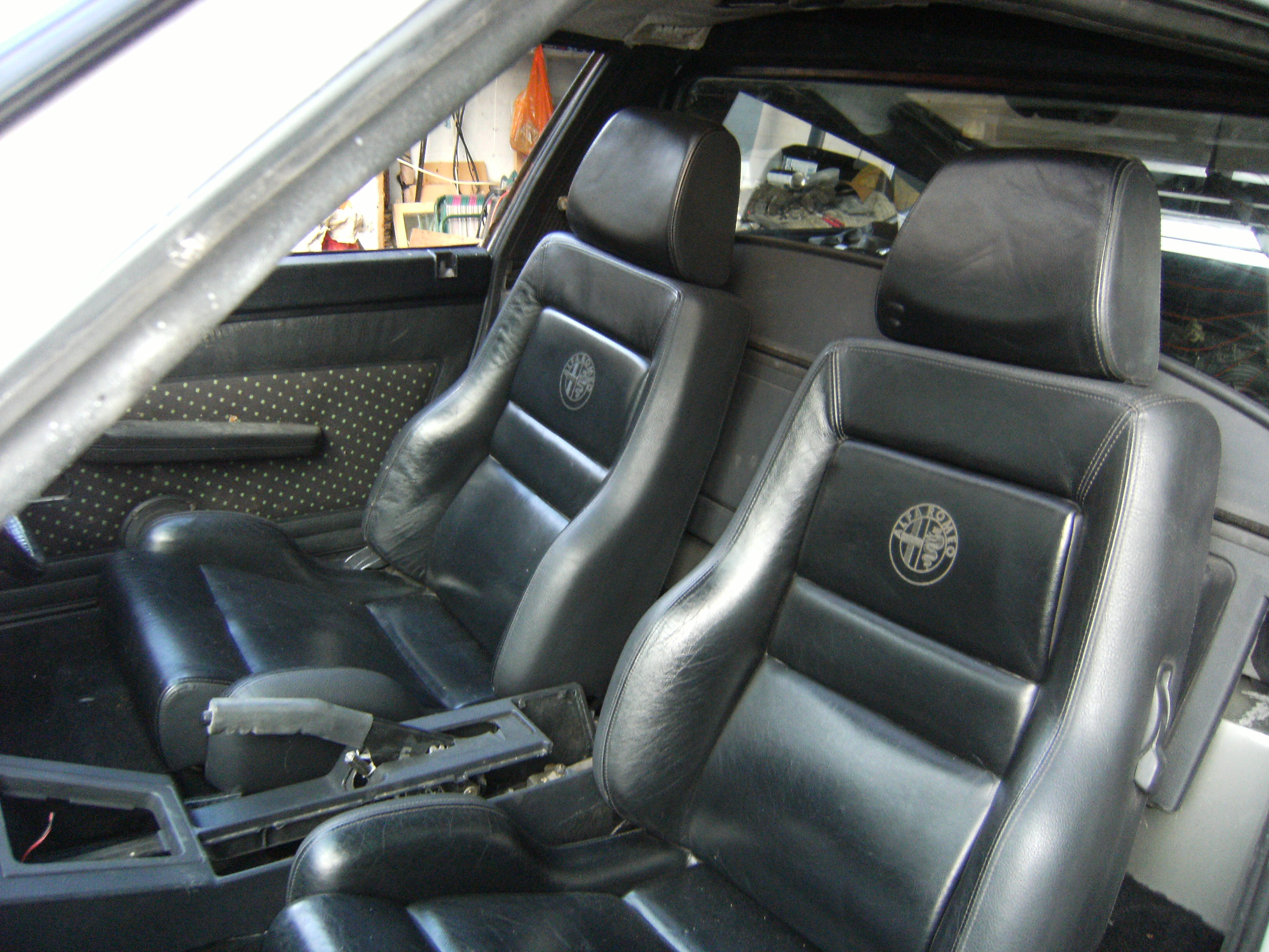

I also used a pair of Spider (916?) seats.

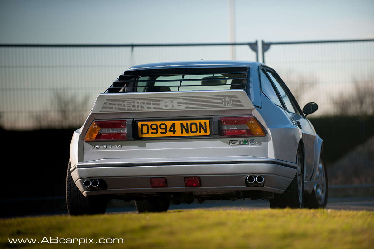

Here are three of the Pro pictures of the 6C
