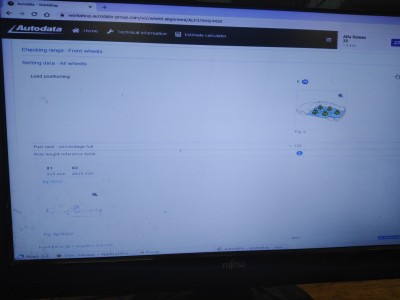

This is for the 33 16v S3 it doesn’t specifically mention P4 but I’m pretty sure it’s the same If you can cross check with your info next week Kev .

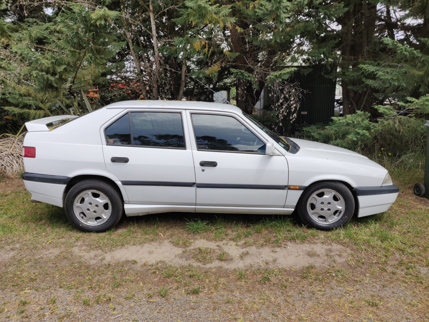

I've been talking with my son (and co-owner) over the weekend and now we're not sure whether someone has been monkeying around with the suspension - and whether that means the correct specs will be wrong. It looks lowered at the front and raised at the back. Could be someone has put a standard 33 lowering kit on it. I'll take a photo and upload.

Here's the photo. So this is standard?

That stance looks correct For a P4

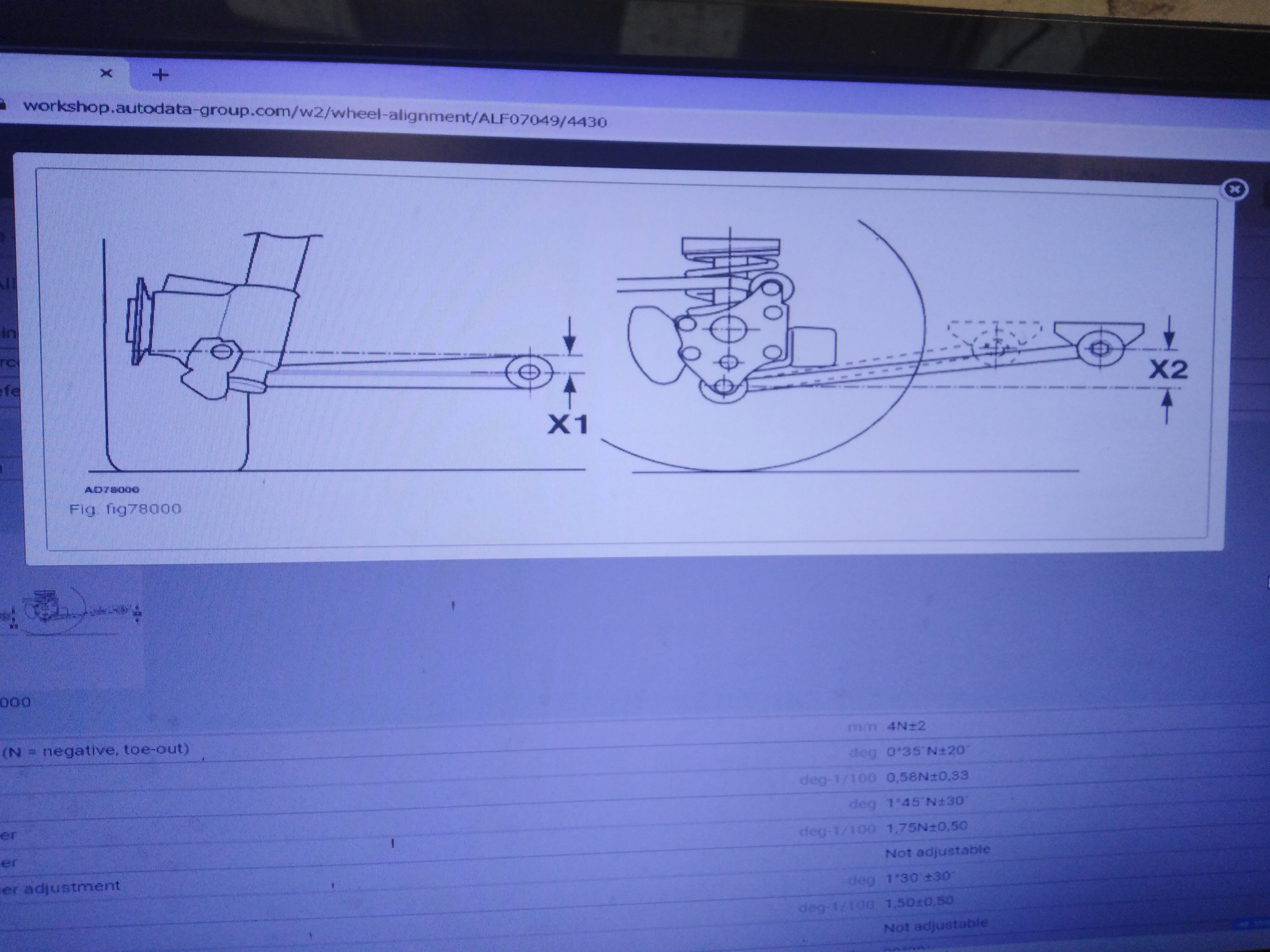

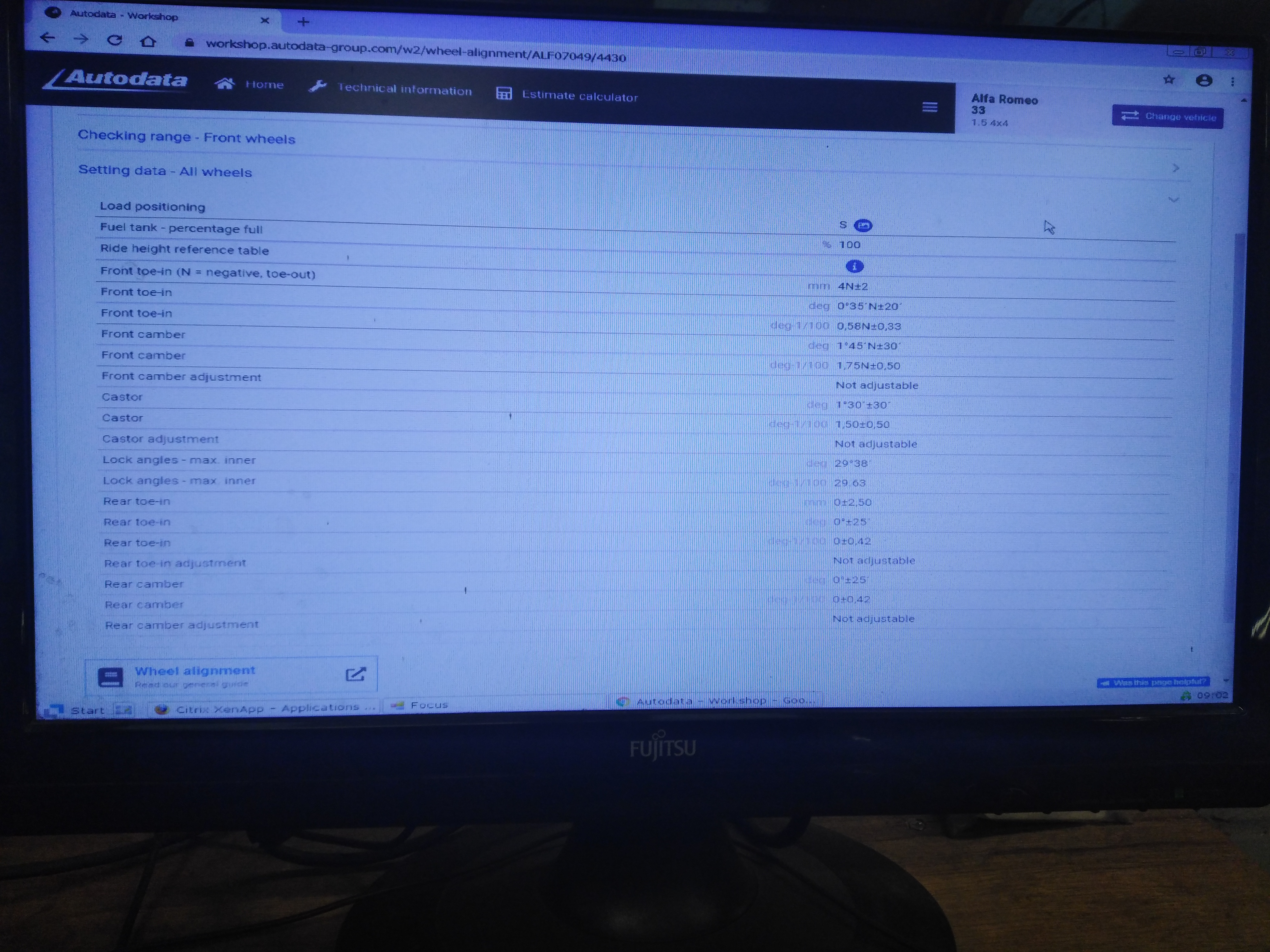

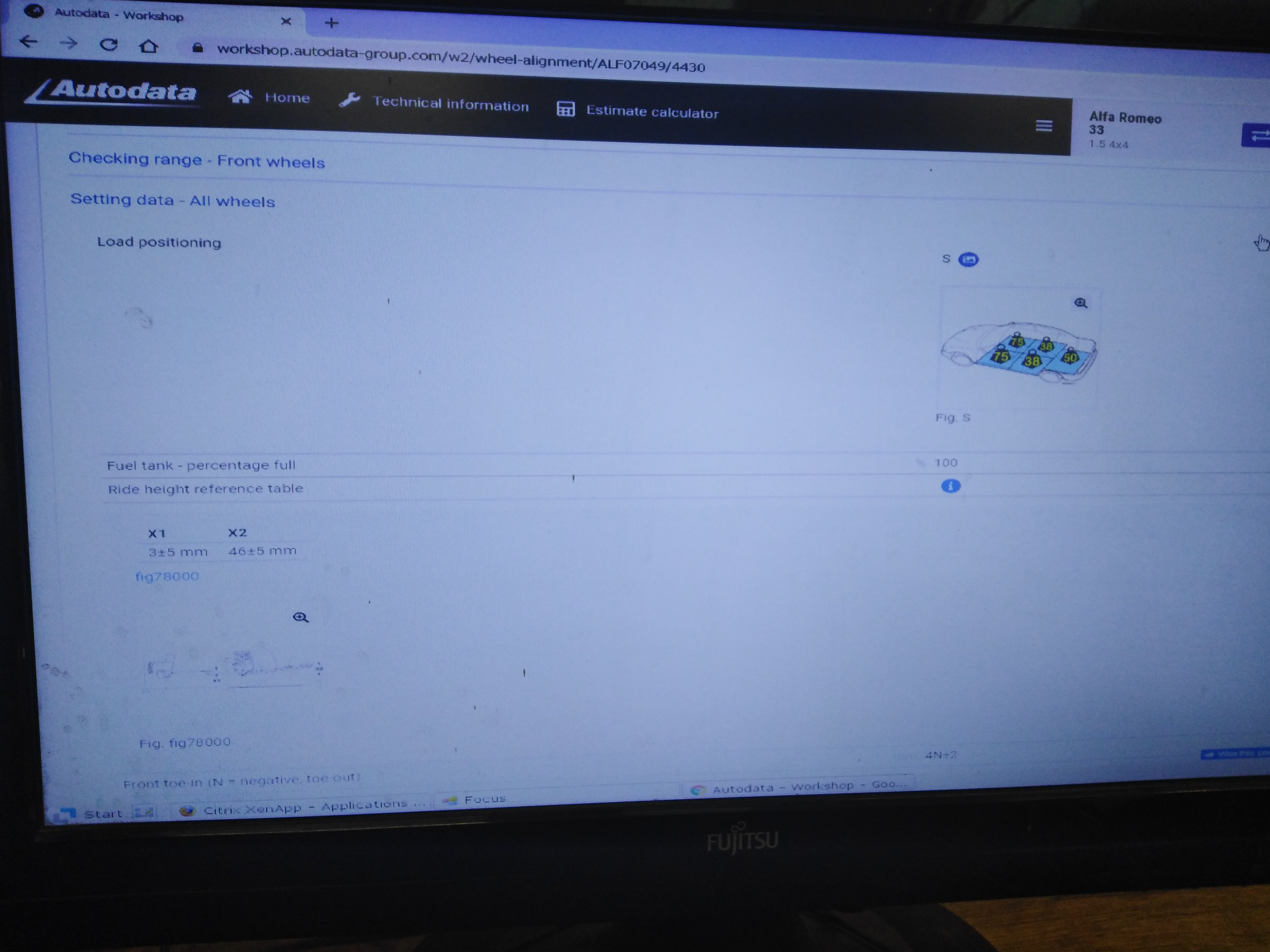

Here you go

Other things before checking are filling the fuel tank & also check what load is needed in the car - it’s stated in the spec with weight bags in the seats and foot wells
Re: P4 Wheel Alignment Spec?
True...Gary Orchard wrote: ↑Tue Dec 08, 2020 9:05 pm Other things before checking are filling the fuel tank & also check what load is needed in the car - it’s stated in the spec with weight bags in the seats and foot wells
