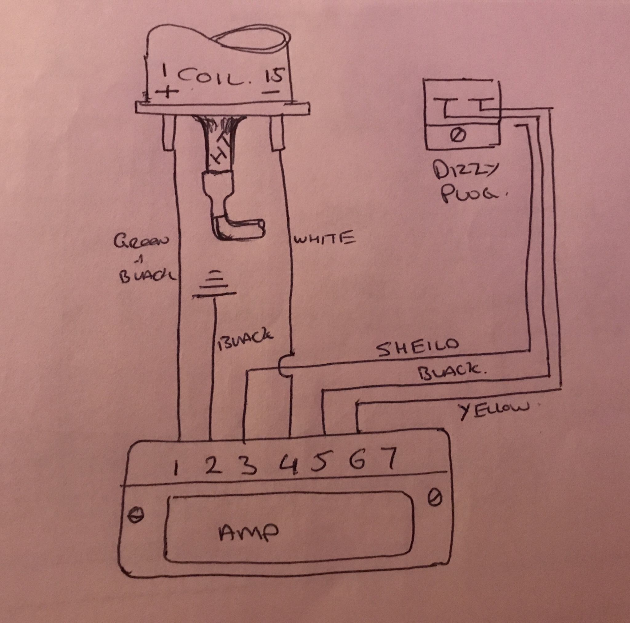

With the supply of Bosch’s “Green” ign lead being of almost Unicorn poo status I thought it may be helpful to take a butchers at this “Special” lead in detail.
You can get The 7 pin connector with terminals for the Amp From eBay and the actual green lead is a simple 2 core shielded lead. The only special part of this lead is actually the 2 pin plug in to the Dizzy. But if you get stuck This can probably be Modified with 2 simple connectors
I’ve drawn a simple wiring diagram to show the amp/coil wiring .
I just I need to confirm the Various wire gauges. I’m currently researchIng the supply of a suitable shielded lead (may not be green) that may mean I can make new ones.
Hope you find this usefull
Lou.
