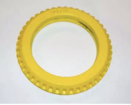

The early set up for strut bearing consisted of a rather hefty collar that the bearing sat on and could be stripped to be greased up. it also housed the seal But this was very small in cross section and was crap ! The strut bearings seizing up was the main cause Of stiff steering And a reluctance to self centre. The modified bearing is enclosed in a yellow plastic housing and they are a much better item. They’re not designed to be split open but You can carefully tweak them open and I have done it in the Past .

Loo is this modified housing applicable to a Sud S3 as well?
Re: Harsh ride front shocks/ springs
Hi Tony yeah the Yellow bearing Can be fitted to S3 Suds this is what it looks like
They’re available on eBay from
Febi. Pt # 17187 It Sachs pt #801025
