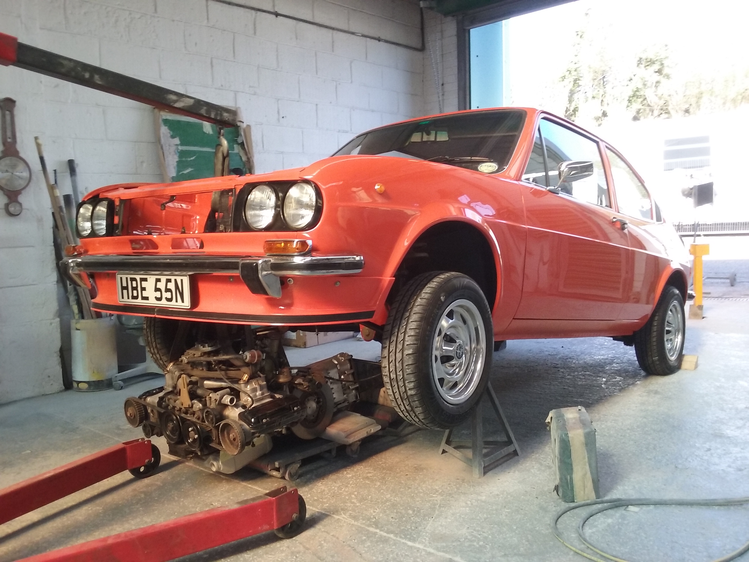

I put the front wheels on DIY type ramps.
Lower the engine/box down using my lifting beam/chain block.
Put hardboard under and pull the unit out........its a tight fit.
Prob best to take the manifold off I think.....it could get damaged.

Sorry no pictures. Get your car on axle stands like in Kegsti66 picture. I'd have it slightly lower and then raise it when the engine is on the floor. Slide the ladder under the car so it just past the far end of the gearbox. Lift the ladder at the front of the car. You will find that the sump fits in between two treads so sits in the gap. Lift the ladder to take the weight. Get someone to pull the bolt then lower engine to floor. Raise car so engine fit under the front. Use ladder to slightly lift engine and pull ladder and engine from under car.

If you have an engine hoist use that to lift the body once eng/trans is on floor... when I removed my engine the highest things to get over were carbs and their horns.
