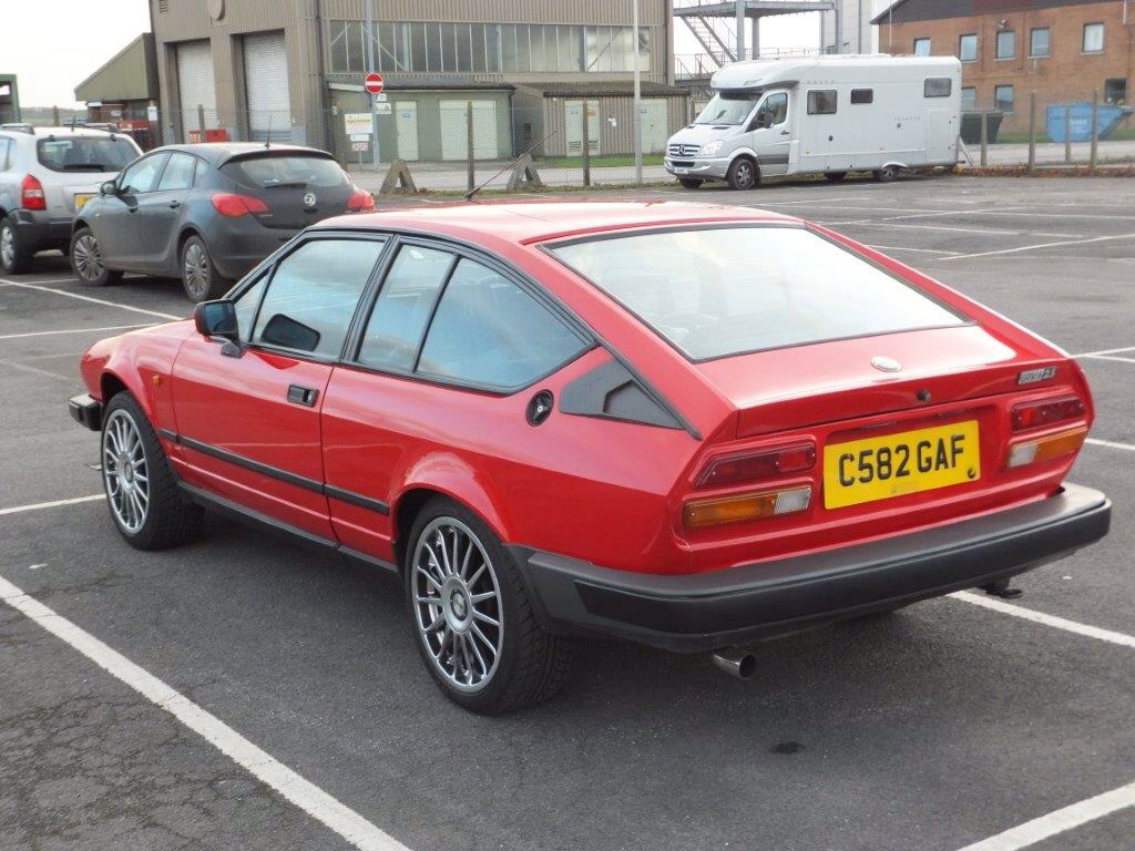

Great looking gtv . I bet your gagging to drive it
Re: GTV6. Prop-shaft rebalance
That's an understatement! I will tear around for a few hundred miles just to say hello again. There is a local transport show at the end of the month that has a classic car category. Entries are closed now but I may take it down anyway.Johnboy wrote:Great looking gtv . I bet your gagging to drive it
