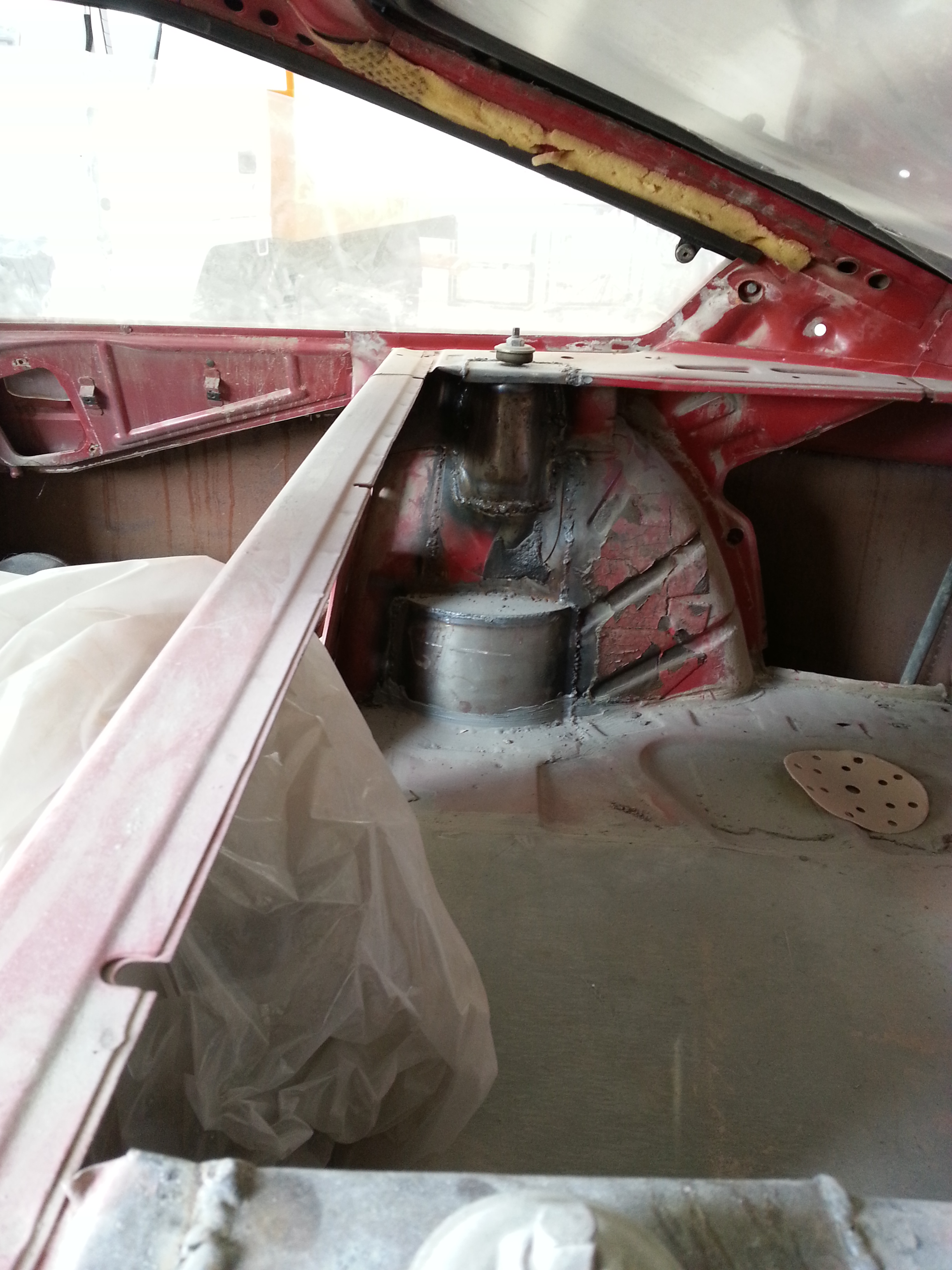

The engine is up front, the rear axle was the π shaped and now there sits the rear diff of the p4
Only hope my measurements were right when I chopped up the rear suspension mounts and moved them up.
Here's what I mean...
Check out the rear suspension modification I did in order to accommodate the springs of a S2 Sprint (same as the 33 only a bit stiffer)
Then see how high the car sits at the moment.

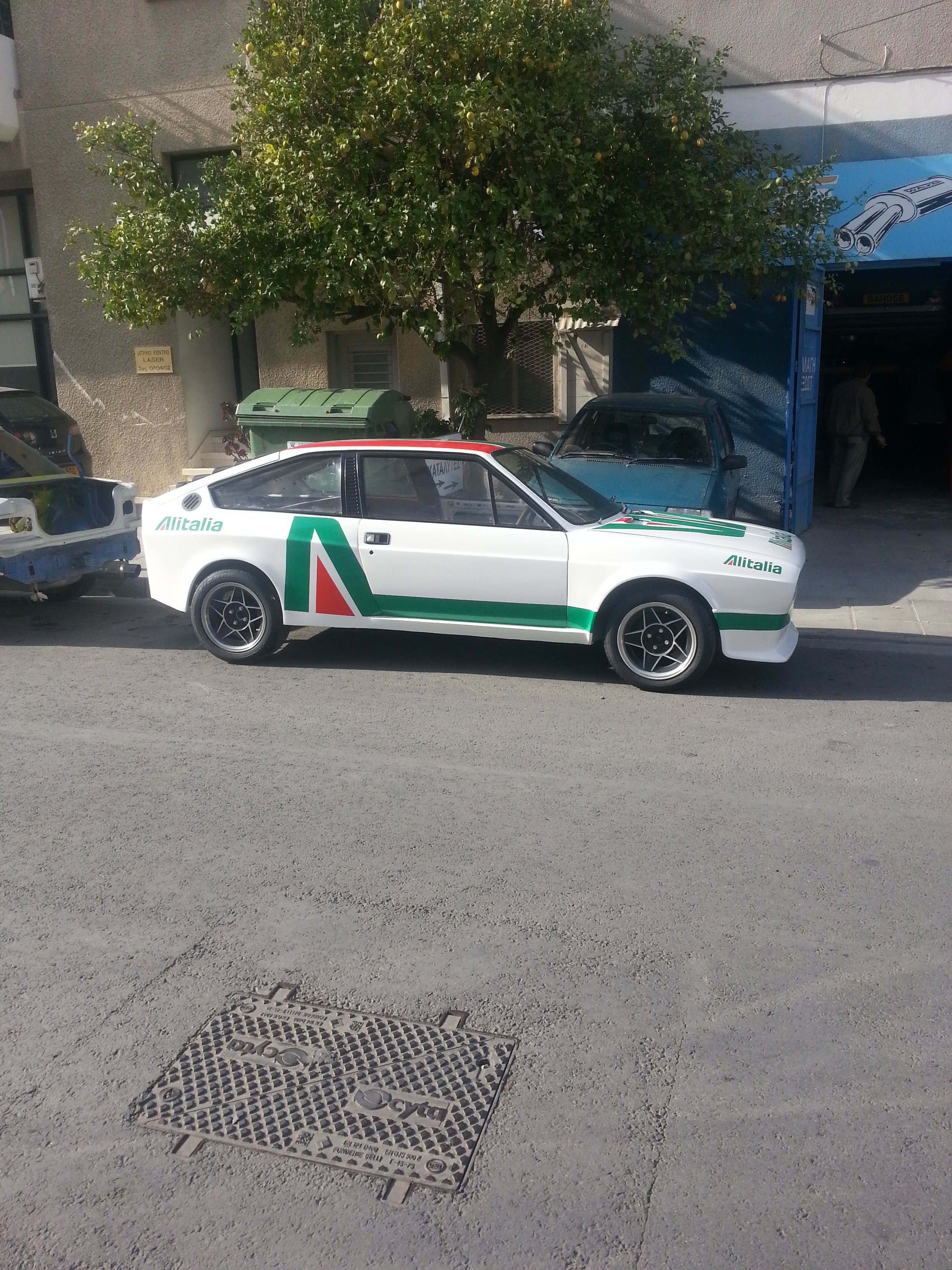

The rear is extremely stiff due to heavy duty gas shocks and very little weight at the back. Front is soft.
Shrewy, got any pictures of how that sud sits ? You wouldnt happen to know what the poundage is on those, do you ?
