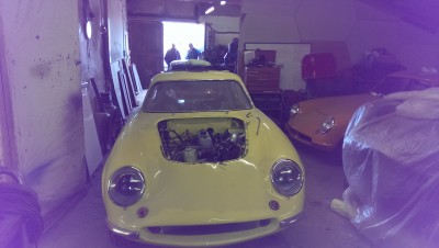

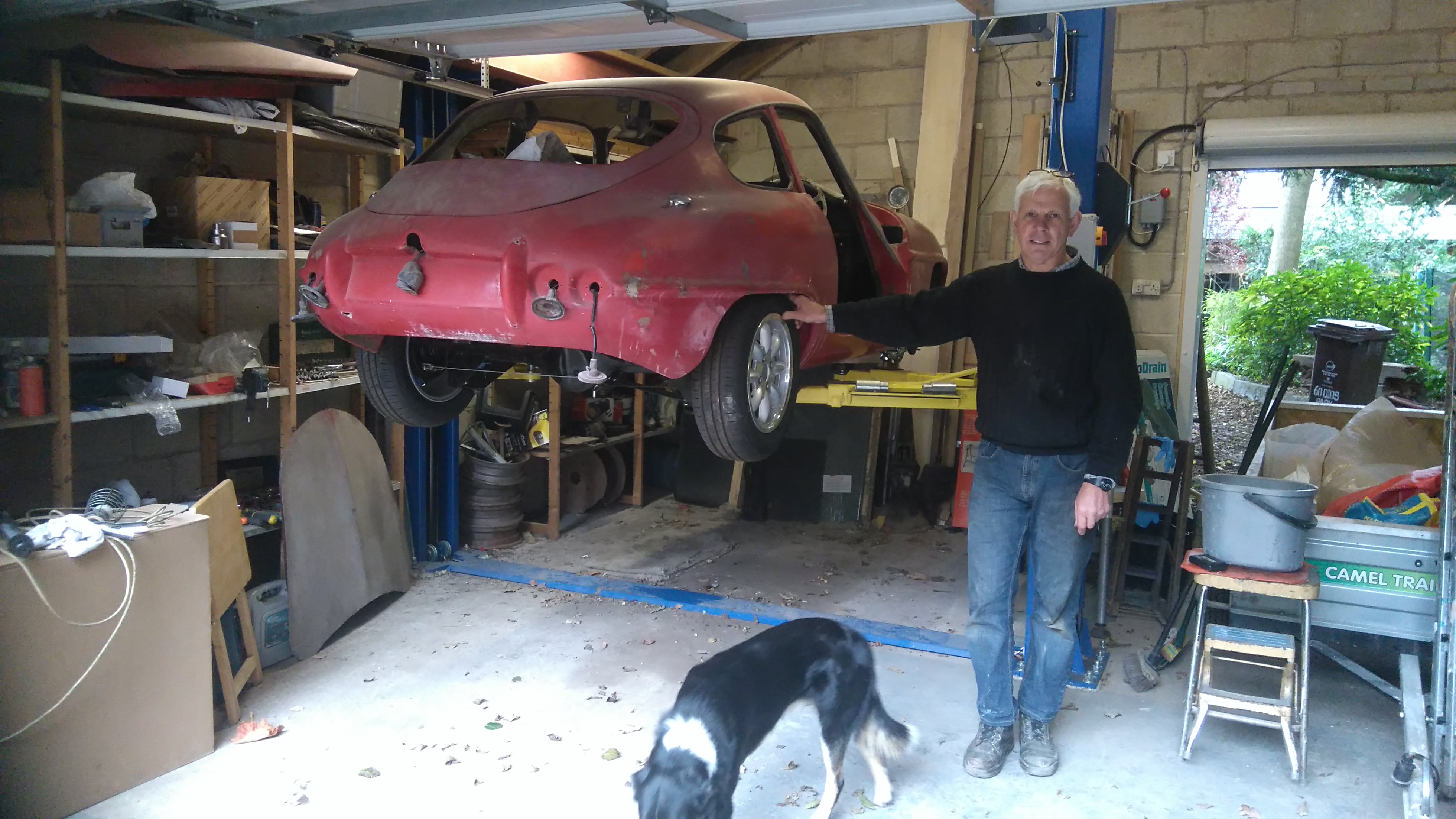

Alfa Daves latest customer project is as follows,
any guess's what it is

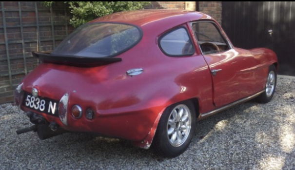

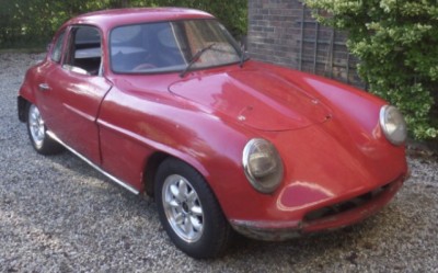

Is it a Rochdale ?
Re: Dave's Mystery Restoration?
Yes......which one?
It's a Rochdale Olympic
Which phase?
I think it's a Phase 2 with the opening tailgate . Engine should be a 1500 ford pre crossflow if I remember rightly
another interesting one to follow, looking forward to seeing all the details
Phase 2, with opening rear hatch
Phase 2 of course.....I'm pointing towards the rear hatch which they added in 1964 if you remember.
No prizes for guessing where it was built.....not Athens!
Originally had a pre Xflow engine which blew up.....and the owner scrapped.
So, now has a 2 litre Pinto SOHC, and the original 4 speed box which he had rebuilt
Its a fibreglass monocoque......the only other car I know like this is the Elite.
There is actually a small tubular sub frame at the front to support the steering/suspension, but the rear end bolts direct to the thickened up fibreglass.

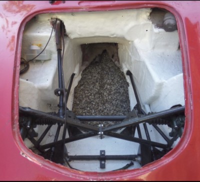

It only weighs about 5p, so hopefully should run pretty well.Current carb is a weber twin choke....but may be upgraded.
The designers father had a 356, so he stole the front end design off that....and the rear end off an E Type.
A bit slab sided, but very aerodynamic.
They had twin tanks formed in the fibreglass in the rear lower corners.....not very safe !
Keith at Scholar Racing who has restored a few of these, told me to fit an MGB tank under the rear floor where the spare was.
Its there in the box on the floor, but the owner is still thinking of using the original set up.
So far, I've got the engine/gear box and trans fitted.
Front suspension (Spitfire) and rear (Riley 1.5) in.
Recon rack, all new brakes done.
Just need the fuel system sorting to fire up.
Exhaust will be a purpose made job in Macclesfield.
Then the challenge of the wiring.....someone else will have to sort that!
Dave

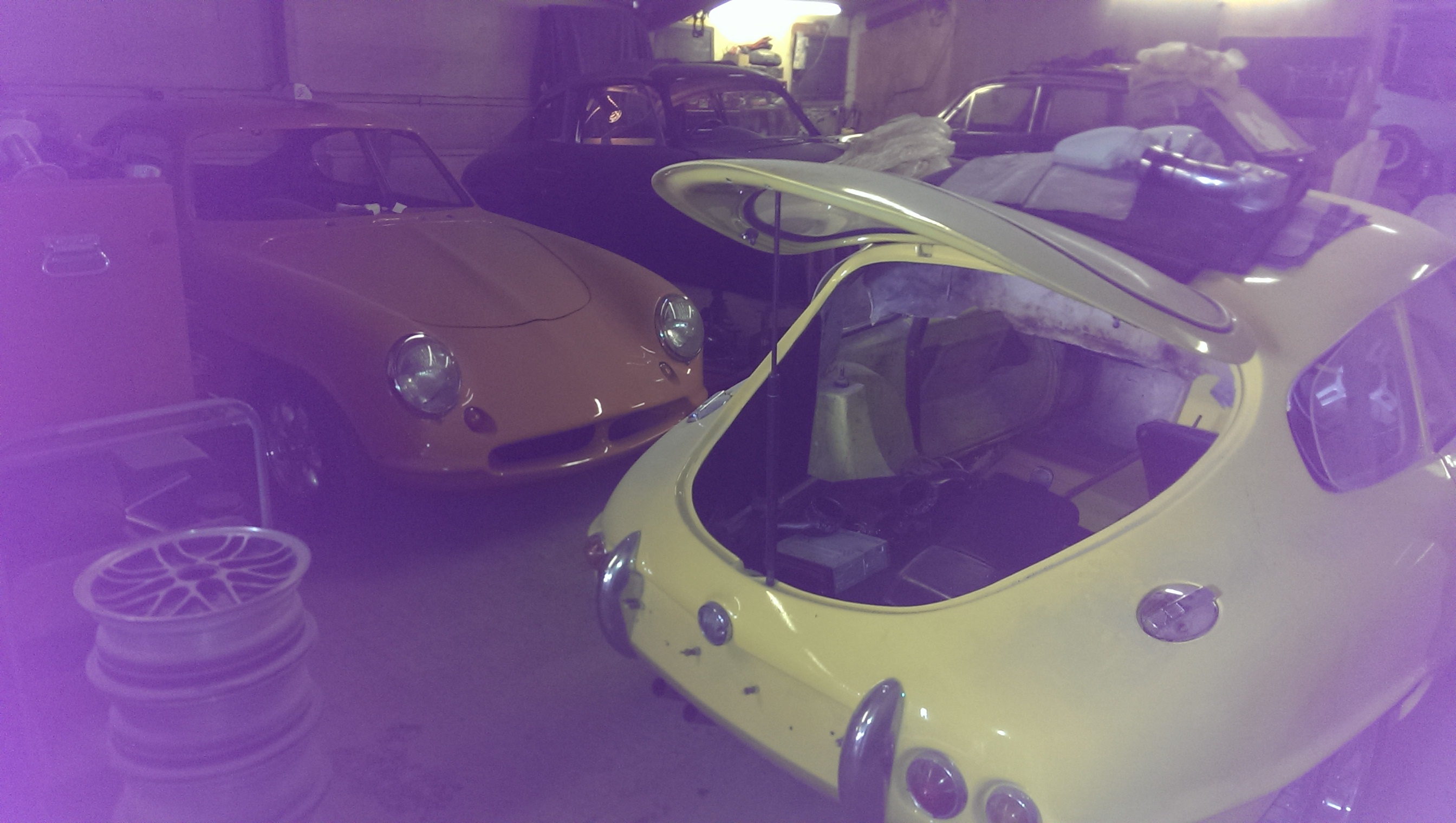

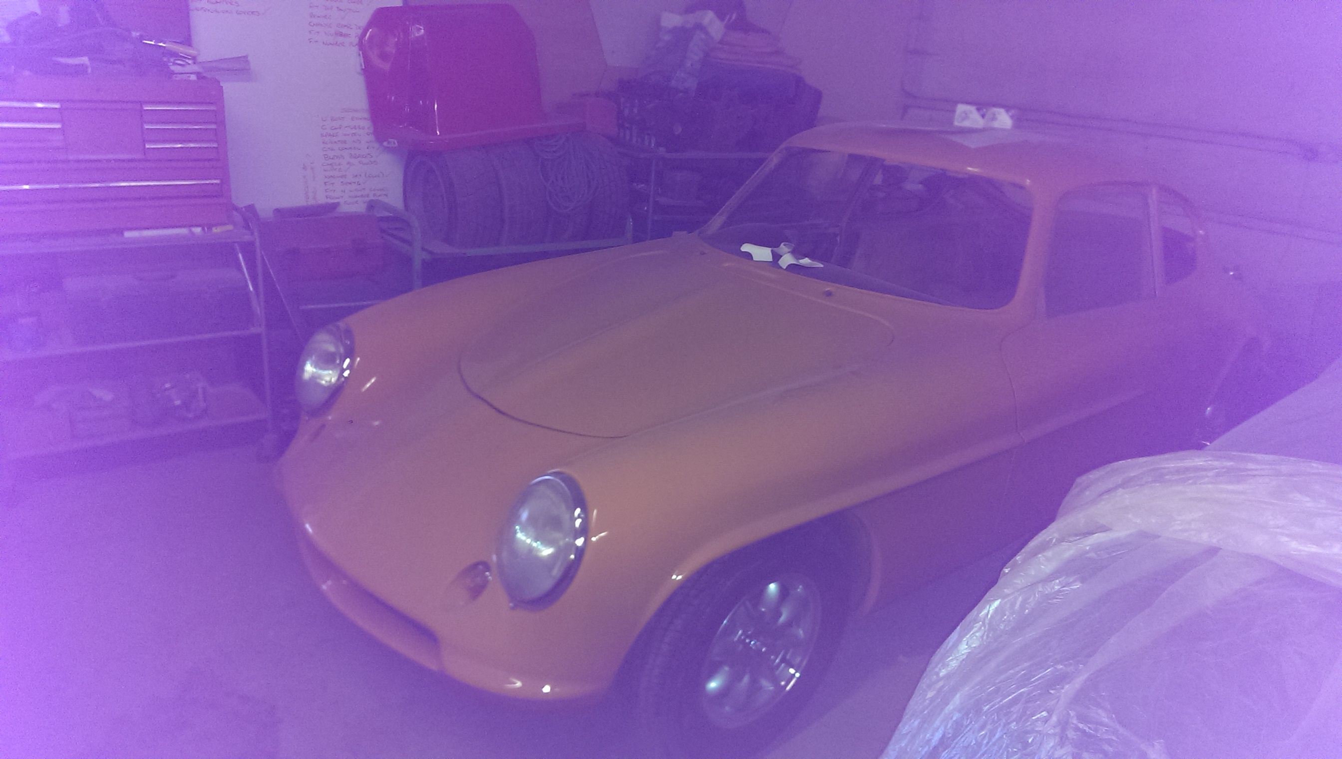

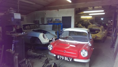

Called at Scholar Racing to pick up a pair of stainless tanks......must have been at least 5 Olympics there!
Also, an unusual little red car in the foreground.....any guesses?
Hopefully Shrew will post the photos for me soon.
Dave
Dave
That’s a Meadows Frisky. Do I win owt.
Which model of the Frisky?

Can’t see if it’s got 3 or 4 wheels . But looks like a coupe
Sorry...wrong
Have a look at Scholar Racings website for the correct answer
Ohhh Soz Mon

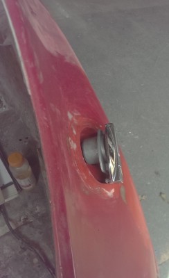

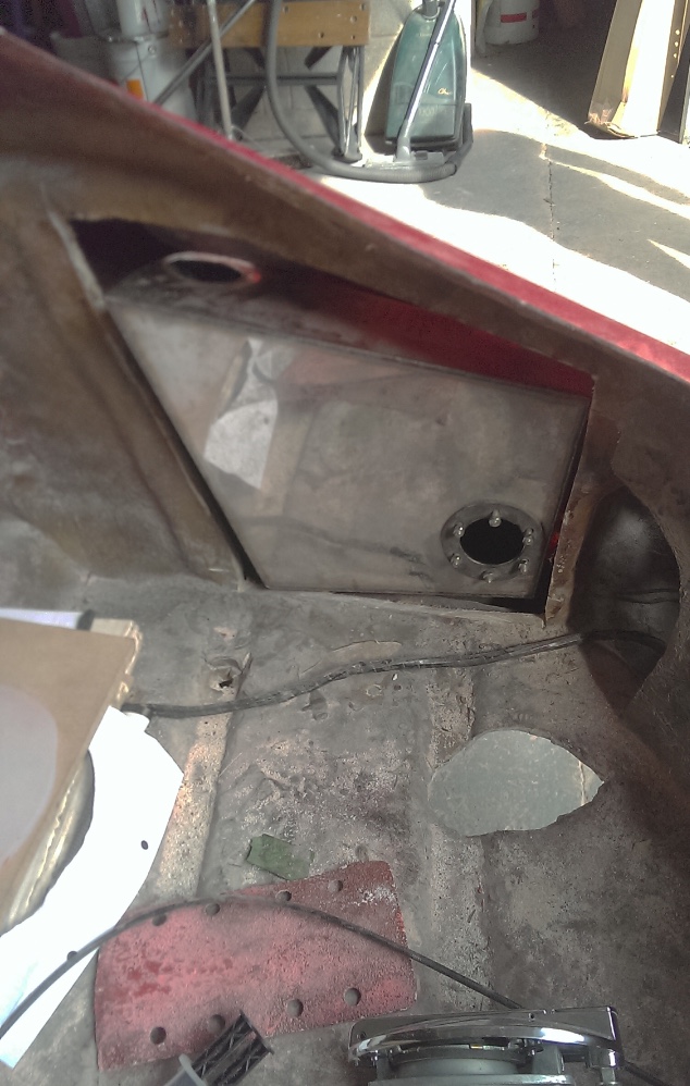

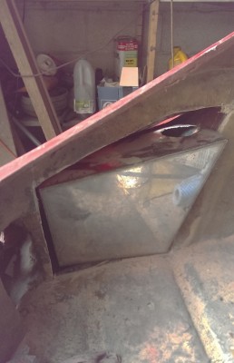

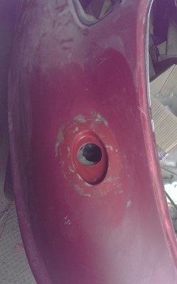

Pics show a pair of stainless fuel tanks, loose fitted in the 2 rear corners of the Rochdale Olympic, where the original tanks were formed in fibreglass.
The new tanks are pretty much the same size......the original 2 corners are different, and the filler holes are in different positions!
We've formed new filler apertures in the fibreglass to suit the pair of XJS type filler caps the owner wants.
Will then need some careful stainless welding to fit a spigot on each tank, to connect to the filler.
Its likely that JP Exhausts in Macclesfield will do that welding, as the car will be going there soon for a custom exhaust fitting.
I've never used them before, but looking on their website, they do a lot of stainless work.
I did try to talk the owner into fitting an MGB tank underslung, and more forward, where the spare tyre frame was originally.
But he wanted to support the Rochdale Owners Club by buying the twin tanks off them.
He did actually buy an MGB tank, so looks like it will be up for sale soon.
Makes me a bit nervous, having tanks on the rear corners in the event of a shunt!
Makes me a bit nervous, having tanks on the rear corners in the event of a shunt![/quote]
Yes can understand that. Is two tanks twice the risk ?
I always just think how much safer it is than a motorbike !
Told him....2 tanks 2 extinguishers!
Also suggested that once the tanks are finally positioned, they are surrounded in fireproof foam.
But ,I wondered if the racing fraternity had any better ideas?
