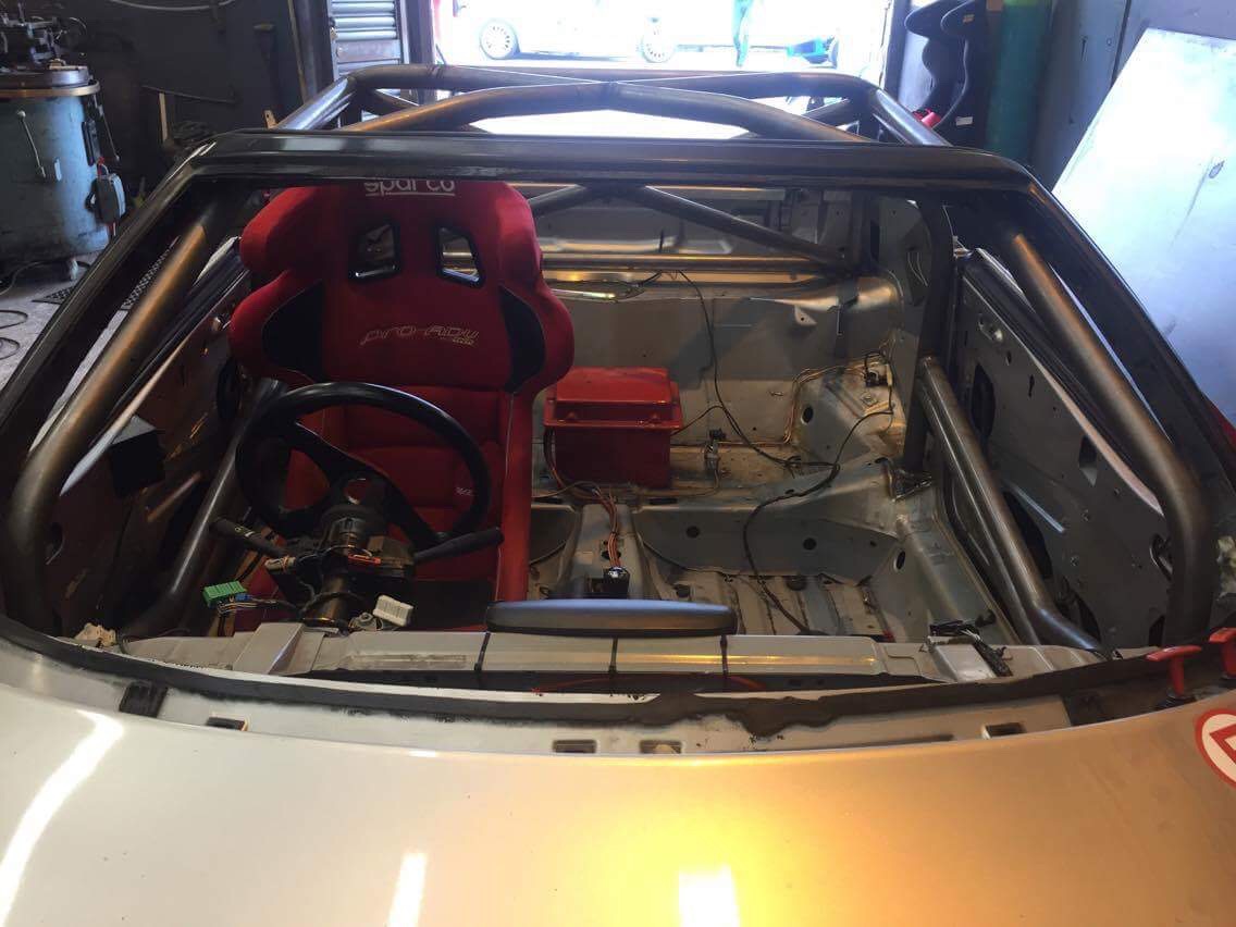

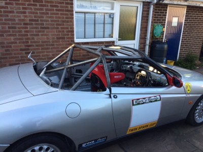

Cage finally in just got to paint it and plumb extinguisher, bolt seat in and fit new harness. May even get to race the sodding thing this year.

Looking good lou,
One thing i cant see though is your harness bar?
I thought being a new cage install that would have specced into it already?
I know from walking round the paddock this year that many folk have been sluggish to react to the new legislation, and some of those that have appear to have interpretted the angles of install recommended in the rules rather, errr, differently!
Re: 916 TS spider
Hi Shrew yes ithas a Hans bar thsi shot show uf better . It has to be down low as the seat is lower than stock.

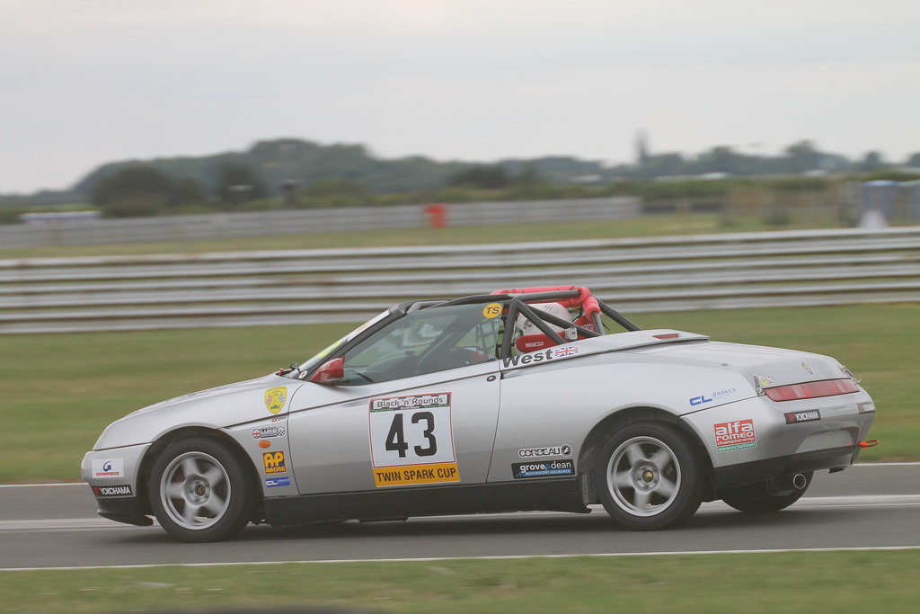

]Finally got the spider finished and track ready . Went to Snetterton a couple of weeks ago . Initial impressions are good its got decent pace. I had a problem with it constantly jumping out of gear as a result i had to race the whole weekend steering one handed and holding it in gear with my left hand. As such we treated the event as a test session .
Considering I'd never even driven the car in the road and had no idea if it had any problems im happy with the way it went. Anyway I've got the gearbox out now to replace the clutch and Found the problem . The linkage pivot thats mounted on the Rack had seized solid and the rubber bush was acting like a spring and pulling the lever out of gear. Thankfully it was A simple fix .

Sounds like a successful first outing .
Nice to hear you sorted the gear problem easily.
