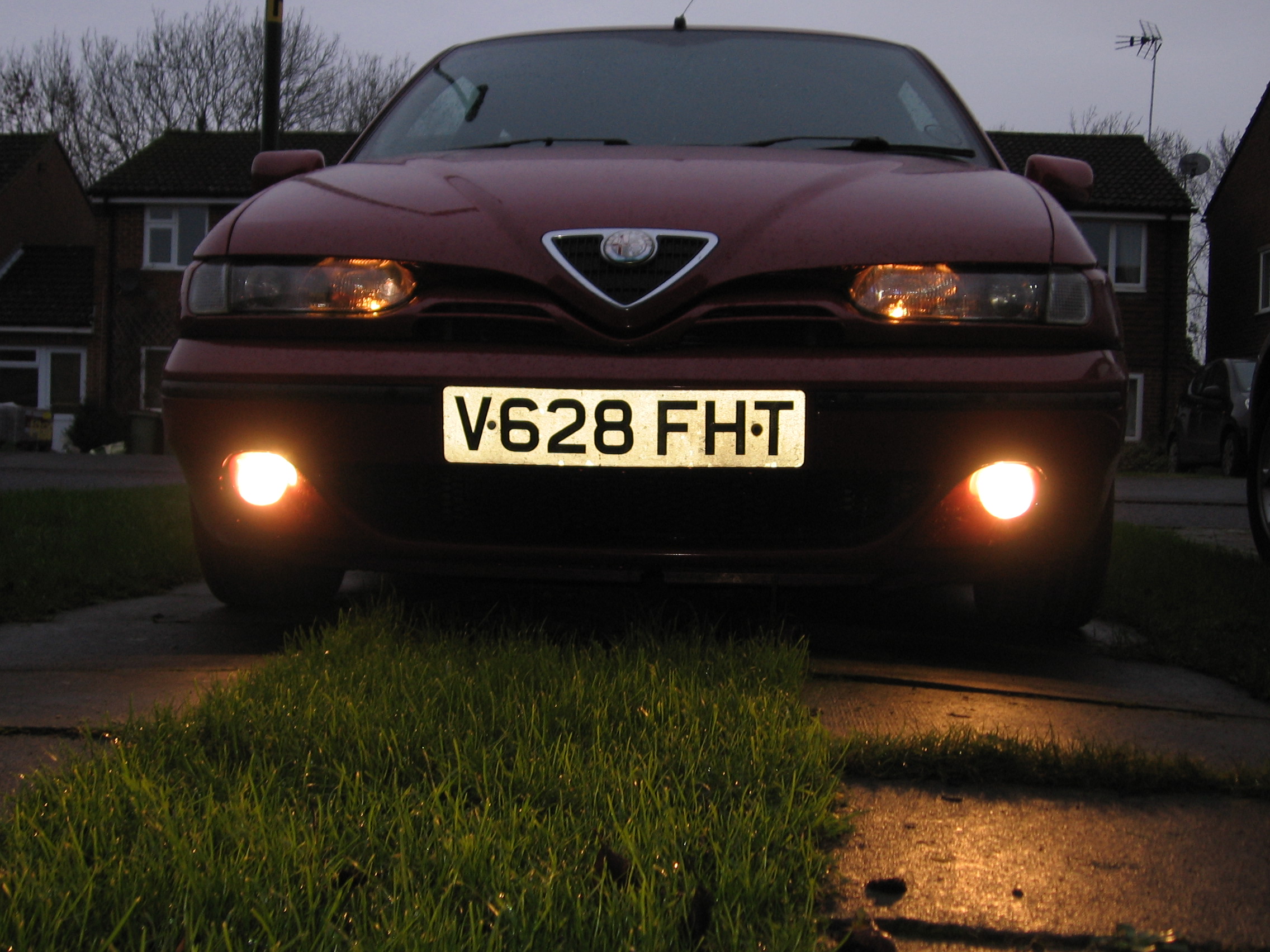

There we go guys job done,took a bit of finding. Who knew the spot lights are the same as a 156 you have to change the plastic mounting over but managed it without breaking anything. Filing a groove by the spindle made life a lot easier. Typical Alfa the lights have different part numbers.
