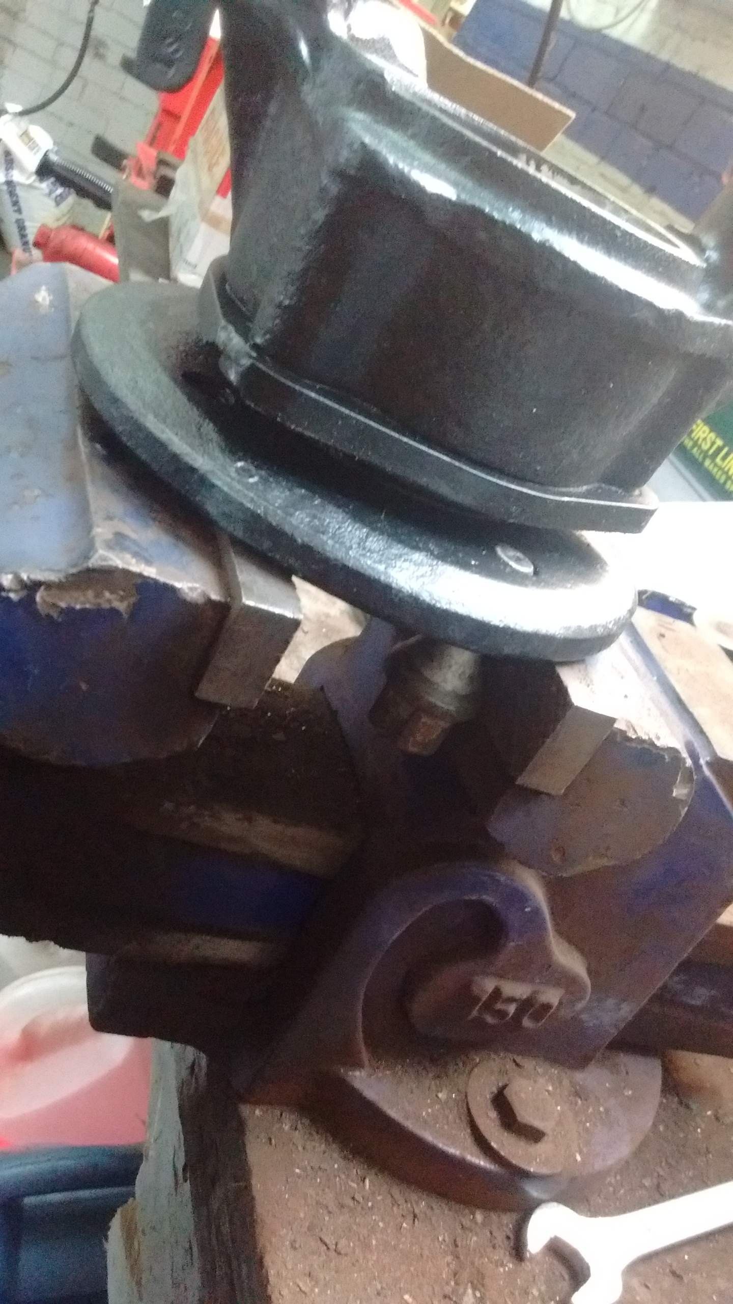

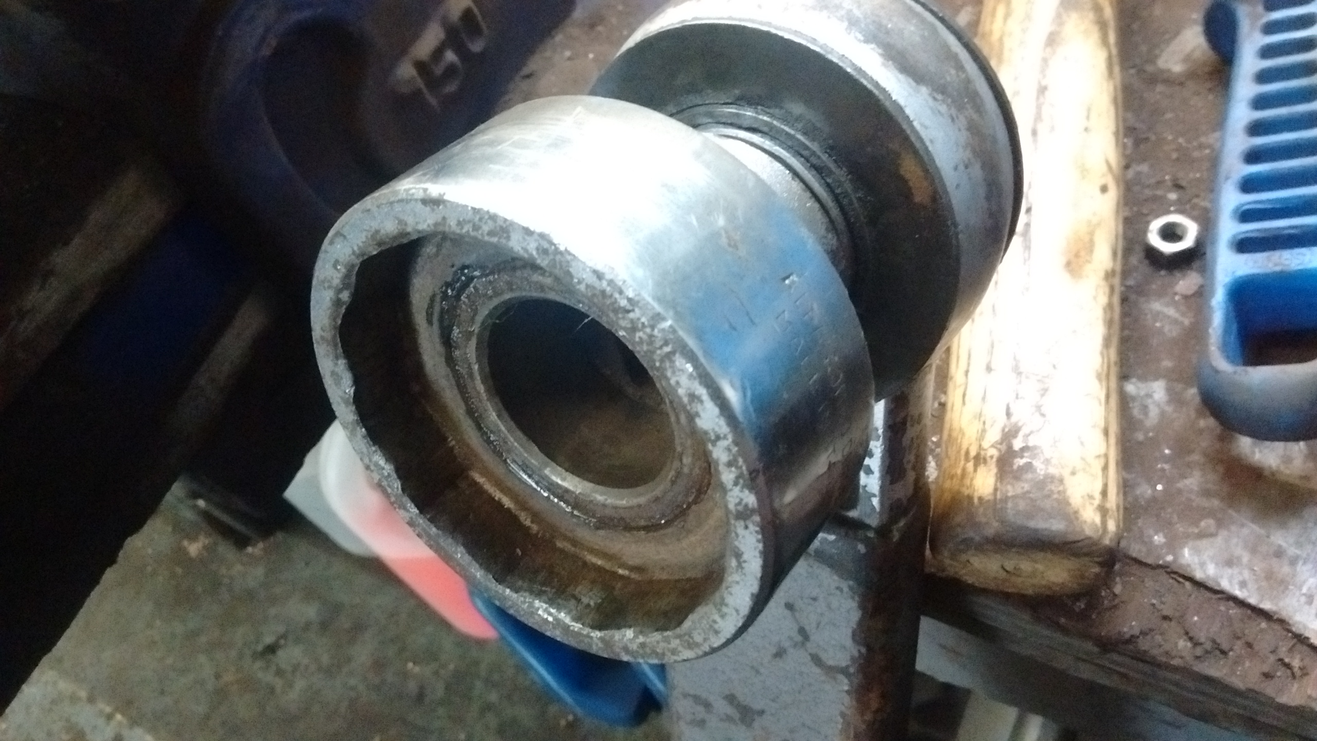

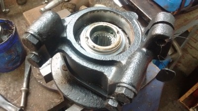

As we know there is an odd nut on the rear that holds the bearings in. I have looked at this nut before and considered buying a 55mm socket but never really had the need to change any....Tom came through with a genuine Alfa factory socket that is made for the job. A very shallow one that fits like a glove. Maybe a multi-point one would do the job too?
Said nut is pretty tight so to undo it requires the hub to be held firm, best way to do that is in a vice on the workbench. Guess on the car would do also but as the hub needs to be off!..
To stop the hub rotating in the vice just screw in a pair of wheel bolts which will stop it turning when they reach the vice jaws.

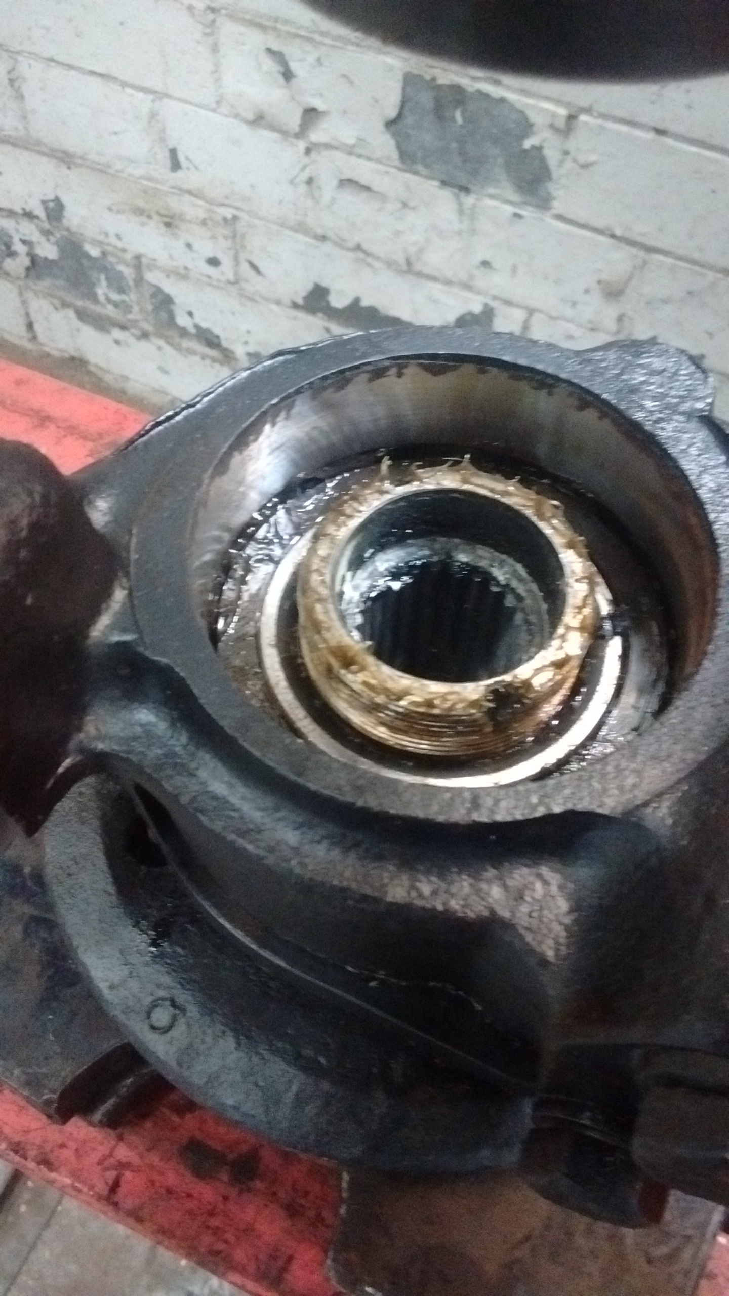

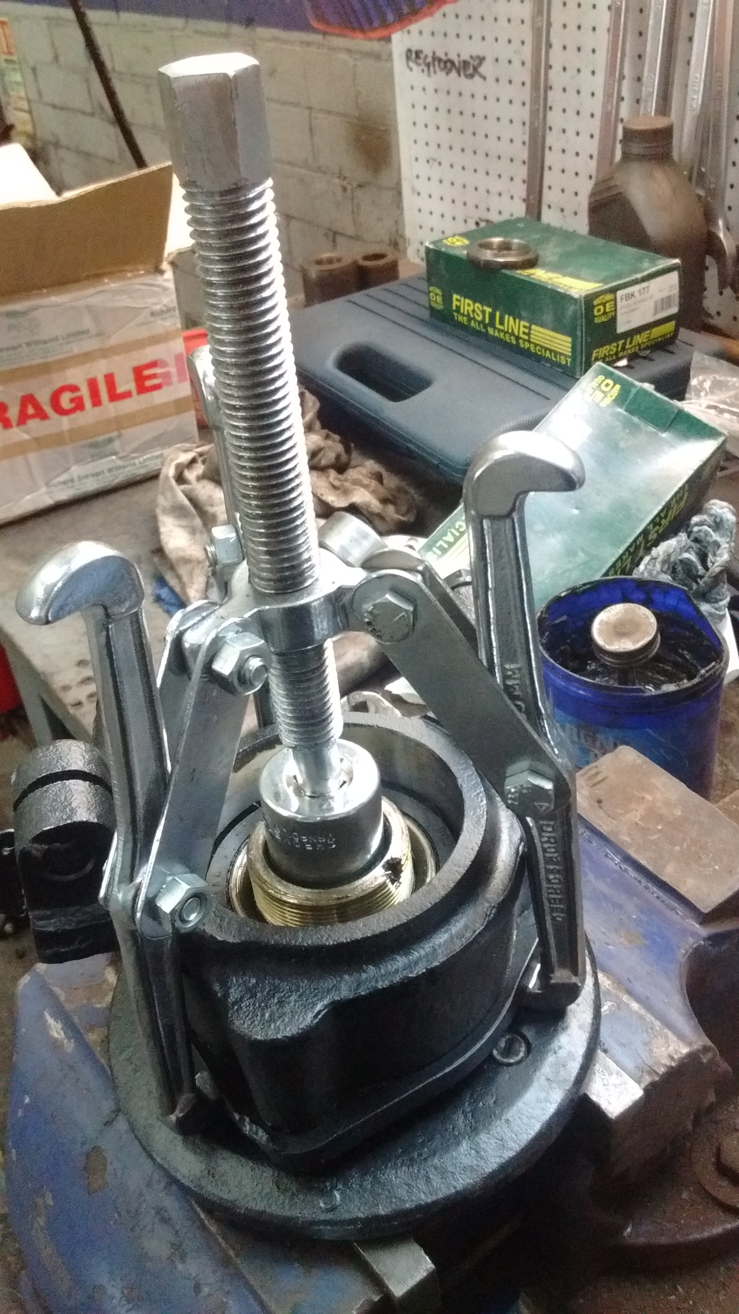

Once you have the nut off you need to draw off the hub from the drive flange, you could use a press to do this but would need some strong and thin flat pieces to hold it in place, probably some thick angle iron sections would do. I used a simple 3 leg puller as it isn't that tight so no need to get too complicated.

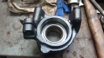

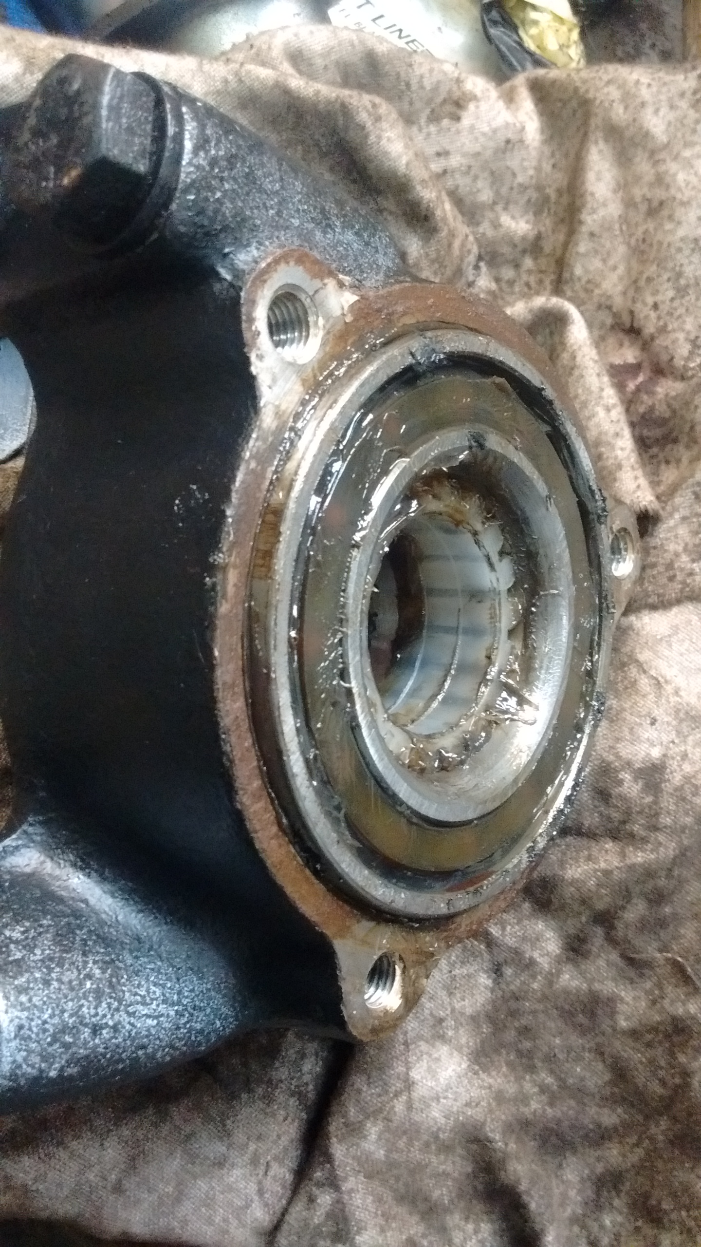

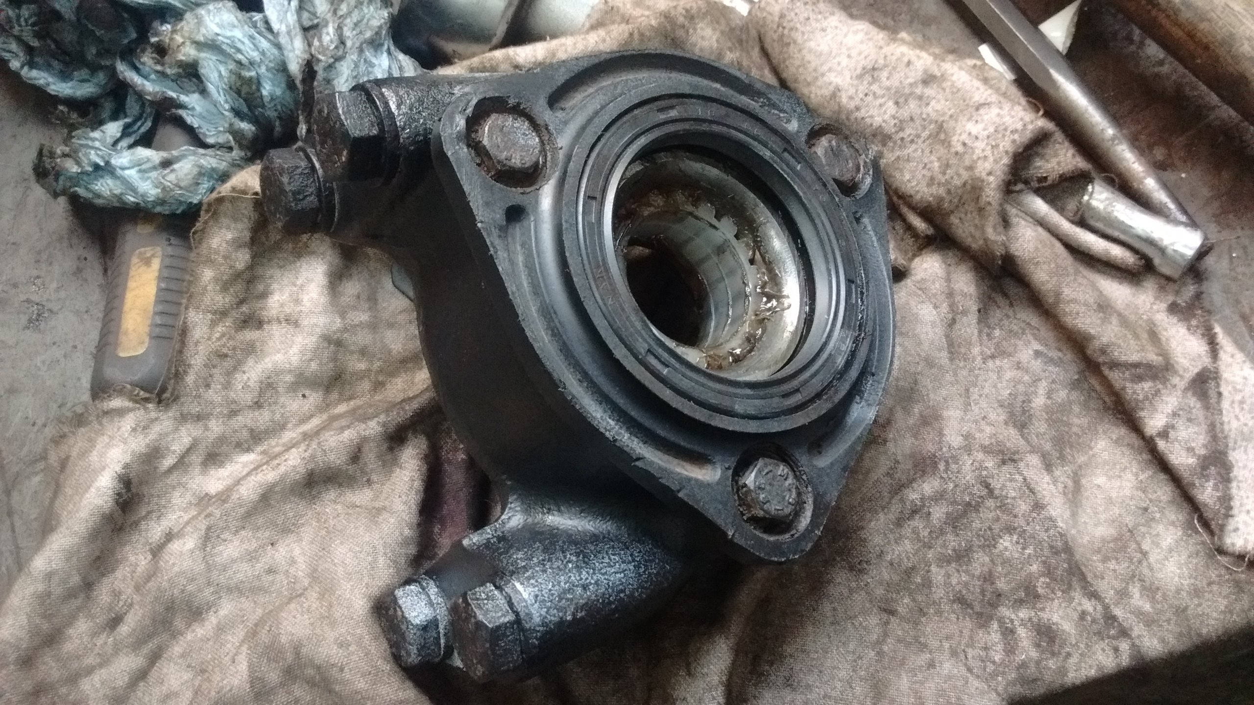

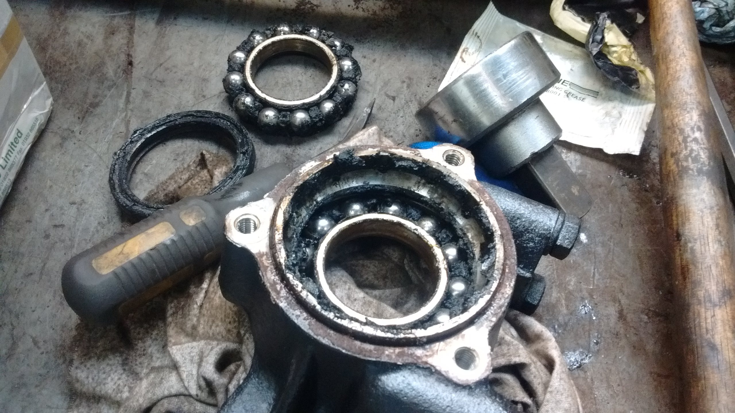

This leaves you with the hub itself containing the bearing.

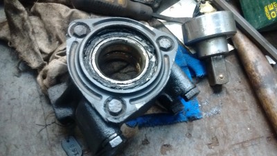

On the front face is the seal retainer, the 3 bolts need to be removed as this is the direction that the old bearing needs to come out from.
Re: Sud front wheel bearings, how to change

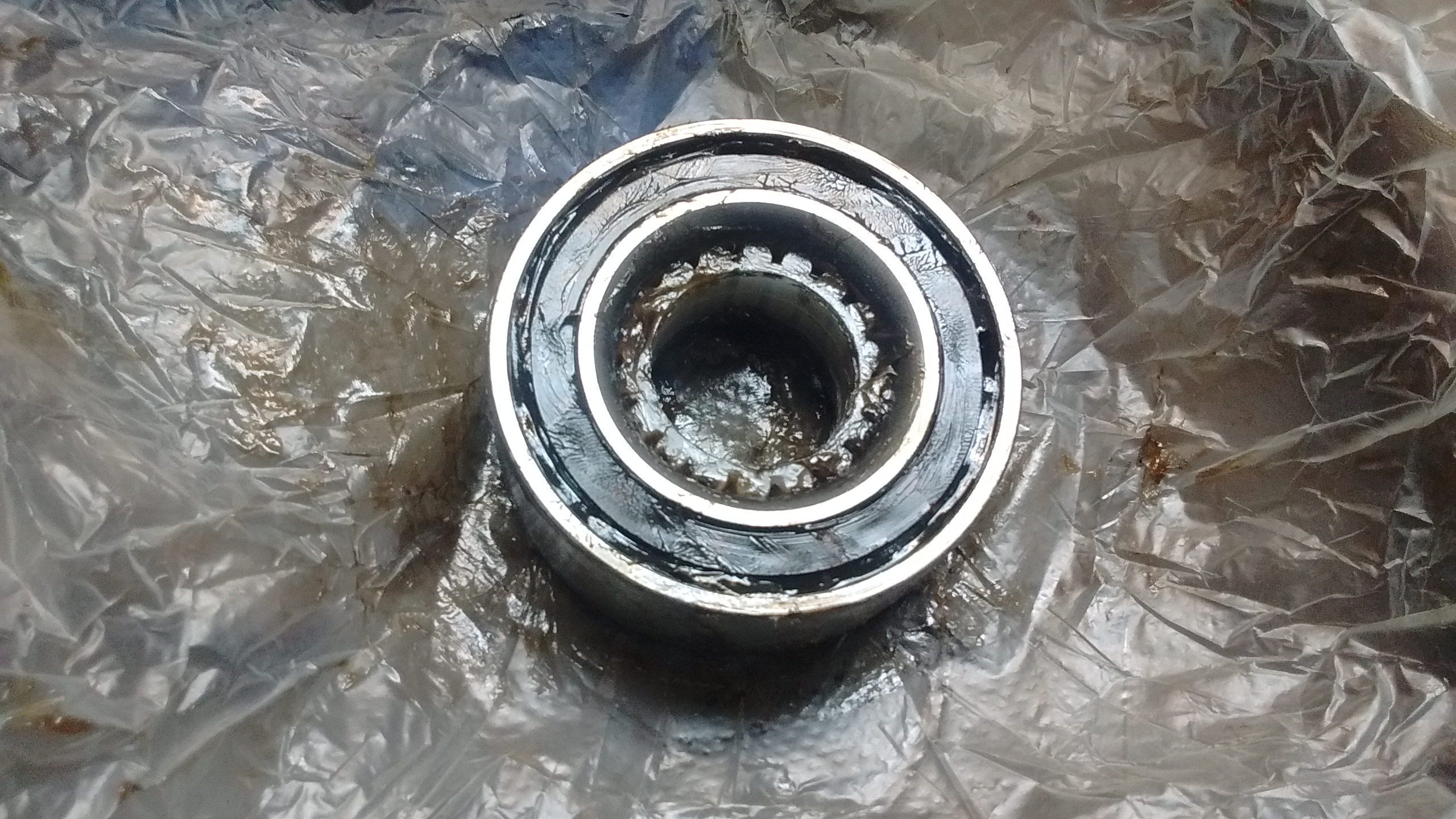

The old bearing with its 30 year old grease is pretty rough, well due a change.

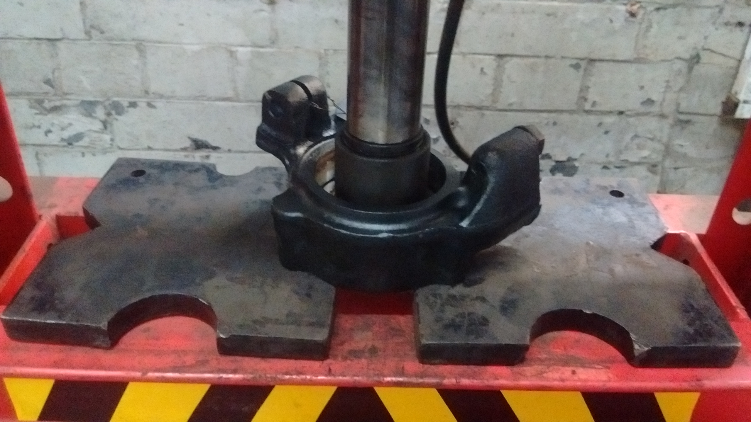

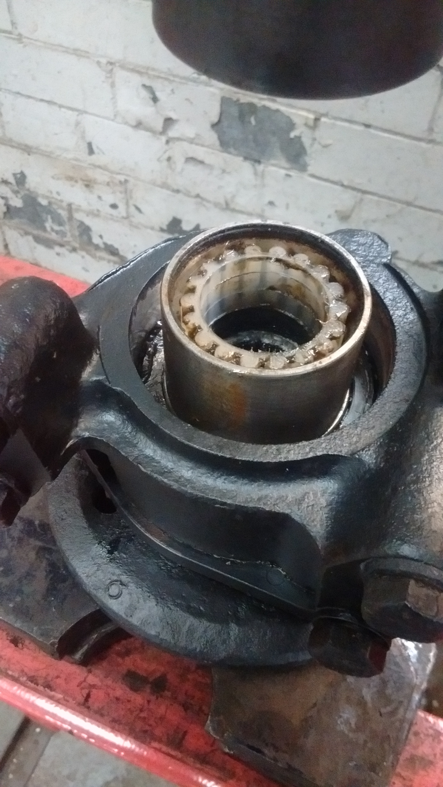

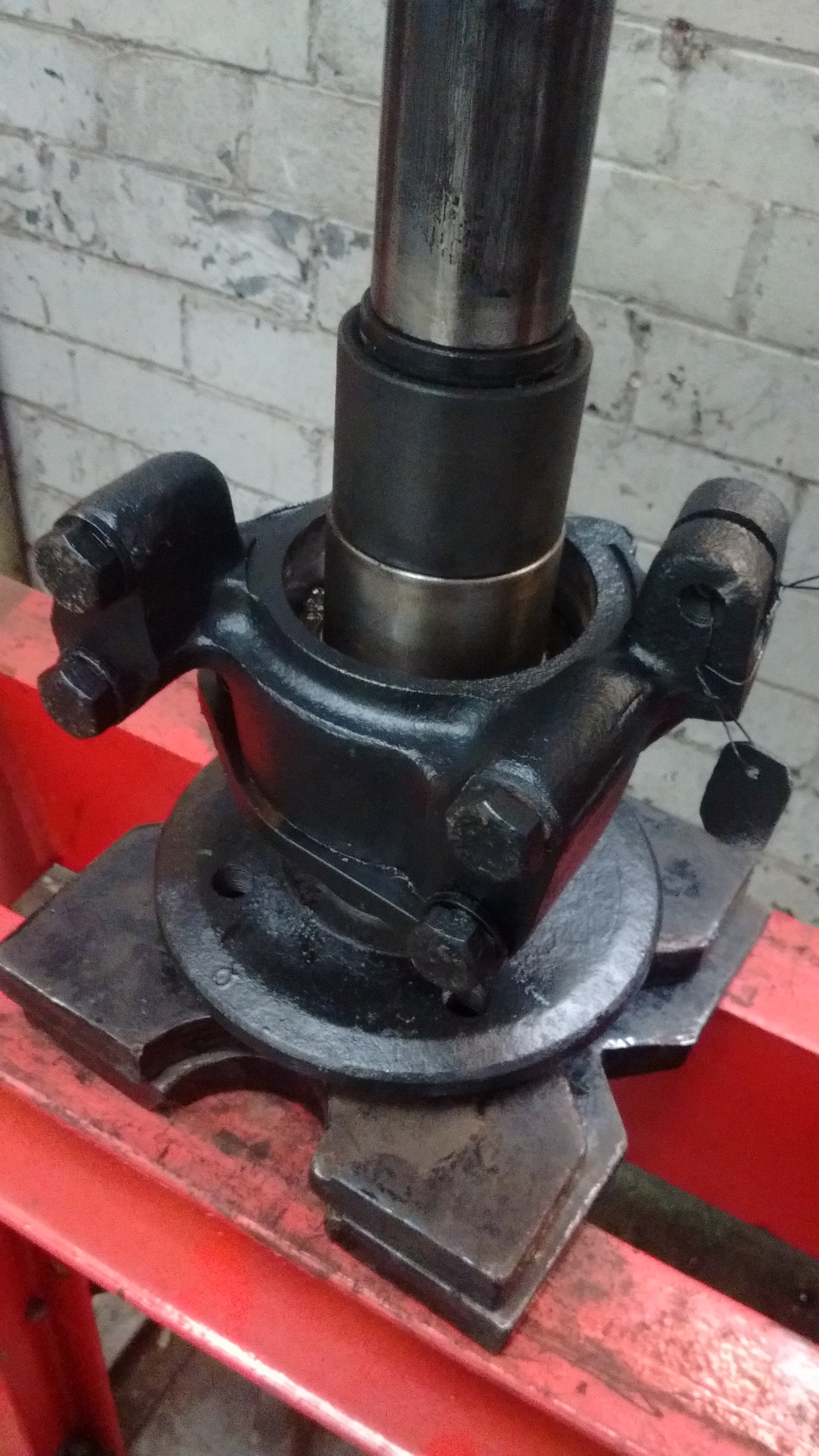

This is the stage where a press is needed. I know folks have done the next stages with a large hammer but it really does need to be done with a degree of control that you can't always get with a 2lb hammer!

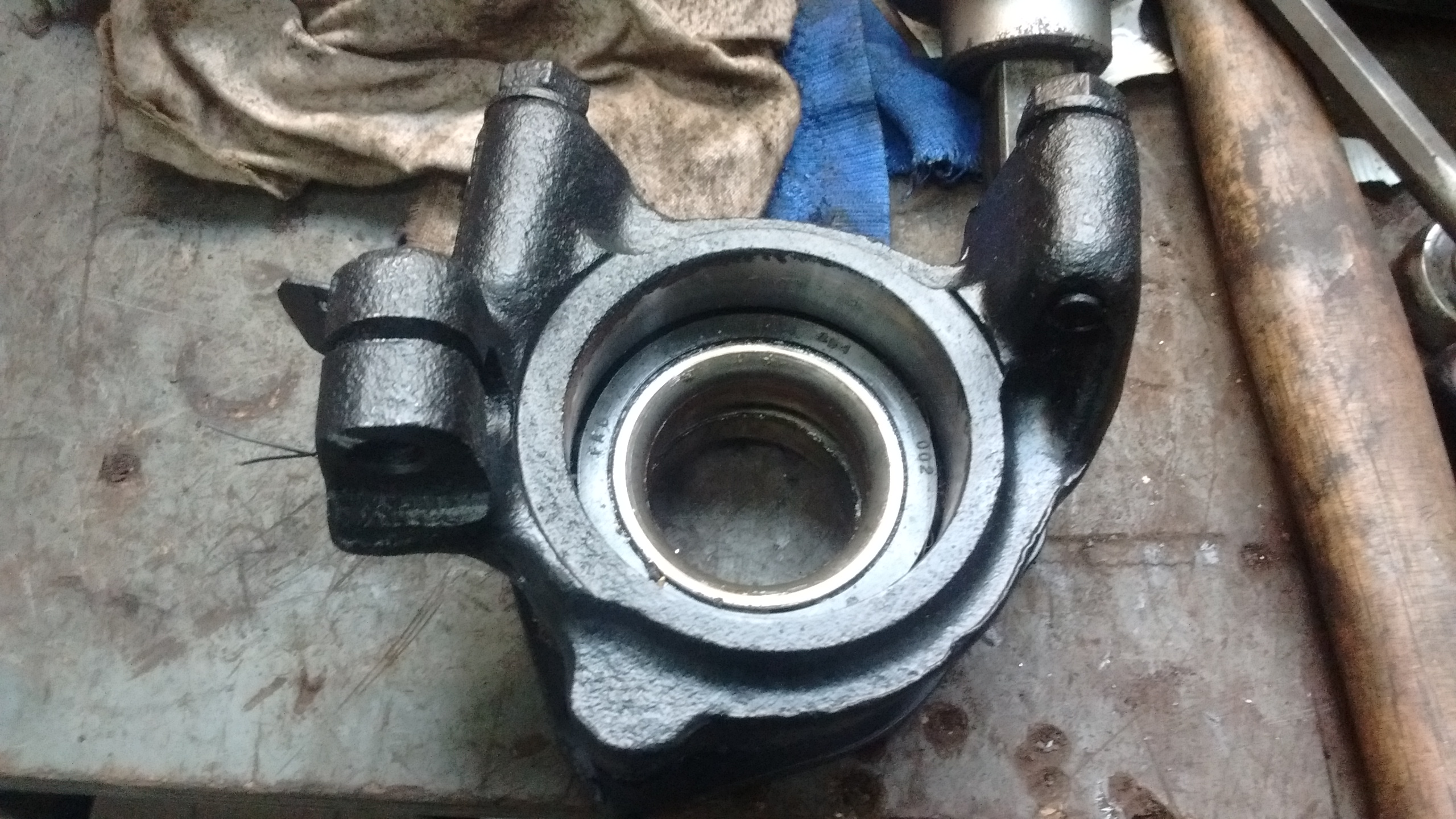

Simply force the old bearing out towards the front of the hub, making sure that it has space to come out. It handily sticks out a few mm so is easy to align plates to get it in position to press safely.

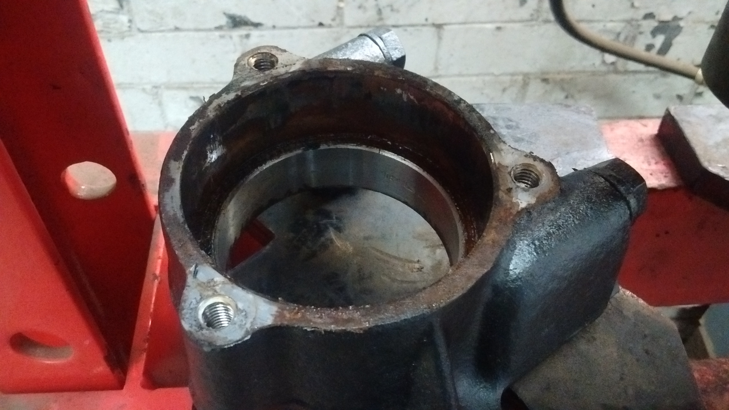

The hub stripped down, note the step in the inner face where the new bearing seats down to, this of course sets exactly where the new bearing will get pressed down to.

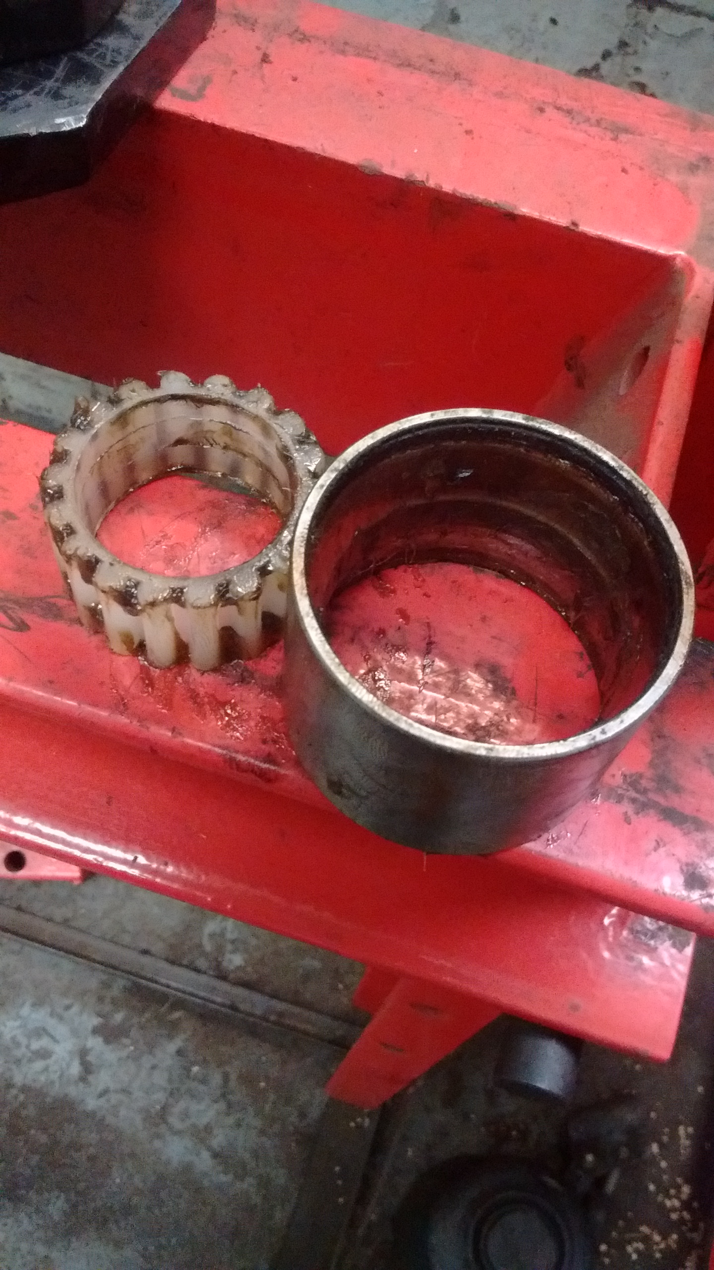

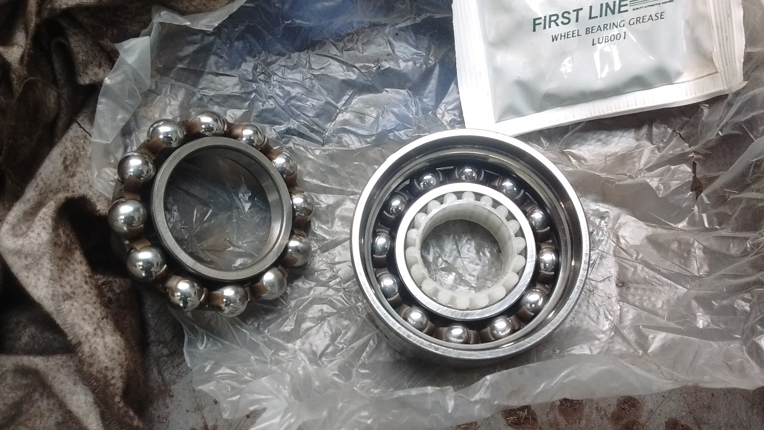

So now the old bearing is removed it's time to prepare the new one. They come nice and clean but that's not the condition it needs to be in, this one needs greasing. Newer bearing designs are fully sealed so are ready to press in..
One half of the outer race is taken out and the grease provided is smeared all over the ball bearings, working the bearing races to make sure the grease gets all over the internals. Messy job but very necessary.
The bearing with both halves greased ready to be pressed into place.
Note the little plastic sleeve in the centre which handily grips both inner halves and helps greatly to keep them in place, don't just throw this piece away!

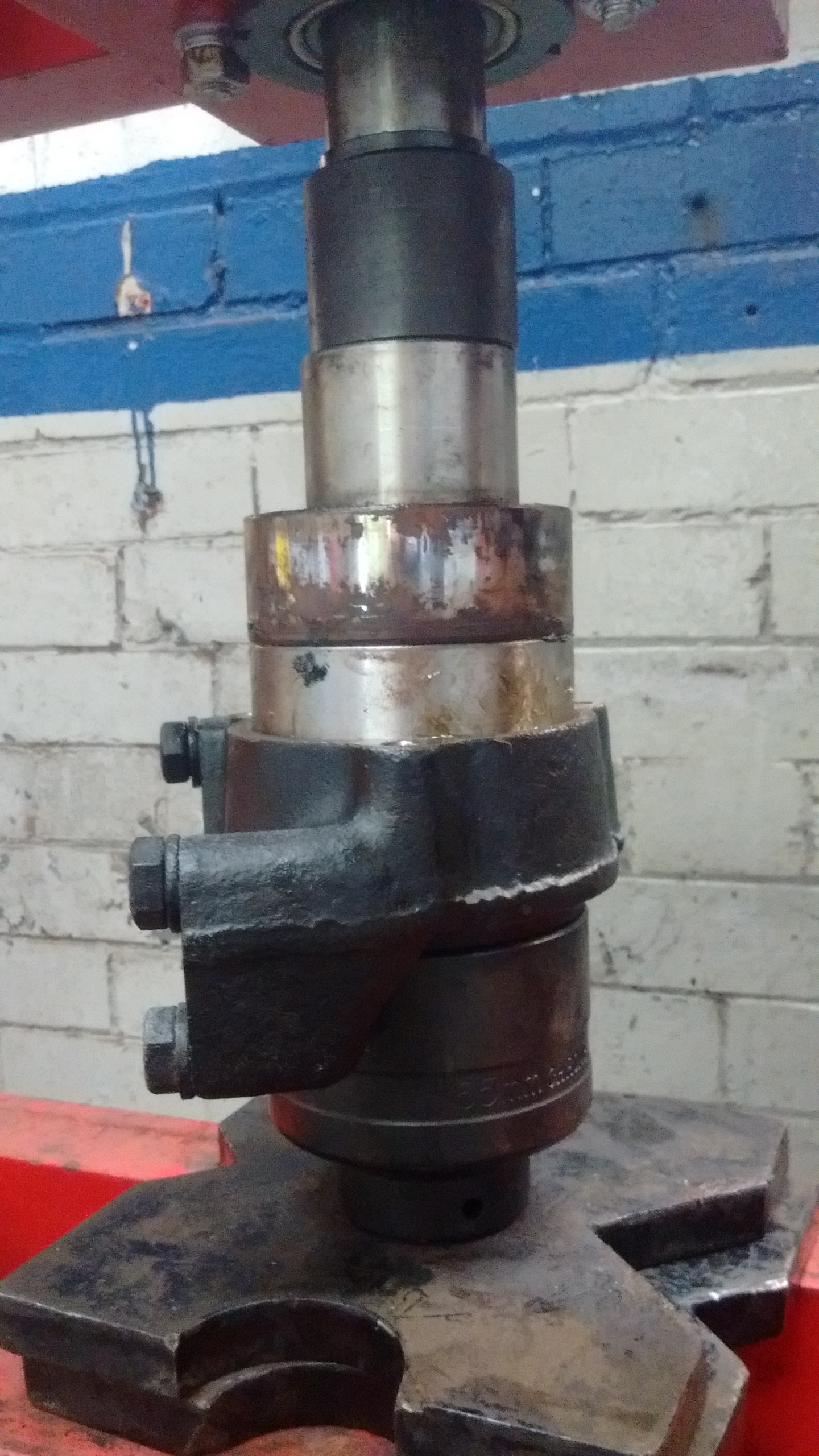

Time for the press again.

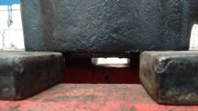

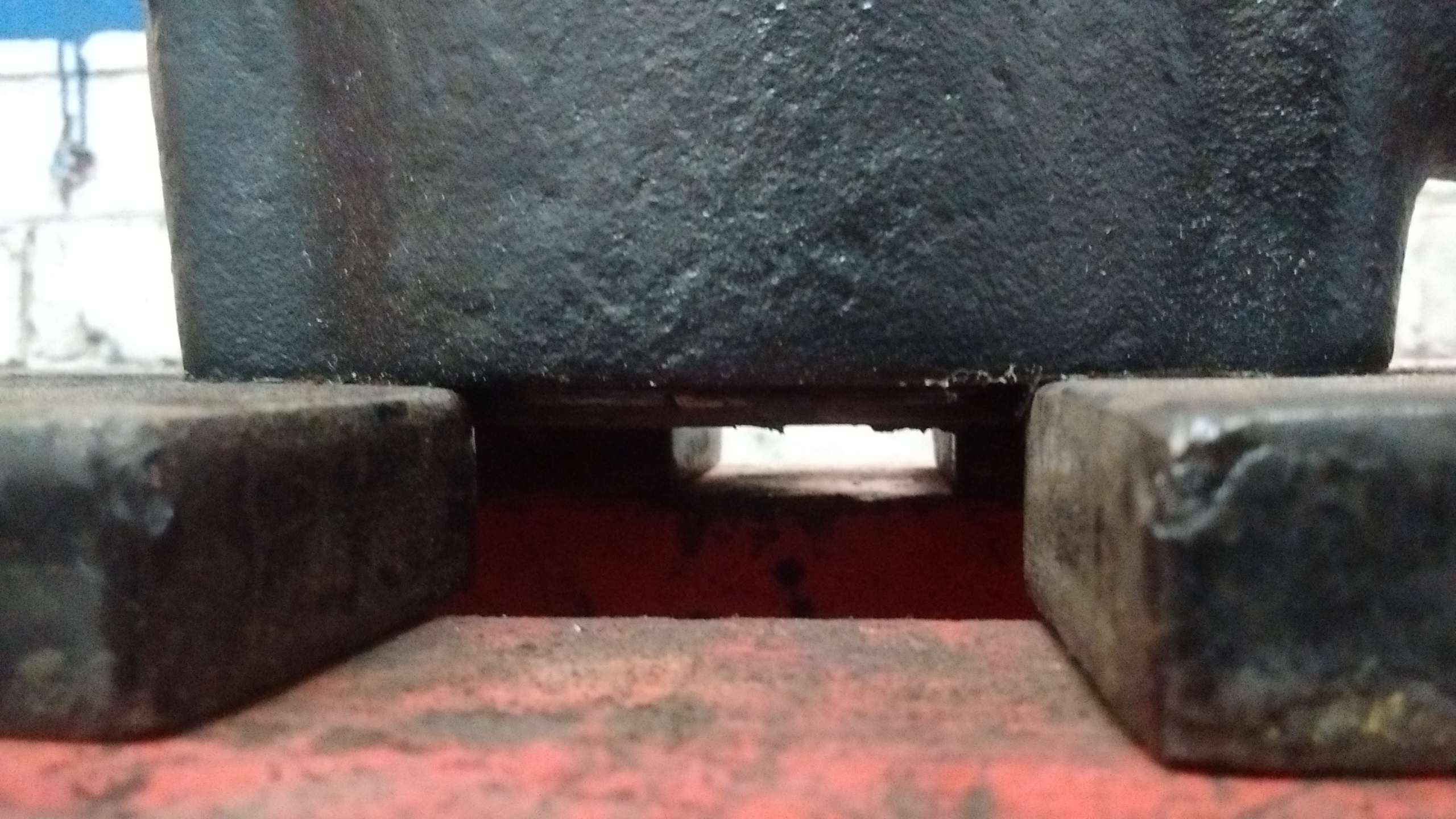

Things to note here is the large socket that is placed under the hub. It is vital when pressing things like this that everything is square on to the ram. With the suspension mounting points etc you can't just simply lay the hub down flat, this is where a bit of lateral thinking comes in with trying to level things up but being firm enough to support everything through the pressing process. Sockets or old bearing cases make great supports, this one is actually a 65mm socket that we use for Ford Transit bearing...handily the perfect size!

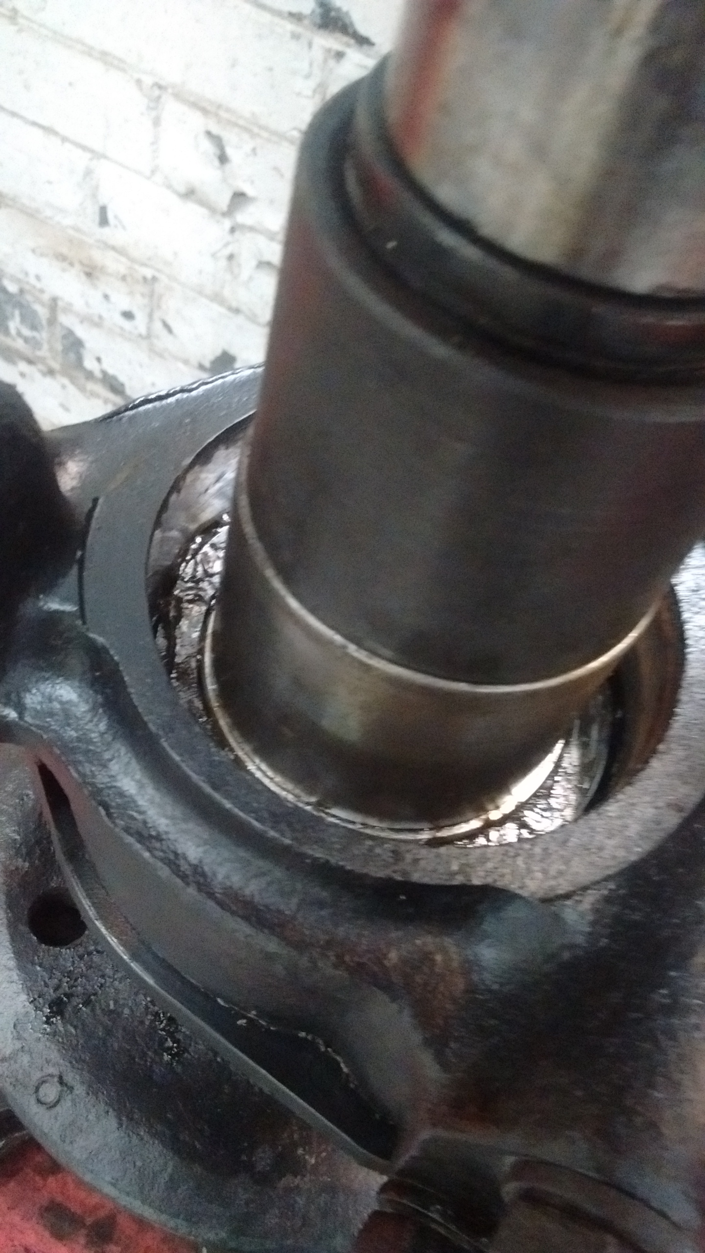

You will also notice that I am using the old bearing to press against the new bearing. This allows me more freedom over where the ram forces things down as I can't then damage the new bearing. Of course using the old bearing ensures a really accurate face to face so the chances of it slipping are minimal.
The new bearing in place. Again note the plastic sleeve still in place on the inner races, to stop it falling apart! Plus it sticking proud of the hub face, as per the original one.

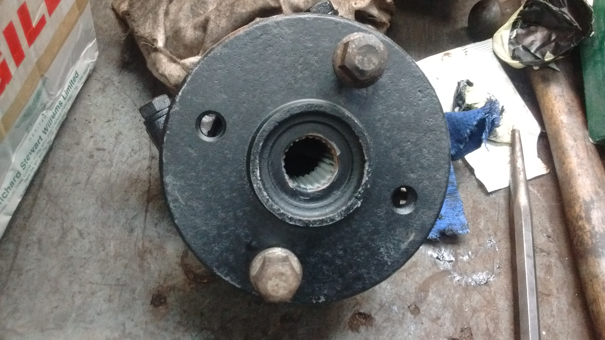

Time now to press the drive flange back in. This stage could be done with a hammer and drift but a bit more control is gained from using a press.
Important thing to note here is that I'm pressing this time against the inner race as it's this that you are trying to re-locate against the drive flange. If you pressed against the outer wall of the bearing case the danger is the bearing pulls itself apart. Vital that you control where and when you press against the inner and outer sections.
I used an old bearing section to press against the new one as it allows the plastic connector to come up inside it during the process.
You should then end up with this..

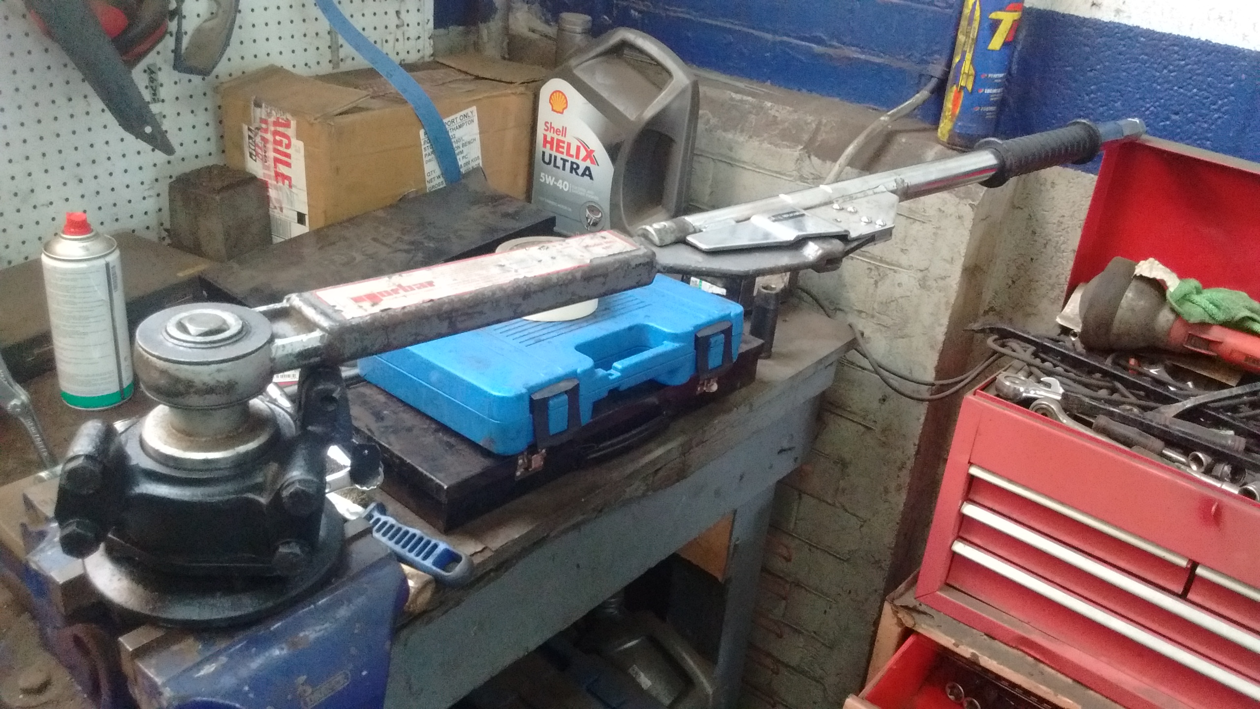

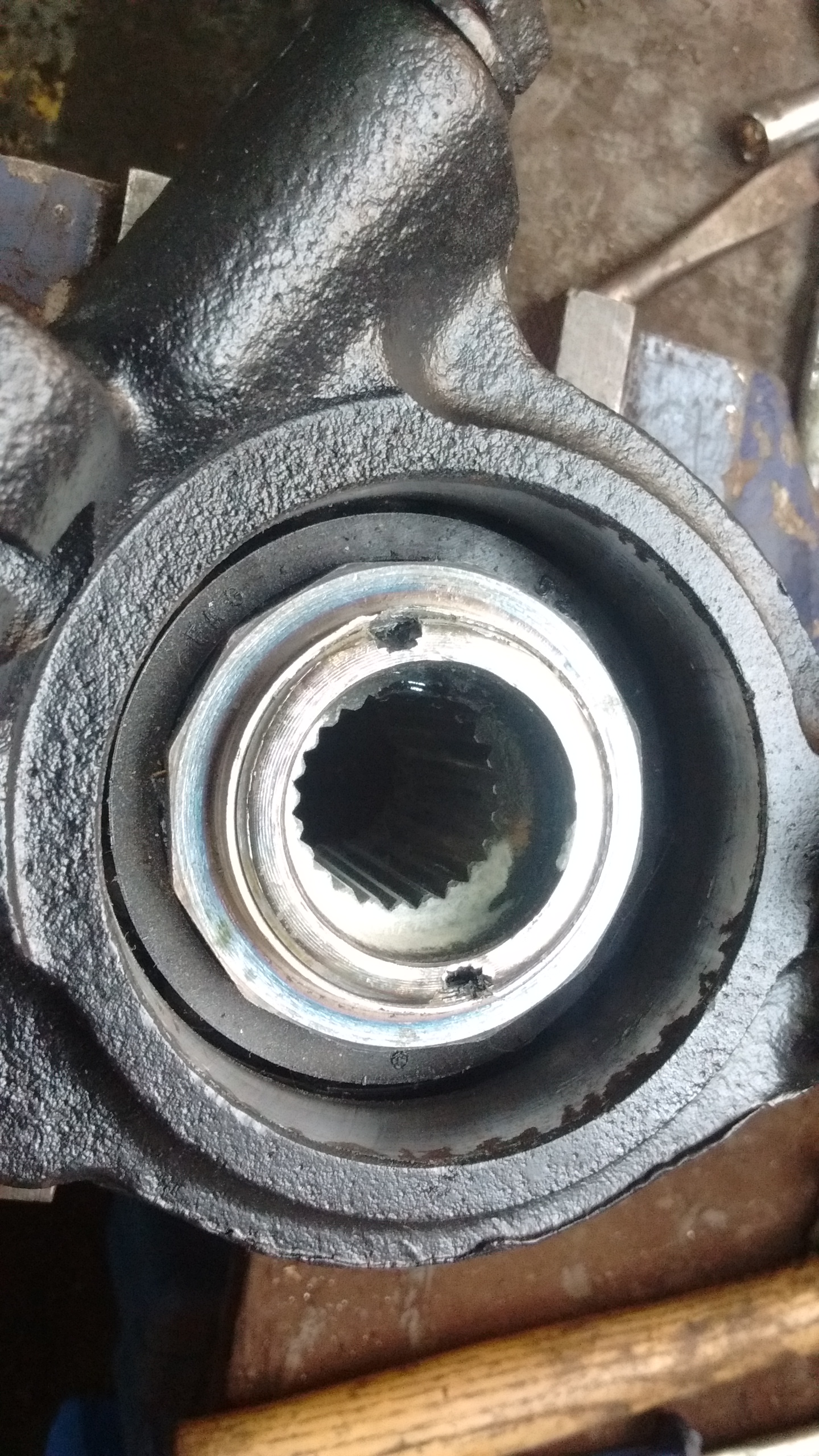

Last job then is to tighten the nut...helps that I have access to some proper torque wrenches, usually used to tighten lorry wheel nuts!
With the nut tight simply peen over the lack tab section into the notches of the drive flange and you're done

You didn't stat the torque with which you assembled the nut. That's an important item. This nut has fine pitch thread and should be assembled with a pretty high torque (can't remember the value at the moment though).

I found gripping the flange to undo the nut quite difficult so i got a thick piece of metal , drilled a hole for the centre and holes for the wheelnuts. The metal was oblong so i put the holes at one end leavinga "tail" to grip in the vice.
I think hub nut should be tightened to:
209 - 260 lb/ft
284 - 353 Nm
29 - 35 KgM

Thanks also to the omission of the torque settings, and Ade for posting them. They are as per the Alfa workshop manual so yes mate, you are correct.

So as the torque setting is a range where should it be set?
