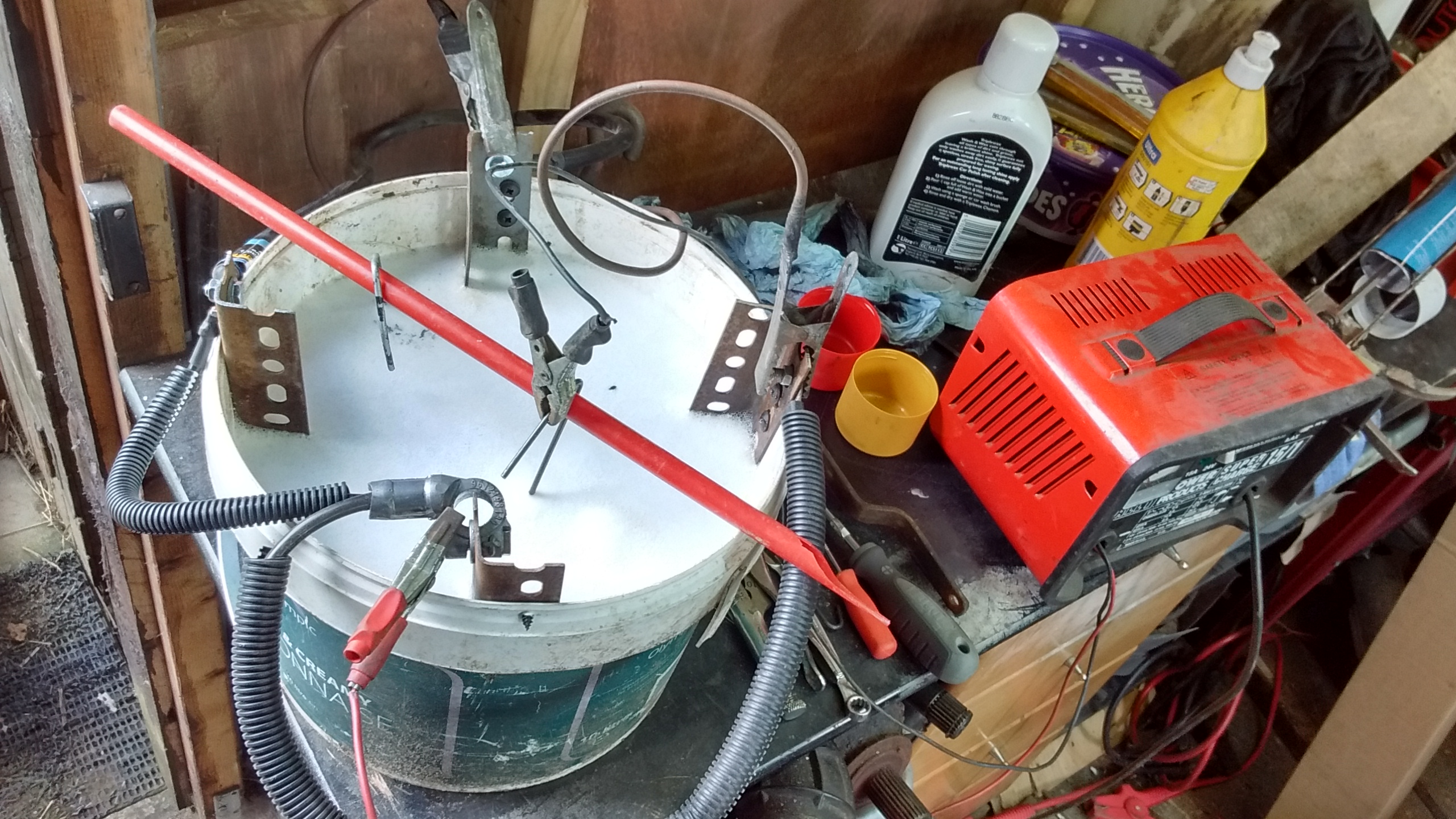

First task was to gather all the components...some variations on what the 'net describes to use but I couldn't see why it wouldn't work...

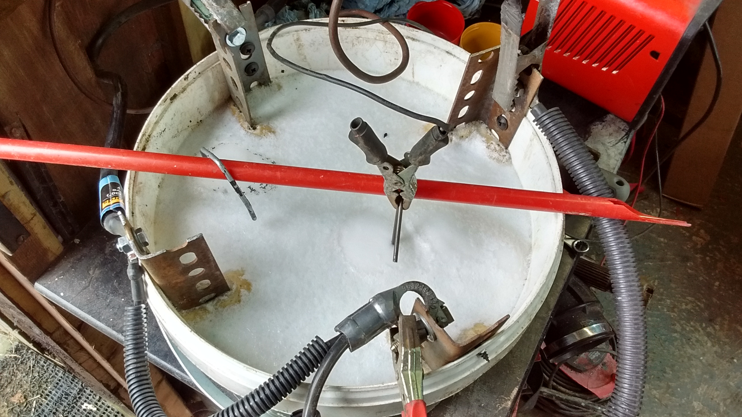

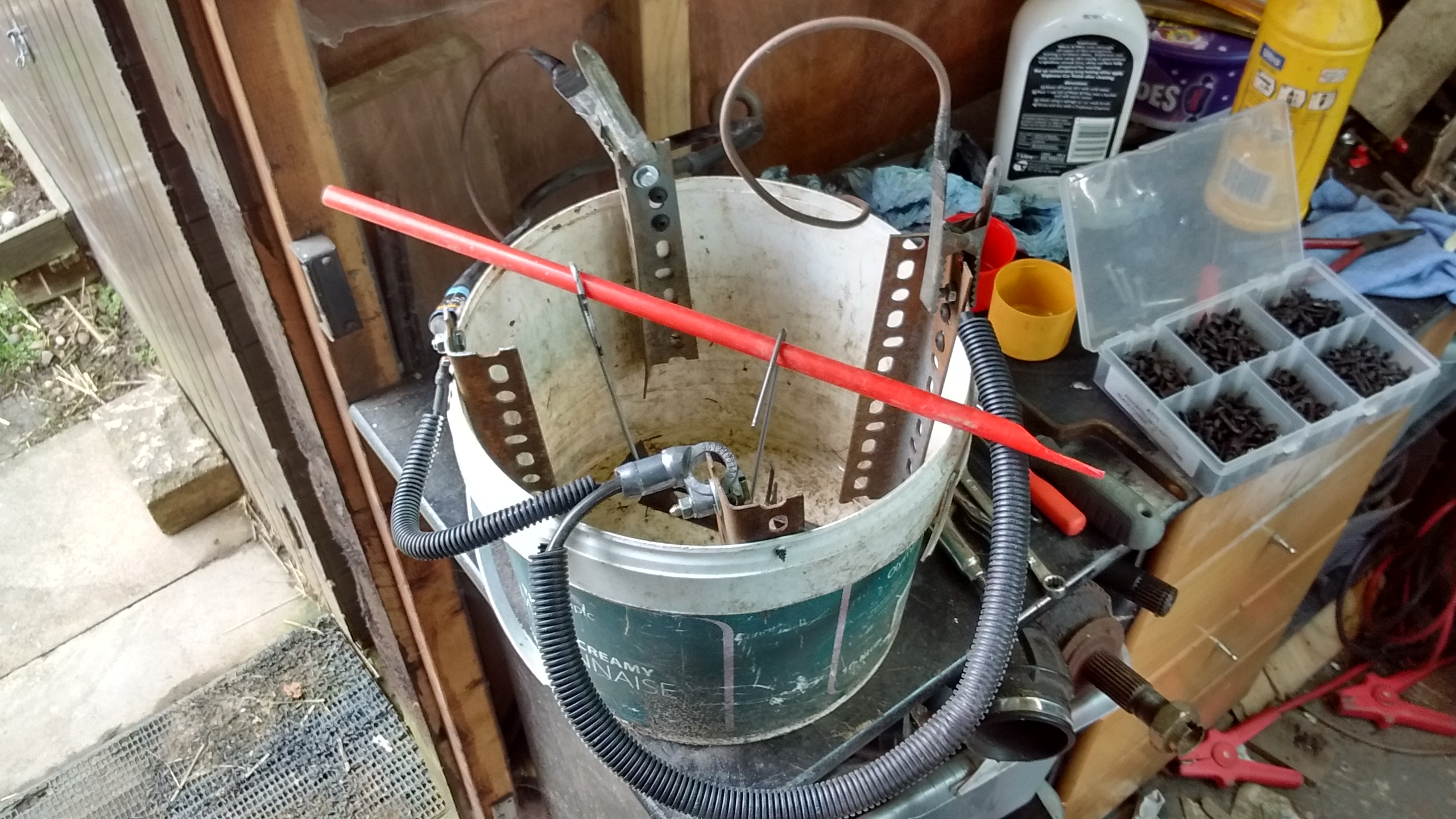

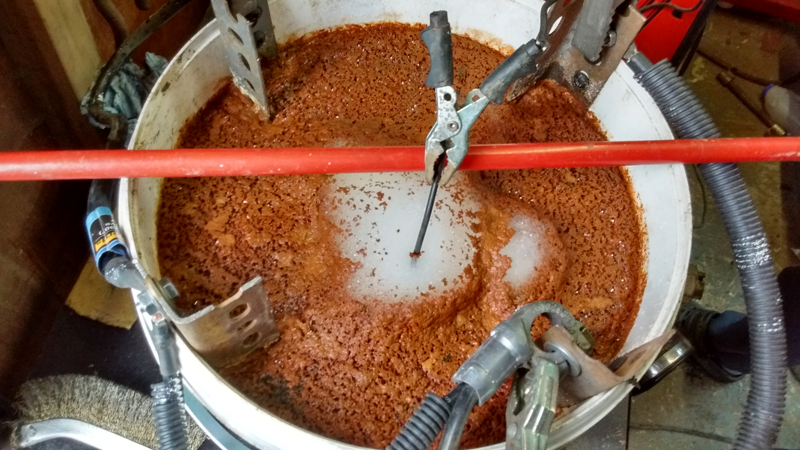

Instead of thick bars I found some old angle sections that I screwed to the inside of a plastic bucket, a non-metal container is vital as will become clear later...
You may have noticed that the metal bars leading down into the bucket are all attached to each other, I used heavy duty battery type cables but not sure if they needed to be so heavy duty.
The bucket is then filled with plain water but the advice is to use washing soda crystals, washing powder seemed about the same to Rob and me so a scoop of Daz was stirred into the mix.
The piece you want to remove the rust from then needs to be hung into the mixture but not touch the metal bars that are screwed to the sides.
You then attach the positive lead from your battery charger to the metal brackets and the negative to the piece via a metal hanger all suspended in the solution without touching the other metal parts, a plastic or wooden cross-bar is perfect

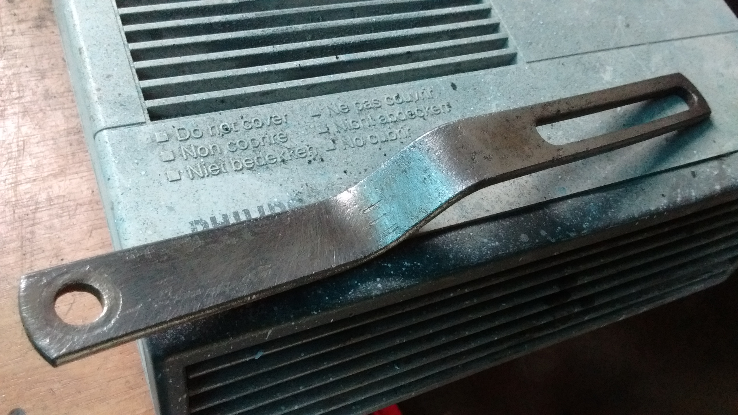

First thing we tried was a bracket of some sort off the Imp, quite rusted but could have been cleaned with a wire wheel or brush.
Difficult to see but once the process starts you see the bubbles rising from the work piece, best to do it in a ventilated place as the bubbles are apparently Hydrogen?
After about half an hour we couldn't wait any longer to see if it was doing anything....on first pulling the piece out we were really disappointed to see it looked not that much better than when it went in, until I remembered you had to wash the remnants off. A quick rinse with a wire brush and the results were great to see.

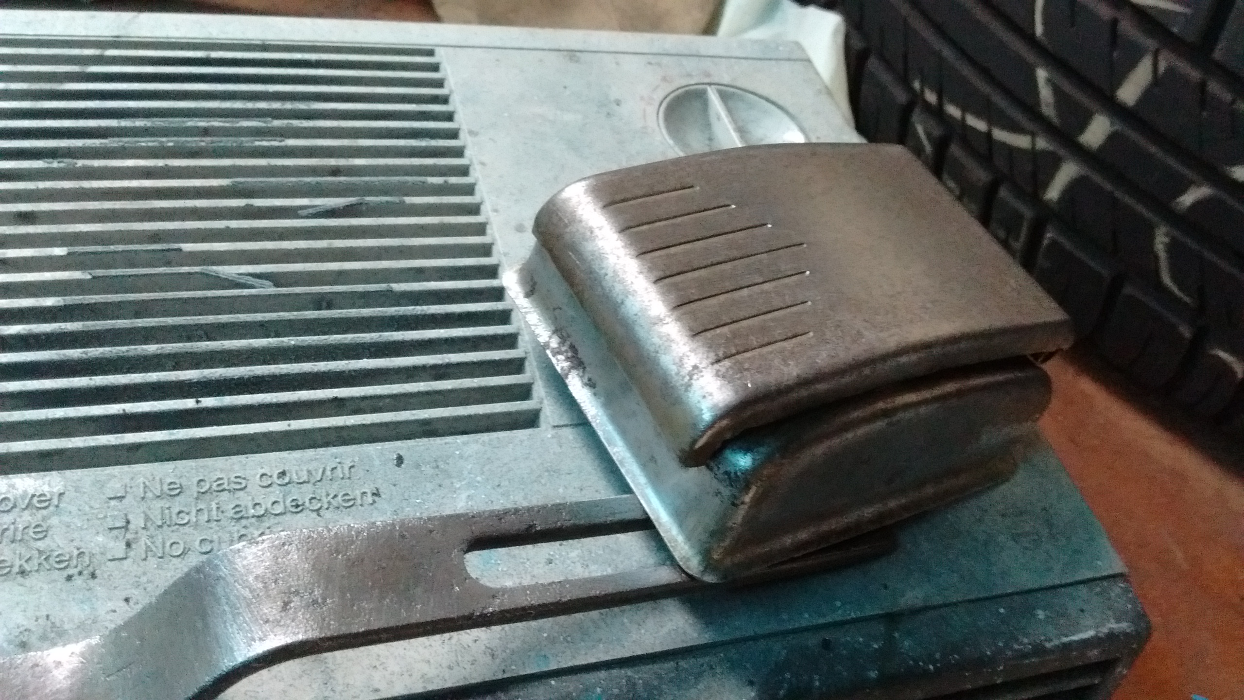

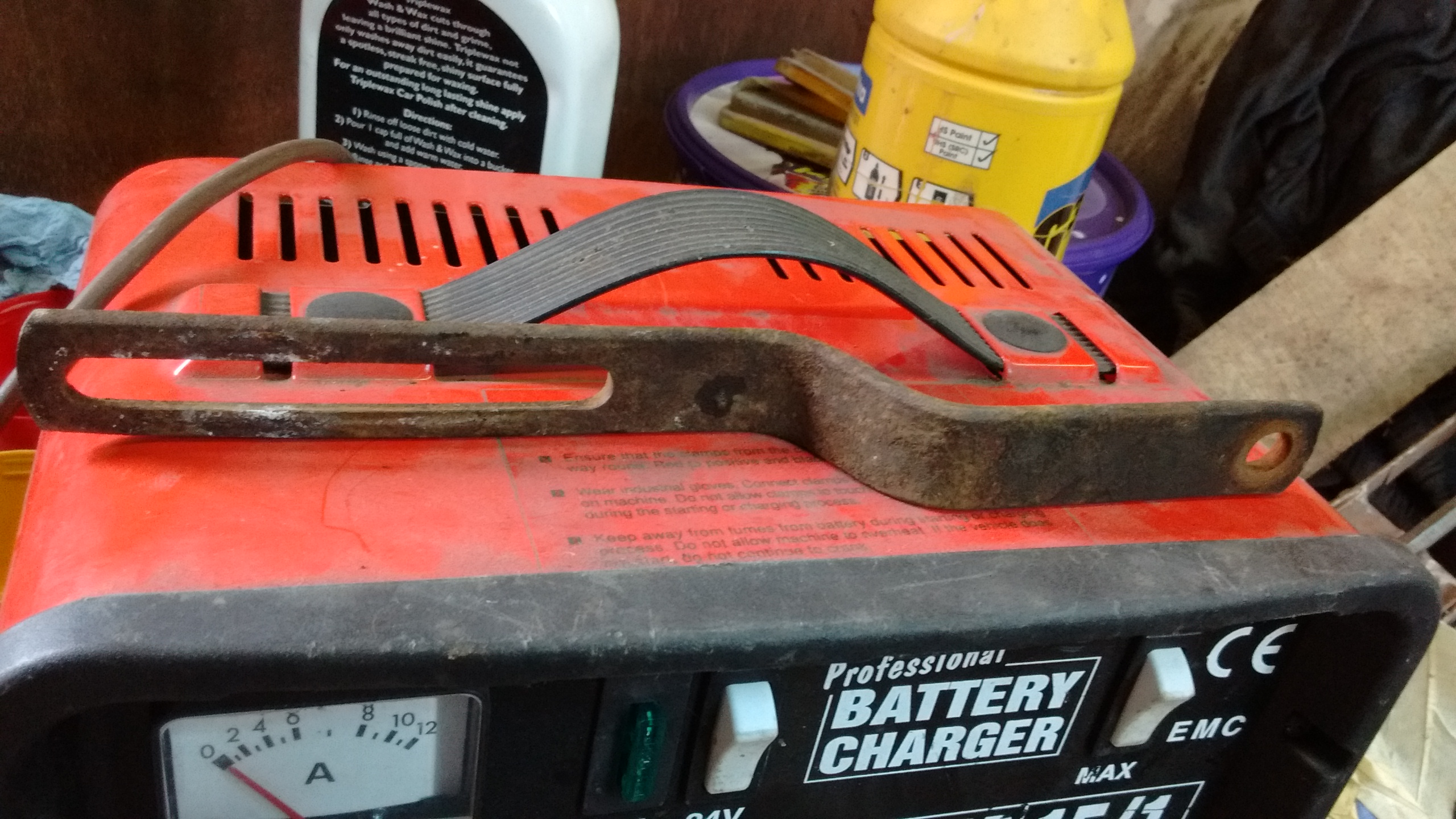

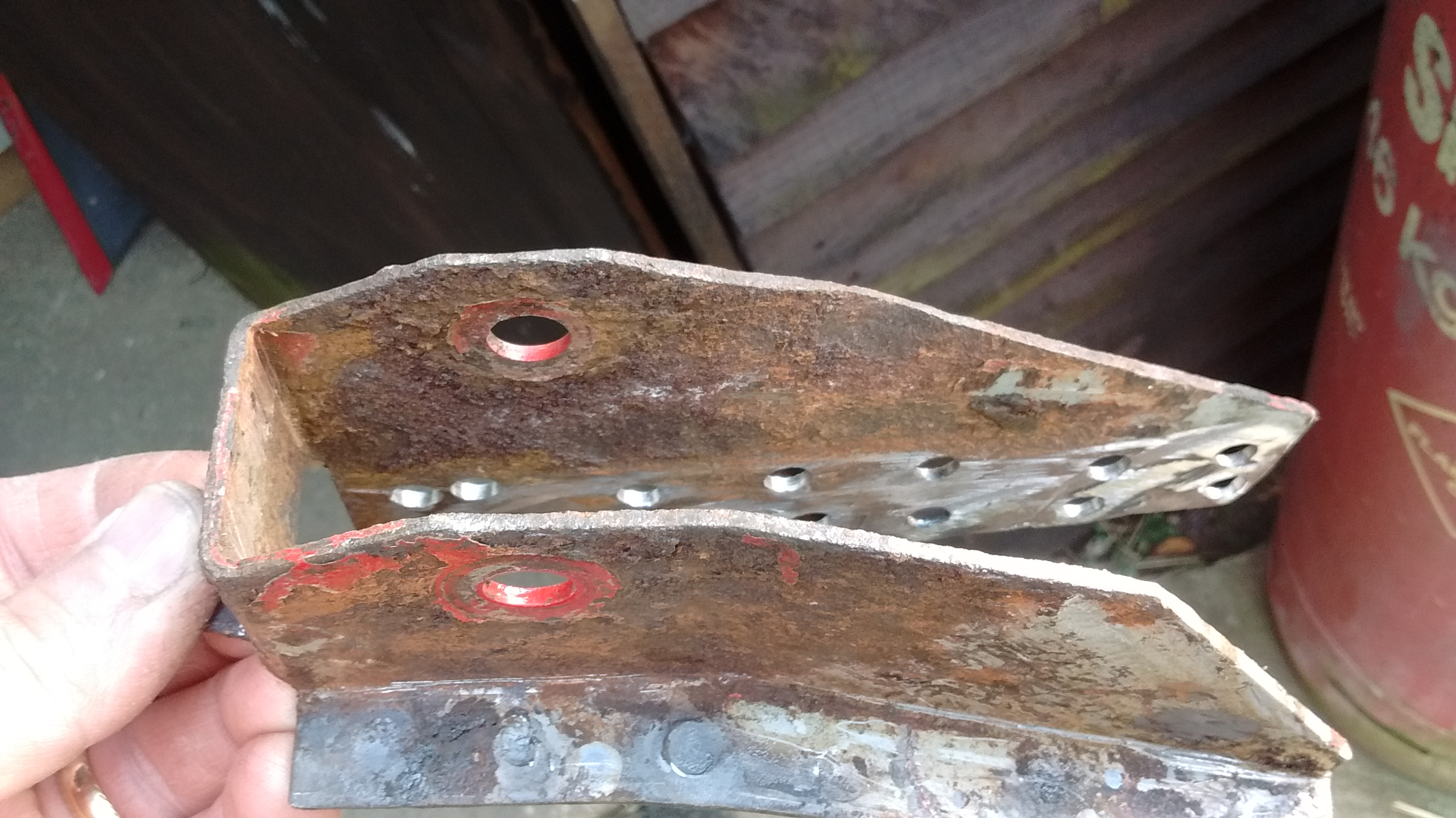

Would it work on this bracket?
Lovely job

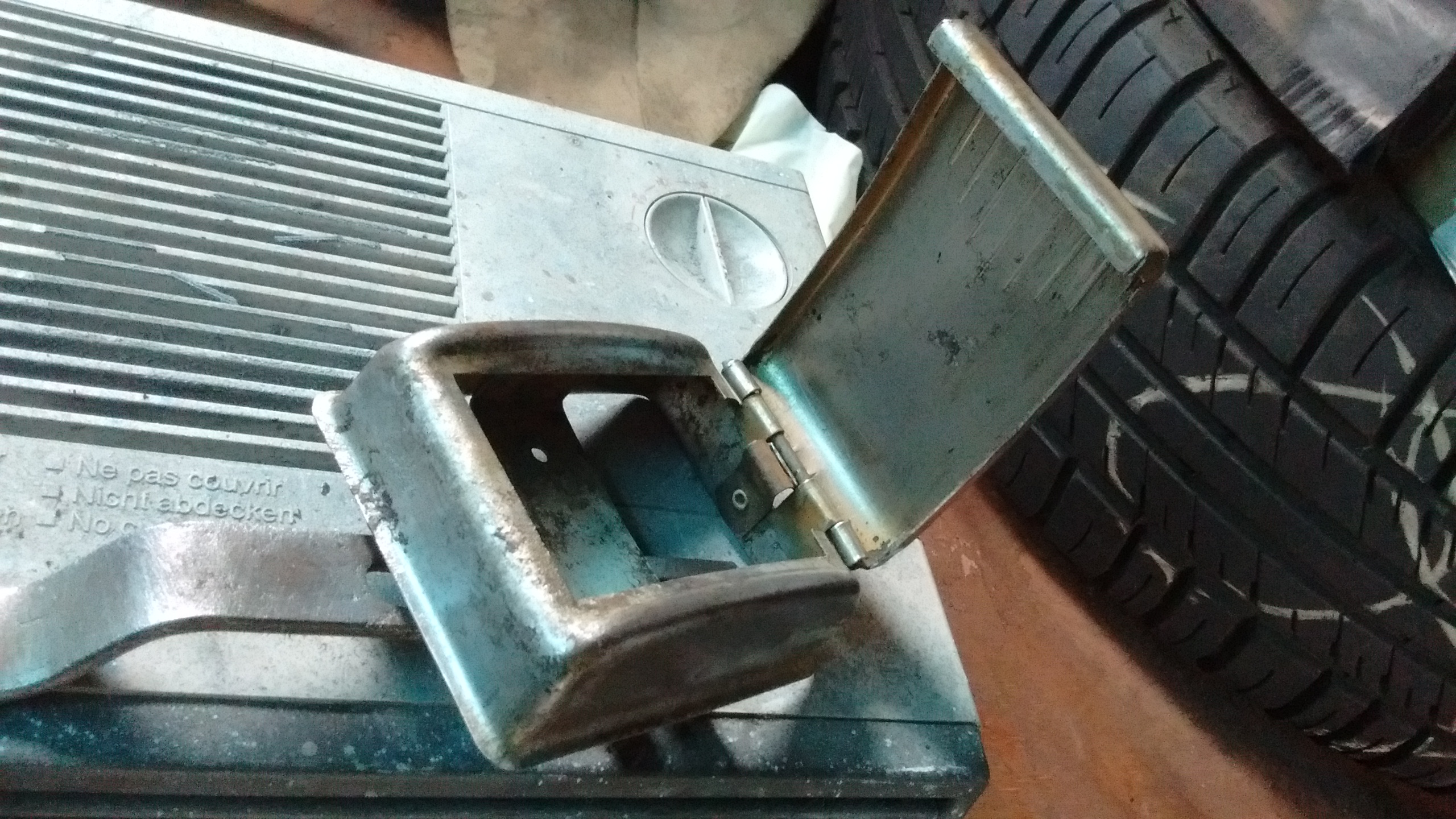

Did a few more parts, ash tray was well rusted but came up great

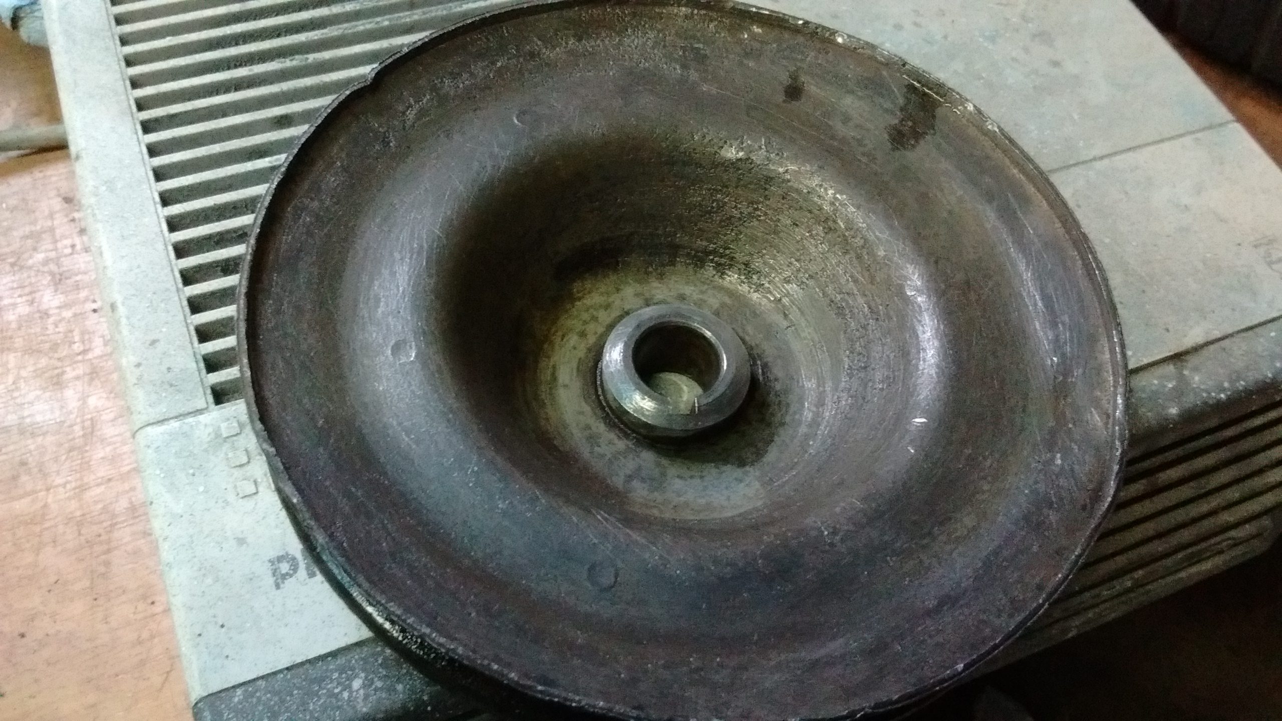

Water pump pulley

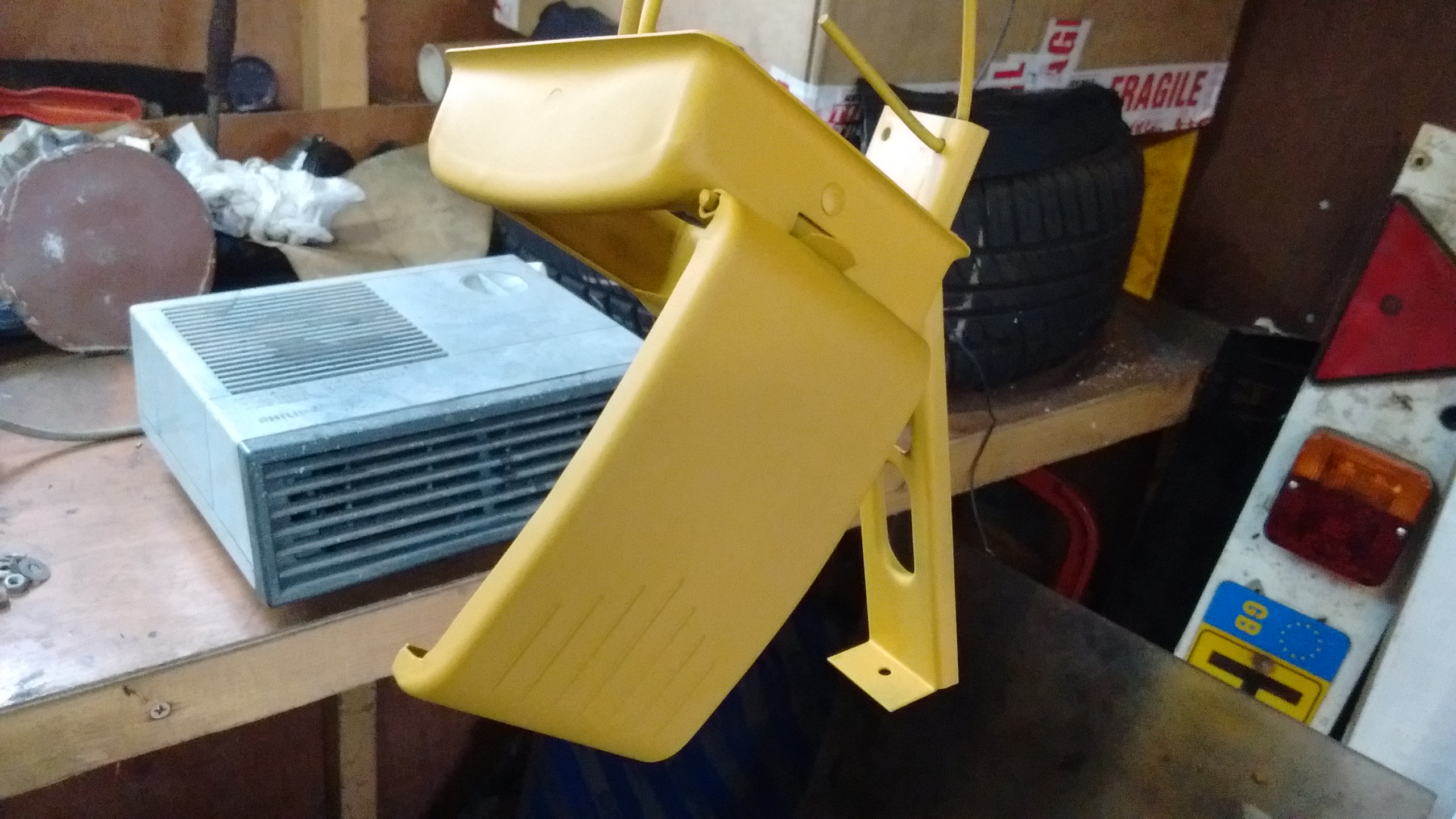

Everything is then cleaned down, dried off and given a coat of primer to prevent rust forming again, which it can do on bare steel surprisingly quickly
You do end up with pretty scummy deposits on the top surface though, it starts off congregating around the metal poles where the positive lead is attached too, but it gets that much so it's just all over the top surface

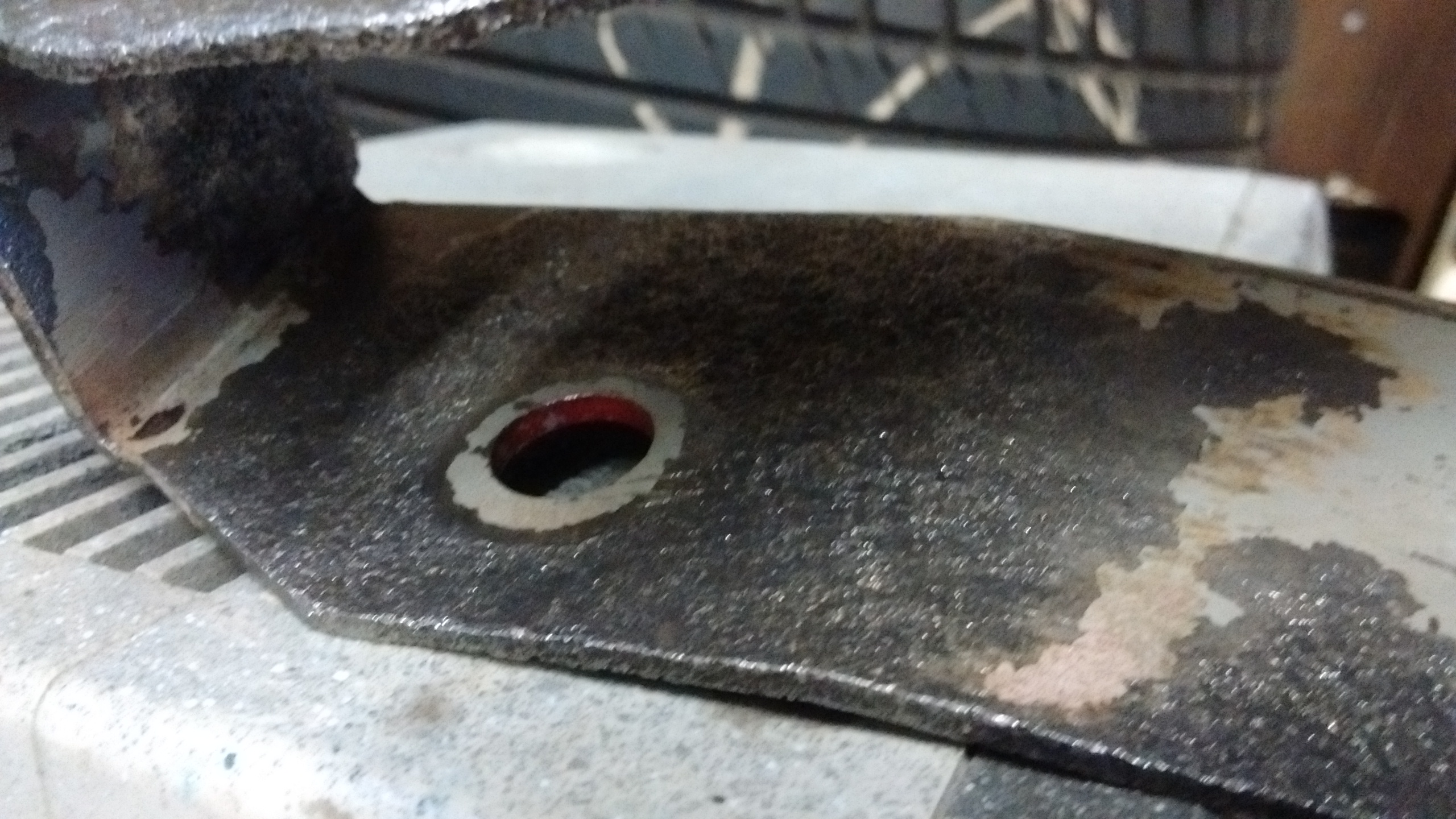

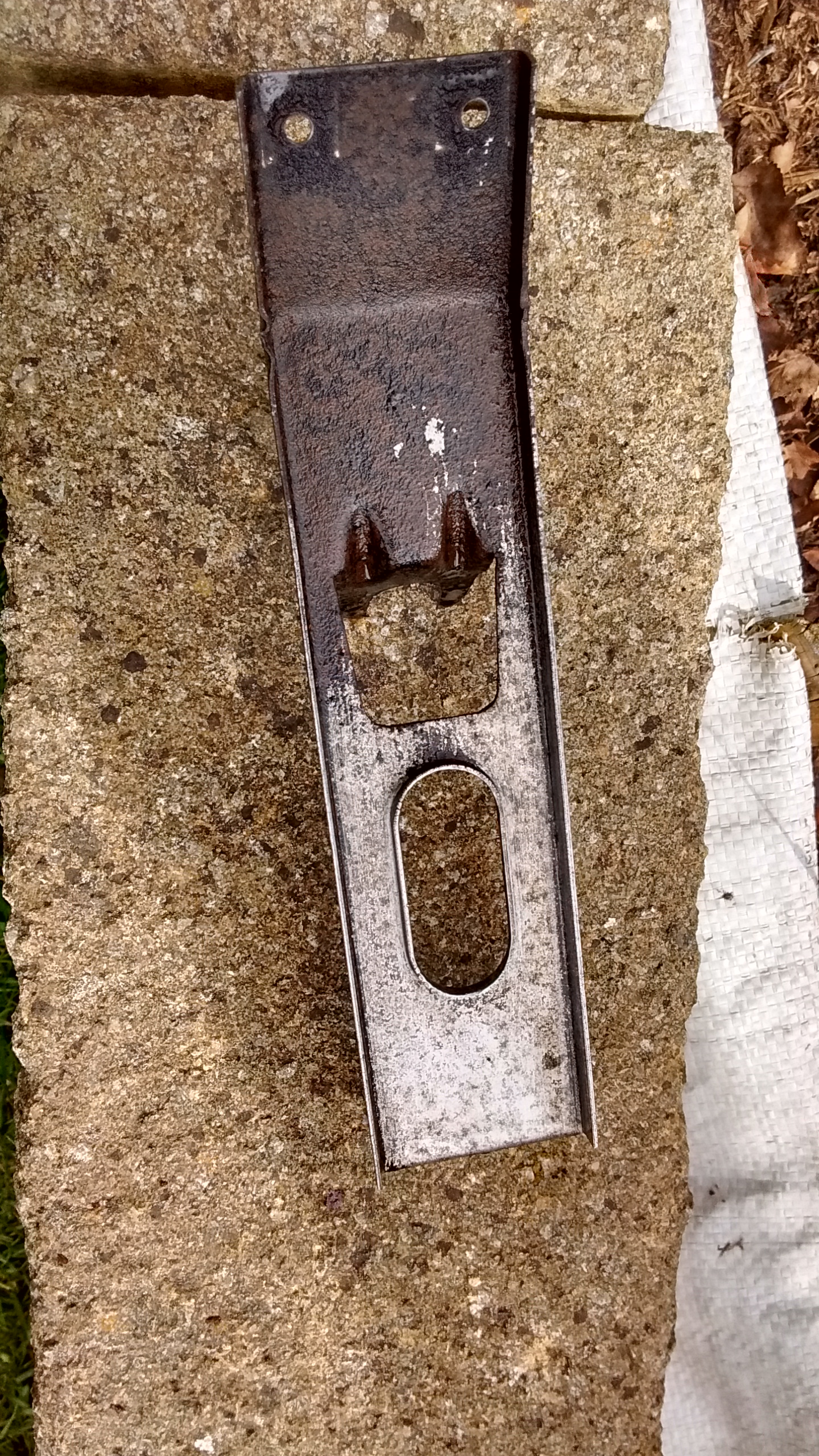

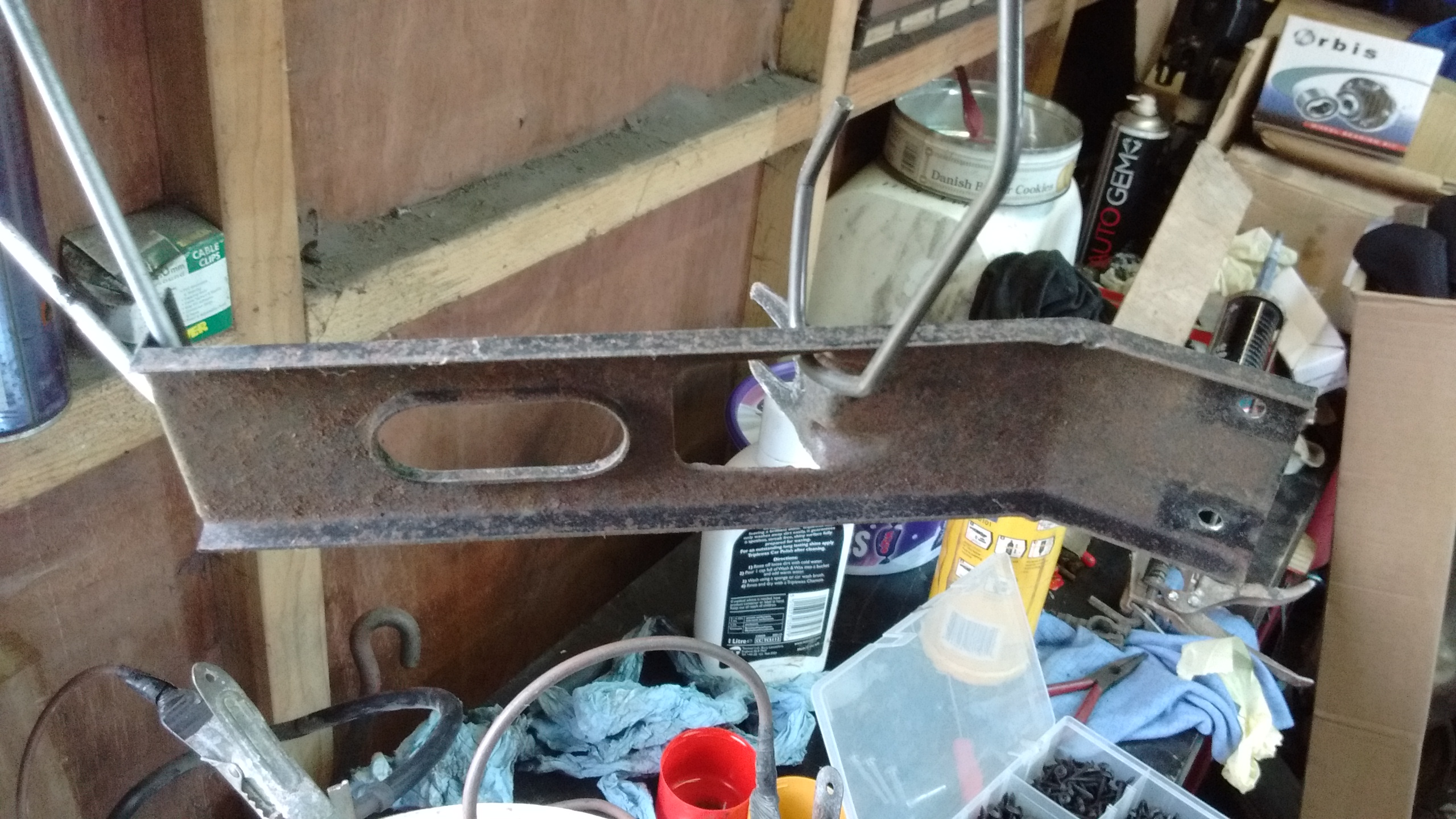

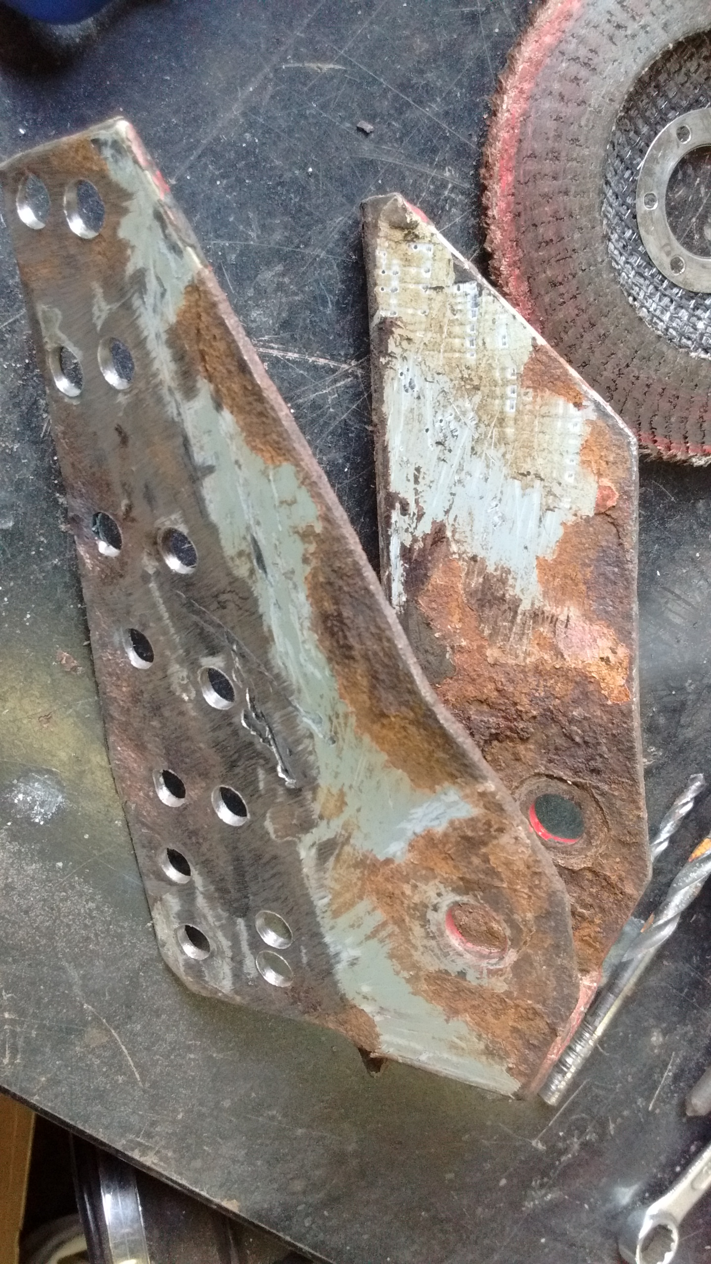

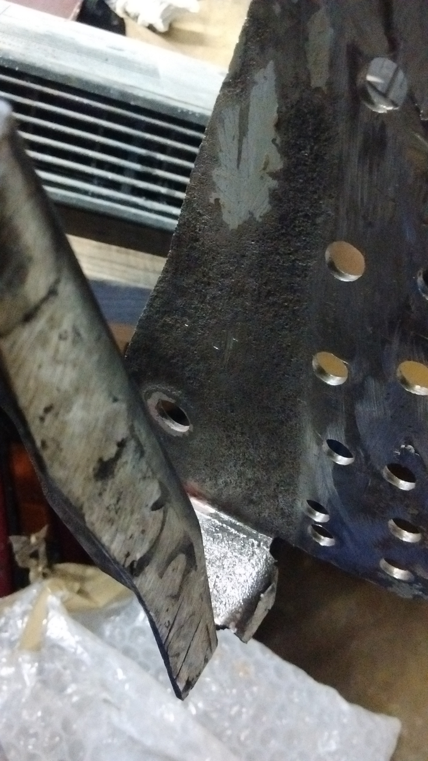

took this rear suspension bracket off the integrale yesterday, was welded to the chassis which had also rotted through so it all got chopped out.
when I did the other side it took me an age to clean off the thick rust on the inner faces..
got some washing soda crystals so tried those instead of the mrs washing powder, doesn't smell as nice in the shed though, the fresh laundry smell isn't there!
all the rust gone!
left pits where the rust has been blown out, just as though it'd been shot blasted, without the effort!
all the rust gone!

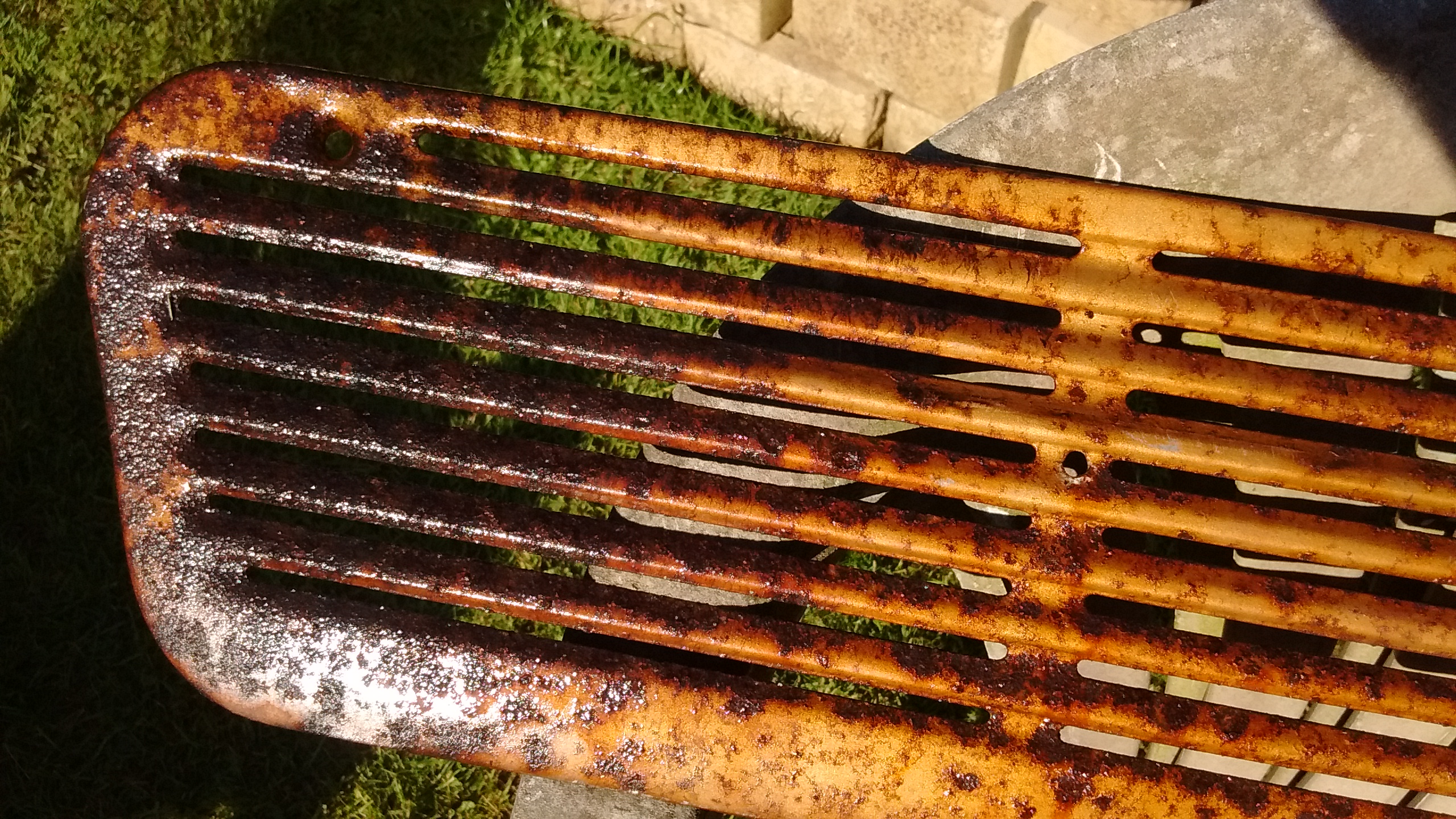

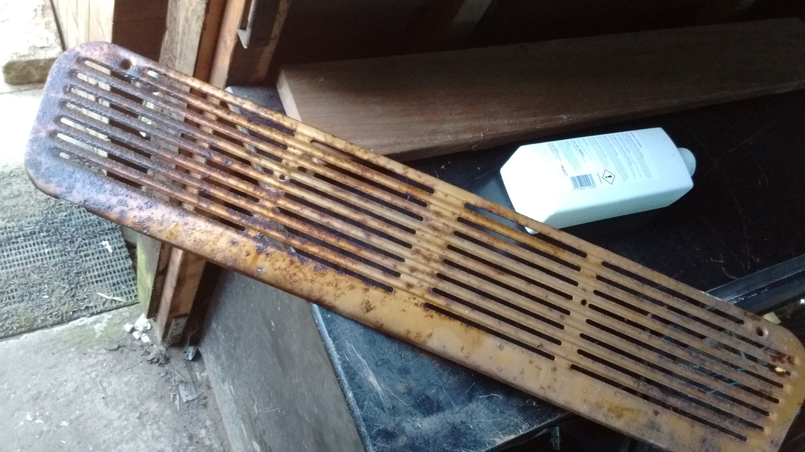

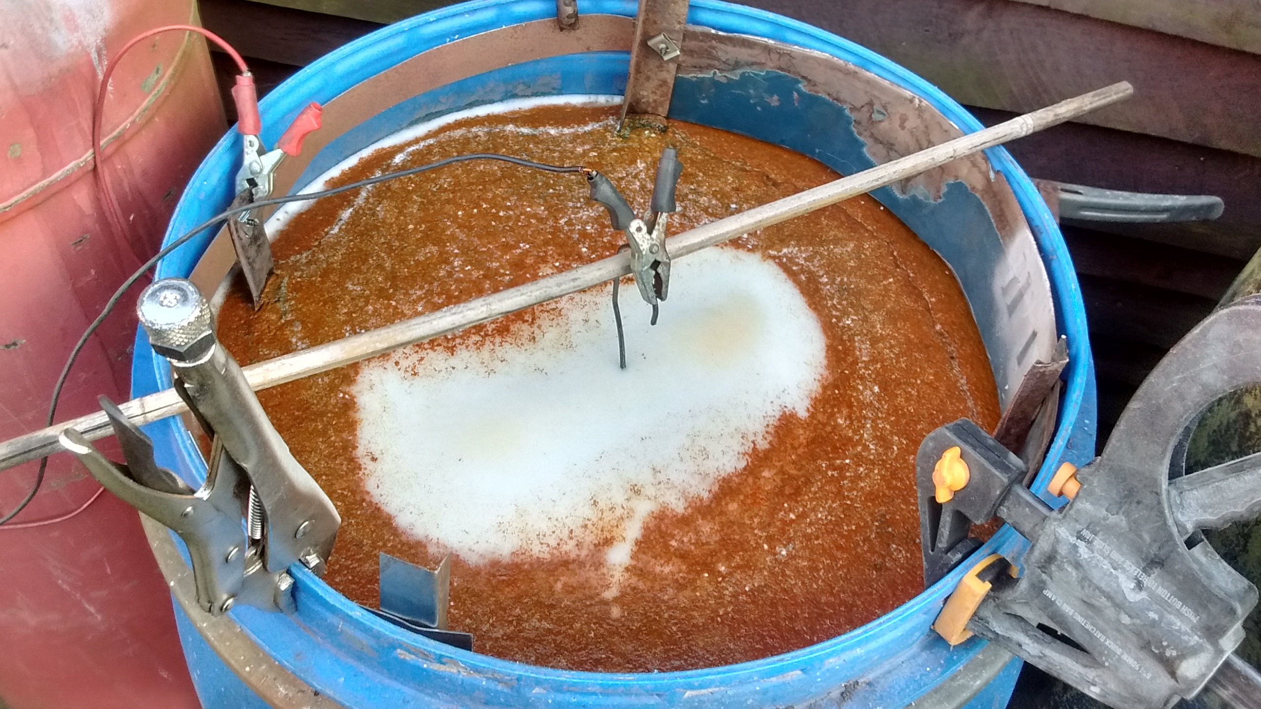

been looking for a way to clean the rust of robs imp front grille, quite a long panel to get submerged.
as you can see, pretty rusted and quite delicate to make using a sander or grinder tricky at best. not sure if it would stand up to being blasted either, fairly flimsy

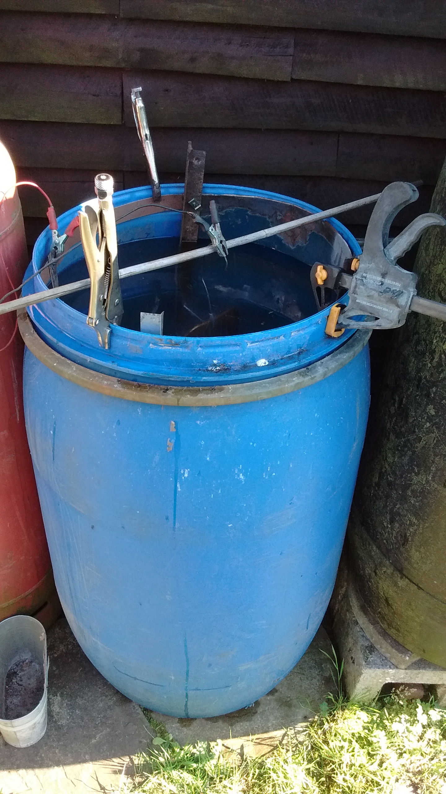

jim kindly found us an old water barrel than is deep enough, a few strips and bands were made up out of various pieces of scrap, including a section of fulvia door bottom!
unfortunately I think I've weakened the mixture down too much, put a whole litre bottle of soda crystals in but there is a lot of water in there!
didn't stop it frothing up though

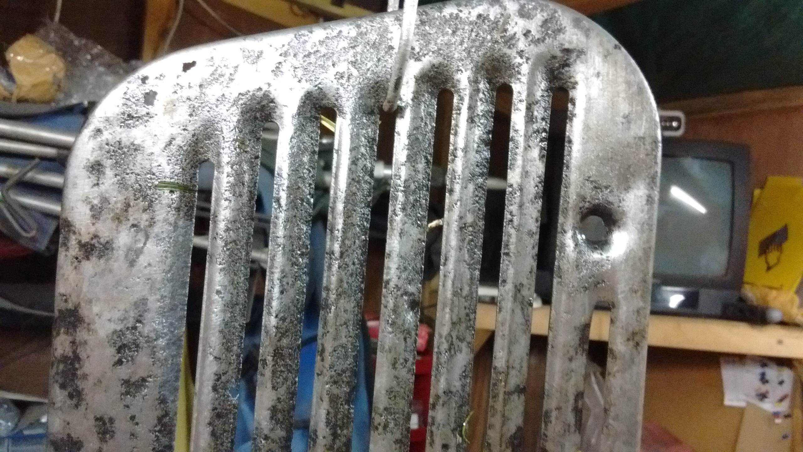

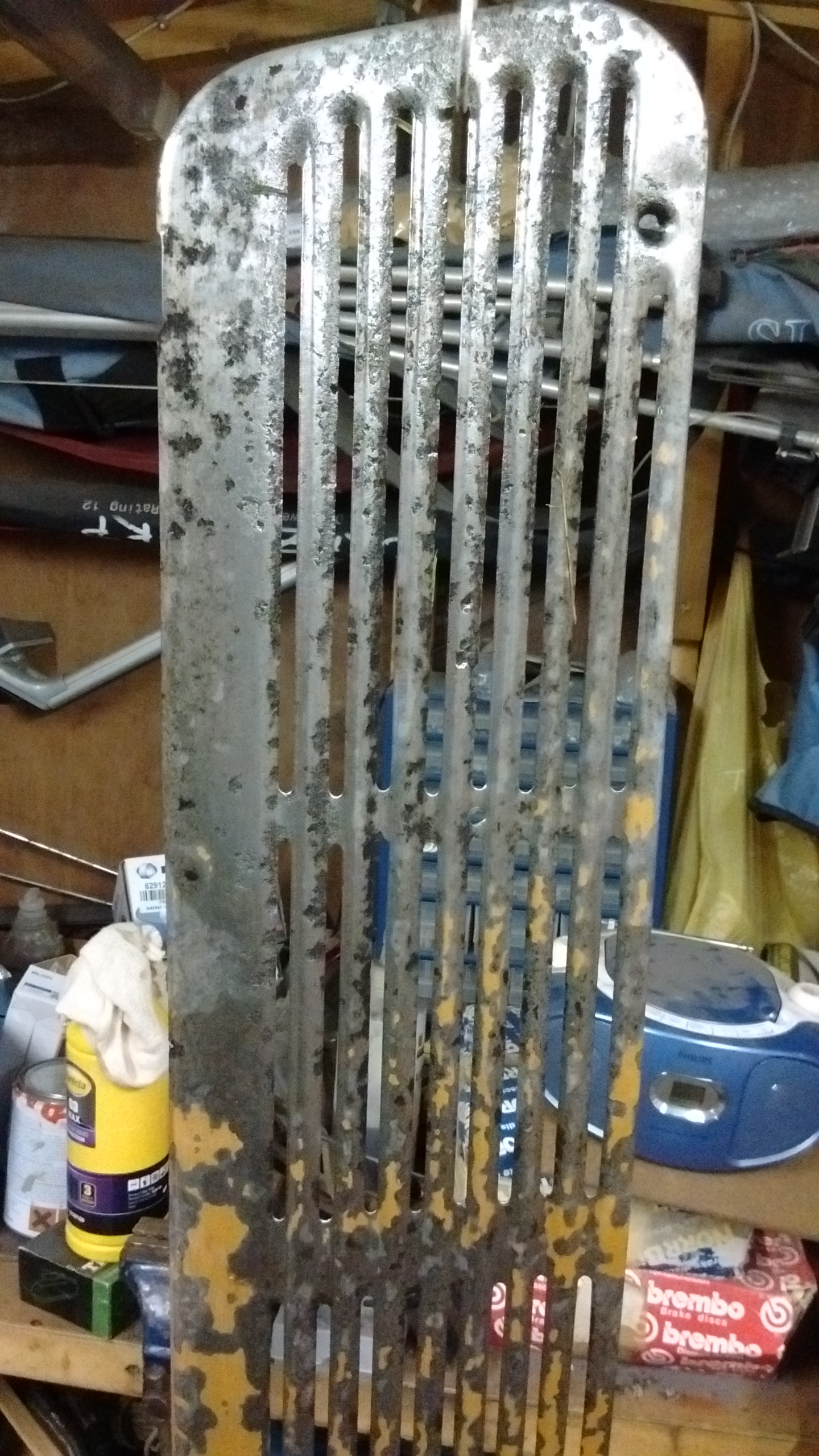

a few hours in and it's almost cleaned out all the rust...
there are now a few holes to weld or fill in, we'll probably hang on and see if one can be picked up for a few quid at national imp day next month before we spend much time and effort sorting it, bound to find one for a fiver in fine fettle if I spend a few hours welding and grinding this one!
