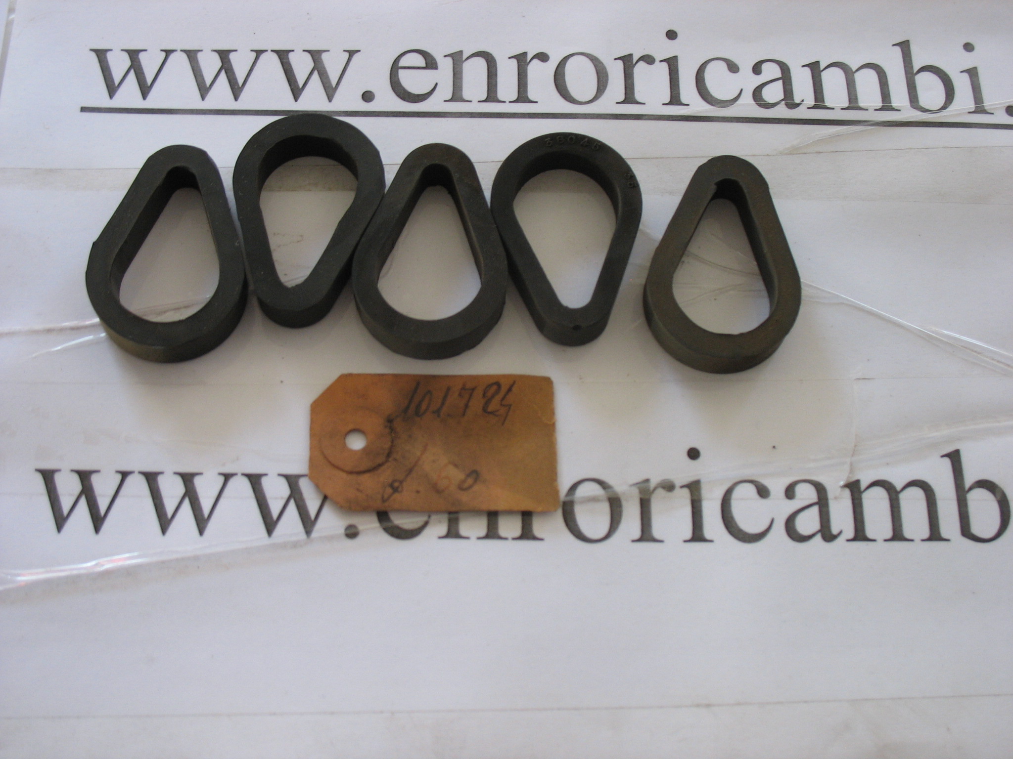

				With my Super body work restoration on hold for now whilst I try to move house I have been looking to try and collect together everything else that will eventually be needed for the mechanical rebuild.
One of the items I have not been able to trace is the rubber band that goes around both the brake compensator activator rod and the Panhard rod.  It was originally listed as part number
101724.
I found a classic car parts dealer in Italy who still had them listed on his webshop, but in the event he had unfortunately sold a lot of his Sud, Sprint, ARNA and 33 parts and no longer had stock of this item.
Here is a picture of what they look like as a NOS part.
I wondered if any other Forum members had come across this problem when rebuilding their cars in recent years and if so what solution they had arrived at to replace this part.  I am also unsure how important it is and what the effect (if any) of not having it in place is likely to be
Any advice/ideas gratefully received

				the compensator won't work properly without it, it ties the rod down onto the top of the compensator providing the required resistance and allowing movement with the axle movement
i'm sure a metal spring could be used to do the same task, would just require a suitable tab to be welded to the arms to keep the spring in place then a bit of trial and error to find a spring that does the job

				I had the same problem on my 33, my rubber band was very perished & cracked. I looked everywhere for the correct Alfa part but had no luck so in the end I bought some rubber tent peg straps from a camping supplier which are the same length & roughly the same stiffness/resistance. They're a little thinner than the original band but I used 2 side by side and have had no problems so far. Still got a big bag of them if you'd like a few? Pm me your address & i'll dig some out of my parts store

				These were available from an online supplier in Greece:
http://parts-alfaromeo-old-models.com/i ... uct_id=533
I bought their last one a few weeks ago and I believe they're out of stock at the minute but say that at some point they will be getting some more in although they couldn't say exactly when.
If originality is what you're looking for, it might be worth keeping an eye on their website for updates?
