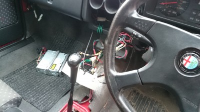

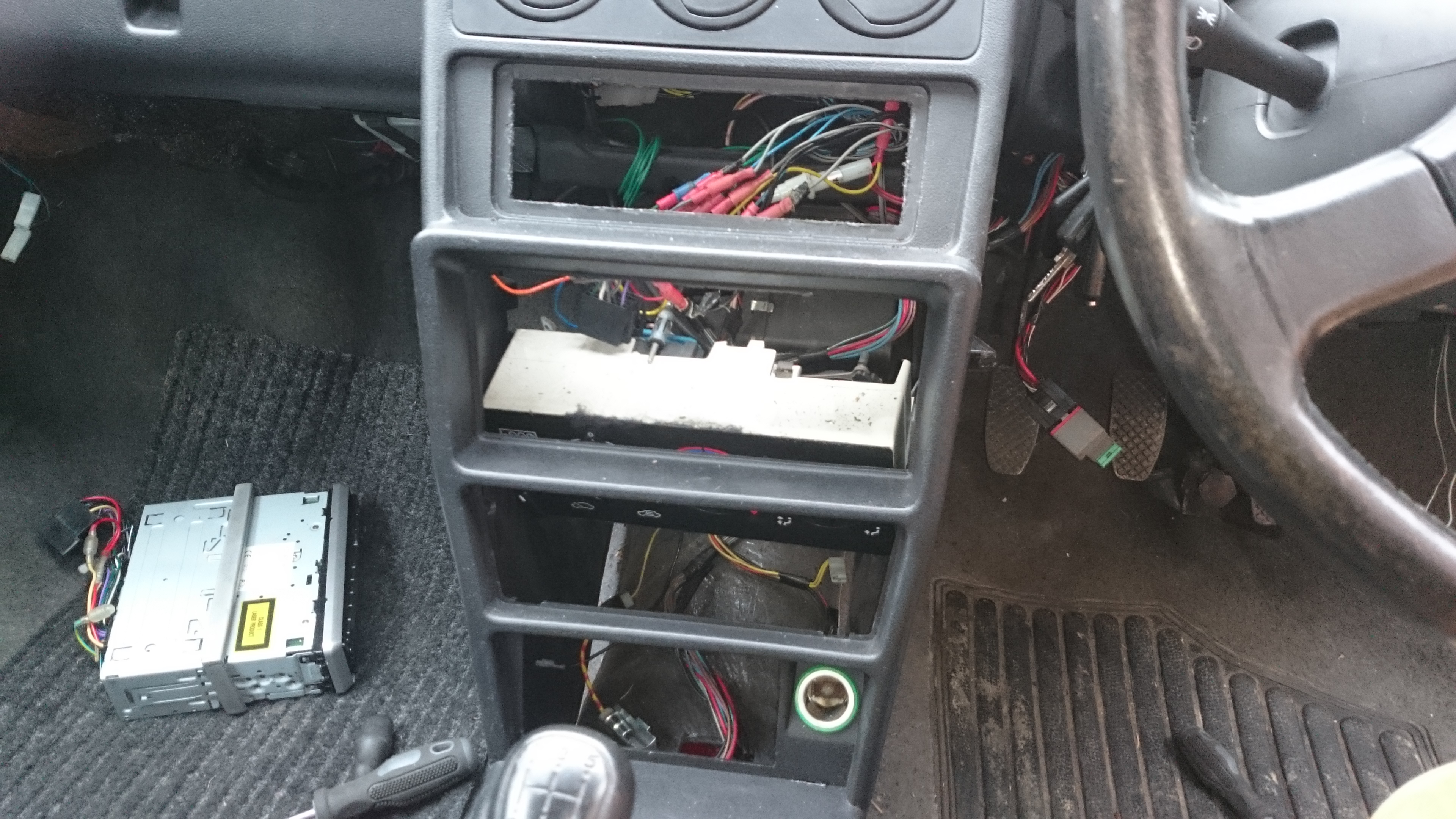

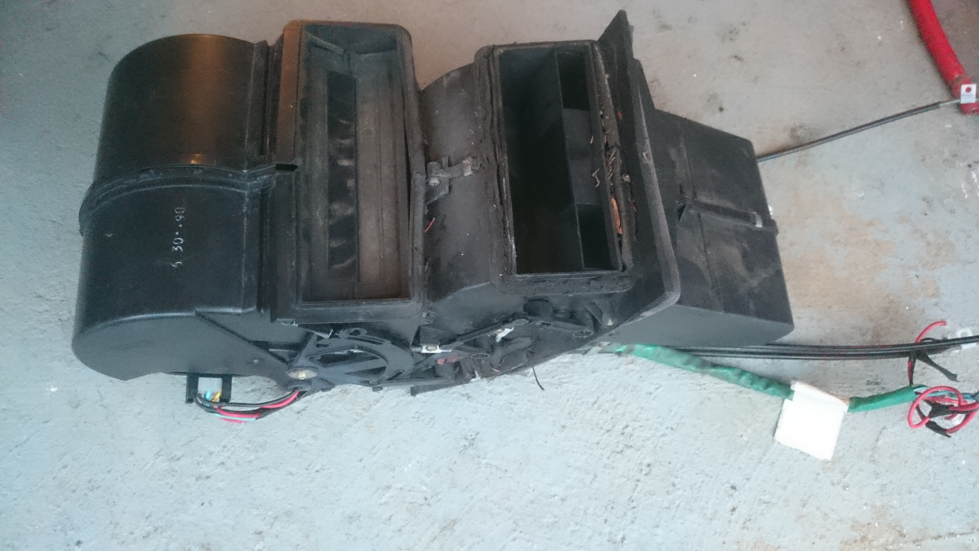

A couple of hours spare so a quick look at the heater controls as they were not working and good old Kev had supplied some spares in this department too.
Out came the dash
Out came the dash
Even the hand brake had to come off to get the centre consul out

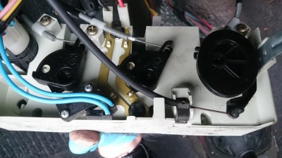

The control unit has a broken dial so donor one will go in
but as some of the cables are stiff they will be replaced as well but this may need the whole heater to be taken out to sort the cables, hoping not as trying to free of the existing cables first, so quick question if the heater unit has to come out to reconnect replacement cables, with the water pipes removed, will this cause an air lock when putting it all back together and need bleeding or will the water just naturally circulate?
Clearly hoping the cables can be freed.
Fan checked and working fine.

the water system will self bleed if you need to remove the whole heater box mate, it sits about the highest point so you shouldn't lose much coolant, worth clamping the hoses with a small quick clamp or g clamp if you've one handy, like the little clamps you get to hold stuff to a workmate type thing.
the heater boxes are only held in by 4 10mm spanner sized nuts, you've got the whole replacement one to see where they are so rathee than struggle i'd be inclined to pull lot out as you've got this far, make a nice job of it now and you'll not have it to do again ;)

Look what was lurking under the heater box!
And finally out.

Has the heater box on the 33 got 4 long captive bolts that go through the bulkhead like on the Sud. If so before I replaced mine i wound the nuts on and shortened the bolts with a hacksaw,made replacing much easier as you don't need a deep socket.
Re: And the side skirts are off...
Posted: Wed Jan 20, 2016 11:33 pm
by NUALFAMAN
Hi Sud 145, Yes it has and it was a pain to get out because of the length of the bolts, so might be worth cutting them shorter to replace it, however the center consul is held in place by the same bolts so will need to measure the length required. But good call there.

Hi. I was lucky and just reglued the seal to the bulkhead. I had the idea of shortening the bolts because of the terrible rasping noise the threads made as they pulled through the bulkhead. Refitting then took no time at all and you wont move the seal. Kev and others have probably done this lods of times. Let us know how it goes when the refit happens..

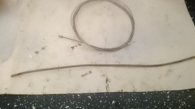

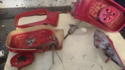

Mirrors off and stripped, found seized and broken cables so will look to my cycle mechanics skills to re-cable these before prepping for painting.
Still some work to do on them!
Bike cables, handy for many uses.

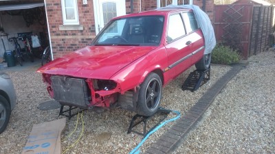

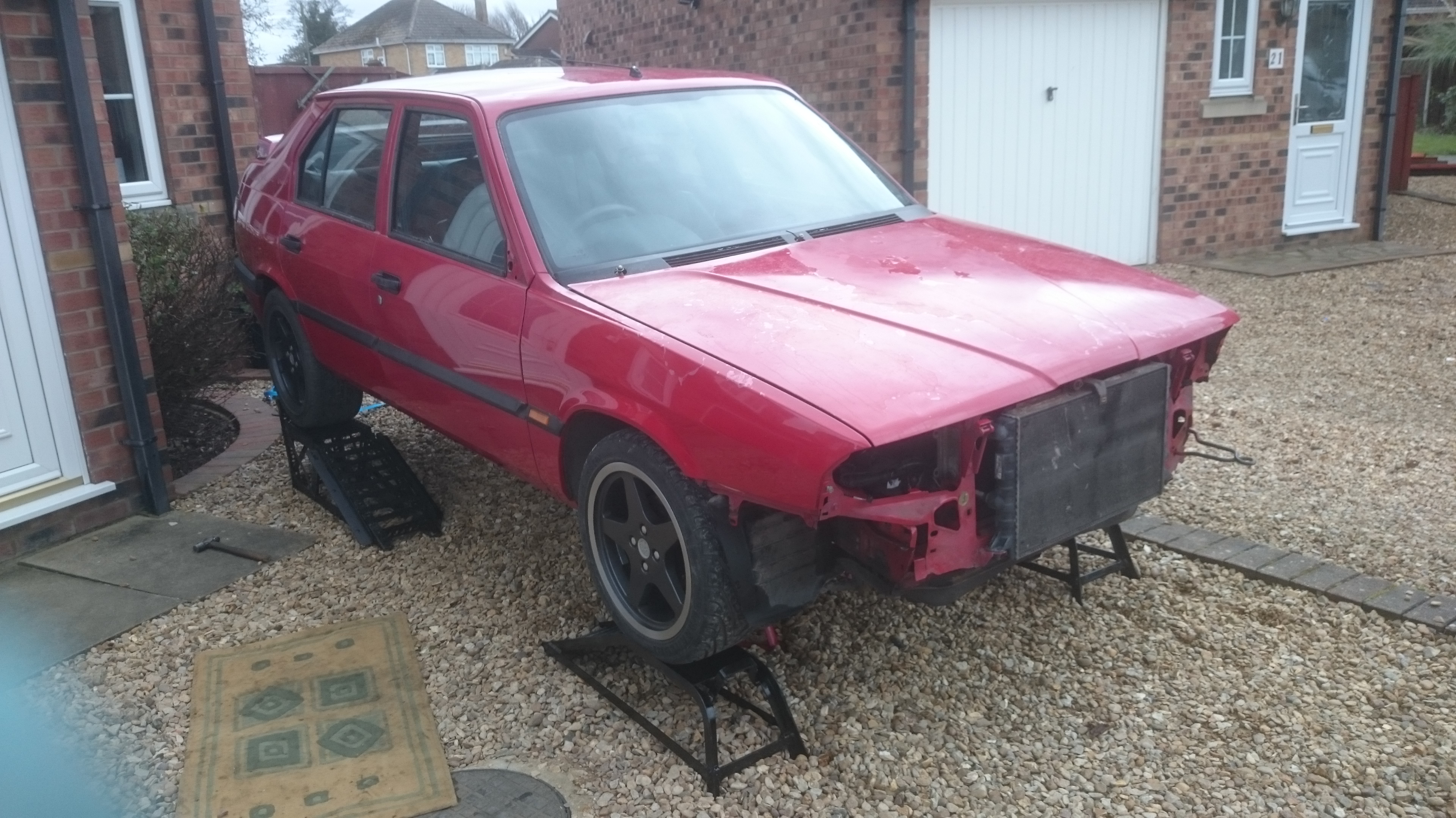

Next was to remove the front lights bumper so I could get the car on steep ramps that I have. The captive nuts and bolts looked like they had never been off, joy! So an hour or so later!
Anyway got it up on the ramps and ready for the underside to be checked, sorted, cleaned and protected.
Roll on the weekend so I can get underneath it weather permitting as I have this weekend off work.
Plan is still to check, fix and clean any removed parts so when the car is ready for the rebuild, after the full re-spray, it should go smoothly but this of course takes time.

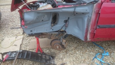

So whilst I was on here asking advice on struts I thought I should put some more pics on of where I've got to so far with the 33.
Suspension removed meant I could clean up and undercoat the inner wings. Then I need a dry day when I can top coat them to keep them in as good condition as they currently are.
Next then will be remove the bottom transvers arms ready to clean and paint.
Brake callipers, discs and disc plates now removed. New hoses will be put on too.
So plenty to keep me busy for now.

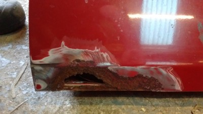

i'm sure Paul won't mind me adding the odd little post to his thread, all relevant to his 33 of course...
this afternoon he dropped the 2 doors and a wing that need repairs.
the hatch needs a repair behind the glass too but that'll be for another day..
wing in pretty decent condition
just needs a small repair down the bottom where it fitted under the side trim
underside in remarkably great condition
the drivers rear door has some corrosion at the front edge of the outer skin, this will get cut out and new metal let in
the passenger front door we knew would need a hole repairing along the front edge of the bottom outer skin
it also has a hole under where the side moulding goes which will get welded up
