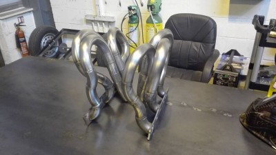

So rather than going through the hassle of finding someone else to do it ive decided to go with the much easier option of creating a headache by doing it myself. Spent a few weeks of looking at the car trying to work out how i wanted to do it, regretting my decision and moaning like a child, this weekend though ive just cracked on. Started with the drivers side as this is the most restricted due to the starter motor, ill then mirror exactly the same on the passenger side. Im doing the best i can to keep the primarys eqaual length and in my head at least....its working out so far (give or take a few mm)
So anyway, heres where im at so far.........

Hi Aaron, good to see you still at it.
the exhaust primaries are looking, Interesting ;)

Not sure at the moment, was toying with the idea of making a "road use" enclosure for them with direct air feed from the front. This seems the best idea given that the raised manifolds are going to increase the ambient temp under the bonnet (even though they'll be wrapped) Then have a set of ITG filter socks for anything else such as driving to meets/shows etc

Are you coming upwards firstly to achieve a certain primary length you have in mind?

Partly that, but also there isnt much room down low and the pipework is quite a bit larger in diameter than the original 12v. I had a few other designs mocked up, all of which were hindered by the fact the engine would need removing in order to fit/remove the manifolds. Most bespoke systems which ive seen for the 24v conversions seem to favour coming up where the room is plentyful

Been a busy time for me lately with many many things in the making, but i found time to get down the workshop and finish the first manifold. Very happy with how it turned out, just need to mirror the same on the opposite side now.
The first picture only shows it tack welded but i can assure you its all been done now.

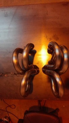

Manifolds are finished! Very happy with how they turned out :)
Re: Alfa 75 V6 24v Project
Very nice. 8-)
