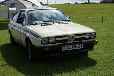

-  My Sprint Speciale before the strip-down.
 Well, after enjoying 3,500 trouble-free and smile-inducing miles since I bought her and with the tax due to run out at the end of the month, it's time to get my little beauty on SORN and to give her the TLC she deserves over the winter months.
Watch this space. During October, we'll be dropping the engine and inspecting all mechanical components with a view to renewing or replacing as necessary as we go along.
Let the fun begin. Stay tuned for more with occasional updates with pictures here...

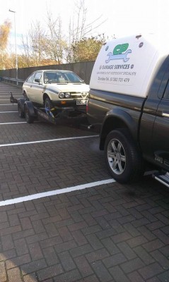

				Update! After a few false starts due to illness and holidays, my baby at last went away today for refurbishment to commence.
Watch this space for updates!

-  Off she goes for some good old TLC
