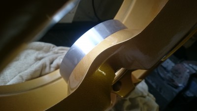

These are my first creations under the new arrangement, and these are to fit a friends Pug 206 gti hubs, which are 4 x 108 pcd, and allow us to fit a wheel i had that he fell in love with, that is 4 x 100 pcd and a completely different offset and centre bore.
and once the fit is finalised i'm going to powder coat the adaptors in a matching gold to look like an extension of the actual wheel.
As a custom made adaptor, it has been machined to be a precise internal fit to the Pugs hub protrusion, and internal bore of the wheel centre, so this eliminates the use of any spigot rings or other parts required to accurately centre the wheel prior to bolting up, which will be done via a full stud conversion and tuner nuts in the instance.
