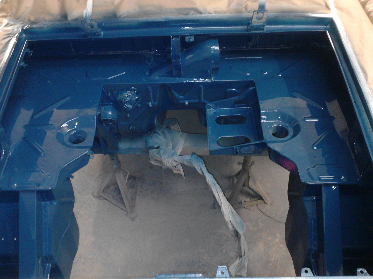

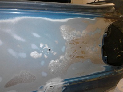

the remaining surfcae rust around the boot opening was blasted and ground back to bare then some rust killer put all over any lingering dimples. all solid so that should hold up for a good few years to come.

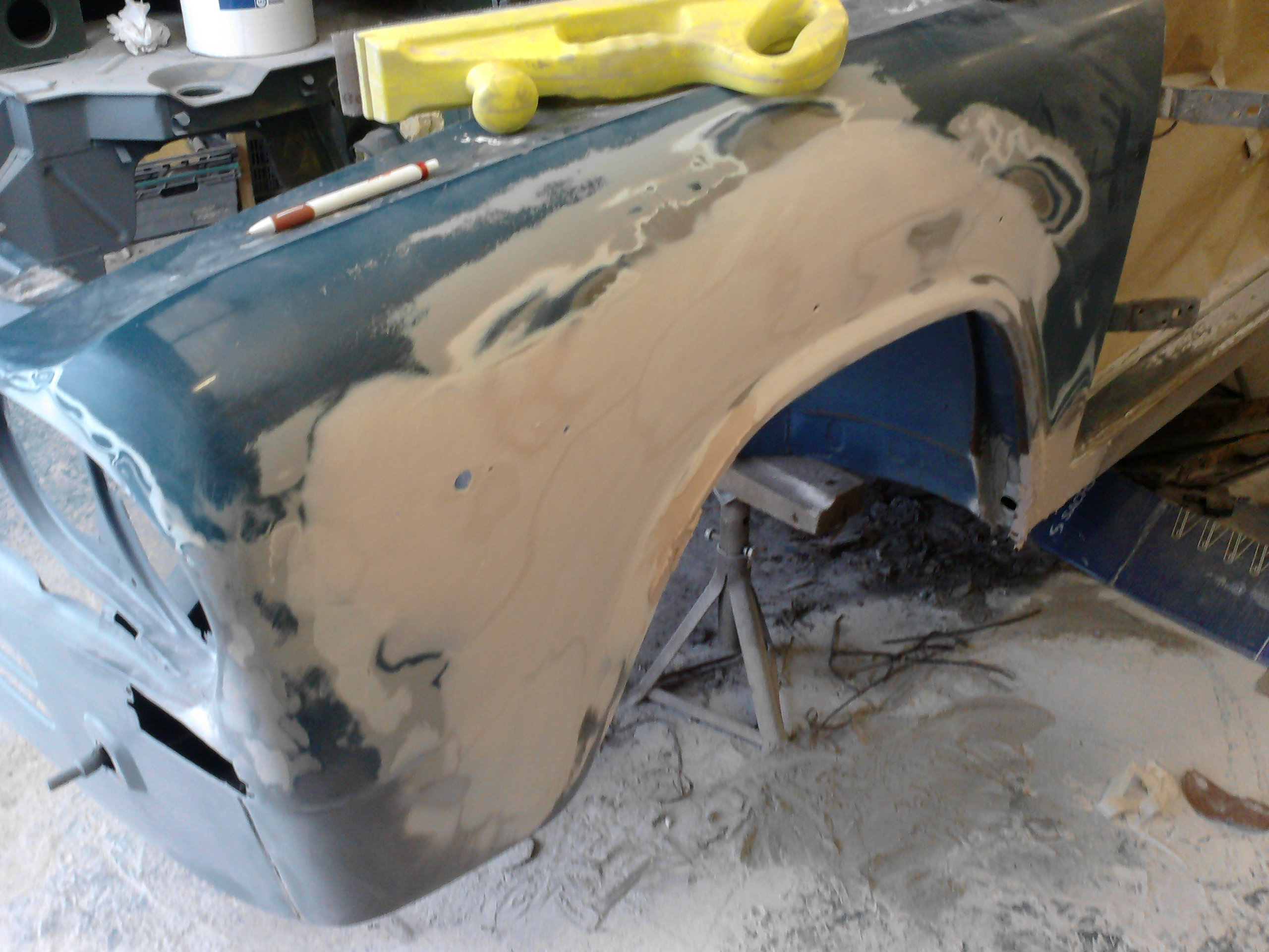

n/s/f wing is all but done now.

front end was finished off and etch primed everywhere last weekend. all the little corners were cleaned out and treated as needed so happy to say forward of the screen it's all about ready for the primer proper

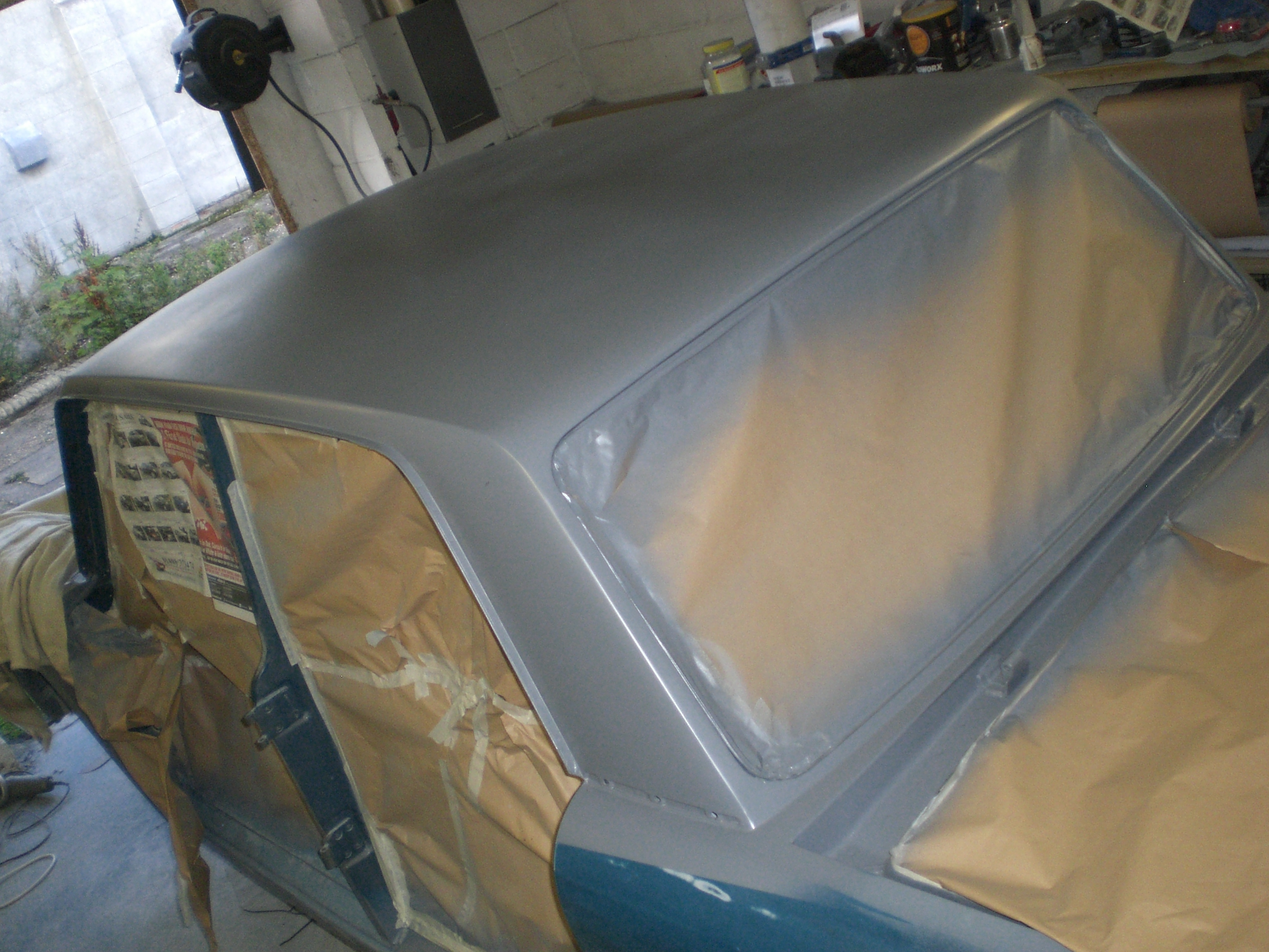

the roof i'd not actually started much on until last weekend, mainly it'd been used to store stuff that i took off
the gutter stainless trim was held on by 4 tiny screws on each side which thankfully revealed hardly any issues at all. just a little bit of work to the n/s rail near the B pillar area.
this afternoon i finished off all the repairs and etch primed the whole thing. it had half a dozen or so little chips to the paint that had let rust creep in but nothing that couldn't be simply sanded out
finally we are getting to the point where the majority of the car is in etch primer, just the rear doors to do (which are pretty solid) and the rear arches and door shuts to sort then it can move on to the next stage, full primer.

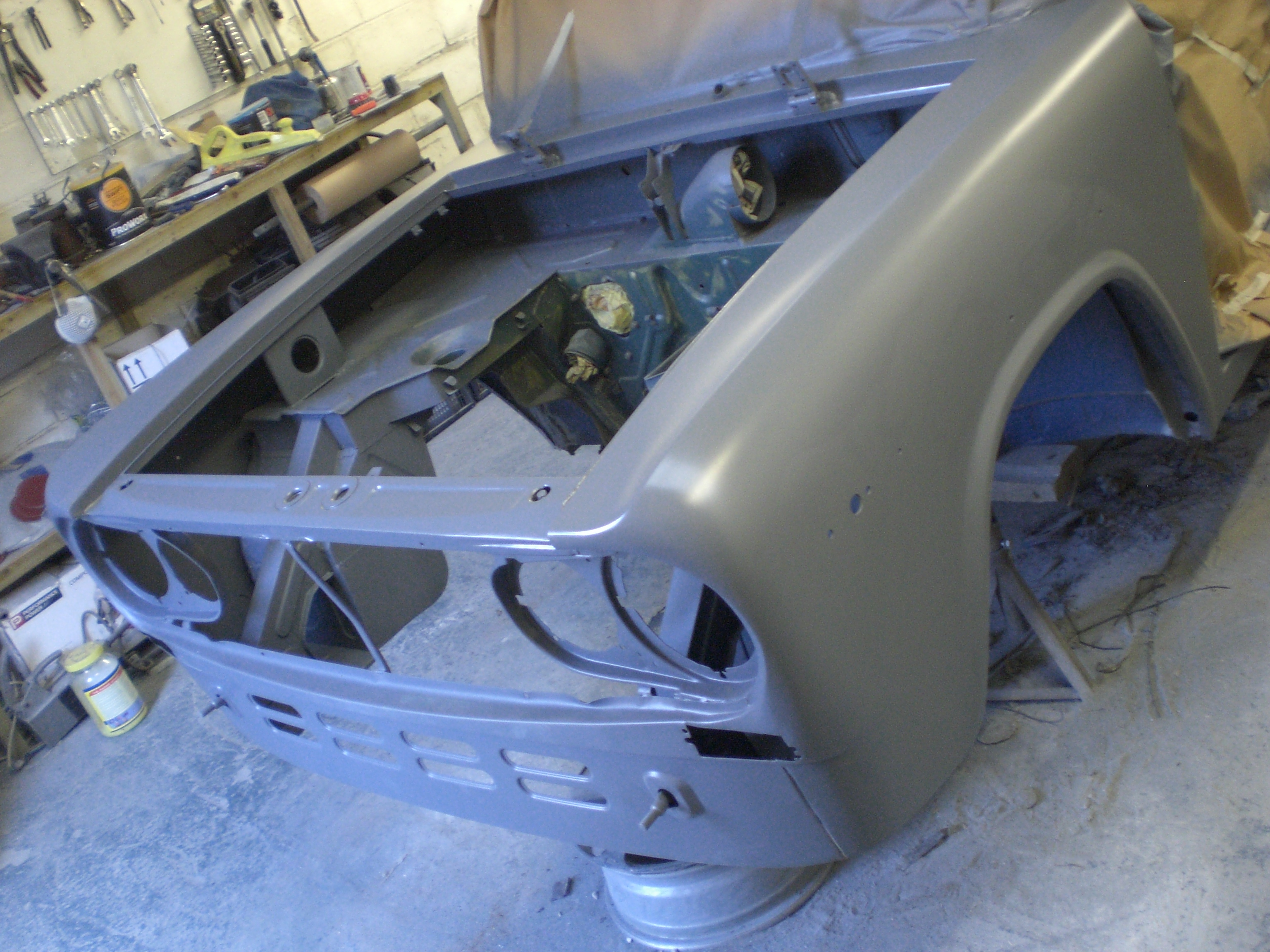

a corner feels like it's been reached at last, the shell is now in etch primer all over!
ok, the rear doors and bonnet ahven't really been touched yet but they won't need much prep.
this saturday afternoon the aim is to get a few good layers of the proper primer on which i've used before at the VW place, it goes on well with a great depth to it which allows it to be flatted back good and smooth.

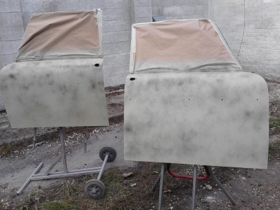

had planned on getting some primer on this afternoon but as usual, things didn't go to plan.
a busier schedule than i'd anticipated and the realisation that i hadn't prepped the front inner wings under the wheel arches meant that priming just some of the bits seemed pointless.

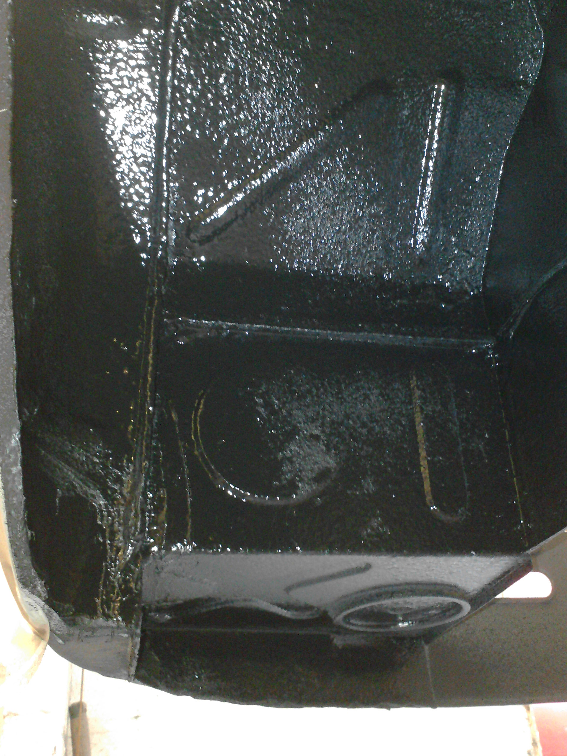

so first off the areas were ground back to bare where needed then i etch primed.
had to pop over to louth so that gave it an hour or so to dry out and get the solvents evaporated off
masked out the arches to make sure there wasn't any nasty platters, also masked into the engine bay too which turned out to have been a good idea as loads of overspray was caught

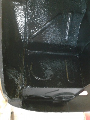

all given a good couple of layers of stoneguard now which will get primed over then painted in body colour.
good weather in mid week and no more hiccups should see the car in proper primer at last...

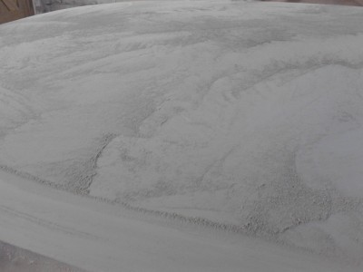

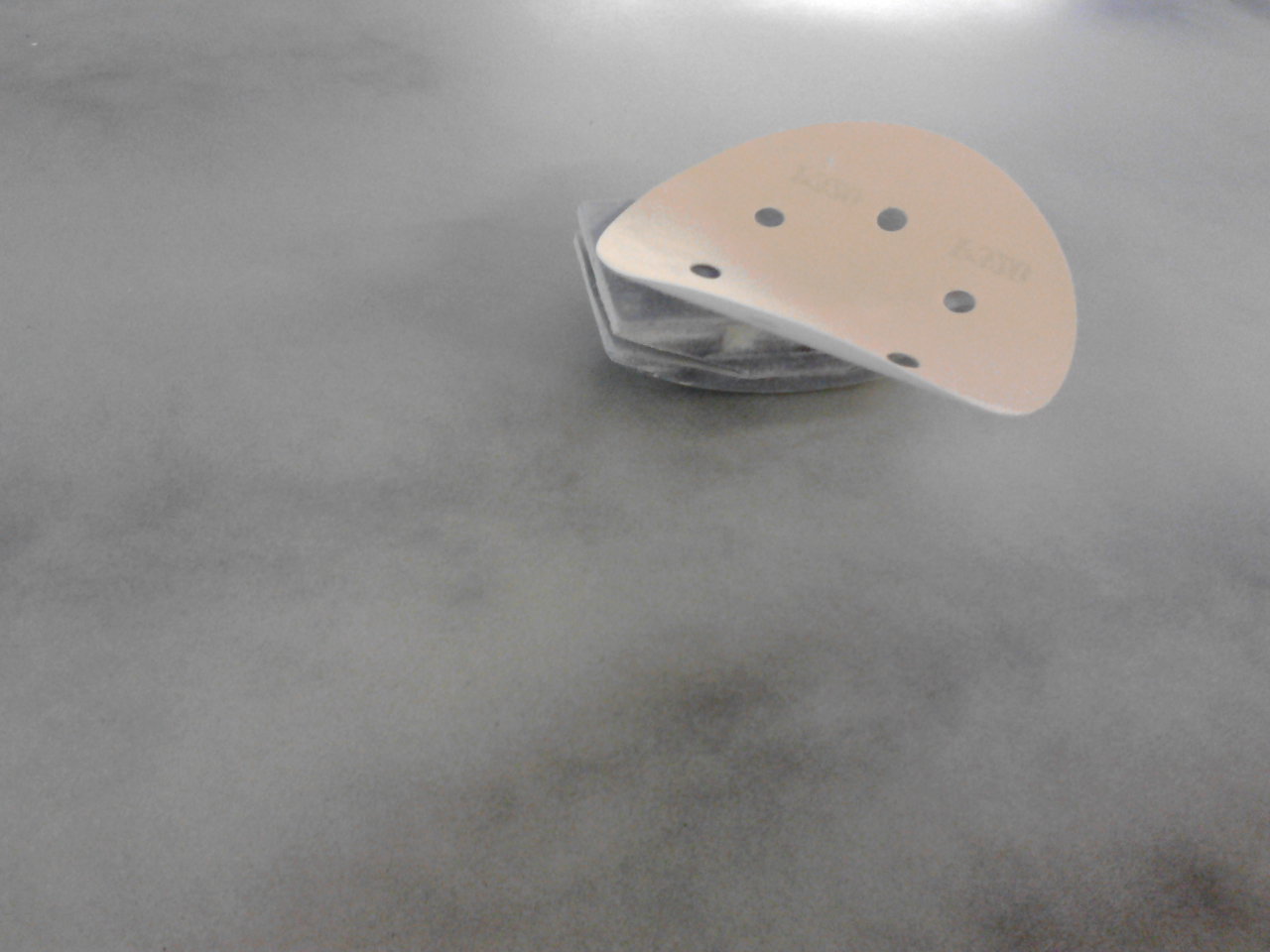

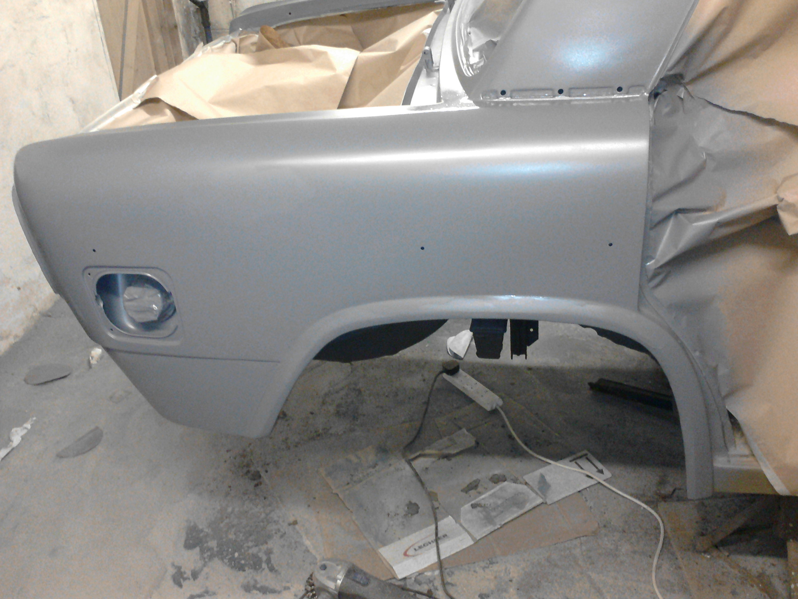

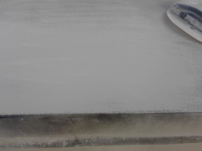

block sanded the shell this afternoon, no midweek visit this week
simple enough task, a flat block, pack of 320 discs and plenty of elbow grease.
method is to rub down until the black disappears which means that it's all perfectly flat.
does end up with a lot of dust from this filler primer though but is mega easy stuff to work with

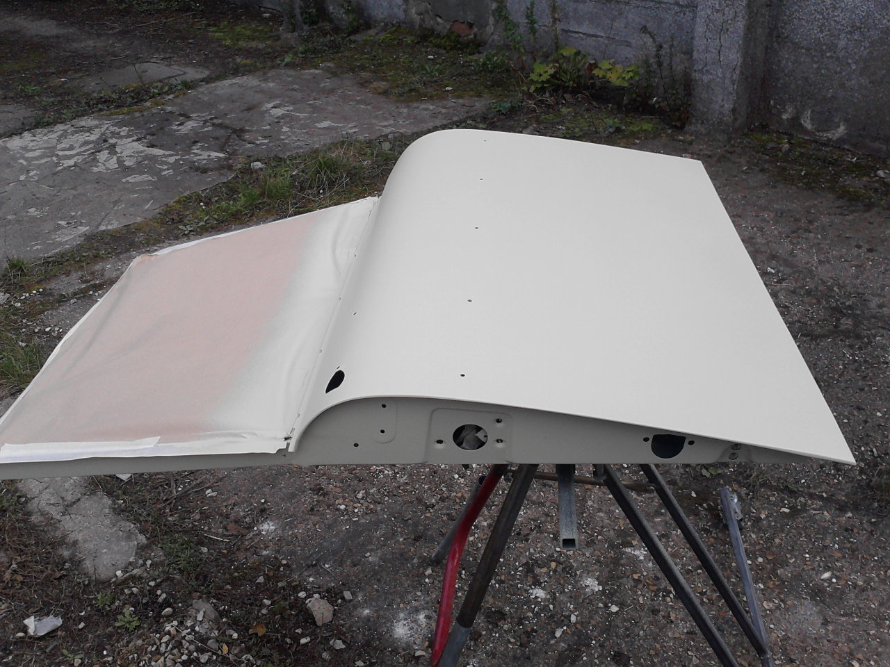

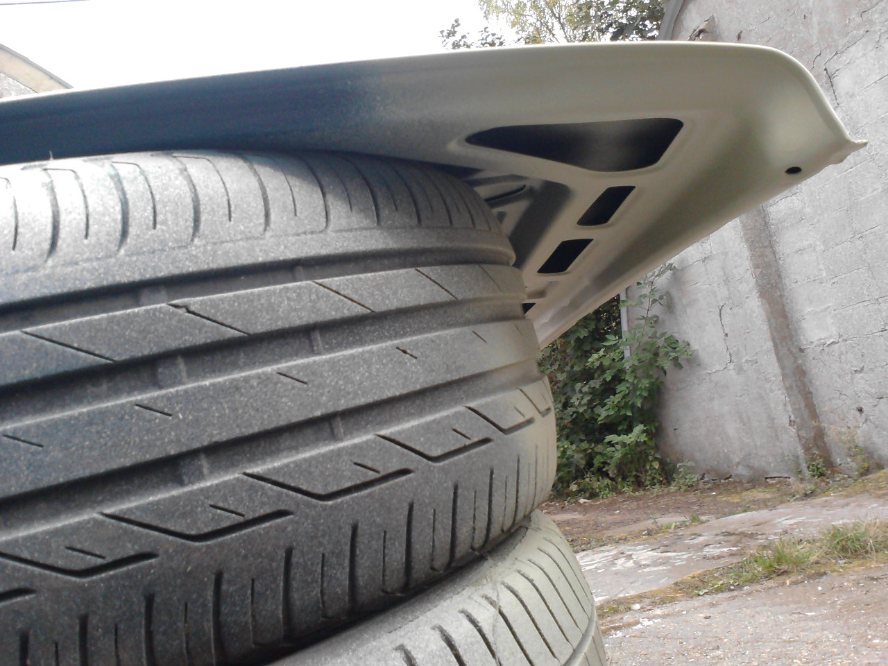

sanded and primed the bootlid whilst the weather was ok
whilst i'd got some primer in the gun i also painted a set of 147 wheels that will become my winter wheels

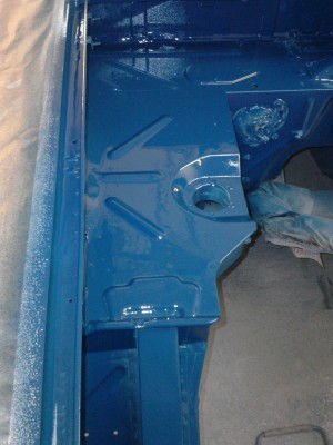

aftrenoon off work so what to do...
bonnet needs stripping as i've not touched it yet so set to and stripped all the bits & bobs off it.
then figured i'd have to start sanding it all down making a dusty mess, raining outside so had to keep doors closed and couldn't think of going outside to sand it
so the car had to be covered to stop dust going into places i didn't want it.
which got me thinking, as i plan on painting the engine bay first and then the bodyshell after to stop the inevitable leaning on a wet wing whilst reaching in with the spray gun i may as well mask out the complete car and paint the engine bay out
once the gas heater had been going a while it was toasty in there so with the car masked up save for the wheel arches and engine bay it was finally time to put some colour on.
a few good coats later and it was all done. when the car is painted i'll mask out the engine bay to prevent overspray going onto the painted bits.
