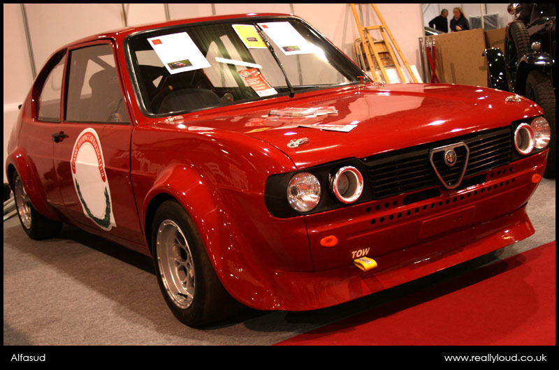

James, do you plan on using a bezel to fake the front to look more standard like the photo ?
Just a thought, someone else may correct me here, but would a series 3 bezel (trimmed back around the indicator area) fit in as I think they hold the lamp and aim adjuster.

I reckon you could get a series 1 / series 2 plastic light surround to bolt up to that section in the photo. It might need a support on the inner side but you could bolt a nice piece of aluminium to that vertical bar towards the middle to act as one
Shrew has some I think, via the Kevbulk buy?
I reckon too much would need snipping off a series 3 surround
Plus if you use a series 1 / 2 surround, you can fit a series 1 grill and it will all line up nicely ?
Tim

Great photo, very smart car, and a good possible way of achieving a reasonable finish. Thanks for the comments chaps.
I can see I should have set it up a bit more. There is a `trusty' :lol: VW radiator that goes on the back of that bar,
and then across the front is quite a brutal mesh that goes right across including the lights. I would have to cut it to fit the lights, but
given how awkward spares are becoming my thoughts are I would rather not chop up good series 1 stuff to make it single lights.
With the double light is one dip and together main beam ? Perhaps I will have to stick to a twin lights set up.
And to answer your question Tim, I was not going to use a bezel, still trying to retain as much of it as it was. Thanks again.
