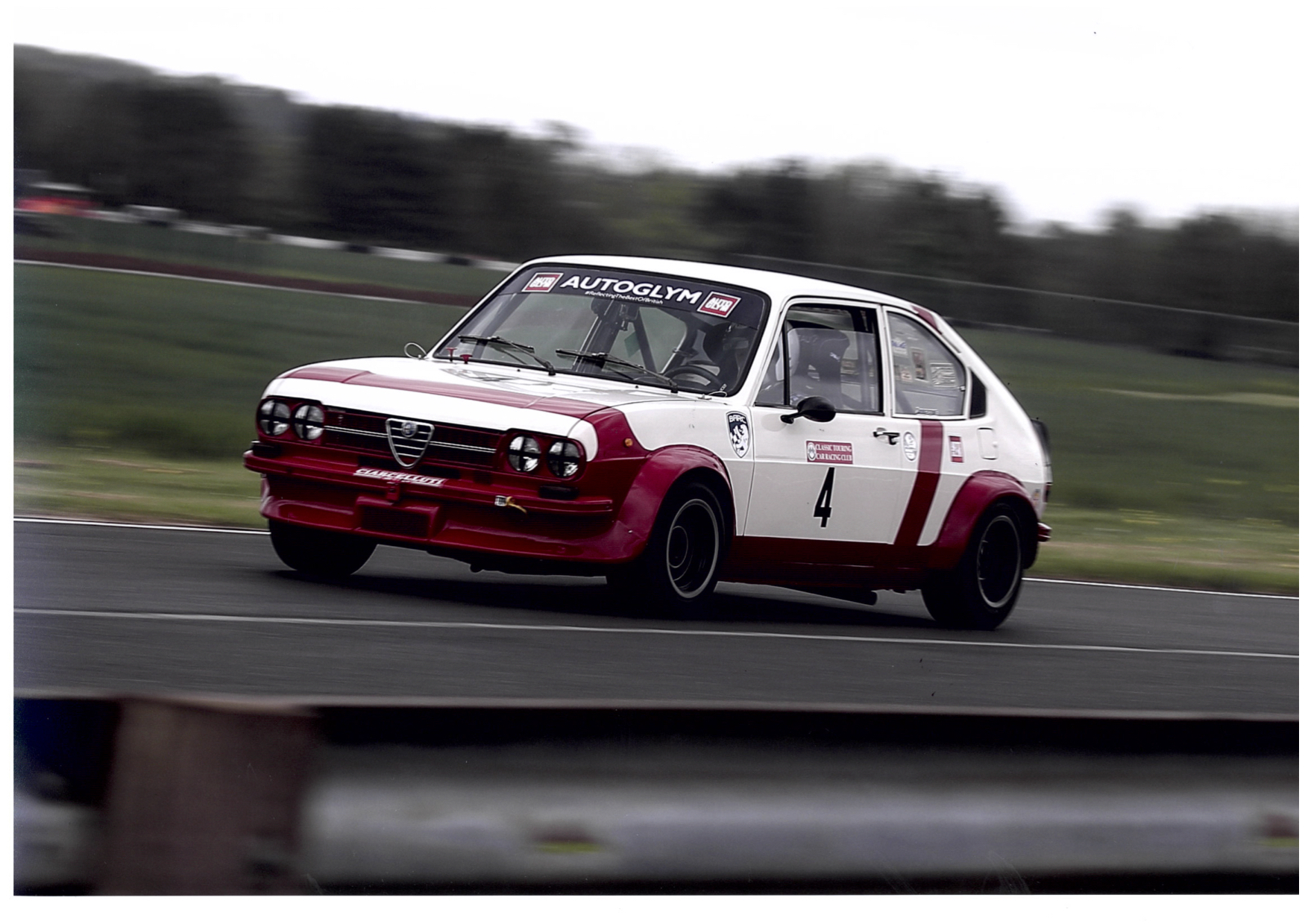

This lady takes nice racing photos:
Posts: 2893
Re: 1974 Alfasud Trofeo
She does indeed Simon, lovely and sharp images. 8-)

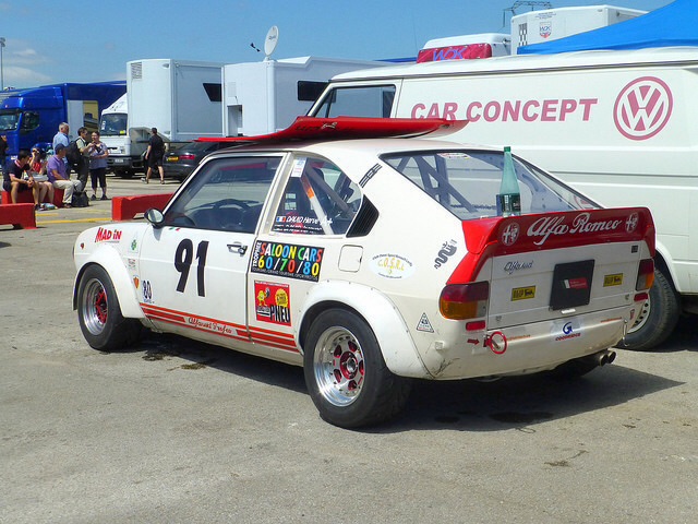

Post by Marlow Sud »

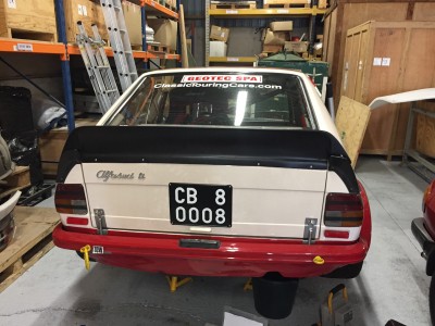

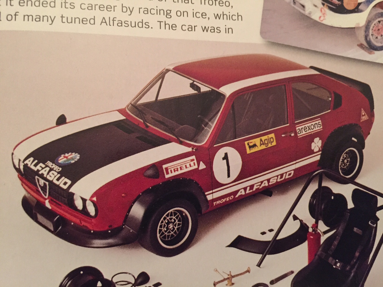

Thinking of a slight change in paint scheme as I will have the original rear spoiler finished in satin black. Love this version:
The plan is to remove the bumpers, return the grille and light surrounds to black and have the front spoiler, wheel arches and rear spoiler all in satin black.
Posts: 577
The contrast between the black and white should be striking, look forward to seeing the finished article!
Marlow Sud wrote:Thinking of a slight change in paint scheme as I will have the original rear spoiler finished in satin black. Love this version:
Doh!
mine and yours will be like evil twins mate!
but at least mine won't be done for years yet! ha ha!

Definitely bumper less ....tough one on the satin arches, I like this one.

Thanks for your comments guys. I was told by someone that a car should only ever have a maximum of three colours on the bodywork. I think they have a point.

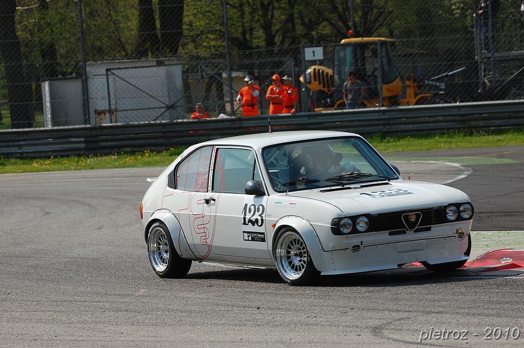

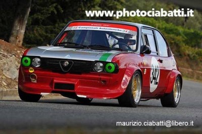

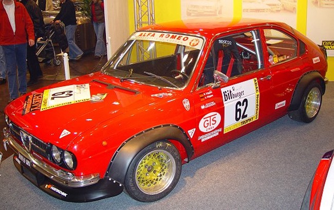

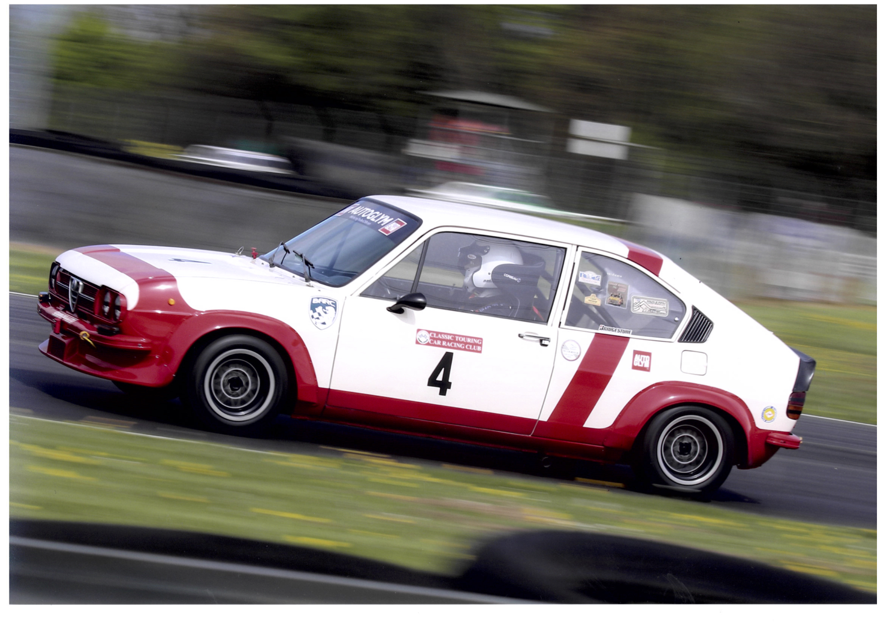

The original rear spoiler will look great.

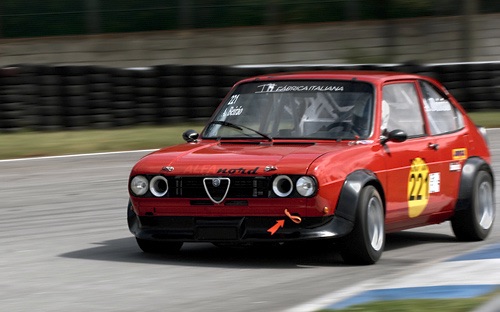

Couple more attached for inspiration, the satin does look a bit more old school so works well. The all white one posted last looks a bit more modern

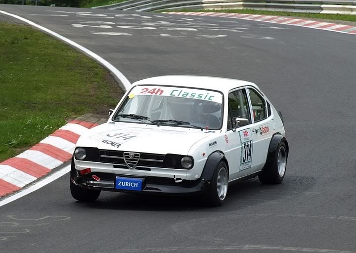

Two more, the first a close example to Simons plans, the second the only trofeo I will ever own....

Great pictures thanks Tim. I do like them in red but I am happy with the white and red and I am sure the previous owner in Italy will be happier if the main colours stay the same. He is a real gent and a pleasure to know. He maintains a keen interest and I send him pictures from time to time.

As said Simon, satin black will keep the old school (skool?) look.
Glad you are keeping the white and red, I think that looks lovely.

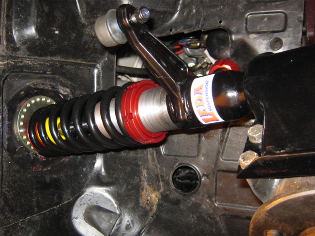

Hi Guys,

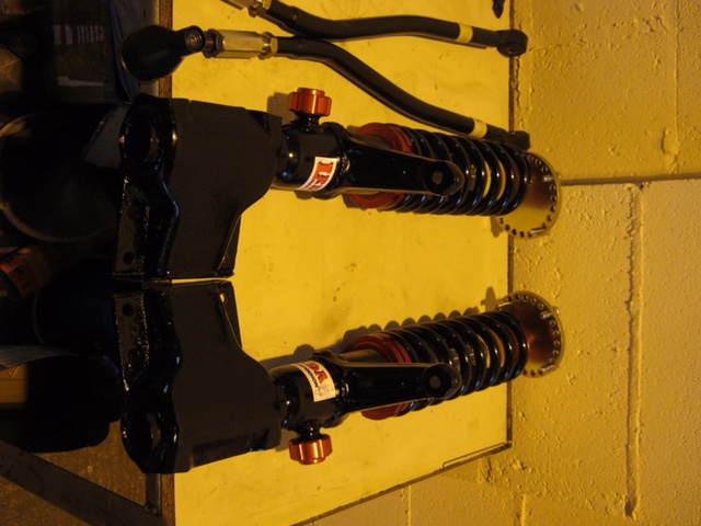

As well as vented discs and four pot callipers, Tom at BLS is lowering and stiffening the car. Here are some pictures he sent today of the front legs.
Very nice 8-)
Posts: 2893
You have all been very busy.
great work.
Superb!
I like the inverted steering arm mount, and rethreaded steering arms,
perfect! :D

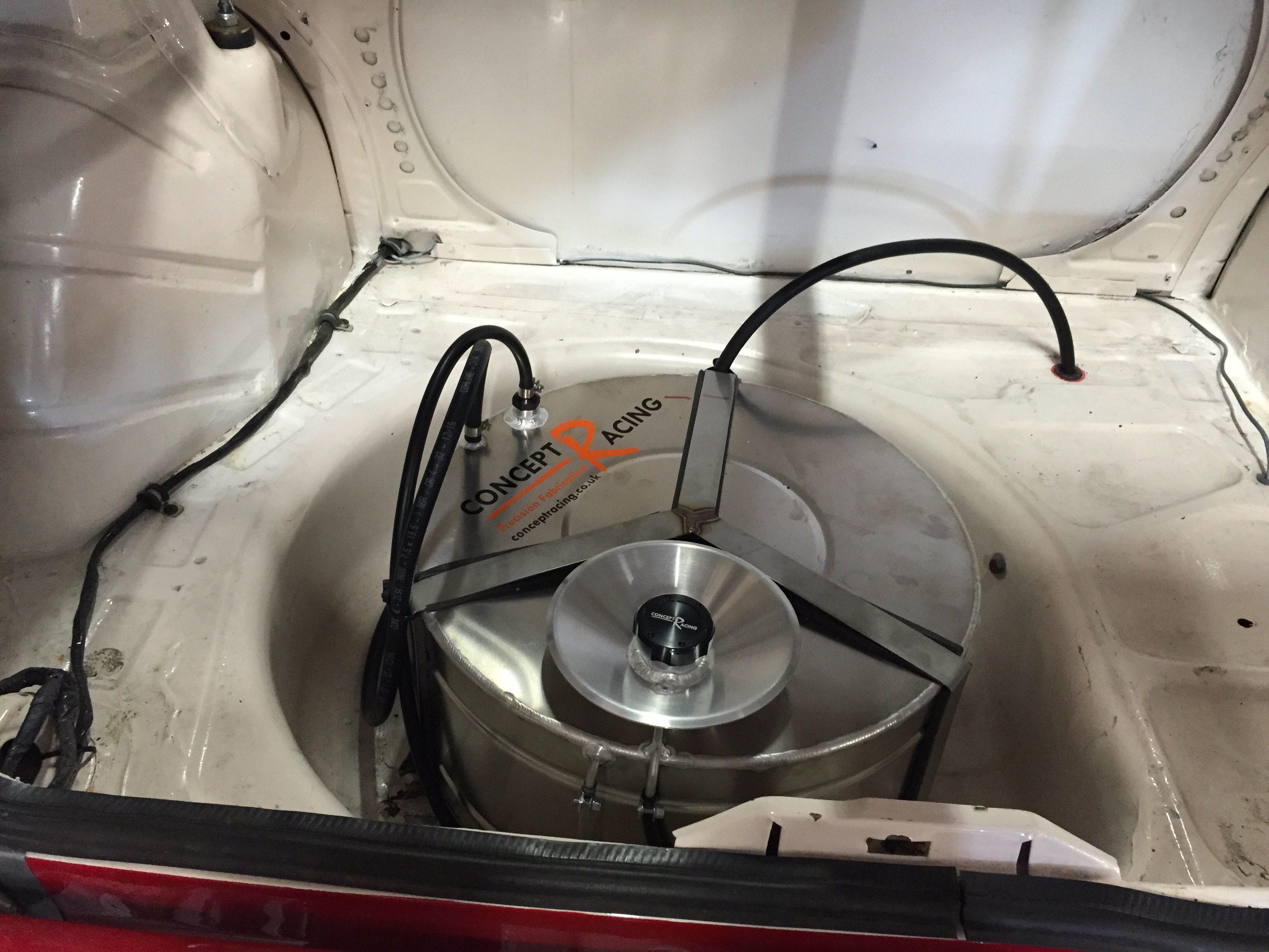

The Trofeo suffered from a bit of fuel starvation on a RH hairpin at Rockingham with half a tank of fuel.
Just put an aluminium race tank in the wheel well. The seat back area is aluminium sheet and I am just fitting an aluminium sheet across the rear parcel shelf to isolate the boot. Then I will remove the steel tank and remove the bumpers.
I have added a bit of weight by fitting a retro Italian number plate. The car came from Campobasso and had one of the earliest plates. Campobasso 8.
Nice touch , I like the plate.
It will look great bumper less also.
Was it a full tank before ?
