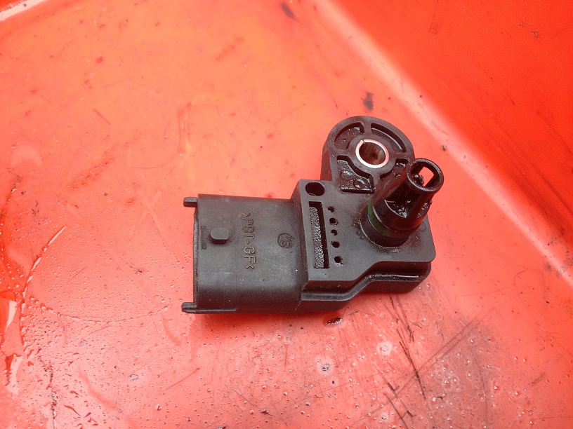

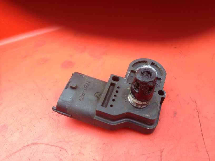

Finally had a free and dry day to have a look at the GT's EGR valve. First up I took the MAF sensor out and found that was a bit gummed up so cleaned that - be interesting to see if that has any effect on fuel consumption.

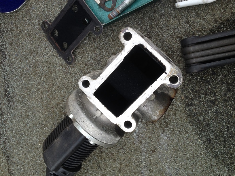

Then I removed the EGR - happily very straight forward. I was surprised to see mine had the restrictor gasket already fitted, whether that was from new or replaced previously I can't say, but it seems to have done the job as the EGR was pretty clean, just a bit sooty but no carbon build up, so I gave it a quick squirt with carb cleaner and re-assembled all with new gaskets. I will keep an eye on fuel consumption to see if cleaning the MAF sensor has any effect, but it seems the GT is running OK for now. Having read up on inlet manifold removal I think I will leave cleaning the inlet manifold until the next cambelt change!

Glad it was an easy job , hopefully your get some more mpg as well too
