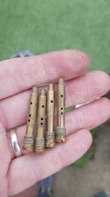

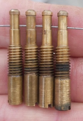

Re: Twin carbs
Posted: Tue Aug 15, 2023 11:50 am
by StescoG66
How does this jetting compare to others?
I am thinking of lifting idle to 55 as am 5 turns out on mixture and still have this pulsing at around 3000rpm
Have not driven the car again since I cleaned them all out with paraffin and my compressor, so maybe its solved.
Also had a slightly sticking needle valve which has been changed too (175)
Idle Jets - 50
Idle Jets - 50
Emulsion F67 + Main 140
Starter jet? 90F7
Starter jet? 90F7

I tried 55s and it totally bogged down. Didn't have time to play so put the 52s back in.
