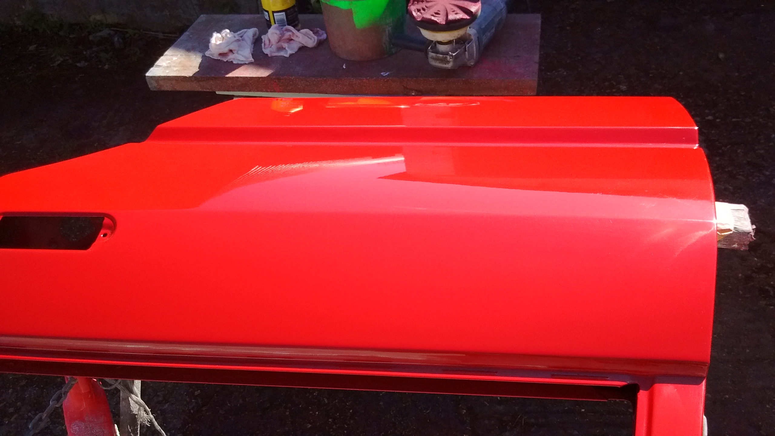

Re: And the side skirts are off...
another busy day with an early start for me, out of the house by 7-30! :o

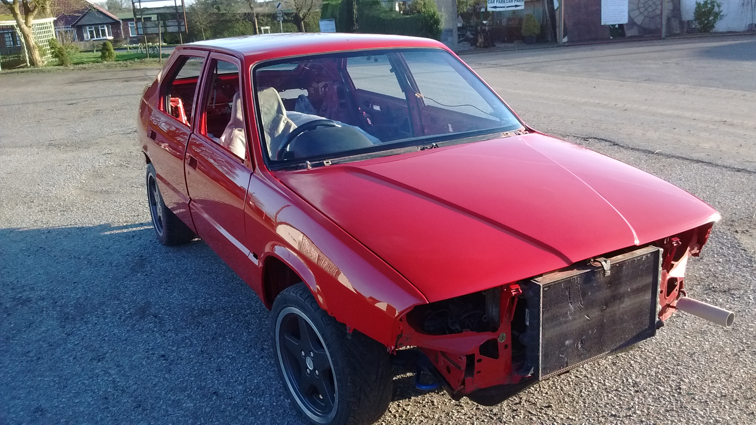

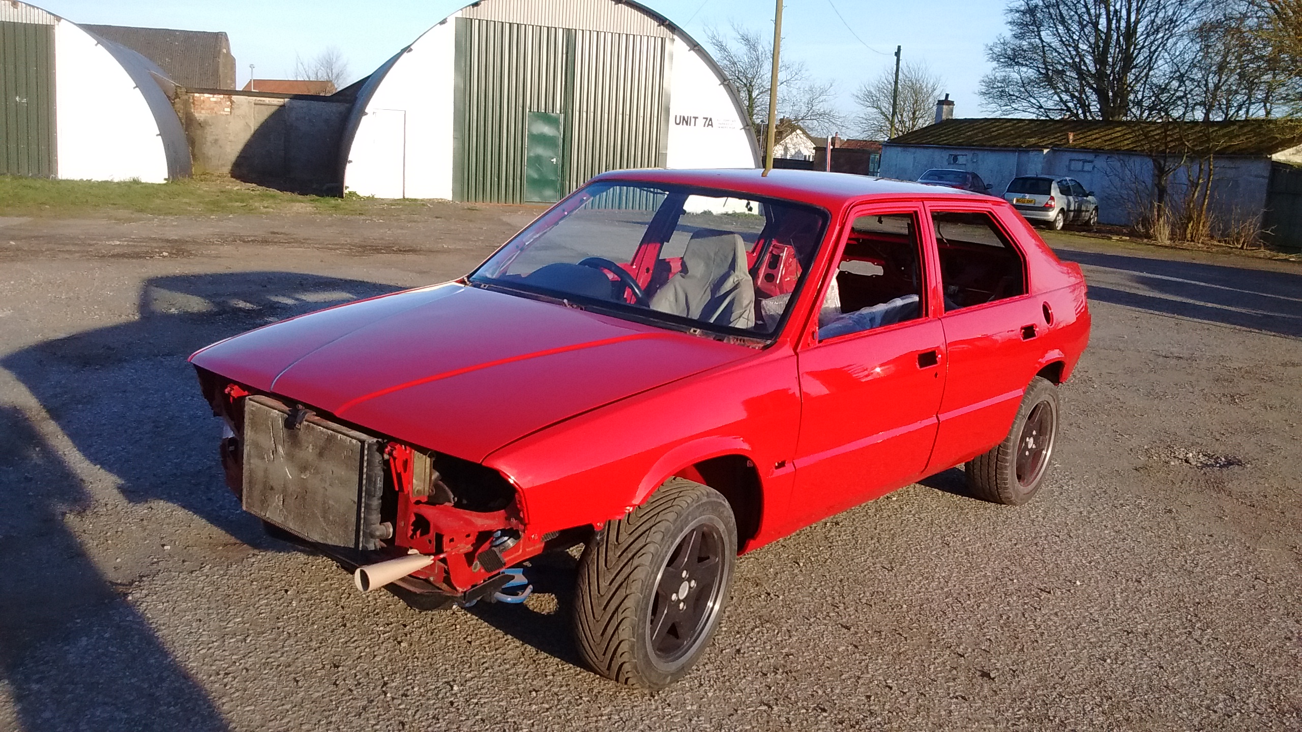

after another lengthy session of flatting & polishing we ended up with some decent finish across all the panels, very happy with the results for what facilities we have

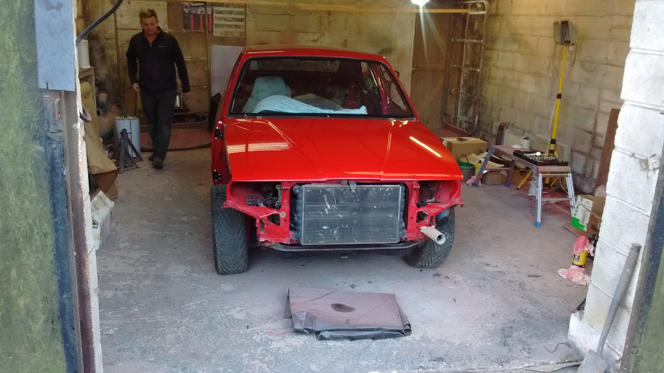

finally time to get it down on the ground and get it outside....

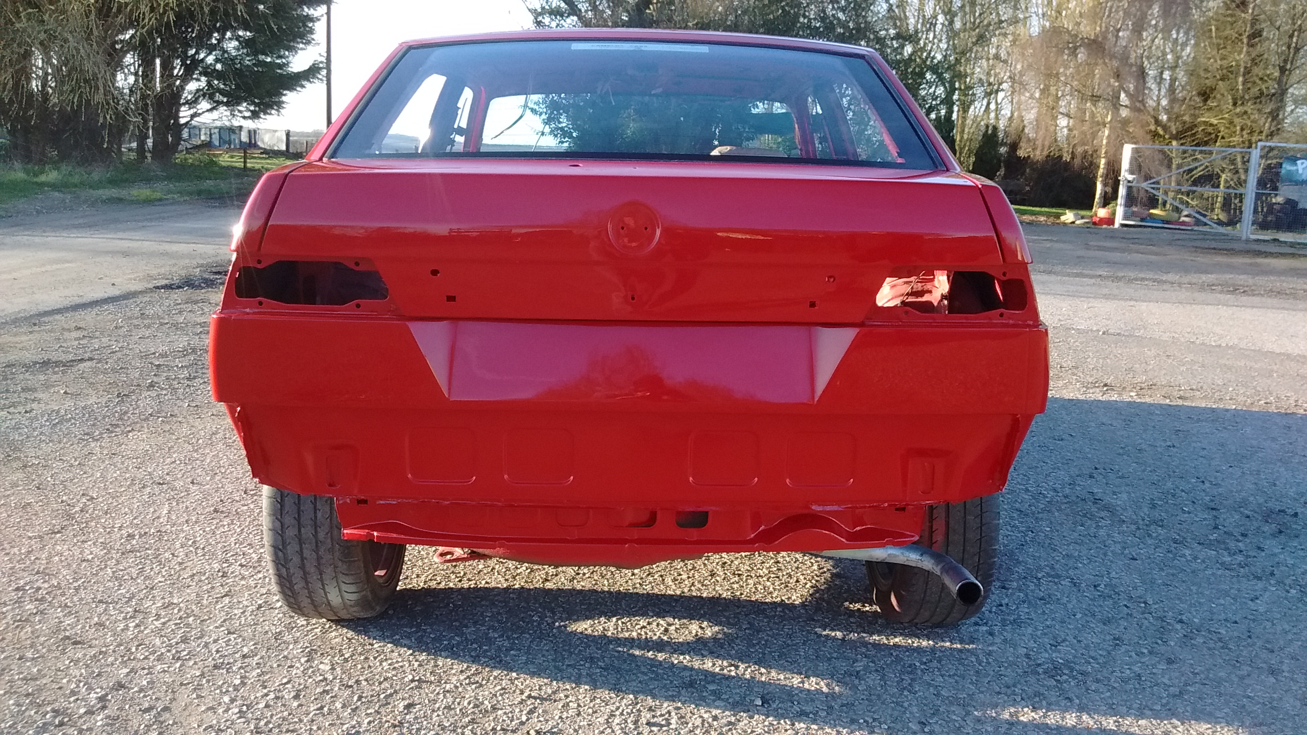

once the final wax went on then time to get it into the sunlight for some pix 8-)
the car is just stunning now, if I do say so myself. red cars are just superb and this one suits the colour a treat 8-)

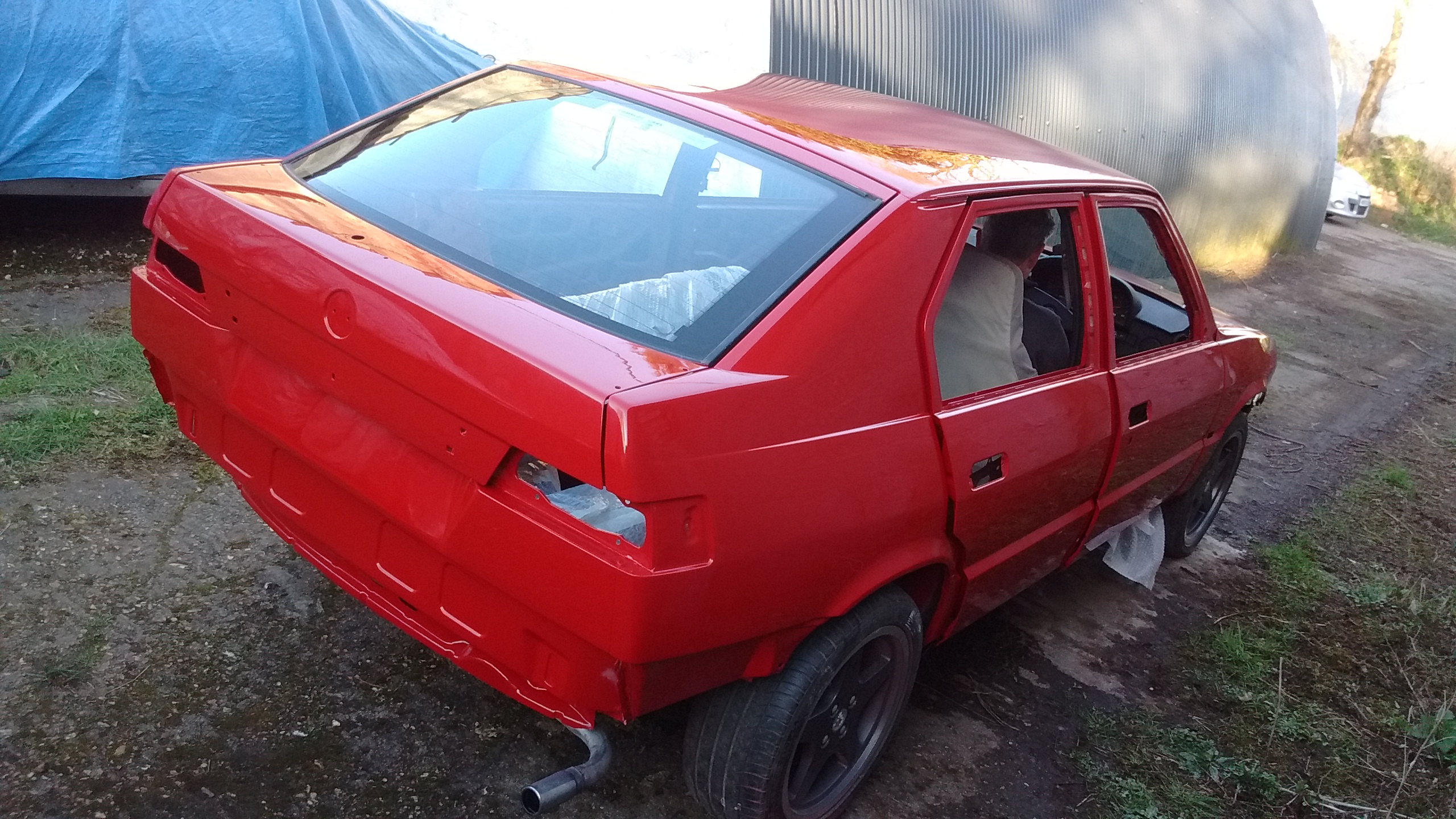

car back in the workshop now, it'll be collected next Wednesday
the last minute roof repairs seem to have been worth it, 8-)
my idea of a millpond picture :)
and lastly, paul checking out the stance :D
big thanks to paul for trusting me with the job, we're both pleased it's come out so well. glad that the 33 will finally be the envy of the neighbours rather than the butt of the usual rusty Alfa jokes ;)

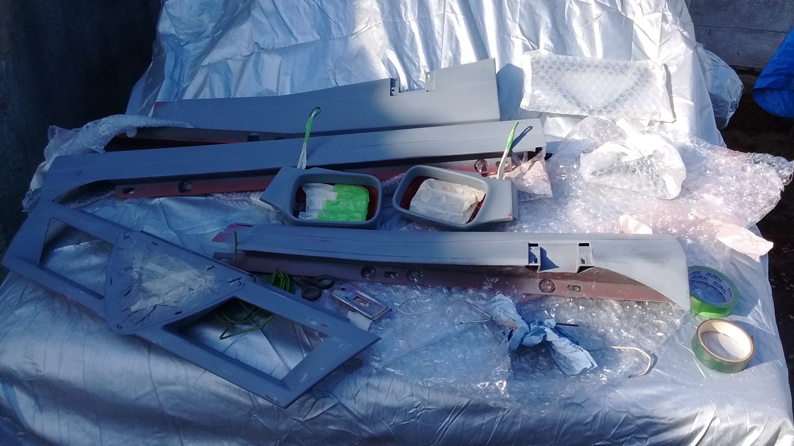

went up there this afternoon just to check out what's left to do on the next stage....
besides the bumpers and rear spoiler there are quite a few bits & bobs still to do....around 20 or so in total!

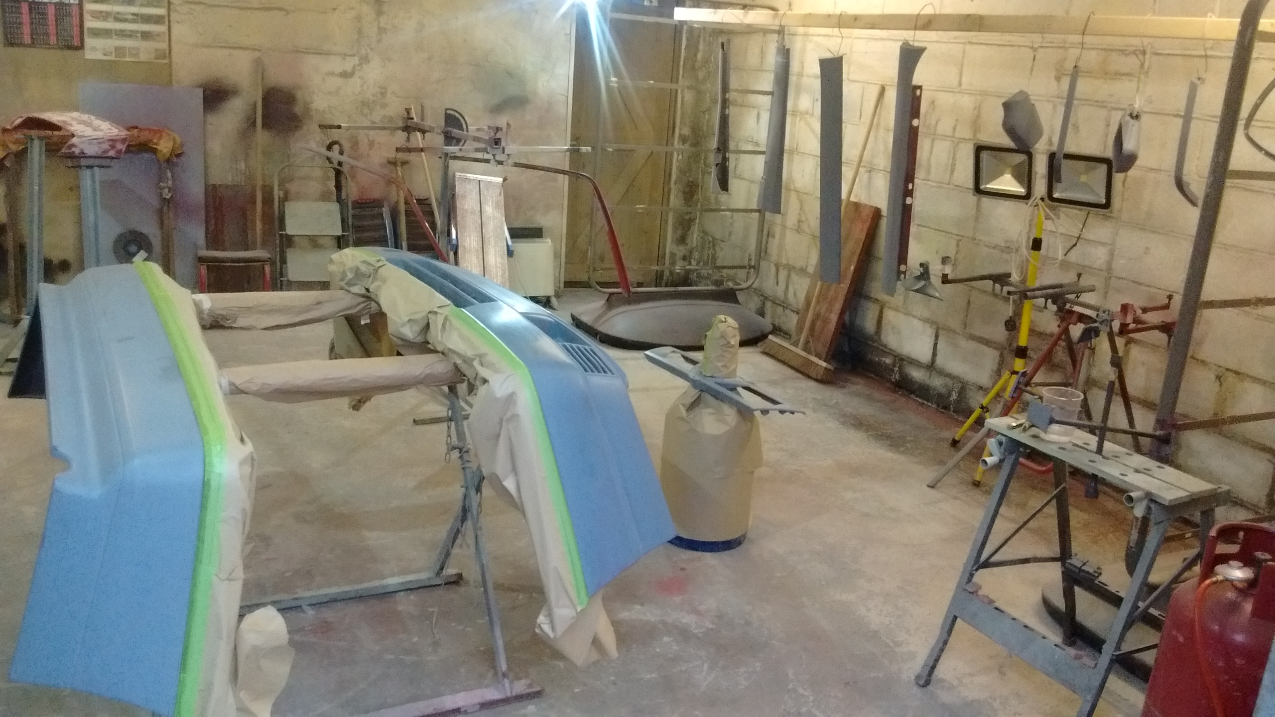

some parts will need painting on all sides so laying flat isn't really an option, I decided that using some double sided tape and sticking them to something to make painting all sides would be best...
some parts like the mirror casings also need paint on multiple surfaces, best solution I found was to tape a loop of wire to the control cables, this will allow me to hang them up for painting
most other pieces i'll be able to hang up when I start priming next Wednesday after the car has gone ;)
all these pieces will get plasticiser in the mix as they will need a degree of flexibility, the parts that don't can just have it anyway :D

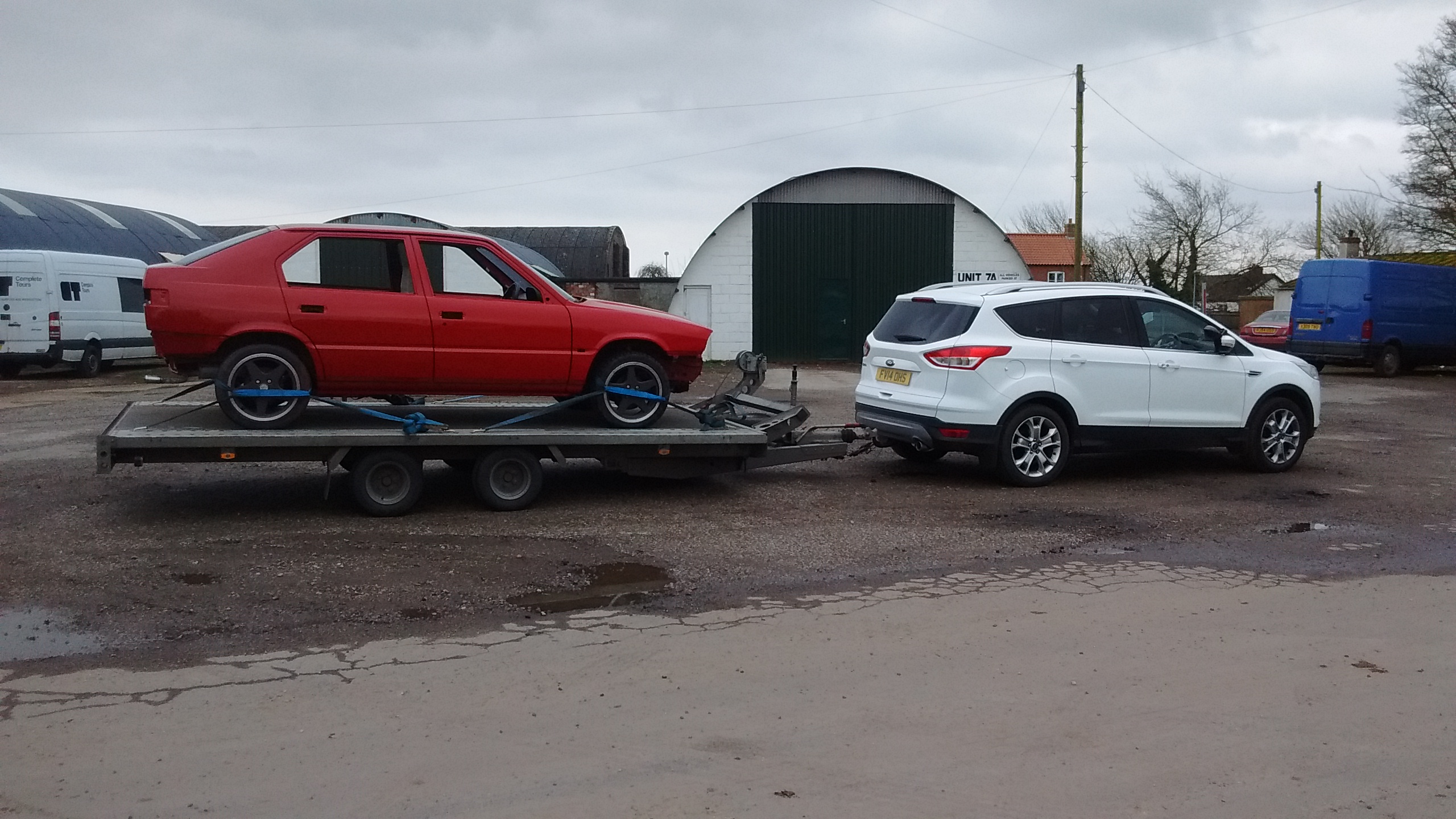

today was the day for the 33 to leave my little workshop to begin its' build up, I'll leave that job to Paul :)

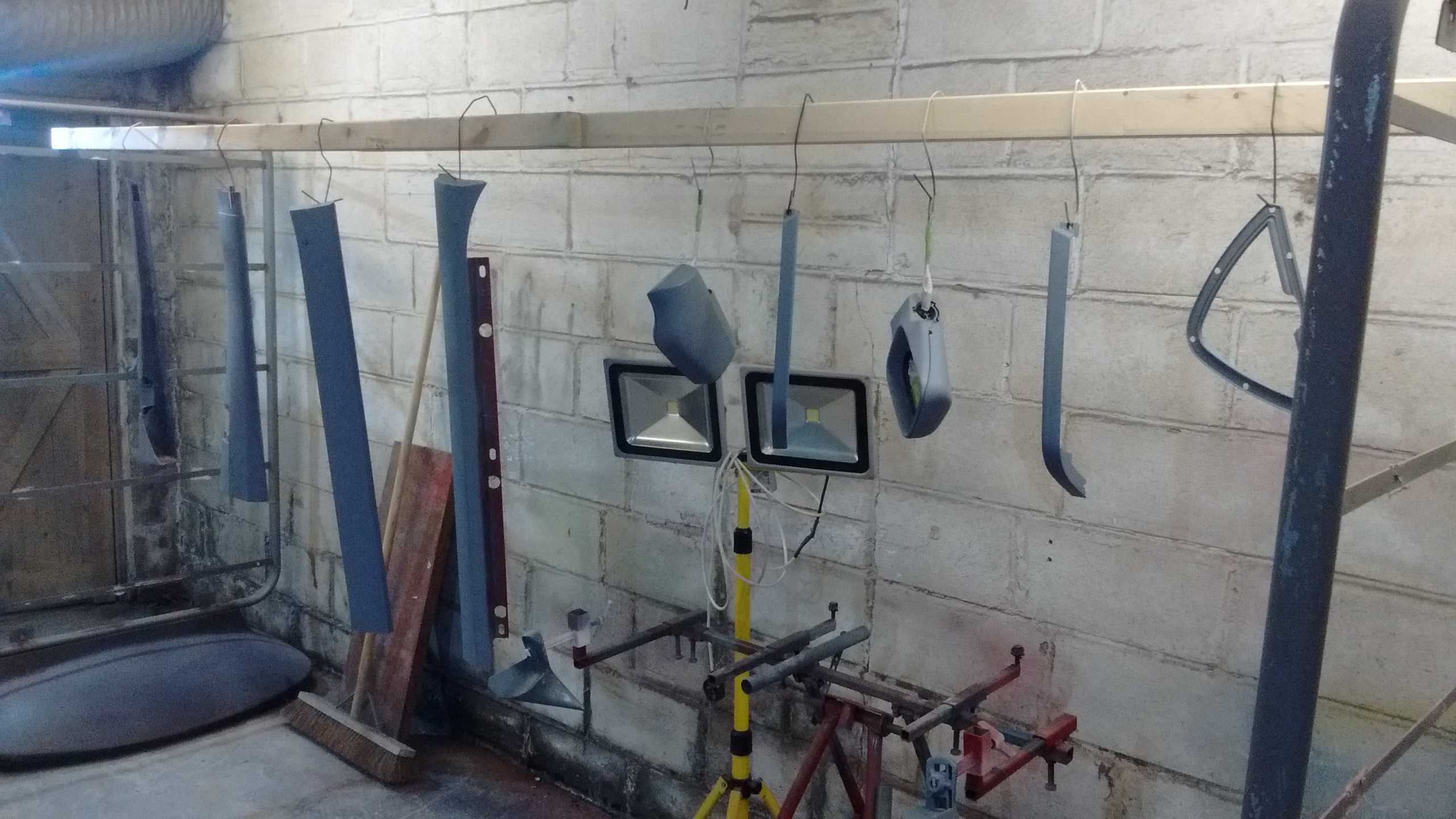

with some space back it was time for a tidy up and then get all the plastics ready to be primed, as I thought they would it all but filled the workshop again!

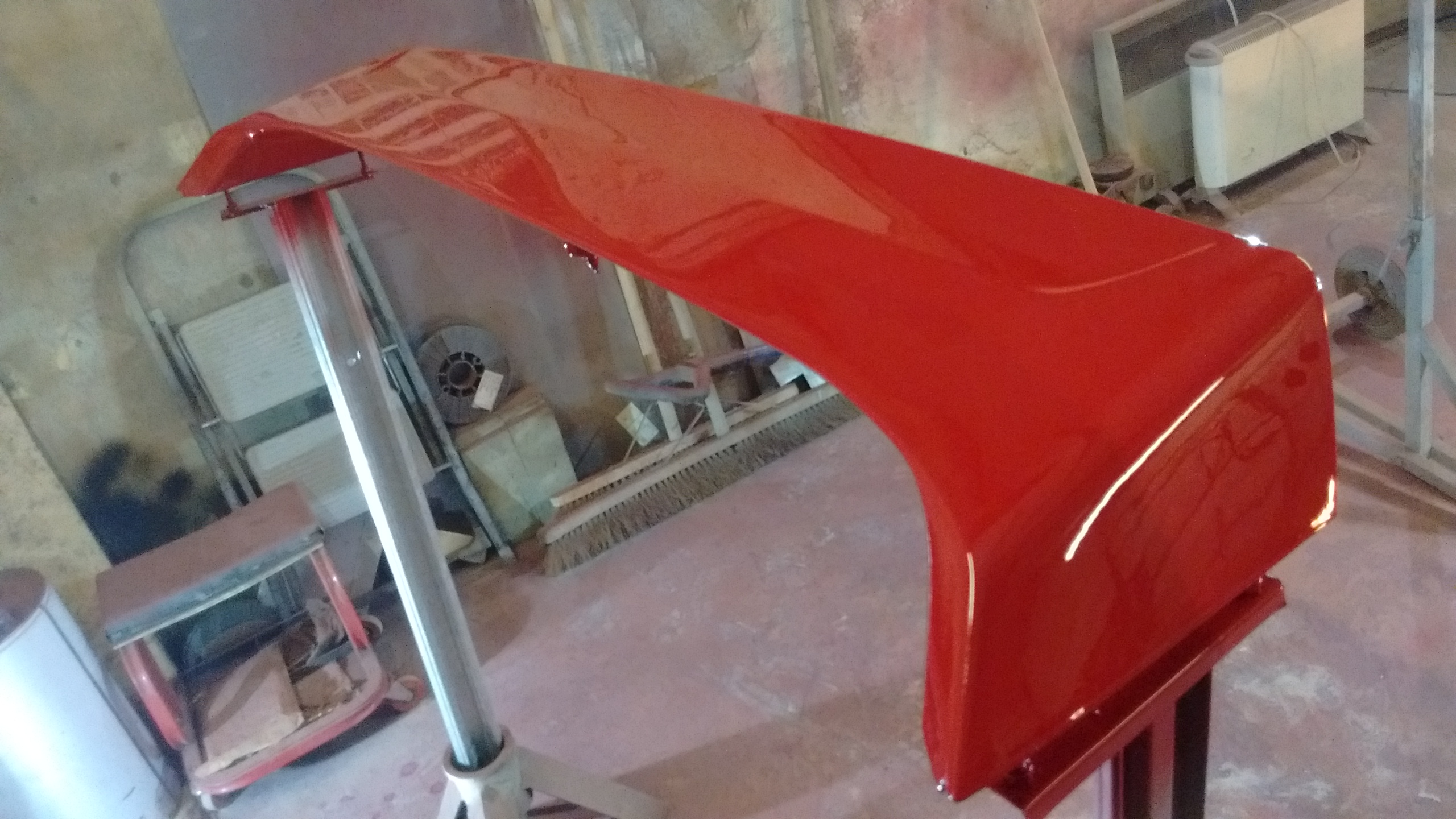

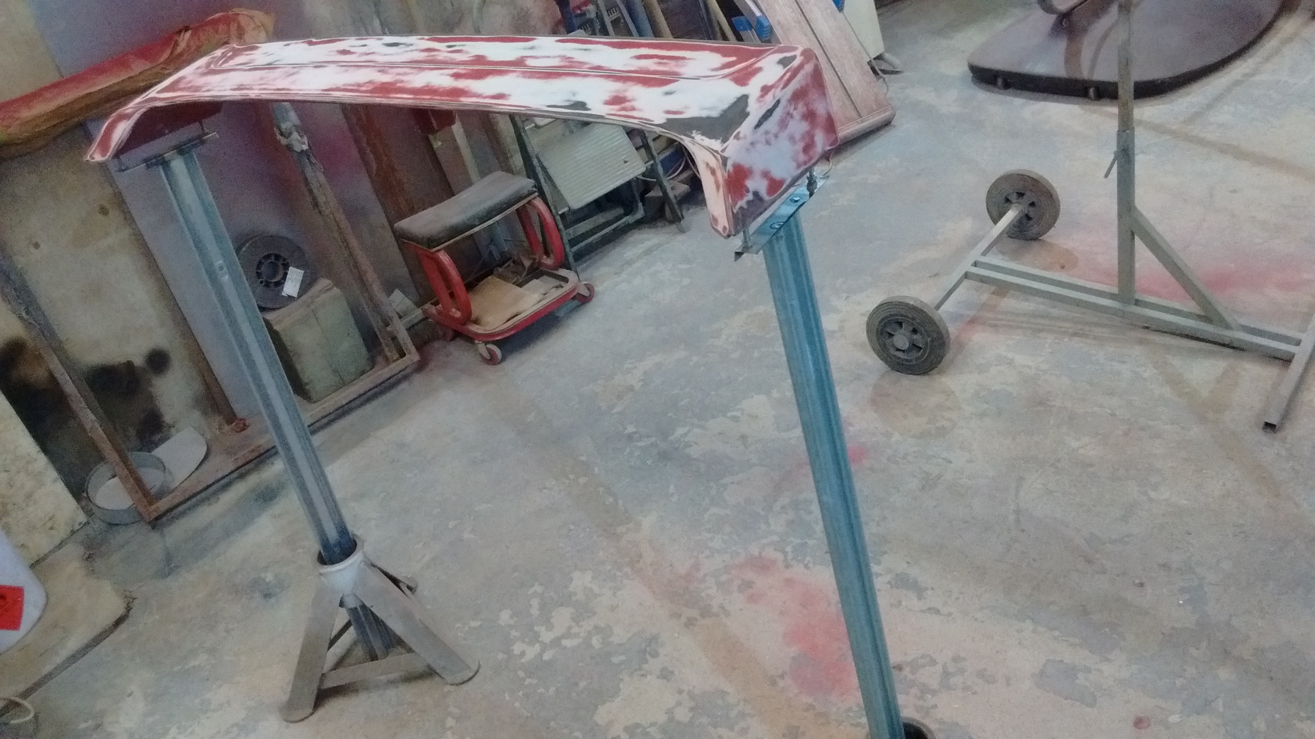

the rear spoiler needed to be able to be painted on the underside and around the mounts so I made up a couple of simple brackets and bolted it to them, then rested in a pair of axle stand bases meant it perched at just the right height to allow easy painting underside and above

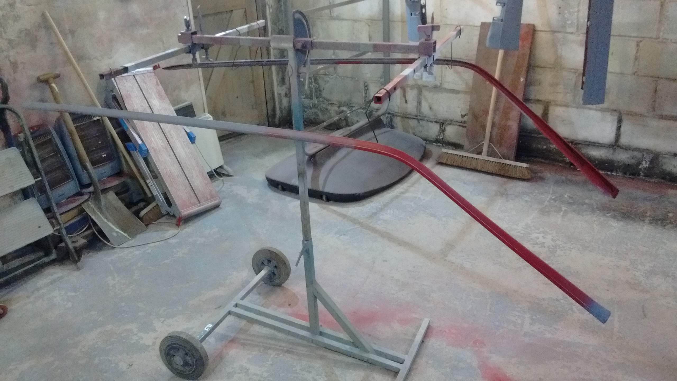

the gutter trims I'd not had space to paint with the shell so they handily got perched on a door stand

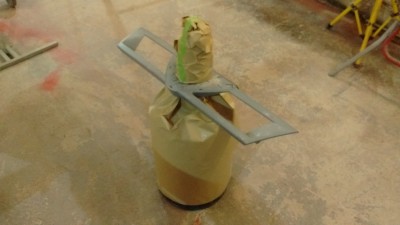

this isn't the grille threaded onto a bottle, it just has a weight on it to stop it falling off the gas bottle when the spray gun blows on it :)
my little washing line of bits and bobs
everything got coated in plastic adhesion promoter then the usual primer with added plasticiser

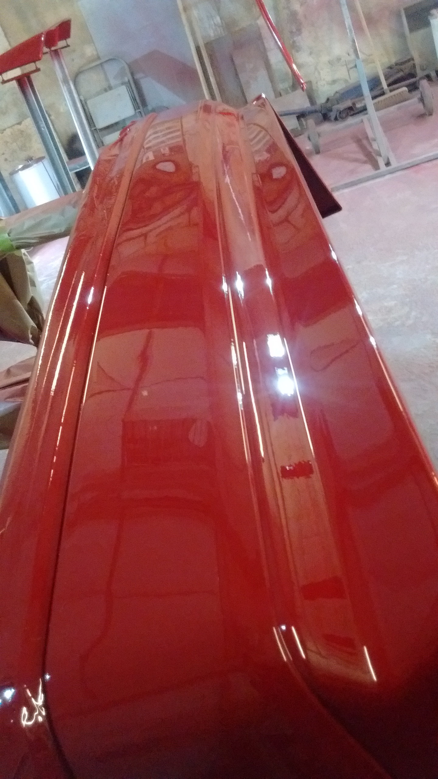

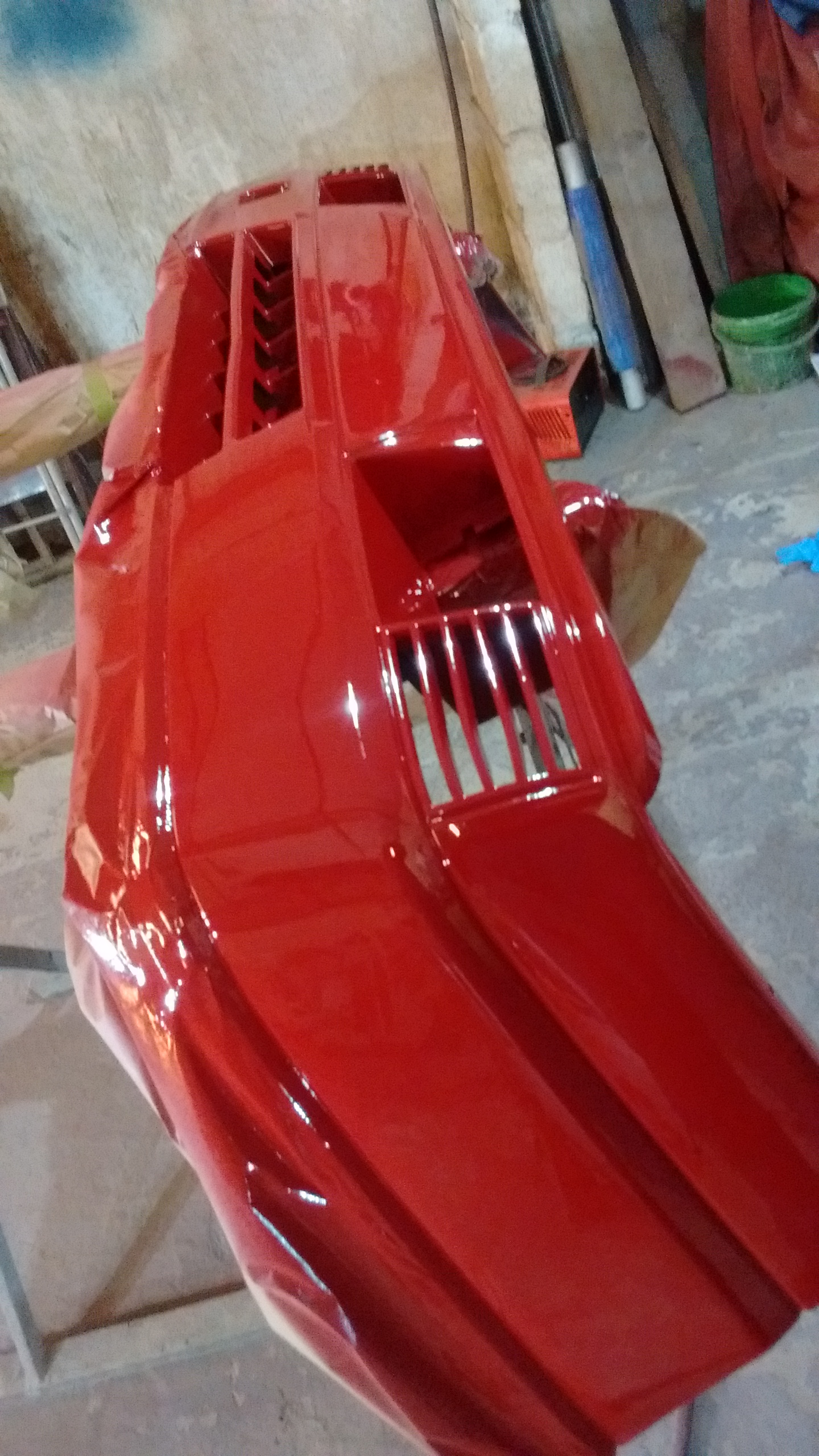

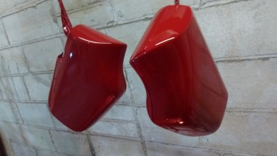

red went on pretty well, tried hard to plan the spraying of pieces to minimise overspray in the air but doing the fiddly bits first and smaller pieces in my hand where possible, did mean I got through an extraordinary amount of latex gloves!
leaving the laid down surfaces until last like the bumpers and spoiler should hopefully reduce the overspray dust to be flatted out
