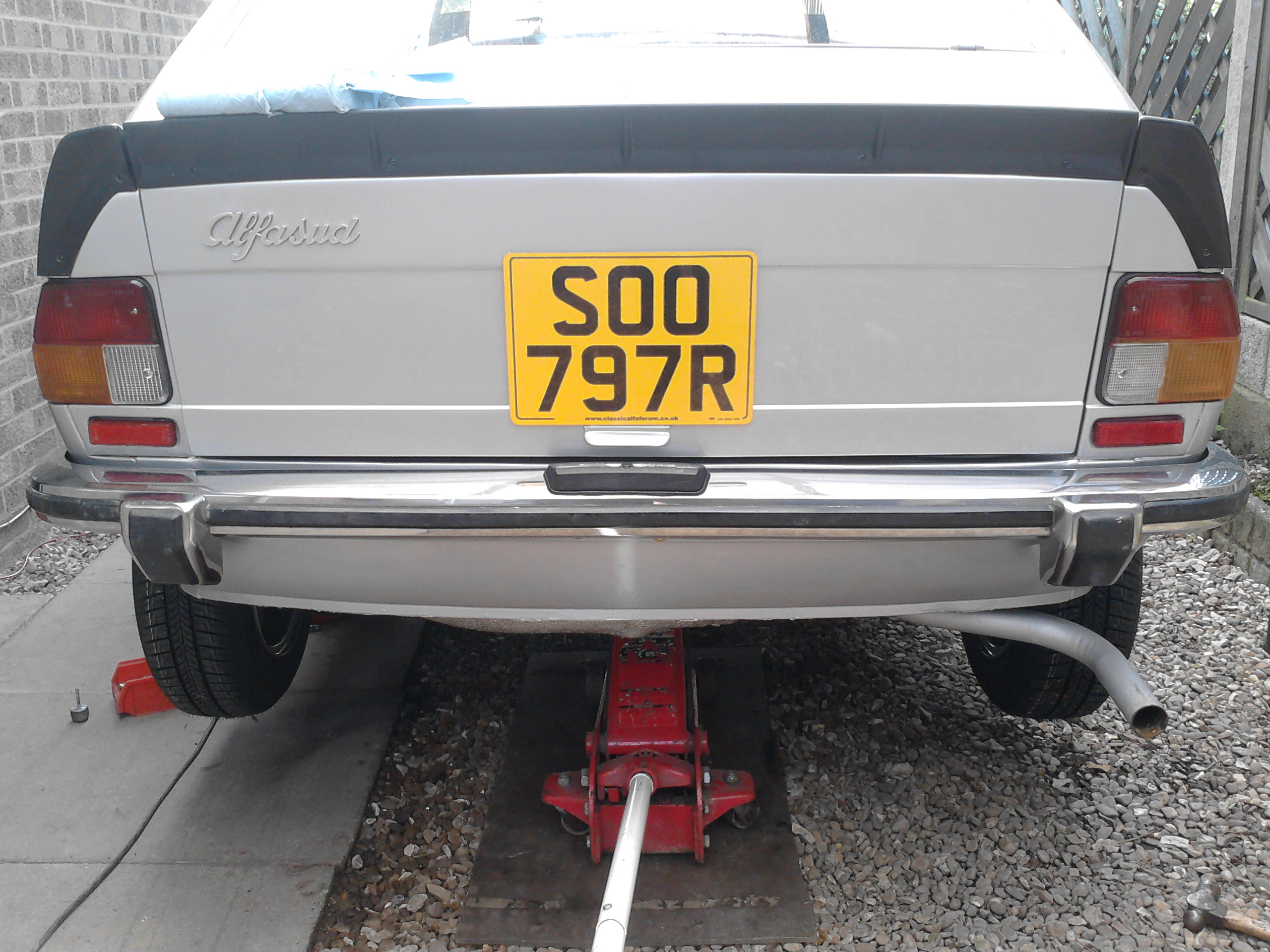

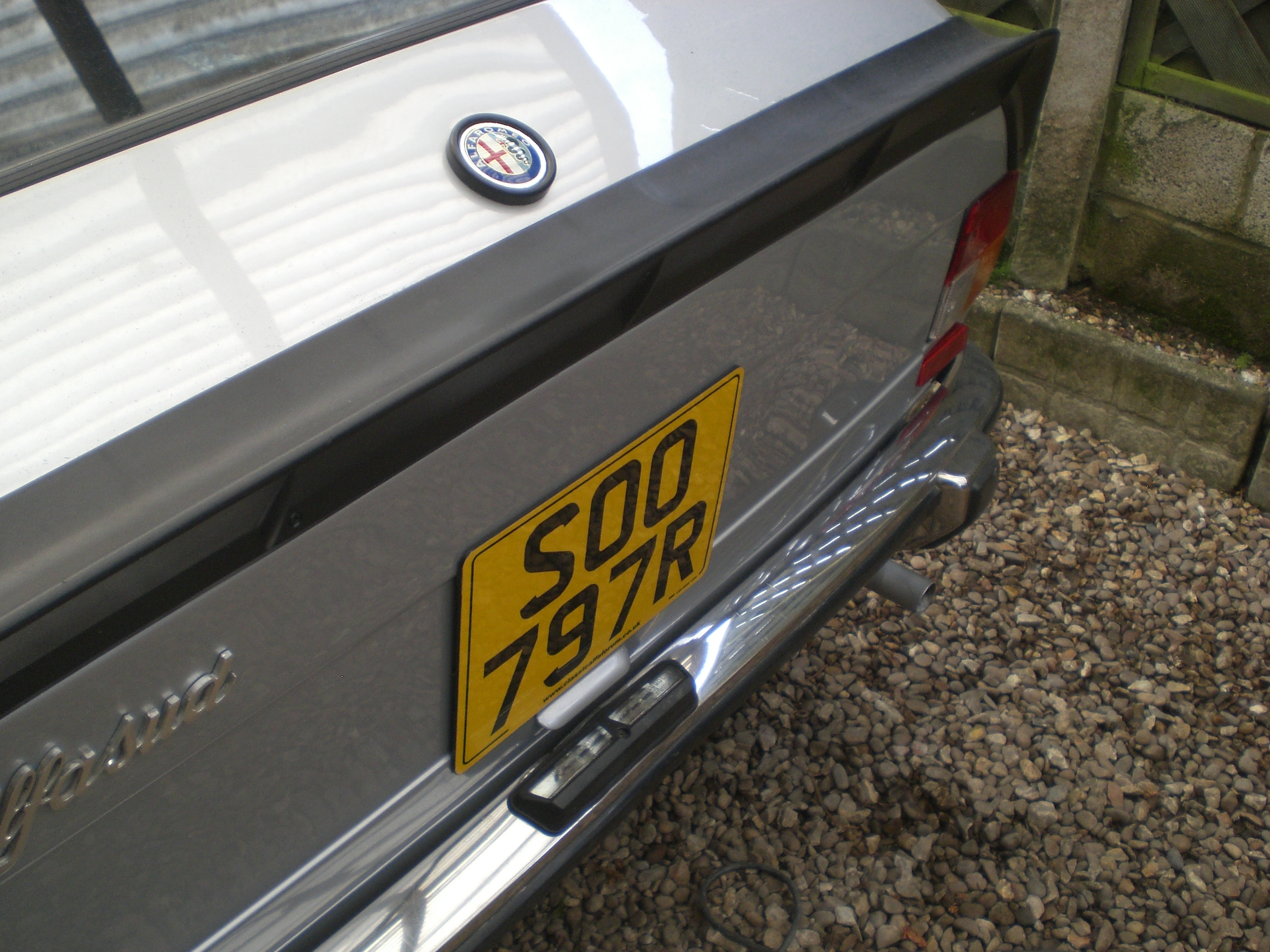

nothing on the mot to check it for a supplyers name, just size of letters and distance between any border
My S1 Sud Ti
Re: My S1 Sud Ti
supplying places aren't supposed to sell them without the plate makers details on mate, loads of places on the web that don't bother with that detail
Re: My S1 Sud Ti
That's what I thought too - is there an exception for classic plates? I got Framptons to make mine up for me, raised white plastic characters on a black background (plus just the plastic characters to clip through the grille at the front) and there was no makers marks on them. There again, the law could have changed since 2008...KevJTD wrote:nothing on the mot to check it for a supplyers name, just size of letters and distance between any border

Spacenut wrote:That's what I thought too - is there an exception for classic plates? I got Framptons to make mine up for me, raised white plastic characters on a black background (plus just the plastic characters to clip through the grille at the front) and there was no makers marks on them. There again, the law could have changed since 2008...KevJTD wrote:nothing on the mot to check it for a supplyers name, just size of letters and distance between any border
I like period plates - had a set of raised plastic ones made up for the Baccaruda too. Modern plates look... too modern somehow![]()
Car is looking superb now Kev![]()
i'd be technically in more hot water for using the black background ones lauren, not supposed to be fitted to cars manufactured before jan 1st '73....
here's the section from the mot handbook, the rules that we testers have to follow...
http://www.motinfo.gov.uk/htdocs/m4s06000301.htm

Spacenut wrote:Wasn't suggesting white on black for your car Kev, as you say it is post-1973, but there wasn't any obvious makers name on the plates I got from Framptons, so I wondered if there was an exemption for classic cars?
I see there is other weirdness afoot - apparently you cannot legally use Ferodo DS2500 brake compound on the road in any car registered after 1999... How do I know? I've just purchased a set of Ferodo DS2500 pads all-round![]()
nothing in the mot checklist to look for makers names on plates lauren, a few guidlines for the border and any message on there, that's all.
for example there has to be space between the border/message and the numbers. so you couldn't have 11 on the reg plate and put a load of TTTT's under it touching the bottom of the 11 to make it look like a U
the makers name thing on the plate i believe comes from all plates are supposed to be traceable to where/who made them in case of cloning. to make plates or be supplied plates with your name on them (for example a car dealership) you need to be registered with DVLA or the makers name will be automatically put on them. as always there are numerous companies that are willing to ignore the rules..
didn't know that about the pads though, but begs the question....how would anyone tell? not like there's any checks an mot tester can do
bit like selling a gun to someone and asking "do you promise not to shoot anyone?"
"yes"
"ok, here you go"
as long as they've asked the question then they relinquish responsibilty.

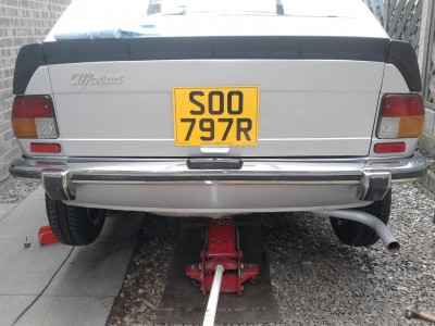

today i sorted out a long list of the little jobs that i'd put off for ages, quite a productive day
finally managed to change the leaking reverse light switch. worried about how much oil had been lost, quite a puddle on the gravel where it's been parked. was gonna ask the mot guy to top it up for me but although it's less than a mile away i didn't want to risk it. topping up the gearbox oil is a pain, official! made up a bit of hose connected to a funnel and poured some in from above which worked out ok. as it turned out almost 1/2 a litre was needed so amazing how much a little dripping part can lose.

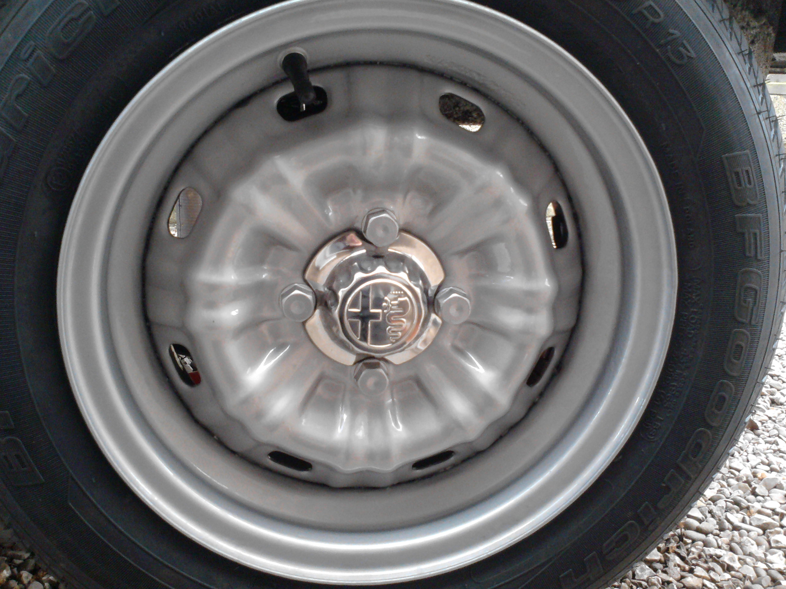

all wheels now on too.

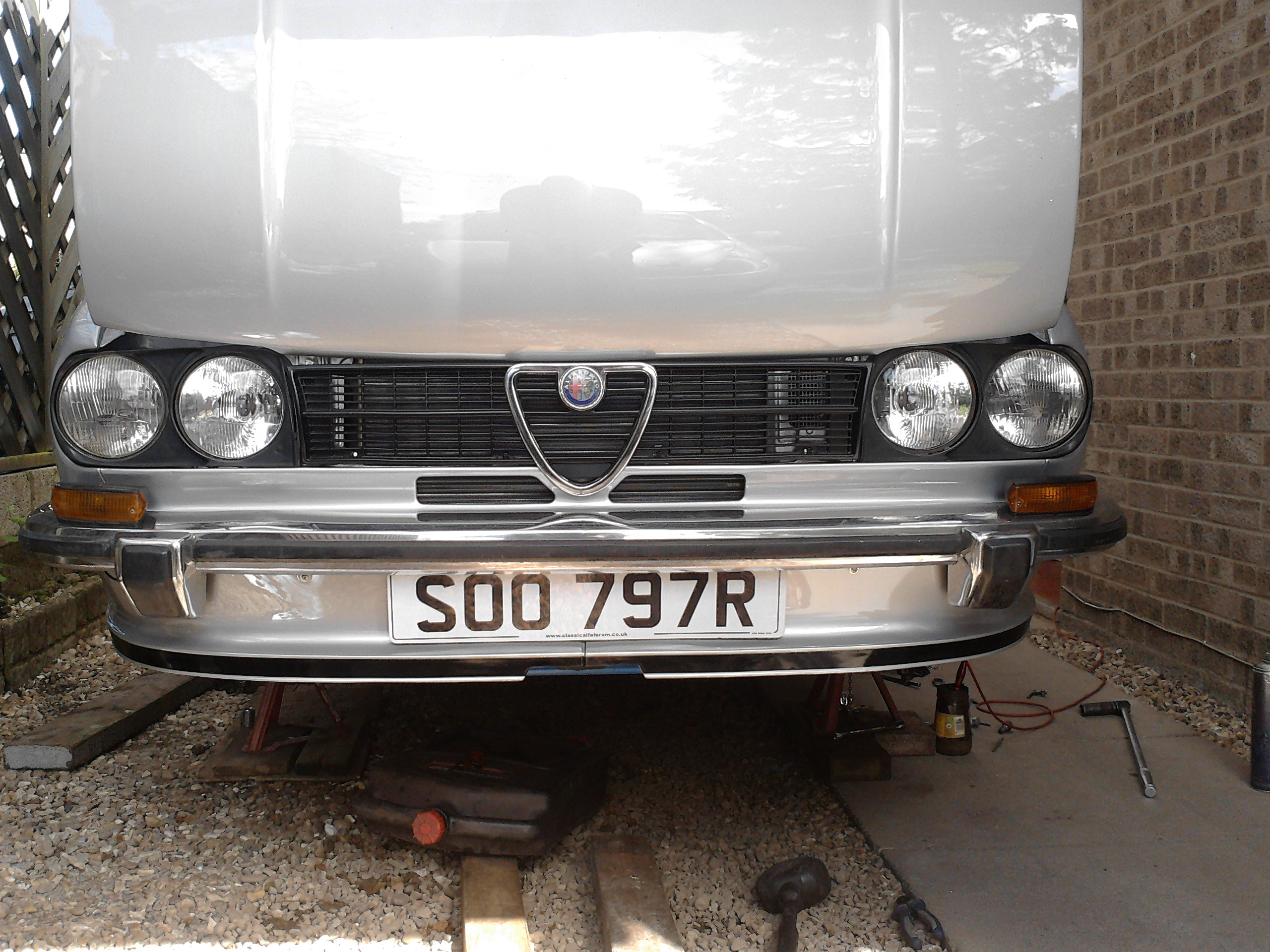

decided to stick the number plates on with 3M tape rather than drill and screw them.
loads of other little jobs done so not a bad day

outside almost done....

that tail pipe looks a bit long - do you think you will trim it back a bit when you get a moment?
Alfa Mito 1.6JTDM-2 QV Line
Re: My S1 Sud Ti
Bluesuit wrote:that tail pipe looks a bit long - do you think you will trim it back a bit when you get a moment?
do you know what mate, i looked at it on sunday and thought of you
it'll get the chop this weekend

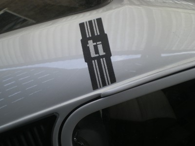

finally got around to fitting the rear quarter ti emblems....the debate about whether the car should have them or a boot ti badge is still ongoing, but i have these badges and don't have a boot one so an easy choice

were did you get the fabric Ti 1/4 pillar stickers from?

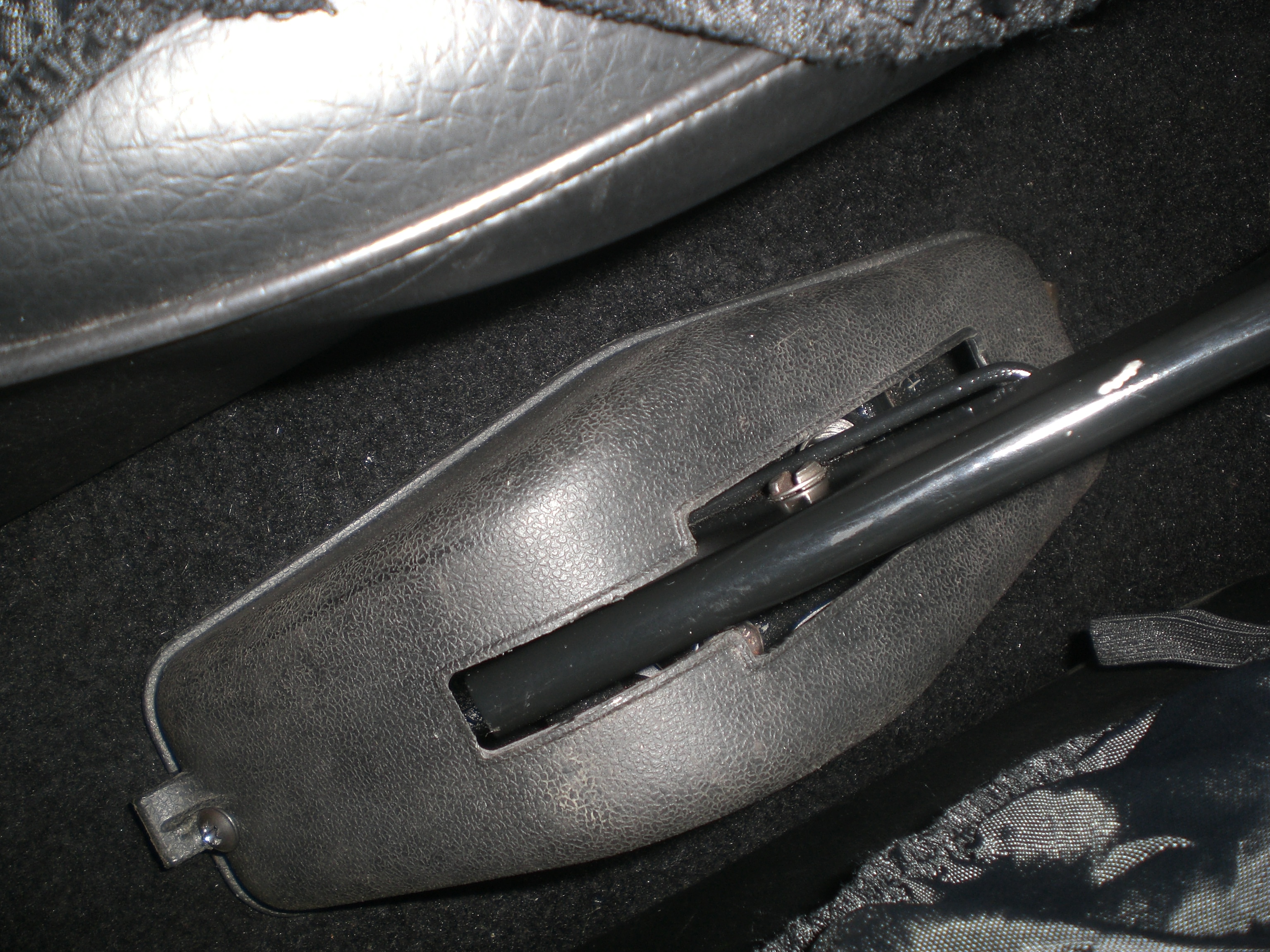

tidied a few more bits up today, car is as ready as it's gonna be.

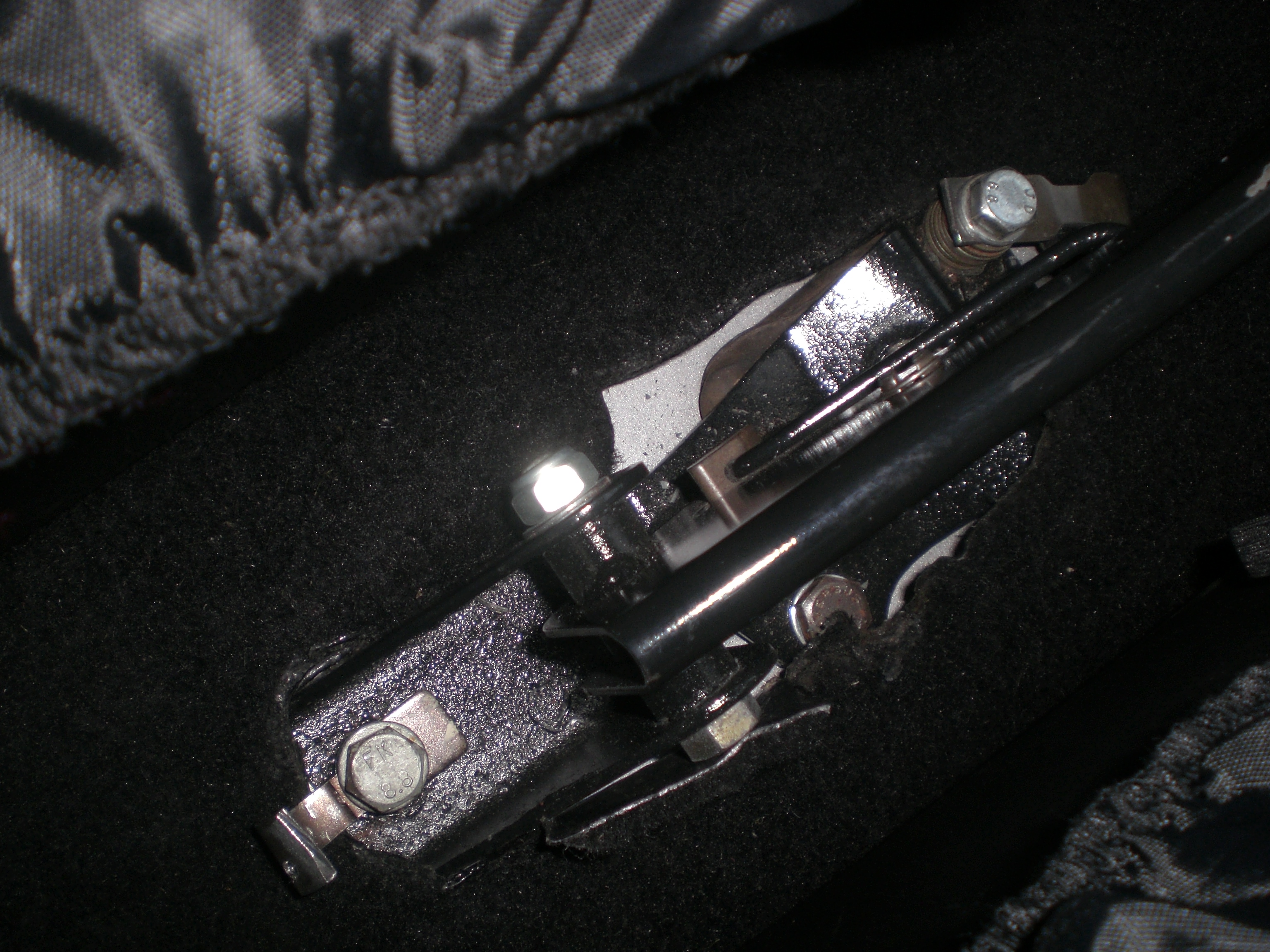

managed to fit a few more trim bits including the hand-brake lever cover. made up a couple of little brackets to hook the front end and a screw through the rear end which is how it had been fastened before so at least i wasn't making fresh holes in the plastic!
managed to drill into my thumb though which smarts a bit, pulled quite a bit of flesh out and leaked a bit..my own fault for not using a vice...

fabric ti badges came with the car liam, they are probably old original ones judging by the age of the backing paper. i know steve parry had some made a few years back, might be worth asking him.
