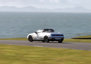

Re: Race Spider project.
I’ve tried to upload a video but it’s says the plugin isn’t supported ??
So here’s a still
So here’s a still

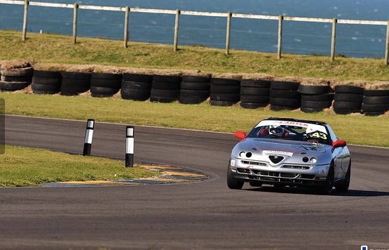

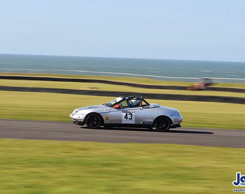

Some track shots from Anglesey
Anglesey looks nice.
Like the middle photo, car looks great.
Hi Keith . Yeah Anglesey (or. Ty Croes. Trac Mon) is a really pretty venue with some stunning scenery . As for the track it’s a Fabulous circuit. It really flows with some decent speeds being achievable and with lots of room with the track being nice and wide we’re running TOYO R888 and had bags of grip. Sadly we had a problem with Loss of oil pressure. I’ve now got the Sump off and it’s done for the crank on both mains and big ends. Luckily I’ve got a spare engine which I’ve started to check out today and swap it next week. we’ll then rebuild the other over the winter and may even build it to a higher spec and aim for 400- 450hp .
