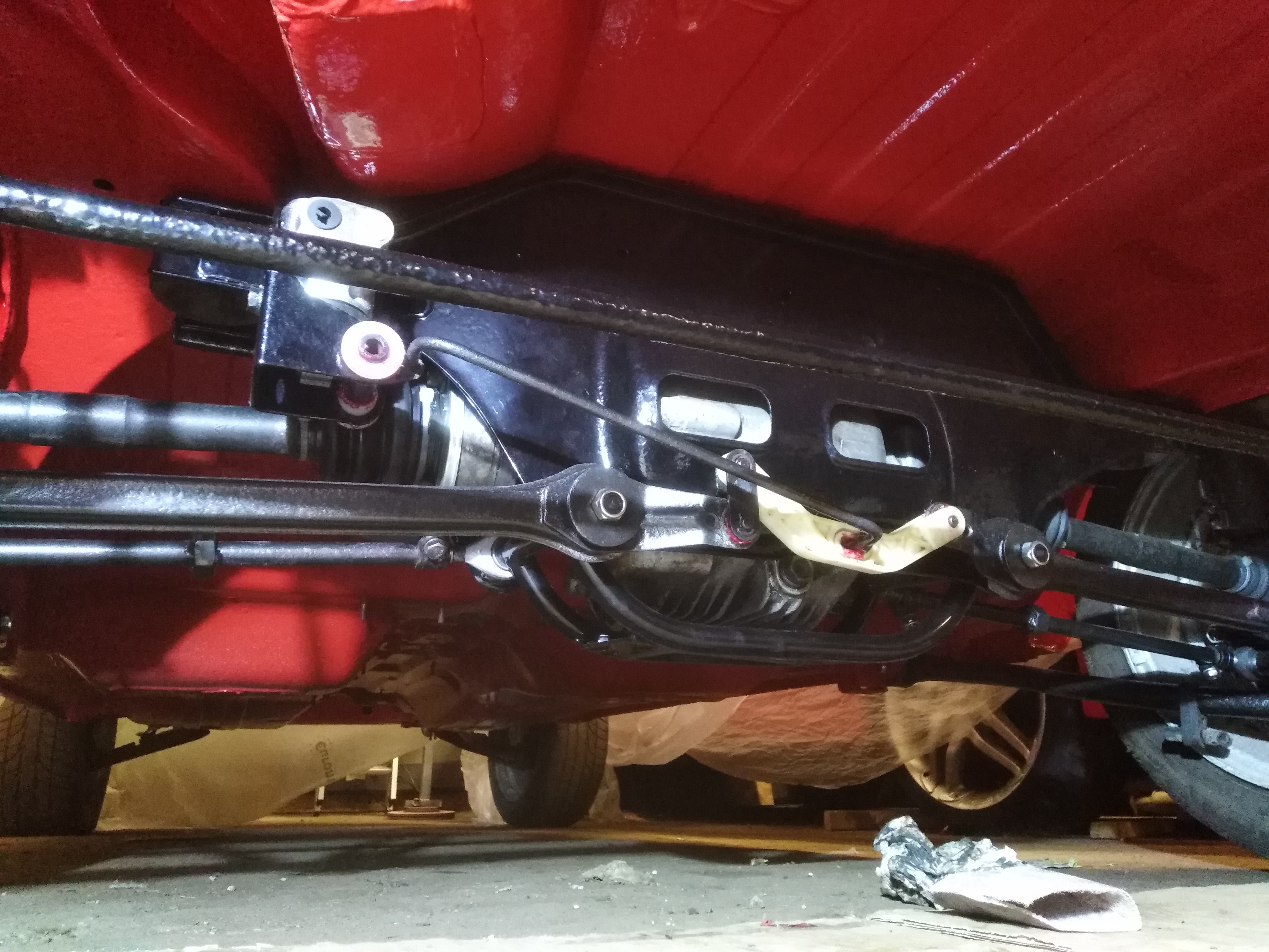

Posted: Tue Nov 20, 2018 11:05 pm
by KevJTD
I need to clear a few parts out of the shed to make space for the engine rebuild so I gathered up all the rear suspension bits and headed up to the unit this afternoon to fit the stuff that will be staying on rathe than the temporary stuff fitted just to move it.
The diff bolts from above the rear subframe so the freshly powder coated one had the mountings fitted back on ready for the diff
To assist fitting the subframe back to the car I used the 2 long studs I made up for fitting the back axle on the 155, the assembly bolts to the floor with just 2 big bolts so jacking it up and trying to get the bolts lined up would be a pain.
Once jacked up to the floor simply wind the studs out and replace with the proper bolts.
These handy home made long studs have come in handy a time or two now

Driveshafts got all new boots and metal cages, freshly packed with CV grease.
Hubs had already got new bearings and been painted up, arms had good bushes or new where needed.
Takes time to fit stuff back up as I make sure everything is cleaned and either greased or painted so that it will all come apart in 10 years time should it need to.
Still got the rear anti-roll bar to fit plus the brakes before the back end is together, I'll sort that out Saturday.
You may notice the little cradle that sits under the diff. The original cars didn't have anything there so the fairly weak pressed steel subframe had some flex in it, this little frame was fitted to the rally cars to stiffen up the diff carrier/subframe up and hopefully make the suspension location more positive. Plus it looks nice
