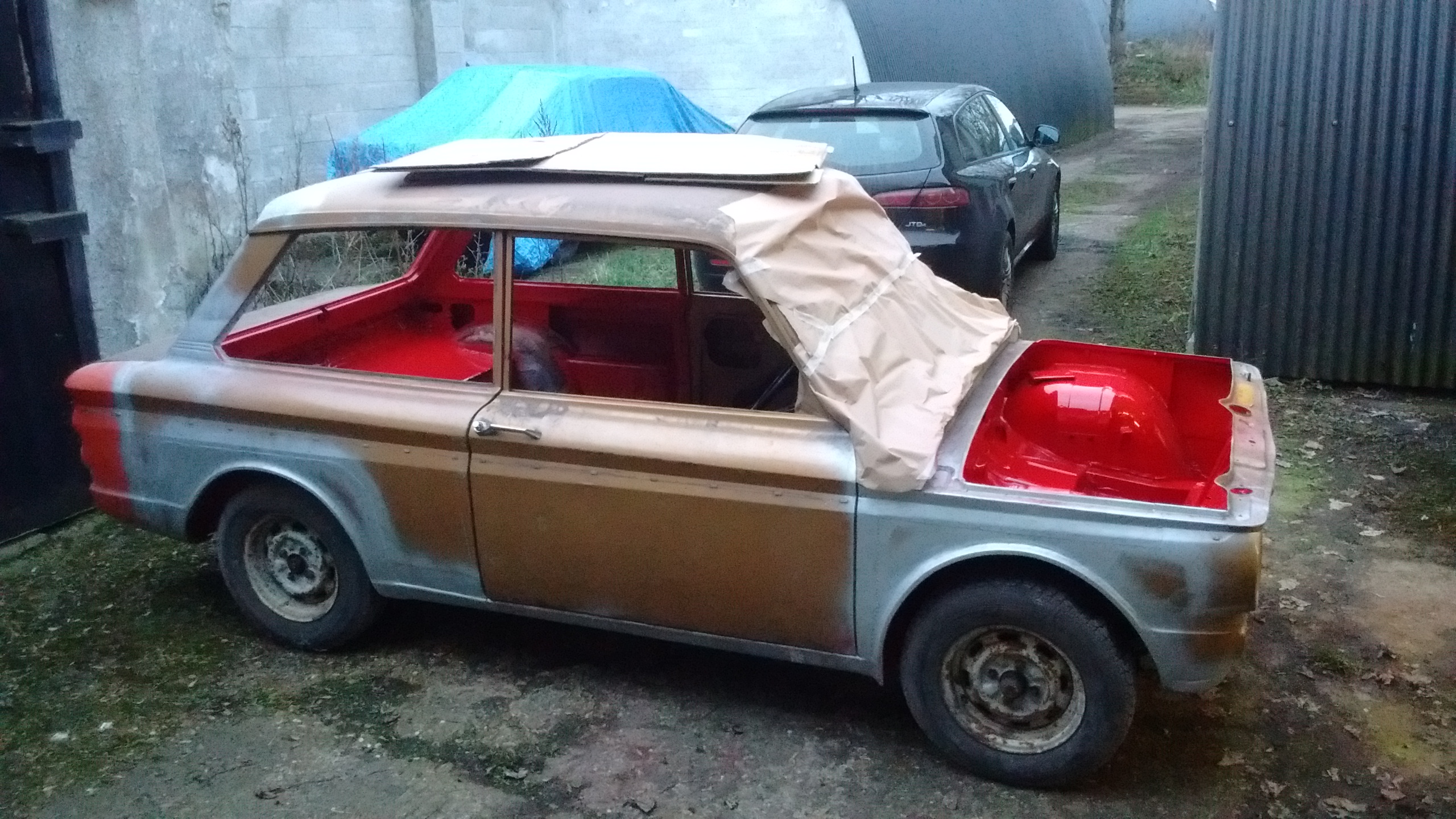

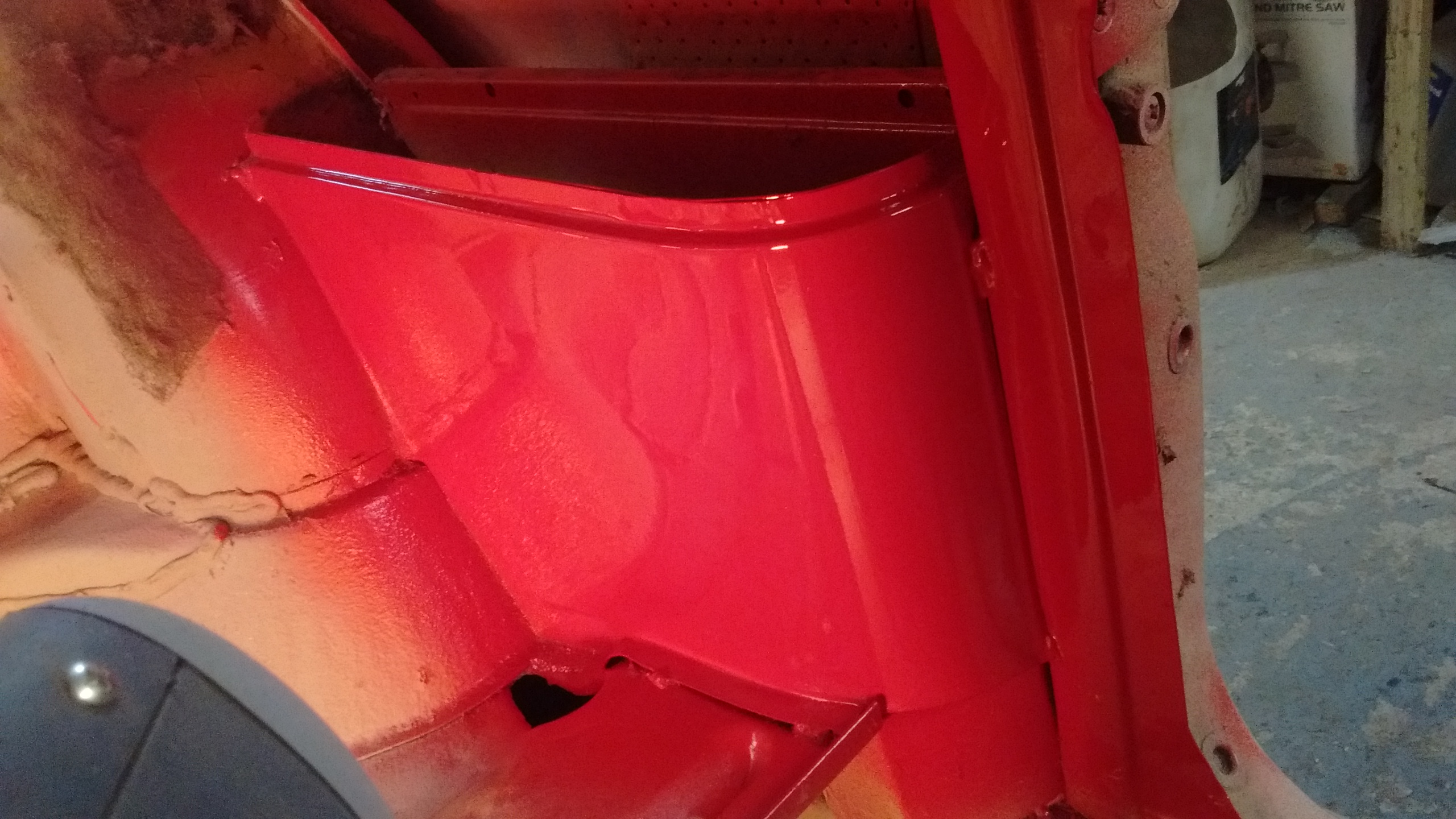

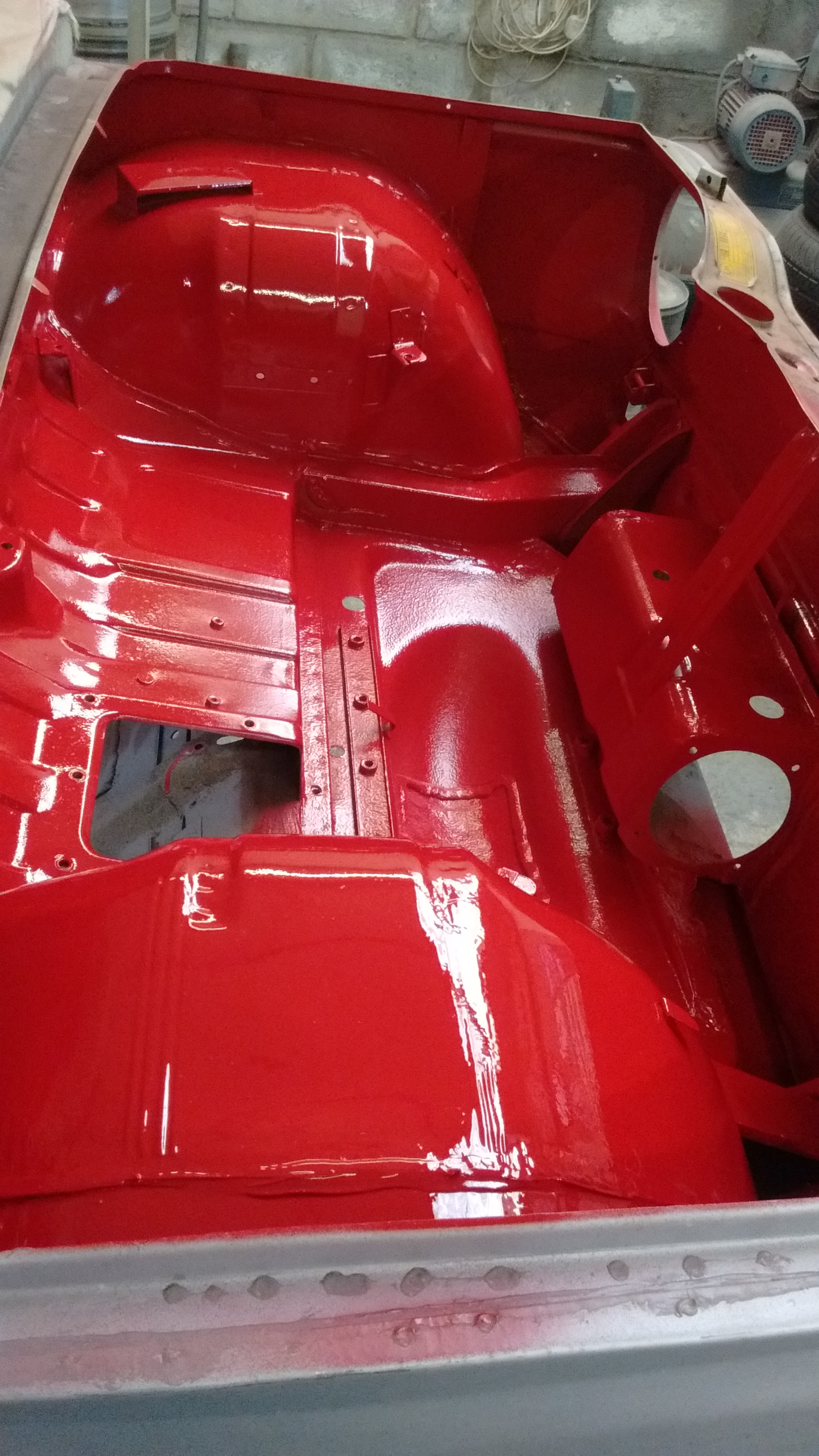

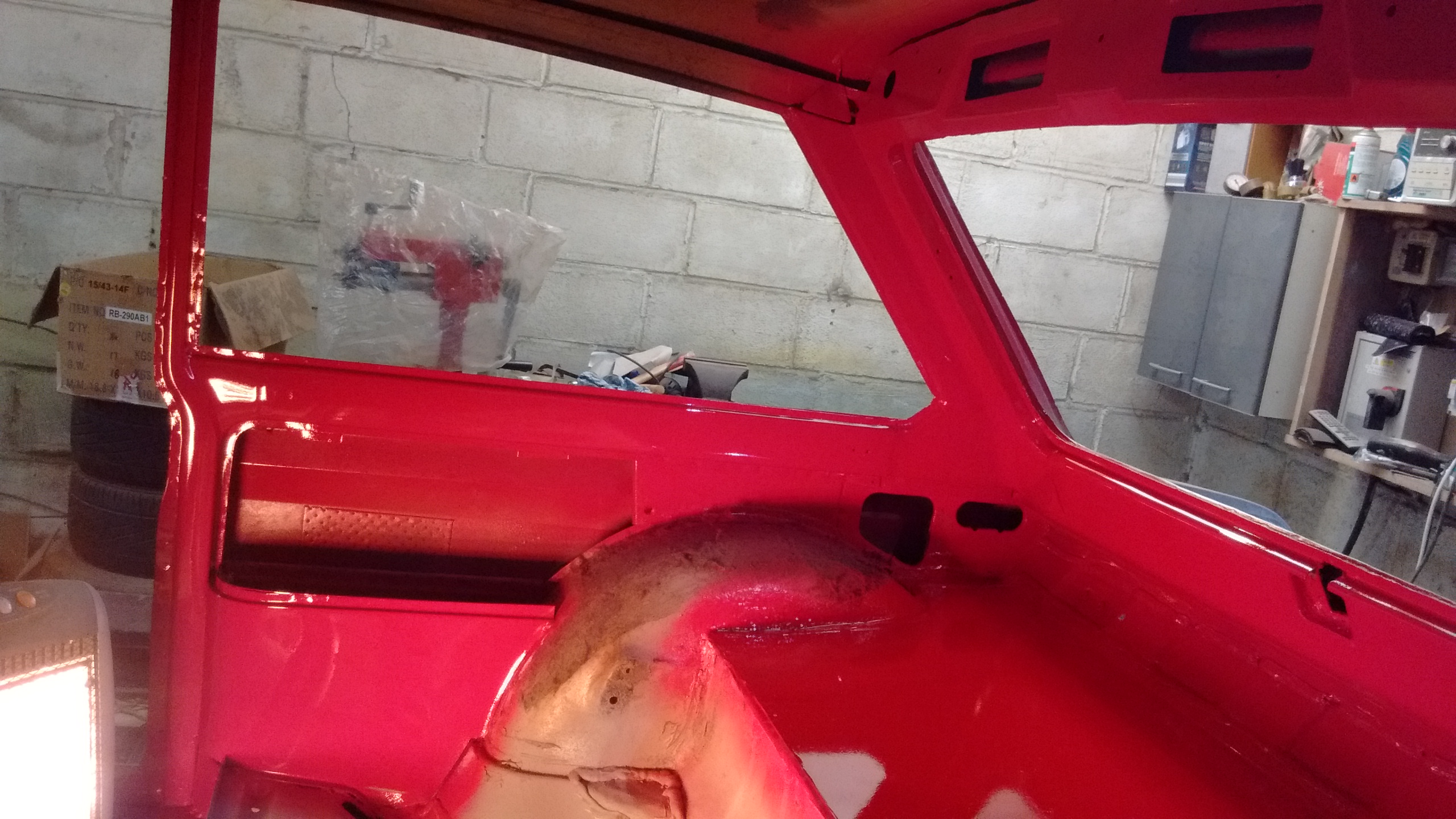

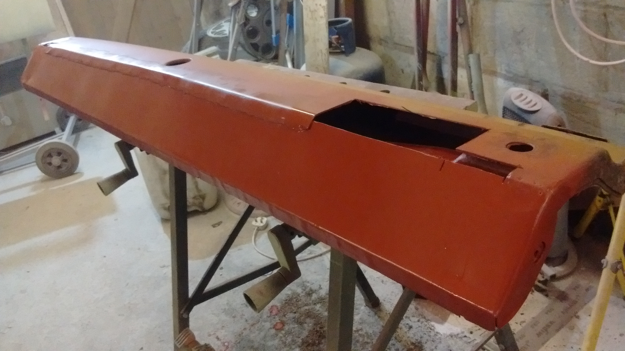

only a morning today to get some red on, this afternoon I had a nice ride out collecting Johns' 205
so once a few little marks had been tidied up with some stopper the rest of the primer got a smooth down with a 320 pad, no need to get too carried away on these sections.
the red was actually a bit fiddly to get into all the awkward bits on the front panel but happily it seems I didn't miss any bits
then onto the rear section of the car where there is a lot more visible metal than nowadays, the rear side bin looks pink but it's just the heaters' reflection
see

Very nice
The heater adds some nice mood lighting, I've noticed

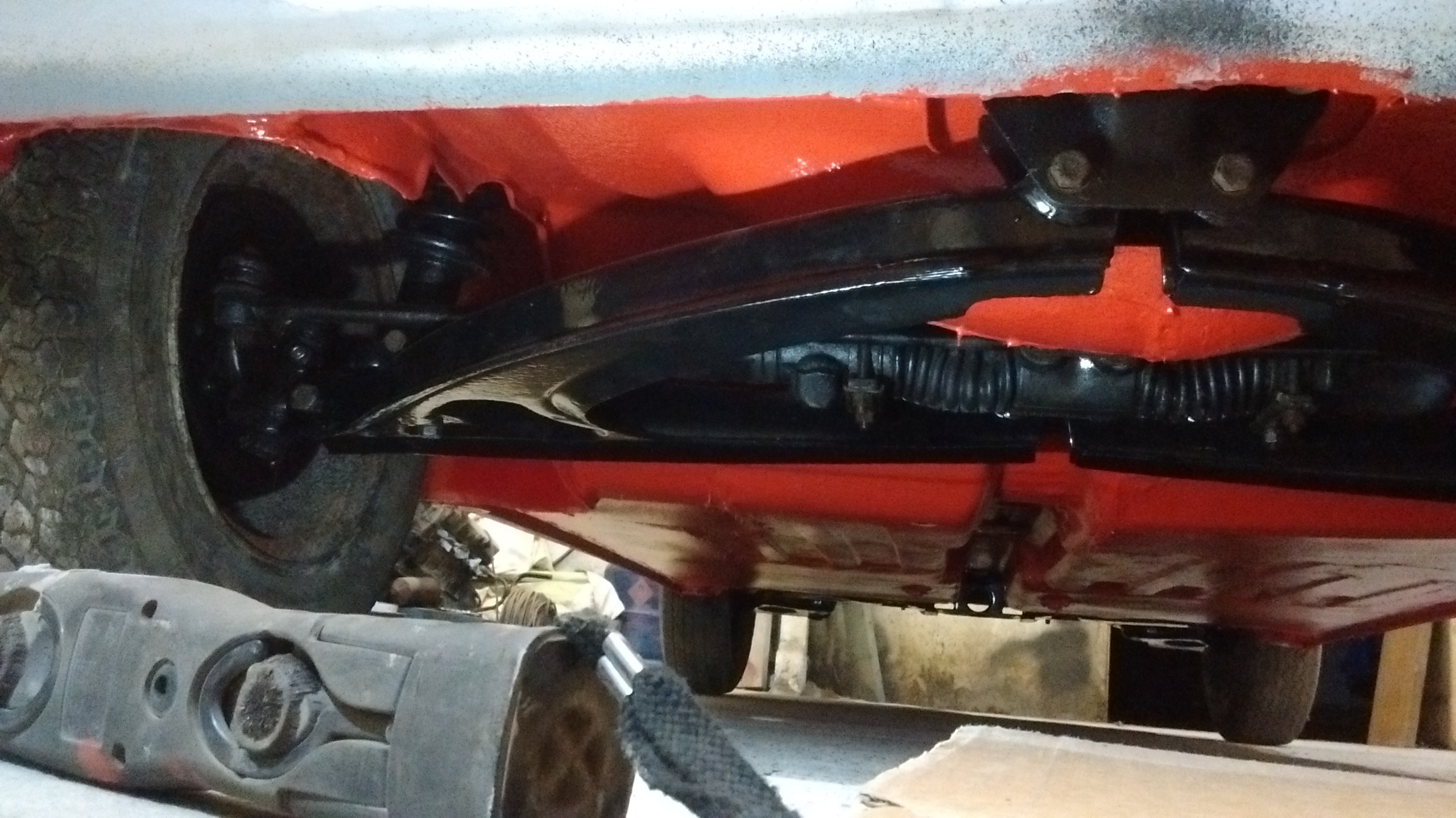

with rob's help we got the suspension back on the little Imp ready for it's sabbatical outside for a couple of weeks, first time out in daylight for some time
I did the kingpins yesterday, not too hard but time consuming....luckily we were quiet enough at work
all suspension parts have been cleaned and painted, complete with lowering springs.

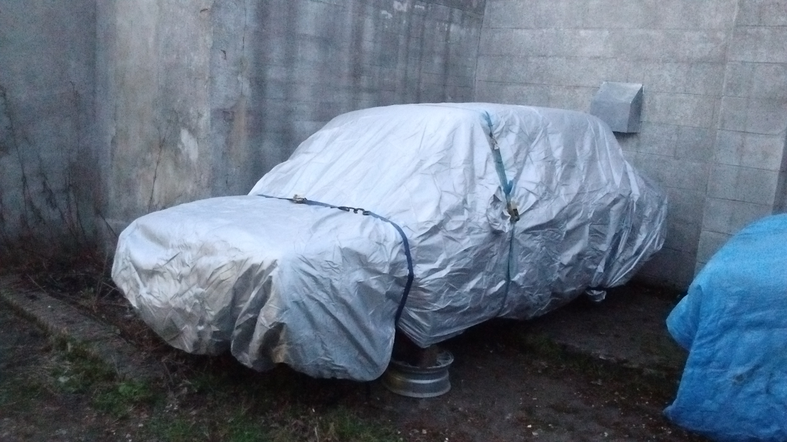

nothing done on the Imp today, apart from it getting a new home for the next few weeks

nothing much to add on this thread for a little while....

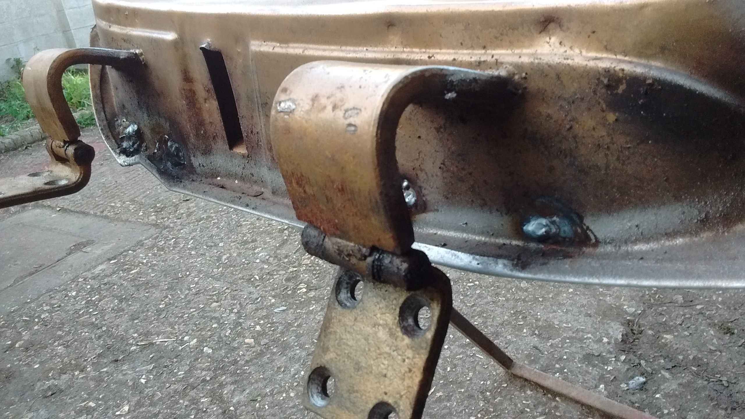

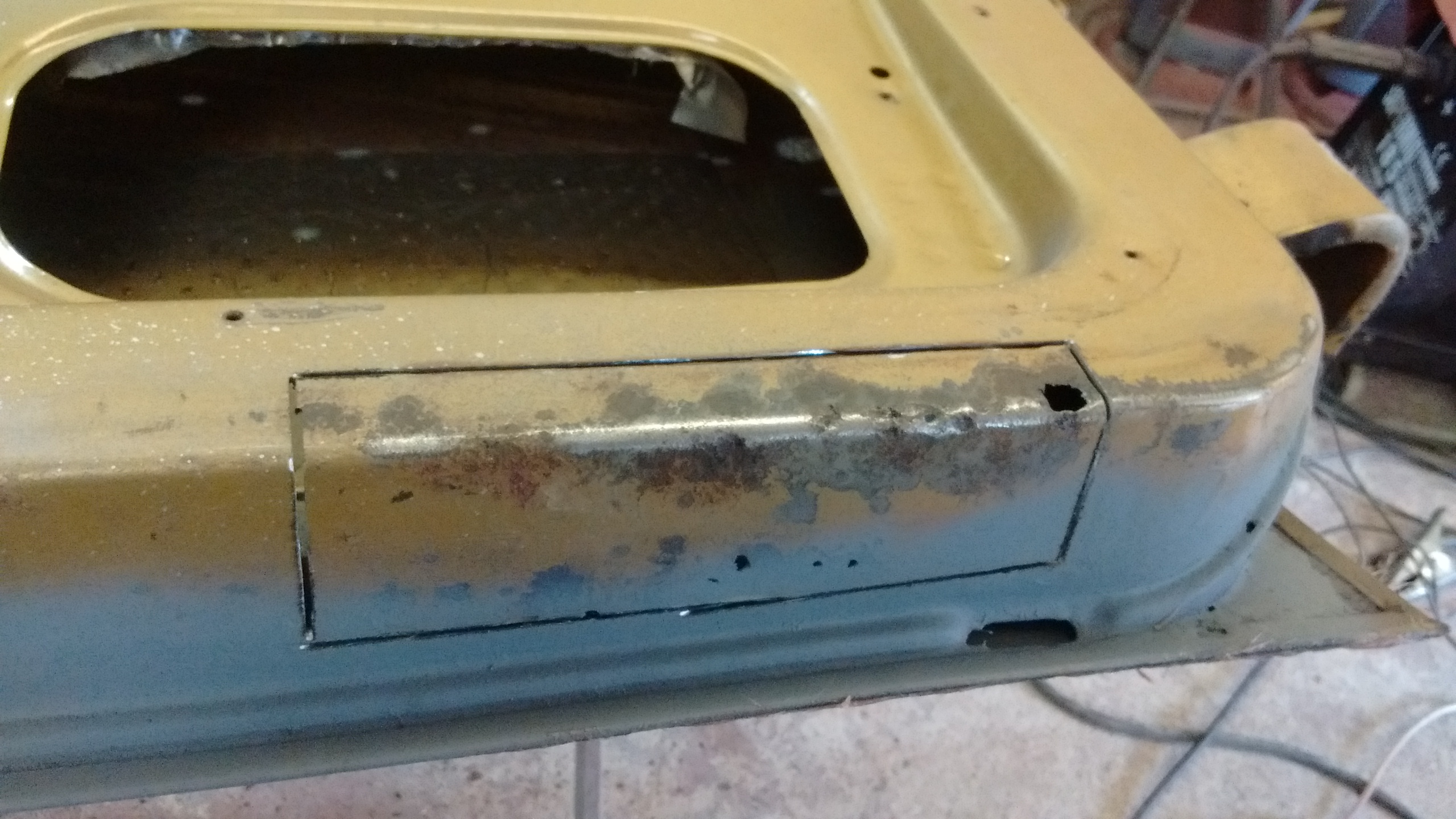

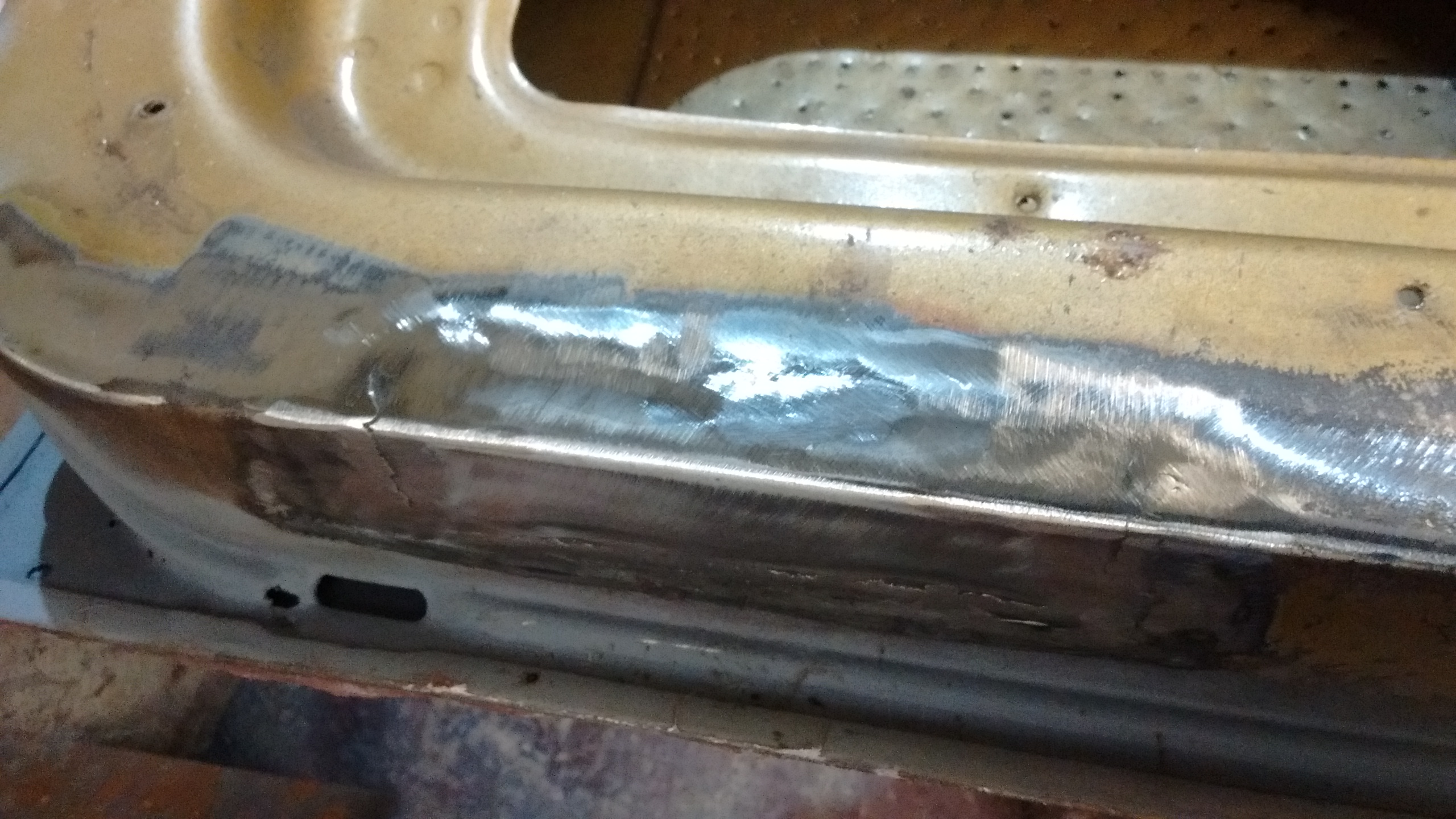

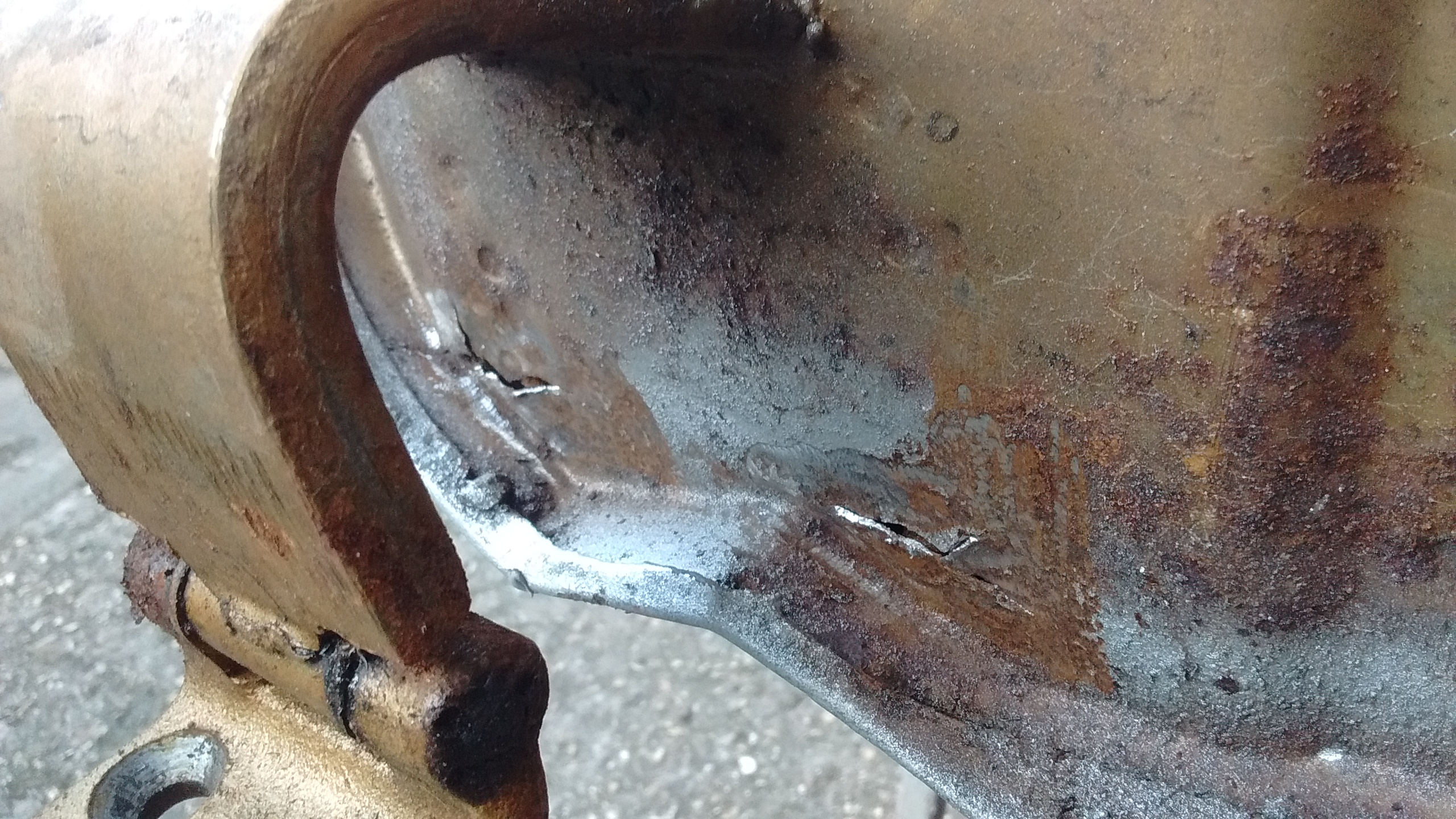

an issue that the car has had since day 1 is the drivers door which had some flex at the hinge area which allowed some droop and very poor fit, with the door off it was plain to see why it was flexing!
the bottom hinge was also starting to pull away so both got cleaned up and welded up, I may well add a strengthening bar in too for a belt and braces repair
with a 1mm spacer plate made up to bring the bottom hinge out a little the alignment and shut is very good now
there was some big dents in the door too which mostly popped out but had left some nasty creases in the swage line, they have come out pretty well now and will require very minimal filler, not being able to get a hammer to the back of them stopped it getting any better but it's more than acceptable now
i'll aim to be making swift progress on it now as it really does need to get going, only a little thing so once the doors are repaired it shouldn't take too long to get all red.....

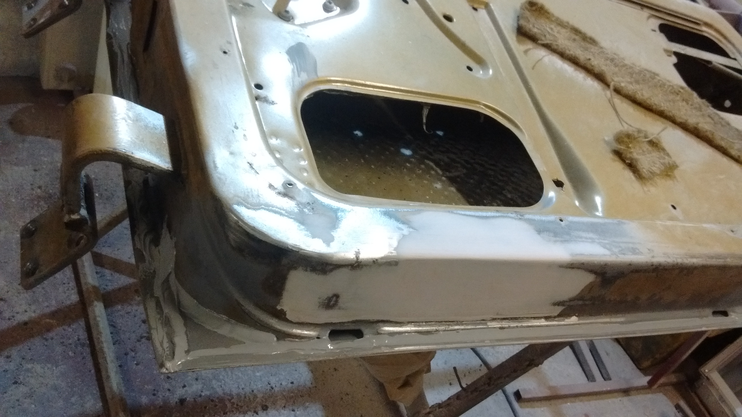

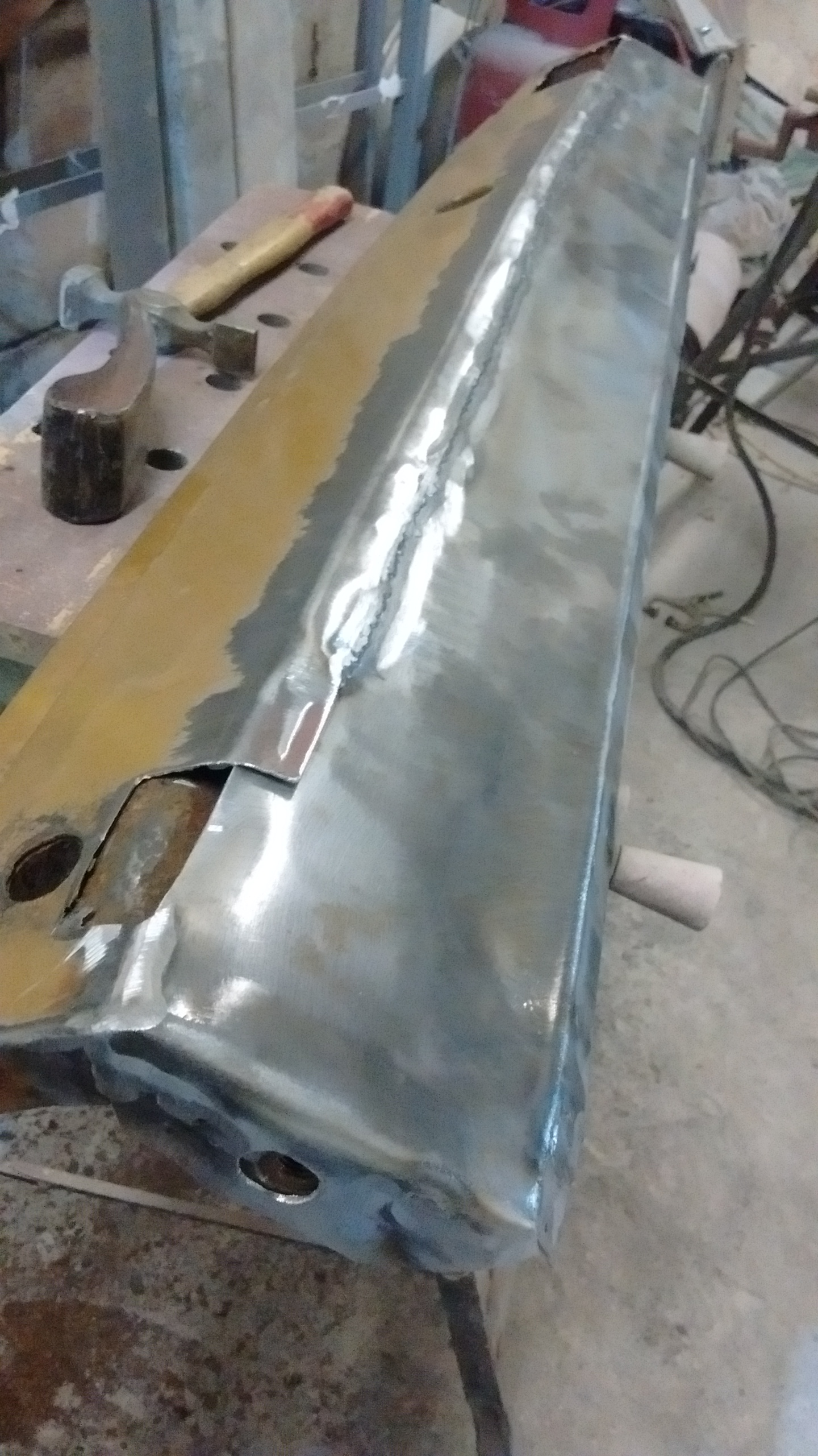

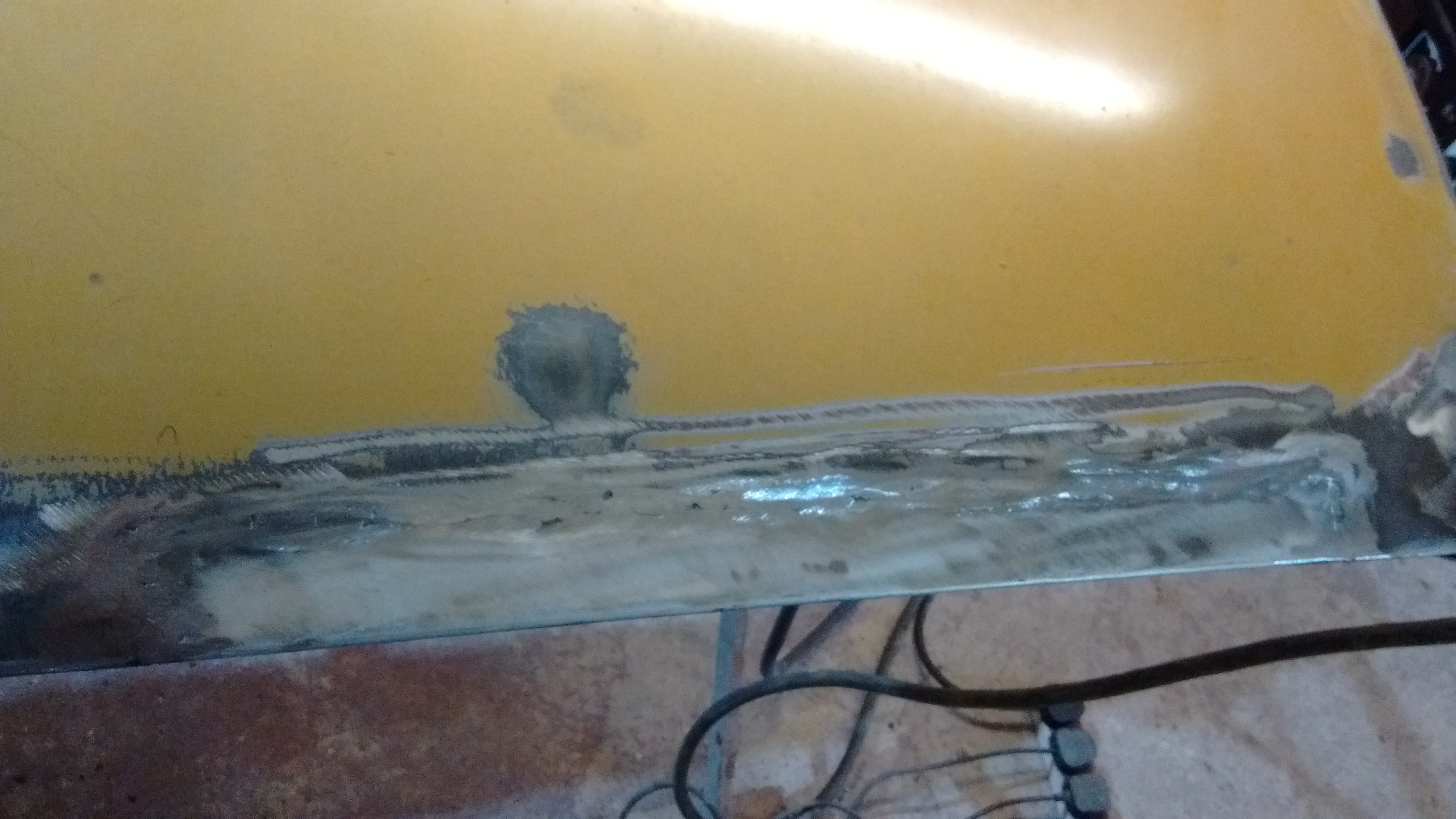

doors are off now with the thoughts that the holes would spread and need some welding....
drivers side first

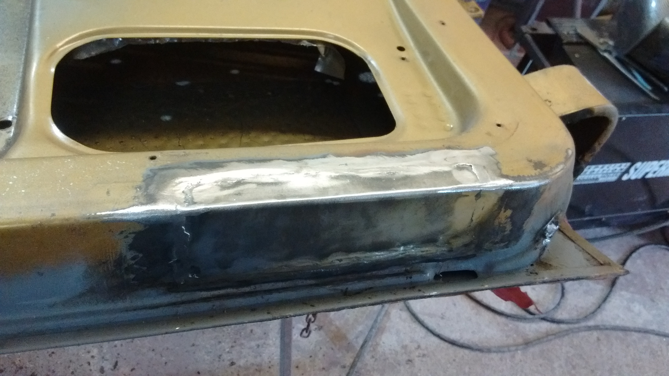

managed to weld it all up without taking the edge returns off as they were surprisingly good..
passenger side one wasn't quite so bad but the bottom edge nearest the rear was too bad to leave on so a folded return was included in that repair plate
a few other bits done today so now the welding is finally (hopefully) done then sanding can commence on the next visit...

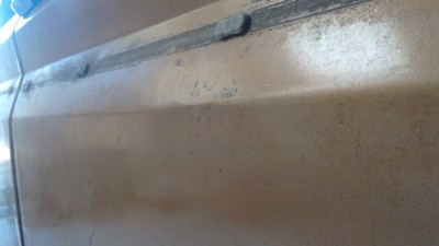

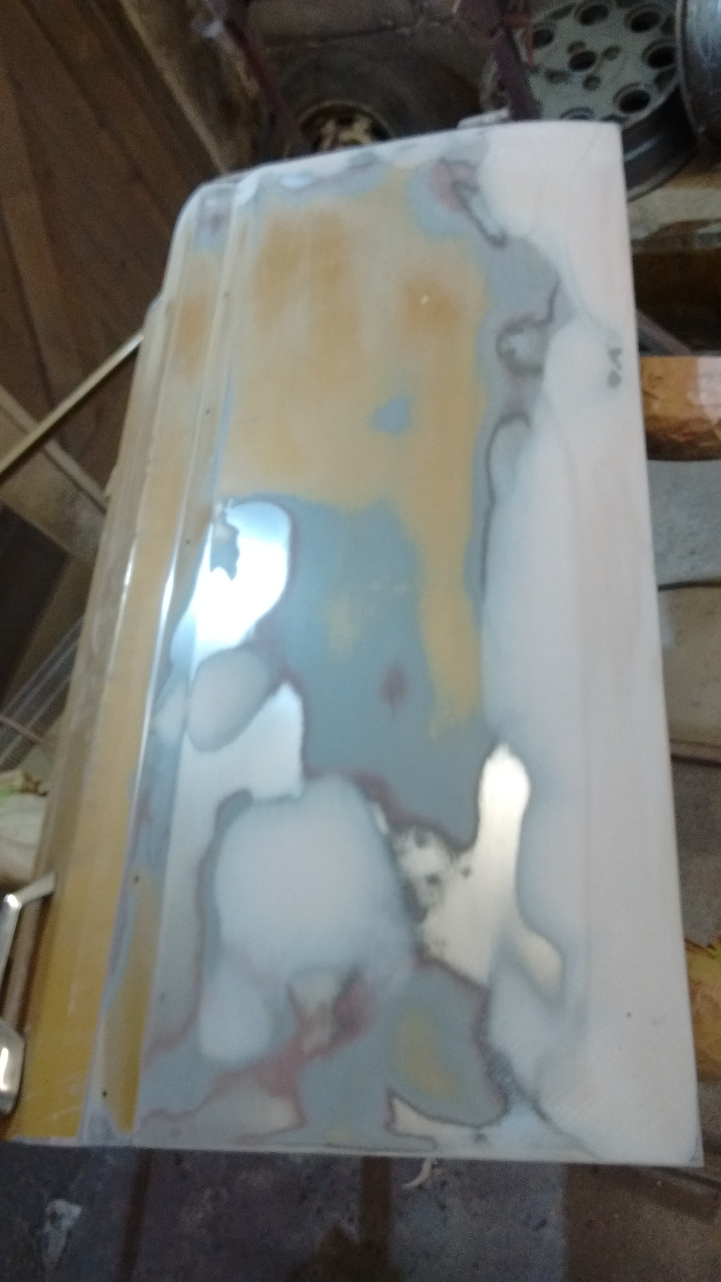

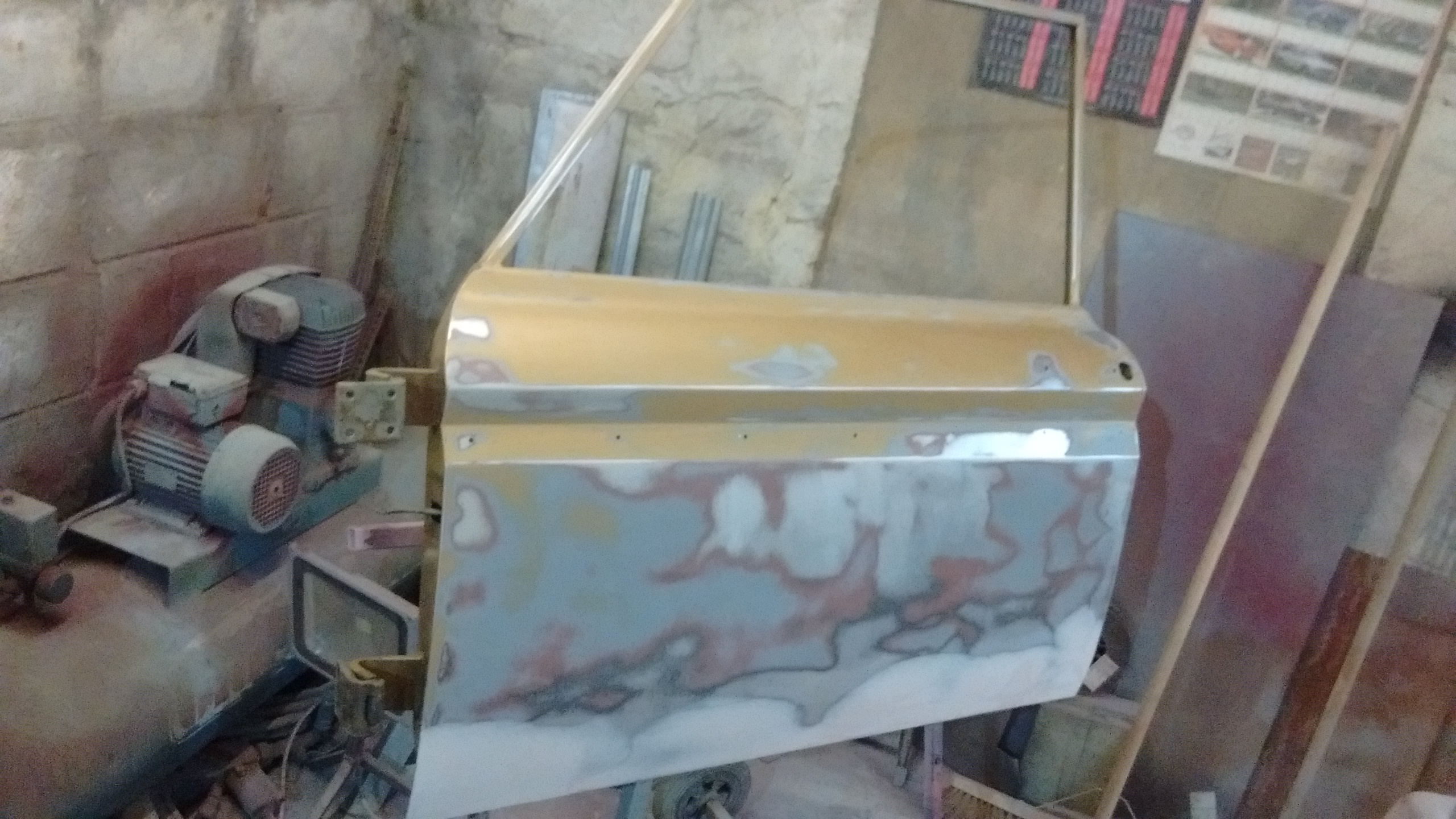

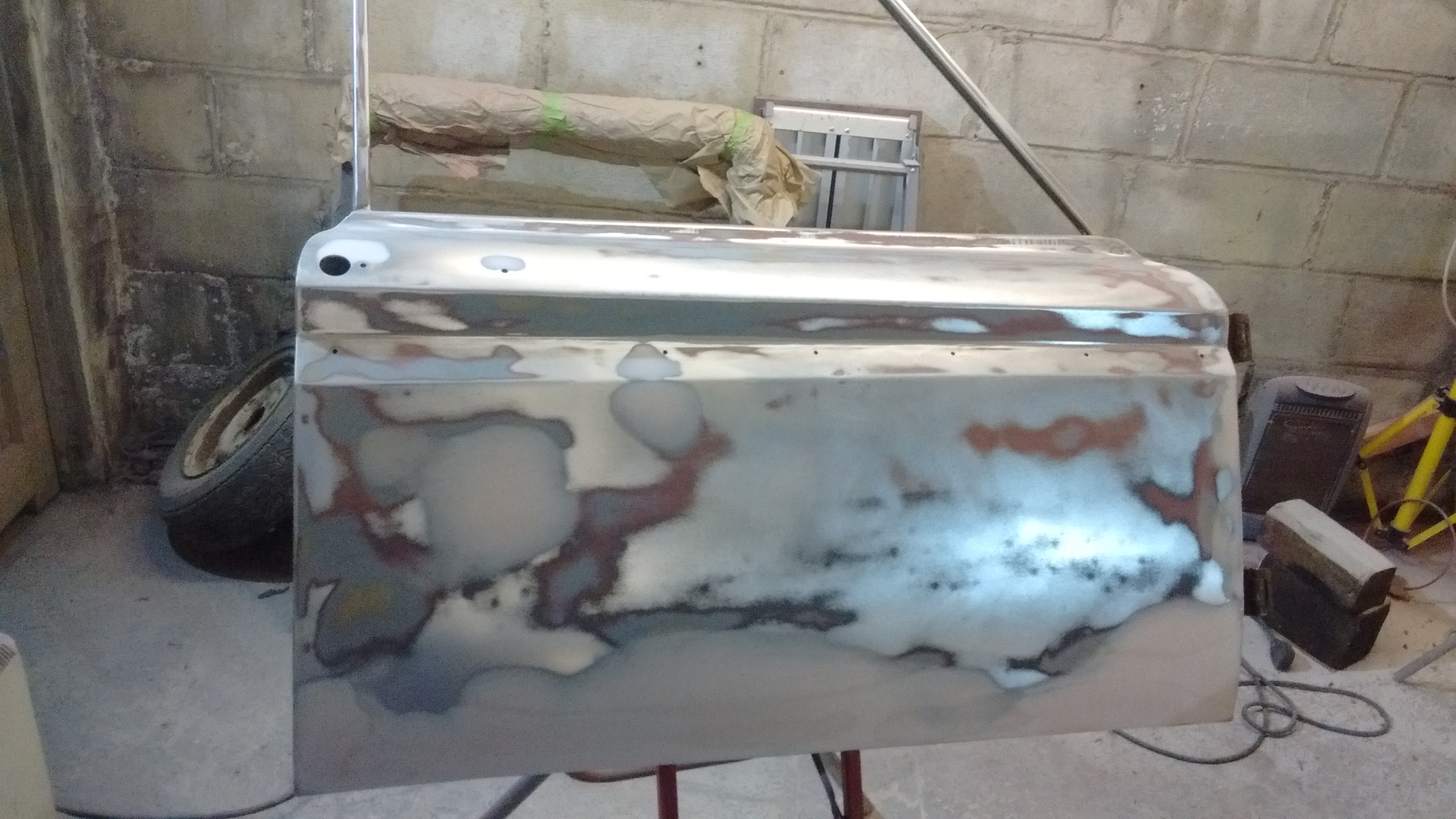

doors all welded up now, underside on both needed some repairing
outer surfaces all sanded down
drivers side dent on swage line came out pretty decent, whole skin was caved in so pleased with the minimal damage left over, besides what I caused welding the bottom up!

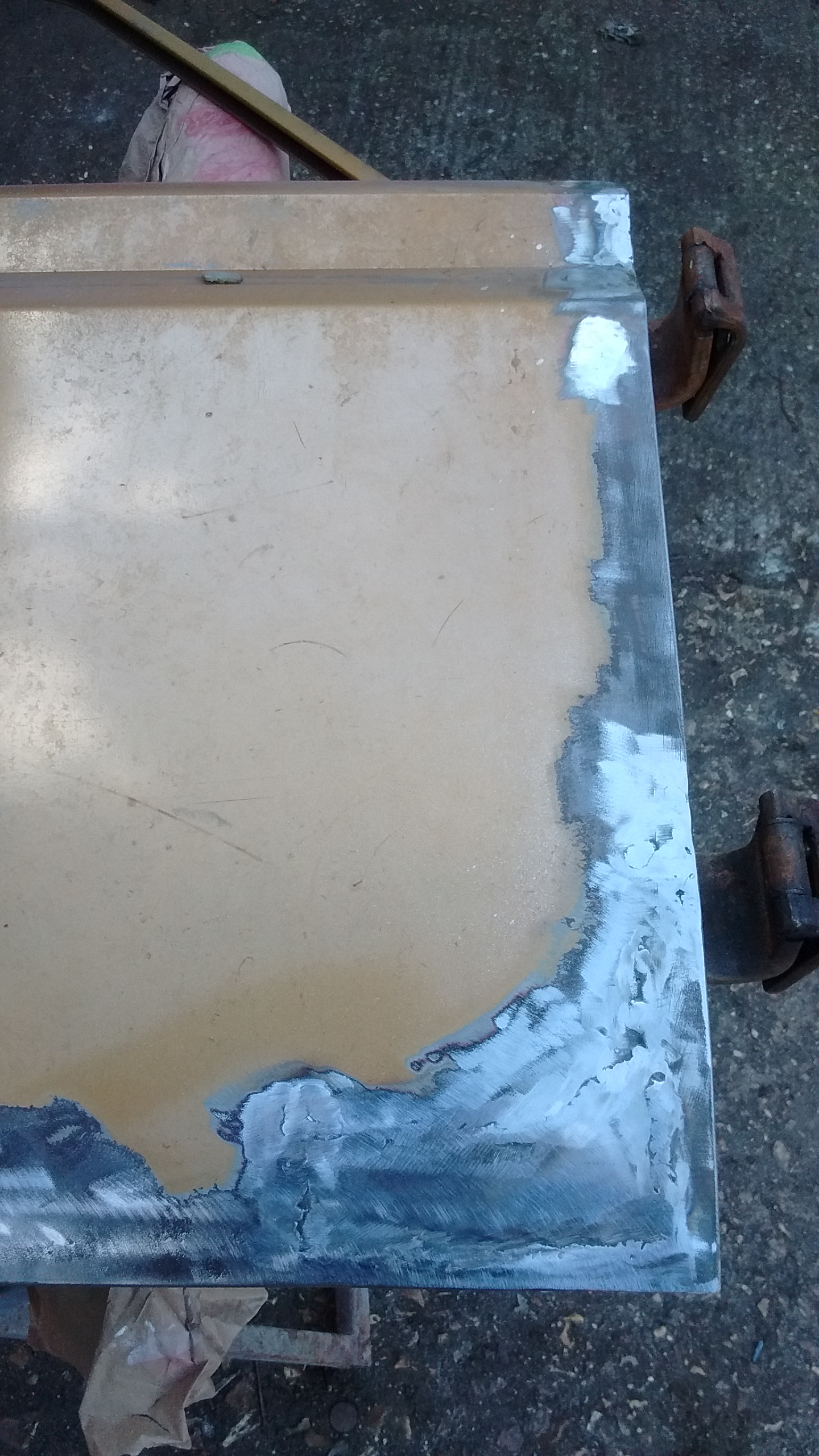

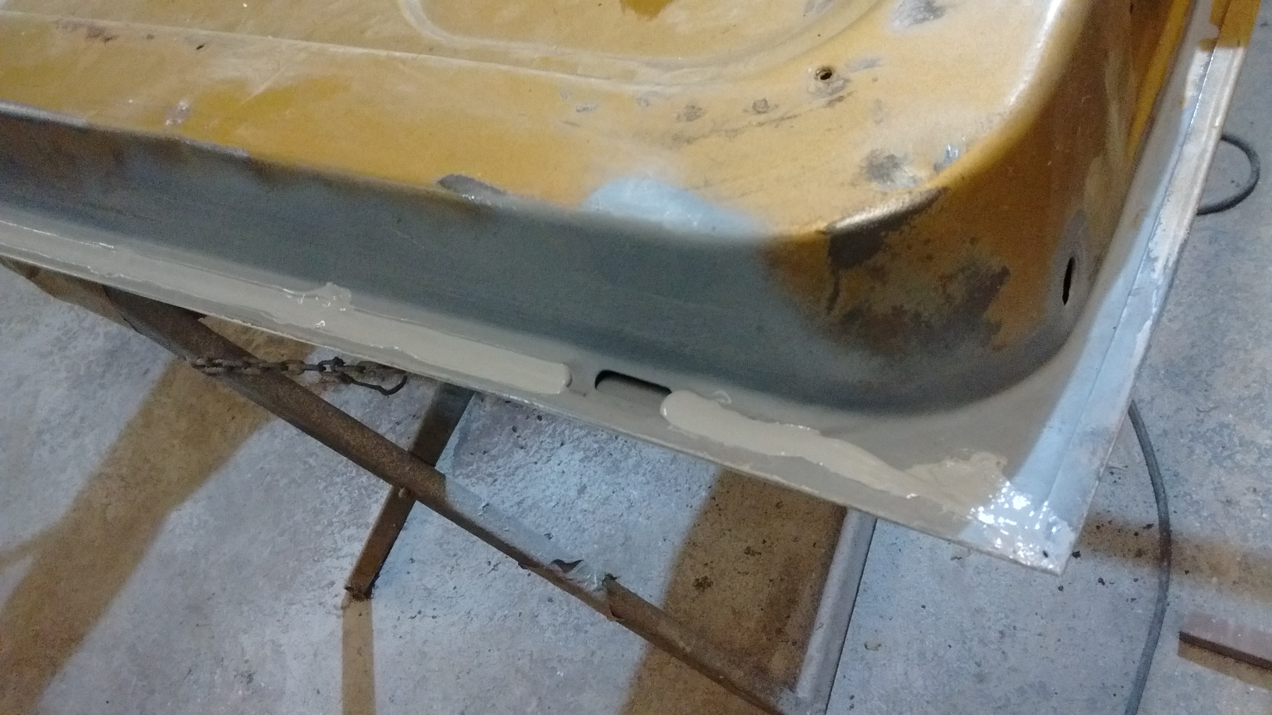

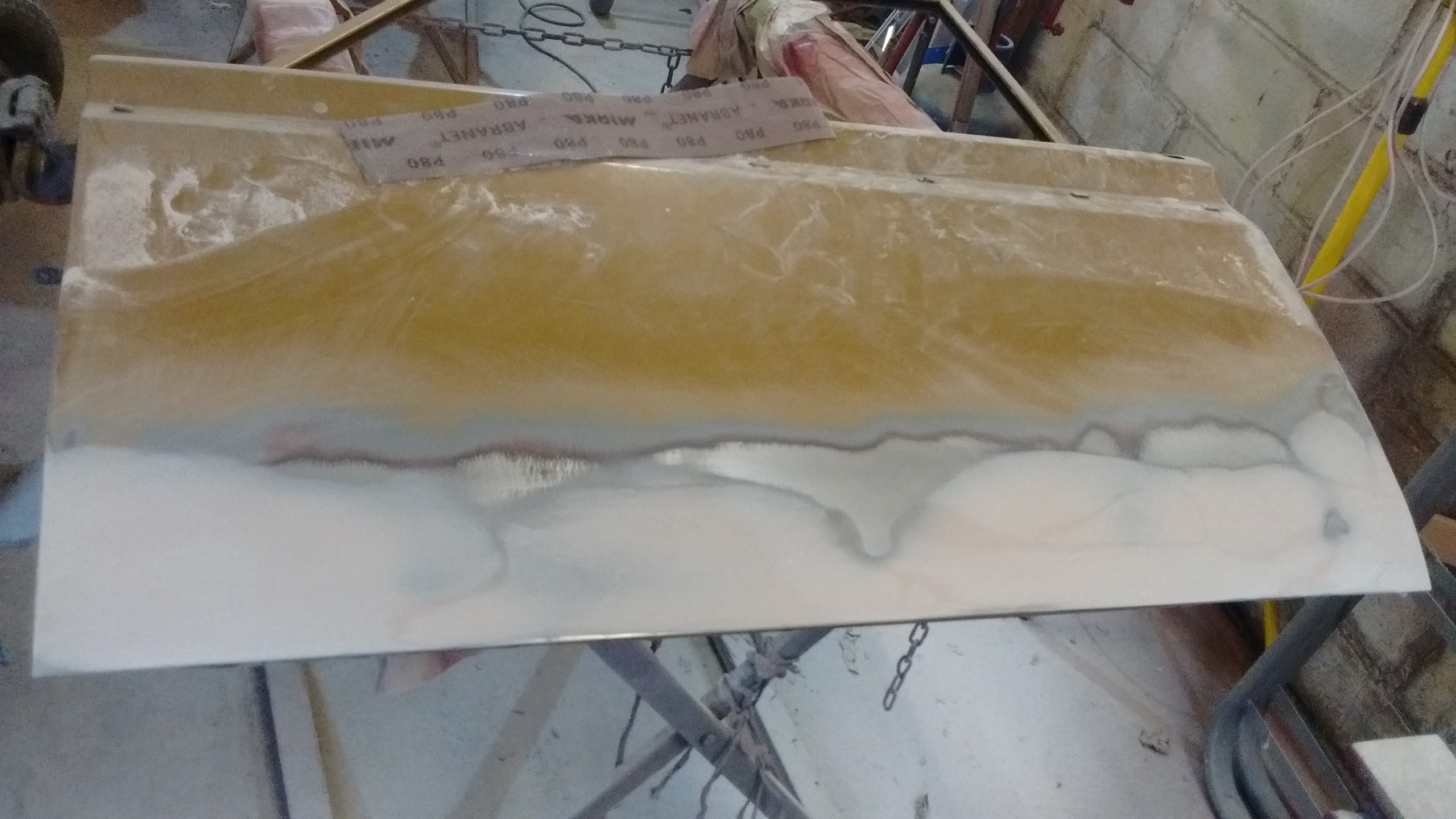

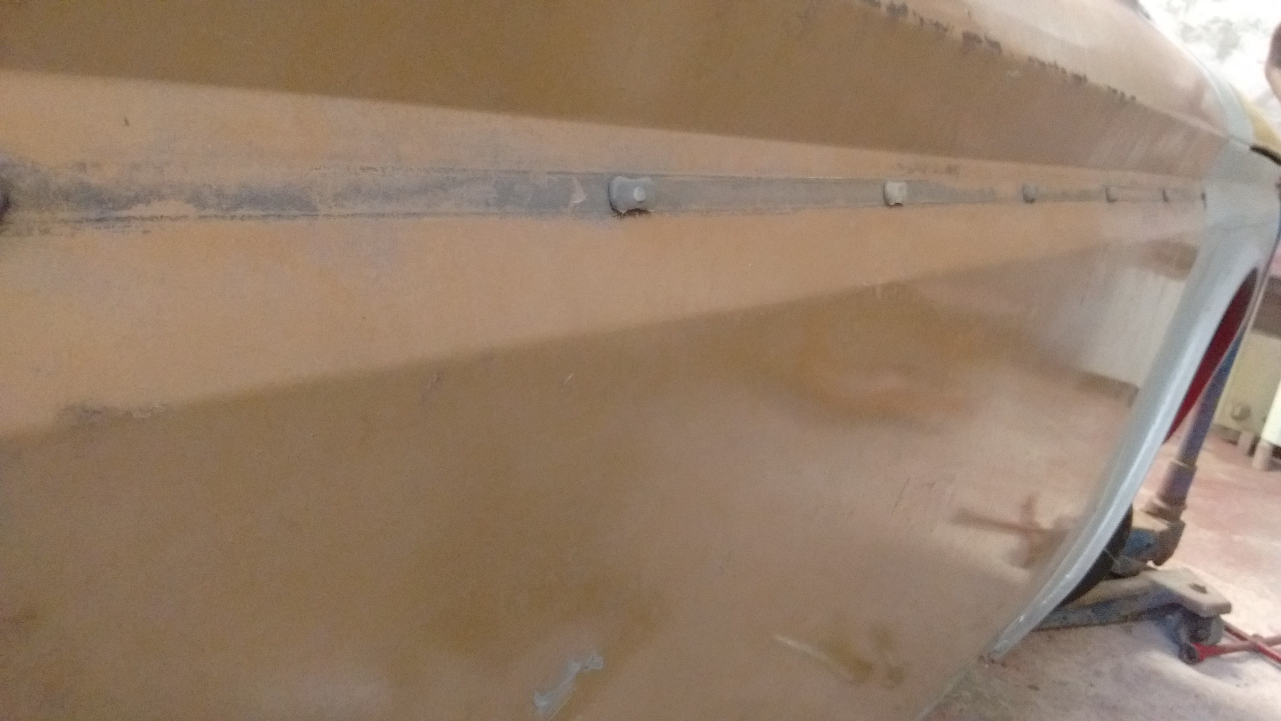

undersides sanded too then I seam sealed the bottom lip with some PU sealer

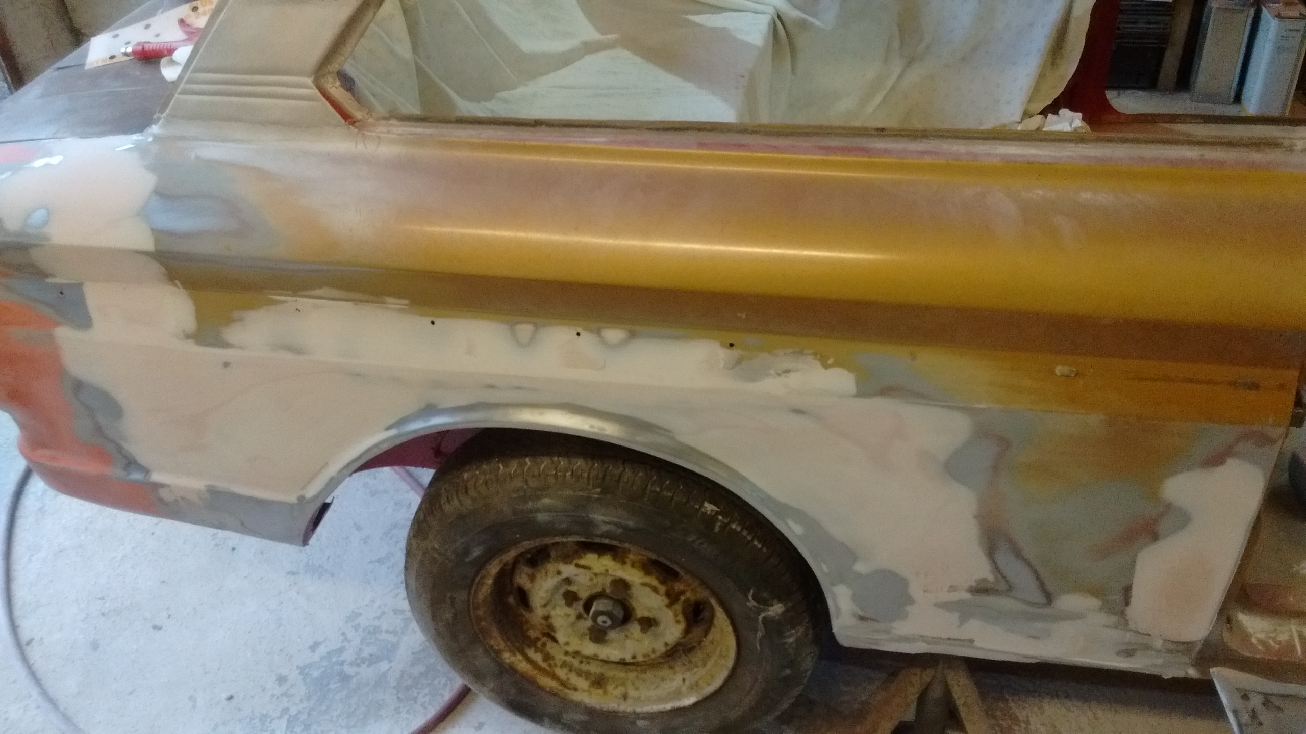

in-between repairing the doors I started to sand the drivers rear quarter which has had multiple repairs so needs plenty of shaping, coming along though
there will unfortunately be a fair amount of filler needed to get back to something like a decent shape, not everybody's cup of tea but needs must

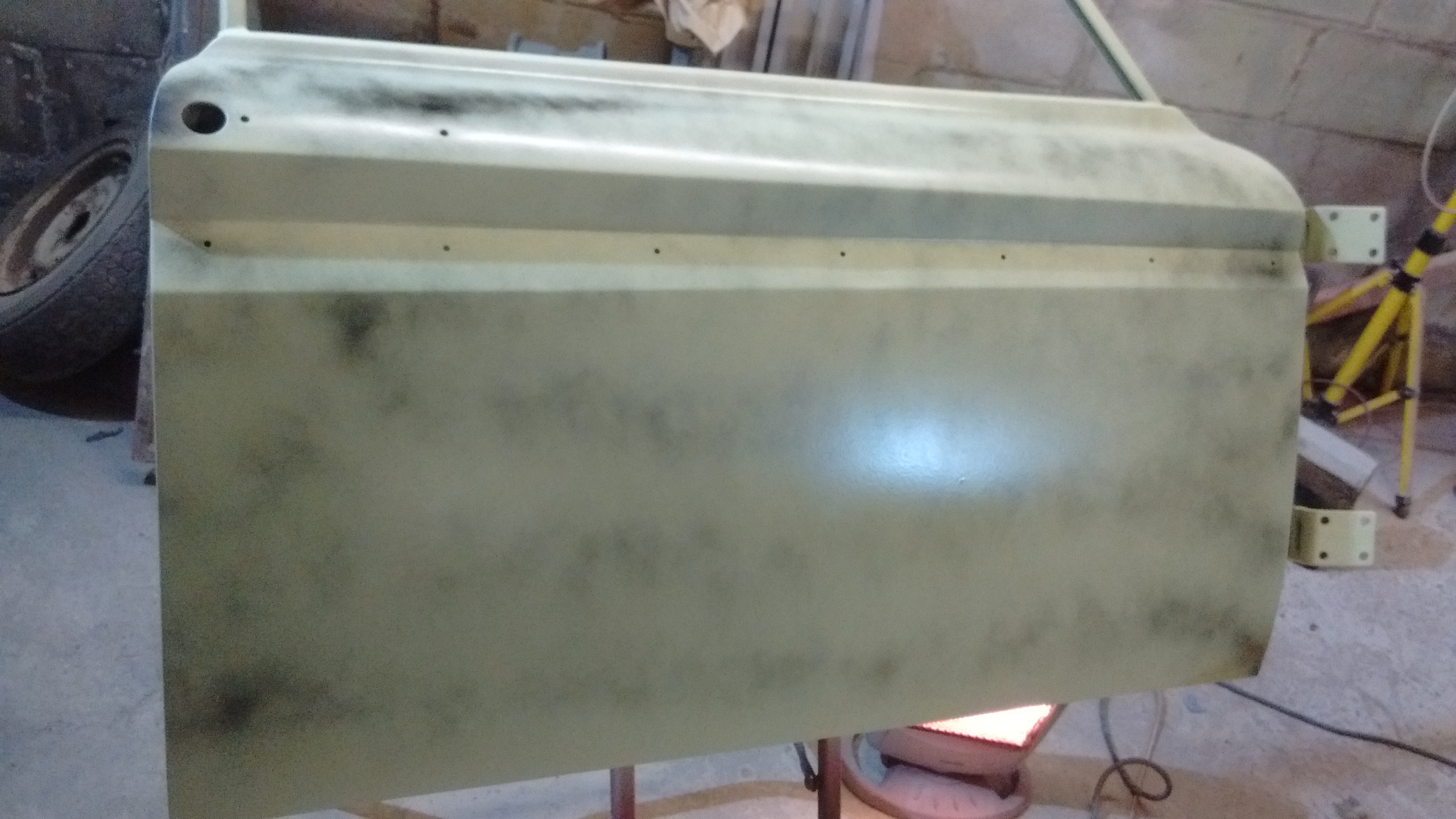

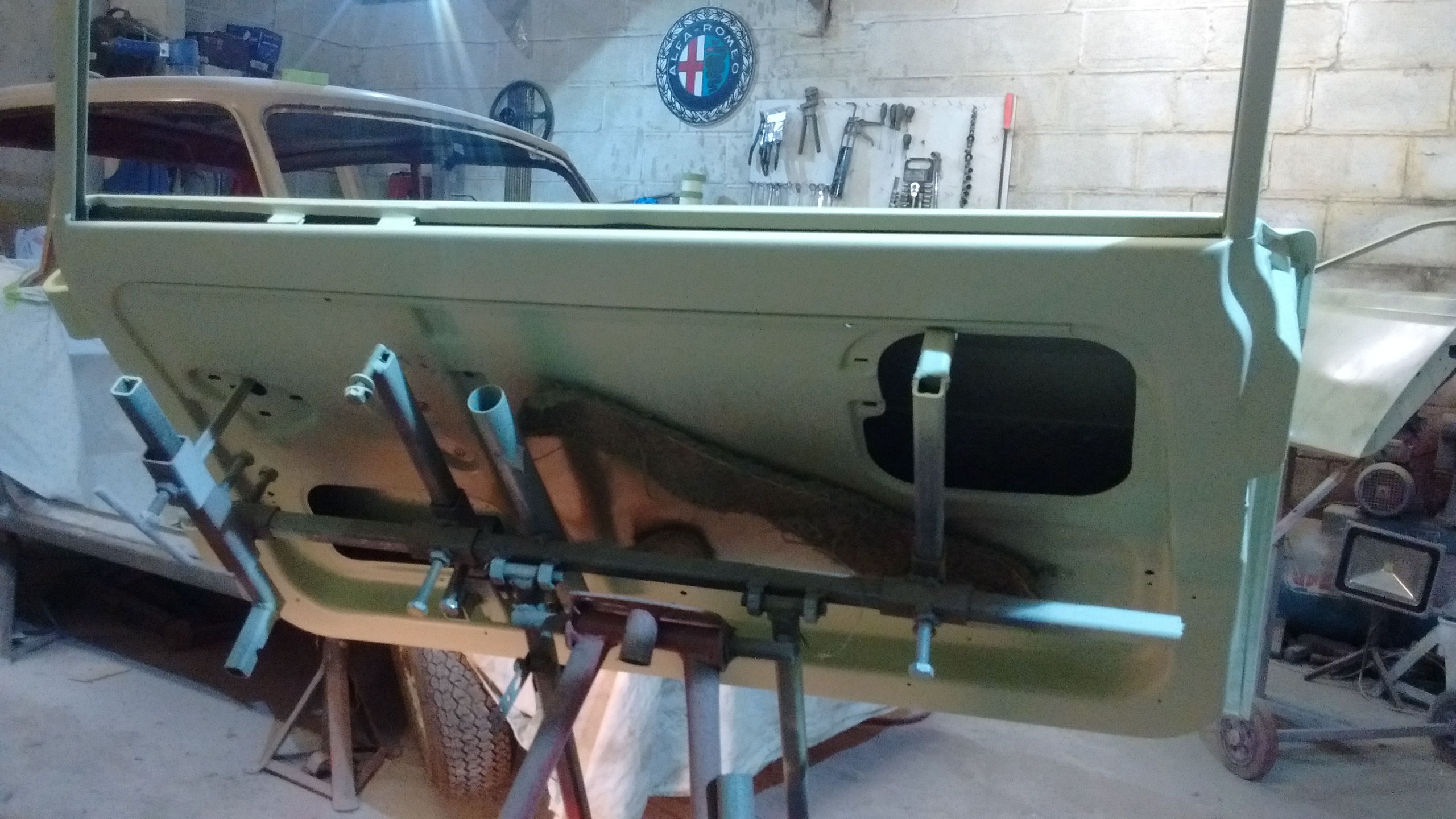

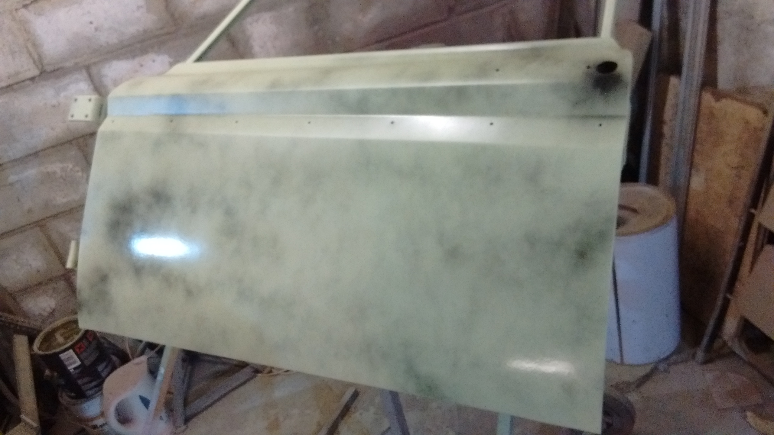

doors are finally fully sanded down, frames were a PITA to do, I hate the fiddly bits
greasy hinges weren't any better either
ready for some etch..
primed up
inner face needs quite a bit of paint as a lot is on show once done, I'll have to come up with a better way of doing it for the paint
primed up

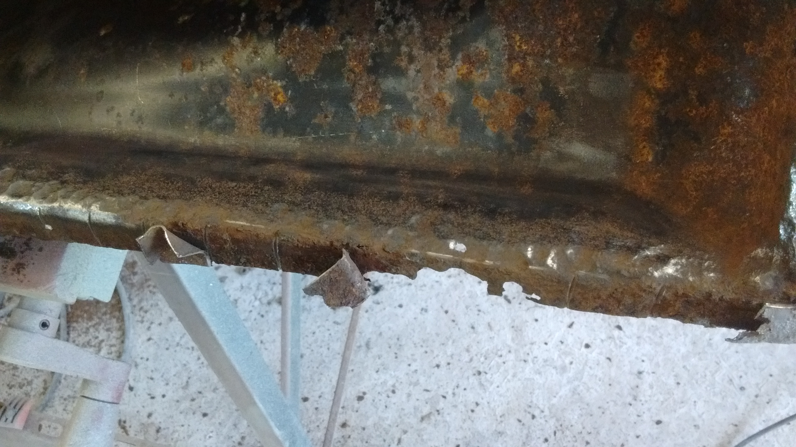

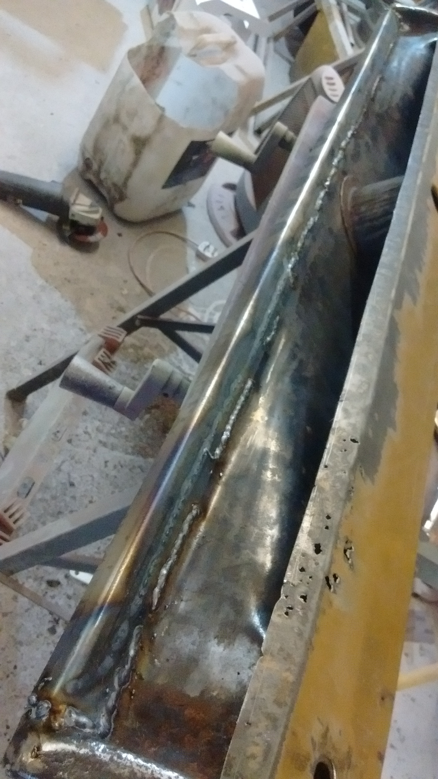

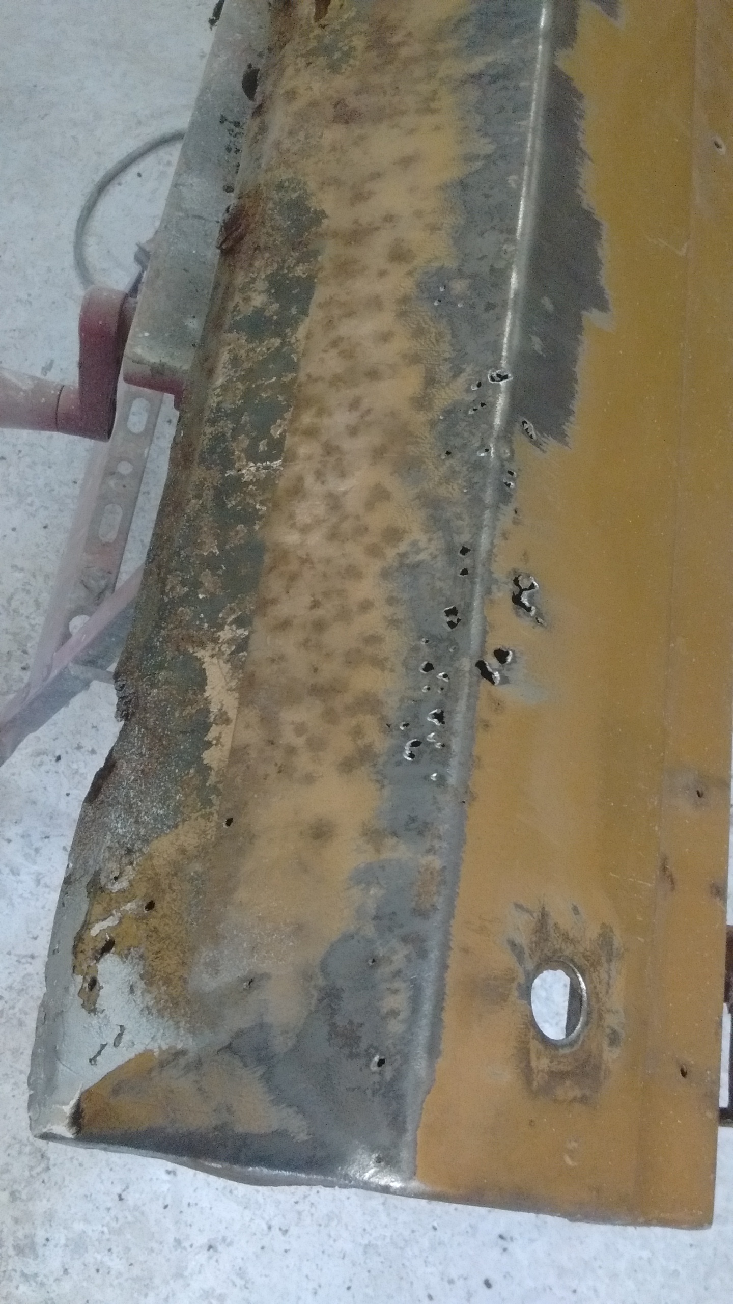

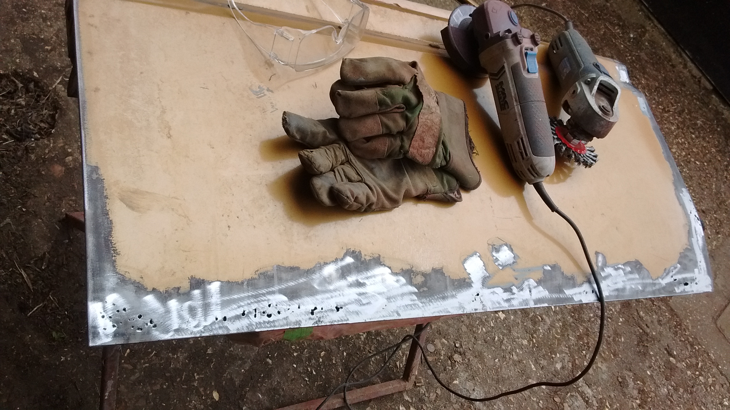

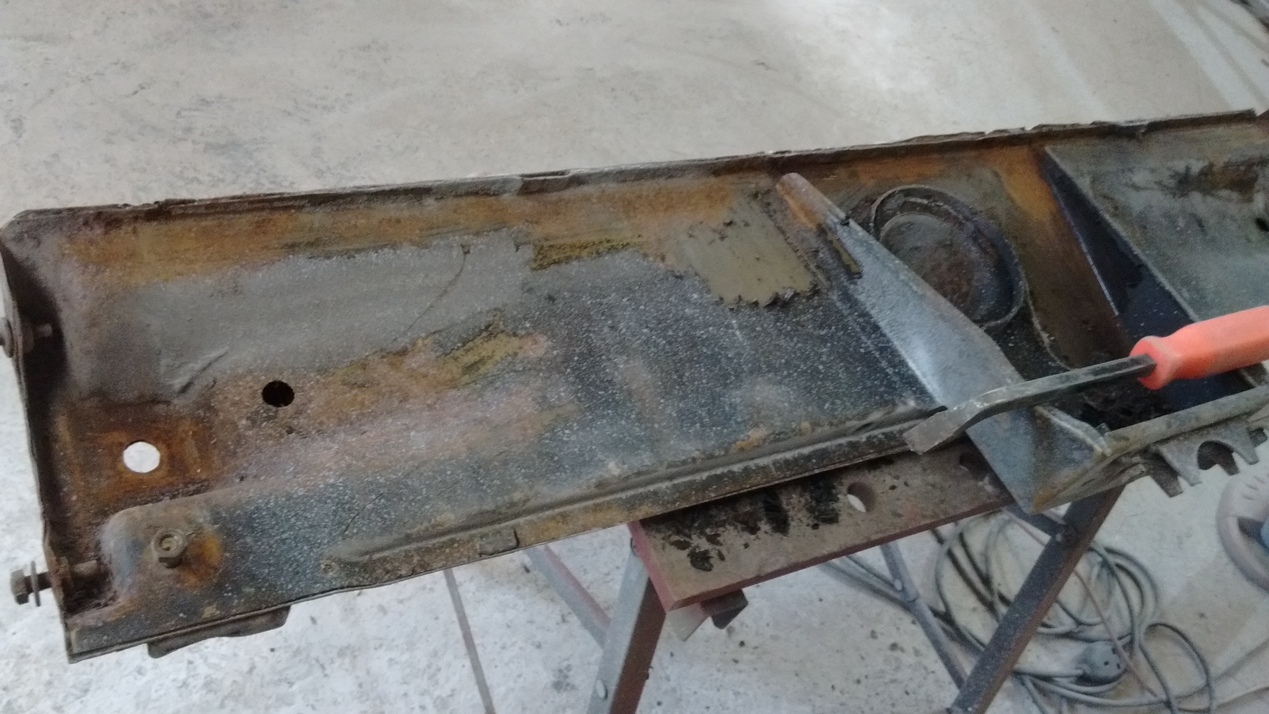

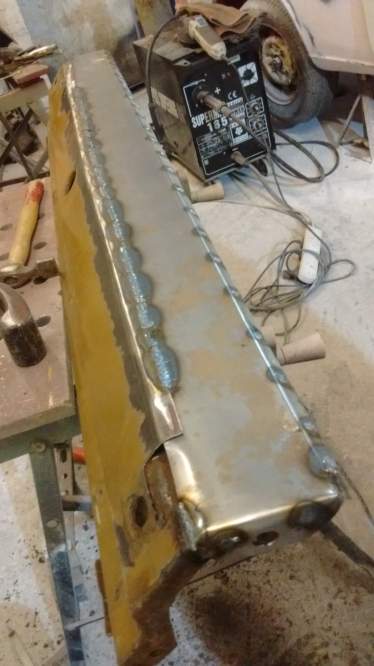

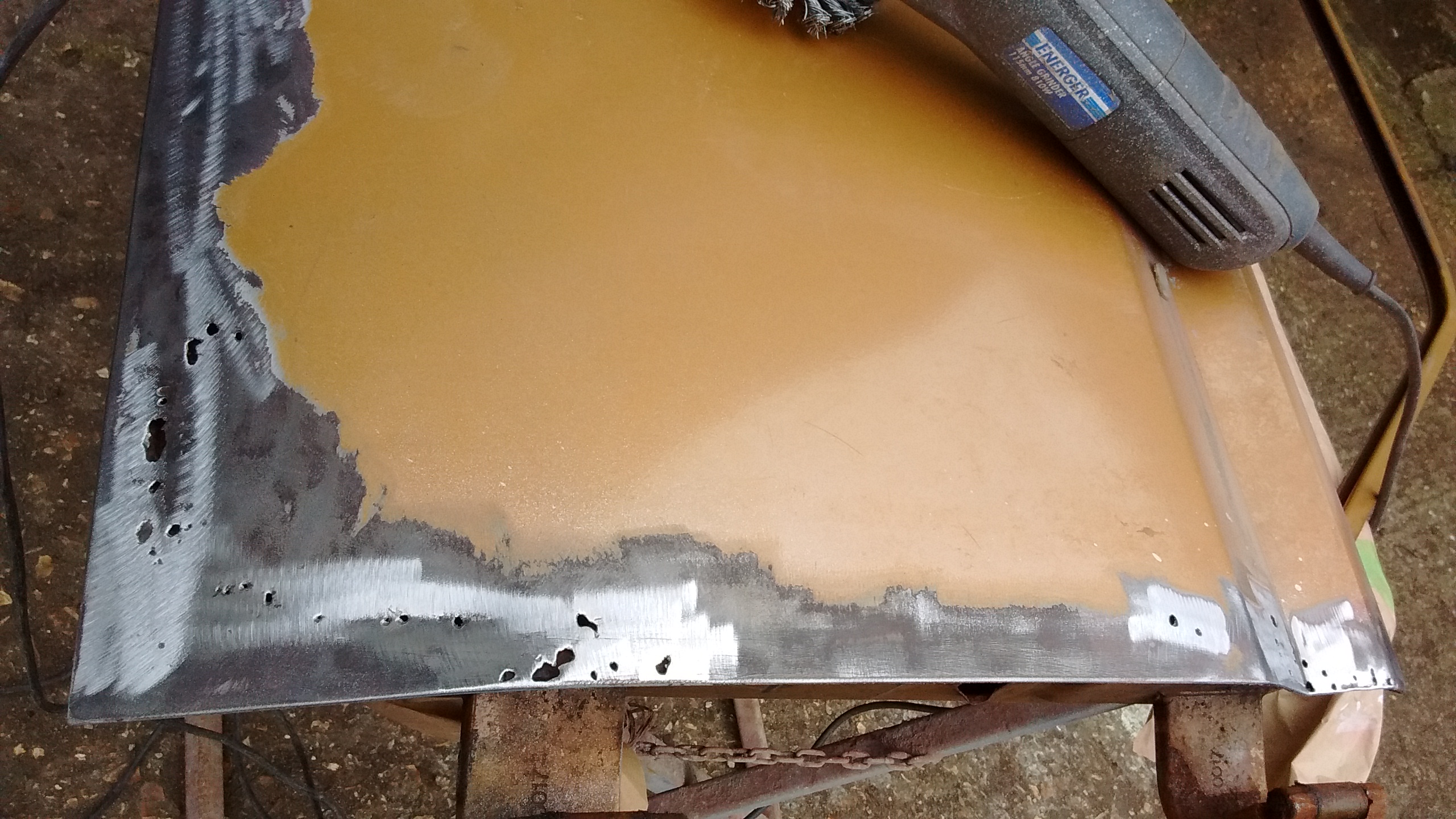

so with just the bonnet, boot and rear panel to sort I set about the rear panel this afternoon.
always knew it would need some welding, just hoped it wouldn't need too much
a few fresh-air pimples

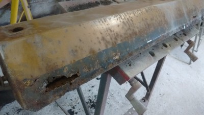

bottom lip was still relatively solid but heavily pitted
whilst at it though best to chop it off and make a new bottom lip
plug welded the underside edge to the central reinforcement section, rest got overlapped seam weld

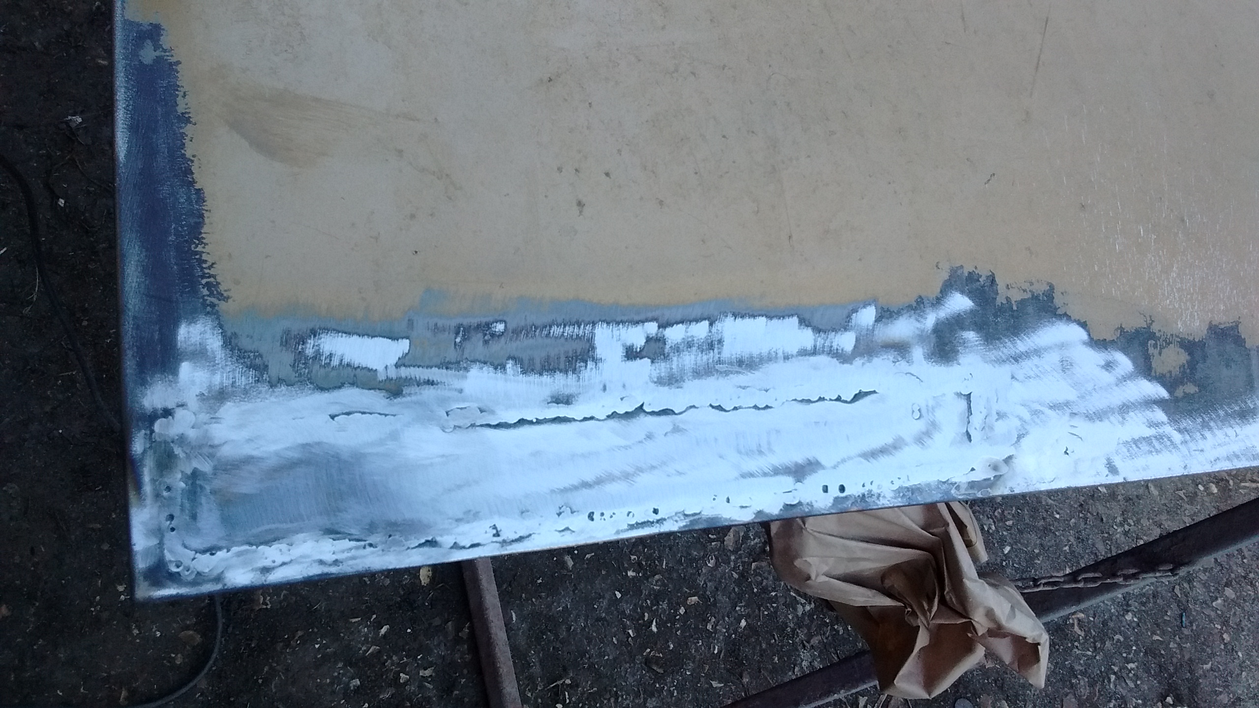

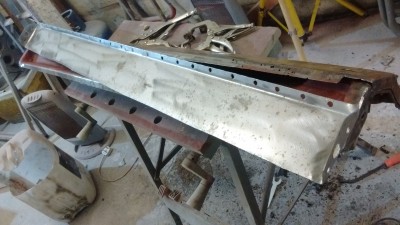

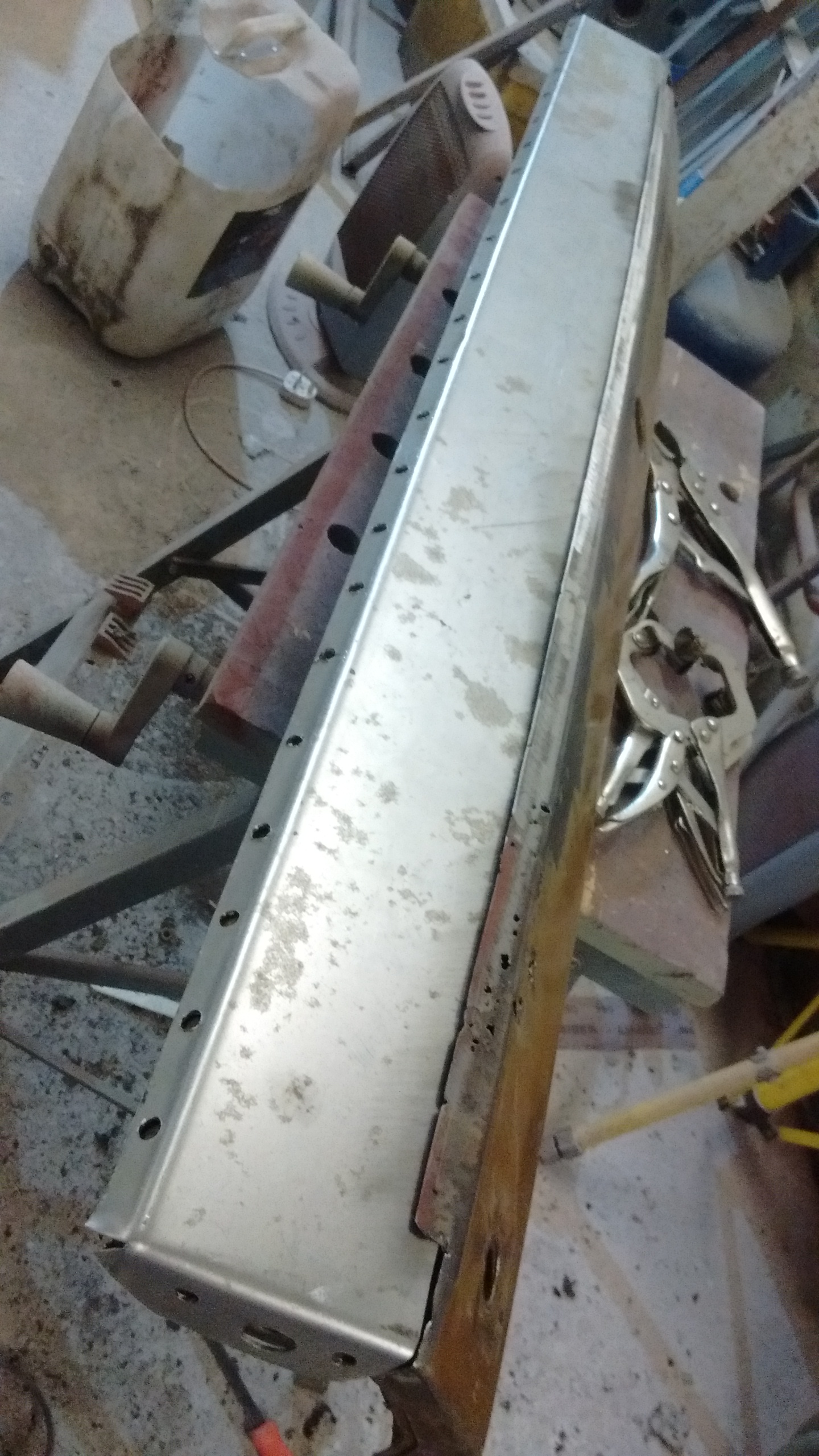

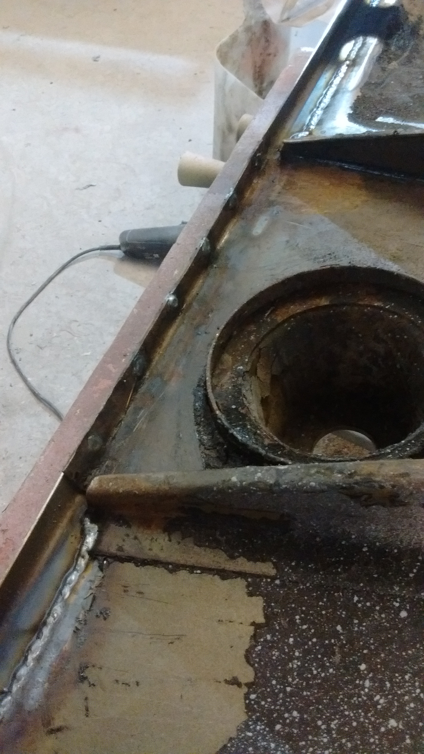

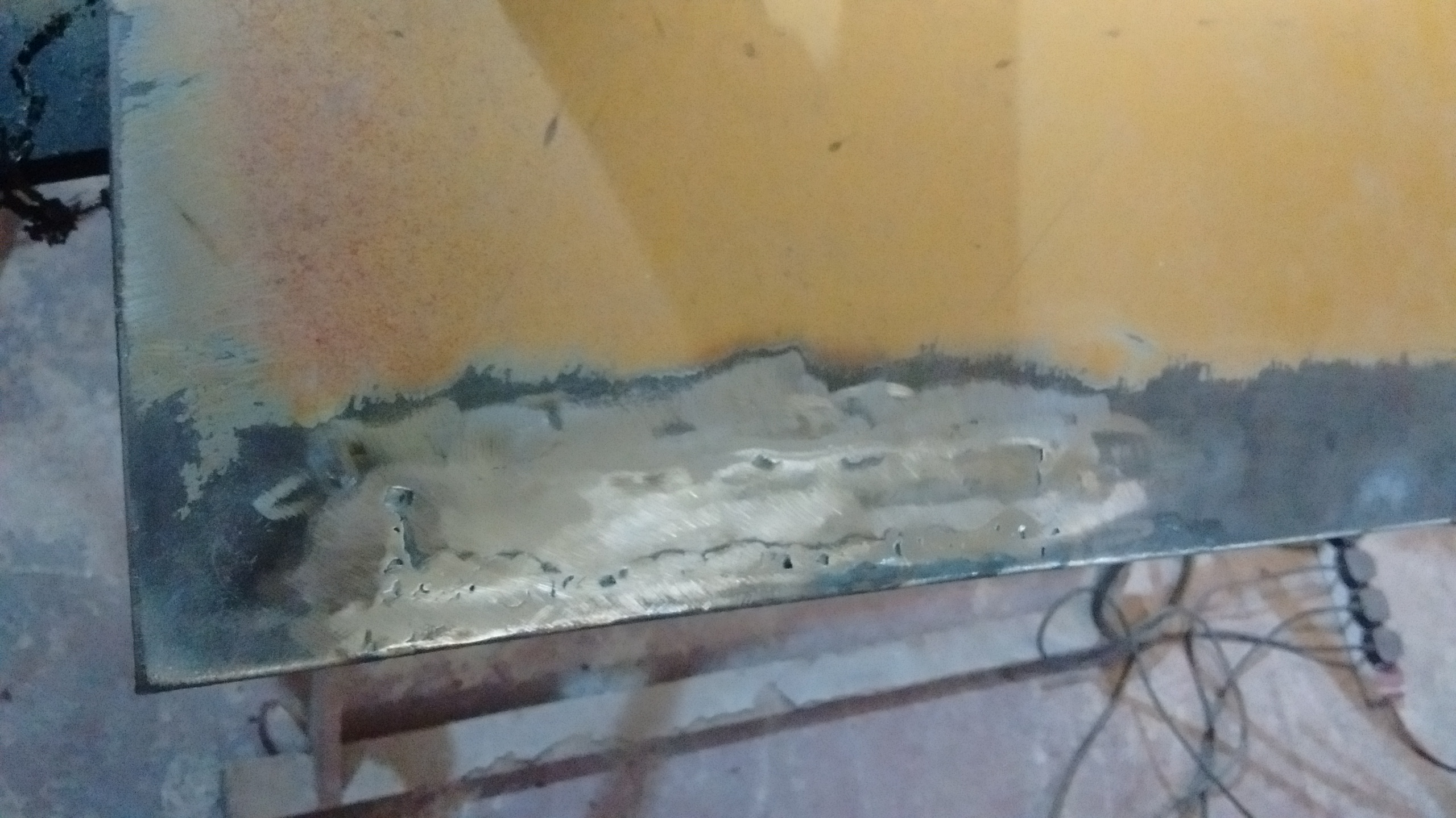

outer skin got a full width repair panel made up
should fit about here...
plugged to bottom edge, seamed to top fold. pretty decently thick metal on original and repair section so could be a bit bold on long welds
ground back
and some red oxide sprayed inside to protect the seams, it'll get filled with waxoyl after paint to help stop rust coming back, must remember to cut some drain holes in...
each end just needs a smaller panel making up then it should be ready to fit
ground back
