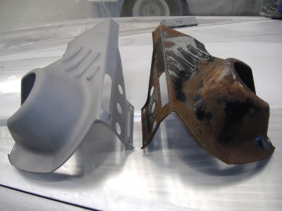

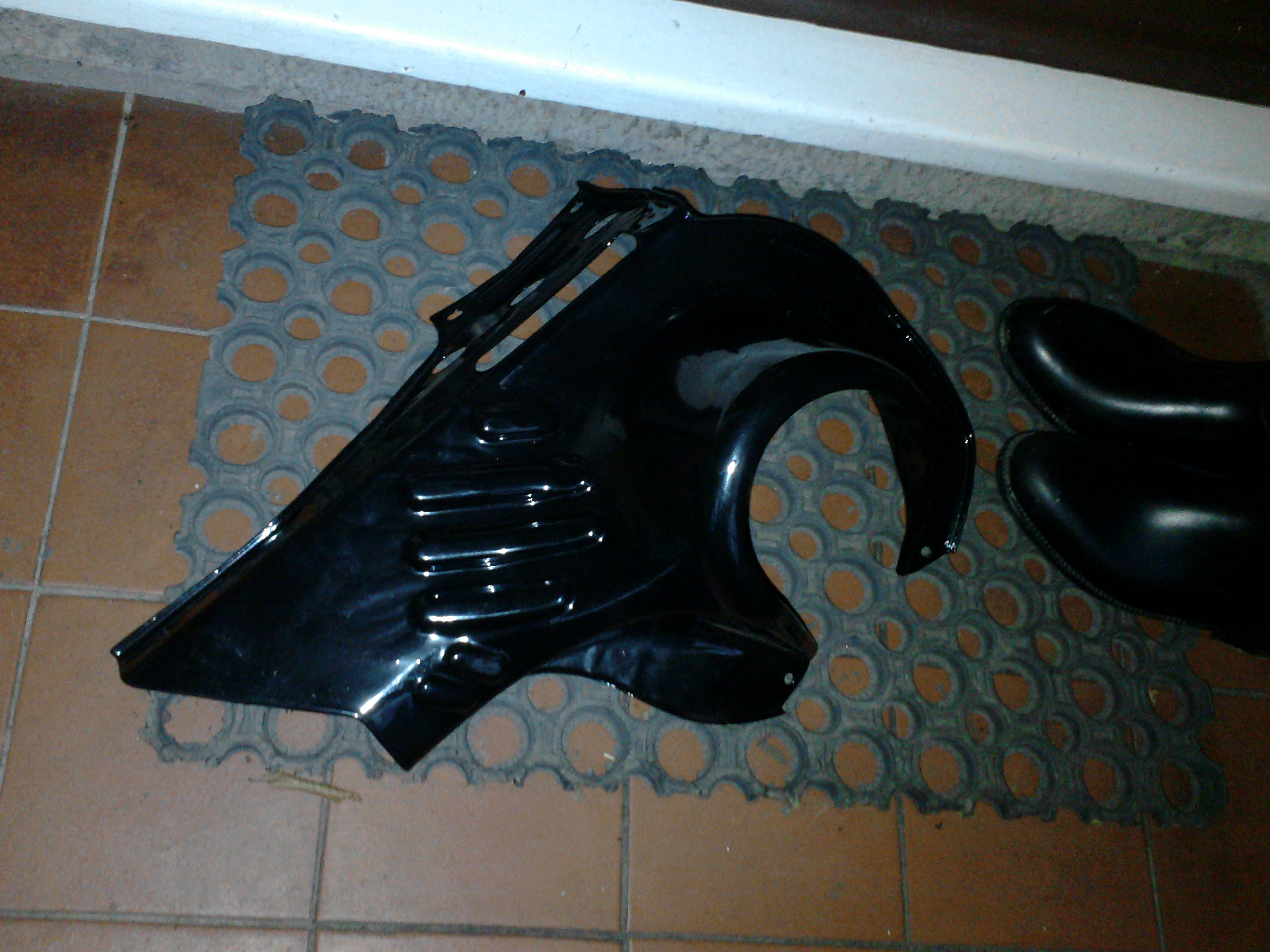

now, anyone recognise this part?
Bluesuit
Posts: 242
Location: Suffolk
Re: My S1 Sud Ti
Post by Bluesuit »
Under dash trim?
Is it plastic?
Also looks like an inner wing/suspension turret

all will be revealed tomorrow.....
rare item ;)

I know Kev , but I won't spoil your thunder.
I will confirm they are metal and are quite rare !! :ugeek:
I trust you have them both?

Is it the corner section under the windscreen scuttle, air vent hole?

I am sure not many people will know what this is Kev.
Have never seen one as a NOS part before, a very rare (if not unique) item theses days I would imagine as they had the durability of a chocolate fire guard.
You would really have to be a bit of a Sud anorak :geek: to know what they were used for which makes me feel a bit red faced as I recognised the part straight away! :roll:
Sorry Veesix75 - they are not part of the scuttle/bulkhead structure.

Post by evanbottcher »
Ha! My 'new' 1974 sedan still has those items fitted, I'd never seen them before. Certainly worth a few more points for originality!

Post by Simonsud »
Are they front disc brake covers
sudboy1490

iv only ever seen one sud with these still on and thats jon trinders
great find kev ;)

Simonsud wrote:Are they front disc brake covers
I was thinking the same but have only seen photo in the manual

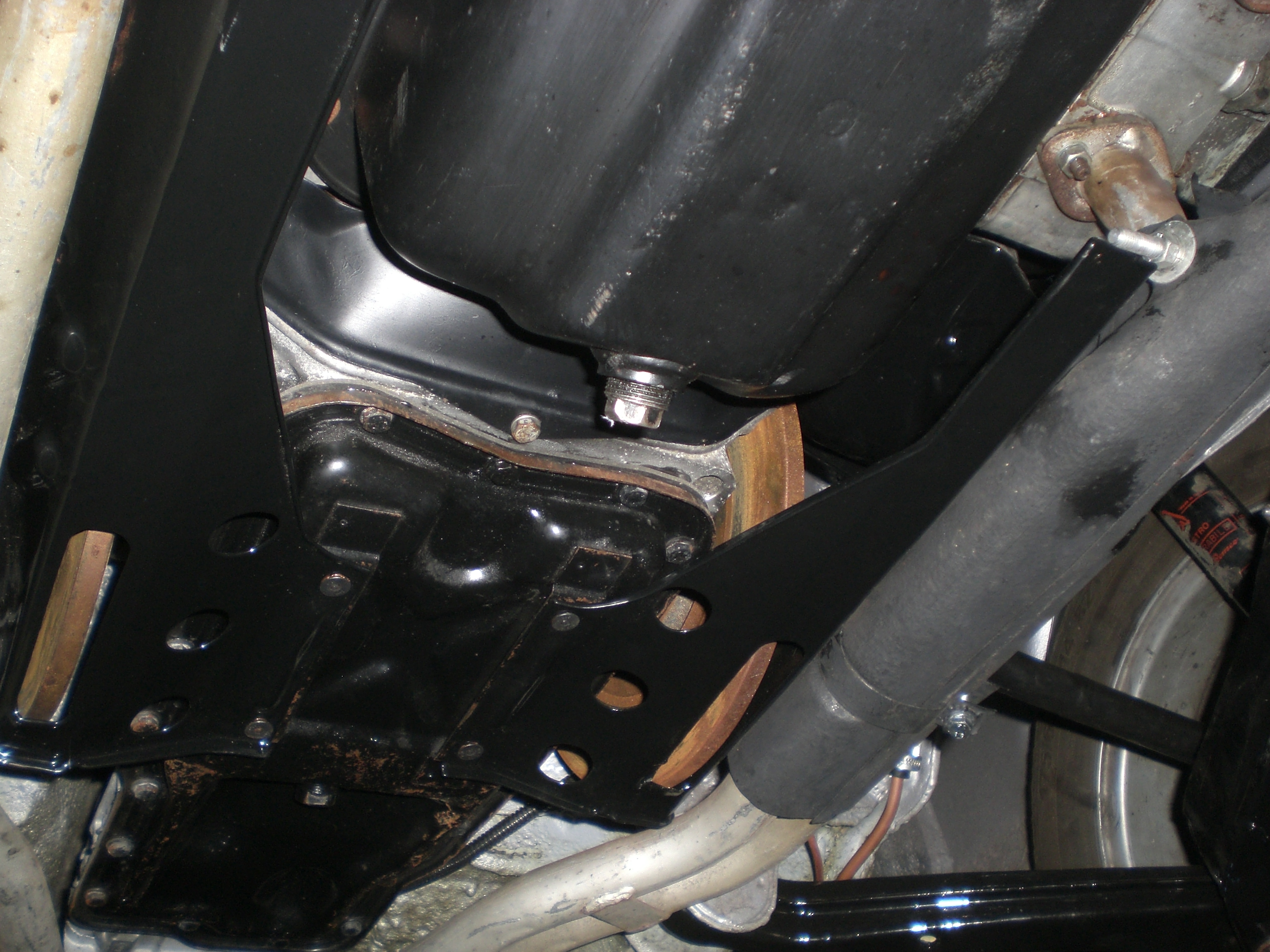

Think you have been rumbled Kev. :o

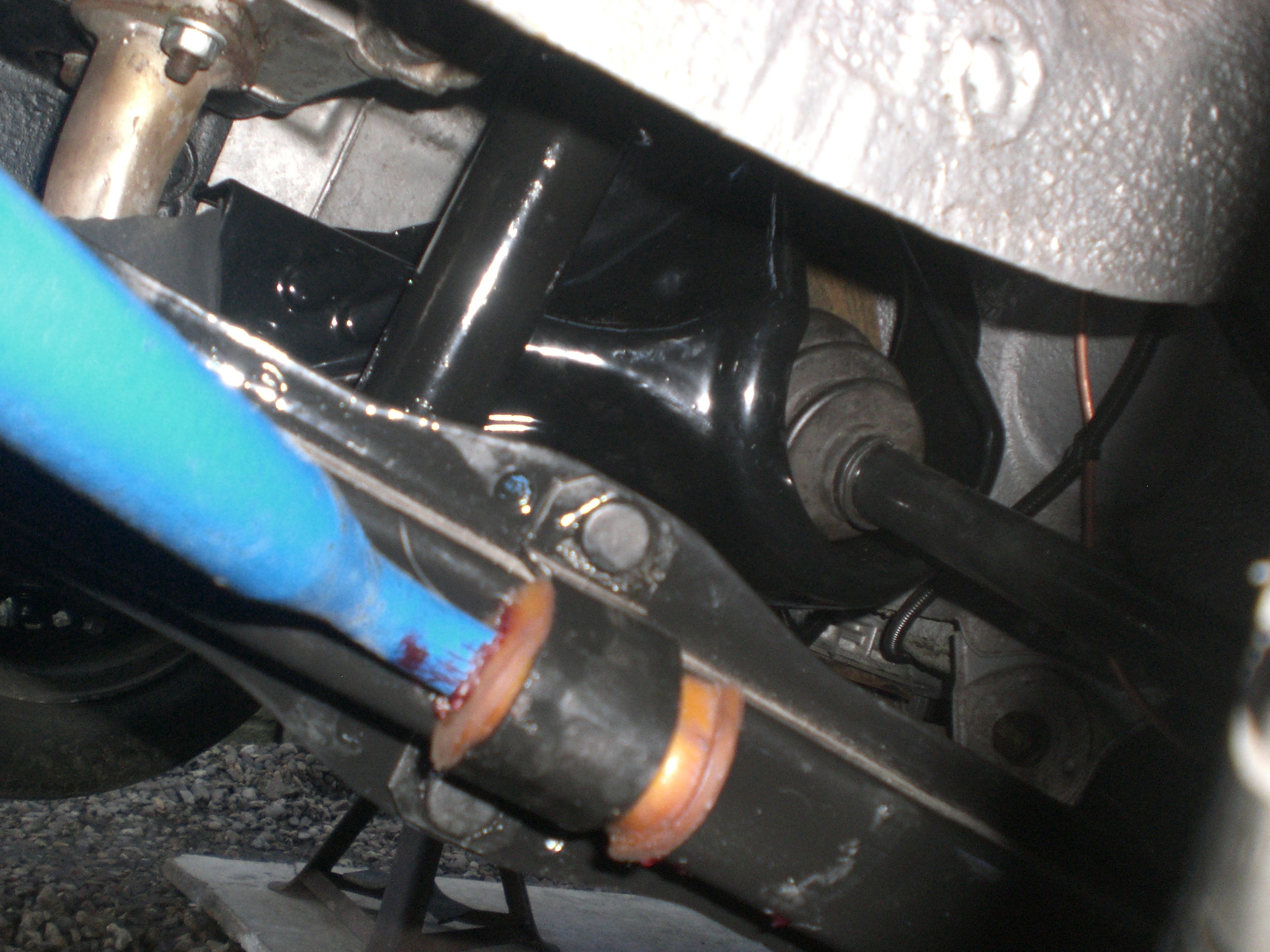

Re: My S1 Sud Ti
I was wondering when they'd surface kev, lol!
This is a very deserving car for them for sure, glad they've found such a good home :D
Re: My S1 Sud Ti
thought you guys would know it in the end although, like to me, they aren't as widely recognised as they maybe should be.
talking to tom at BLS about these some time back he said they were a royal PITA and most got left off when they were removed.
pretty sure it was only the earlier cars that had them as the mounting points aren't on all sump pans..
i didn't fit them initially as wanted to get the brakes all done first, thought i'd "pop" them on at some point when i got a minute.
yes, right!
i now realise what tom was on about.

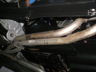

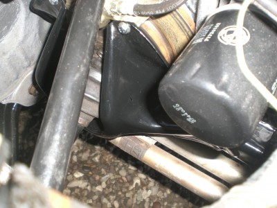

the only way to fit them is to drop the exhaust front pipe down from the engine! imagine having to mess about like that when you need to change the discs or the driveshaft. although you can still get to the driveshaft bolts from above it'd be a pain to line them up.
they bolt in 2 points to the sump pan then to the outer edge of the calipers
these pair were very kindly given to me by rodger some time back, haven been blasted and powder coated by shrew, they look fab fitted 8-)

They are a right royal PITA.
Glad my 77 never had them.

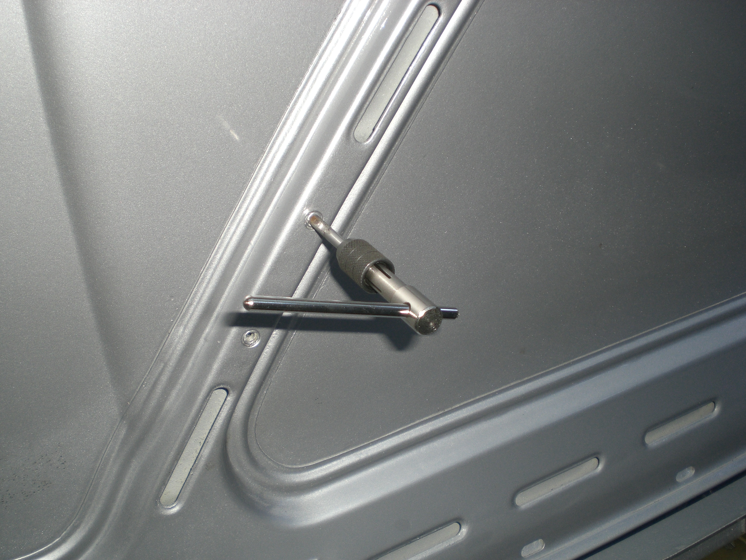

fitted the sprung bonnet stay too, had to tap out the threads in the pointing point on the bonnet to clean the overspray, you don't want to wind that in too far and poke through the bonnet skin!

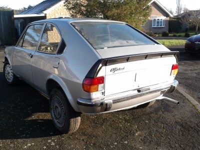

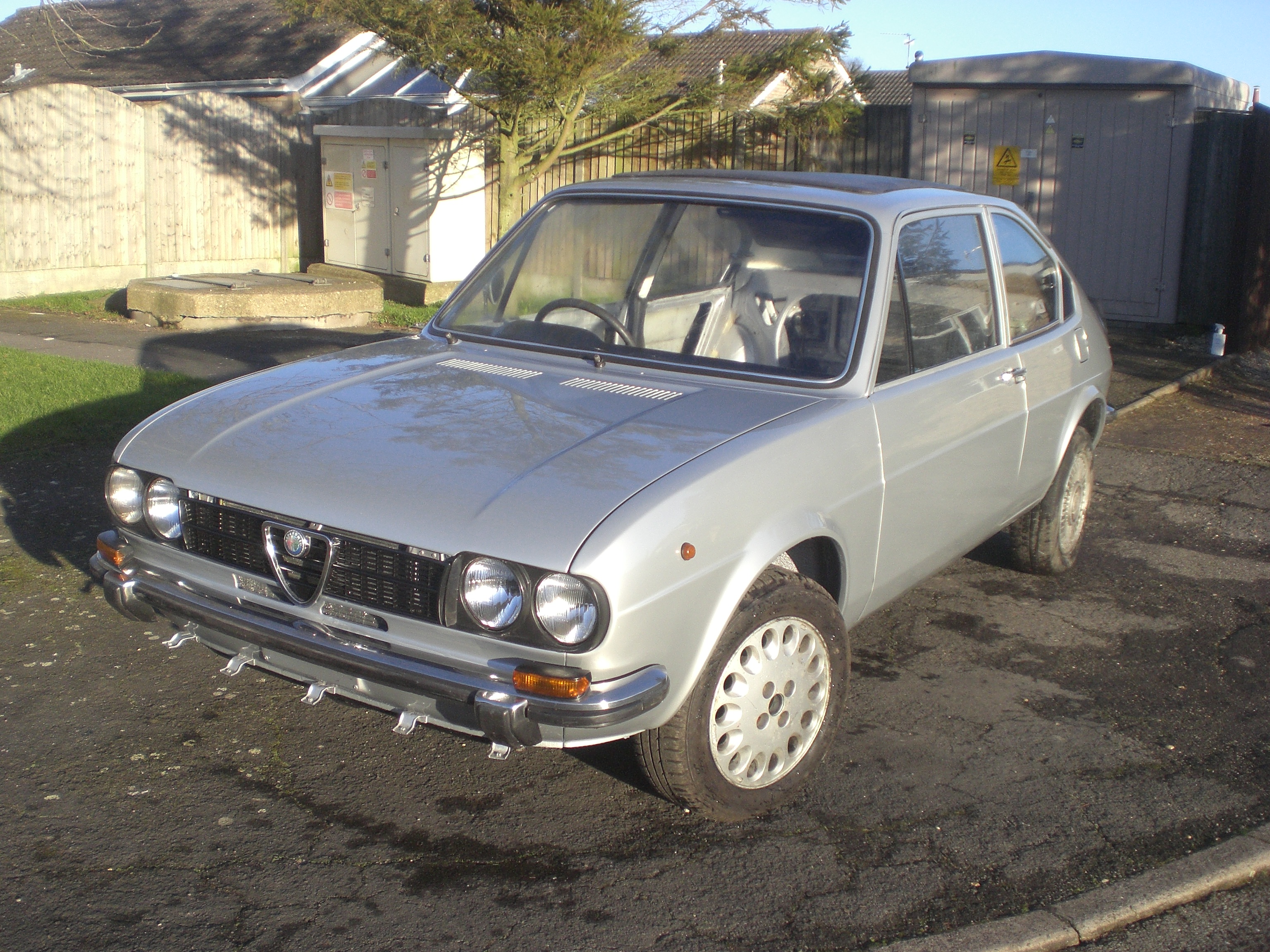

Re: My S1 Sud Ti
as it is now 95% watertight and the heater box water drain is now in place it was about time it had its first proper wash. amazing how dirty it was!
will look better once the steelies go on, and a few more trim bits and reflectors etc. plus once the interior goes in it'll help!
dralf1965
Posts: 147
Re: My S1 Sud Ti
Post by dralf1965 »
Beautiful!
Posts: 1235
Re: My S1 Sud Ti
That. Looks. Fabulous. I know Alfasuds have always been about funky colours, and I love that, but I think it looks great in silver too.
Really intrigued by the brake shields. Like everyone else, I have only seen pictures of these in the Haynes manual (which used an early car for the strip down) - what was their primary purpose? They have foward facing air intakes, so was it brake cooling or protecting the brakes from stones and stuff, seeing as they weren't inside the wheel like normal outboard brakes?
Re: My S1 Sud Ti
I was wondering what their primary purpose was whilst fitting them Lauren, heat shield? dust shield? They also seem to protect the brakes/driveshaft boot from exhaust heat.
The fact that they go forward also points towards scooping clean/cool air as you say.

Always wondered what those brackets were for on the gearbox sump.
Great attention to detail, you are going to have to enter this in a concours when done!

She is looking really nice now Kev. 8-)
sudboy1490
Posts: 242
Re: My S1 Sud Ti
Post by sudboy1490 »
yeah a fantastic looking sud kev ;)
sud_1.5ti
Posts: 84
Re: My S1 Sud Ti
Post by sud_1.5ti »
WOW!
Re: My S1 Sud Ti
I don't think silver was your first choice Kev, some reservations initially i seem to recall, but has it grown on you now mate?
I think its gonna be one of the best decisions you made on it, i reckon its looking stunning in that colour against the black contrasts,
Gorgeous! :D
