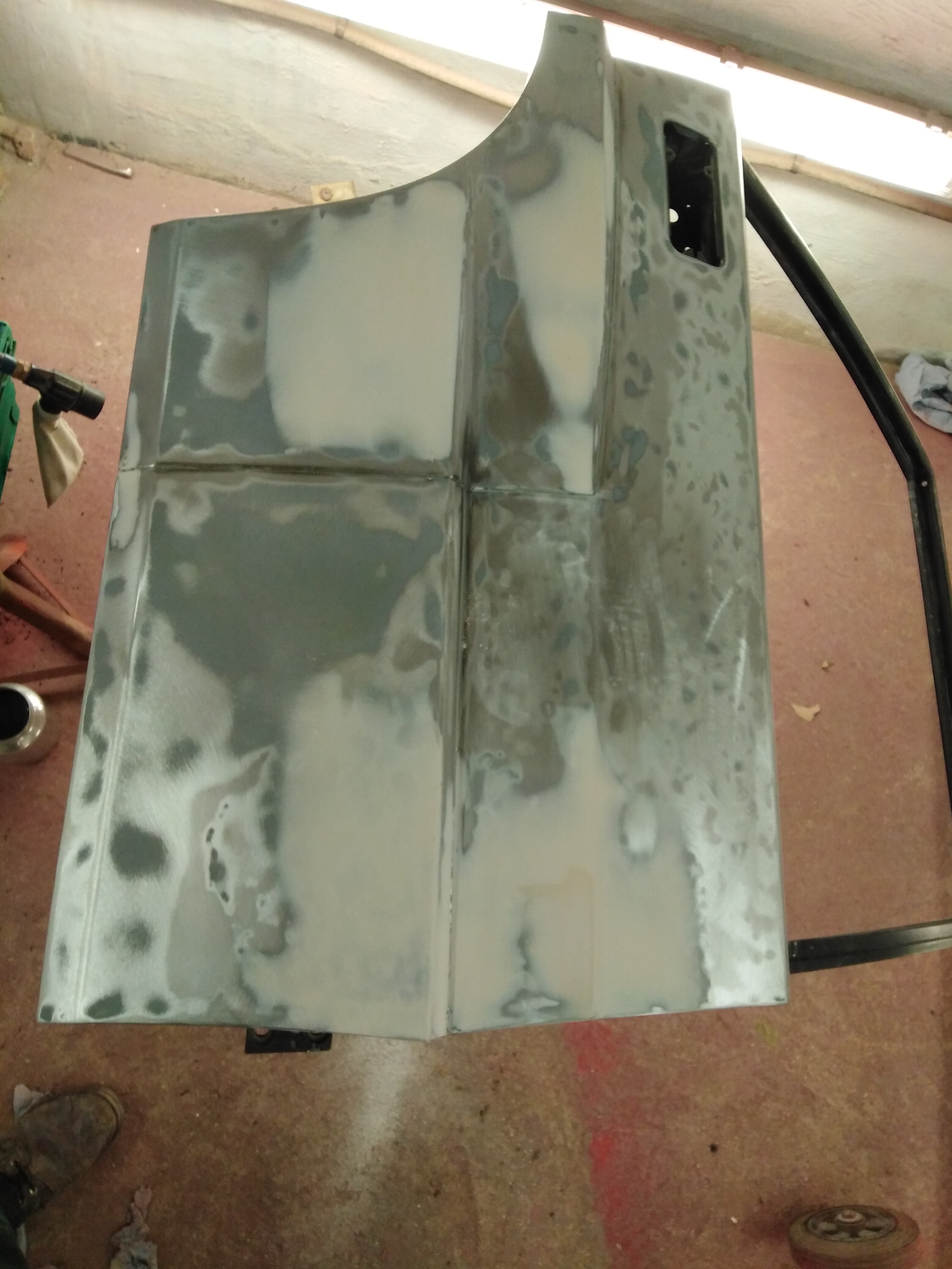

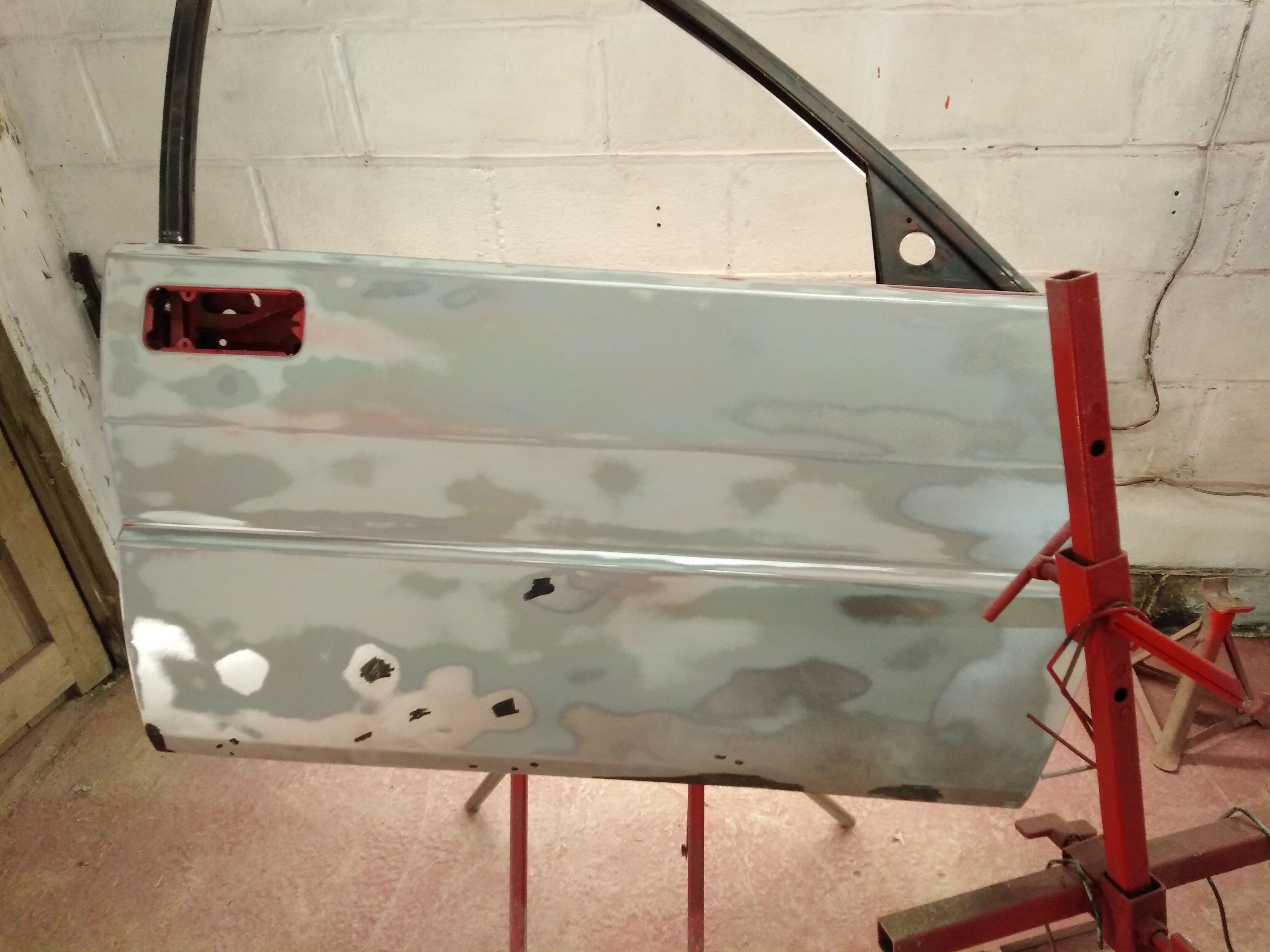

The door I'd dug the filler out of to find some rust spots got spot blasted now that I could use some dry grit!
You can usually get the spots out with the knotted wheel but sometimes the little dark spots are too deep and digging them out with the grinder loses too much good metal. The hand held spot blaster does a great job at getting rid of any dots of rust.
With that done all the little leftover dents and knocks could start to be redone, kind of think this door has had some damage at some point as the forward edge had been welded, not for rust I don't think but for a knock.

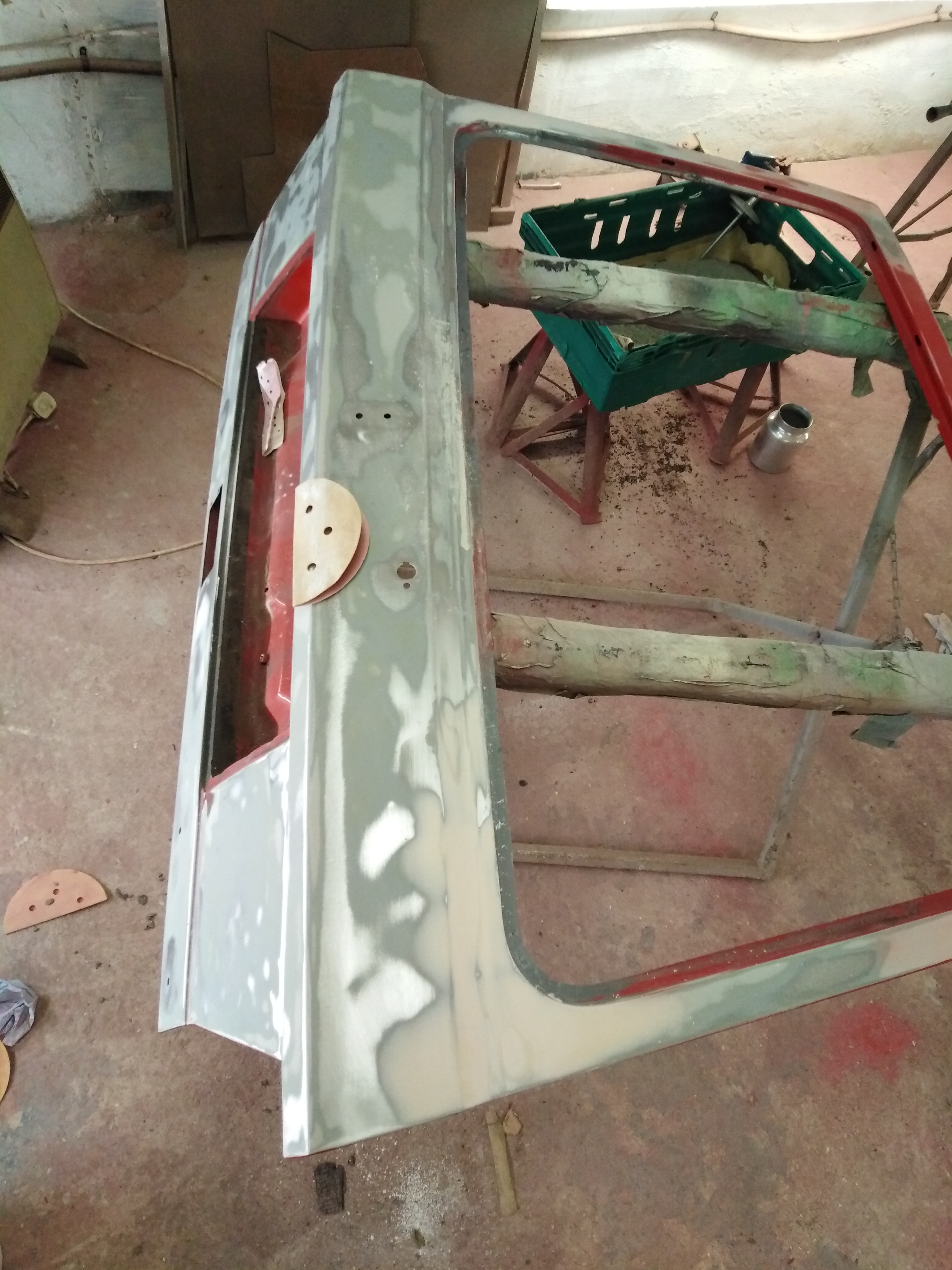

The rear hatch got sanded down and the repairs I'd previously done got filled, thankfully nothing untoward was found!

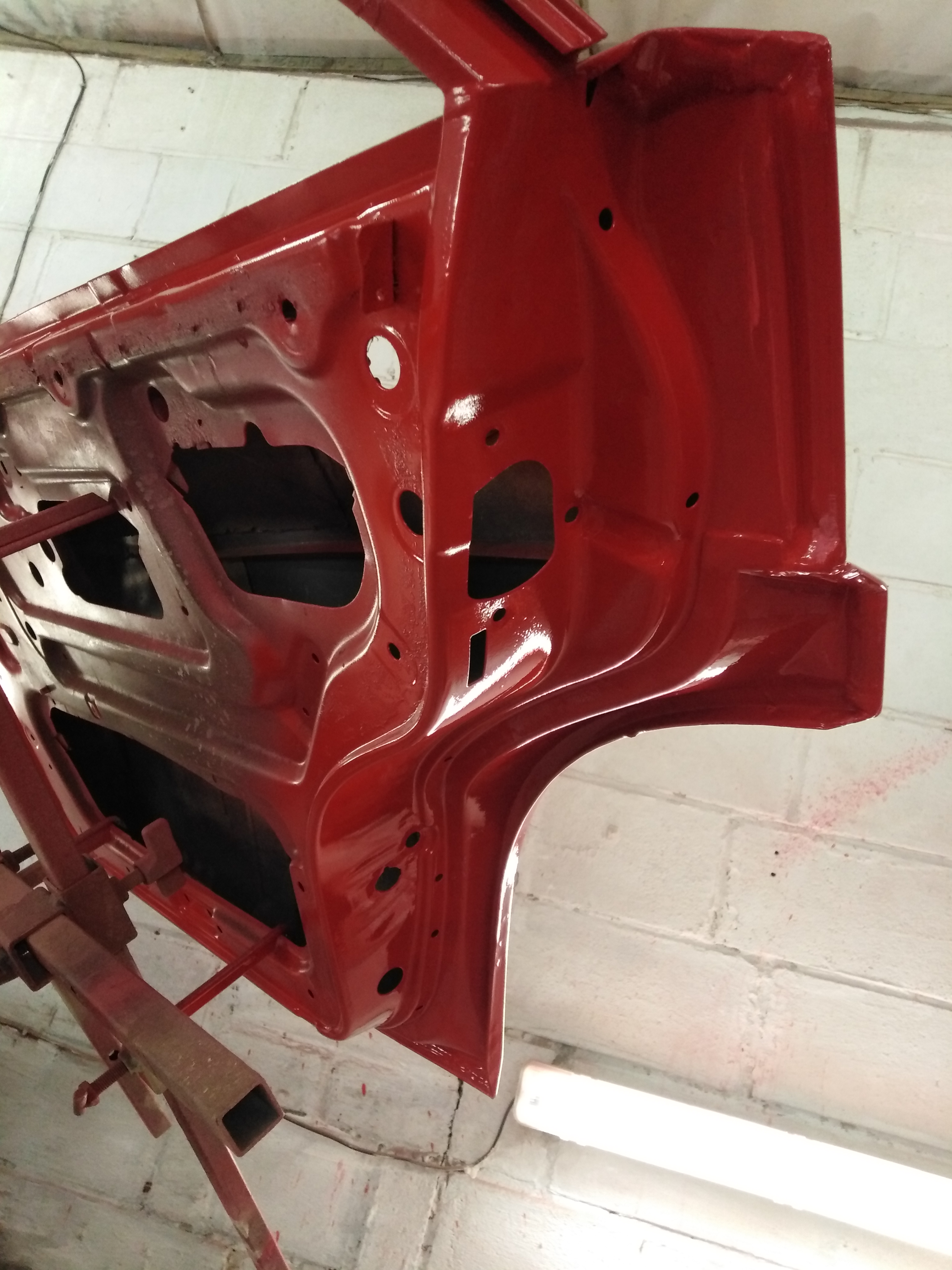

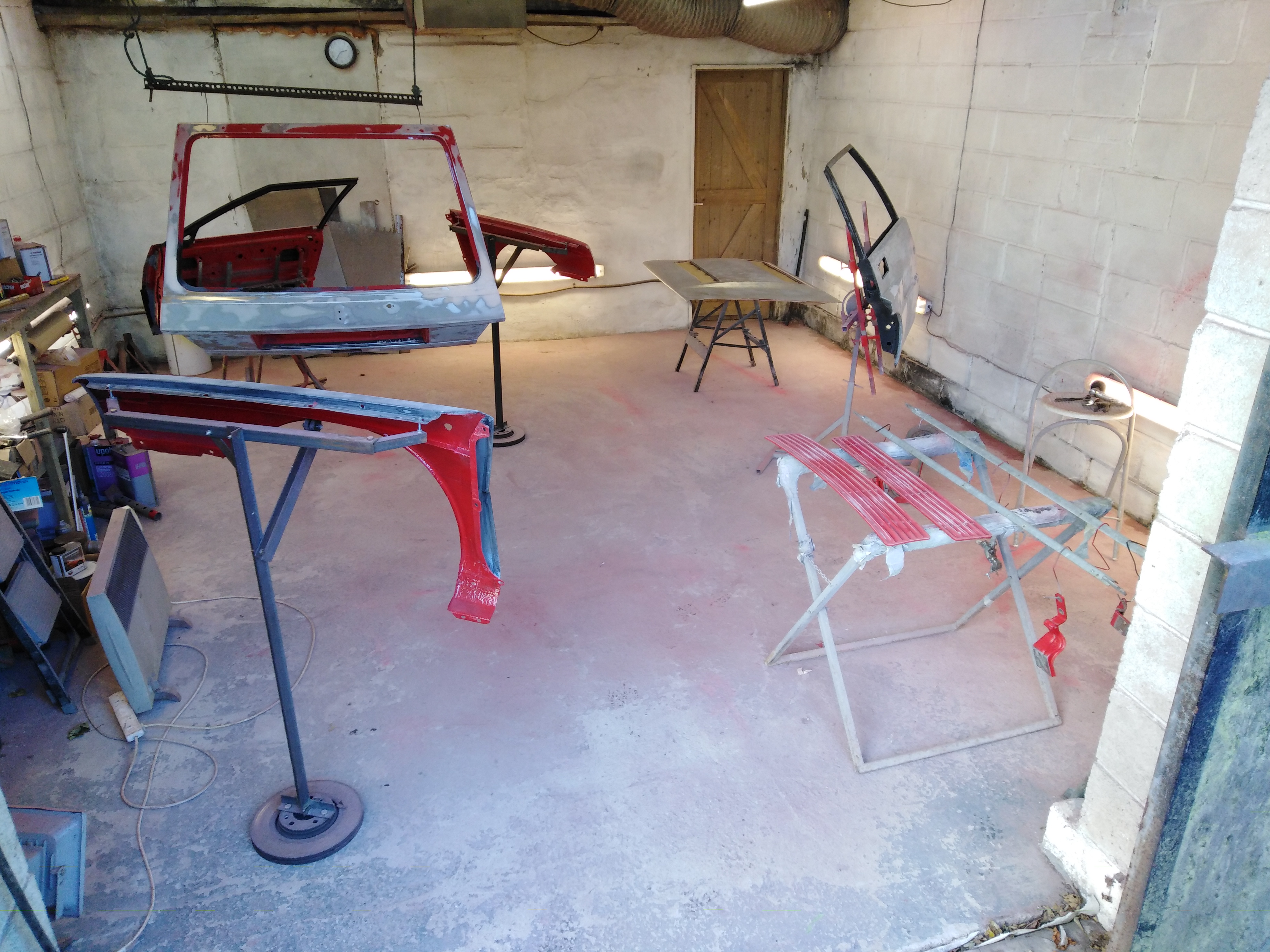

Finally got everything prepped for primer today, all laid out ready to go up there Wednesday afternoon and one last panel wipe then primer.
That will just leave the 2 rear plastic vents and the 2 bumpers to do...

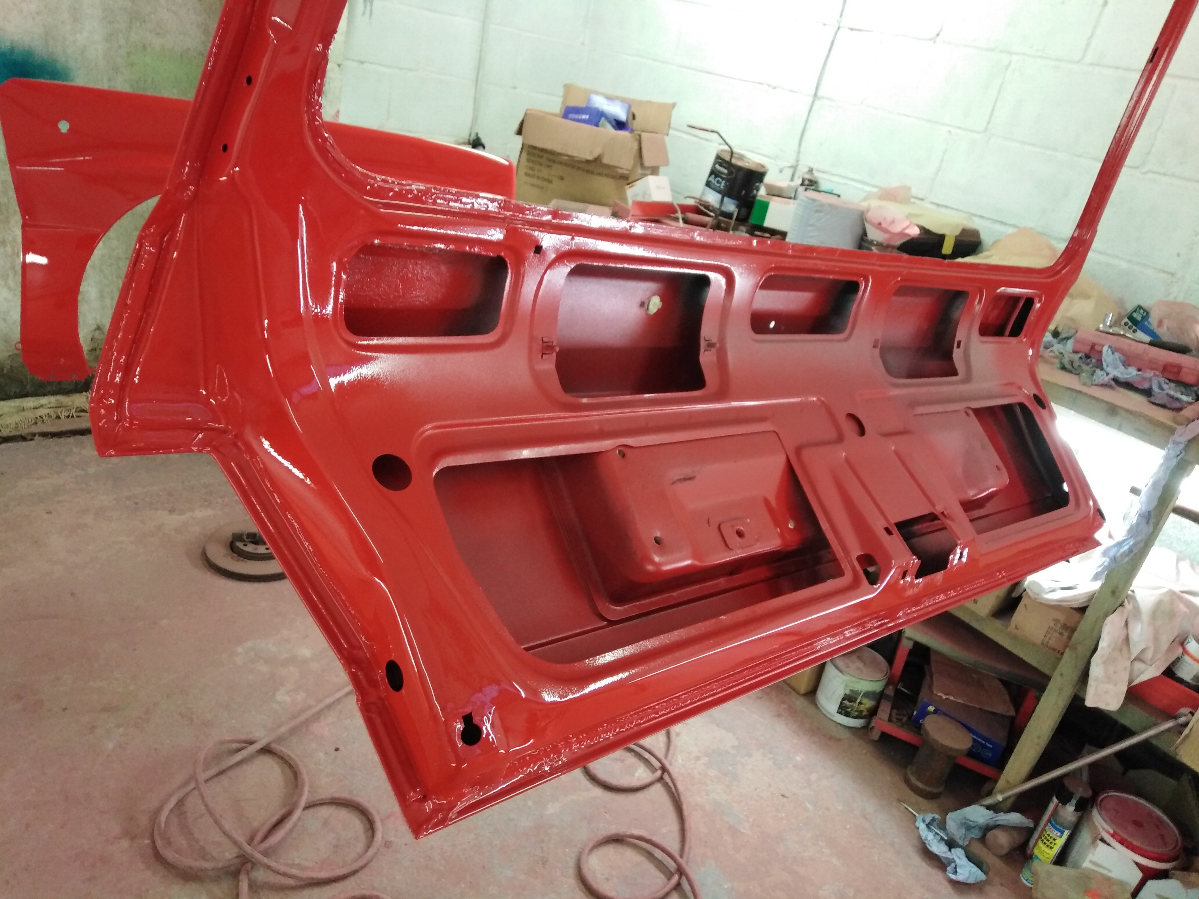

Primered it all on Wednesday, went up last night for a couple of hours then up there early today on a day's holiday off work to get the paint on. Just about got in time as was a dry and bright but not overly warm day, loads of gas used on the heaters!
Hatch needed a new location point making for the bump stop in the corner which has come out ok, most of the repairs will be hidden still

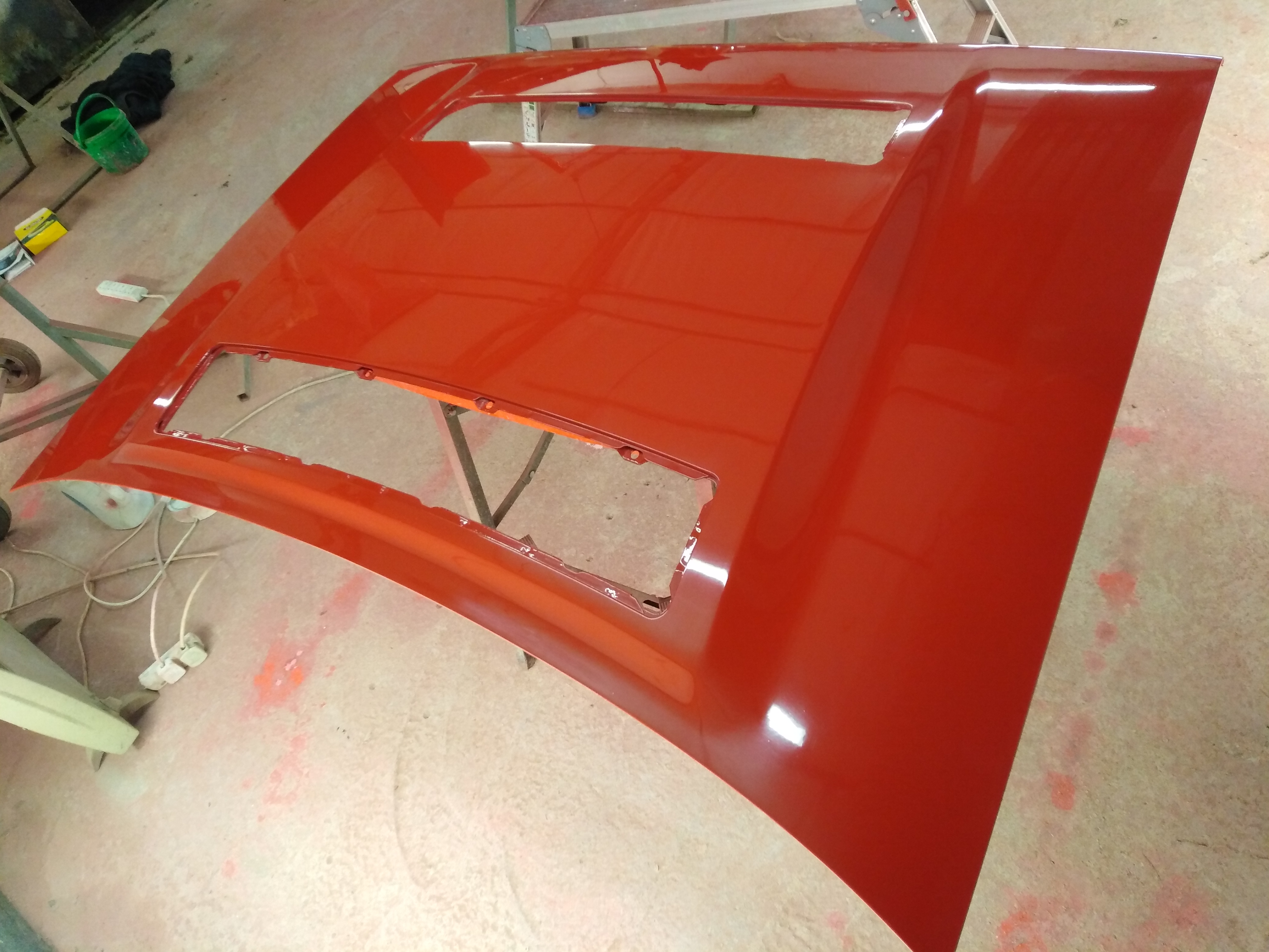

Bonnet got some dust in it but should flat out ok, passenger wing that had all the repairs has come out well though.

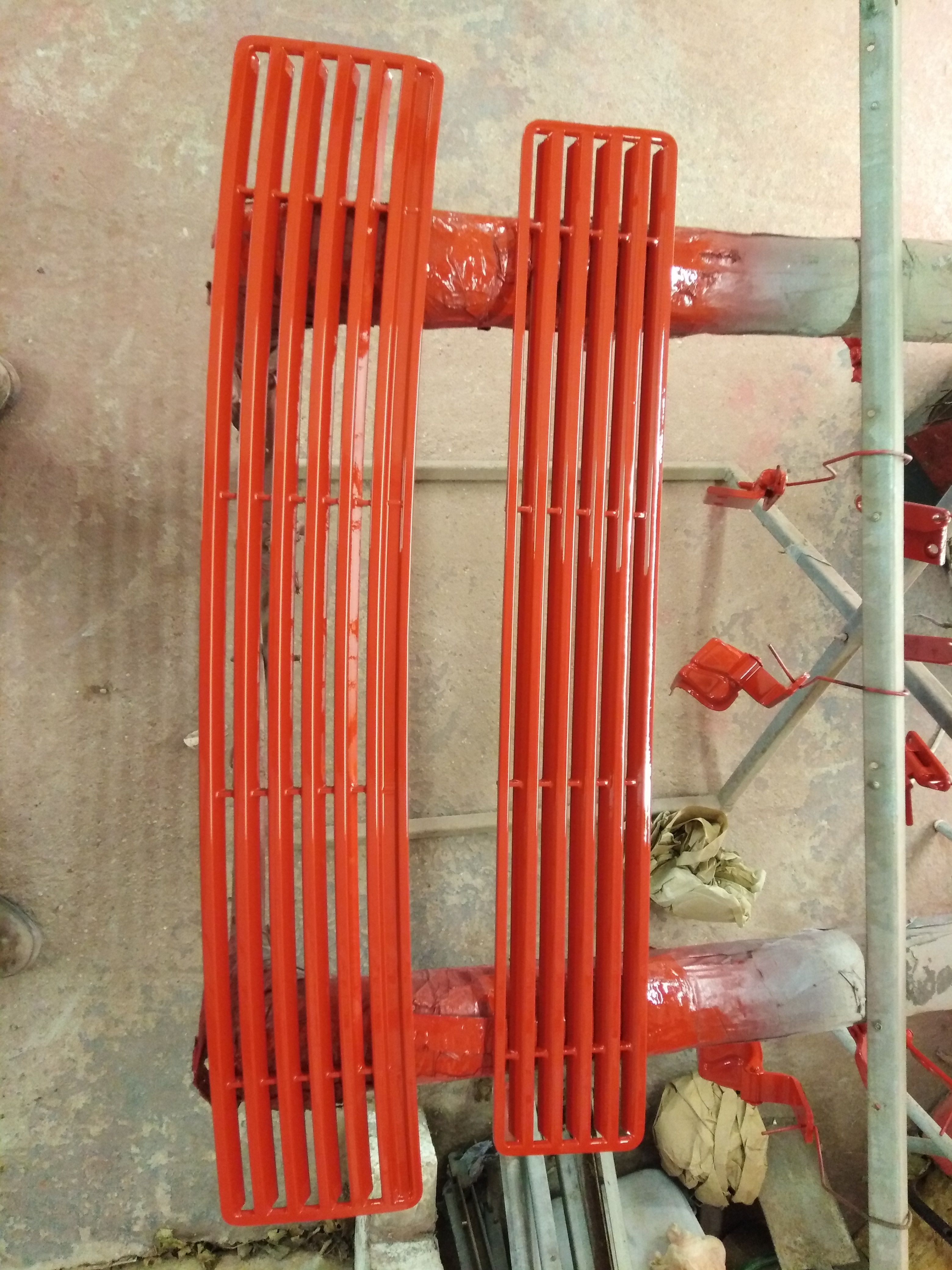

Bonnet vents are actually alloy not plastic, a few hinges etc got done also.
Hoping to get up there Sunday to flat and polish the panels.

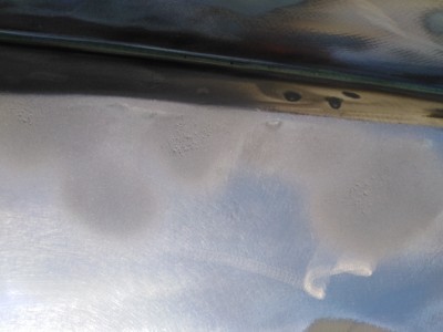

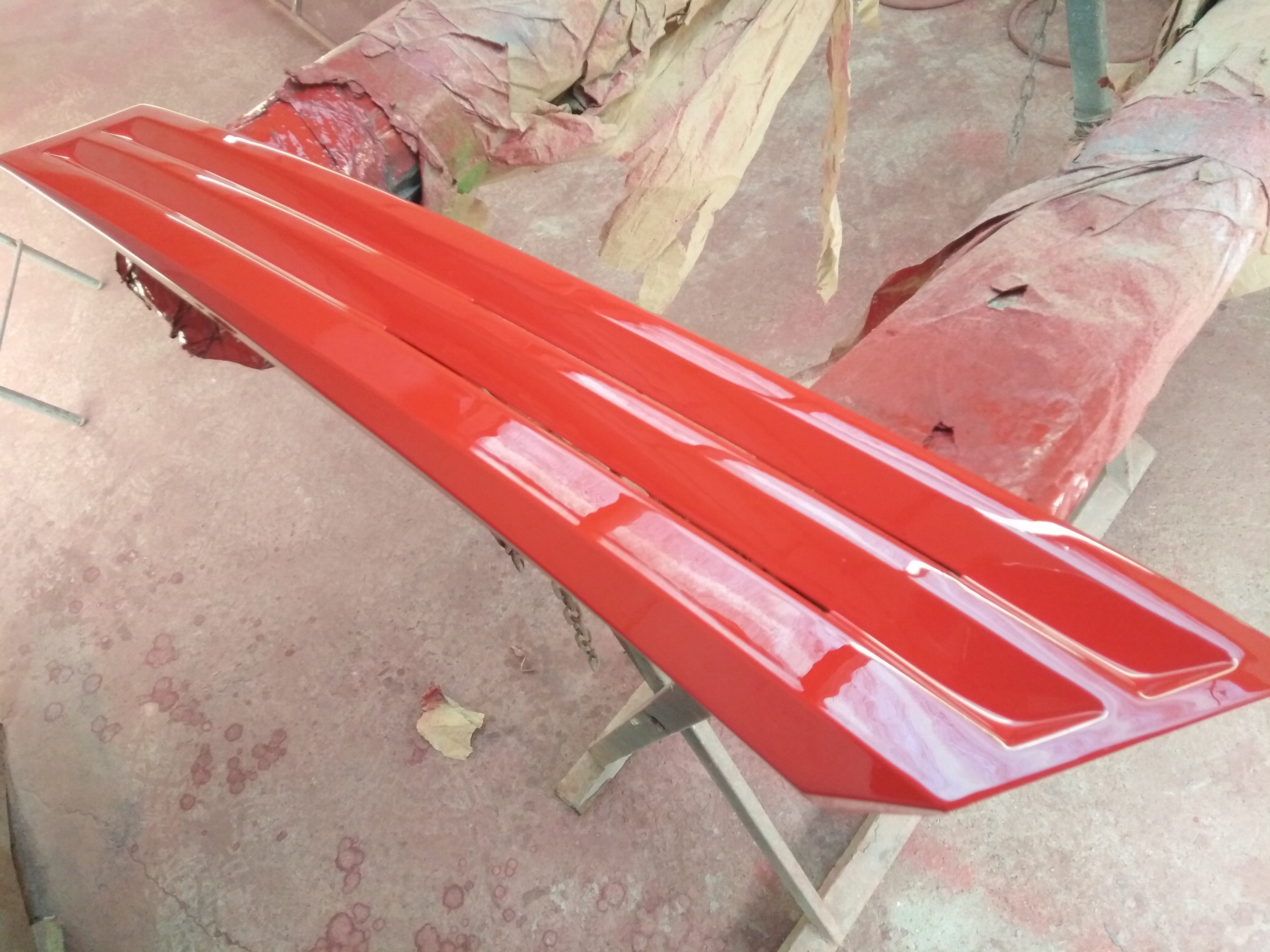

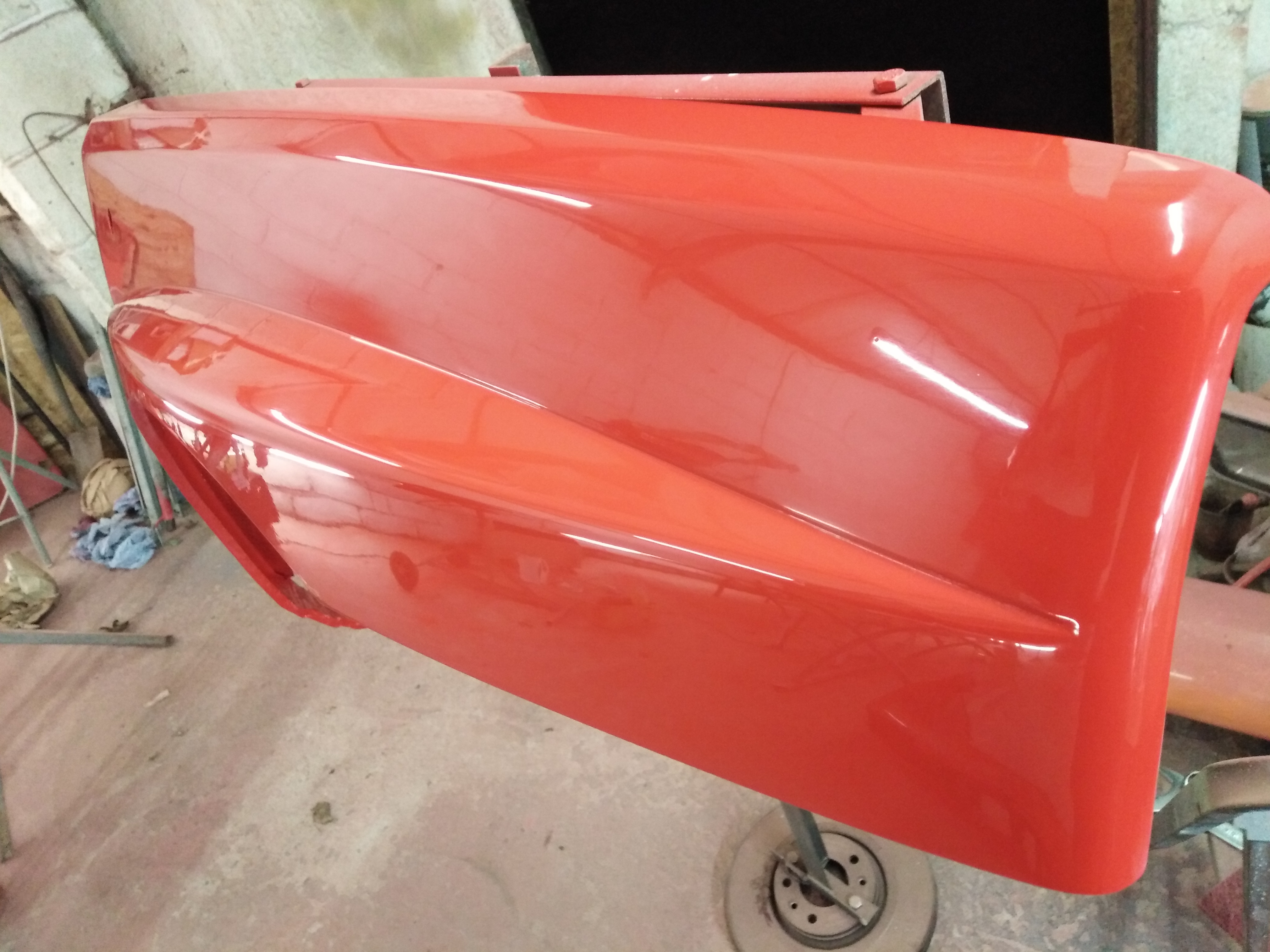

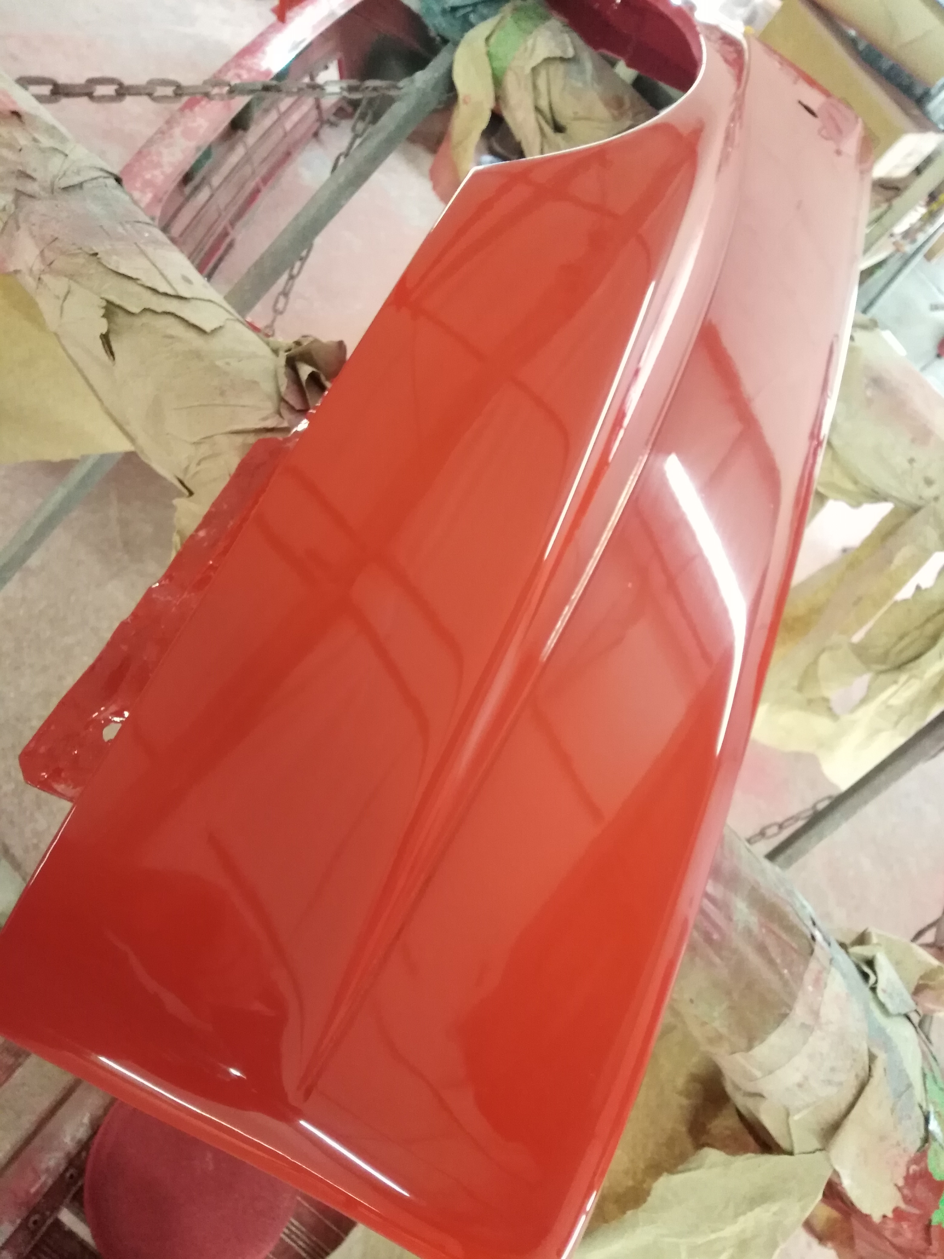

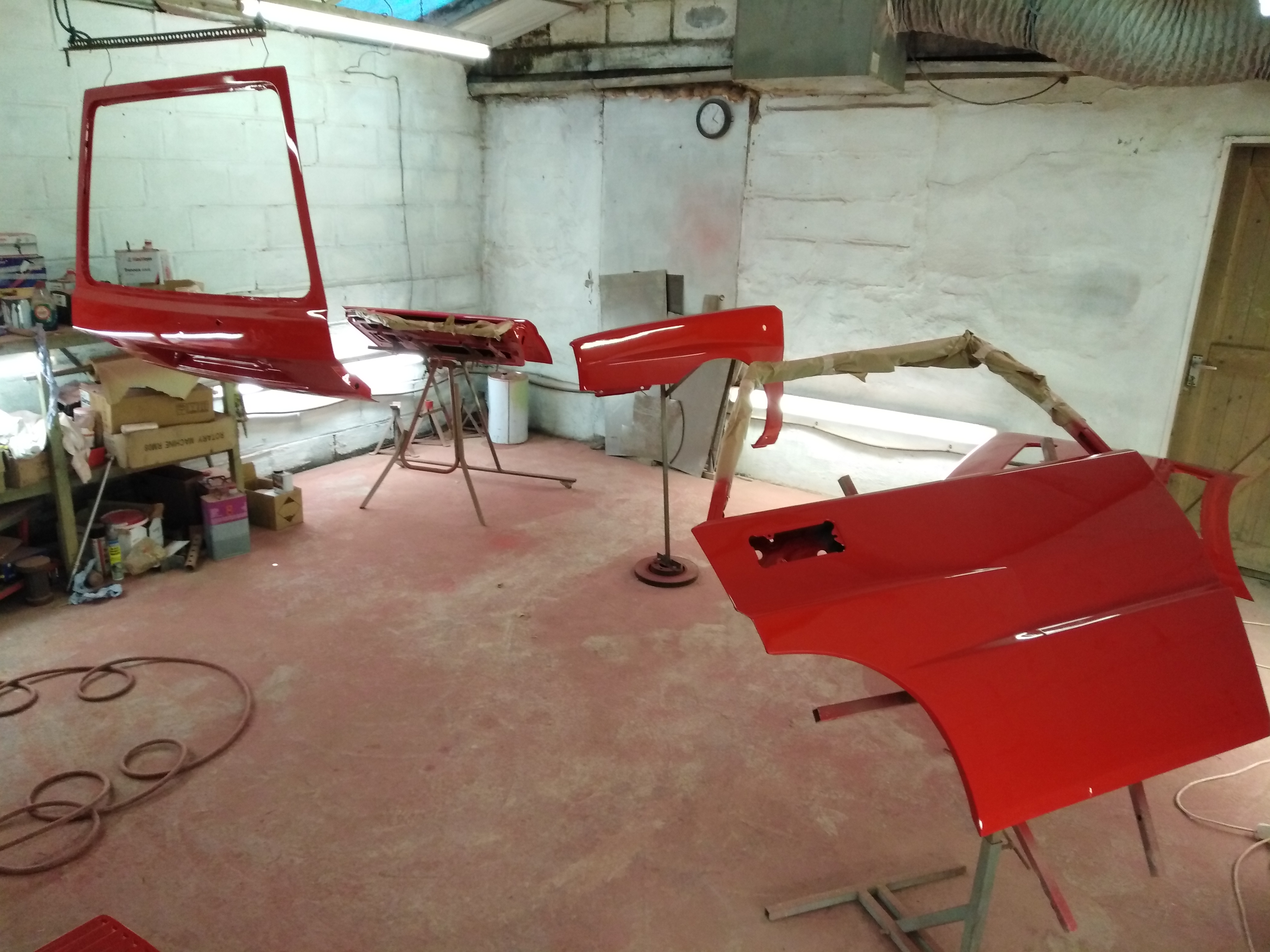

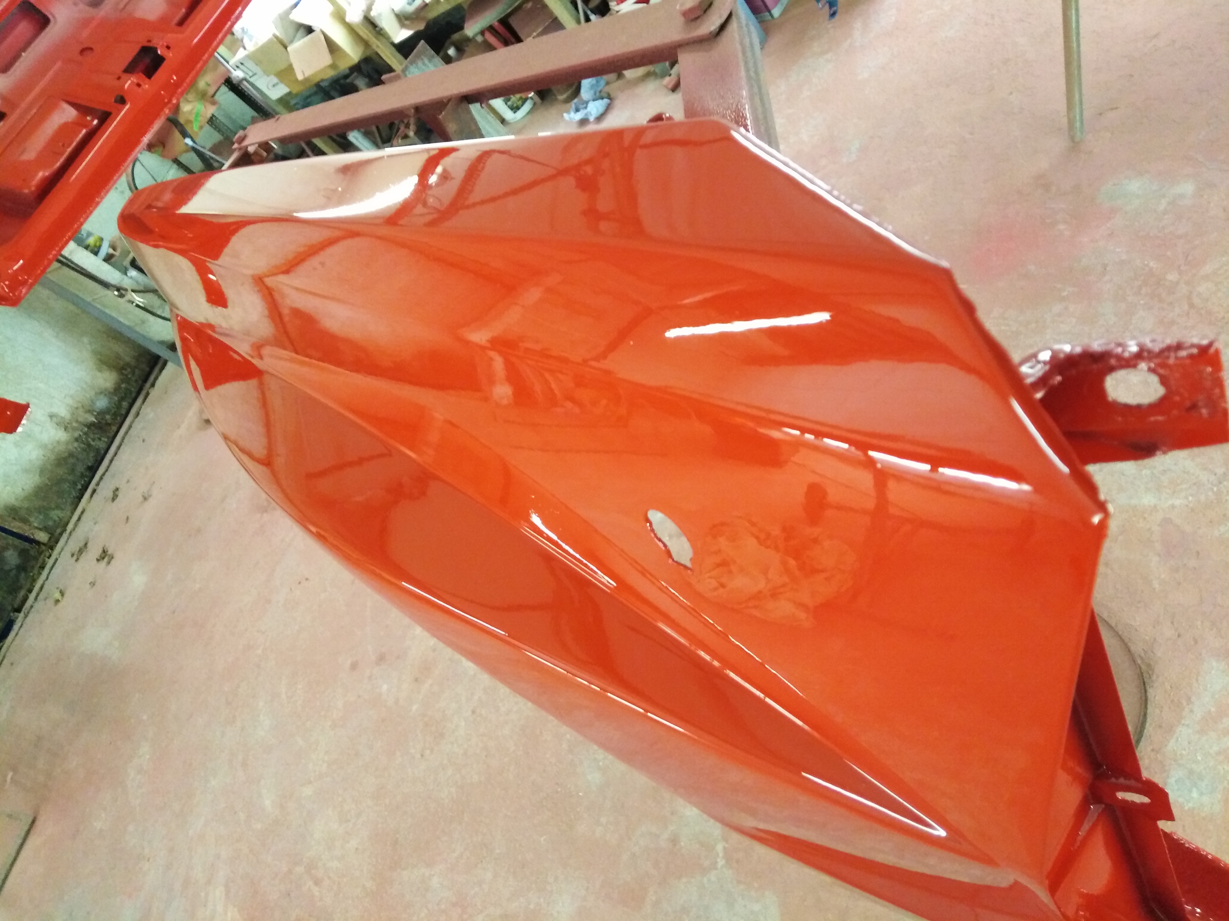

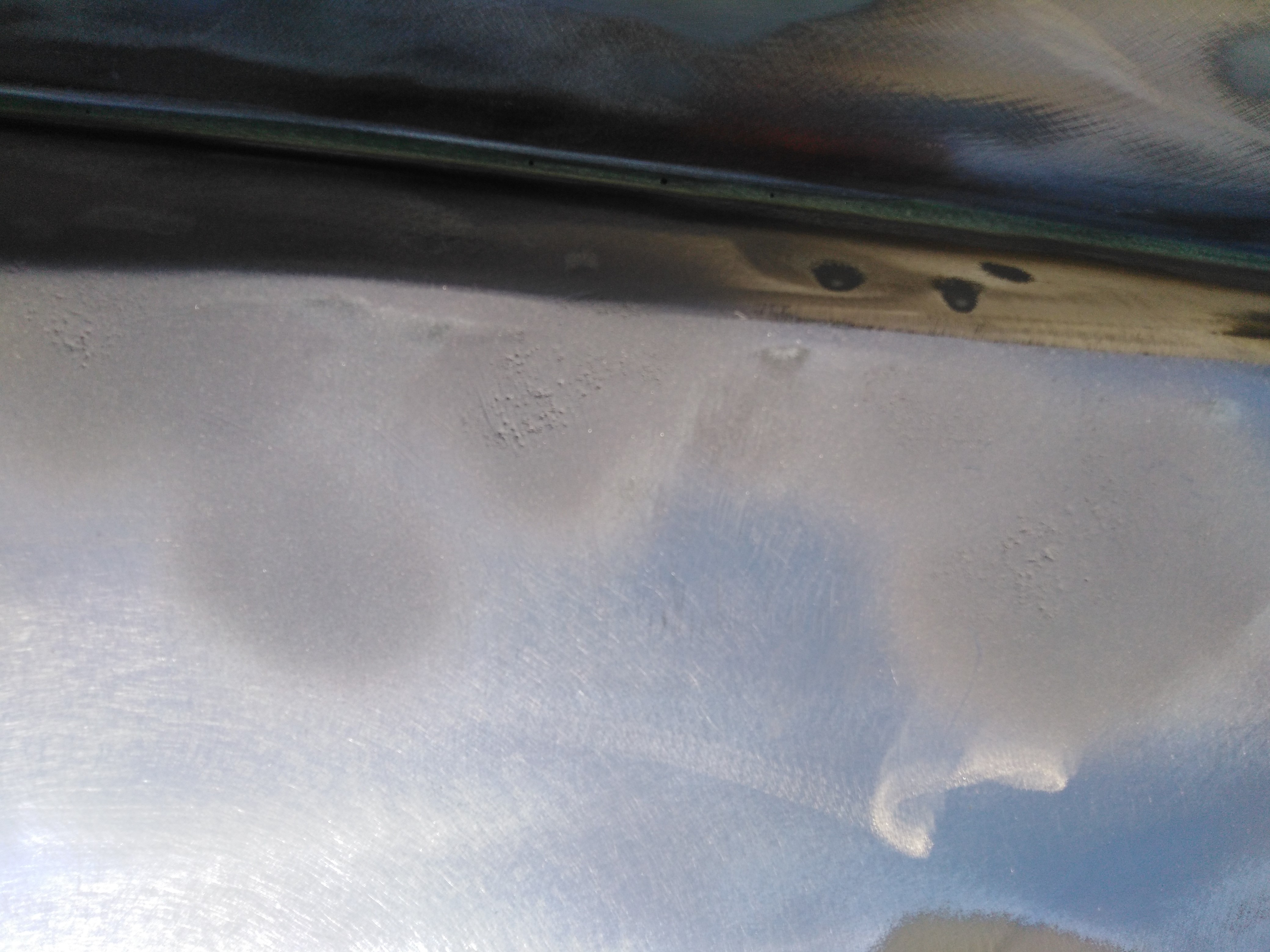

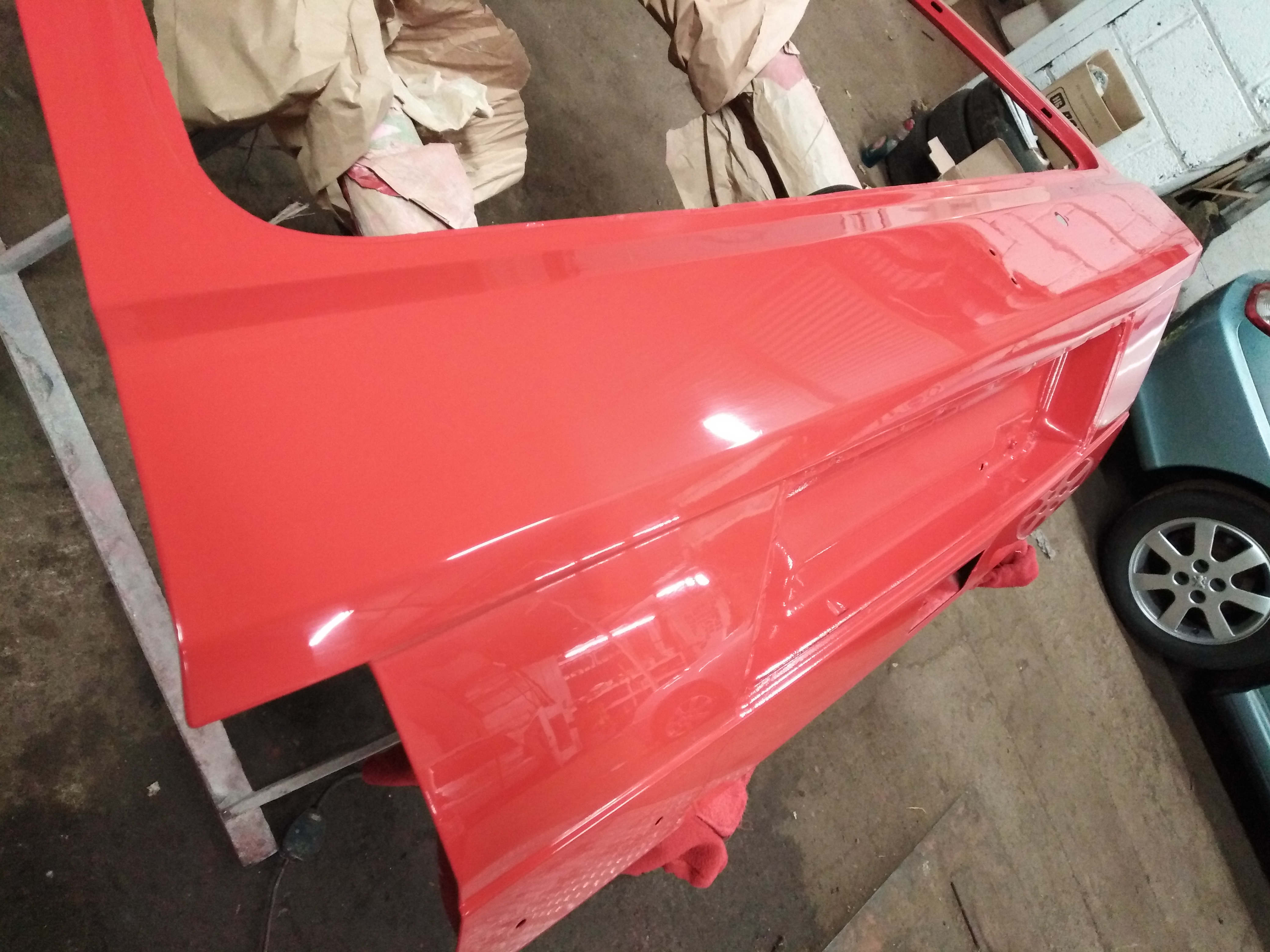

Had a good few hours up at the unit this afternoon to flat and polish up the panels, happy with the results 8-)
Wasn't too bad on the orange peel front other than the bonnet which strangely should have been easier to get a nice flat finish!
Advantage to doing the doors on the stands rather than on the car is the underside and ends etc can be painted.
8-)
Great finish. Well done.
Nice work kev .your getting pretty handy with gun now respect :D looks great 8-)

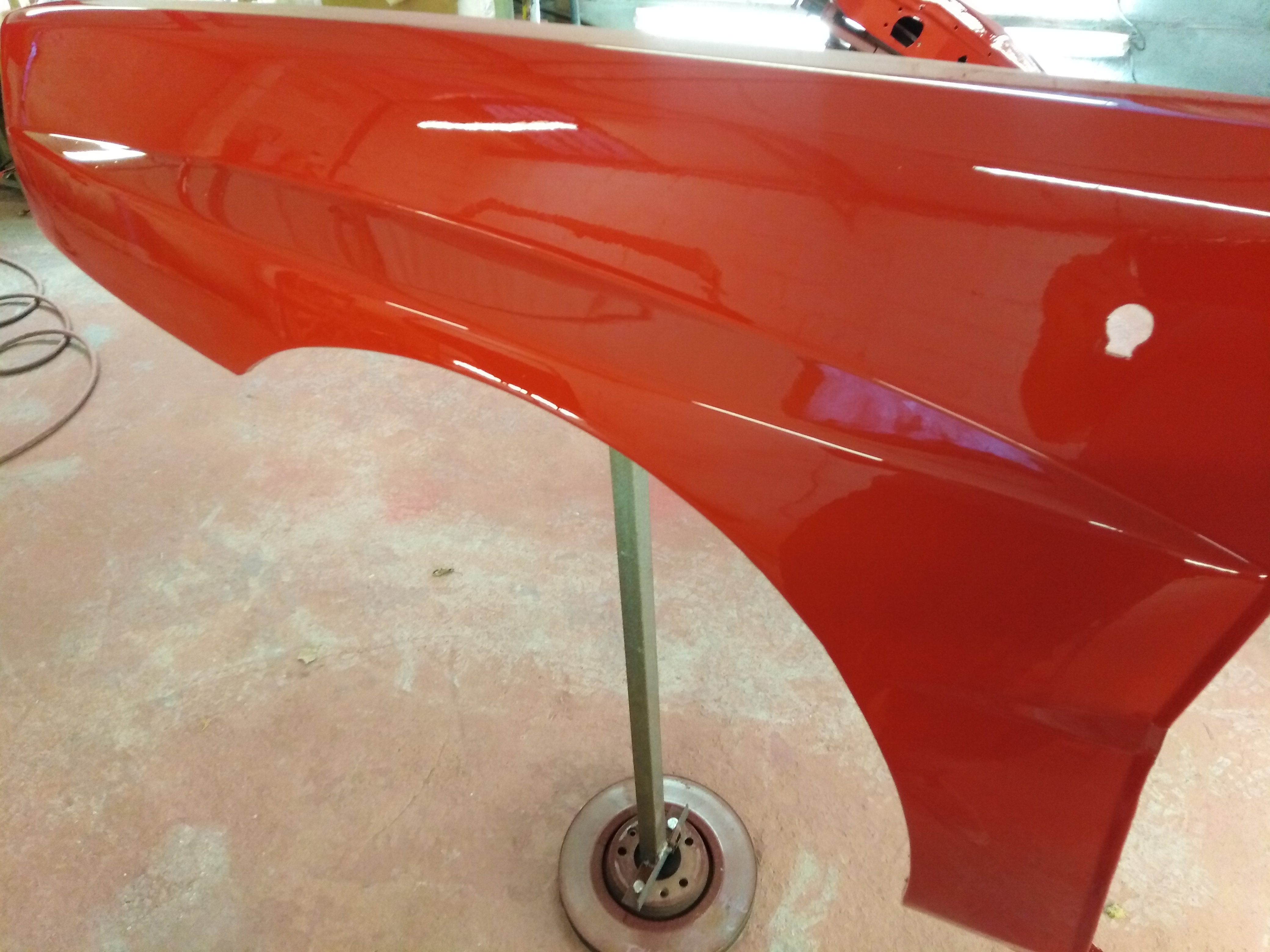

The last pic is more the red I was expecting Kev. Who says the camera never lies.
Sud 145 wrote:The last pic is more the red I was expecting Kev. Who says the camera never lies.
Amazing how crap the camera is at picking up red mate!
I'll try a pic with the camera next time instead of my phone..
This is the hatchback that I flatted and polished this afternoon, looks almost pink! Hope it's a few more years before it turns :? :lol:

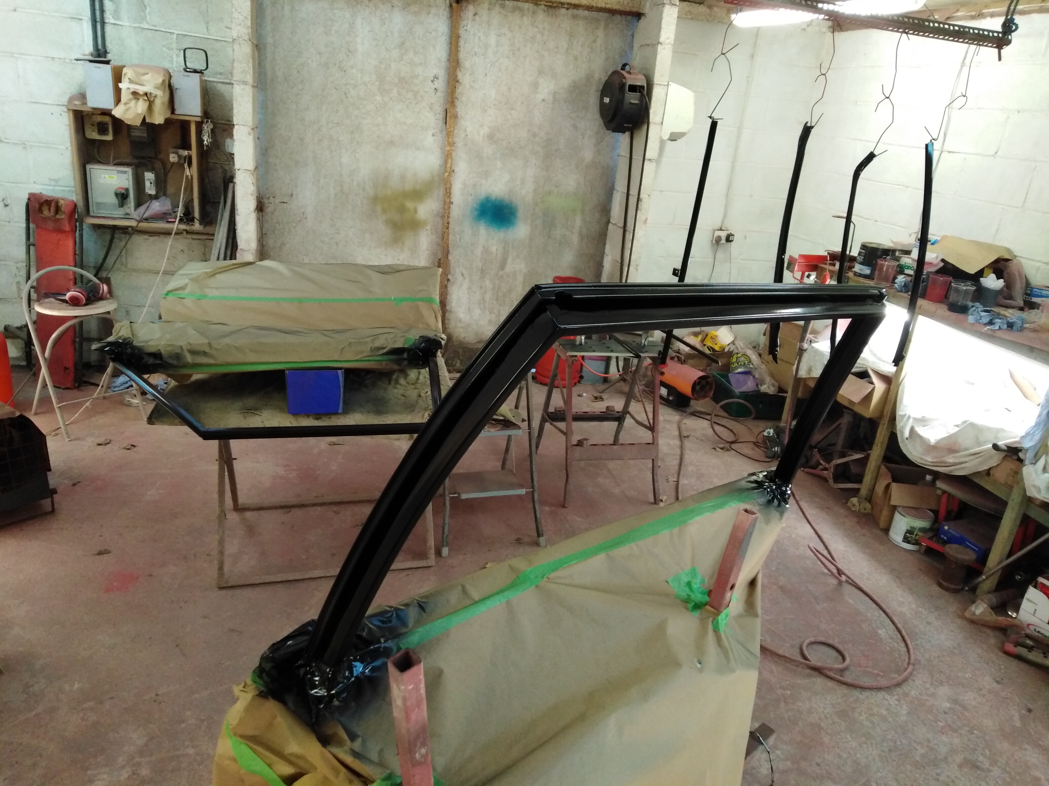

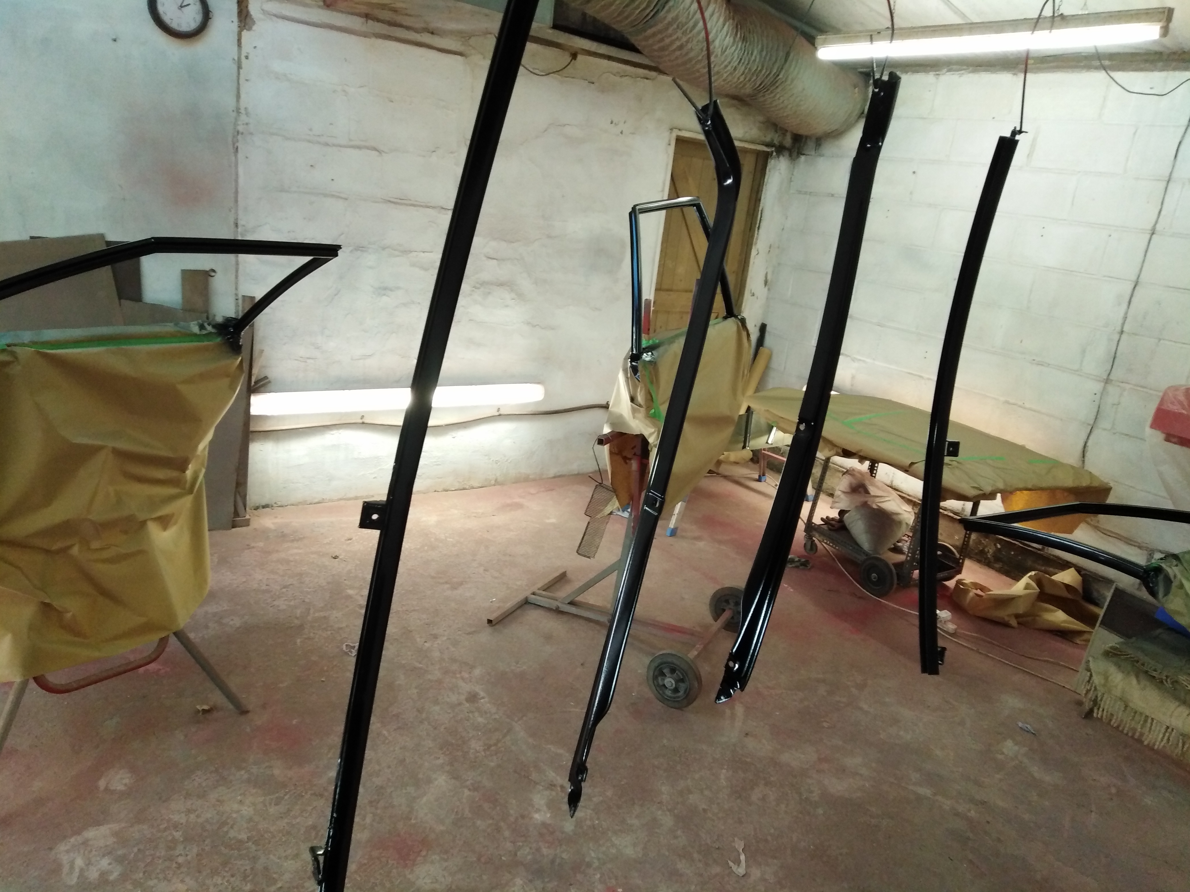

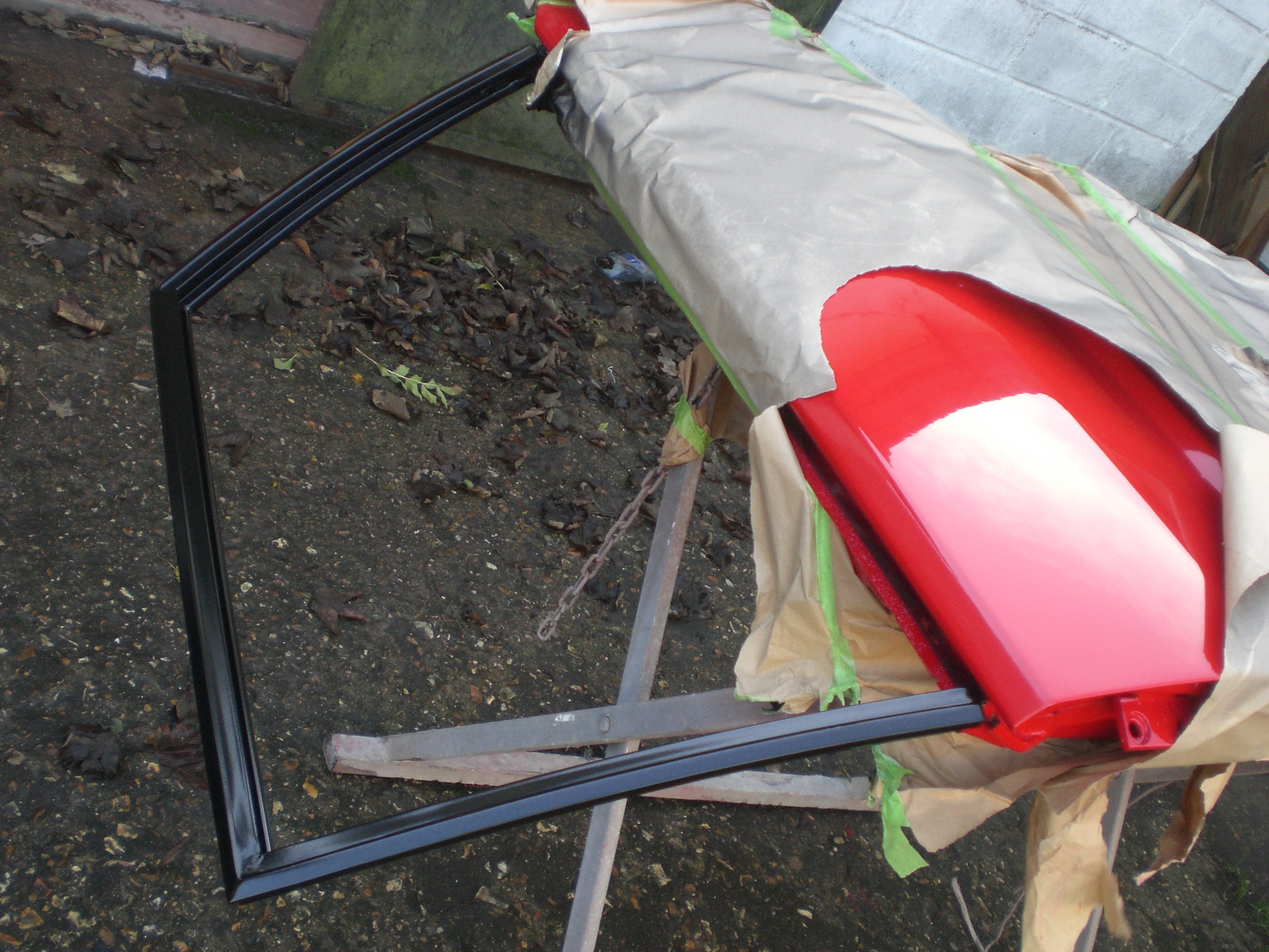

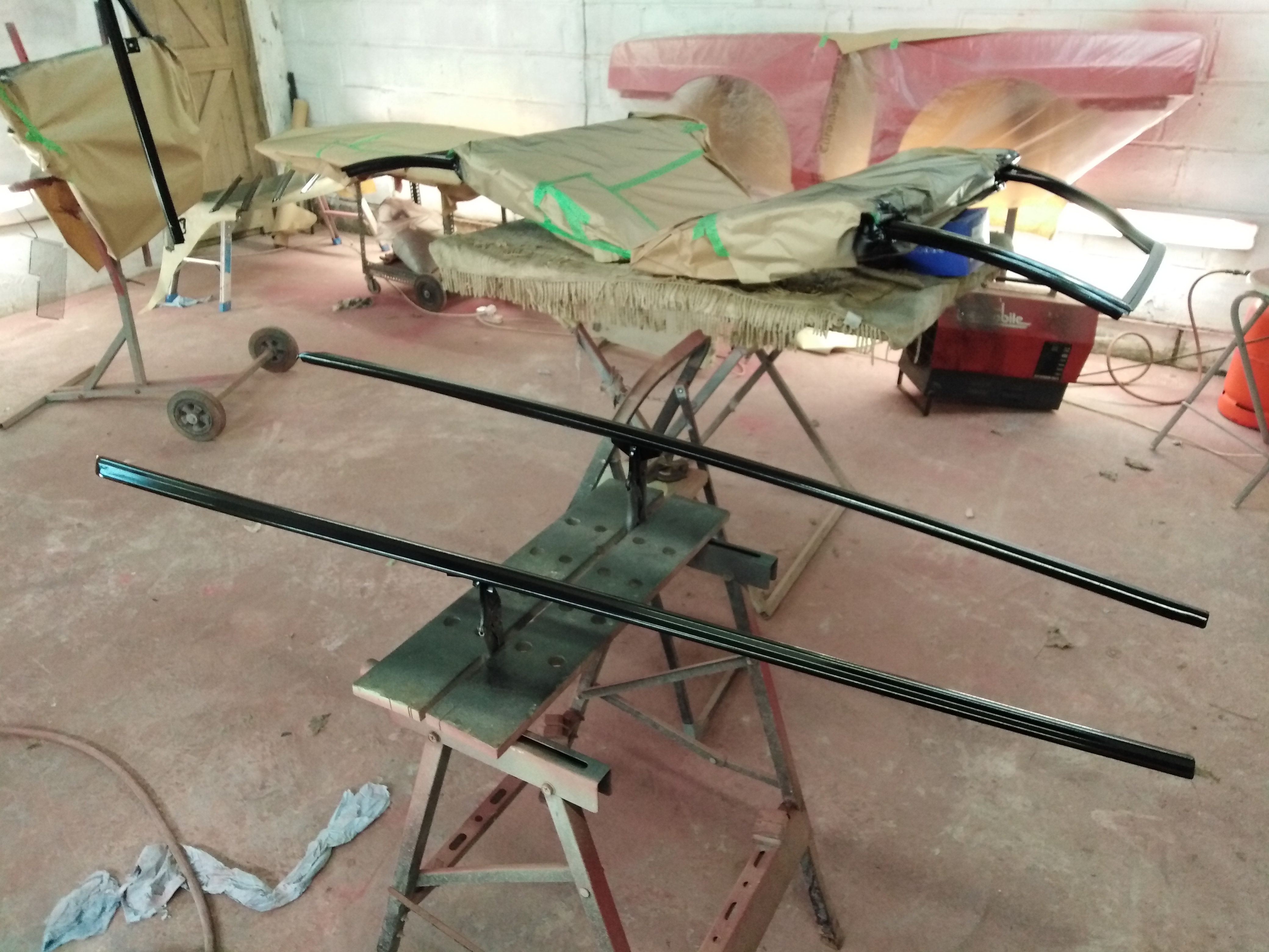

Yesterday afternoon I set about prepping the door frames for paint as they need to be black.
Of course to make things match that means the weather strips also need doing along with the rear doors window runners.
The gutter trim looked like it was a dark grey but after looking at original pictures they appear black like the other parts so I prepped them too.

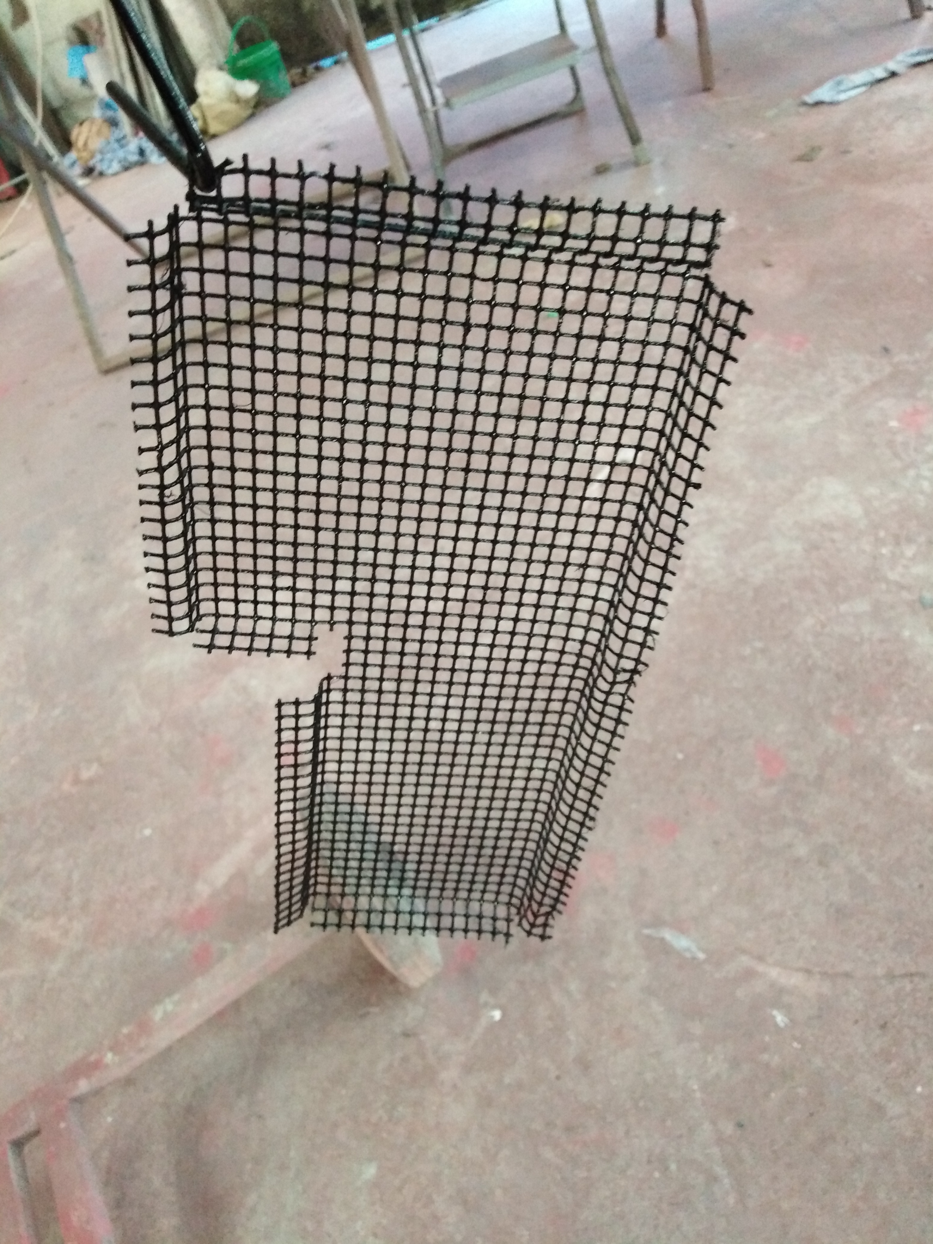

The front bumper also had some metal grilles either side of the number plate which looked cruddy so they joined the satin black party.
The passenger window guide I had to chop about a bit as the bottom few inches were rotten and the centre bracket missing, of course that was the only passenger one I had yet I have 3 drivers ones!
I used the top section off the drivers side one which handily flipped the centre bracket to the correct side then welded the bottom bracket on. Handily it all fits to the door, best to check this before painting!
All painted today with my little miniature spray gun, a real nice tip to get one, cheers JB ;)

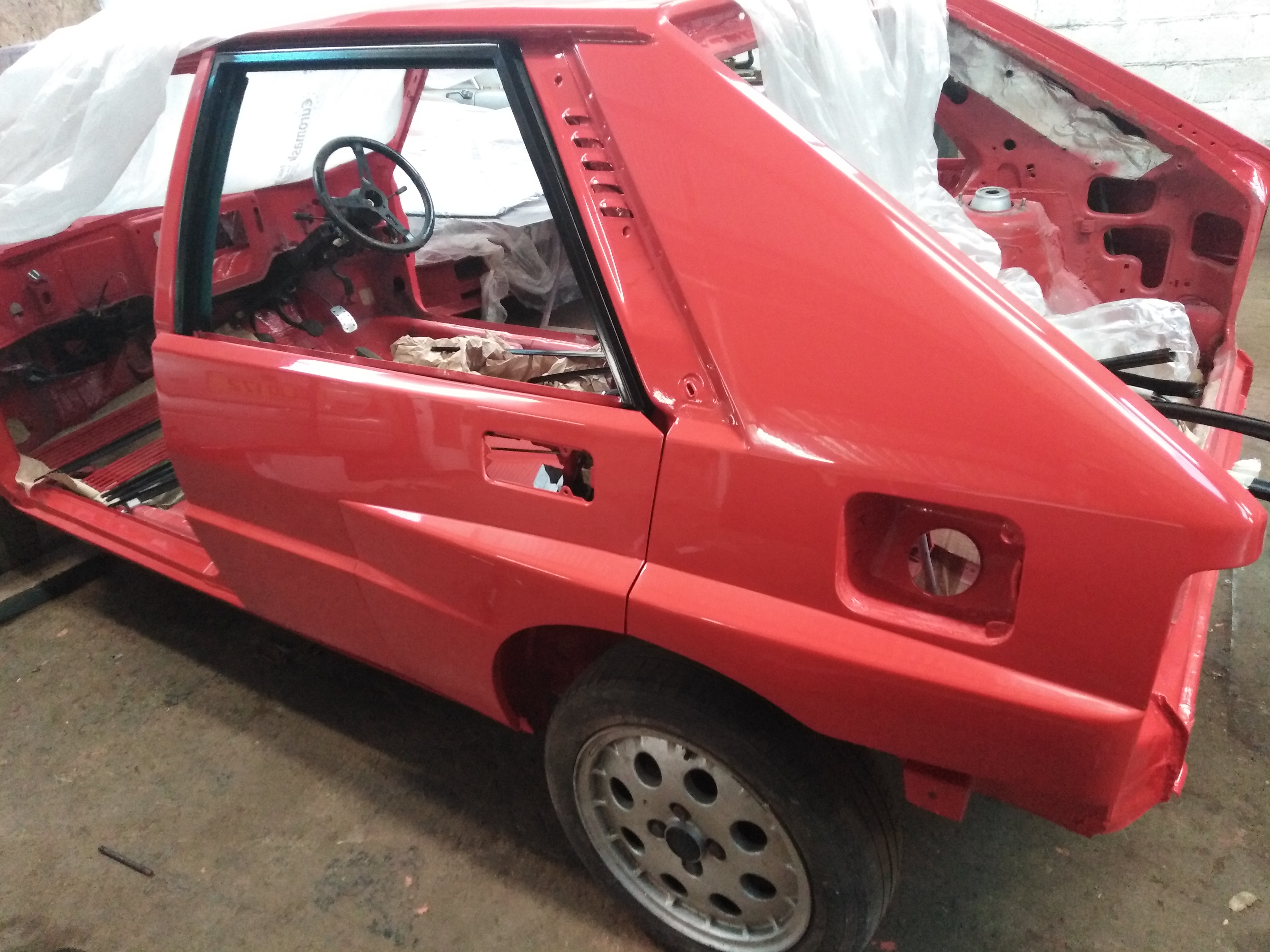

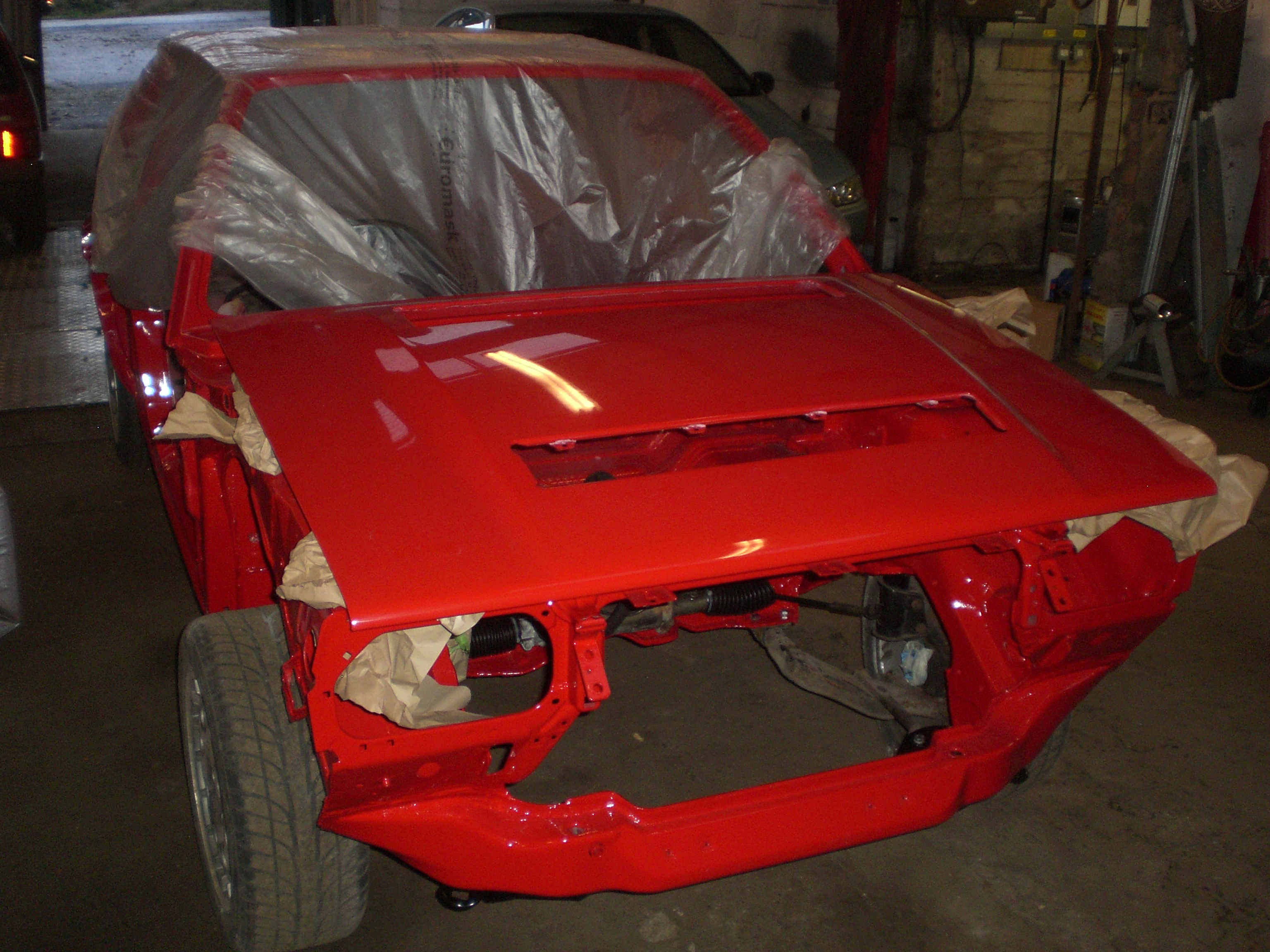

Took a few pictures with a regular camera which have come out a bit more representative of the correct colour, just for you Tony :)
Best place to store the bonnet I figured was back on the car! at least I can say I've started to put it back together! :lol:
At least it doesn't look pink! :D

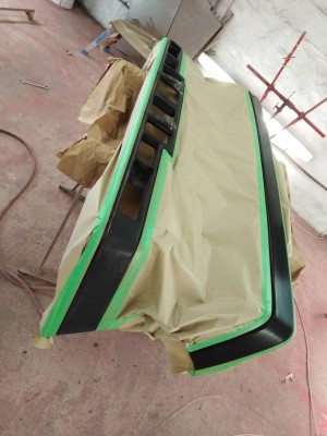

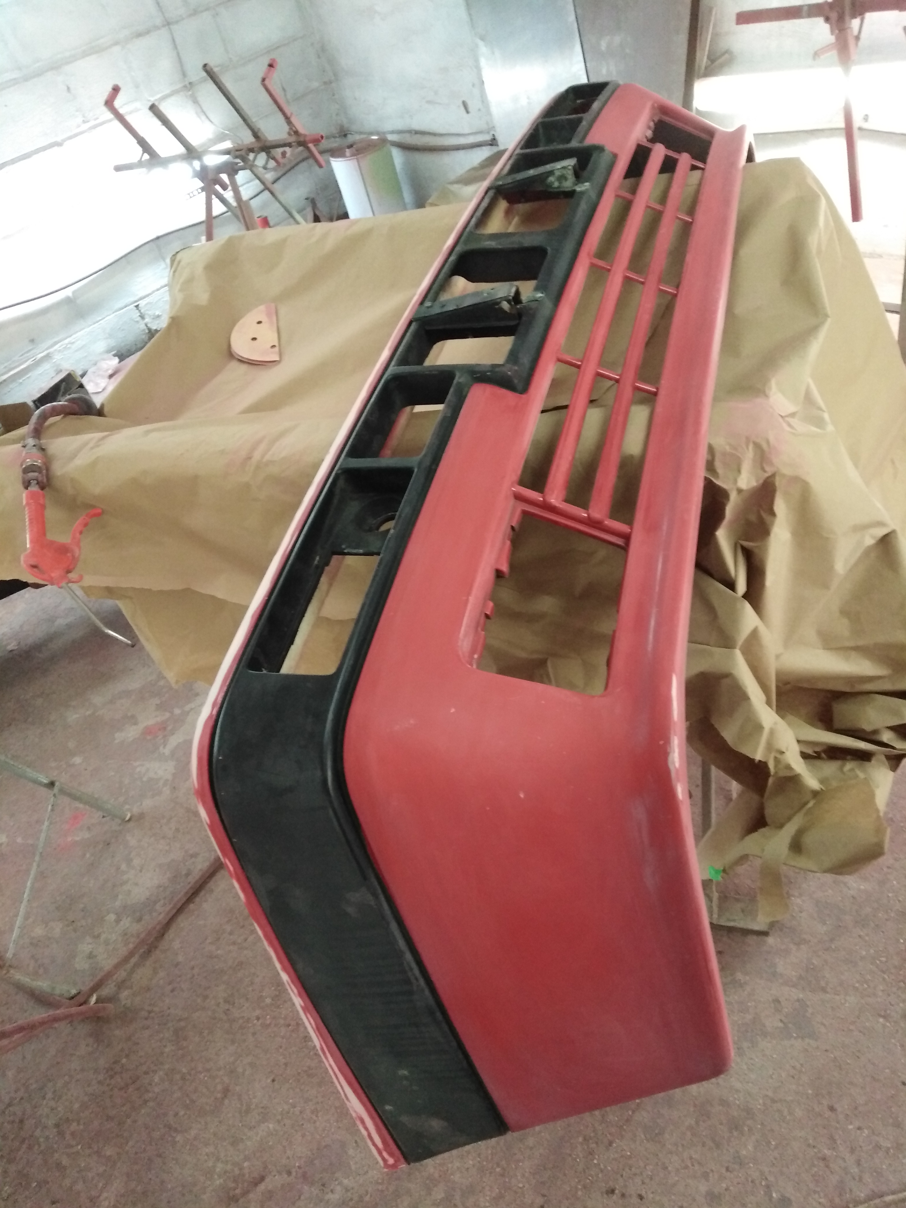

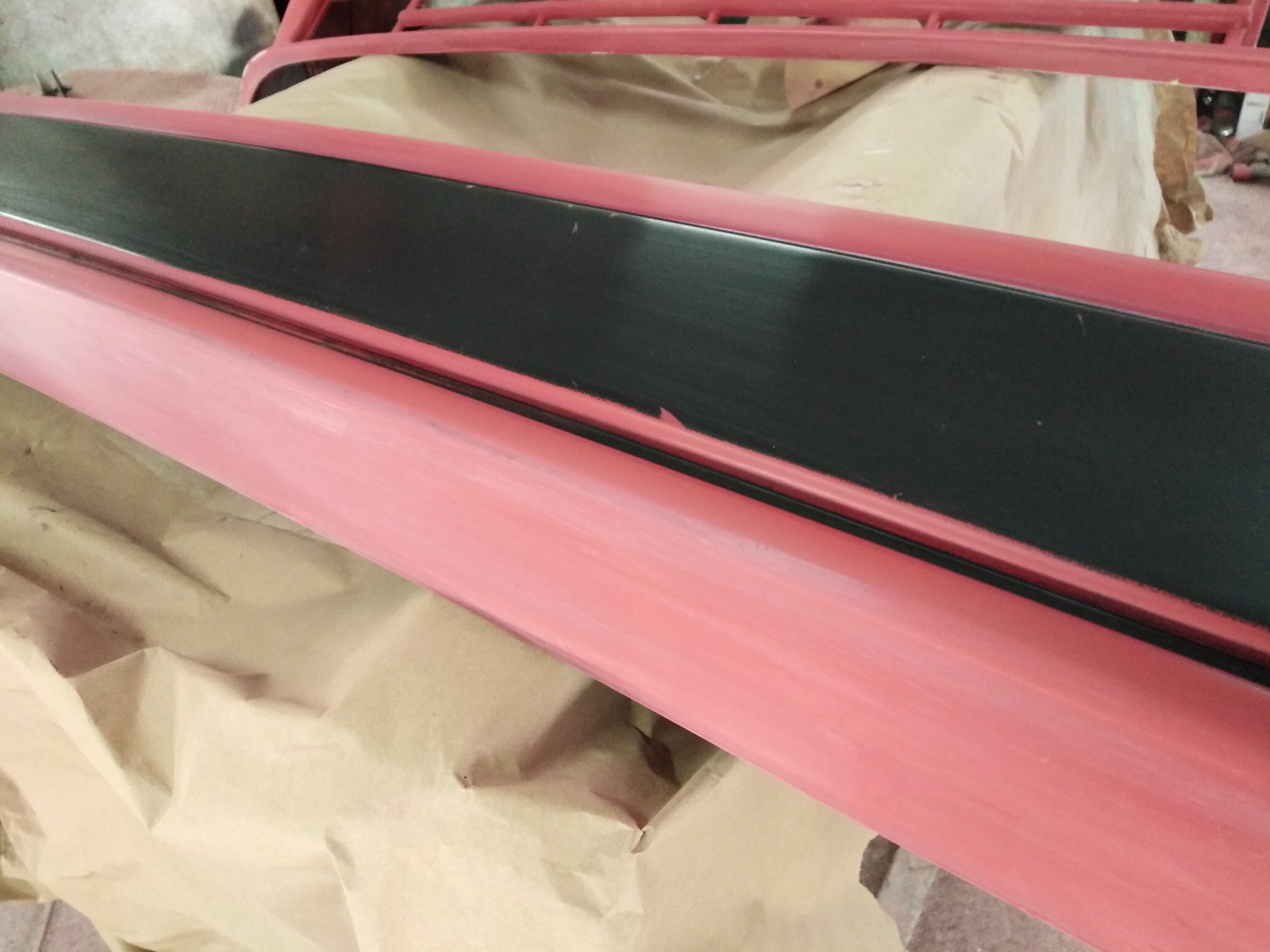

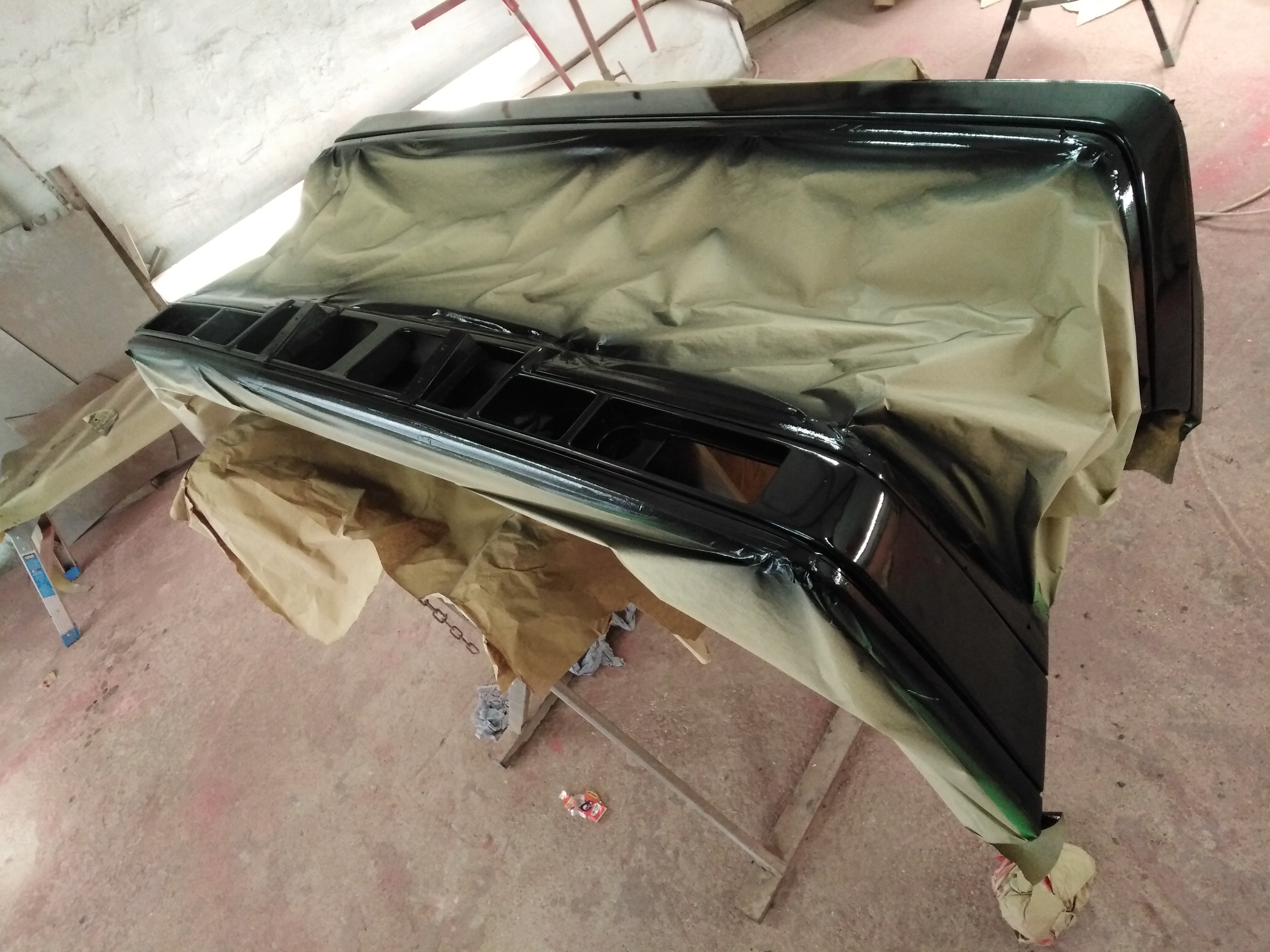

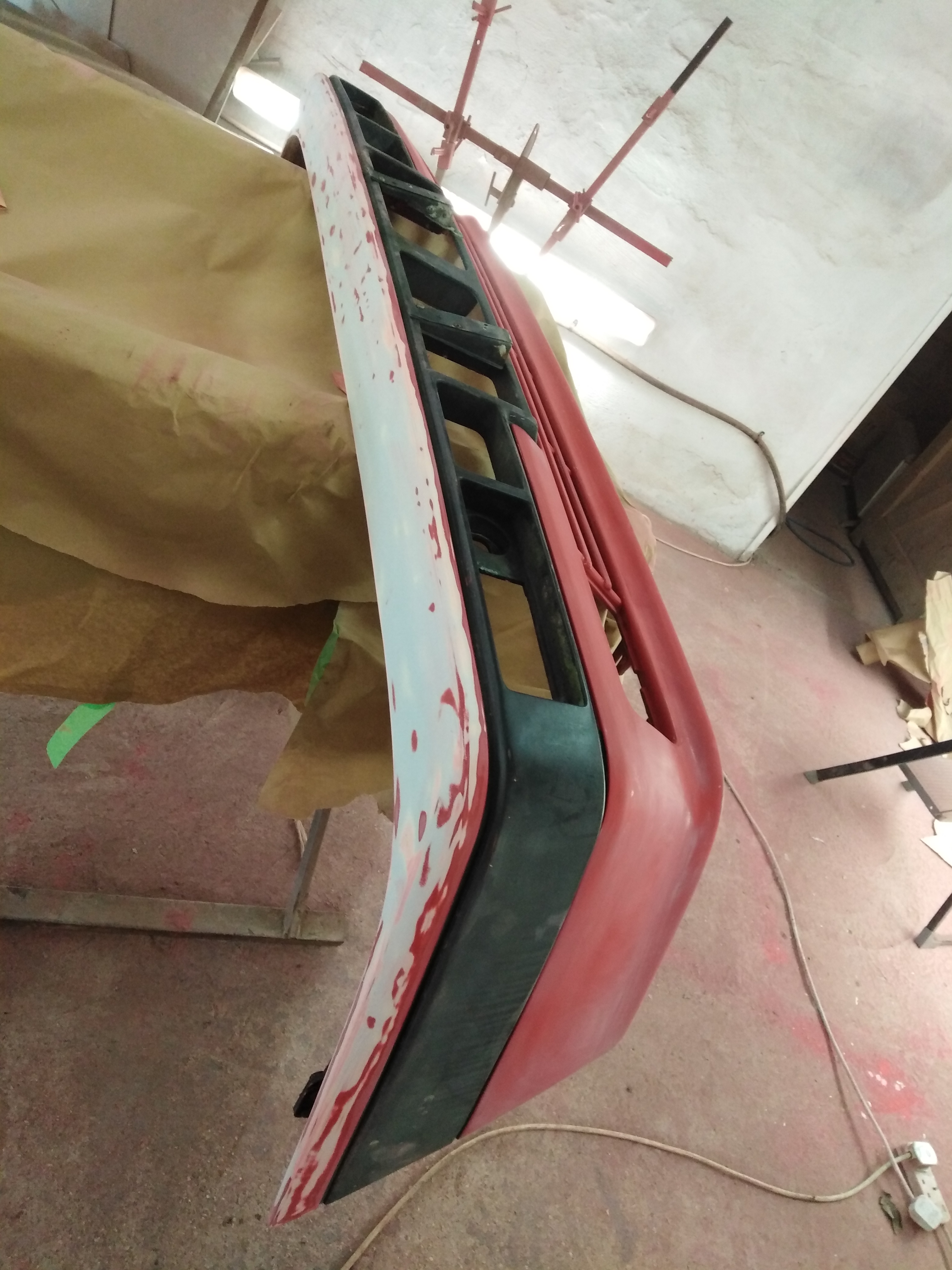

with everything stored out of the way the last remaining jobs are the plastics, the front bumper had been lacquered at some point on the top section which was peeling badly.
Being plastic I was a bit worried about damaging it so tried to rub it down by hand, boredom soon set in so the DA sander with a 320 pad speeded things up a bit. Bottom half was just straight colour so just needed a light sand down.

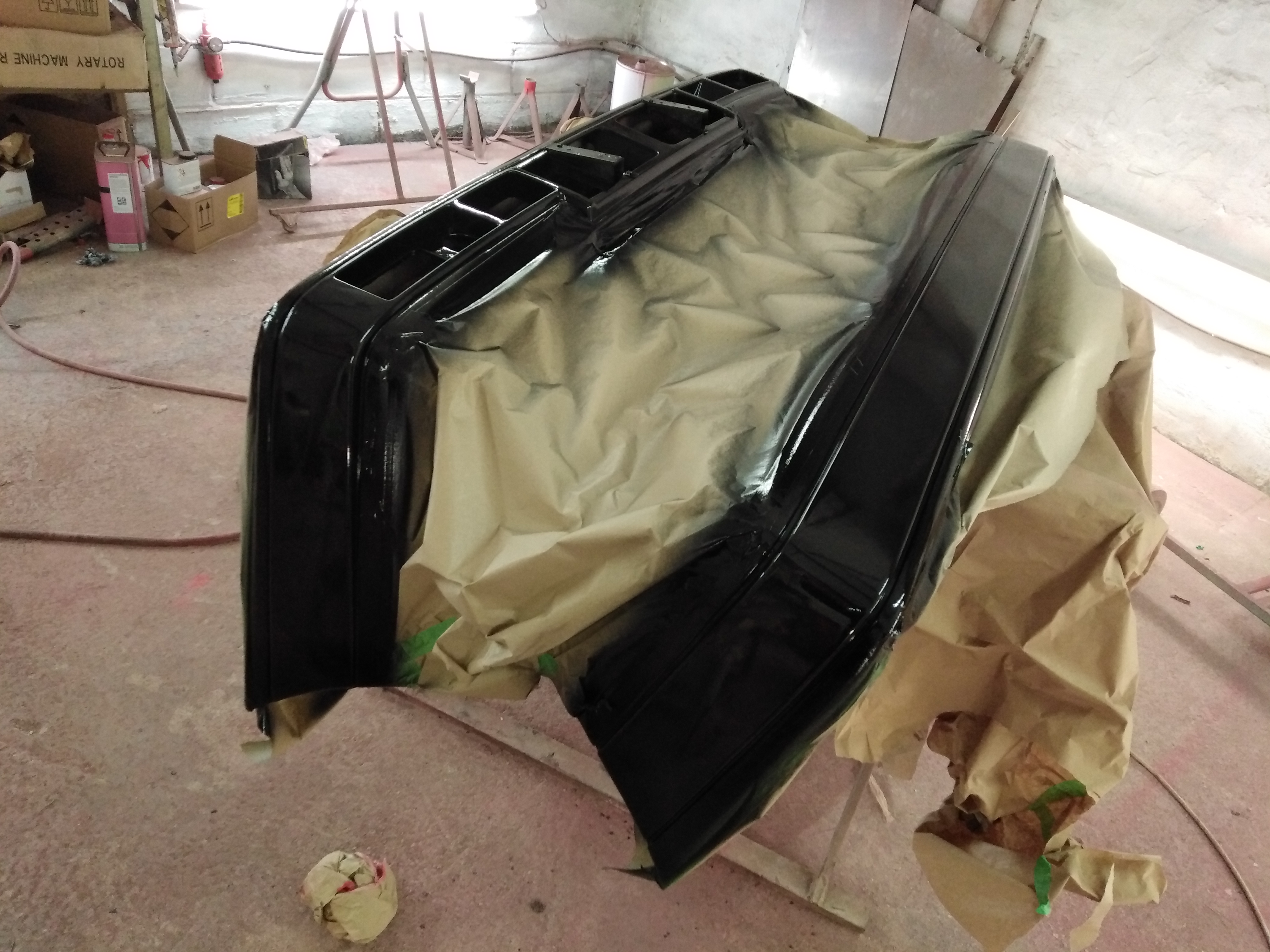

The rear bumper was pretty good so sanded down fairly easily although it did reveal that the black section had worn through in places...
Yes, I know the bumpers look pink, they have indeed faded!!

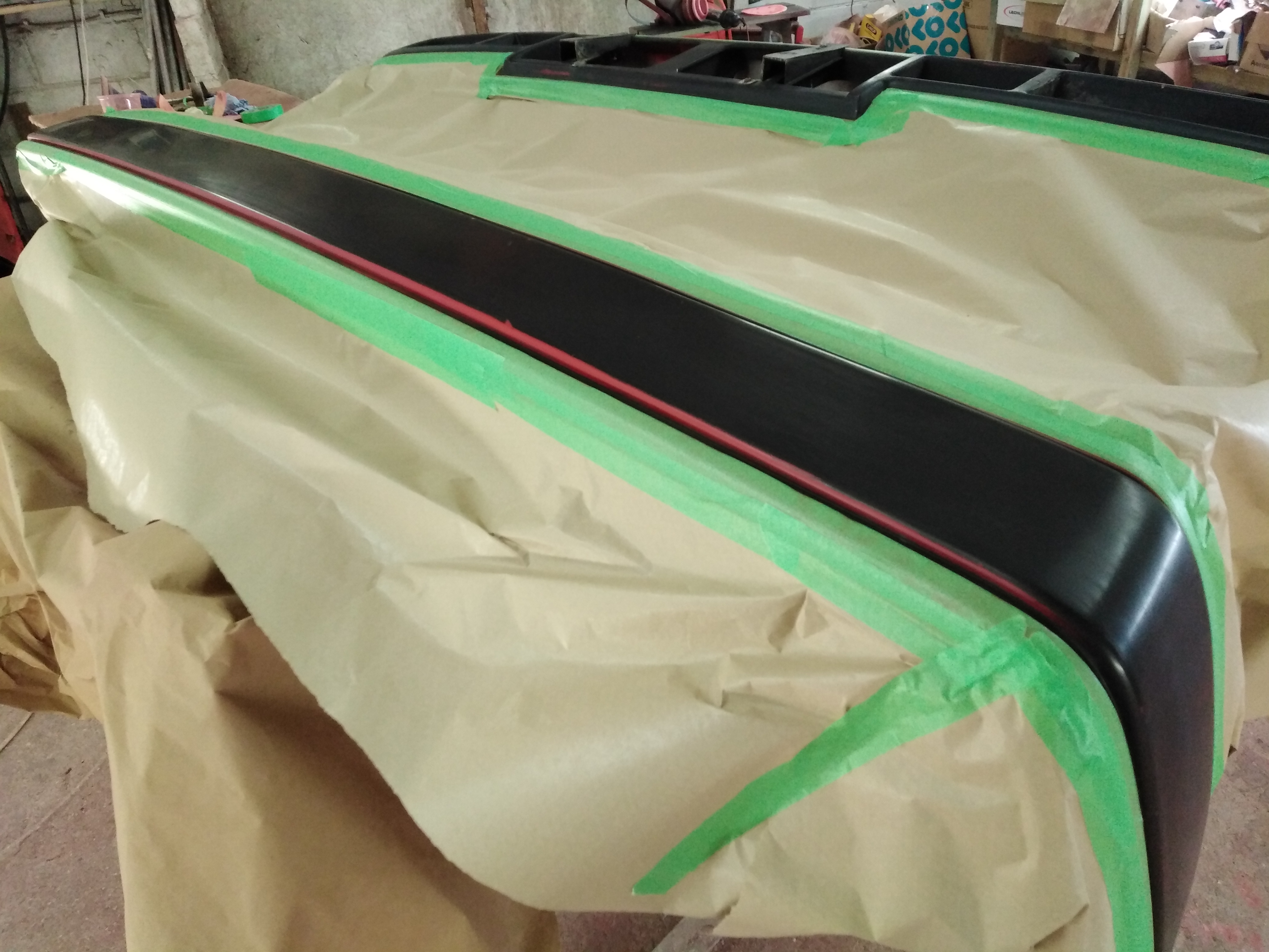

As the black section was in poor shape I thought I may as well do them in satin black like the other bits, at least it'll kind of match!
I'll give the black a few days to harden off then do the red sections along with the rear quarter vents....hopefully the last bits to paint besides a few bits on the engine.

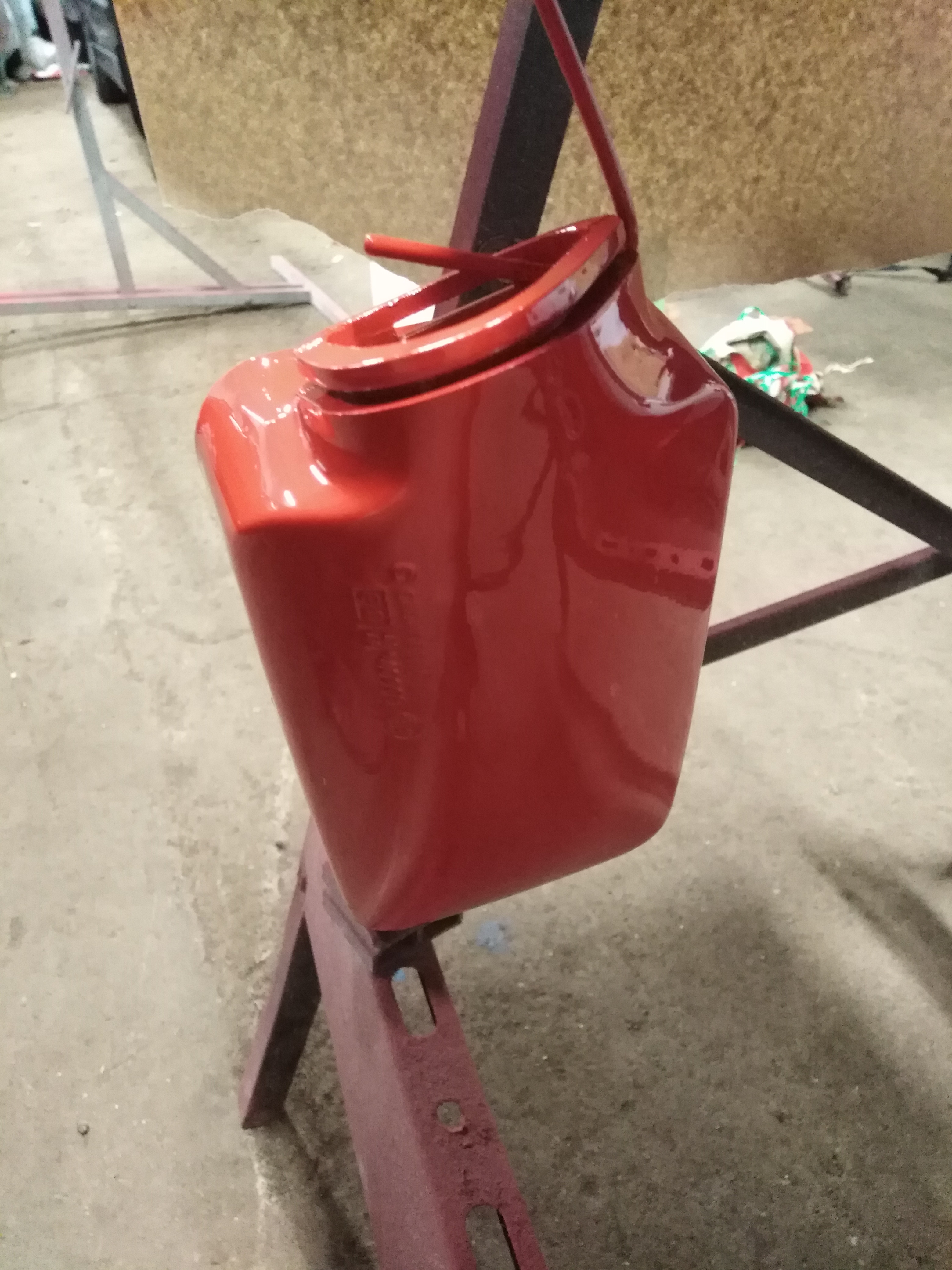

Then another box revealed another task, door mirrors!
The plastic outer covers are in a right state, faded and paint chipped off.
Had to have an hour down the shed to strip them all down :(

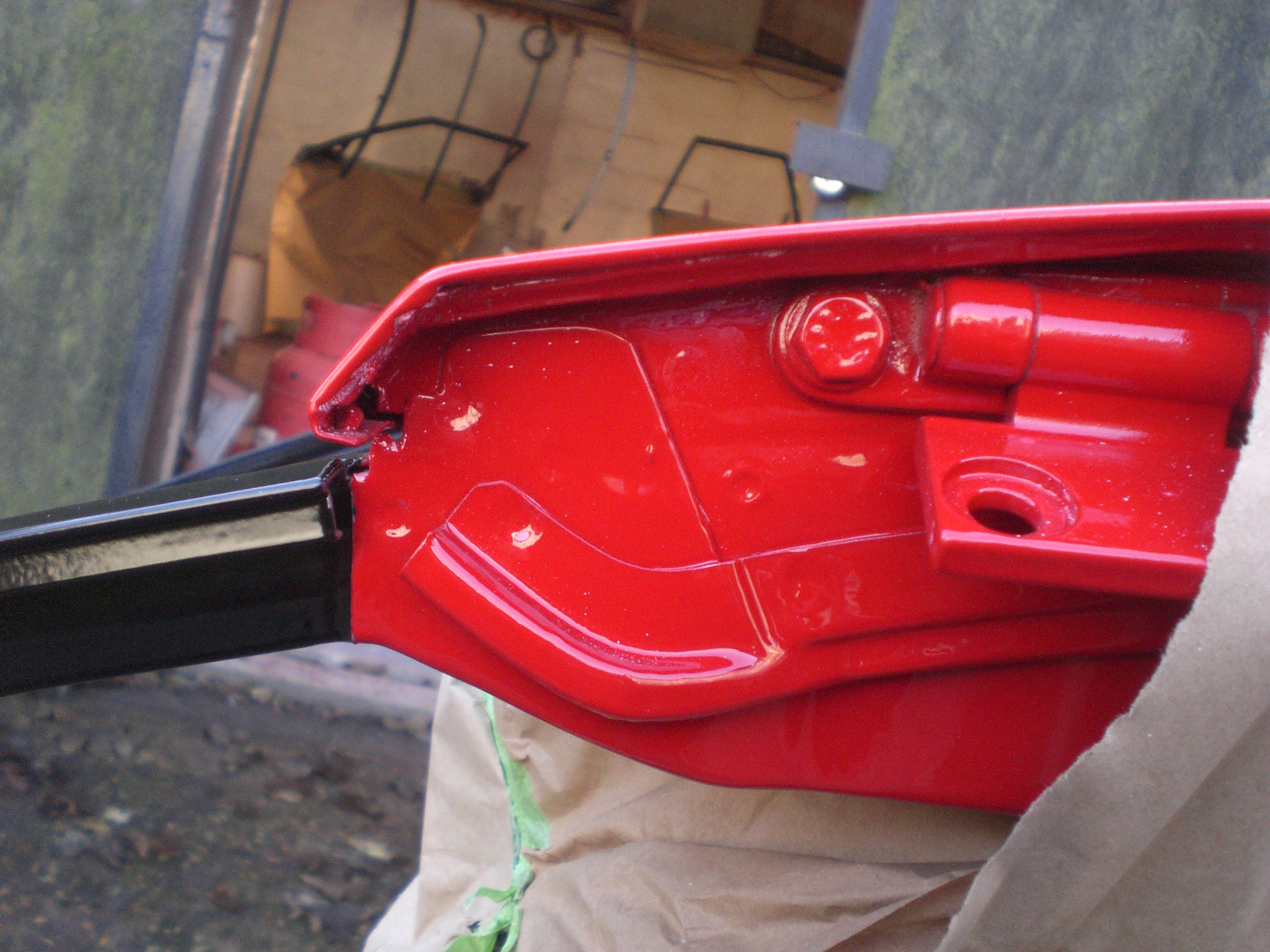

So that's more plastic stuff needing red paint!

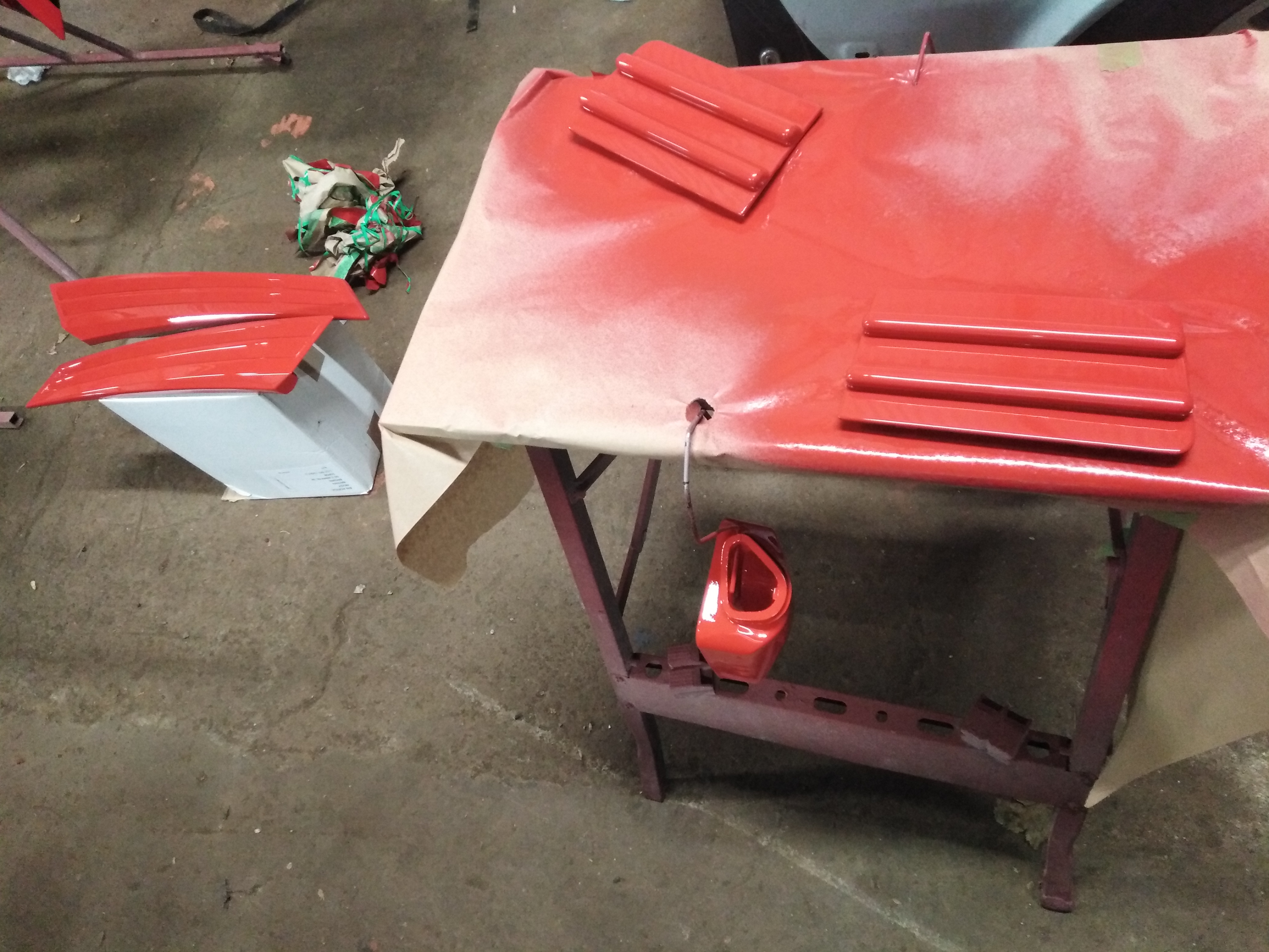

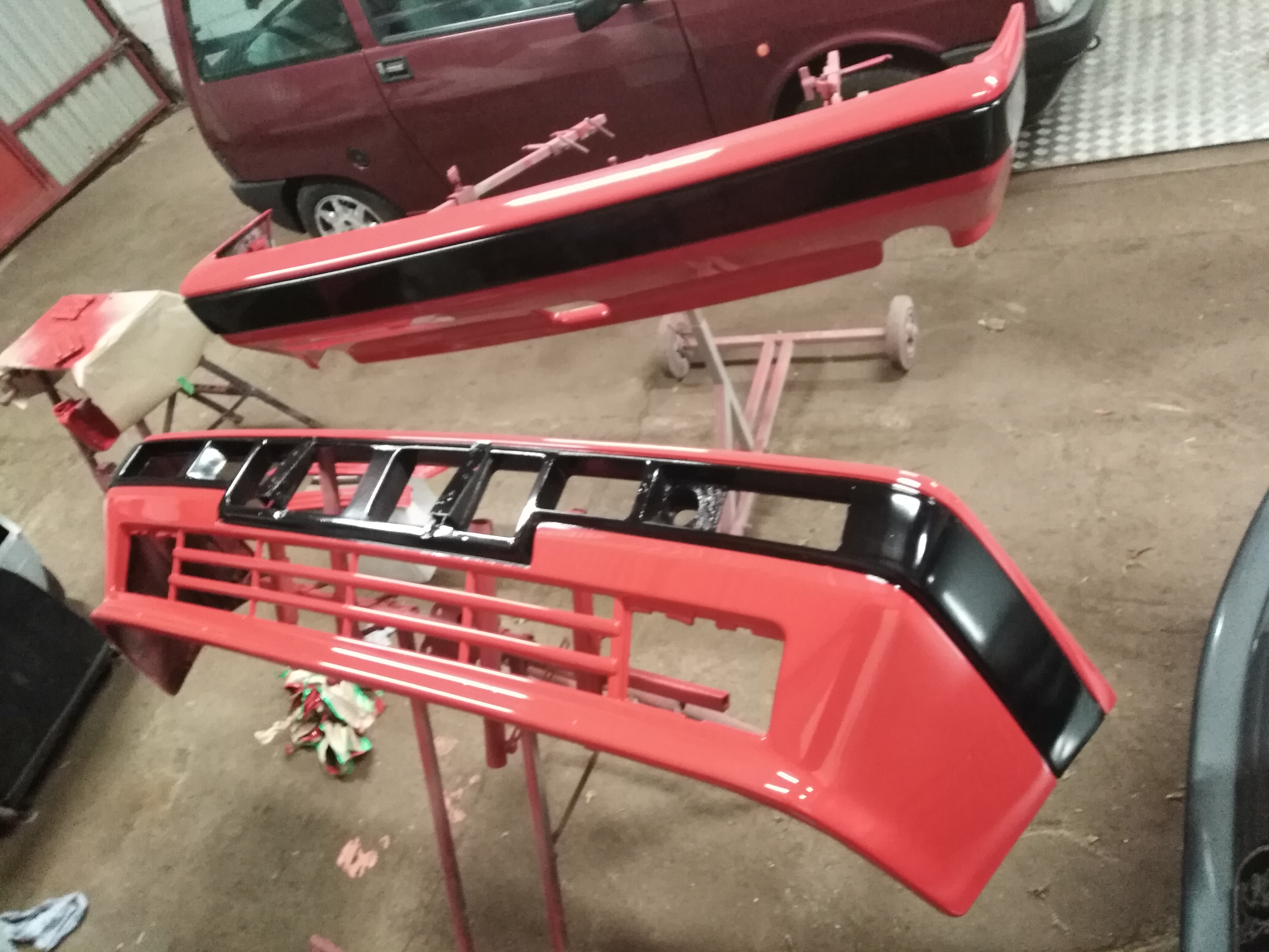

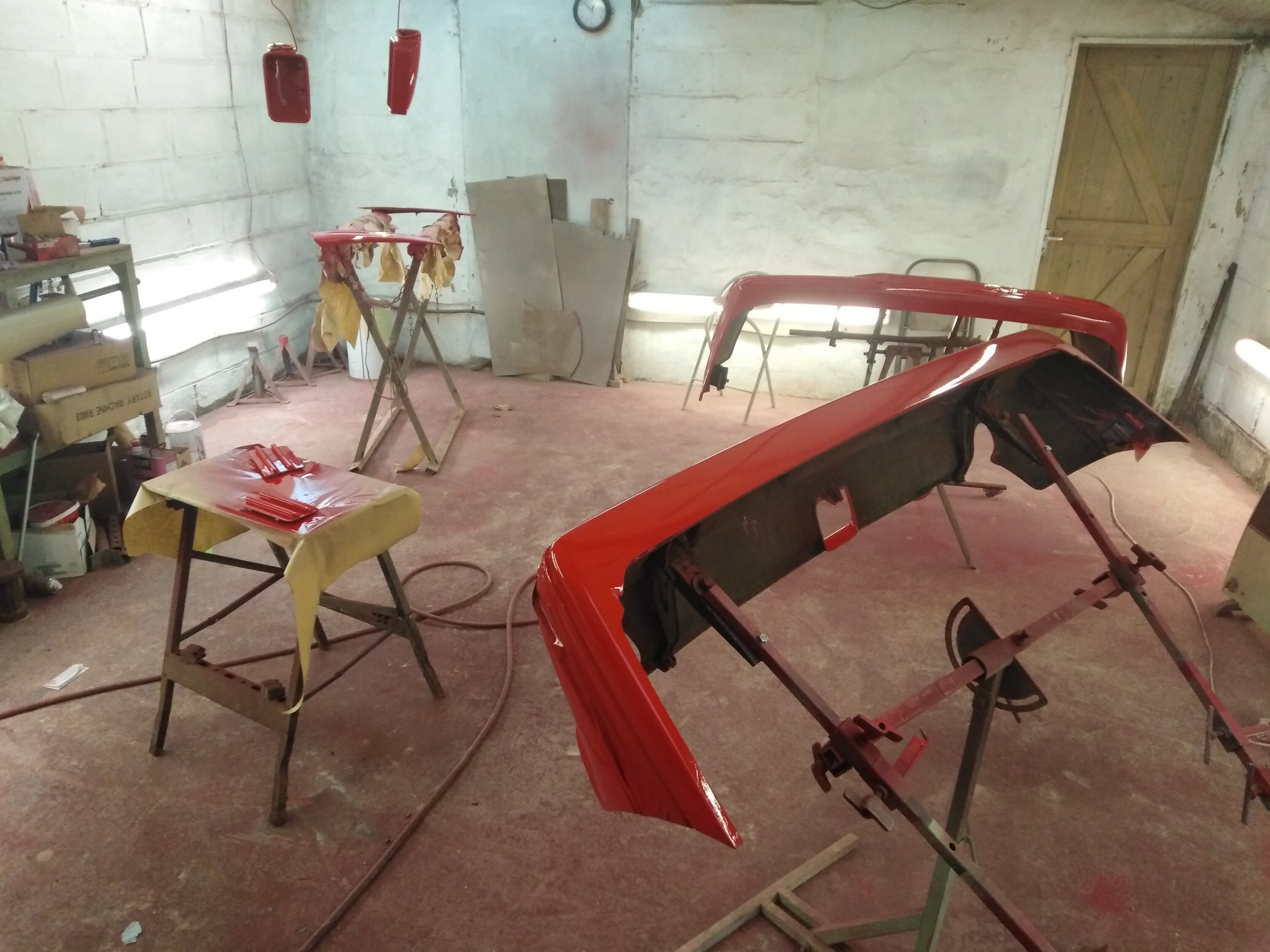

As timings went well with Terrys' Moggy then a space to paint the bumpers this morning fell into place just right.
Of course the fact I'd also found the door mirror covers plus the front fog light covers to do added to the workload.
All went well though.
Got carried away with the rear 1/4 air vents though, at least they won't need flatting much!
All masking off, looking good if I say so myself, pleased I painted the black now.

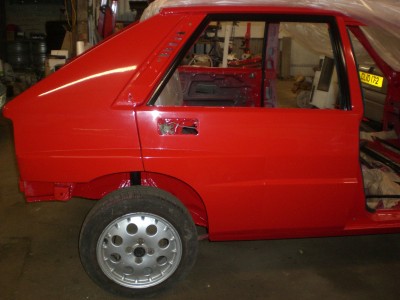

With a bit of space now in the big unit (Robs' Imp is up there now too...) it was at last time to start putting stuff back on.

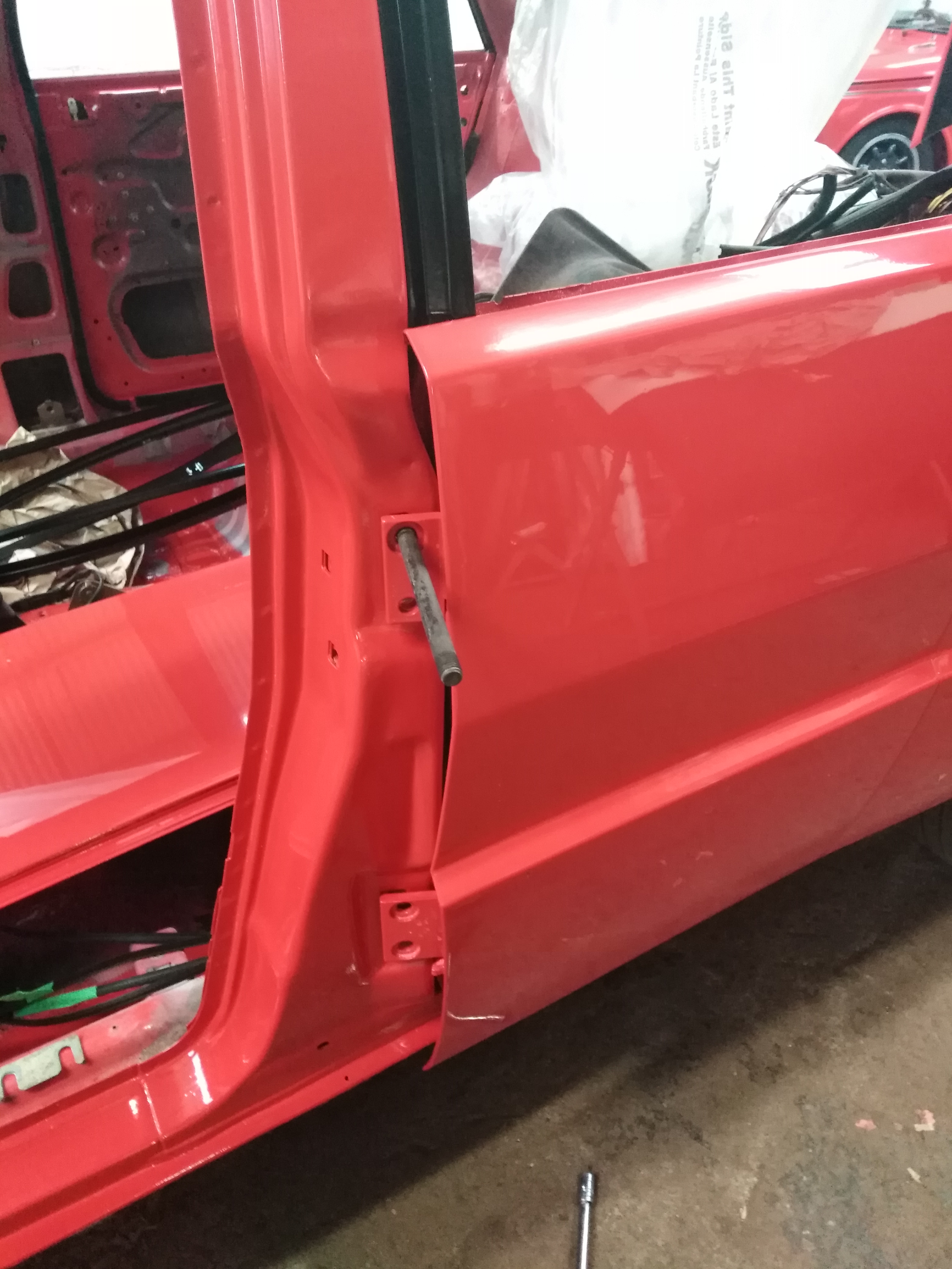

The rear doors were a good place to start, less likely to get damaged if they're bolted to the car than laid on trestles.
There is a seal that fits all around the doors rather than to the car itself, glad I fitted them before putting the door on as very fiddly to get back in the groove.
Locks etc then were found so the doors were ready to go on.
As I'm up there on my own a method needed to be thought up to try and fit them without damage.
Solution was to use a long stud in the top mounting point hole, feed the door hinge down the stud then latch the door on the first saftey catch. This held the door in place so the correct bolts could be fiited then remove the stud.
Happy to say the doors went on without drama.

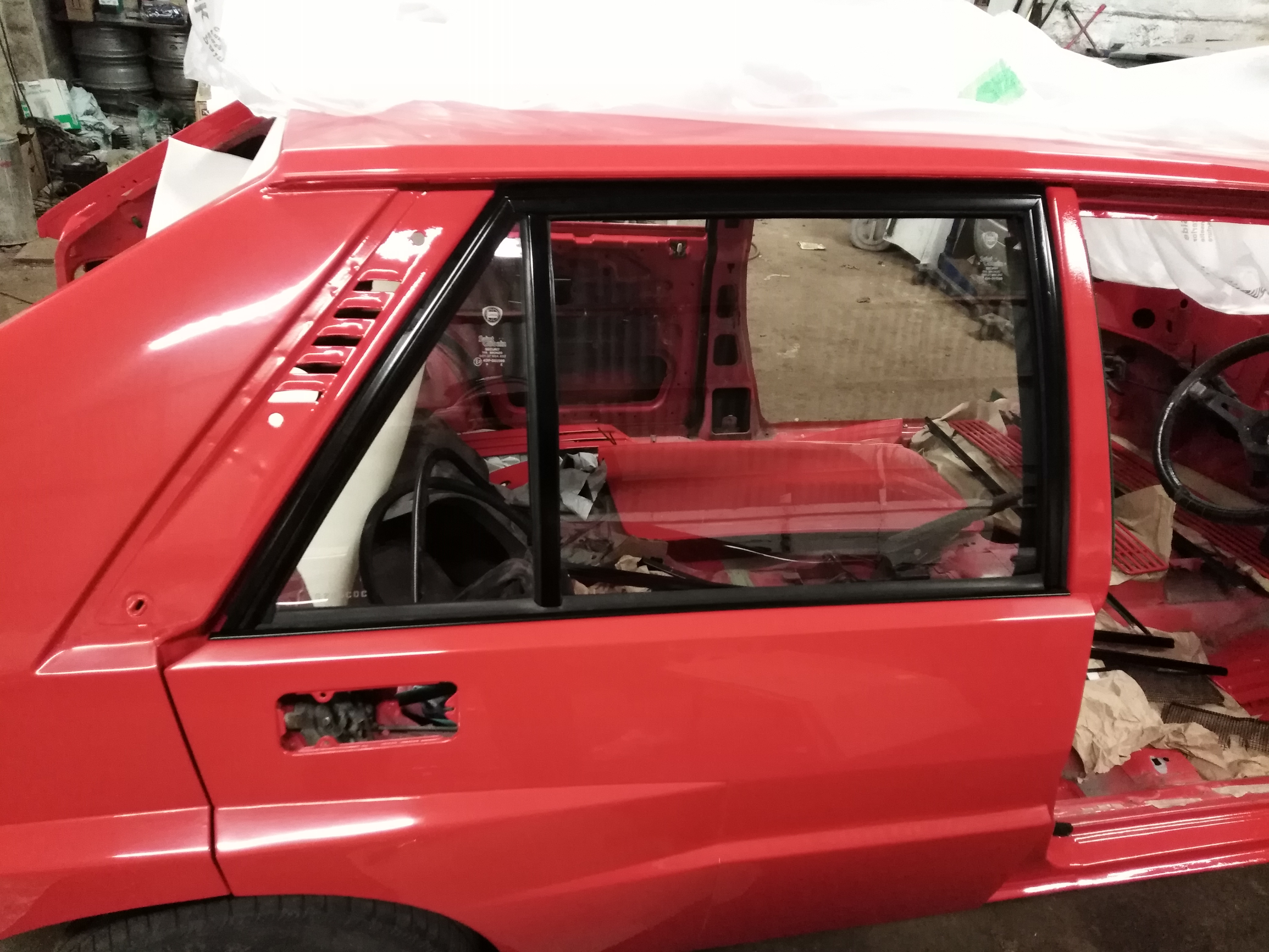

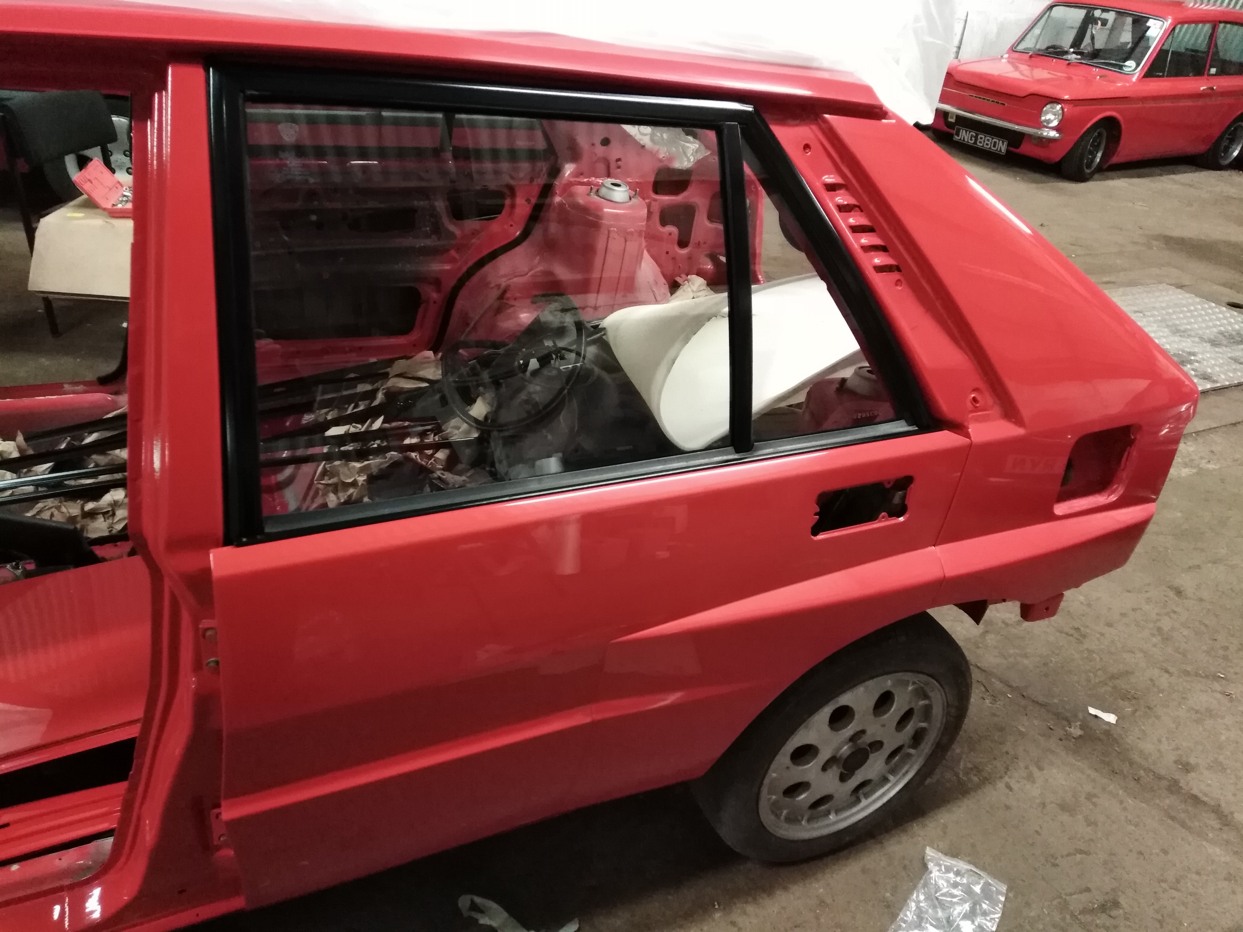

Had a couple of hours fitting the rear door windows with the freshly painted guides etc, glad I decided to paint all the parts now rather than have odd coloured parts. Love red against black. 8-)

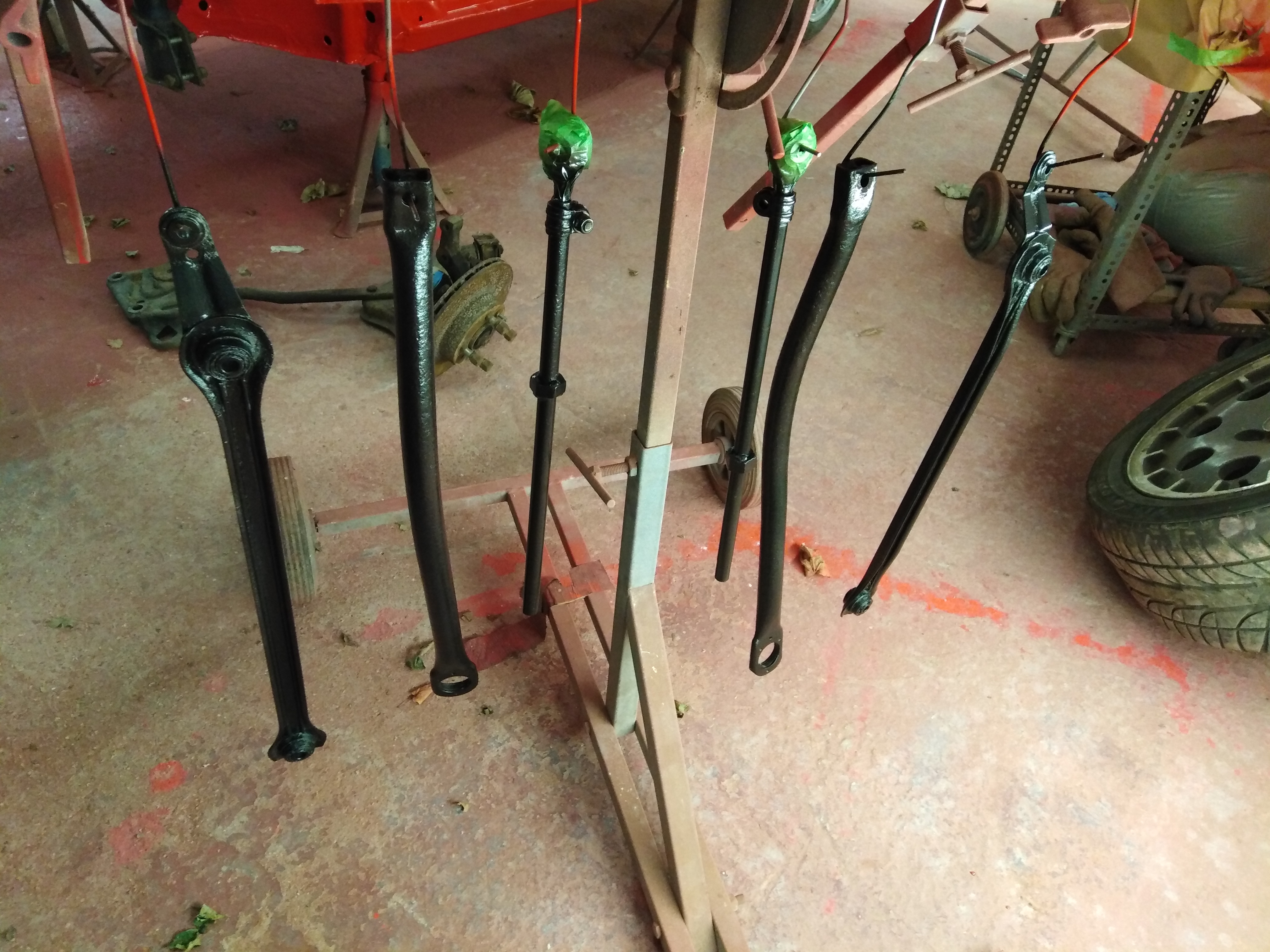

Busy now sorting parts in the shed ready to fit the rear suspension.
Driveshafts are getting new boots and packed with fresh grease.
Hubs are ready painted with new bearings, arms all cleaned and painted.
I welded a large nut to the rear tracking adjuster arms before painting, the usual method of mole grips or stillsons to rotate the bar makes a mess, the nut will allow a 24mm spanner to do the job simpler. I did actually get very lucky on these adjuster arms picking them up off ebay for about £20, they were already cleaned and greased with new bushes pressed in each end. Each new bush would have cost me that and there are 4!
