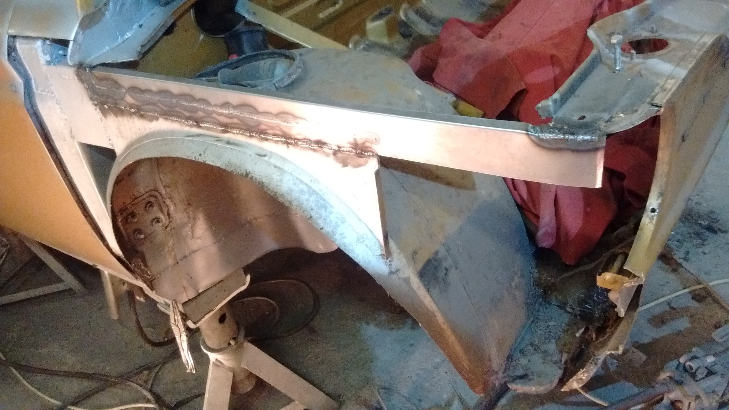

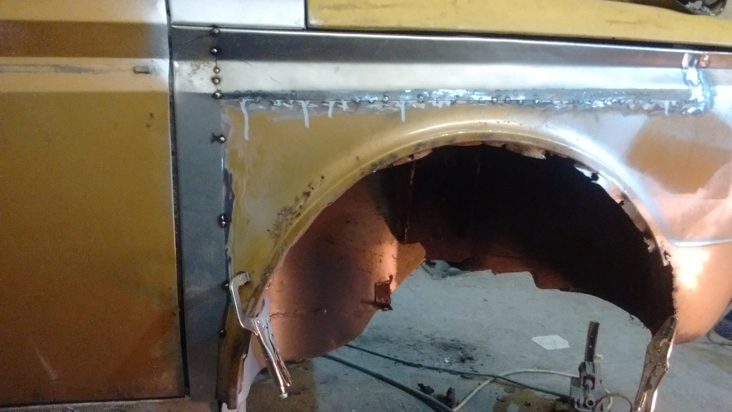

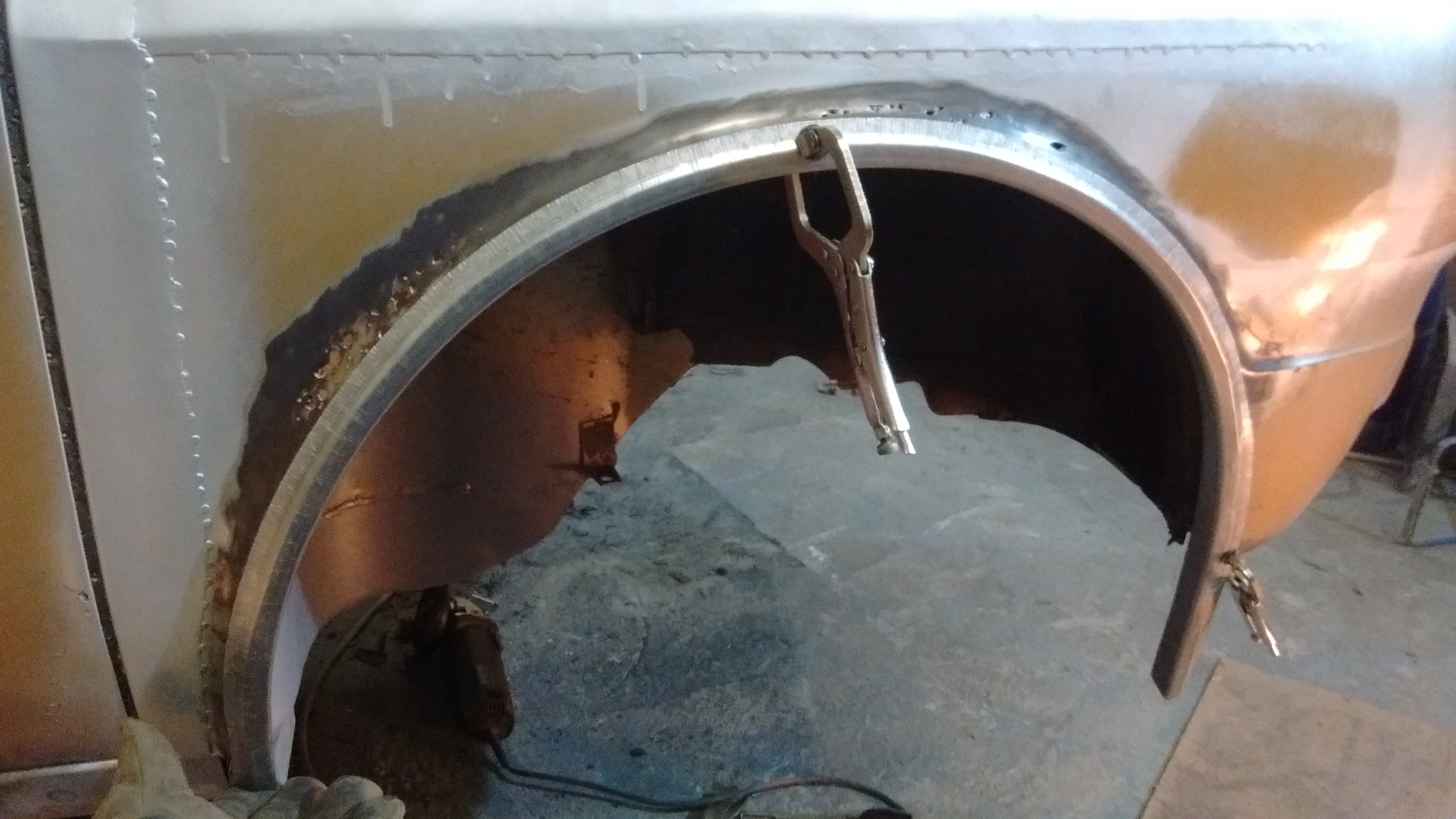

bit more done to the little imp, repaired the inner arch on the drivers side
fitted the outer arch, well mostly. welder broken half way through :twisted:
Re: Kev's workshop projects

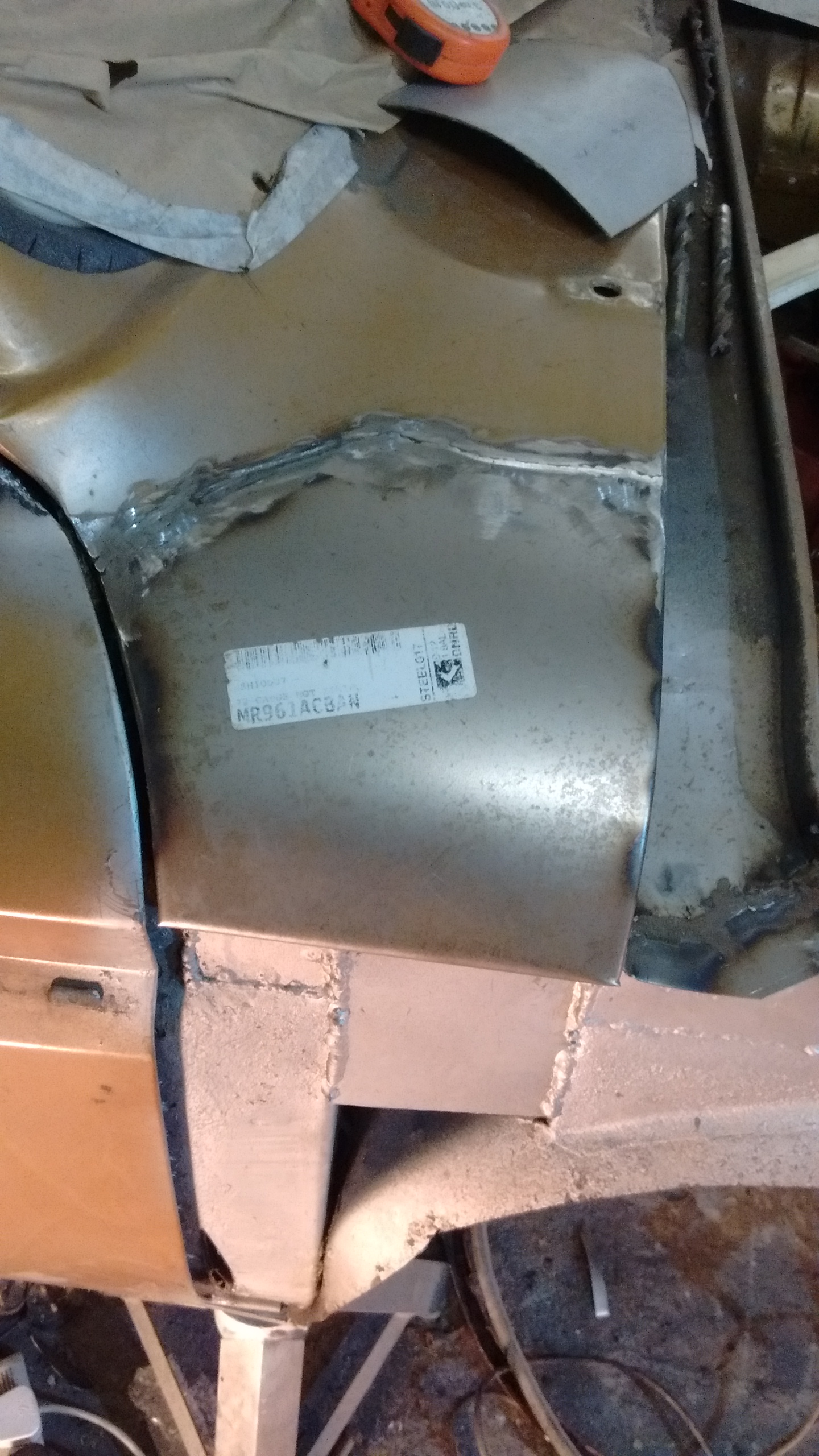

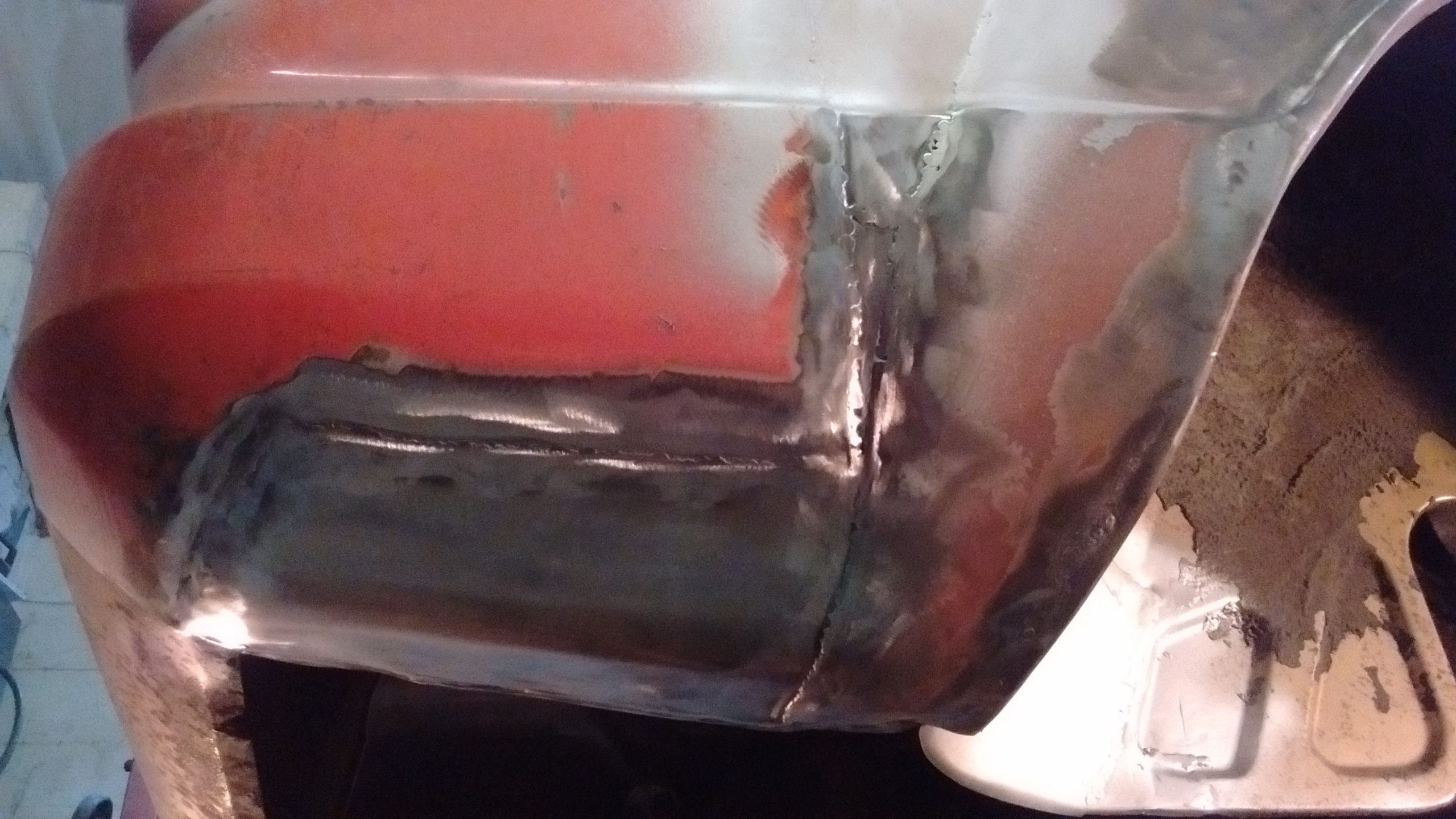

arch got lined up as best as I could, swage line at the rear end isn't in the best position but these are hand made arches so can forgive a little discrepancies
rear bottom section needed a big gap filling up so a patch was made up to fit along with filling the gap between the replacement quarter panel and arch panel
inner arch repaired at bottom end too
front section now boxed in
whole section now fully repaired, needs a bit of tidying but all solid metal now instead of fresh air and rust!
off to collect a pair of fibreglass front wings tomorrow, not sure how good they'll be...
if not i'll have to repair the rotten metal ones :(

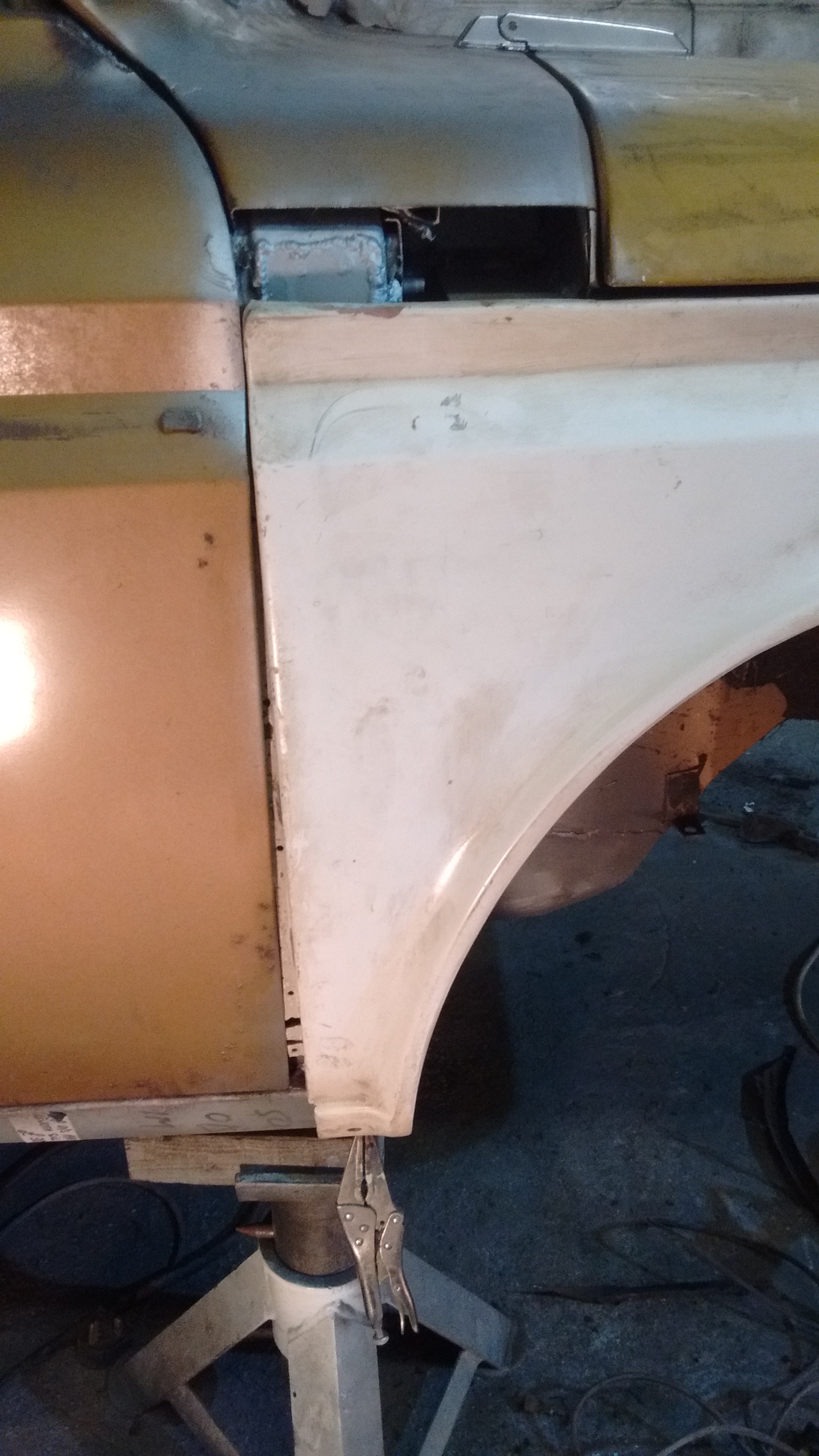

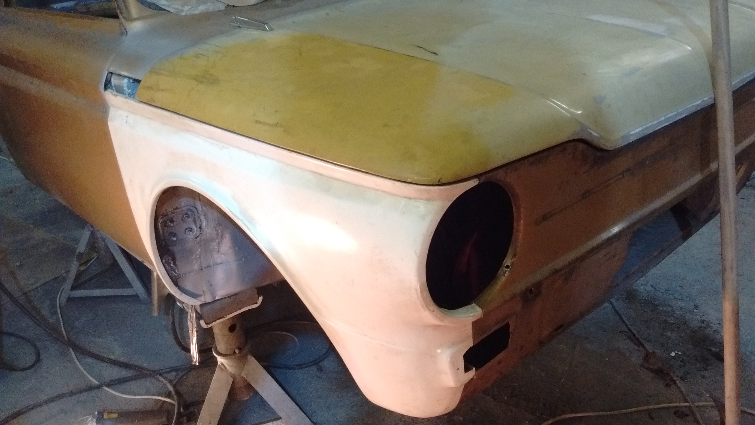

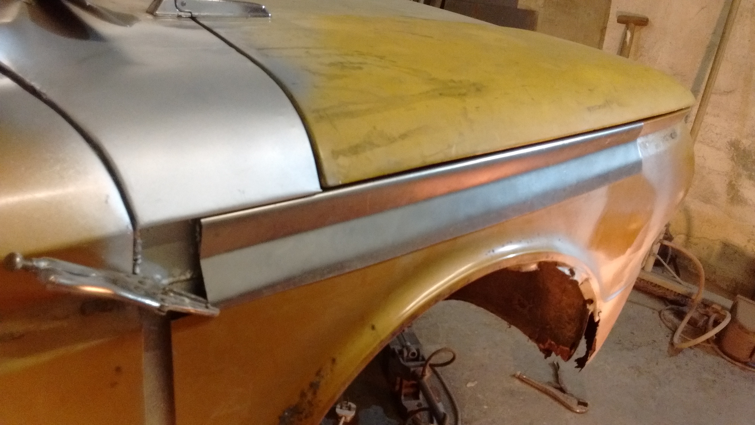

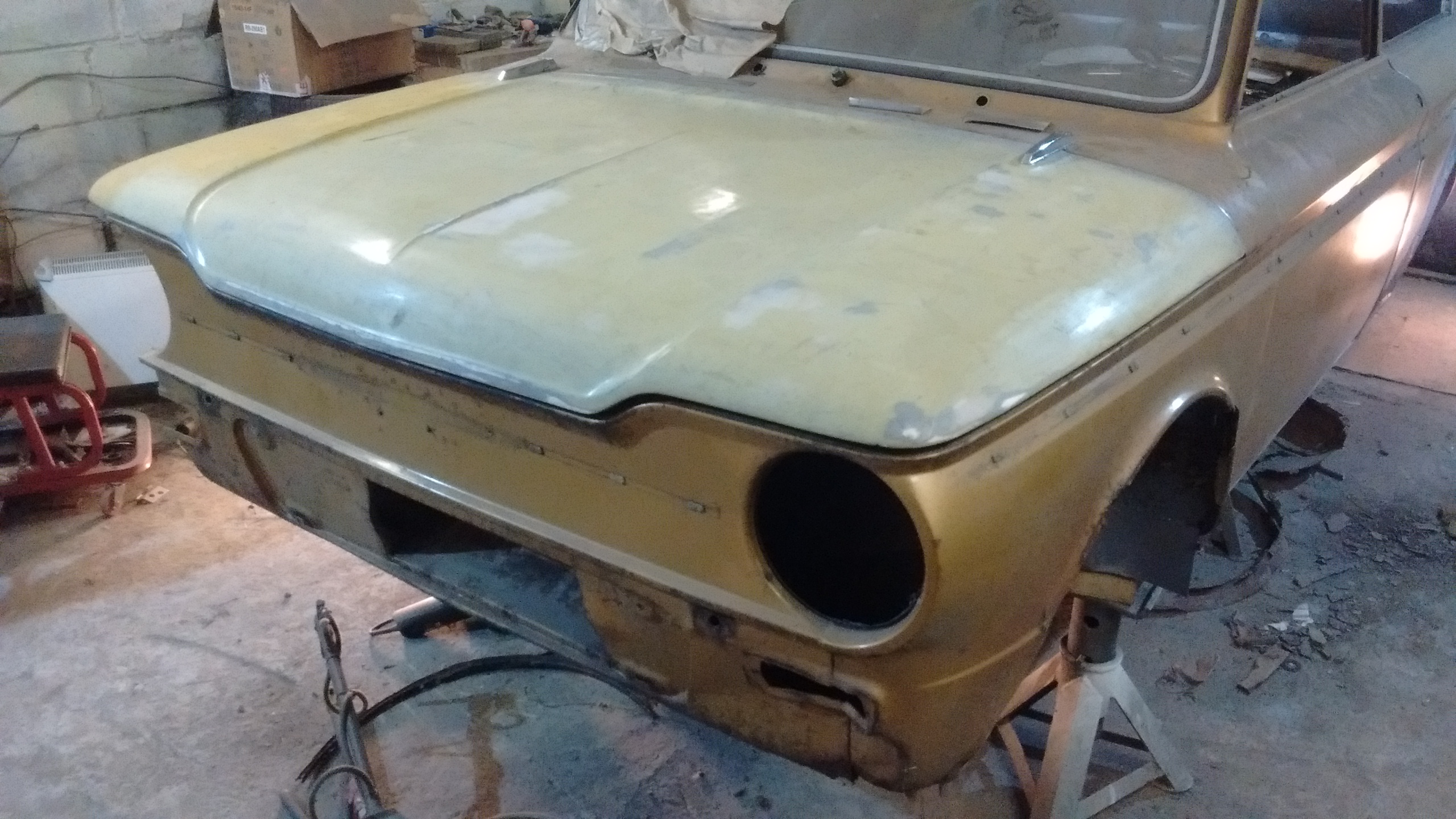

the imps' front wings were pretty shot, drivers side one especially so
picked up a pair of fibreglass replacement ones, only new metal ones we could find were £500 each!!!
the bonnet also needs major repairs, not only the front lip which has heavy corrosion but the underside bracing etc is as crumbly as dust.
handily enough a fibreglass one turned up last week on ebay at Lincoln, a bargain for £38. saves hours and hours of metal fab. 8-)
bonnet fits a treat, always a worry with FB items..
drivers side wing could then be arranged as I now have something (the bonnet) to line up against!
i'd already chopped off the top portion of wing rail, it was in the wrong place for the FB wing and pretty rotten anyway. an angled repair section with a slight curve to follow the wing shape and a notch or two to get it level was made up
then welded into position
this got me a decent line with the bonnet and a very stable edge to fasten the wing to the top rail

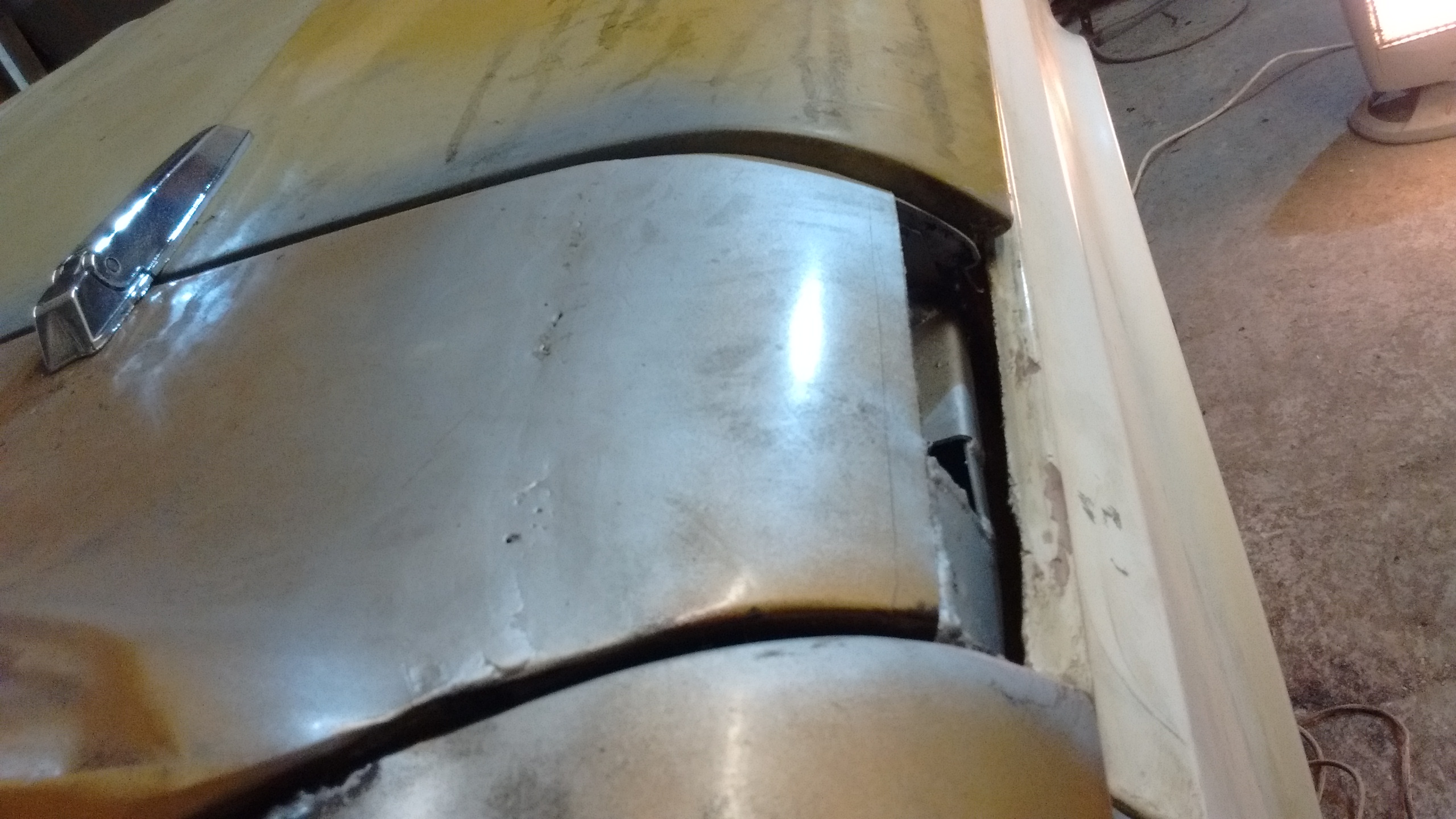

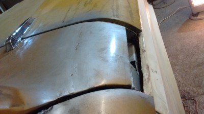

trouble is as i'd already discovered before I started, the shut line to the door is anything but good! i'll have to chop it off and either move it to the right position and fill in the gap or just make another wing edge to graft to the wing itself

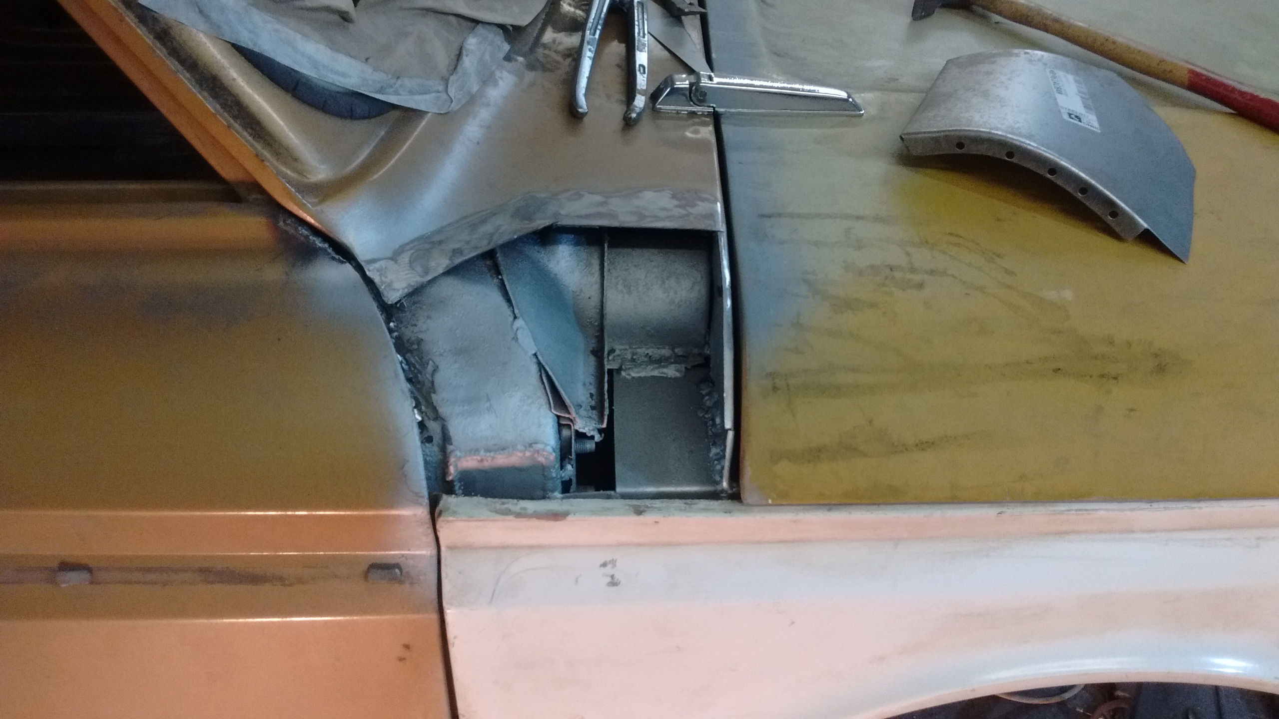

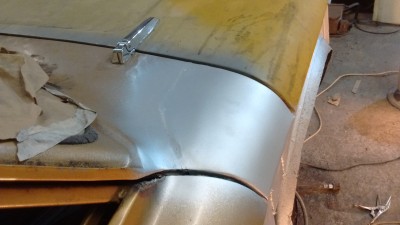

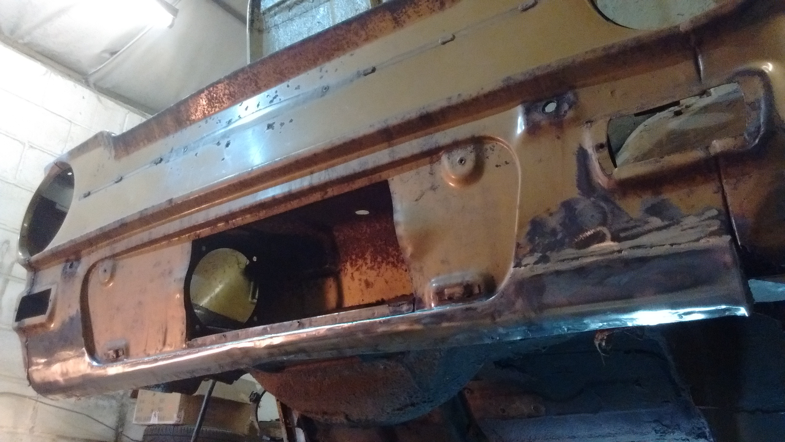

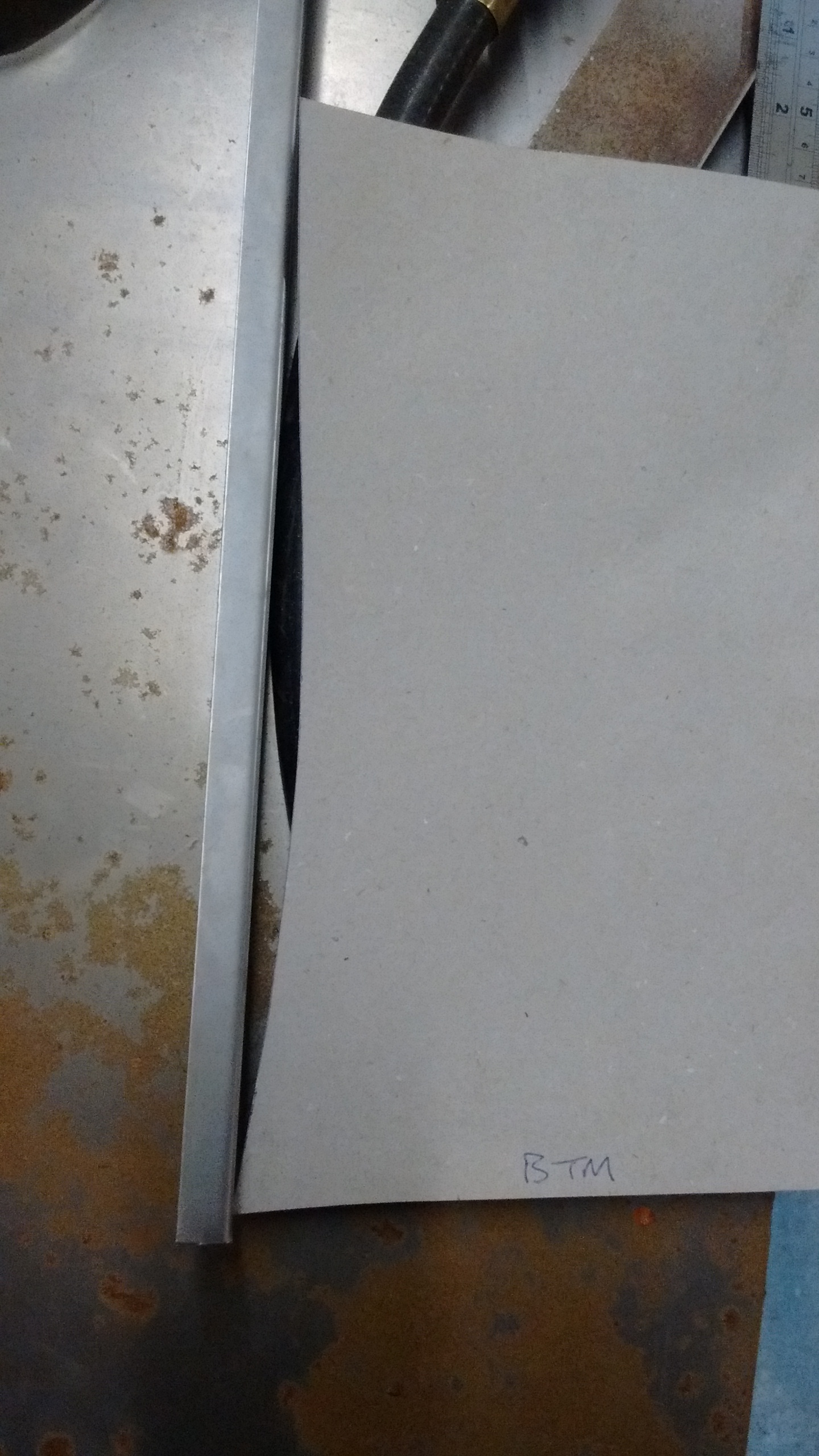

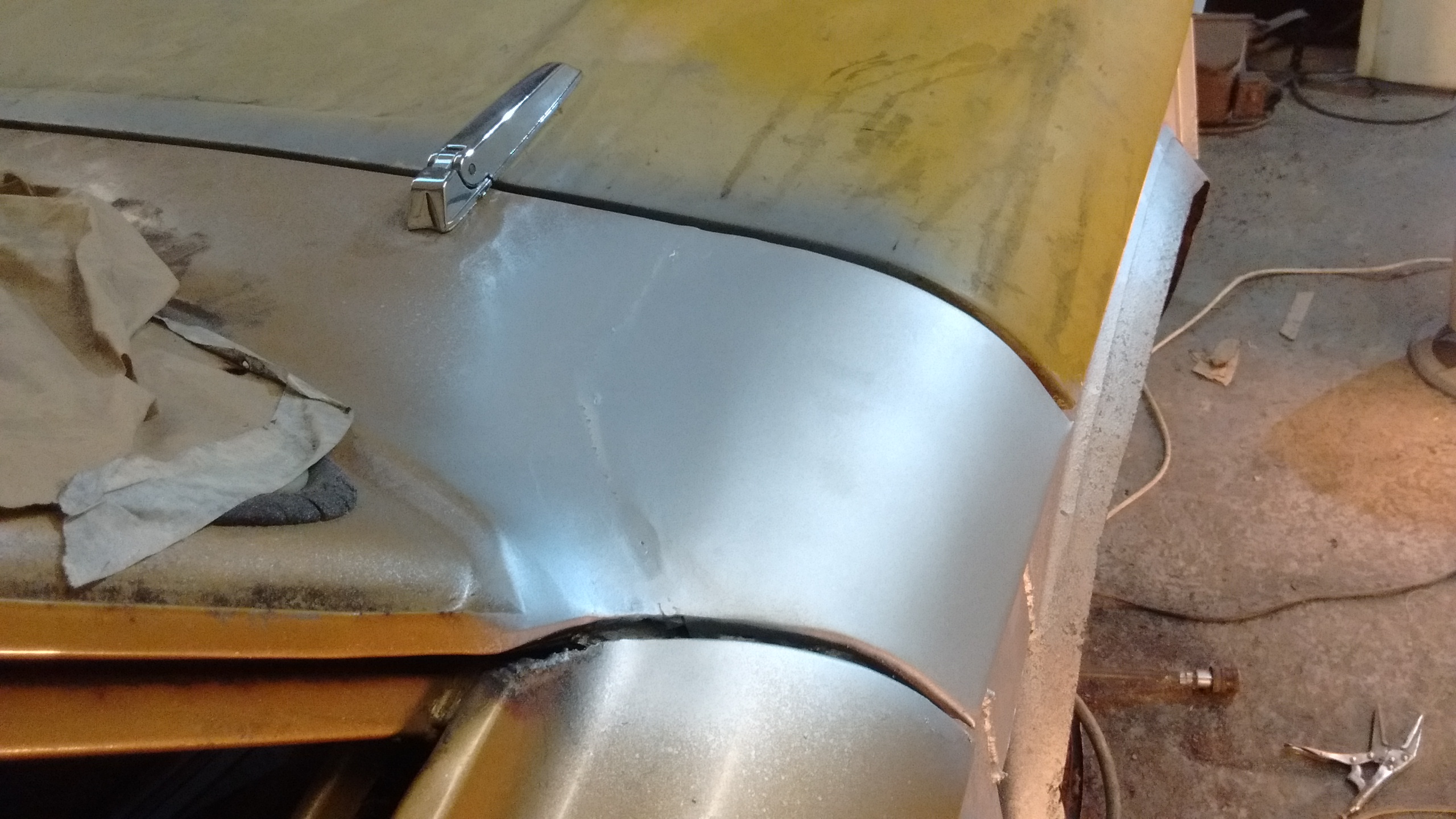

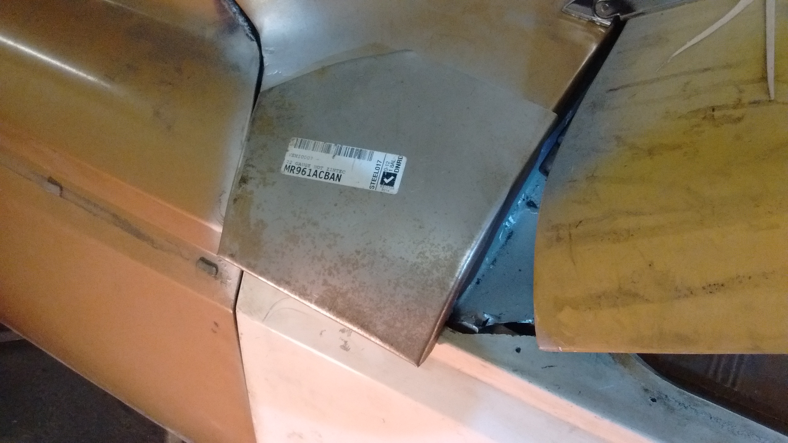

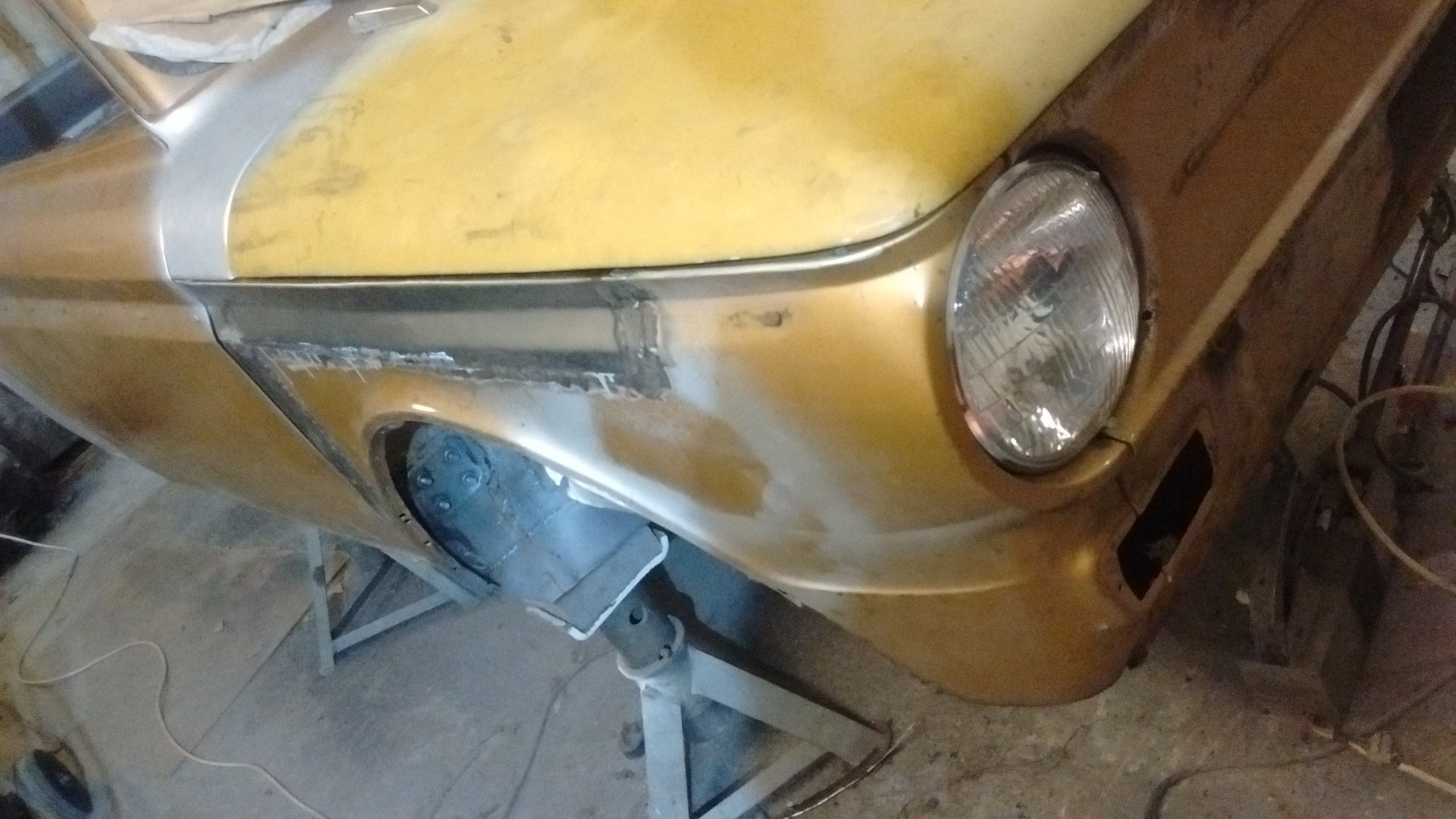

the area between the screen scuttle and the bonnet also has some alignment issues, not the bonnets fault I don't think but my own mistake at welding the panel back in the wrong position
I next made up a repair section that will follow the bonnet line much better
it'll go here next time i'm up at the unit, in a much neater position I might add!
most likely won't be there on Saturday, Christmas eve and all. couple days off next week though so may get a full day in...
enough of the xmas pud and mince pies....

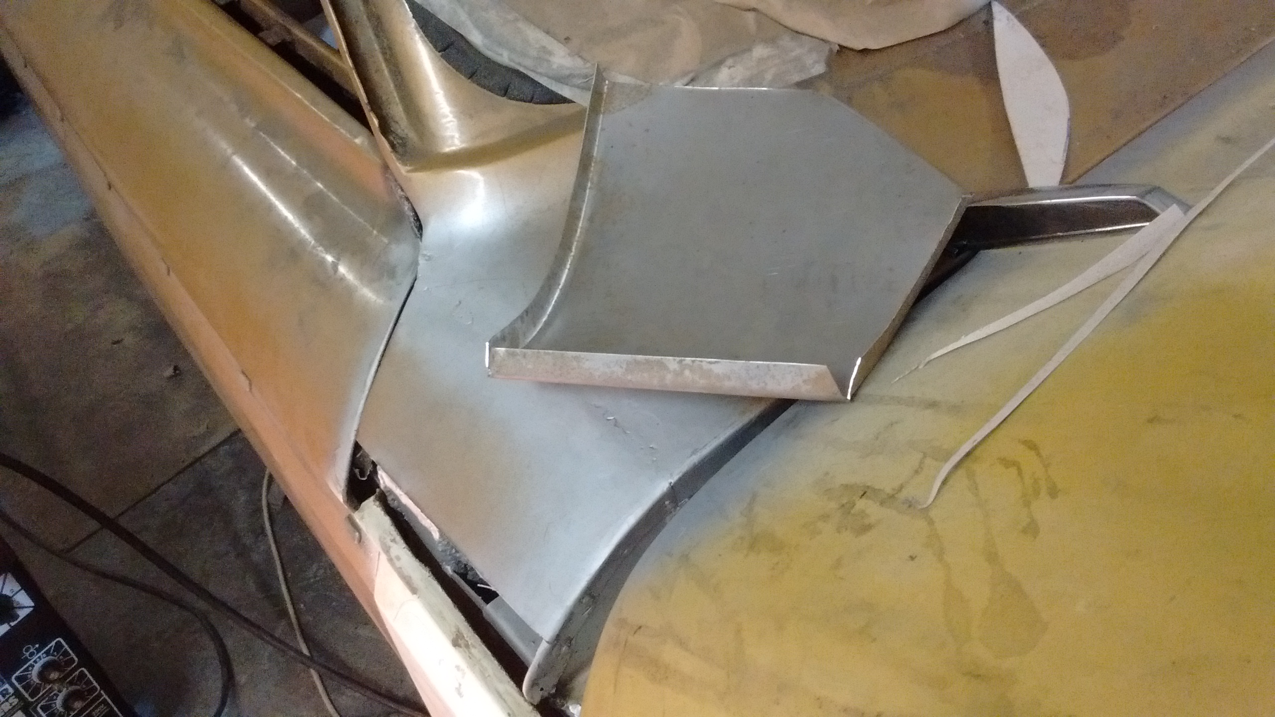

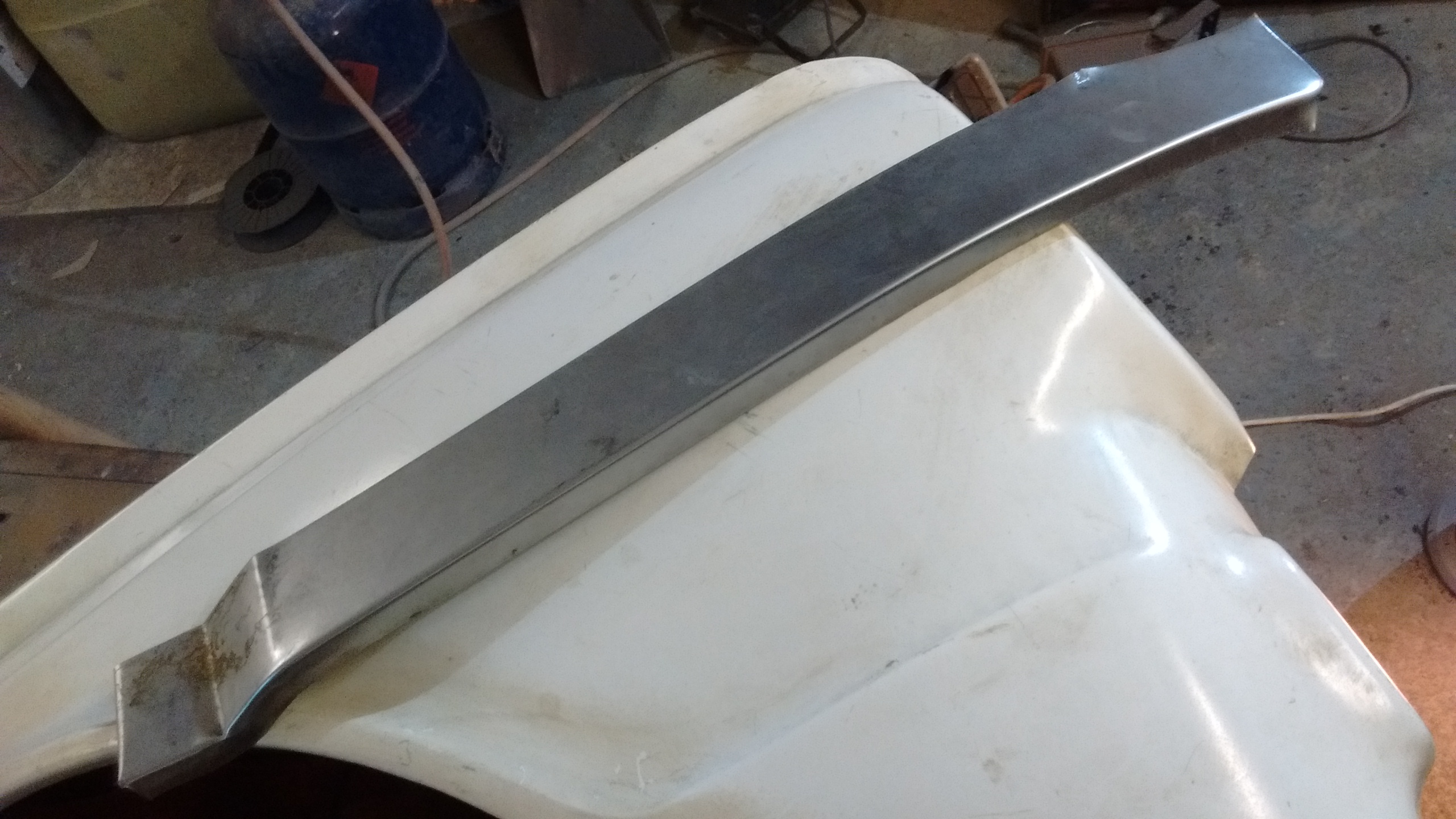

the patch I made up last time got trimmed to shape and manoeuvred into a position ready to fit after a bigger hole had been cut out
welded in
fit to bonnet now what I wanted

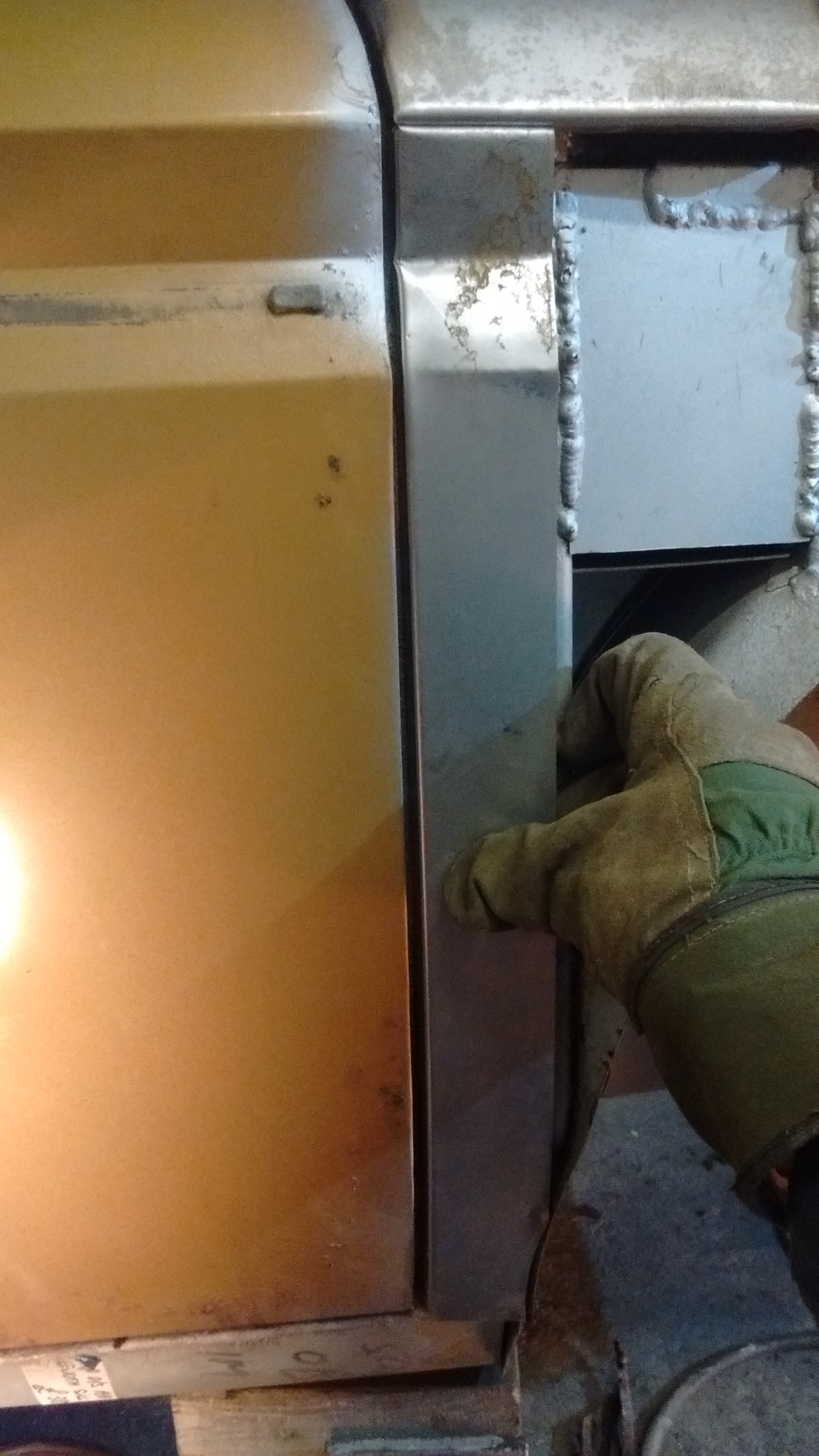

next job was the gap to the door front edge, the fibreglass wing was just terrible!
options were to chop the edge off the wing and move it or just make a new edge....

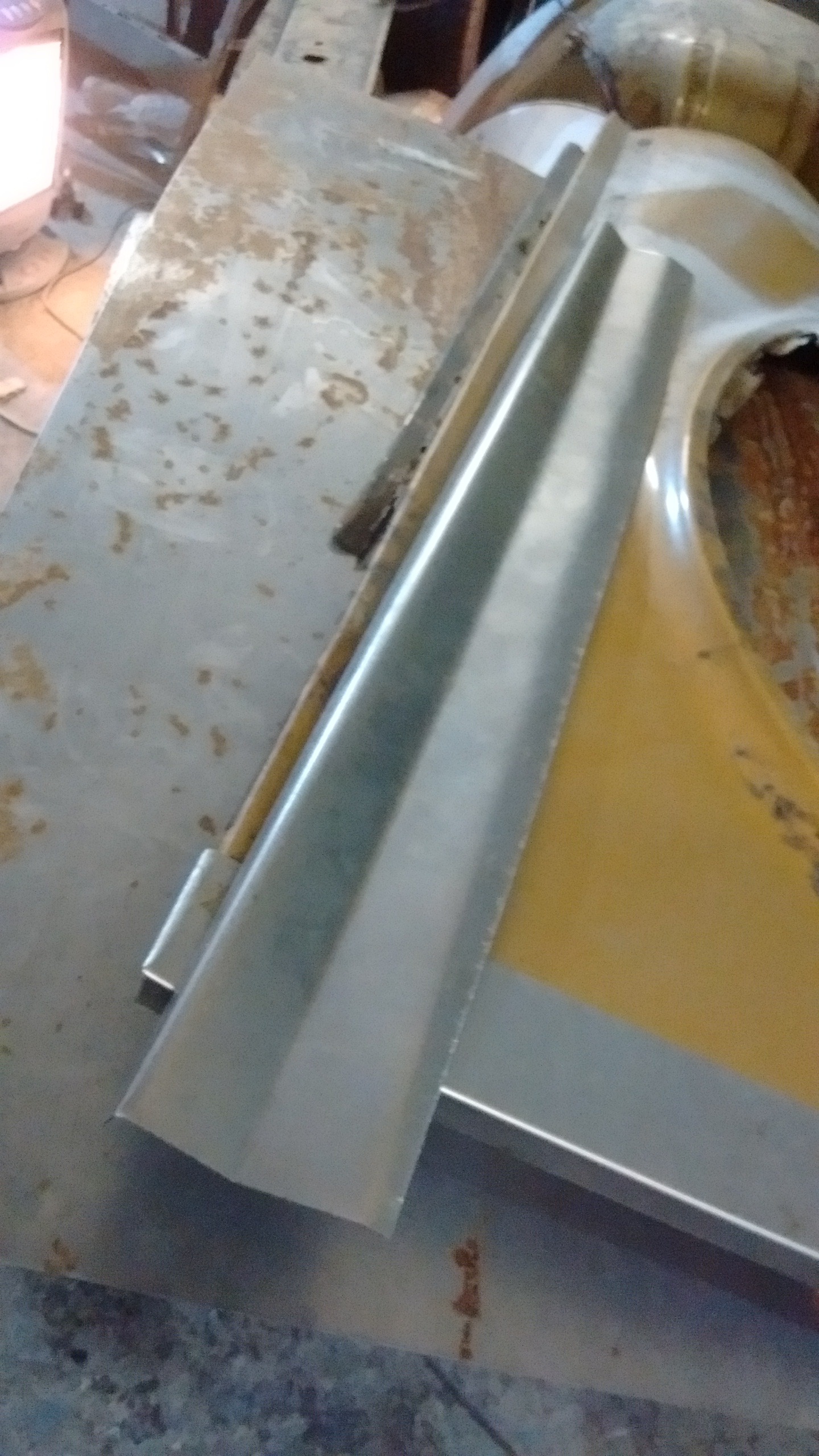

a folded section was readied, the short edge needed manipulating so the outer facing edge would follow the contours of the door. a piece of card cut to shape is used for a guide as to what shape you need to end up at
a bit of shrinking and we are there
the swage lines at the top were more tricky, much tighter turns but some patience at it's near enough
I can now set the gap exactly where I want it

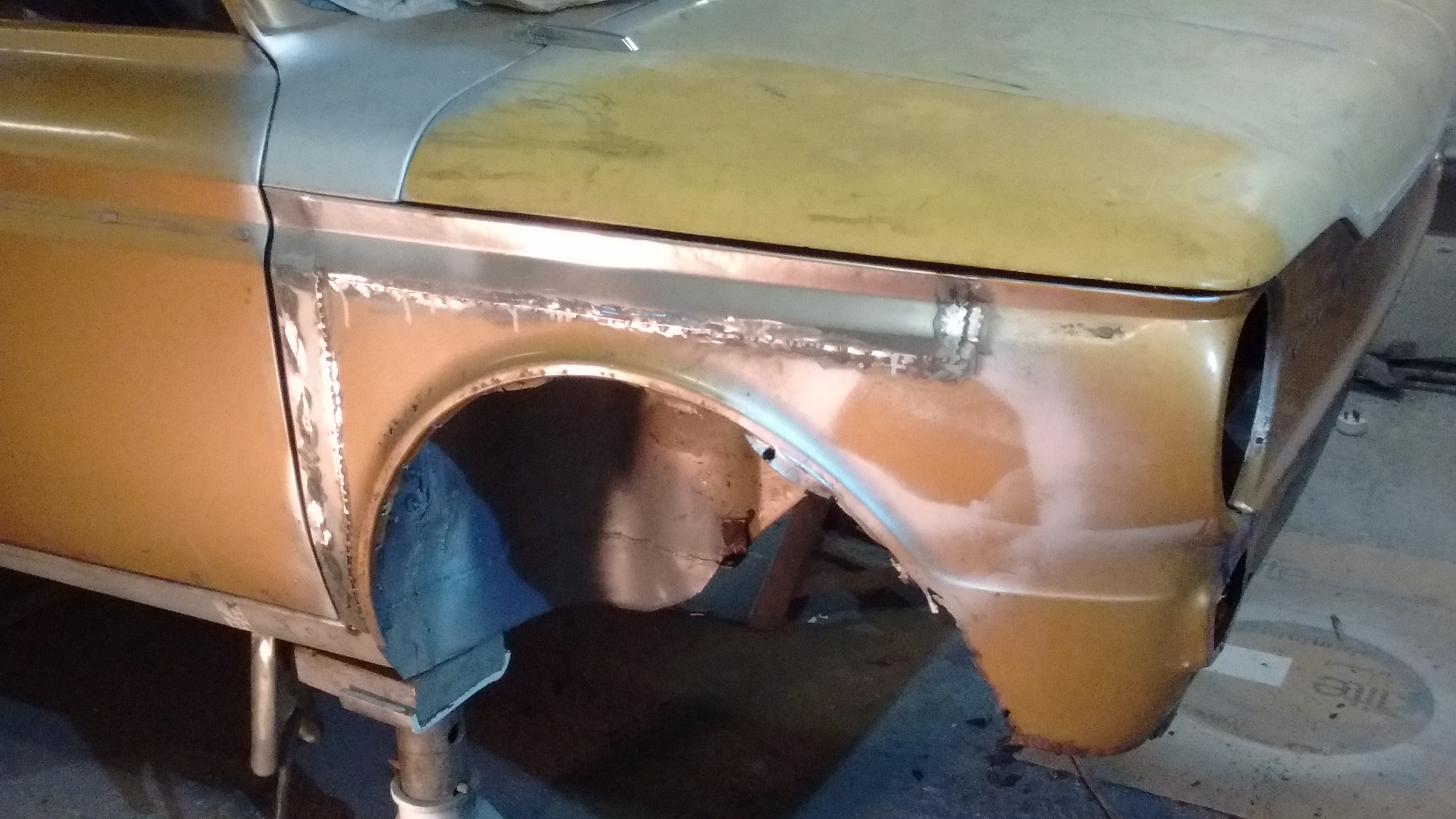

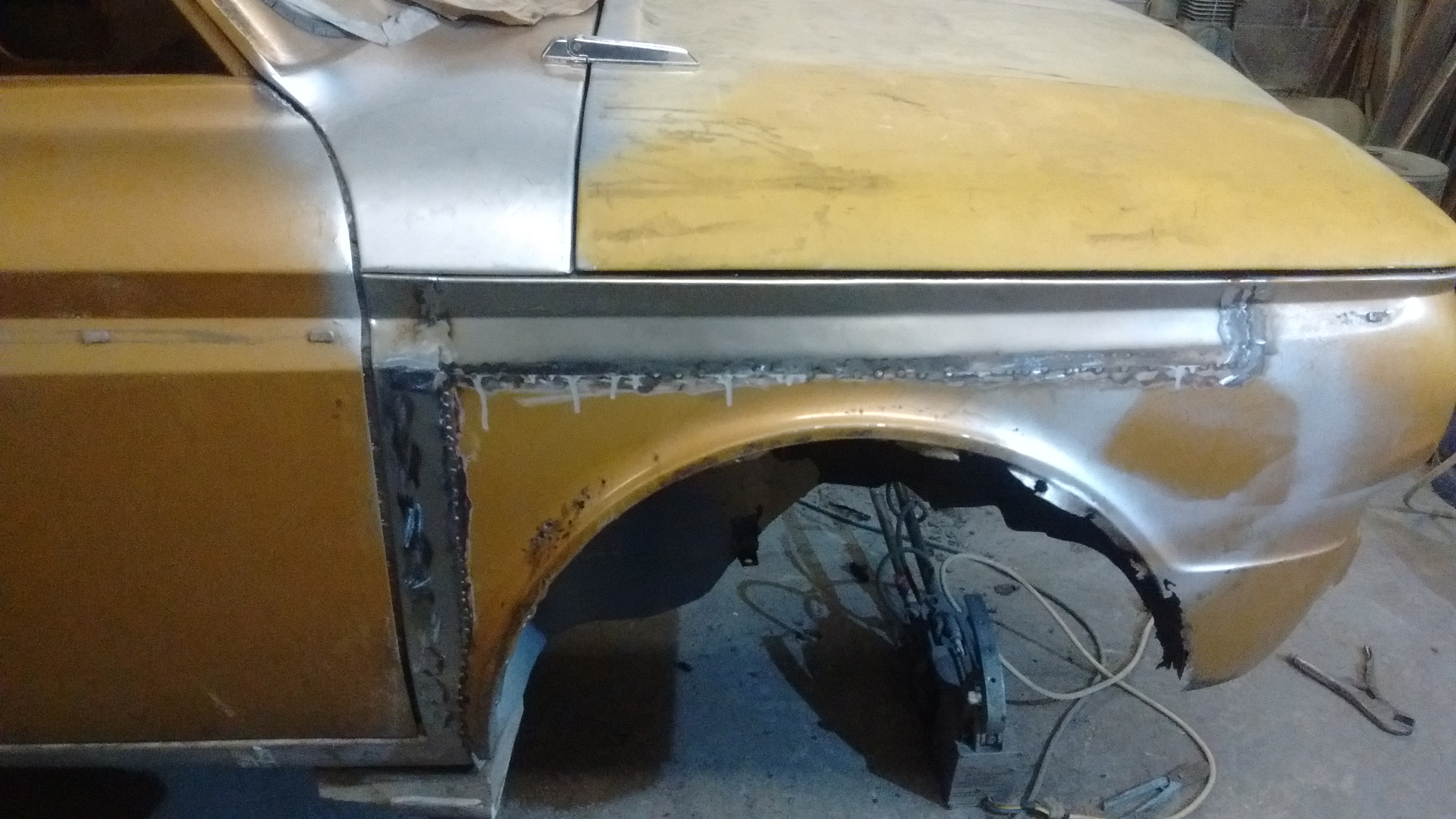

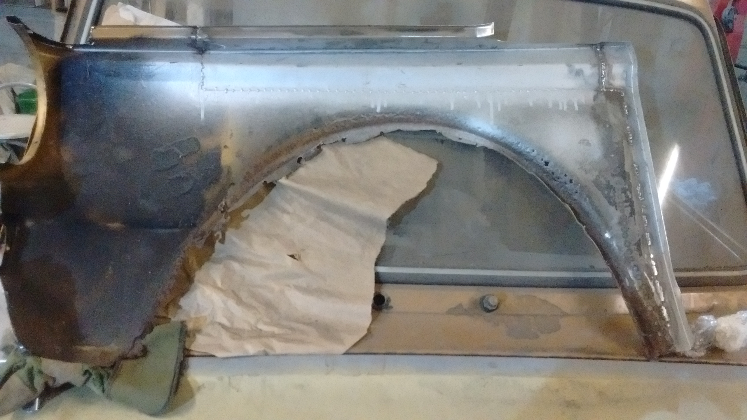

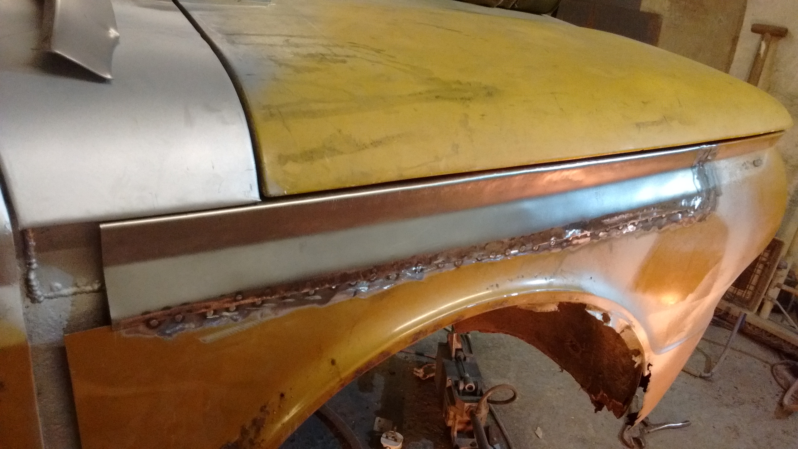

this solved the alignment issues at the door edge but the fit around the headlight section was just terrible. realistically there was a shed load of work needed to get it anywhere acceptable, probably the only solution would be to use the front off the original steel wing.
faced with such silly ideas I decided that i'd go down another silly route, repair the original steel one1 at least the fit around the headlight would be spot on :) and I already had a new door edge made up....
i'd originally thought against repairing it as so much needed doing, the whole arch lip plus the door edge and most of the top section.....
once i'd got a few points fixed in a repeatable place so I could take the wing off and get it back on in the same place I cut off the grot from the top..
i'd already made up a repair section for it, quite a tricky one as the folds weren't uniform gathering in towards the front plus having some curvature too
lined up to meet the previous repairs to the scuttle and follow the swage lines which will link in with the door gap section
i'll keep adding sections as I go, will be a bit of a patchwork quilt when it's done but better than £500 for a new one!!

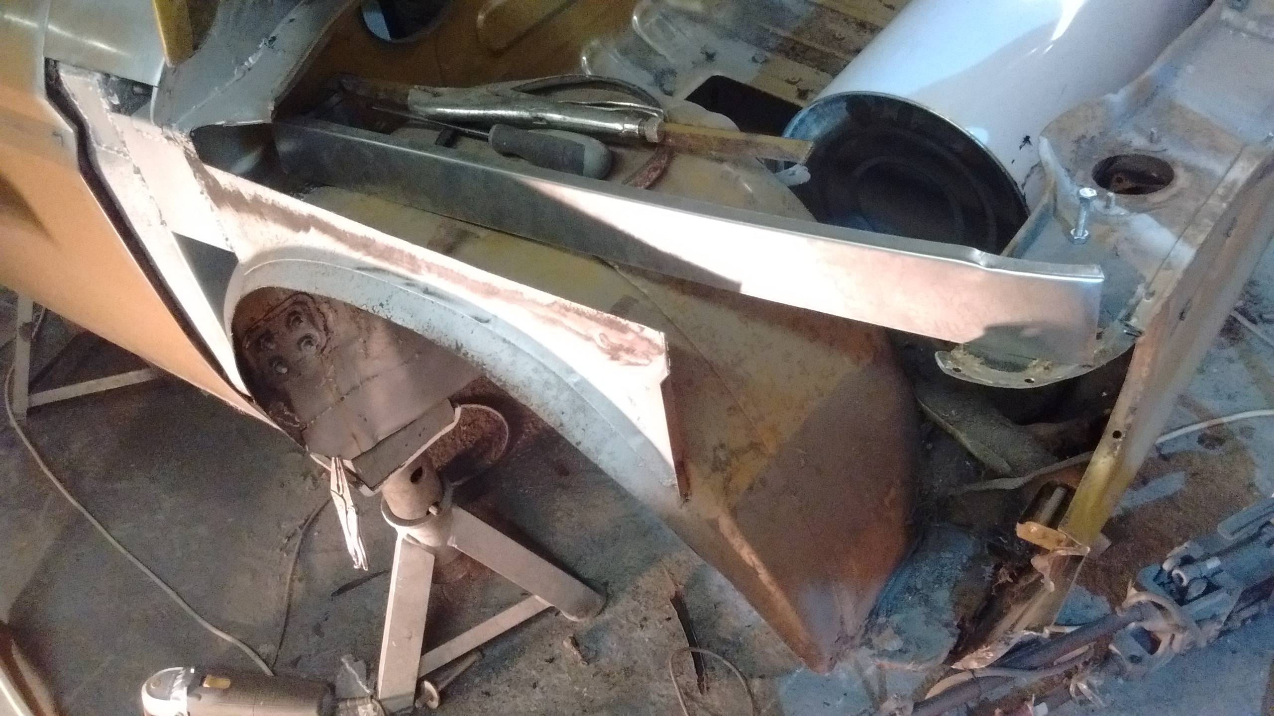

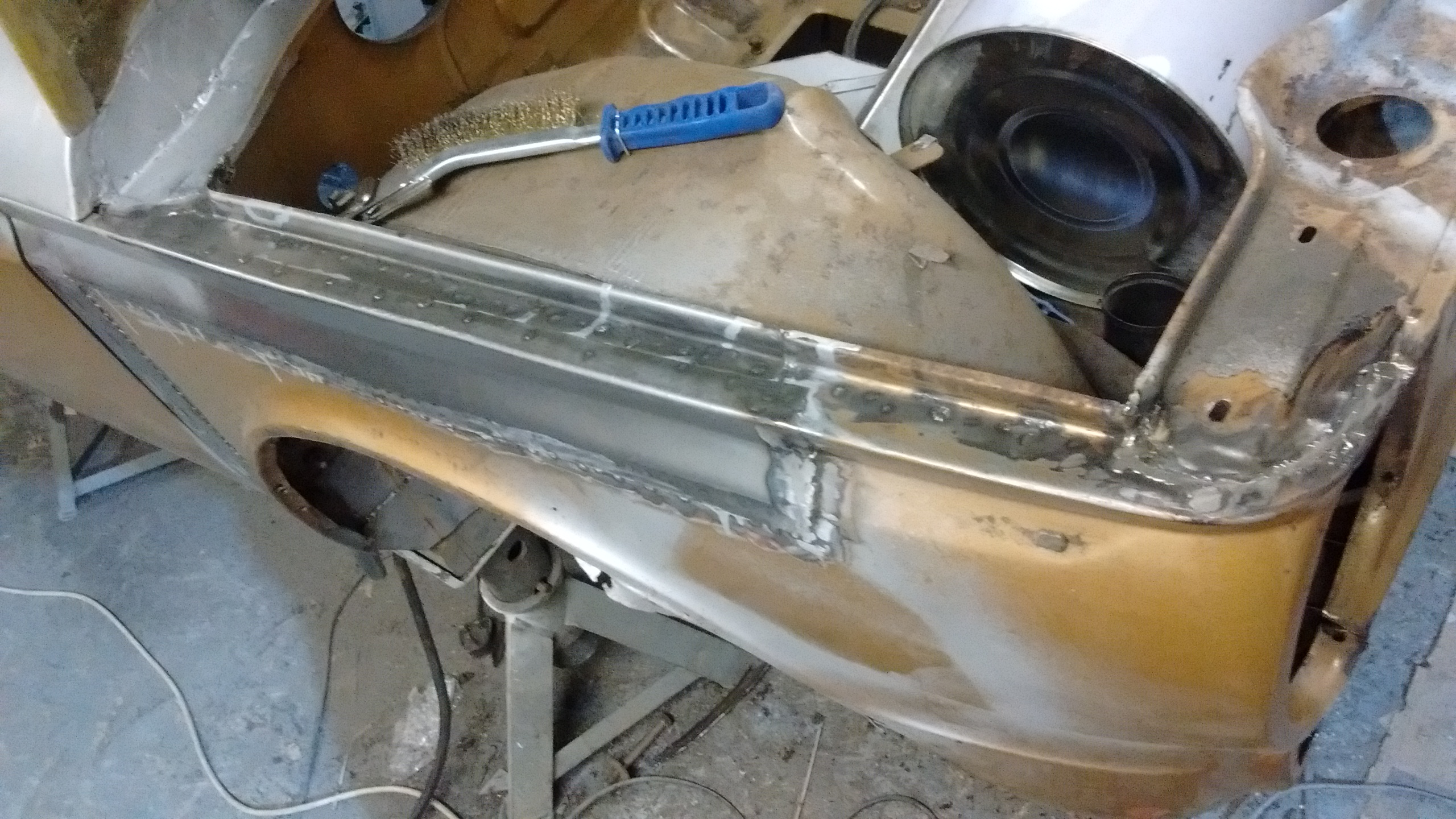

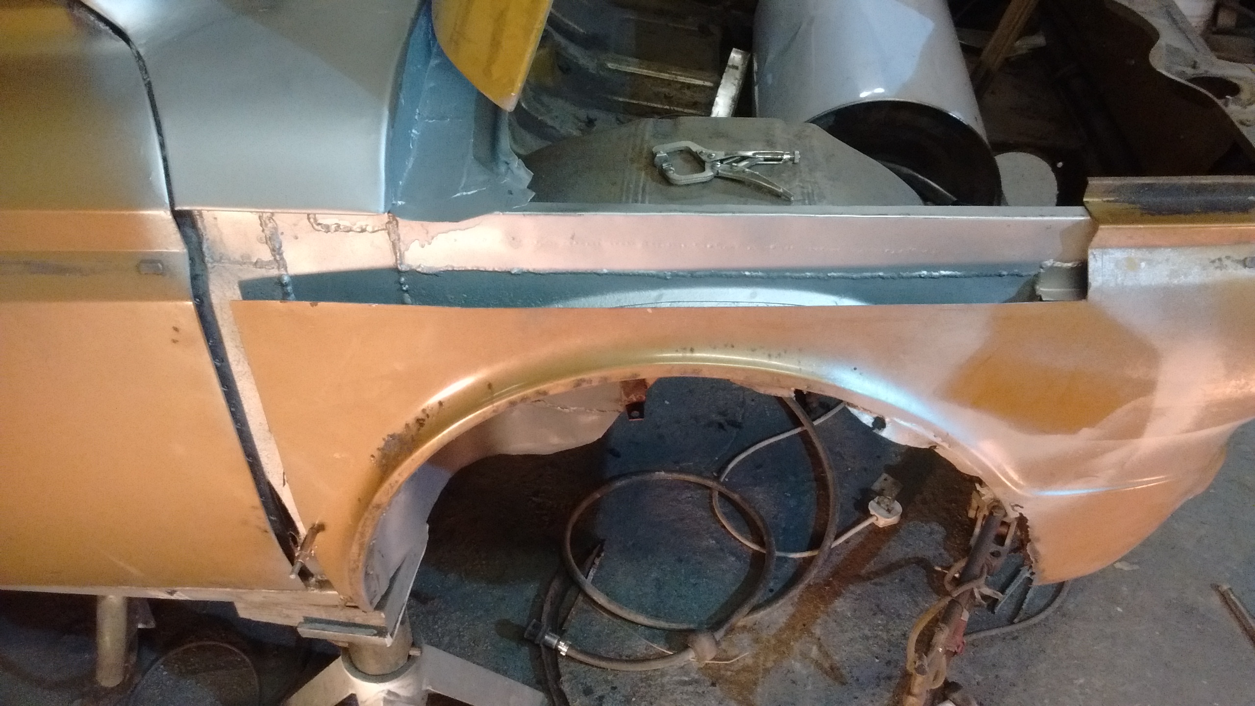

a few hours on the drivers wing this afternoon...
started off fixing the repair section for the door edge with a few tack welds before more permanent welds in front and behind it
repair section now in place, wing still loosely in position

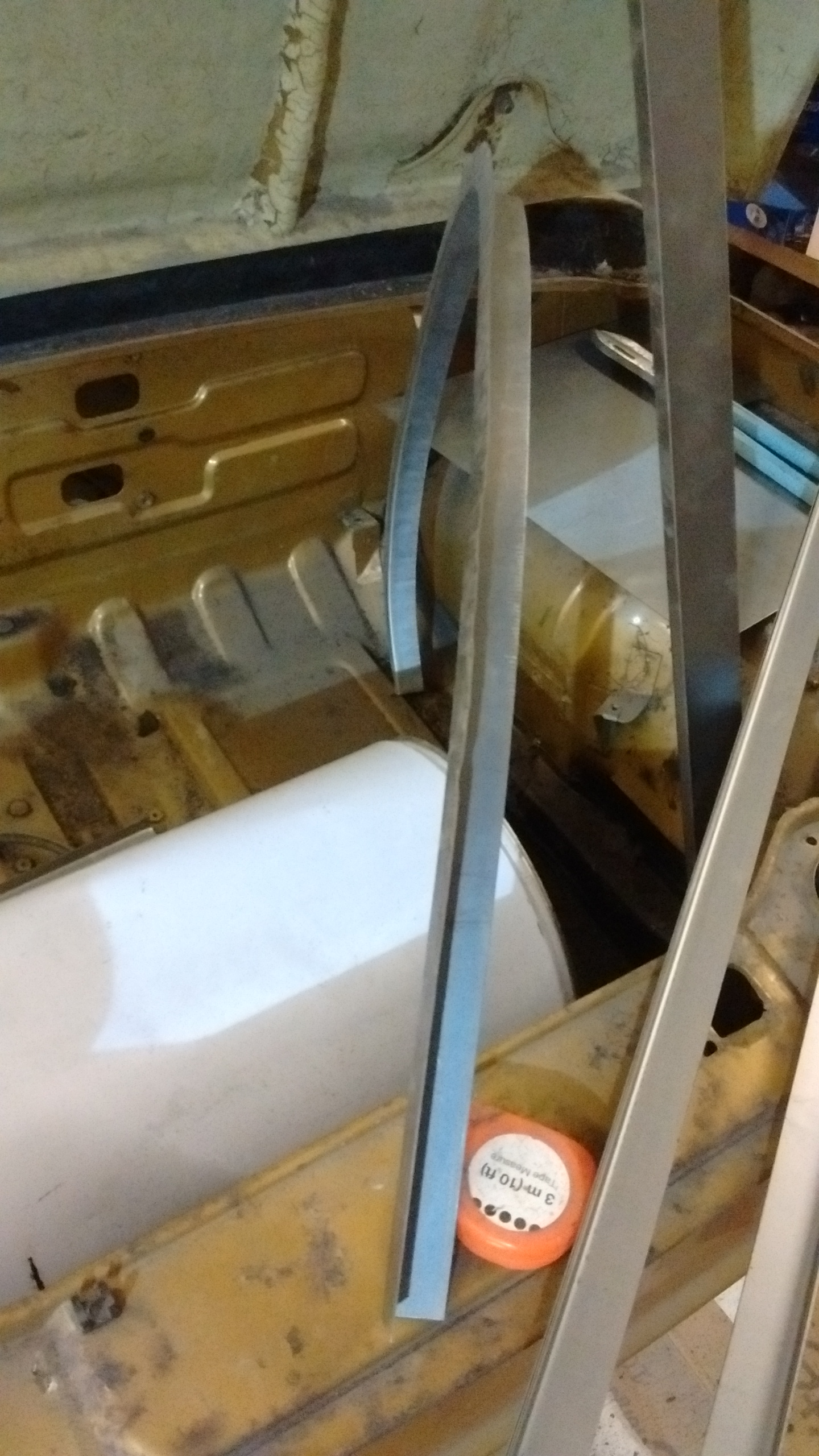

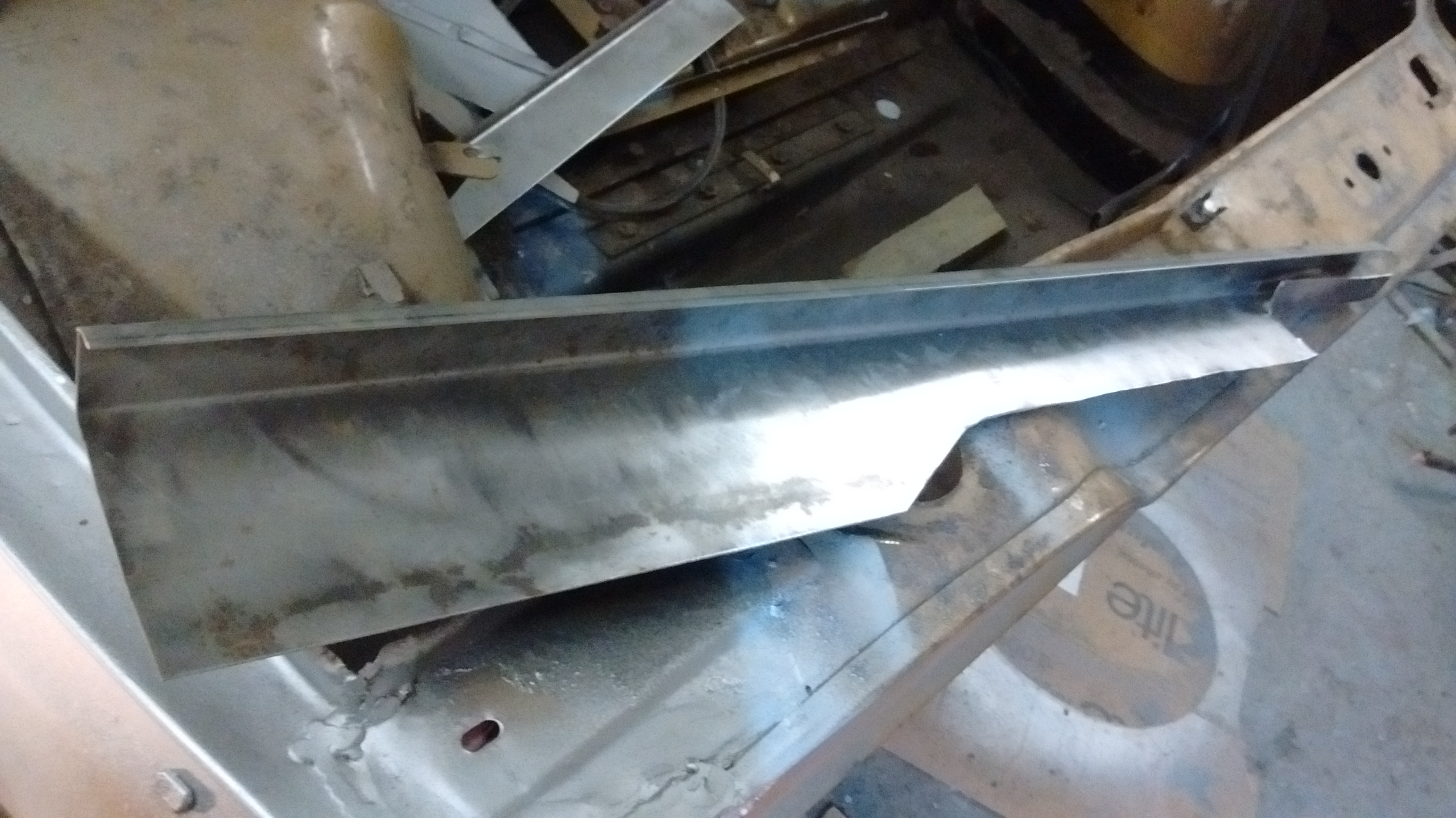

the wing rail needed an extension piece main to join the wing itself to the cars wing rail, this got spot welded to the wing which will itself then be spot welded to the car
the underside then got a clean up and some etch primer liberally sprayed into the seam to keep moisture from doing damage, seam sealer will also go in before fitting to the car where I can. you can also see that the arch edge has quite a bit of reconstructing still to do....
should eventually sit about here, a tweak or two to get full alignment and a section doing for the sill join but we're getting there
about it for now, Wednesday should see a return to normal after all the xmas upheavals, be nice to get somewhere close to thinking about paint prep....

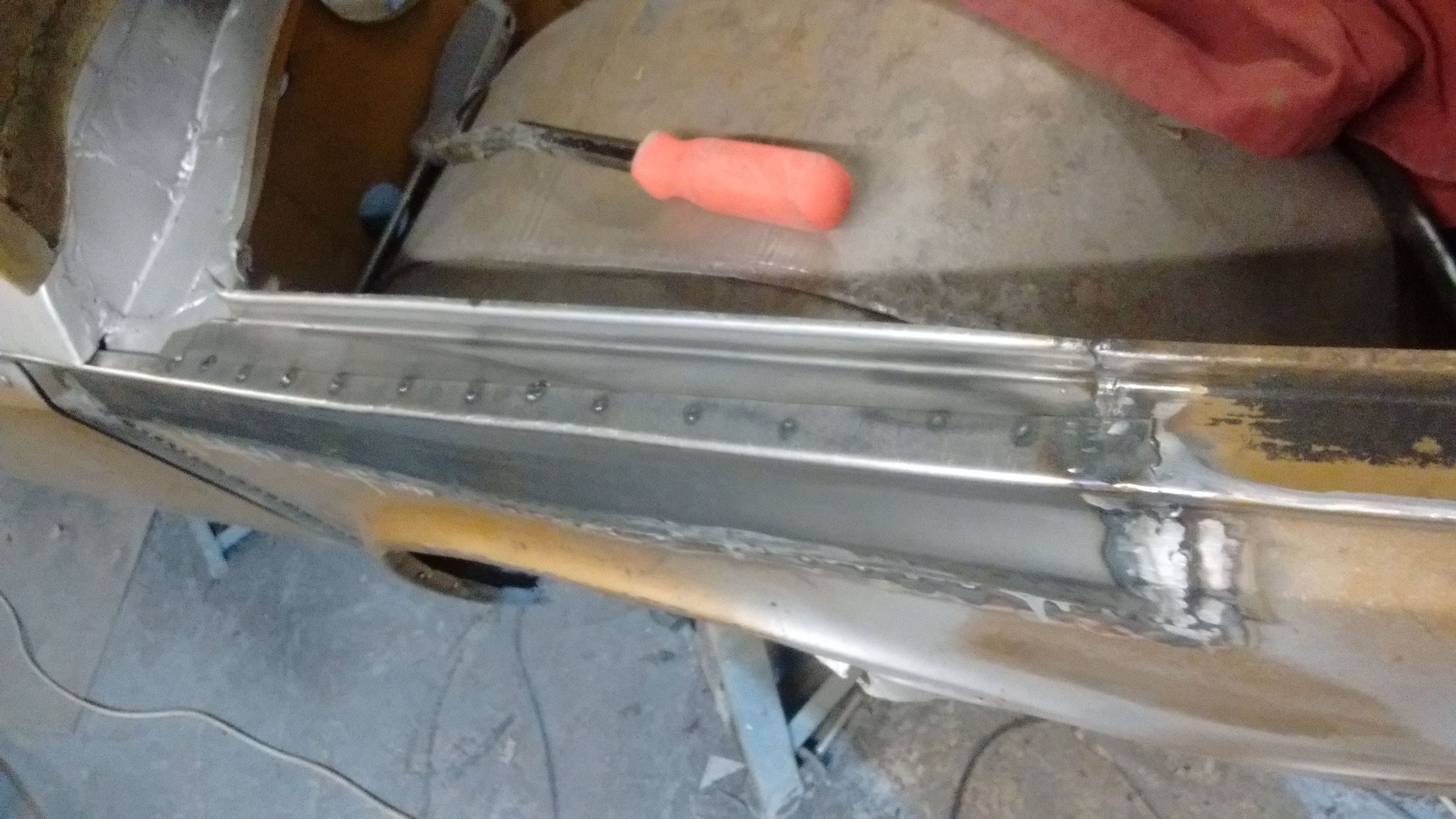

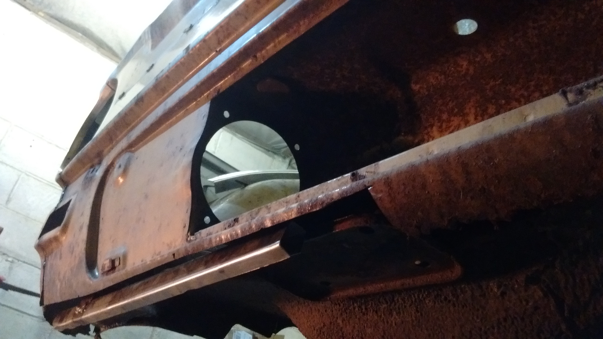

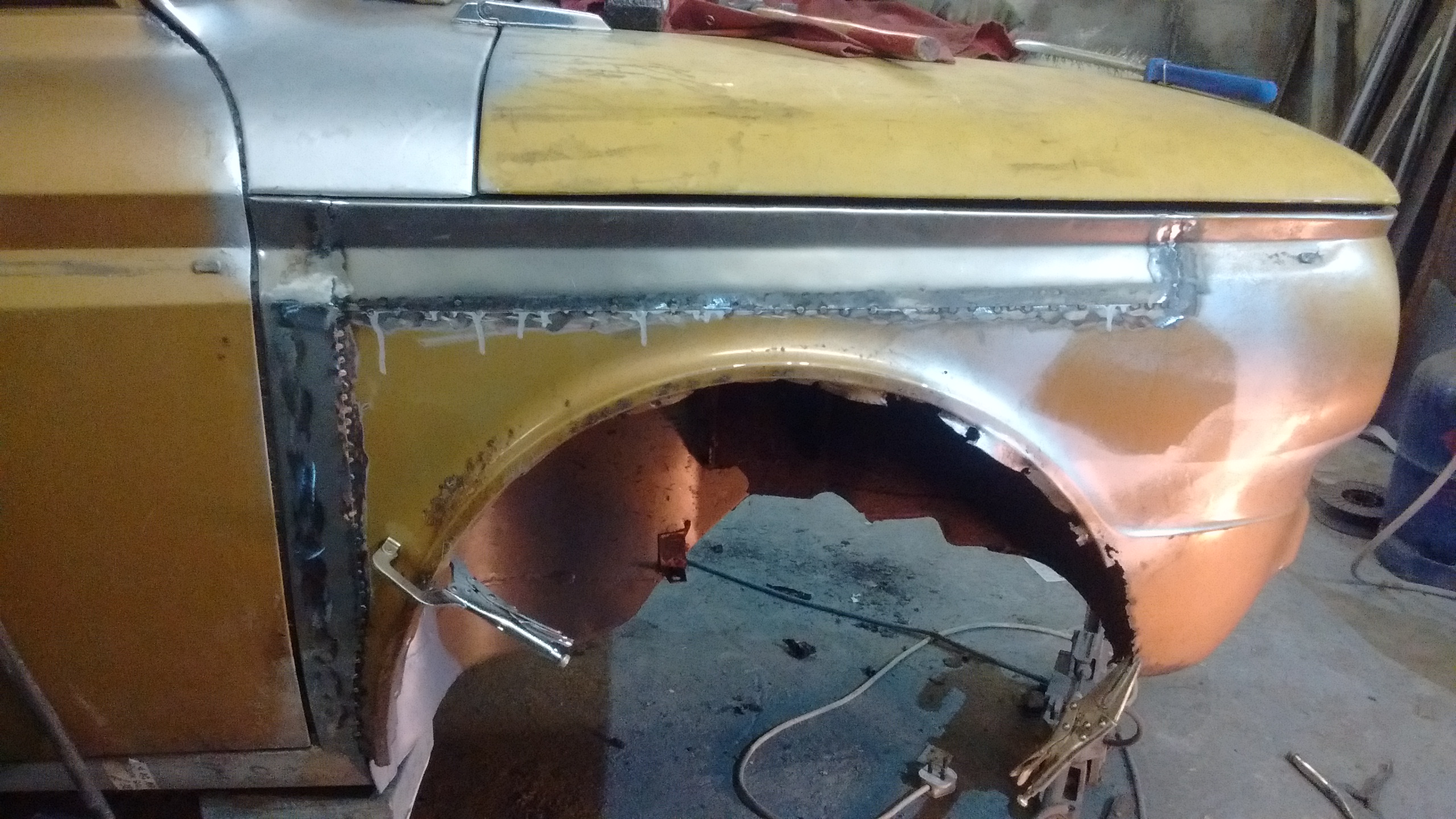

another trip up to the unit to carry on with the imps' wing rescue
the previously made repair sections which got etch primed to seal some zinc in are now covered over with seam sealer, that should stop any moisture getting between the joint. once we're done a good dose of waxoyl should complete the job.
the lower edge of the front panel, which i'd not really looked at before, also seems to need a bit of work.
I did think about doing that first but decided that getting the wing on as a guide to where the panel would need repairing to made more sense
so a few spot welds and seam welds where possible and it's in position
the mounting rail needs a good lip on it as in the imp this is your luggage space, rainwater getting in isn't the best!
i'll start making up the arch lip inner and outer sections on Saturday, may have been easier to do it with the wing off but at least now it's solid enough to work off

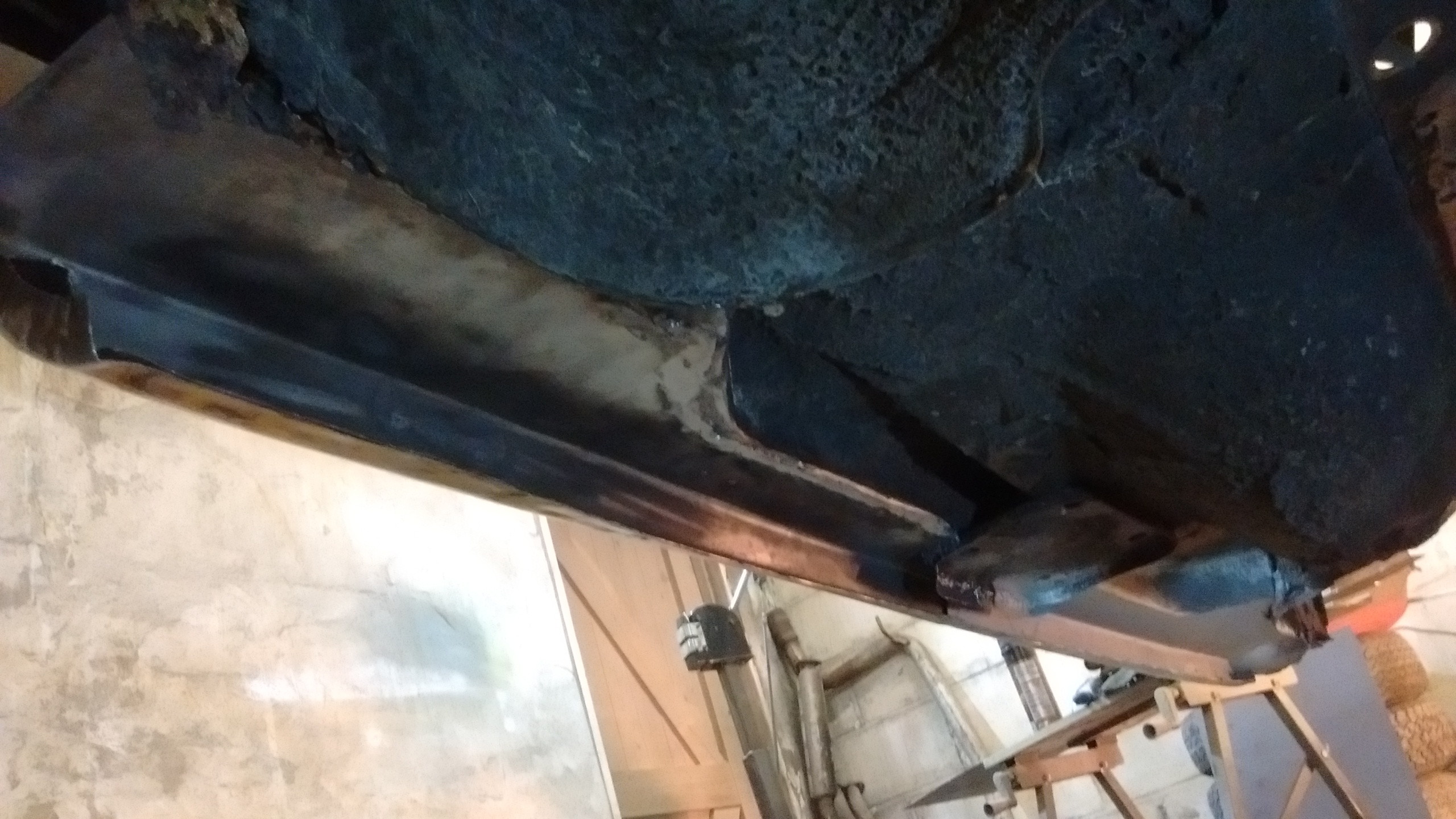

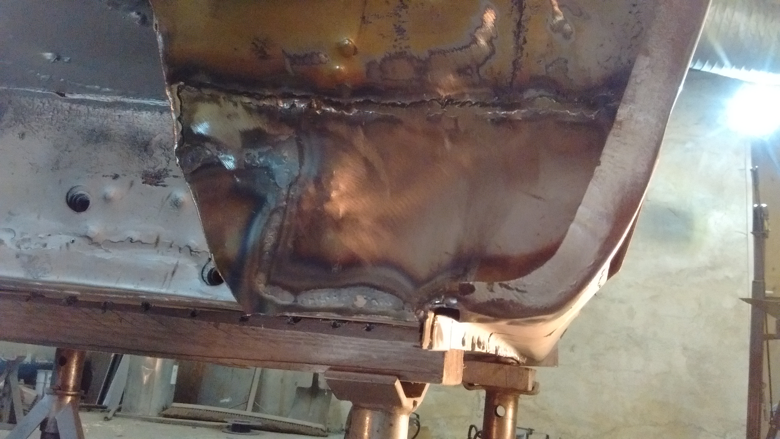

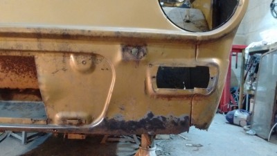

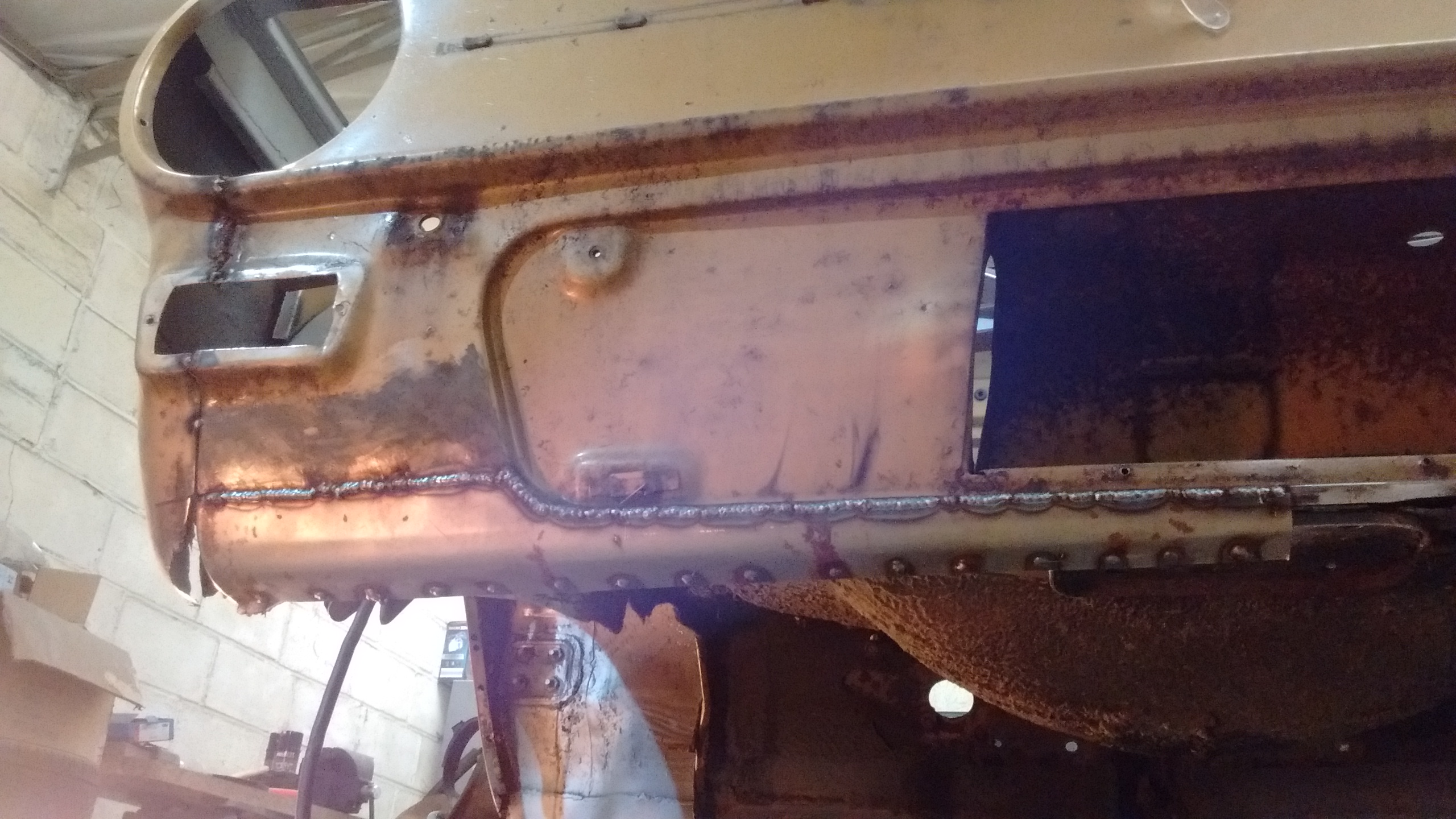

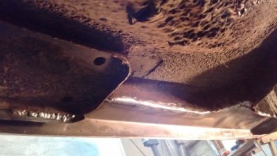

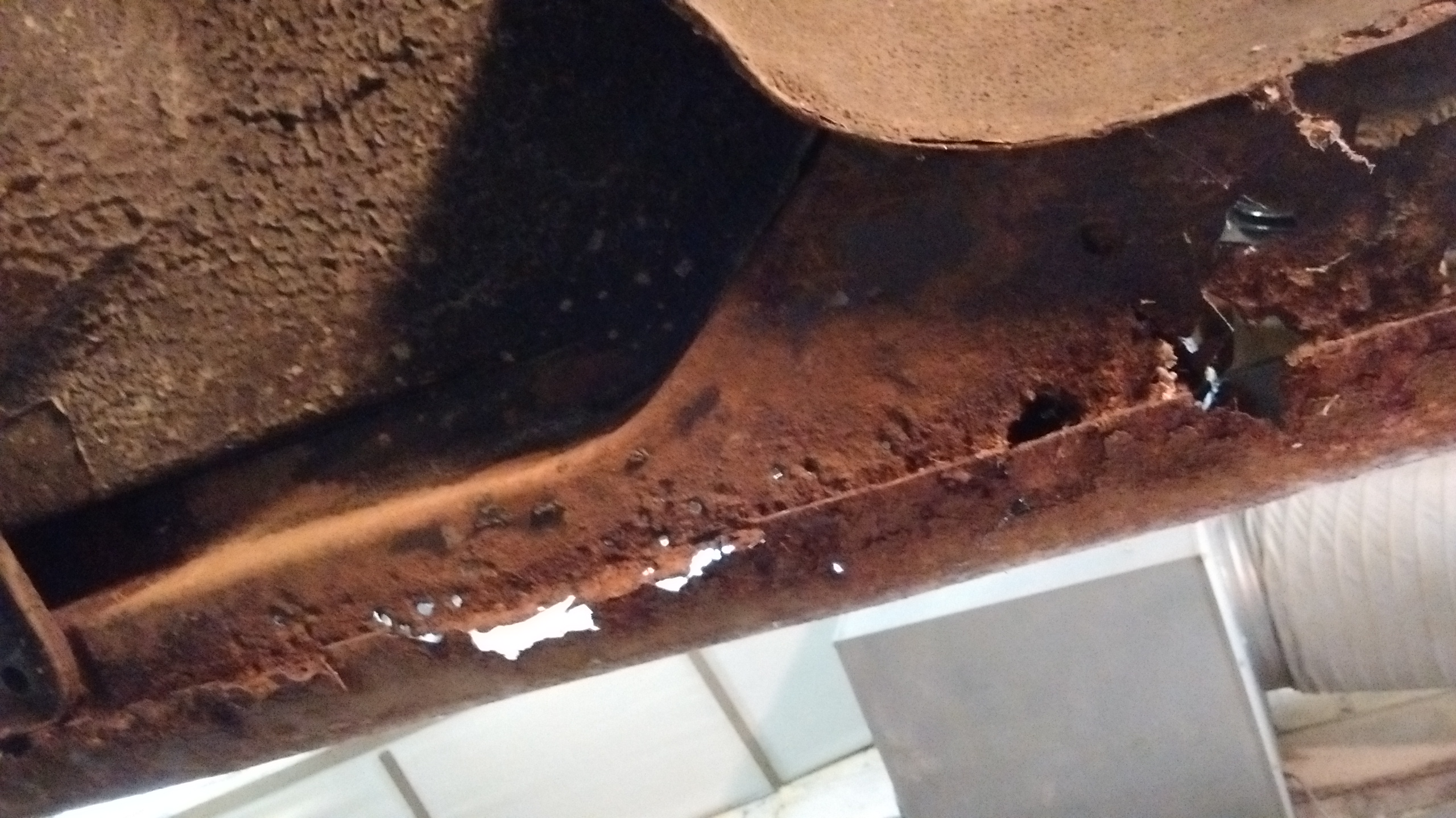

some jobs done last Saturday afternoon but not posted, the underside of the front panel got chopped about a bit and repaired with a nice thick section
the outer skin I chopped away in readiness
i'd also bought some more angled sections to make an arch repair section, I could cut a piece off a sheet of course but my folder won't take a long enough section to do it in one piece
some stretching action and it's about the shape needed
should sit about here...
has a little twist in it to follow the wings contours

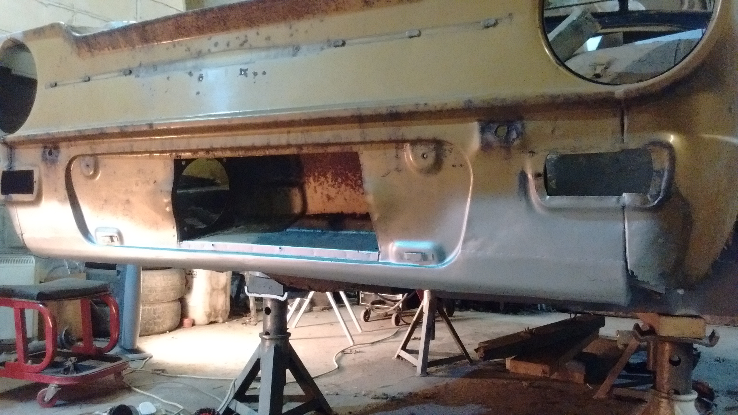

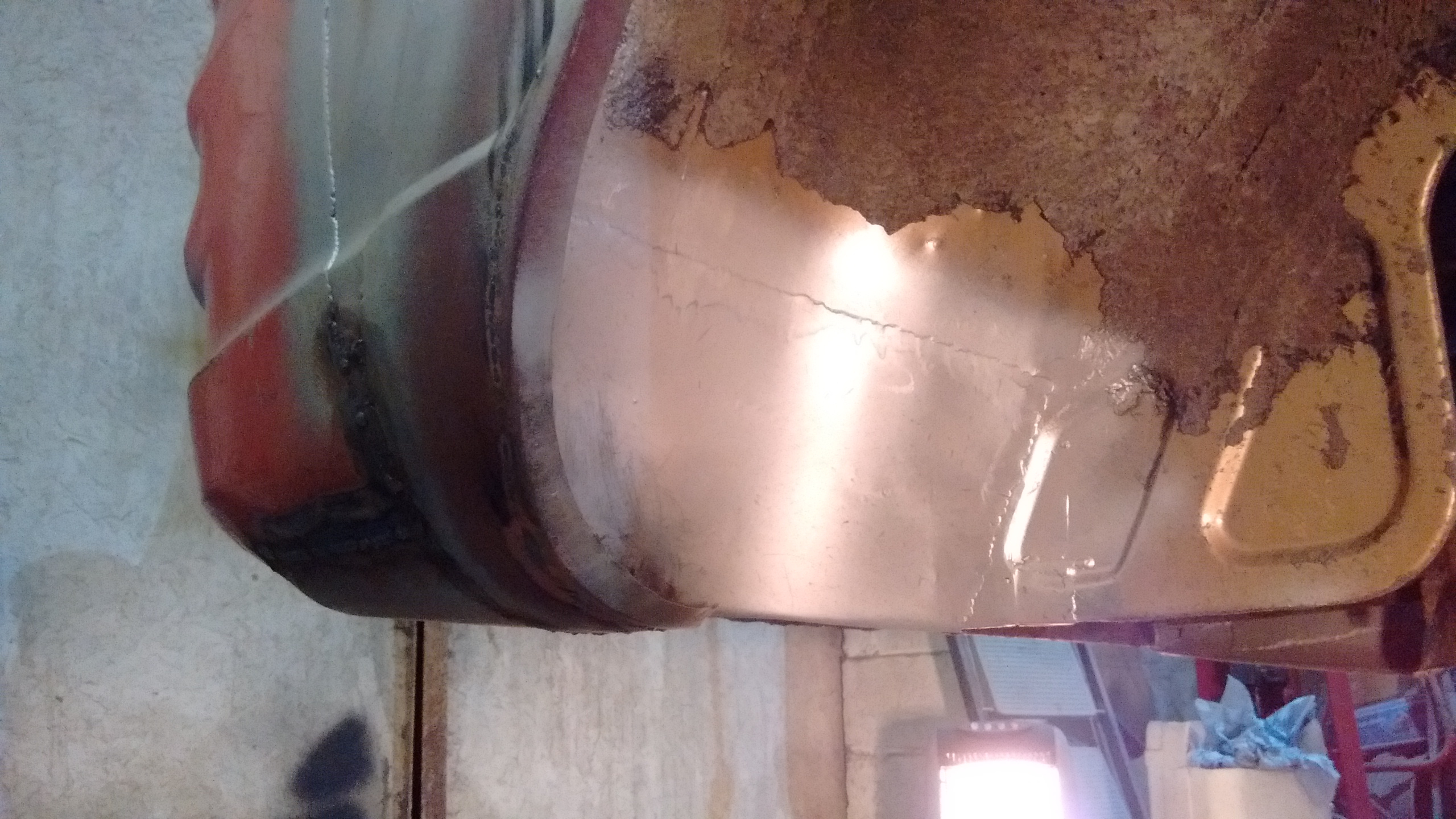

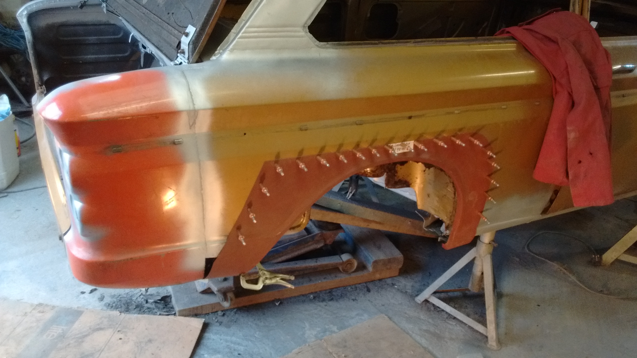

today I made a start on the rest of the front panel.
first job to make and fit an outer repair section
the underside of the passenger side then got chopped out so I could straighten out the big dent it had around the indicator opening, was pretty well stoved in but has come out pretty well
another underside plate made up and fitted along with the other half of the outer skin
underside back to being strong enough for the suspension to stay where it should be!

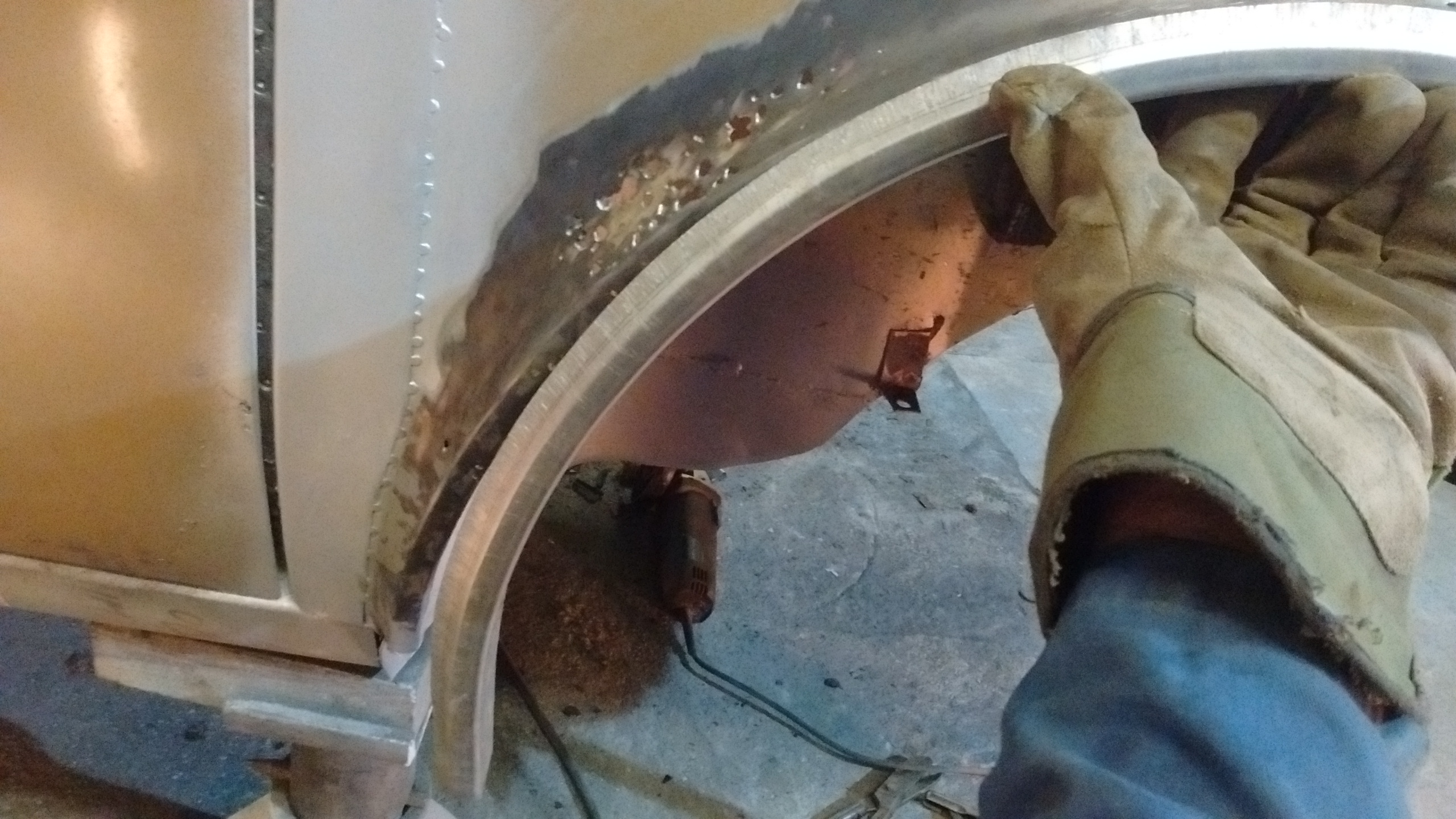

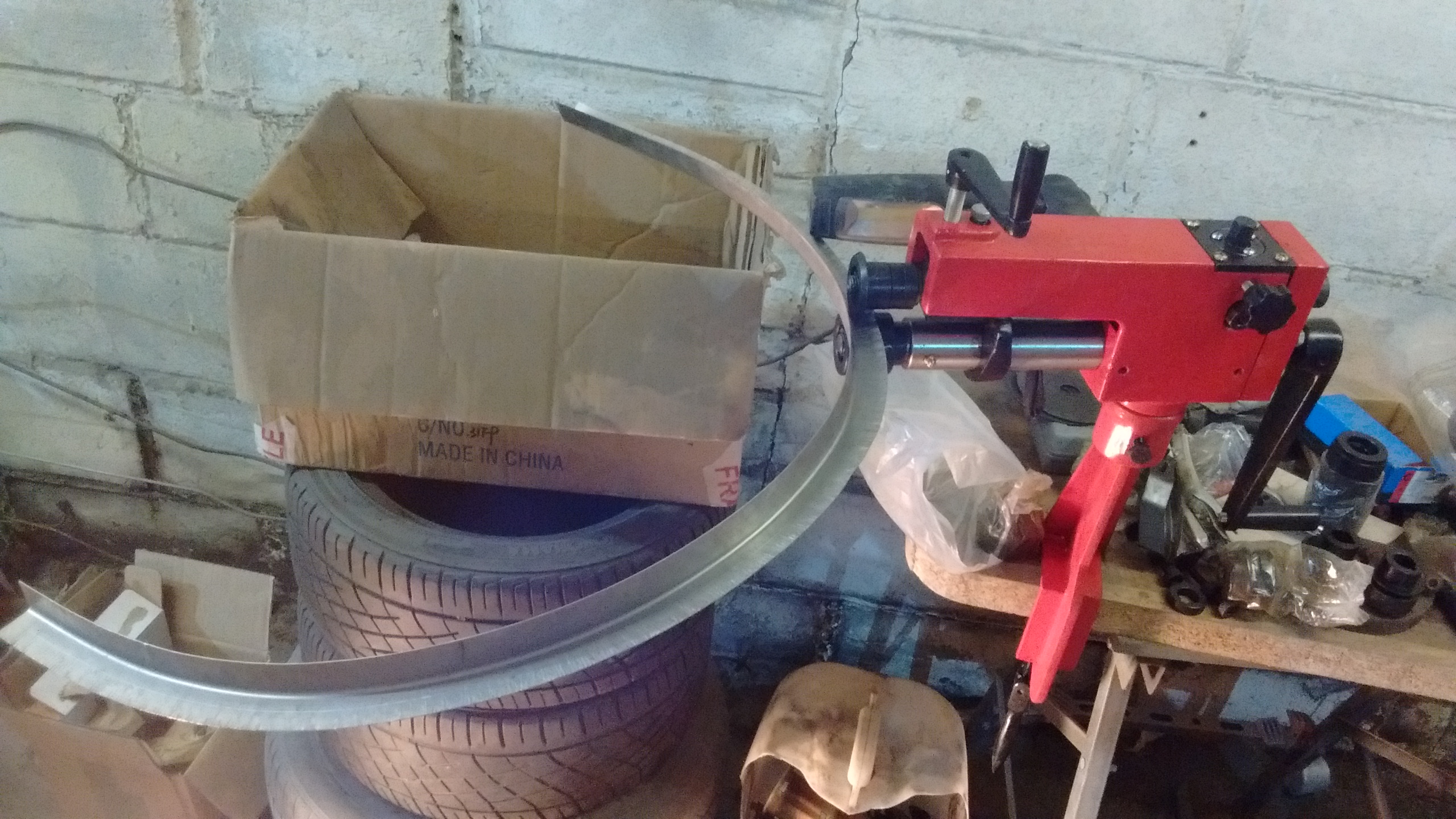

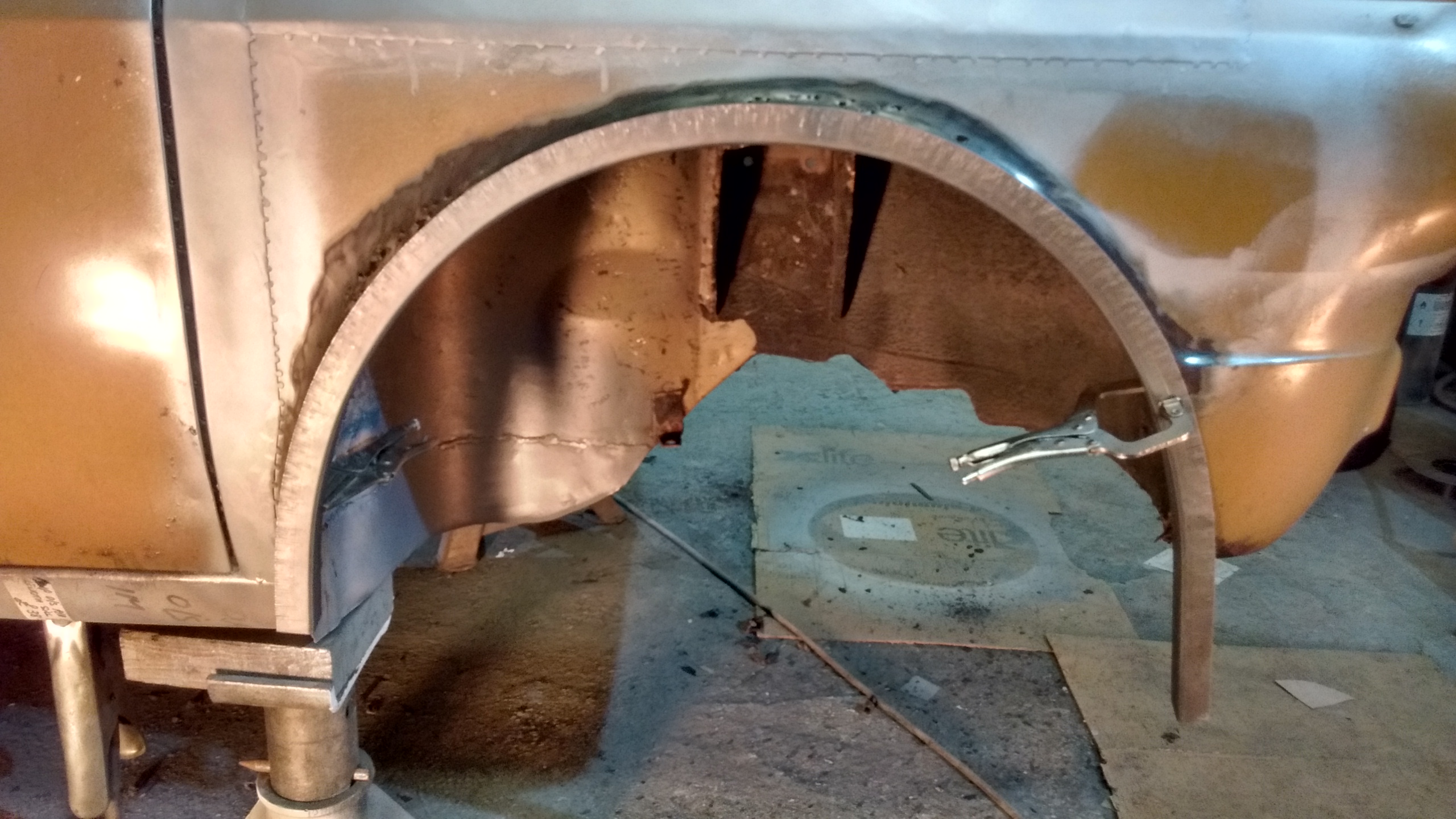

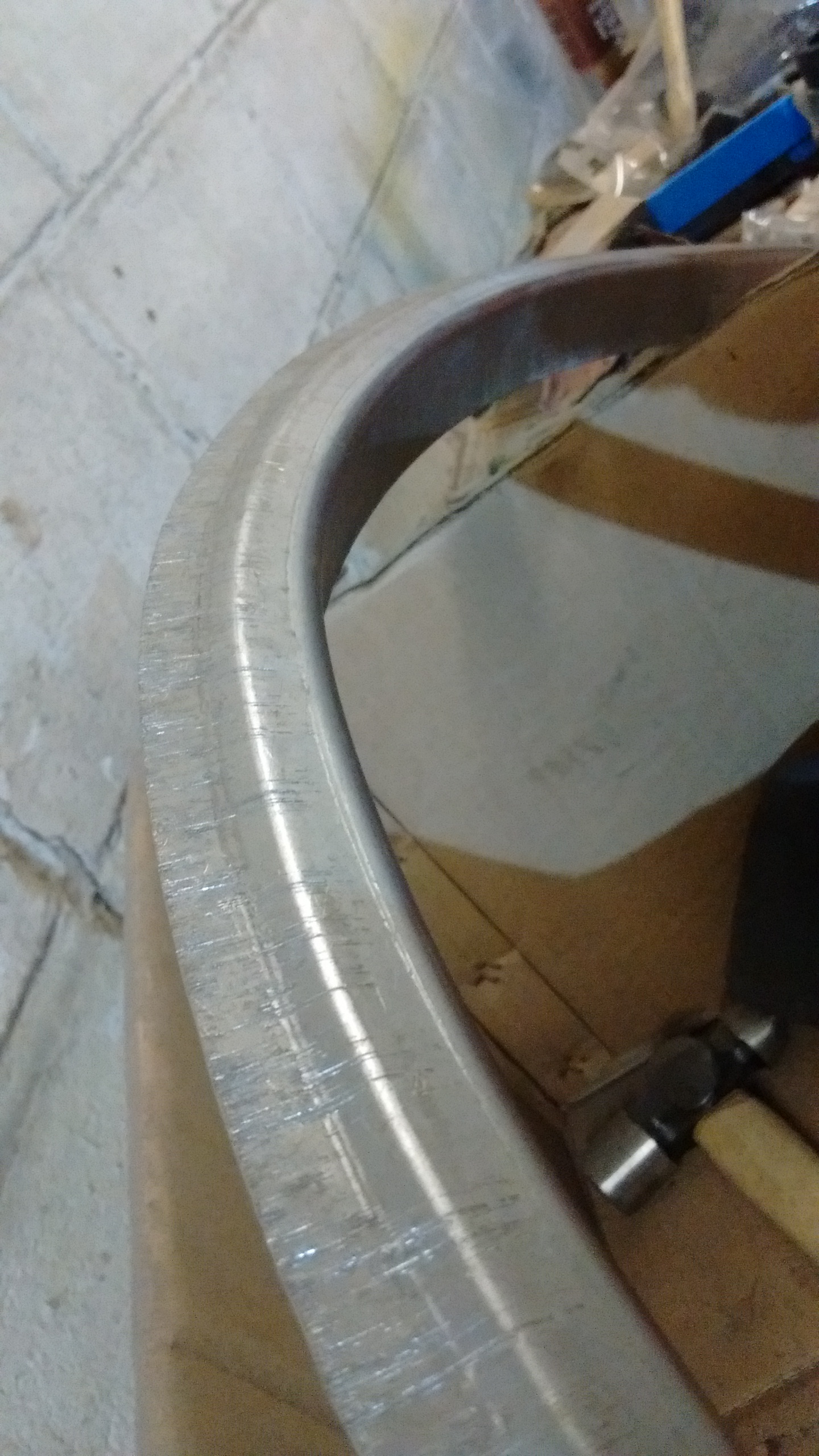

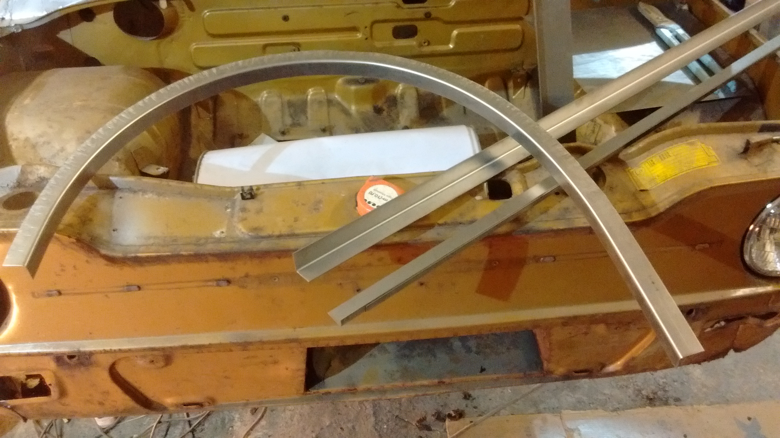

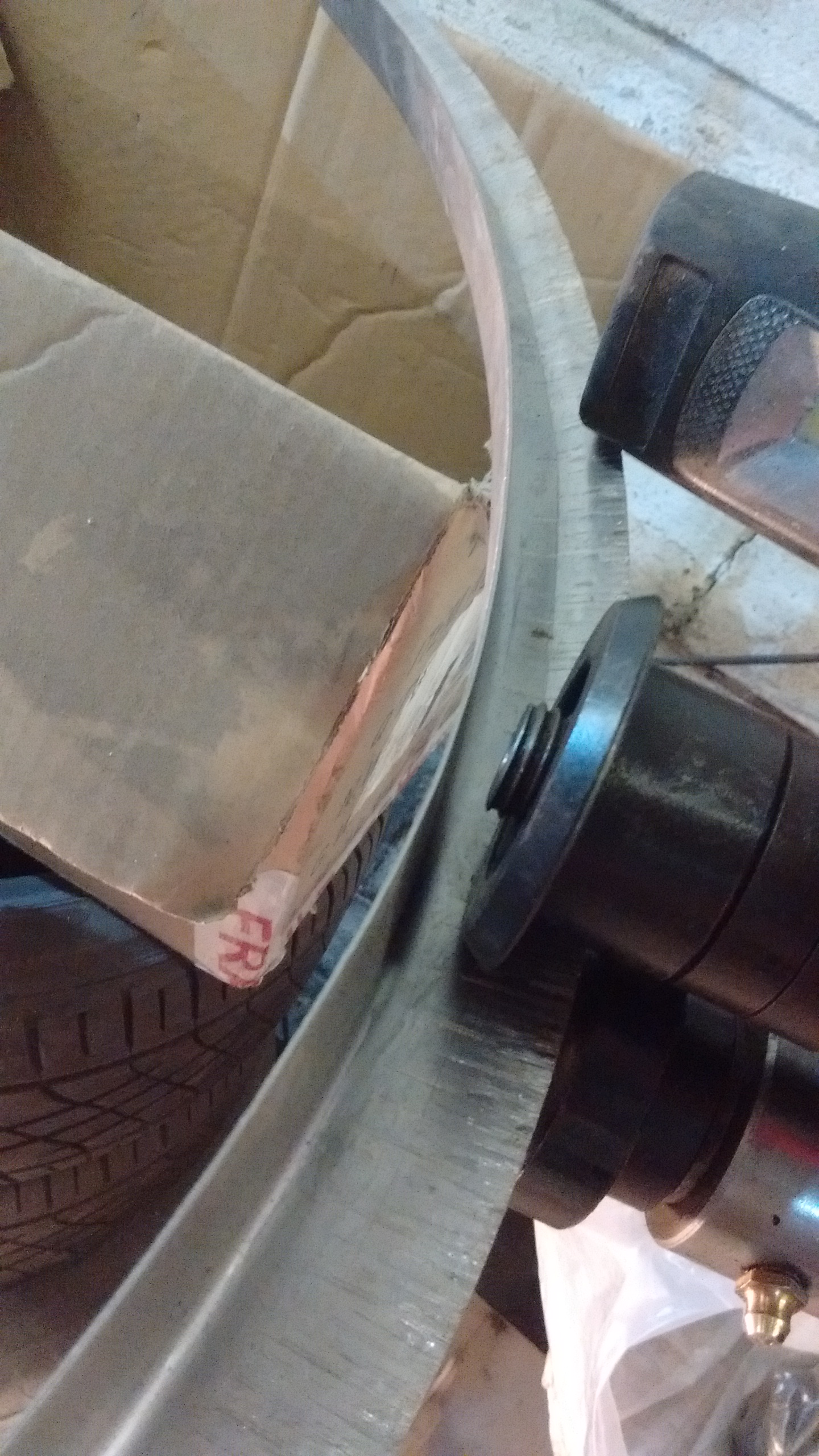

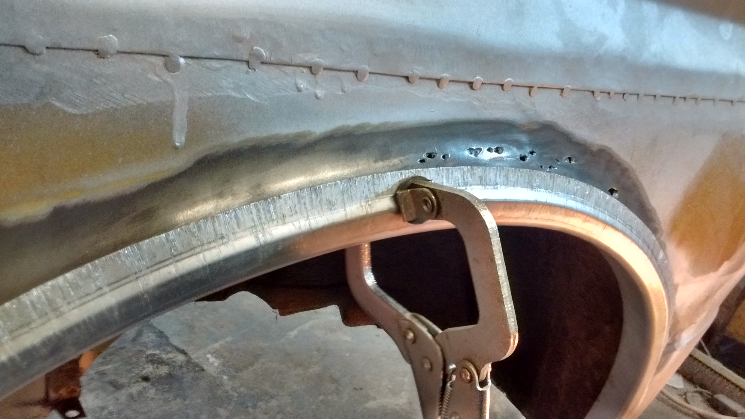

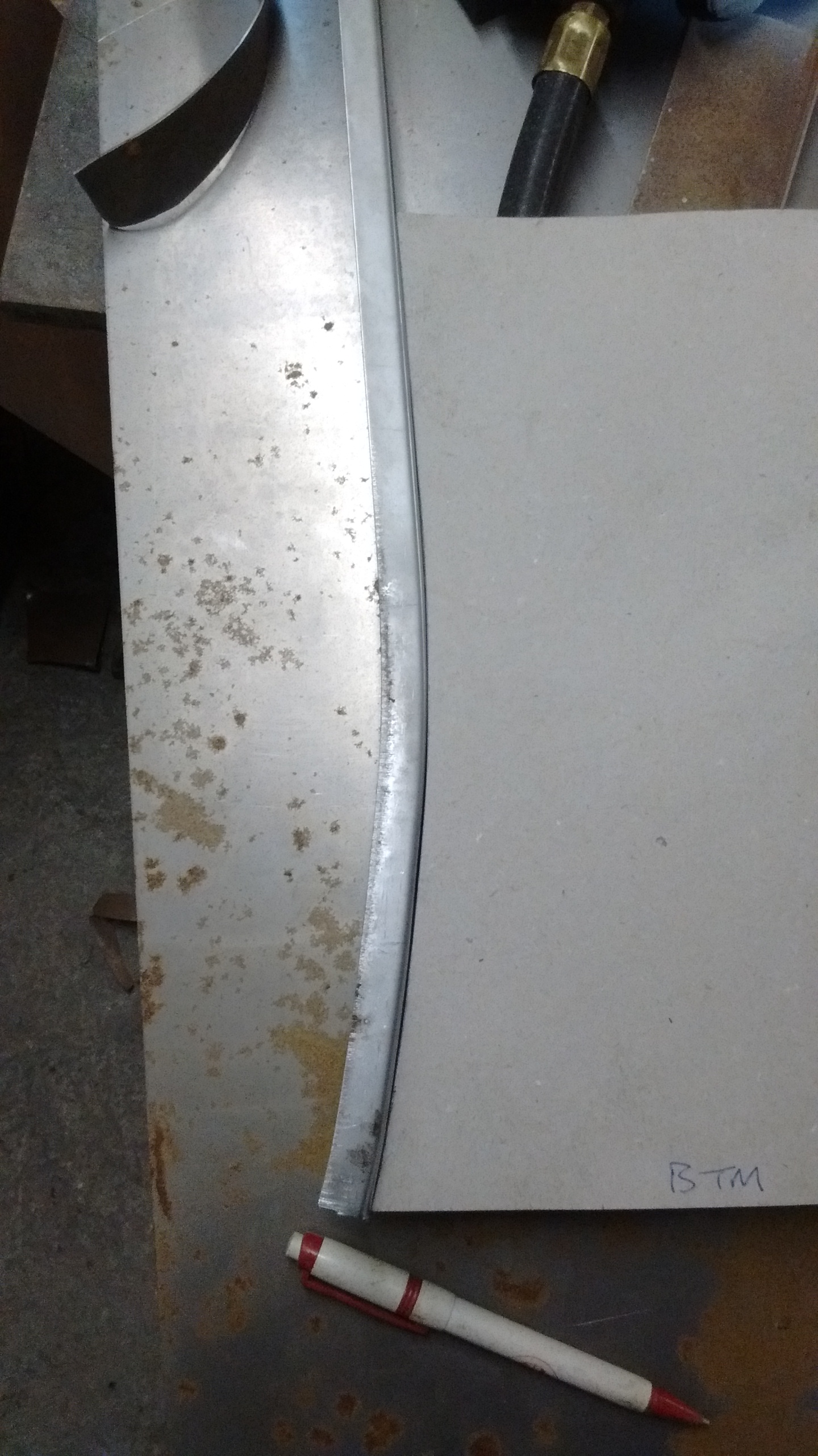

bought myself another new tool to help with the panel making, had been toying with getting one for some time but the arch repair section meant I really did need one
the face of the repair piece needed to be folded over to create the lip of the arch, being curved meant that folding it all by hand would be tricky to say the least!
a bead roller was called for
as you wind it through the tool following your marked line very carefully it creates the fold where you need it.
ending up with a nice crisp fold
which when put against the car you can see what i'm trying to achieve....which throws everything out of kilter again so needs more work on the shrinker
bit more tweaking and it's getting close
near to the shape i'm after

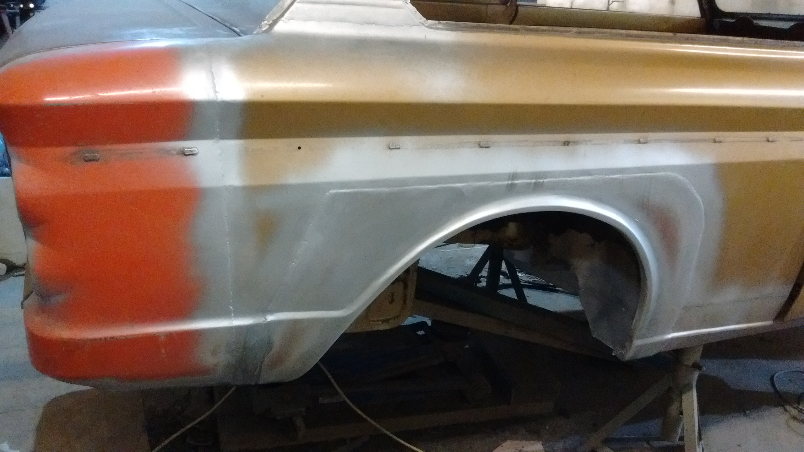

pretty much got the shape I need
bit of etch on the front panel, inside and out so it runs out and that'll do for the day
