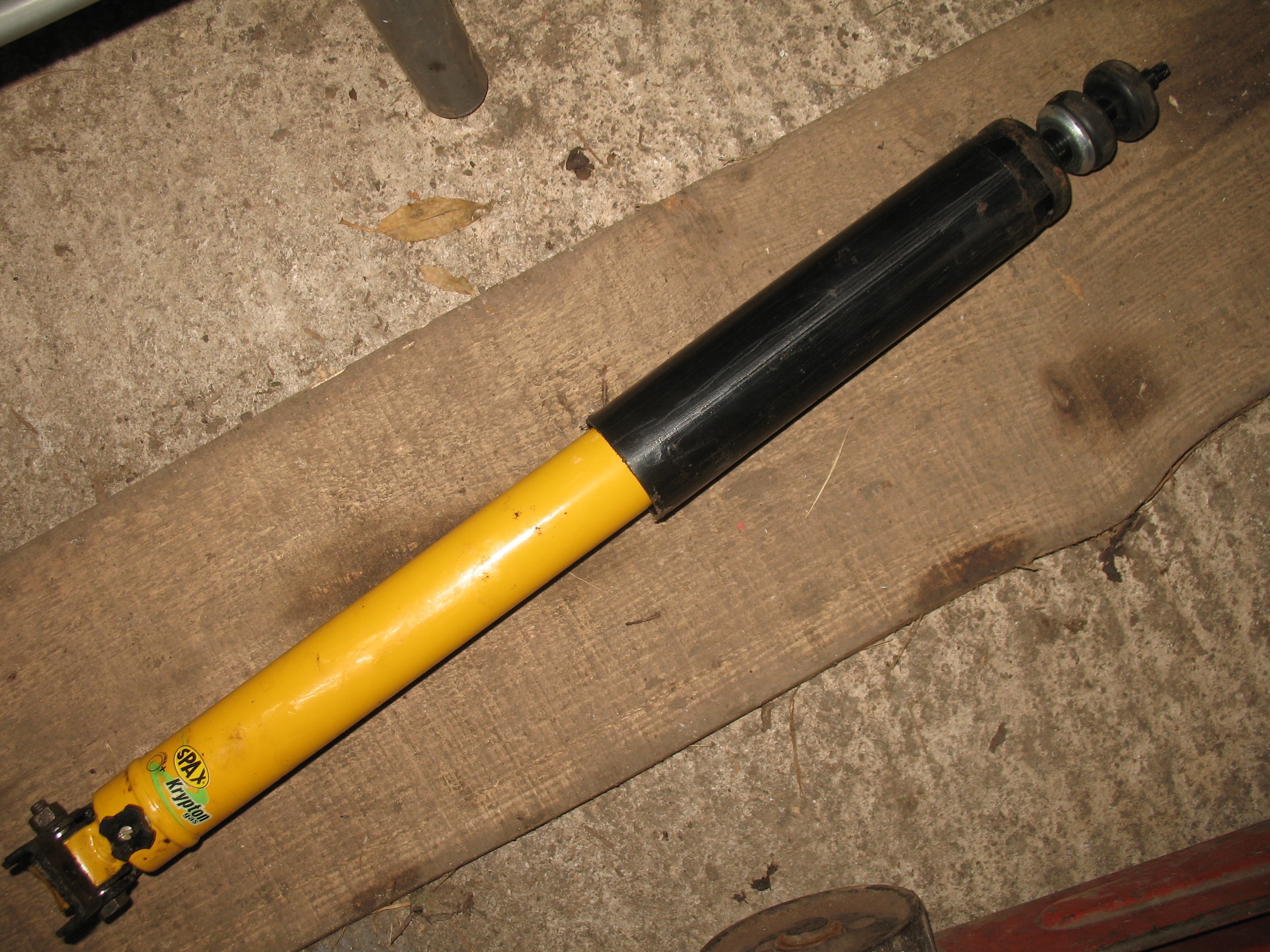

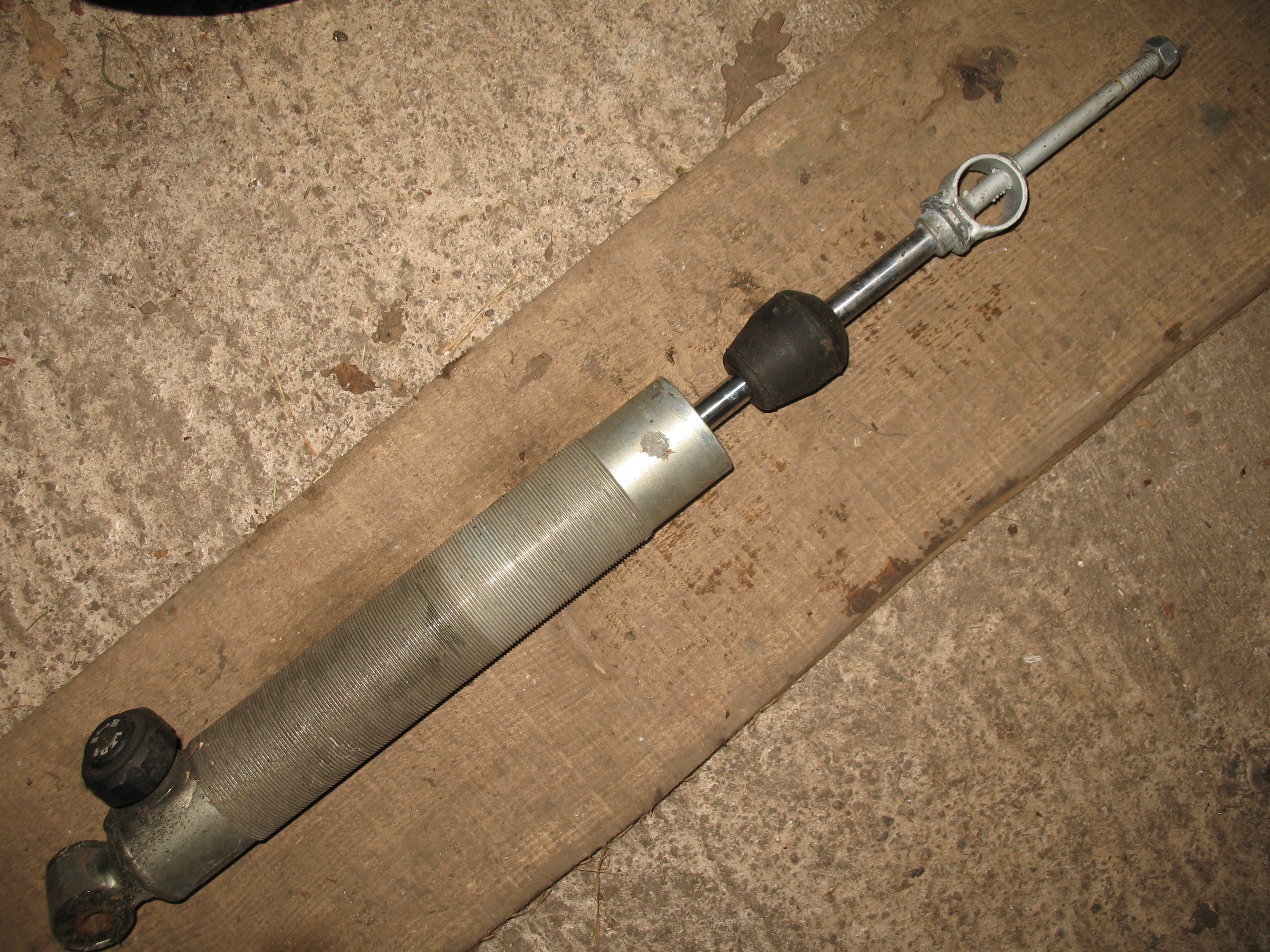

Had the original shocks I put in give up very quickly as one lost all interest, so the back end was fighting itself.
Then tried to fit a pair of Leda shocks and found I had not taken into account the width of the body of the shocks.
Found this after I had got them altered. Then deciding I should stick to tried and tested methods I bought Spax gas shocks.
One went in as easily as can be possible. The other just will not quite fit. I have tried several different ways of doing it.
Anyone had the same problem? Is it the shape of the internals in the suspension tower?
Checked the hole size, shone a torch up and not extra rubbers are in the tower. It just wont quite go.
The top sticks up but not enough to get a nut on and pull it up that way. Is it the plastic cover on the shocks?

Had exactly the same problem took the plastic sleeve off, heated it up and refitted. Heating made it a bit more supple and deform easier. Bit of a fiddle but it went in. Make sure you fully extend shocker before you fit. Also try thin nose pliers to grab the top of the thread?
So it is the plastic sleeve!  Many thanks was really getting to me as such as simple task.

Will try as you say. Can get mole grips on the very top, but not enough to pull the threads into play.
Roll on tomorrow and another attempt.

The other thing I found was that the threaded section can need some guidance to go through location in body.definitely easier if someone can help.Rsfruitbat
That sounds sensible as well.  Will wait till a friend is down on thur.  Also hopefully not so cold then !

Shocks are in and it turned out to be the collar at the top. Took the plastic cover off as rsfuitbat suggested.
Hot air gun helped. Then pushed the shock up into the tunnel several times till they marked the top of the metal collar that the plastic sits on. Then cut a bit off and it was better. Bit more and slid into place. Happy days.
Just been down the little road opposite and over a very rough cattle grid and already much better.

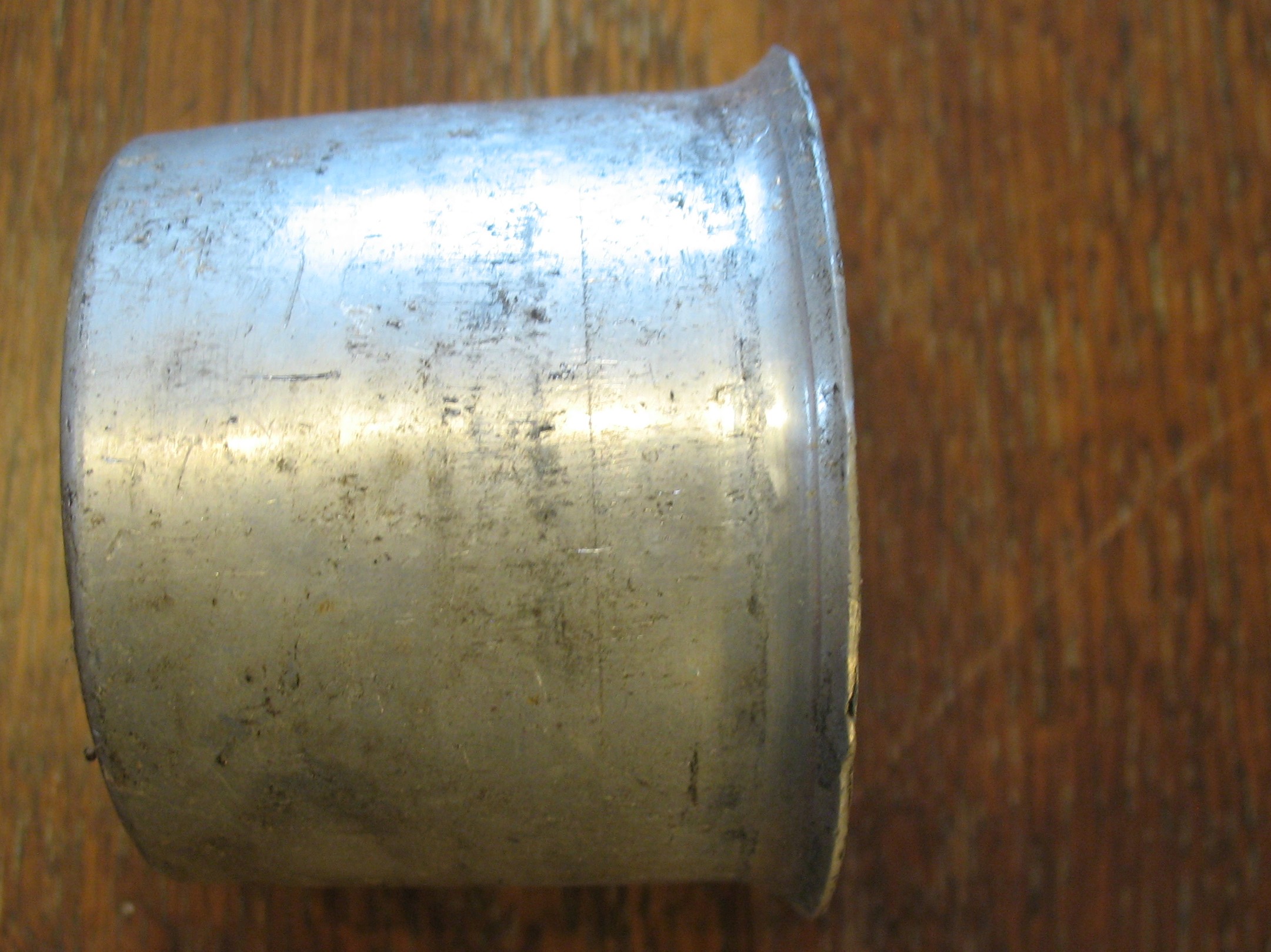

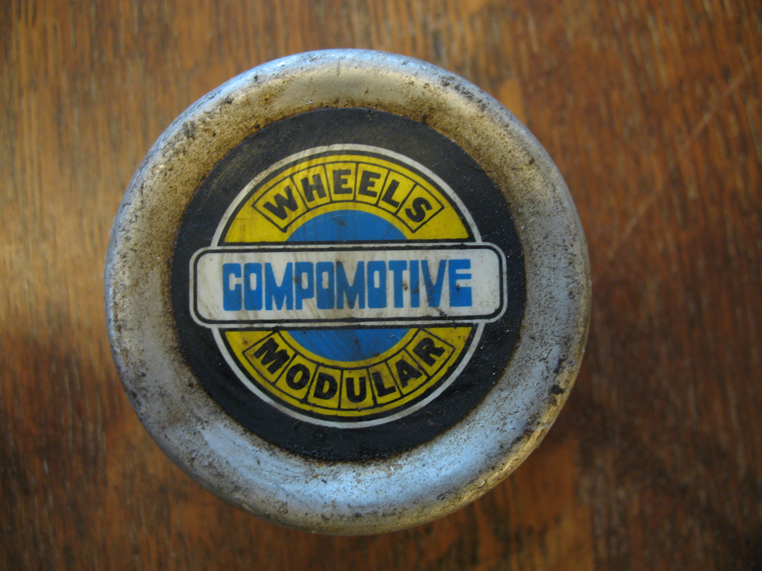

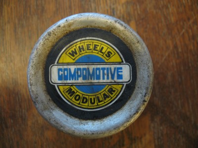

Hi Chaps.
I have three of these wheel centres and of course could do with one more. Not essential but I feel it would just add a bit to the era of the car . Any chance of anyone having one ?
Thanks chaps as usual.

Ha.   I did not think anyone would be making them!
Great, many thanks for the link.
Blimey! theyre a price aren't they!
Let me know if you go ahead and buy any, otherwise give me a nod and ill have a dig round my stock of old centres and compomotive stock bits, never know my/your luck!
Yes, they seem a lot and I have asked if I can just buy a pair as I only need one, but a new pair at the front and old ones at the back would be fine.
Thanks for the offer and if you do bump into one....
Let me have the pertinent sizes and i'll see what i have mate
Hi Shrew.
They extend outward 50mm and if read across the top 58mm dia. The base is 65mm dia.
Thanks for looking.
Thanks for looking.

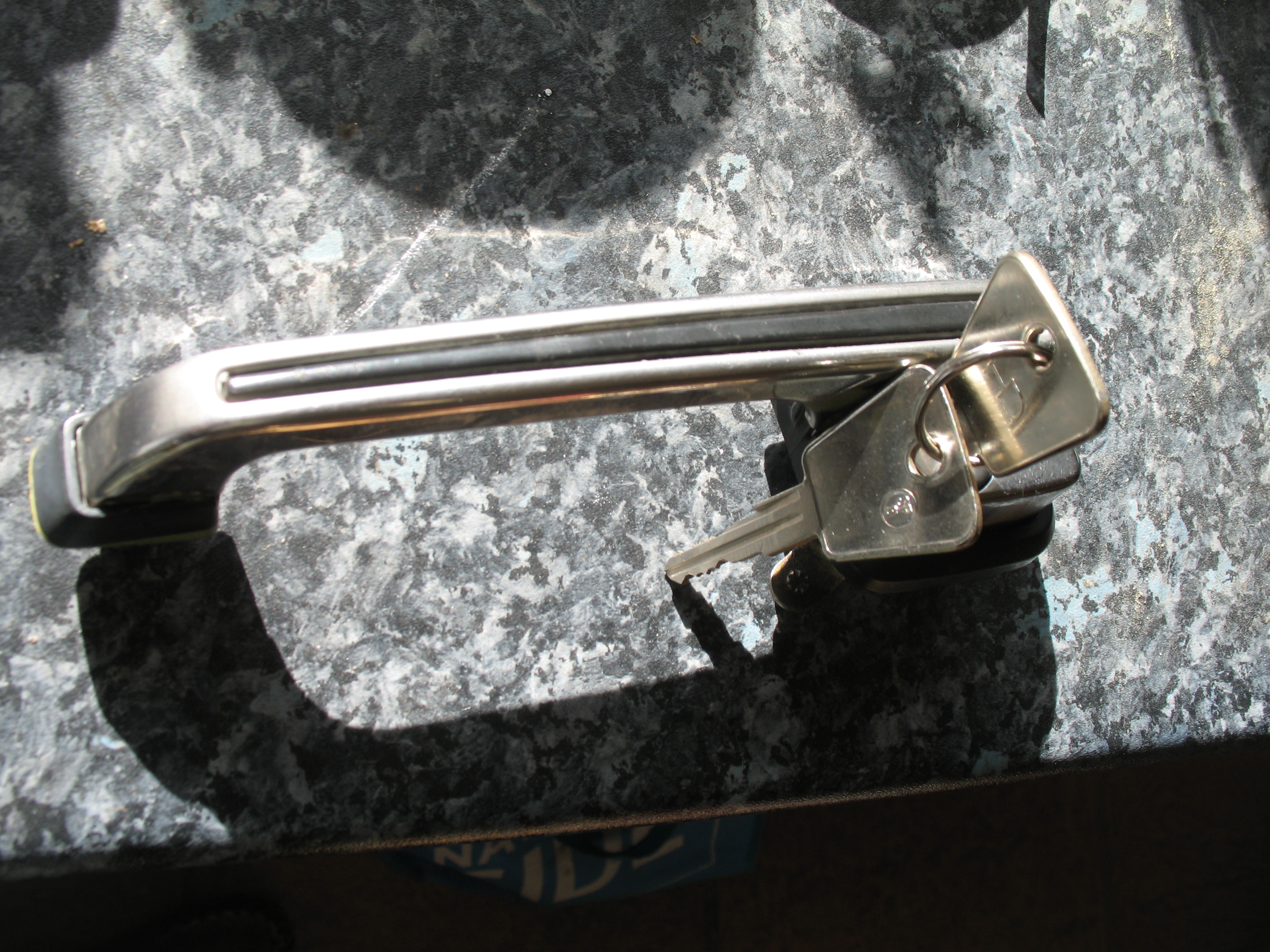

Did not get door keys to the Sud so one of this years tasks was to find some.
Took door handle off, initially it turned the stud and not the nut, but having talked to John at Justsuds and being sure
of a replacement handle plus excellent advice yet again I went ahead.
Took it to Malvern to Elite Service Centre 01684 561100. Did detective work with Terry and it was an education.
Now got door keys, plus one for my C3, and the all for £100.

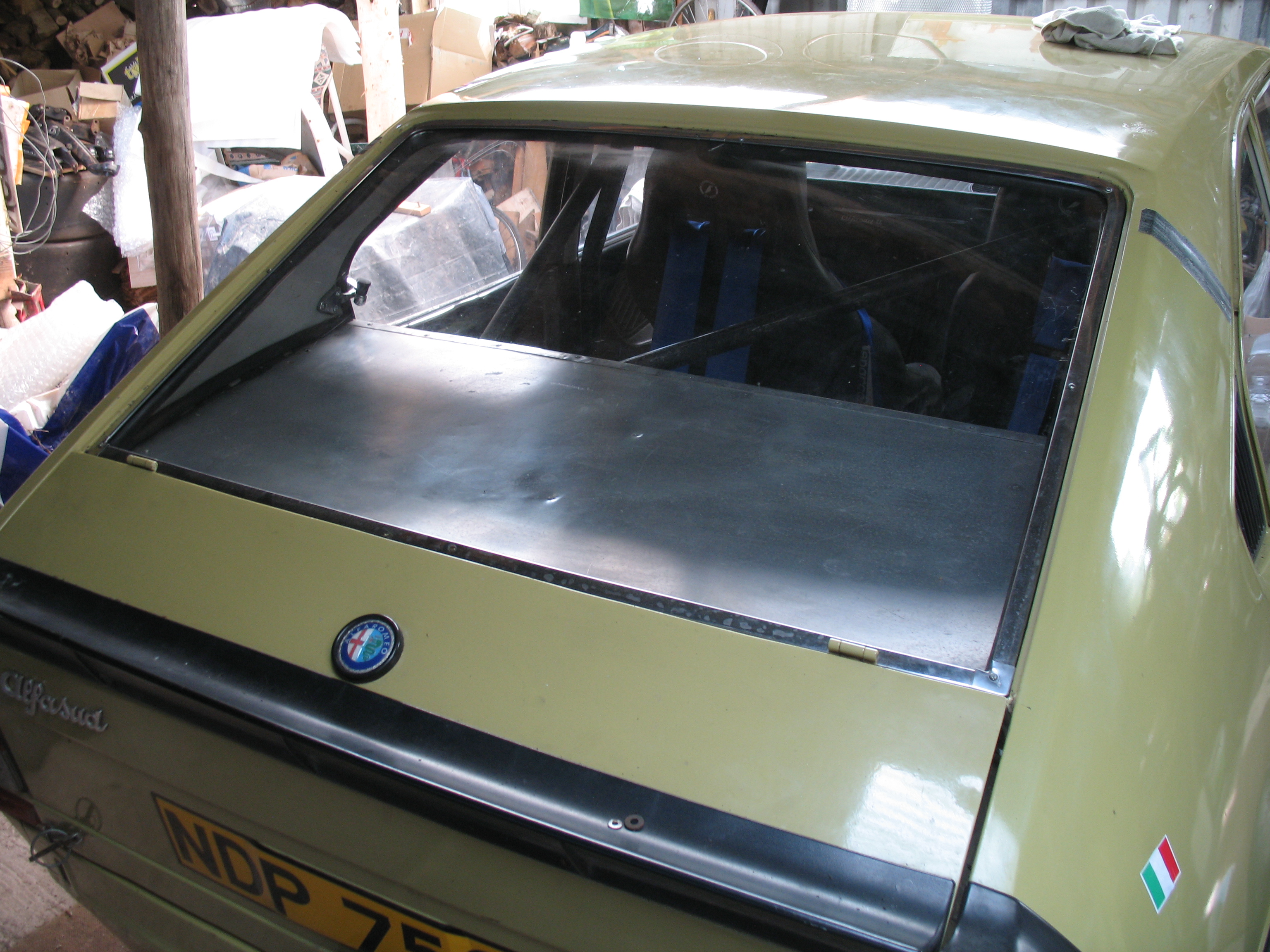

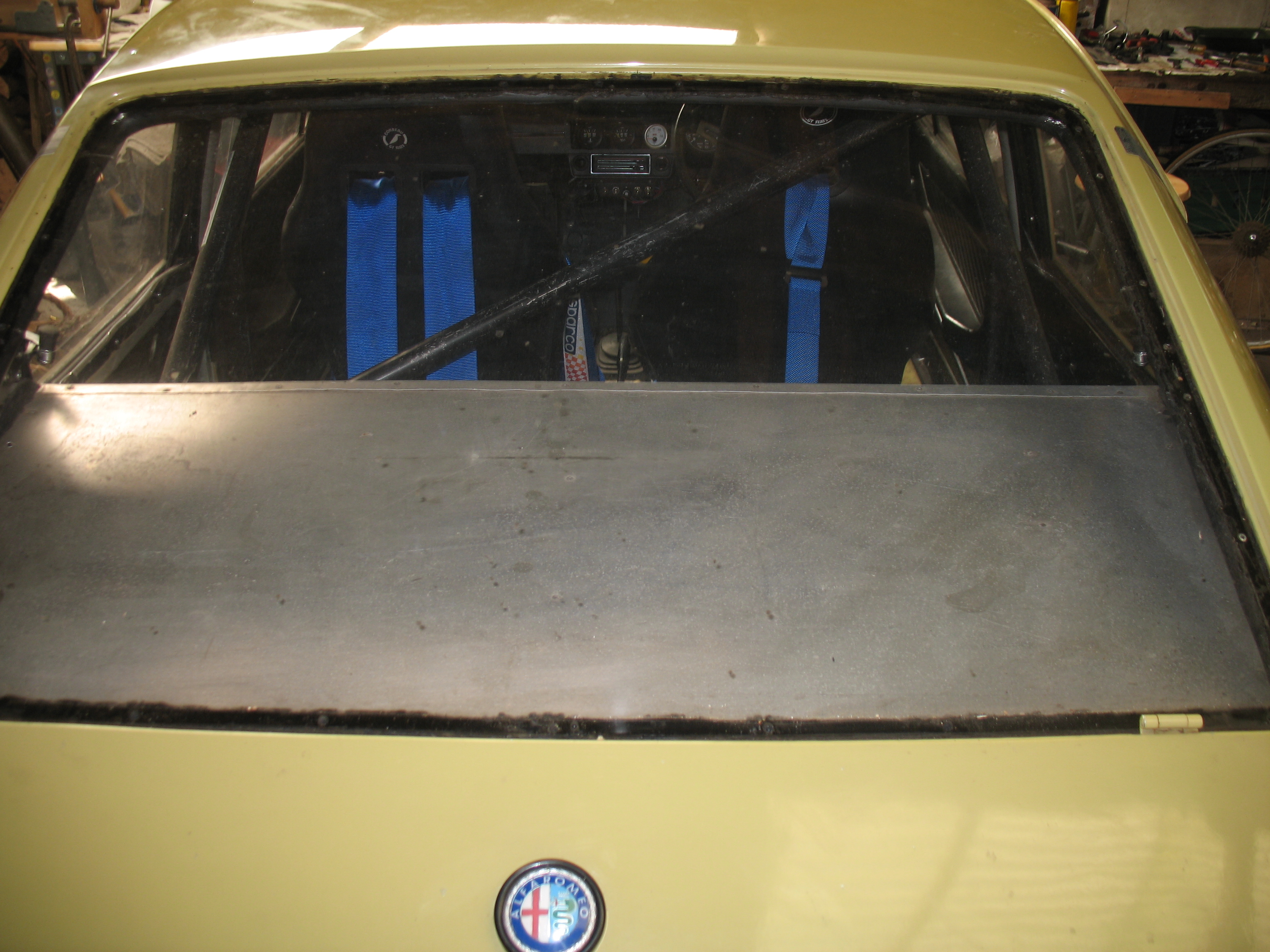

This perspex rear window has been annoying me for some time, but always had more important jobs to do.
Also wanted a warm day so the old silicon would scrape off with out taking the paint off. Monday was perfect.
Took a while and had to use a lot of care as the perspex has a few cracks that I could easily see them
getting much bigger if I was not careful
Very pleased with the end result. Just hope its all well and no cracks will appear as the screw holes were all over the place and the screws varied greatly. Tried to keep each to its original place. but some would not return easily.
