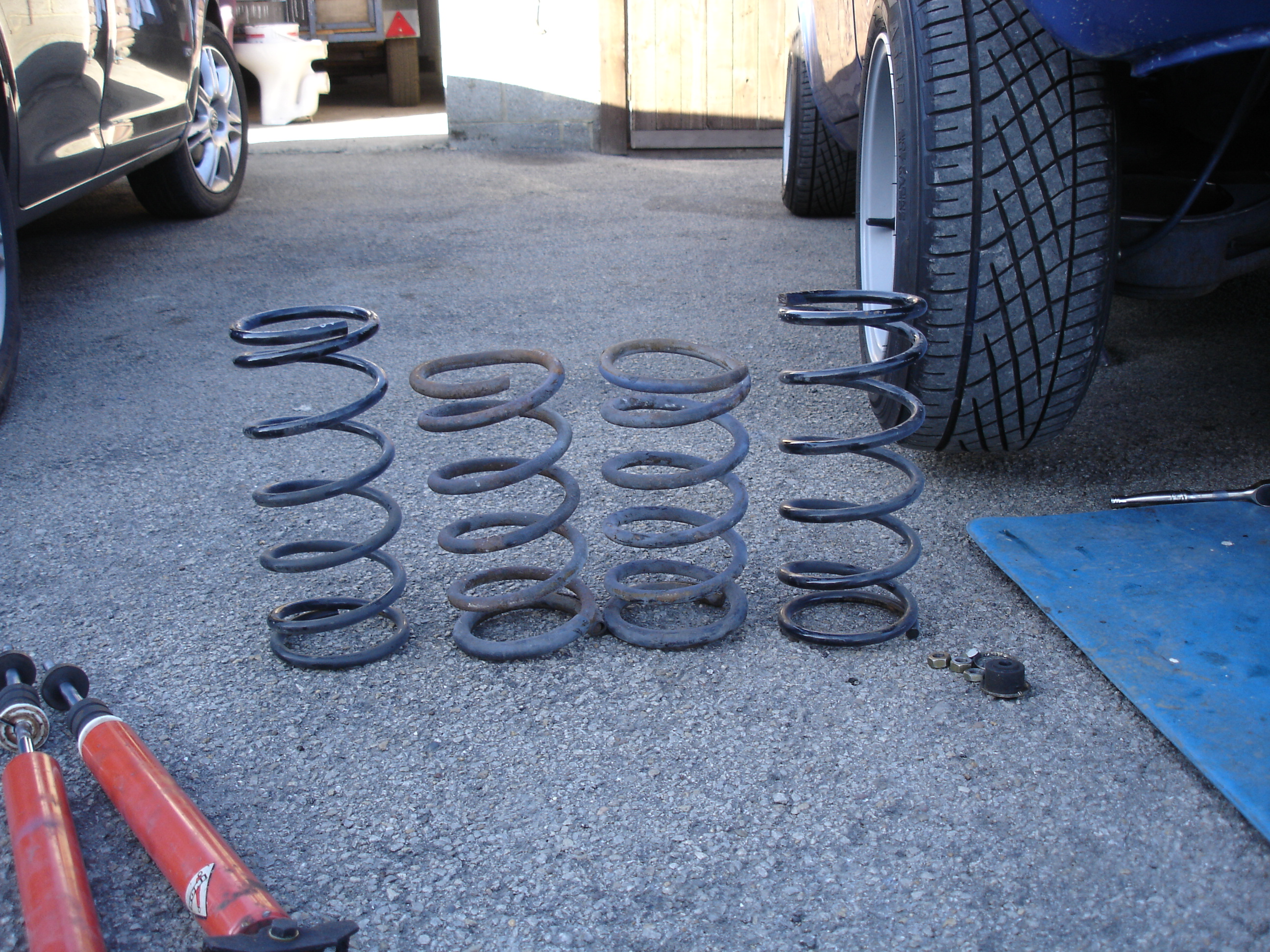

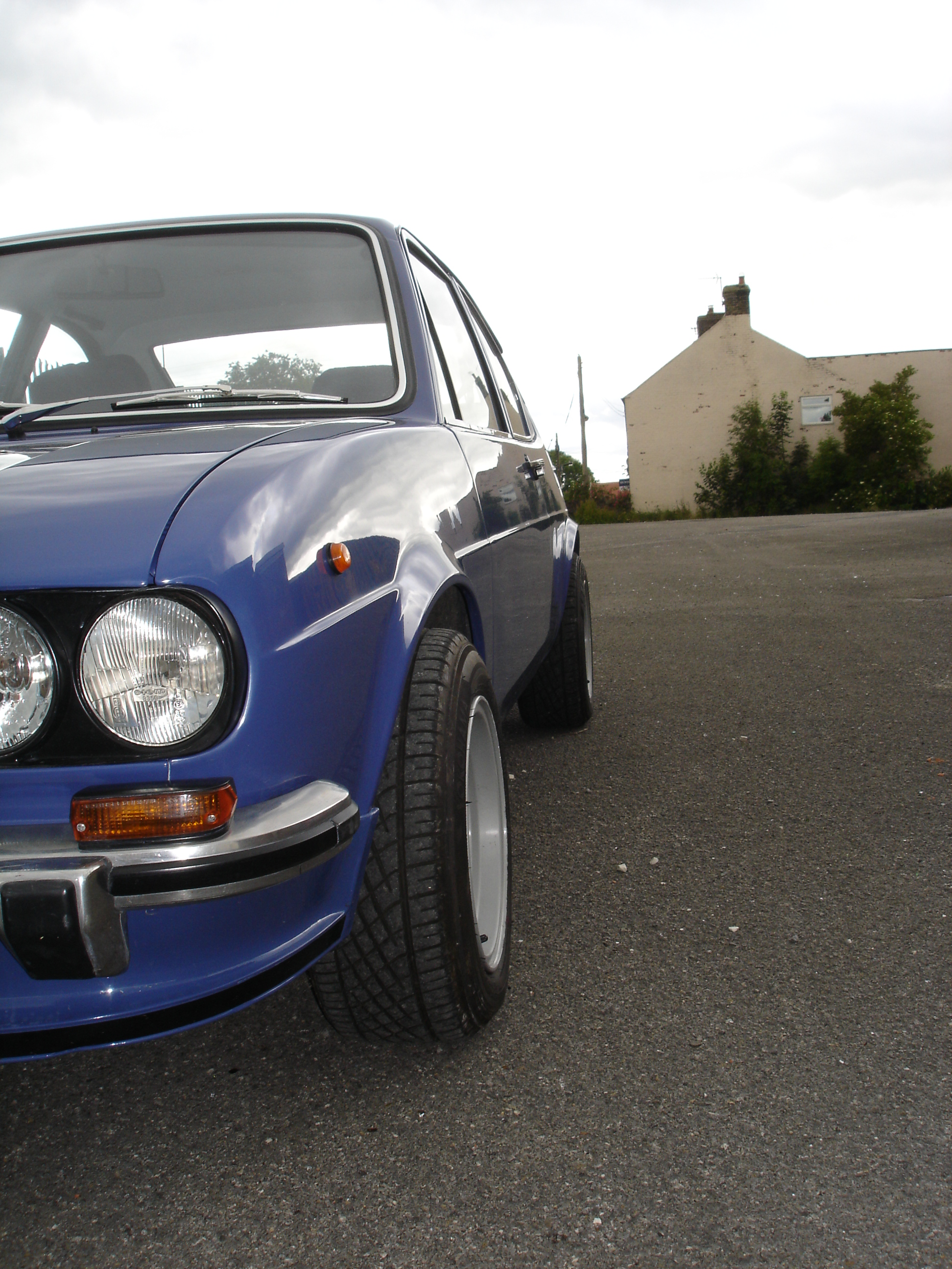

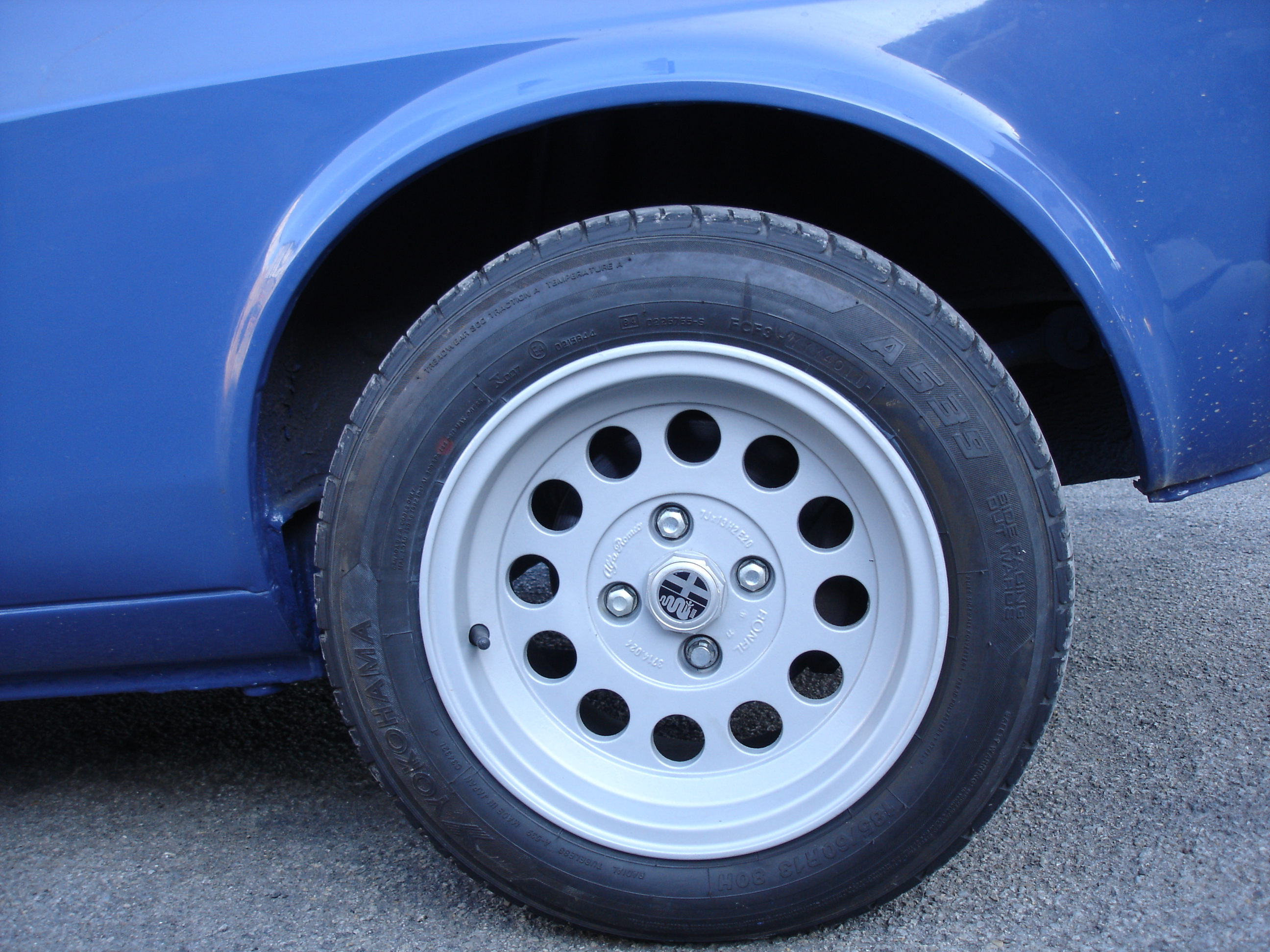

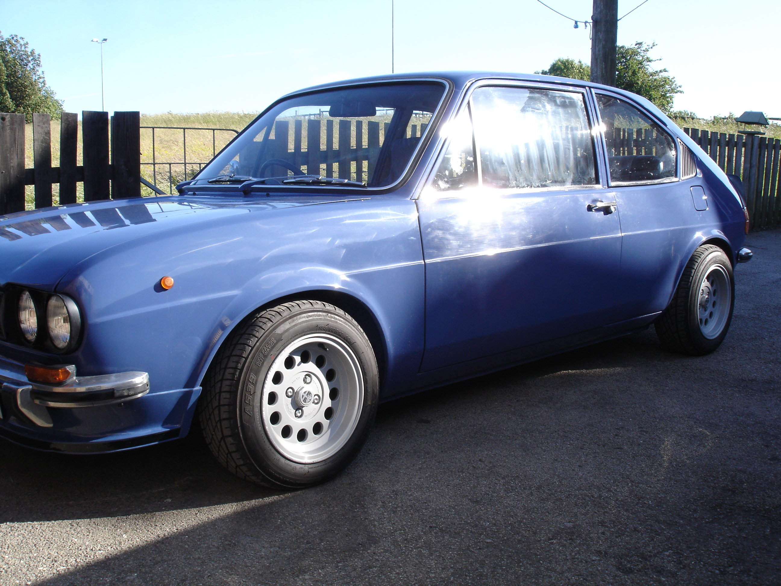

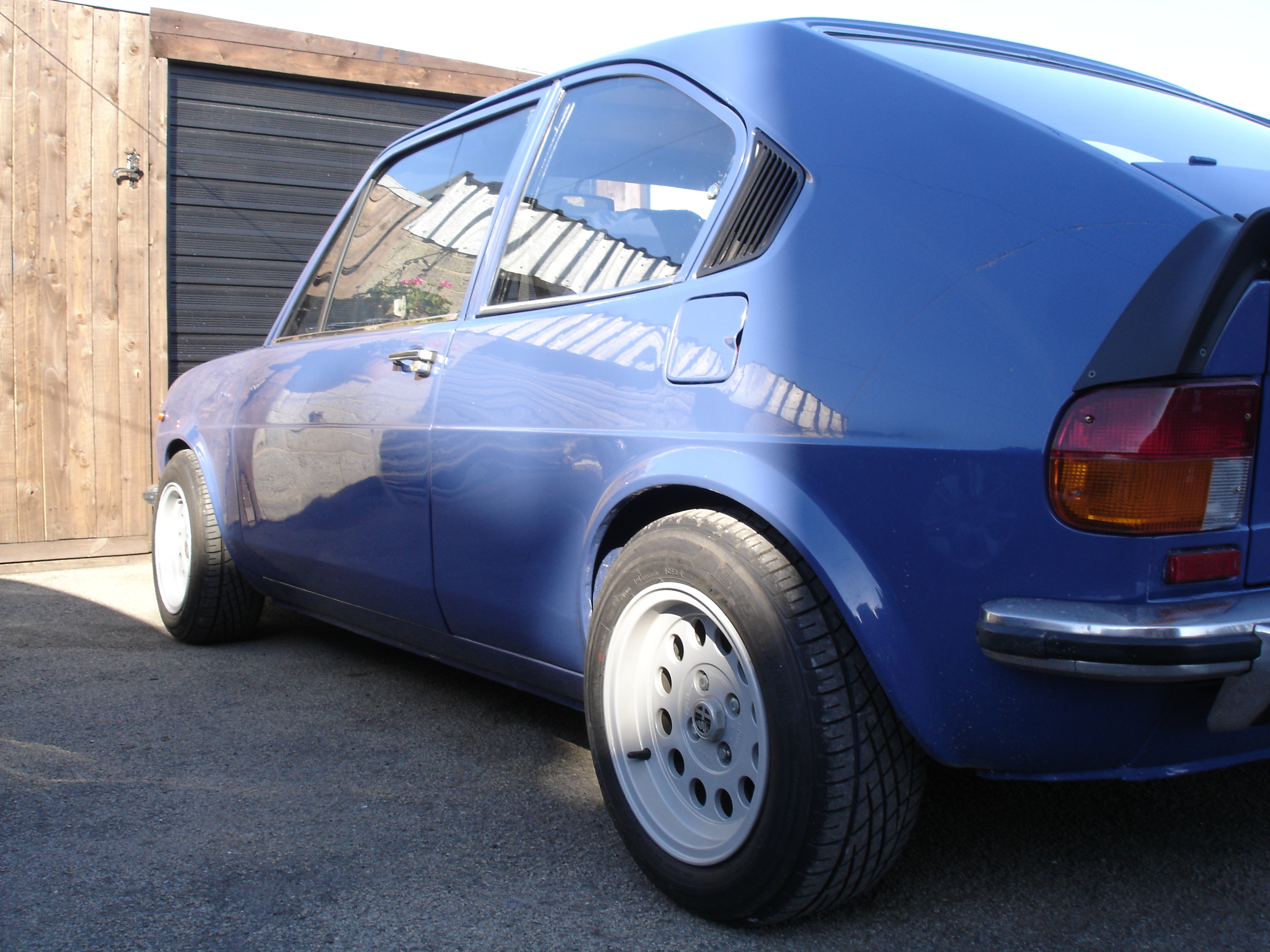

Spent some time putting the sud back together this week, took it for test this morning and with a bit of tweeking got it through ok :) Next thing i wanted to look at on the car was the suspension. Iv had a Justsuds lowering kit on it for 3 yrs and always thought it was a bit high in the rear compared to the front (20mm difference). Lately iv been talking to john and Keith about his suspension, trying to find a solution! Then i went and found some lower rear springs stashed away in the back of the garage. I tried them on the car and today i got to try them out on a good run. Iv found that although the car sits level now, it looks way too low for road use and the rear tyres catch the arches on bumps! To be honest these 13/7 wheels seem a little too wide, theyr always going to be prone to catching. So tonight iv put the Justsuds rear springs back in and now i need to make the front 20mm higher to level the car out. I think fitting alfa33 front spring pans will raise it 10mm and then maybe making some kind of 10mm spacer to go between those and the bearing!
Anyone got and ideas as to what else might work?
First photos are of it with the lower rear springs along with justsuds front (level but really low), then later with the justsud kit all round, you can see the difference front to back!!

Yeah Keith my suspension looks like that, theyr just the standard sud stuff, the alfa 33 spring pans are the shallower type you mention. Along with alfasud springs they help lift the front up as most modern lowering springs are based on the 33 set up, i.e. the front springs are lower. This certainly seems to be the case with the Justsud springs although they are orientated correctly unlike all other lowering springs iv tried over the years! Normally you have to rotate the upper spring pan by quater of a turn to fit lowering springs to a sud..

After talking with John from justsuds today I think the best option is to try putting a 20mm spacer between the pan and bearing to lift the front up level with the rear on my car Keith. I'm not sure you'd get a 60mm drop from switching from sud to 33 springs, not in the rear anyhow, im not sure but i don't think there's that much difference. Be interesting to see a set of 33springs up against sud ones for comparison!

what about trying a pair of thses col on the rear, space out the top coil. should gain you 10 to 20mm i'd have thought?

Kev iv got a set of those rubber spring dampers in the garage, i tried them on a sud years ago that was catching. Didn't do anything to be honest mate :(
Thanks fruitbat its a good idea but id like to find a cheaper option first if possible!
I wonder how a standard set of front 33 springs would work out if they give anyway near the 60mm drop Keiths talking about?
