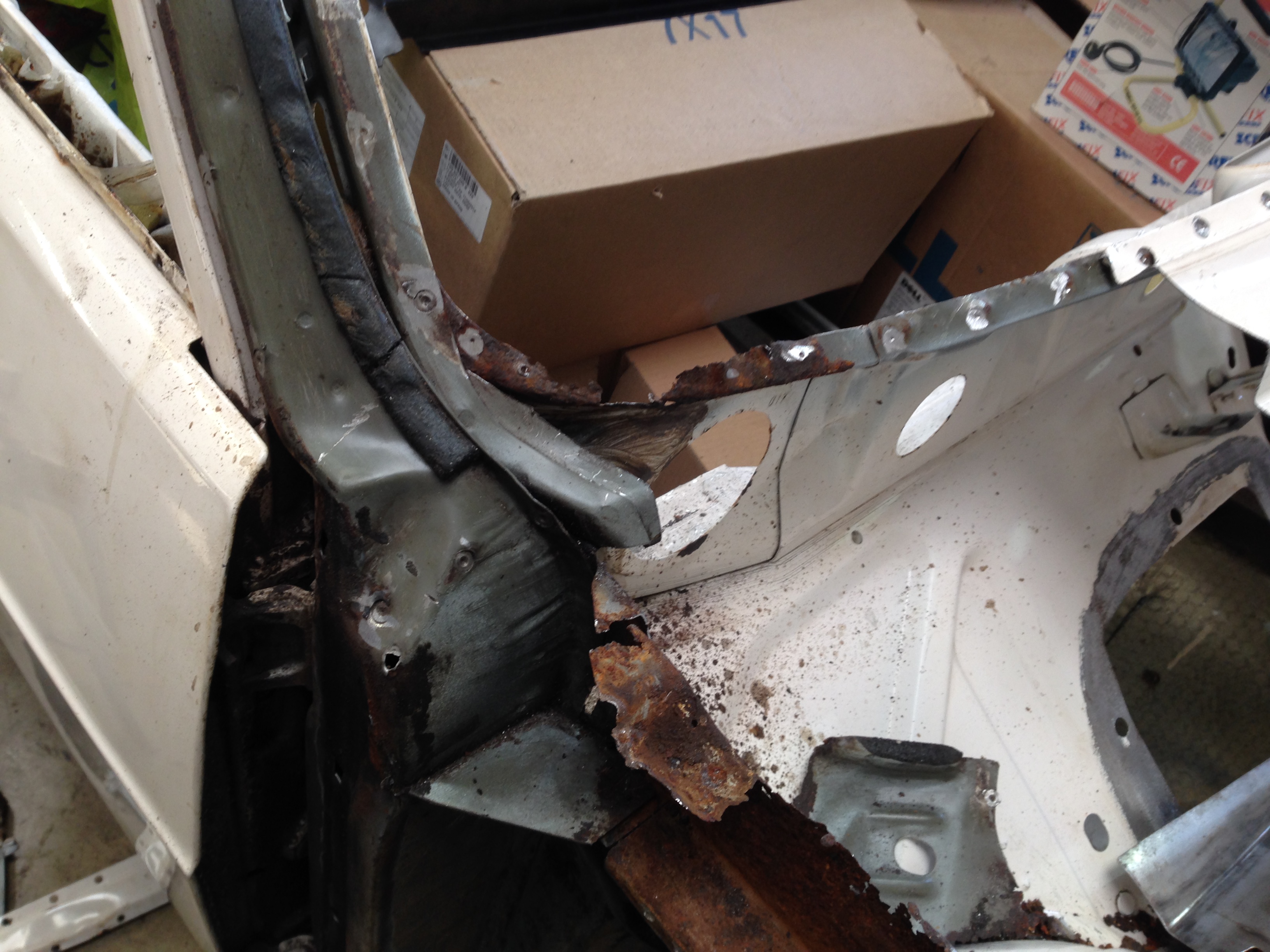

Lost of work done last week - the body repairs have started to get serious now !!
First jobs were to straighten up the front panel and sort out the wing rails
As you can see in the first picture the windscreen frame has also been cut off - small section to make on the drivers side but the passengers side is fine (see the last picture)
All the boxed in panels have been painted with zinc and the bits that will be body colour painted with acid etch for now

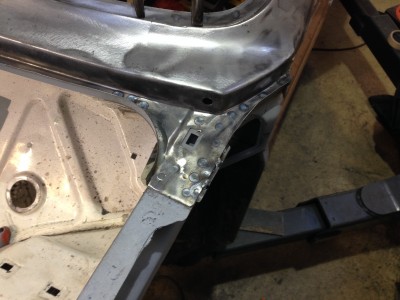

The passenger side wing rail was in good shape when openened up so no need to repalce it - just cleaned it up and zinc painted in the box section
New outer wing rail boxed panel used as I had one and also used new panel for the end where it meets the door pillar

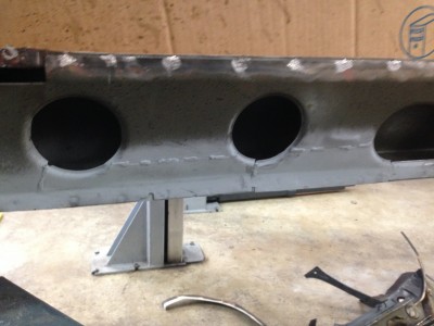

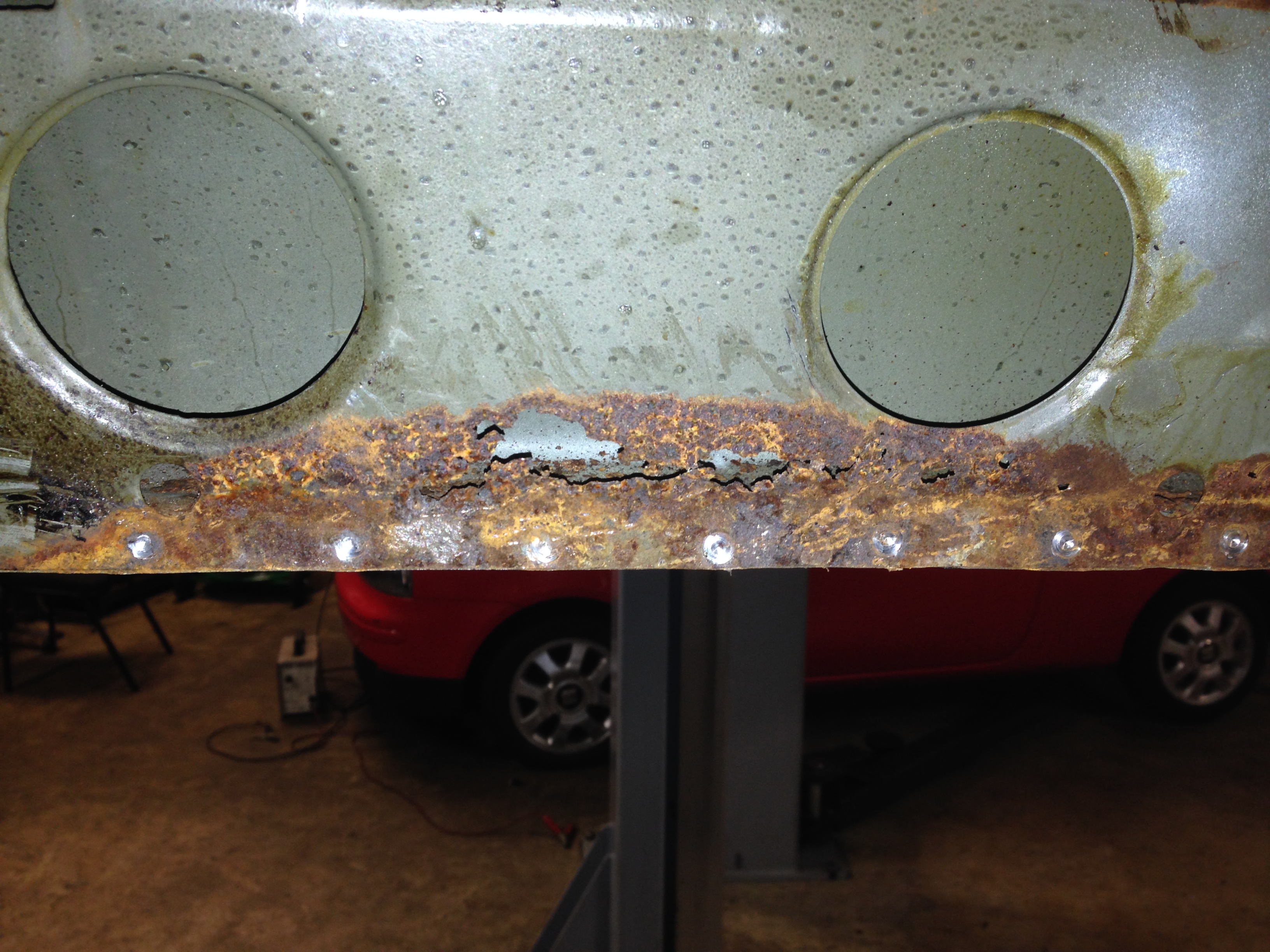

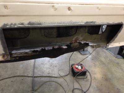

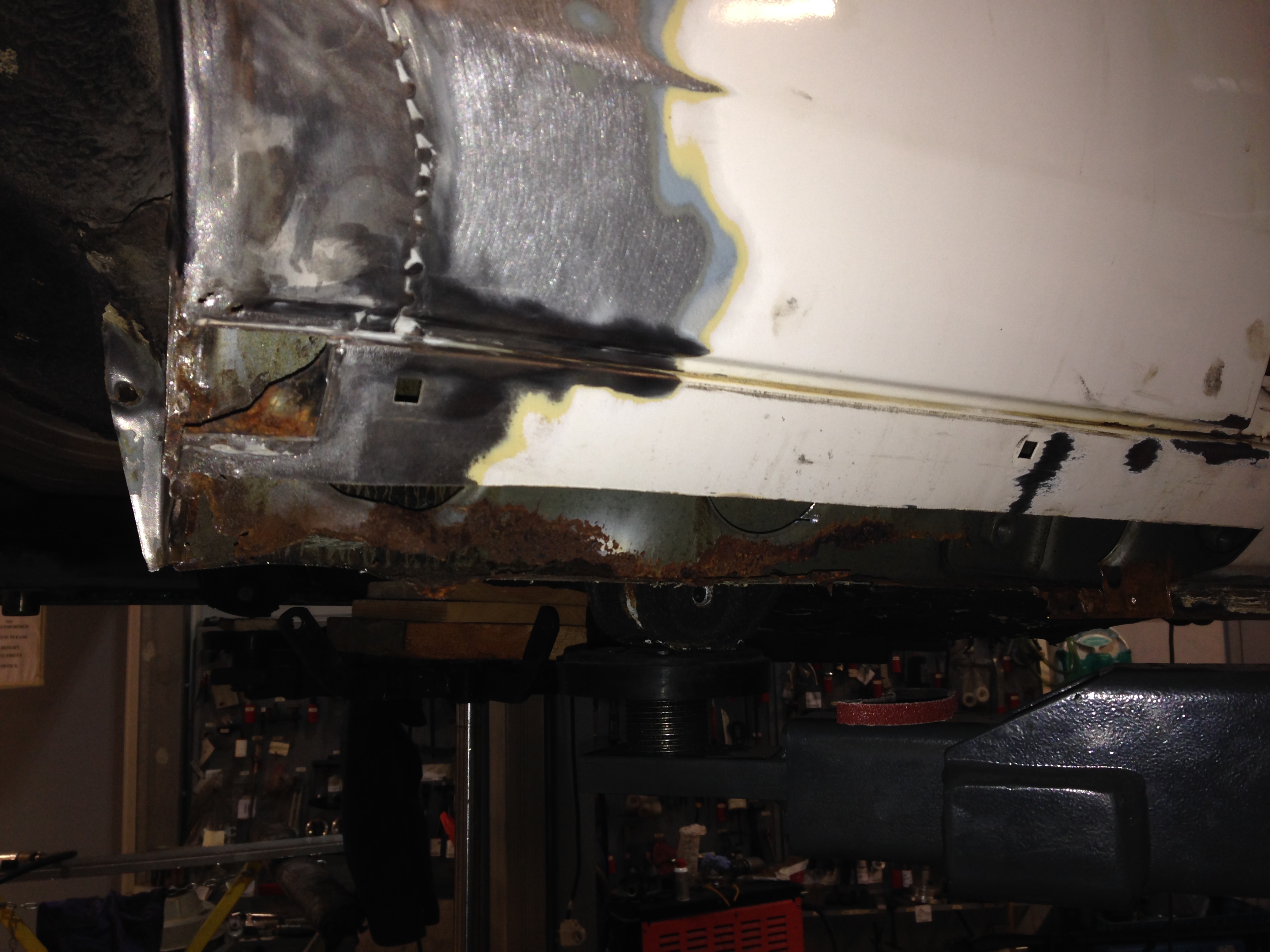

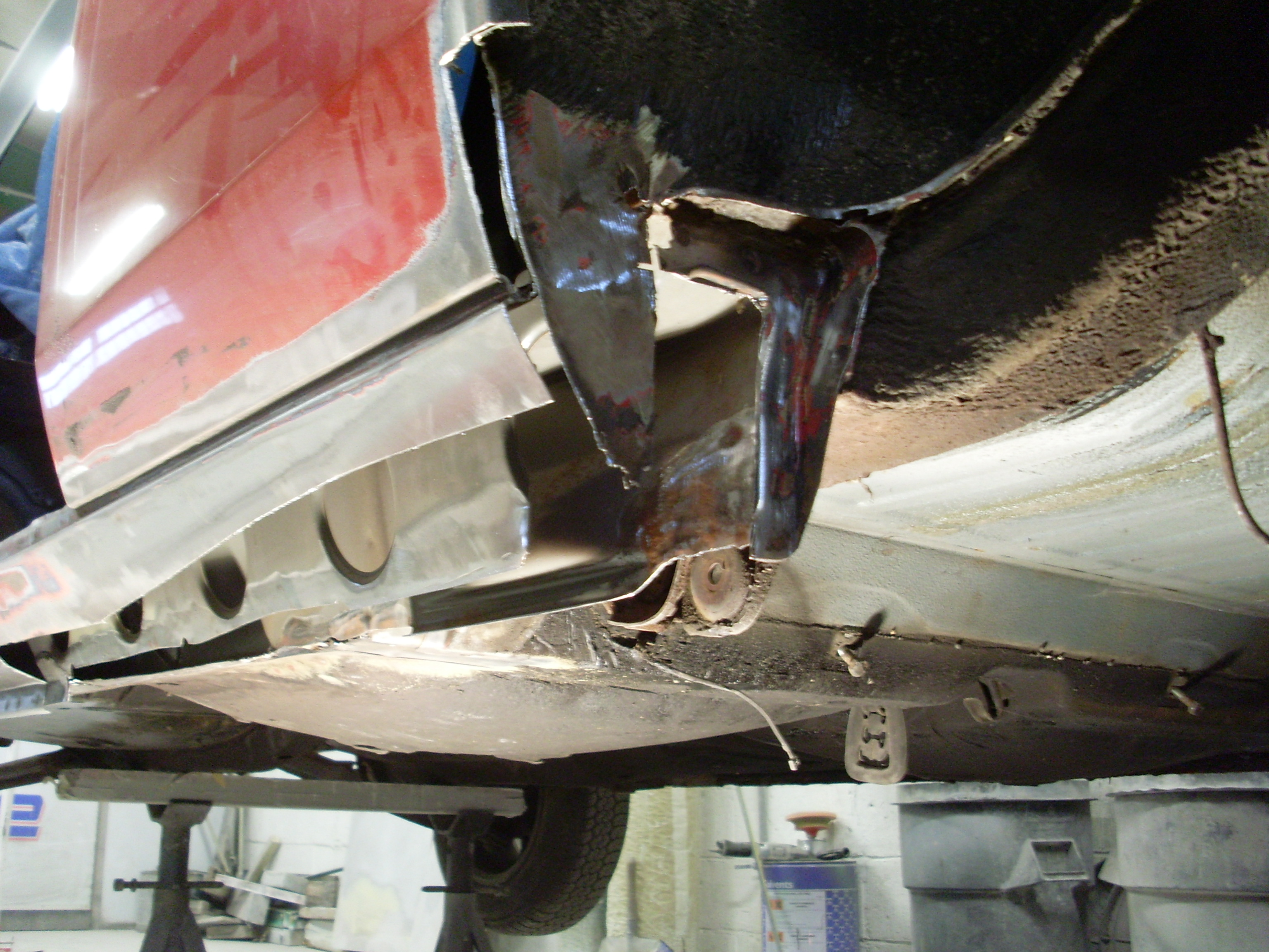

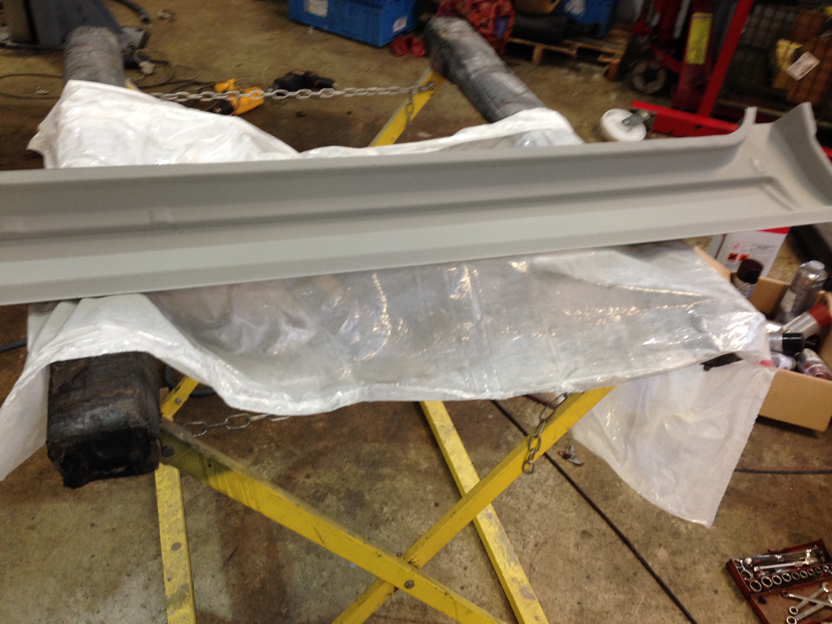

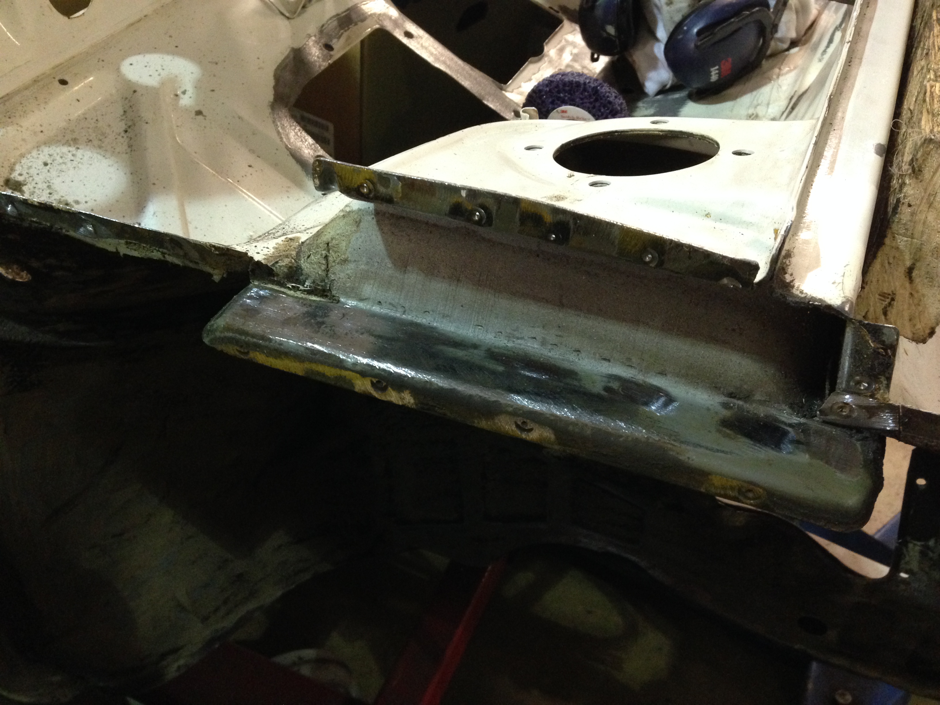

Moving on to the passenger side sill repairs now
Again was lucky enough to have some new parts to work with - had a complete inner sill and a very well made pattern outer sill + a bit of recycled centre membrane cut off of another car
Old bits cut out and the new bits put in
Your picture does look very similar Kegsti - but at leat yours is all done now ! I still have a way to go yet but is making good progress

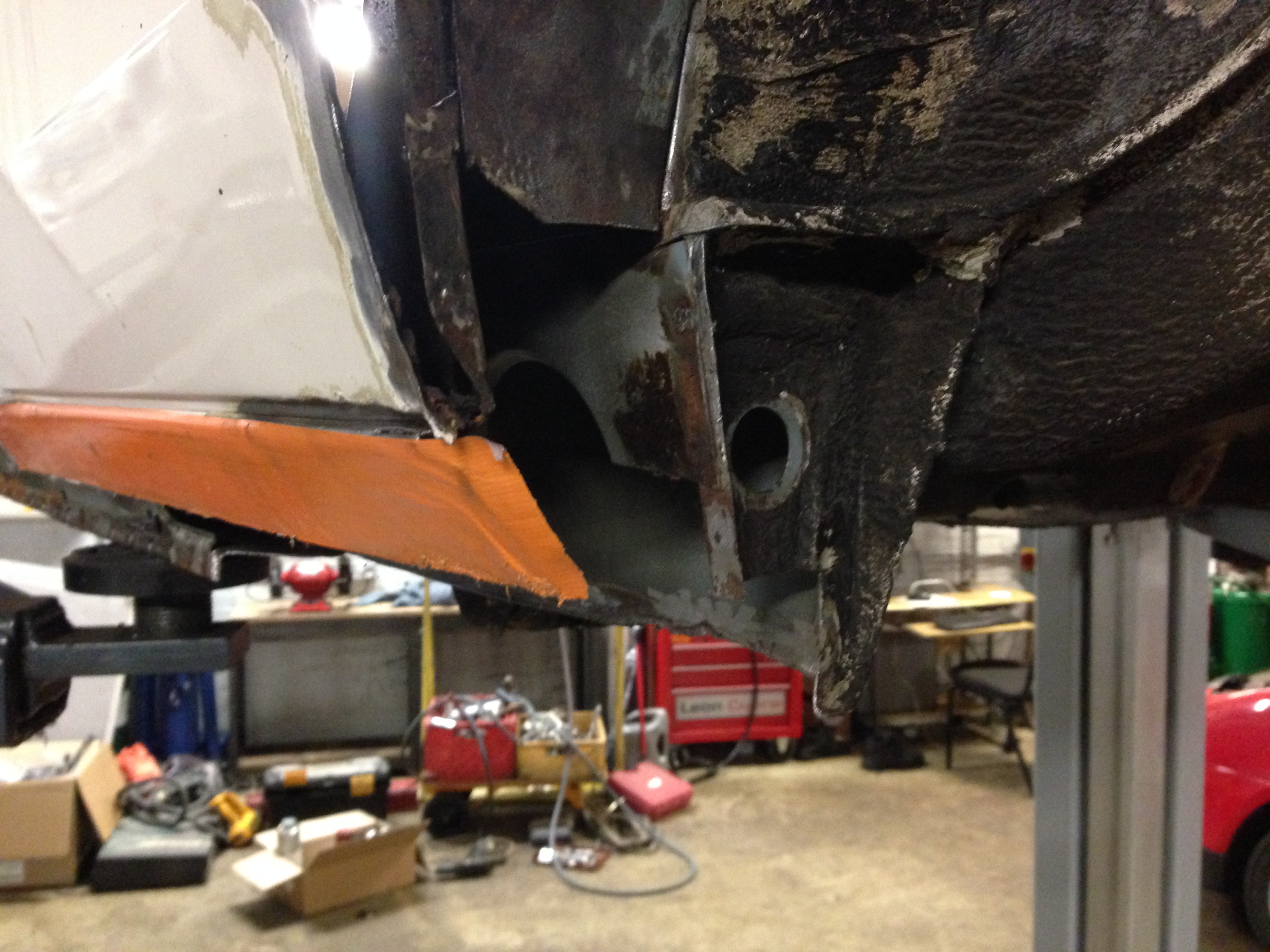

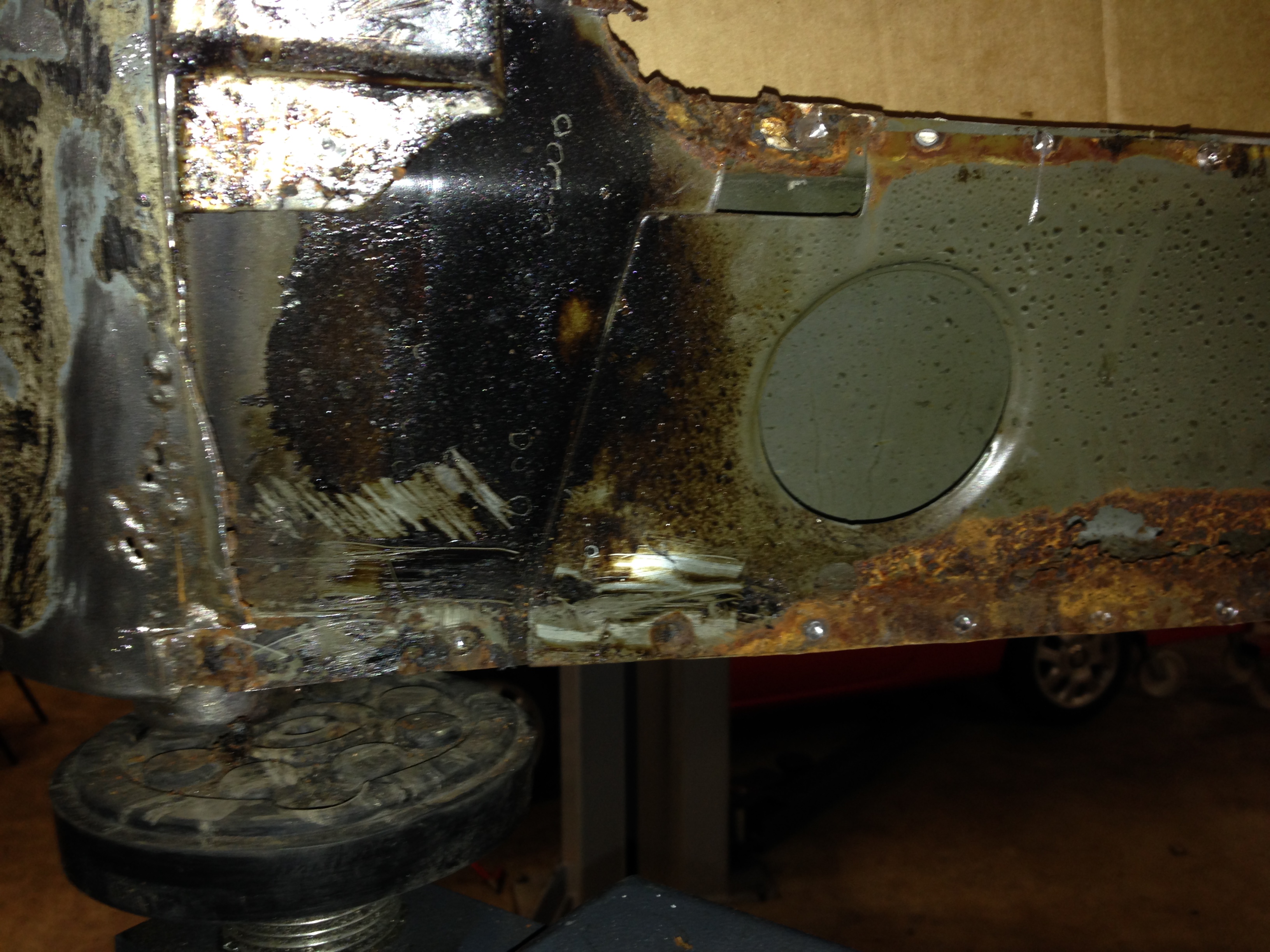

Last bit of the recycled membrane fitted at the front of the sill and then on to the rear wheelarch

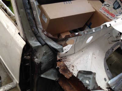

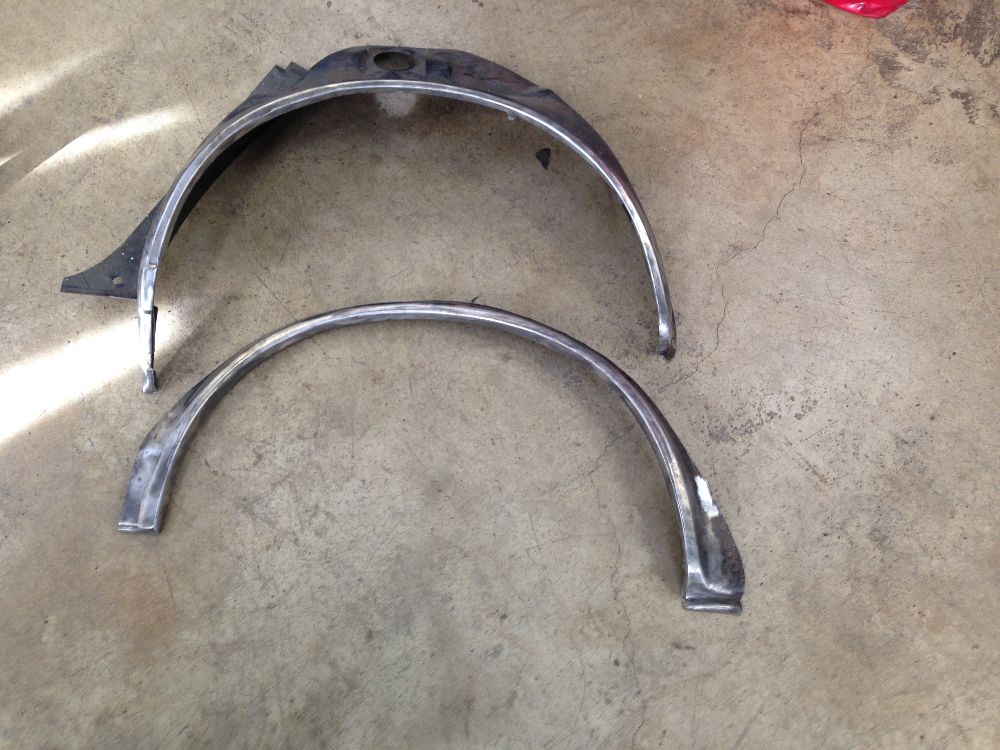

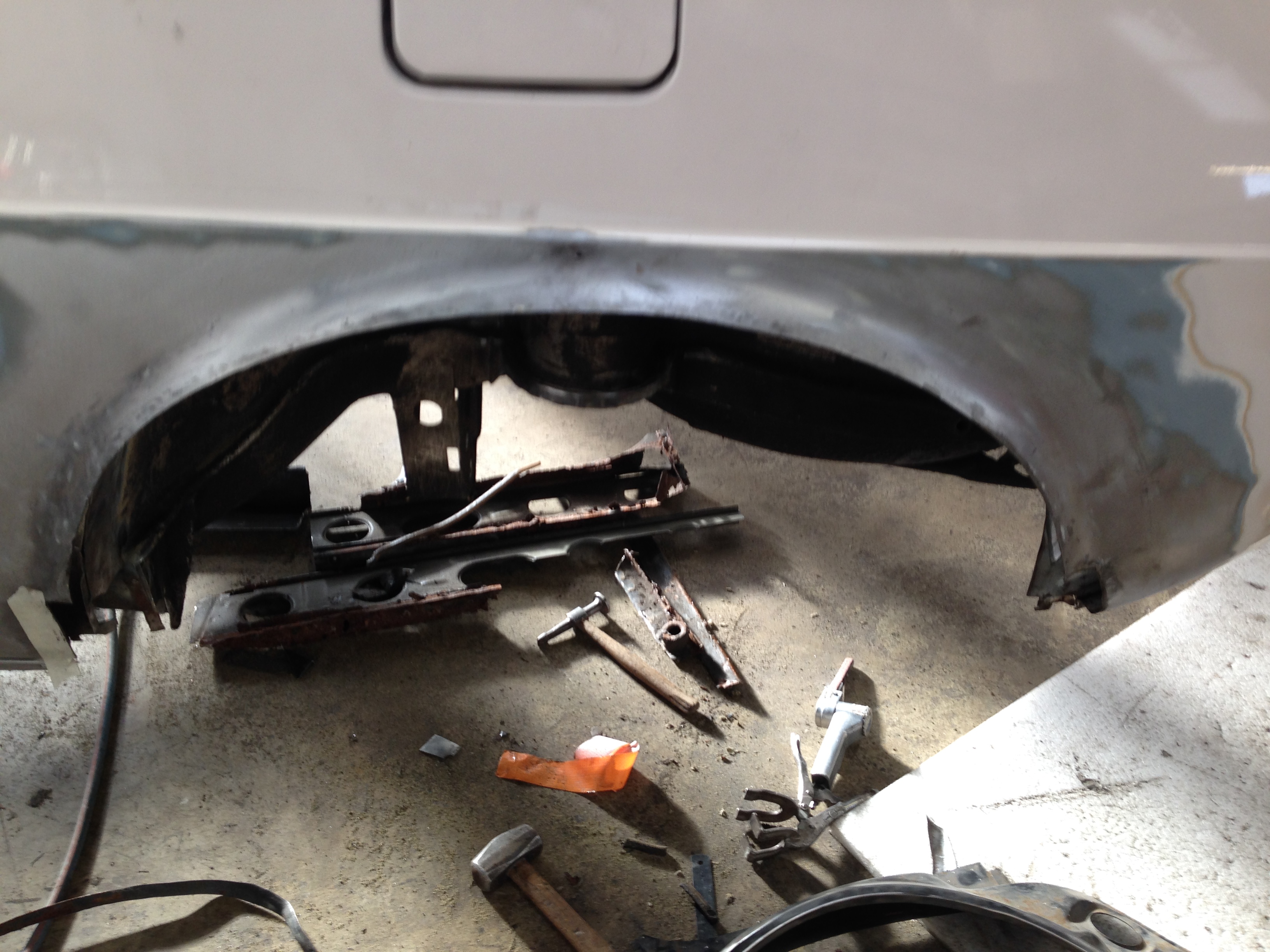

The car has been repaired here before having had a new wheelarch put on but there was no repair to the inner arch - just filled with some black "goo"
Shame really as the outer arch has been fitted quite neatly but the black "goo" had held the water in and started to corrode the new outer arch again
The inner and new outer wheelarch were cut off again and then a section taken from the new inner wheelarch panel first was fitted to get the correct shape back

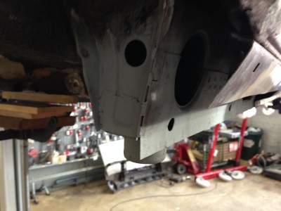

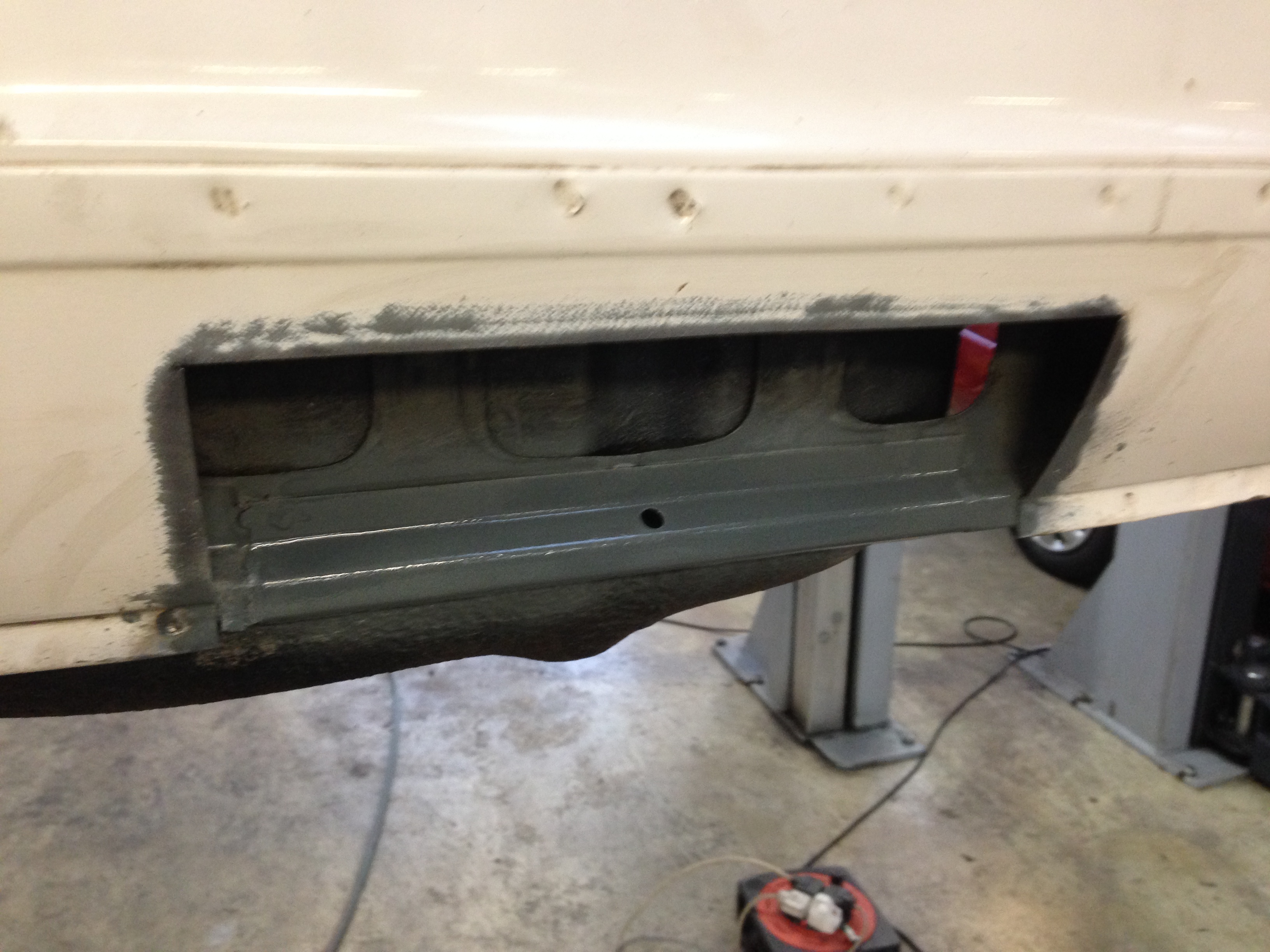

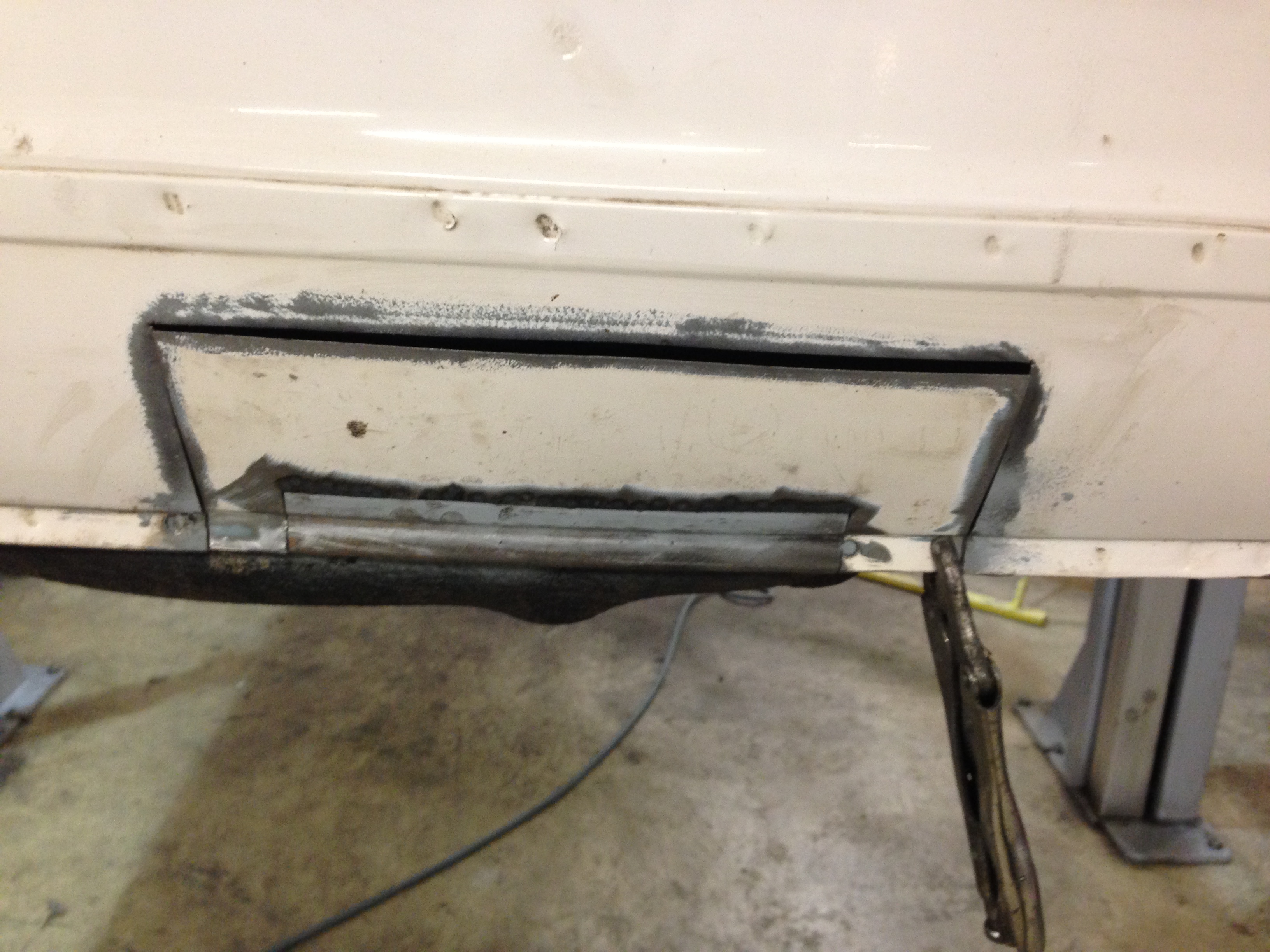

The rear wheelarch repair is not quite done yet but a repair to the lower rear panel was next (the wheelarch will need the new outer repair panel as well as the new inner panel)
A section cut out to access the inner panel behind it
Then the inner panel repaired and painted with zinc
Then a small section out the removed out panel was repaired
Then all welded back on and ground back the welds
Then the removed panel was fitted back on again with the new bit of metal at the bottom of it
So that is another bit fininshed - 1 week left if the 3 week target for the panel work is going to be kept

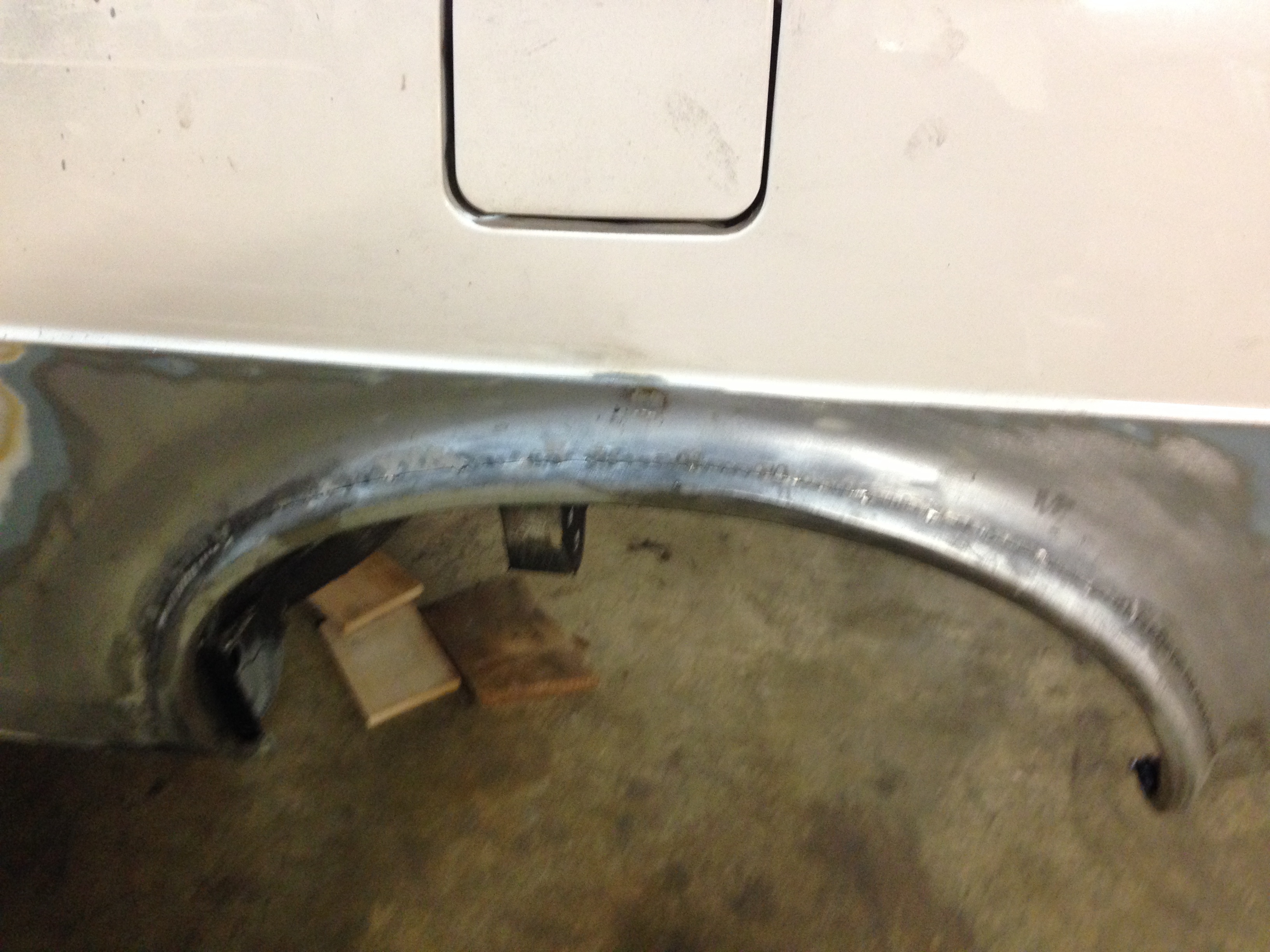

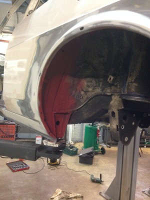

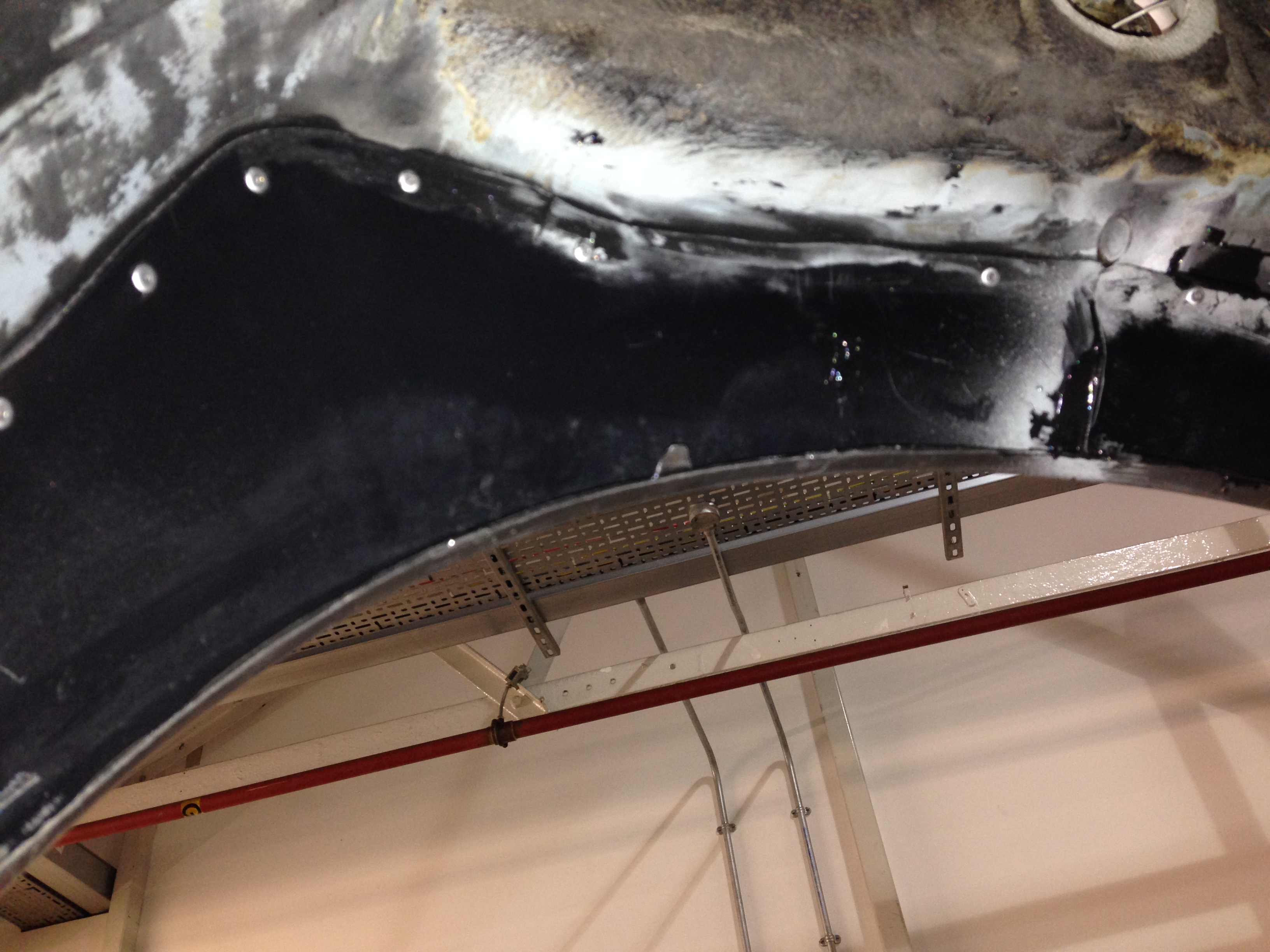

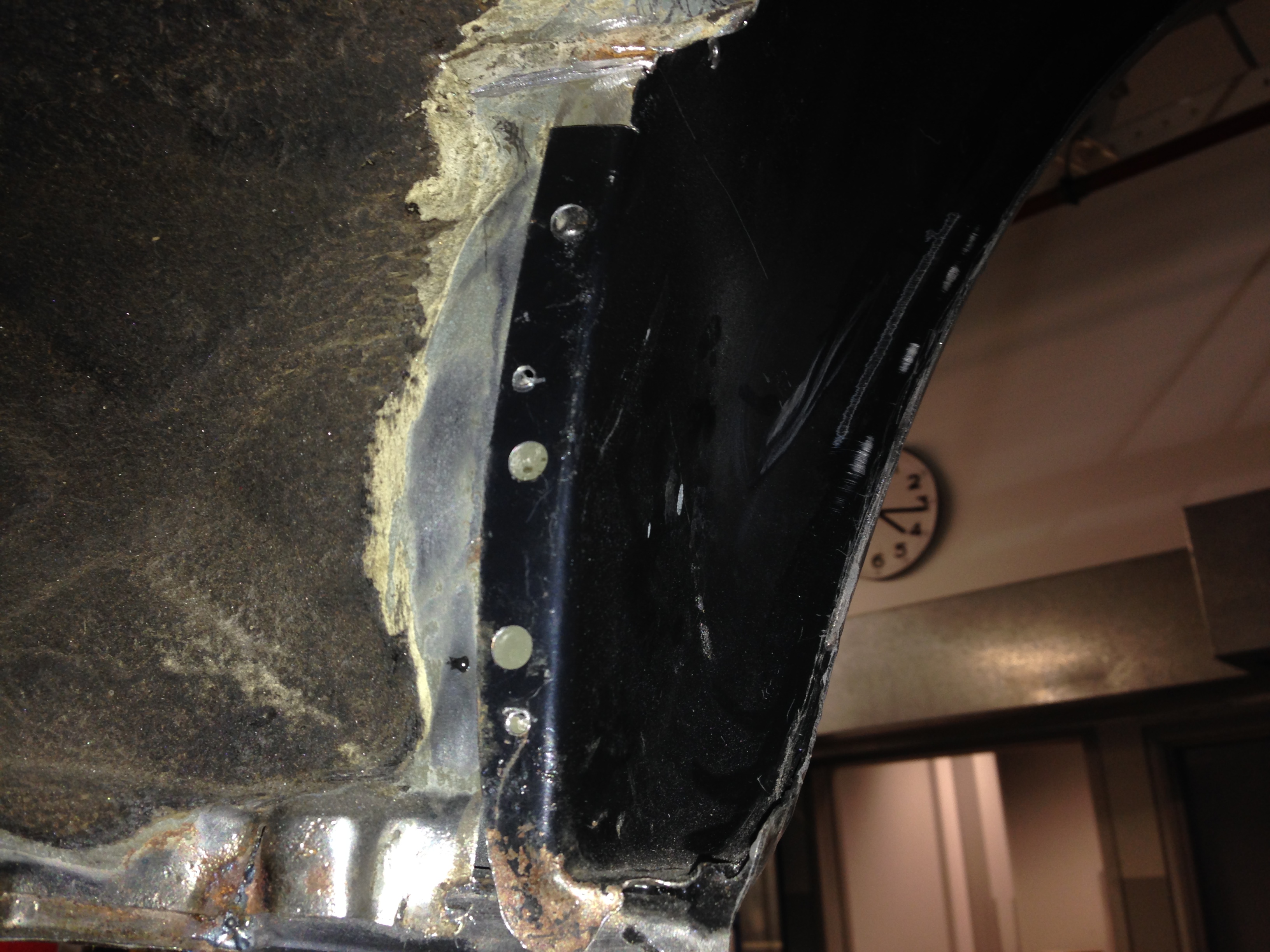

Left rear wheelarch and sill are now all done
The new outer arch repair panel was fitted under the lip of the rear wing and then tack welded all round on the outside
Then the inside of the area was all painted with zinc etc. before the new inner arch was fitted
This was fitted in 2 sections using a mixture of welding and 3M panelbond adhesive
The idea of the panelbond is to fully seal the lip where the inner and outer arches meet together to stop any air gaps etc. that you will get with spot welding and there is no heat to burn off the paint inside so hopefully with a good wax up after final painting this should help to stop the corrosion starting again
The rear of the sill was then closed off as well
The area under the wheelarch will be etch primed followed by anti corrosion primer,paint and then stoneguard and again when it returns from painting the outside of the car will be coated in black wax
In the last picture you can see the little triange bit of metal that is part of the inner arch to hold the plastic drain pipe from the fuel filler flap - these are usually long gone from corrosion !!

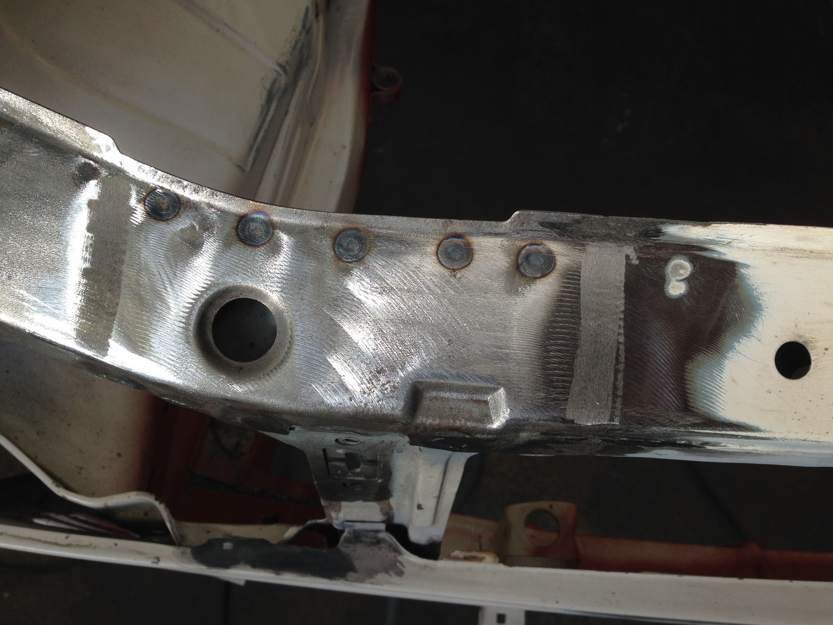

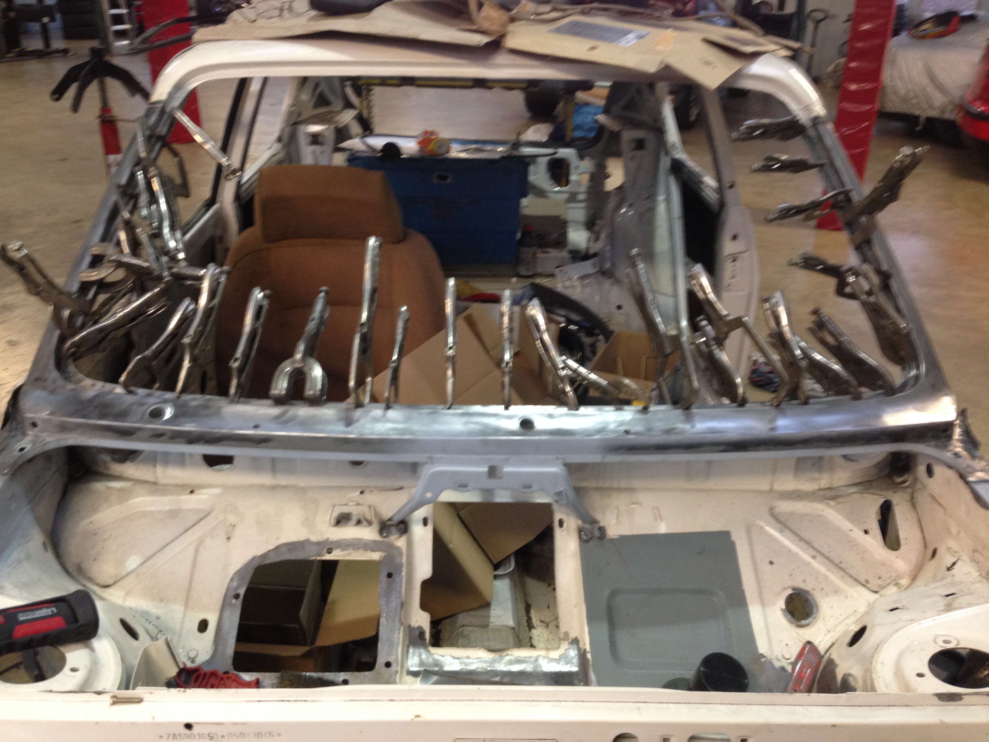

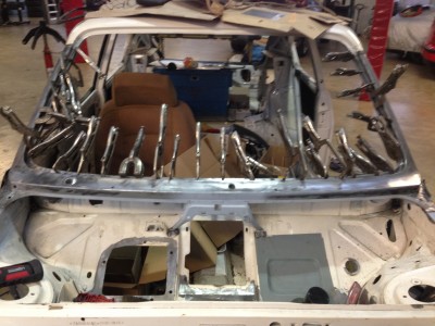

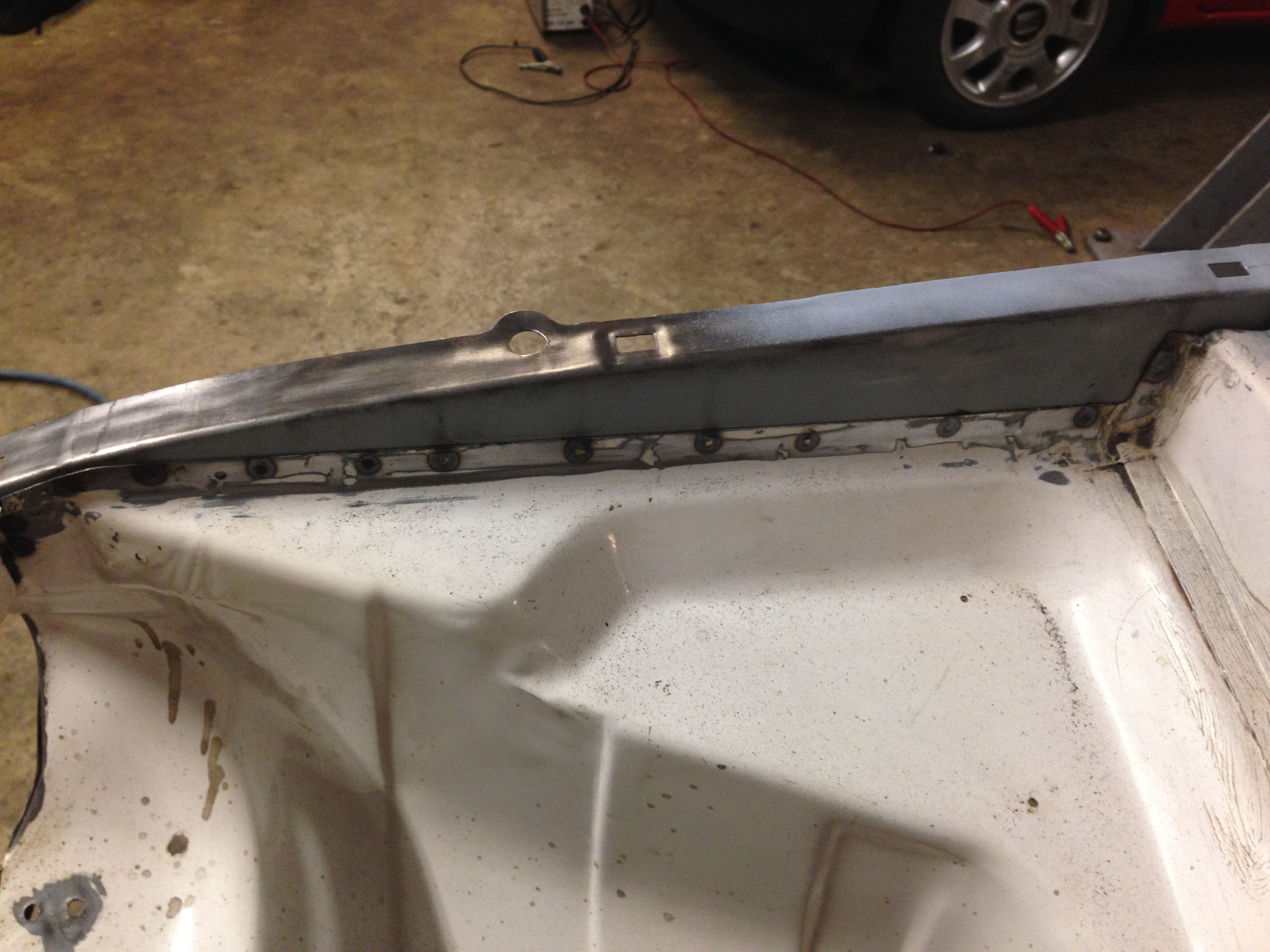

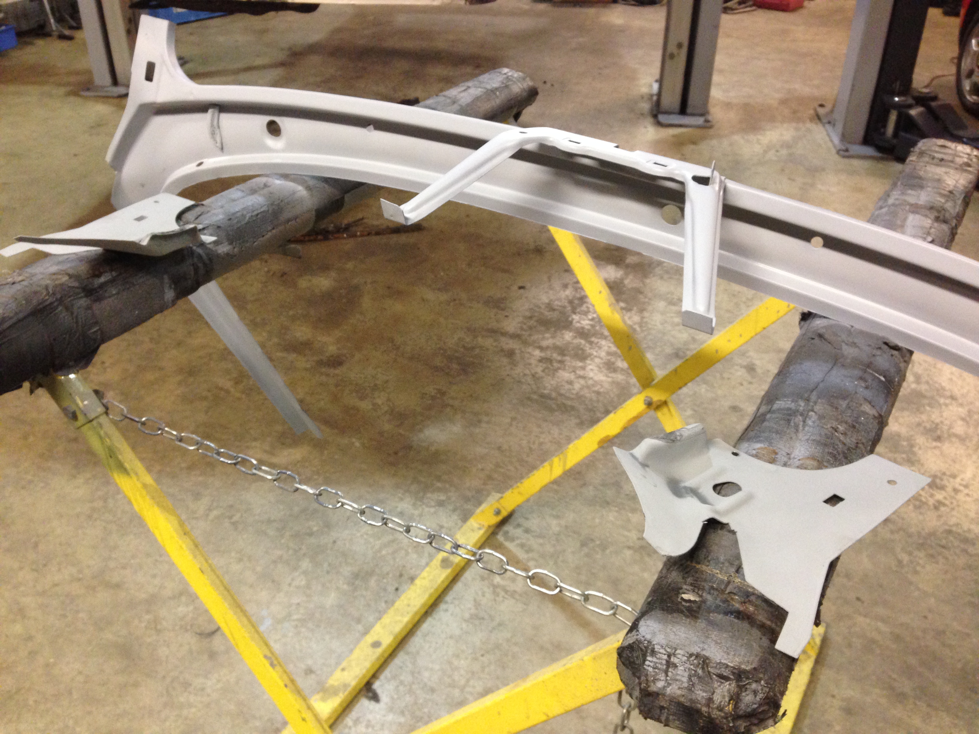

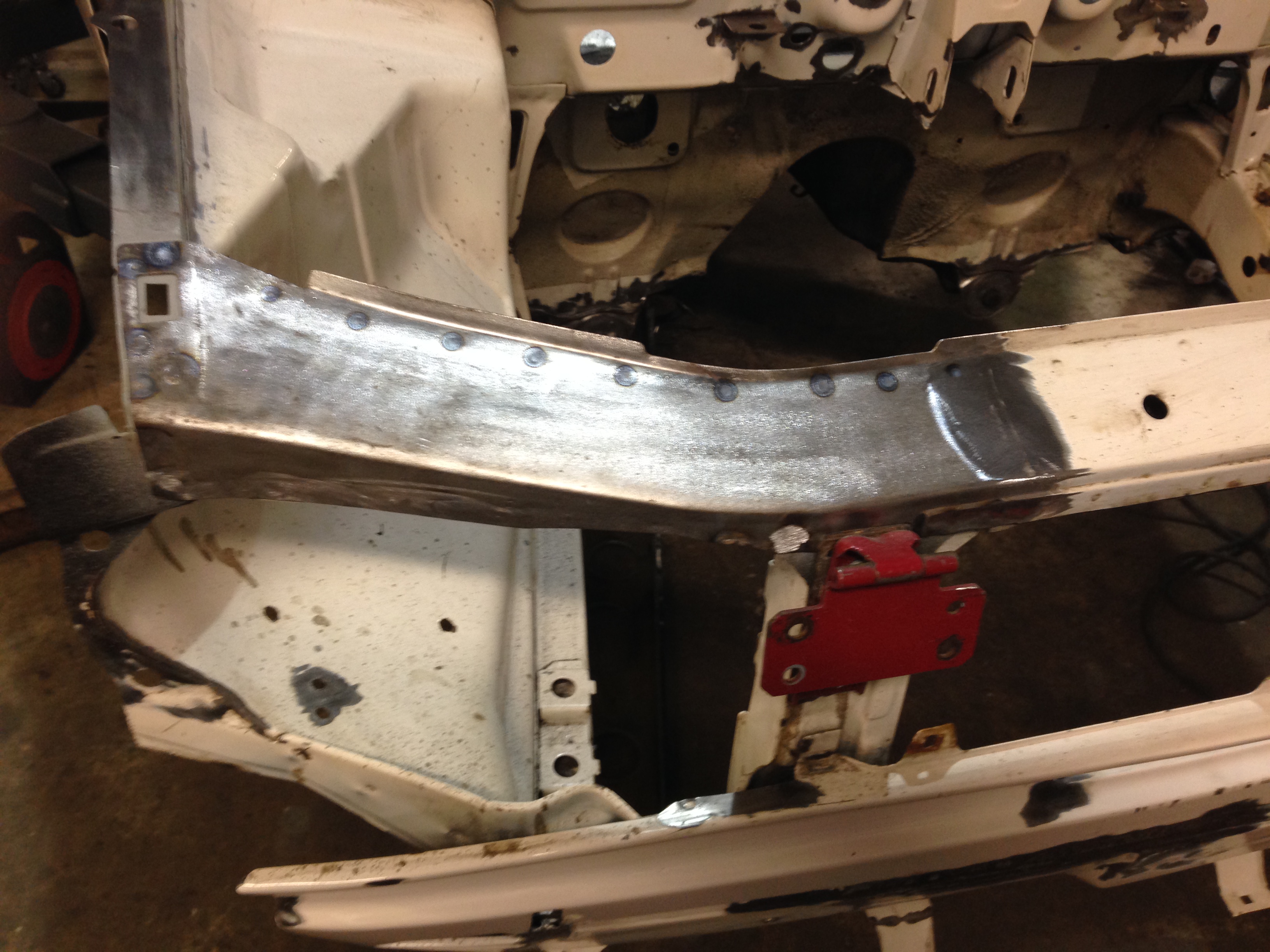

Next job was to fit the new windscreen frame - again with a mix of the 3M panelbond and spot welding
Just a few pairs of mole grips while the panelbond cures !!
Then the front panel was finished off - trial fitted the bonnet to check the gap to the screen frame (forgot to take a picture but it has a nice even gap)
Only fitted a small section of the upper front panel in the end as it all came back into shape very well

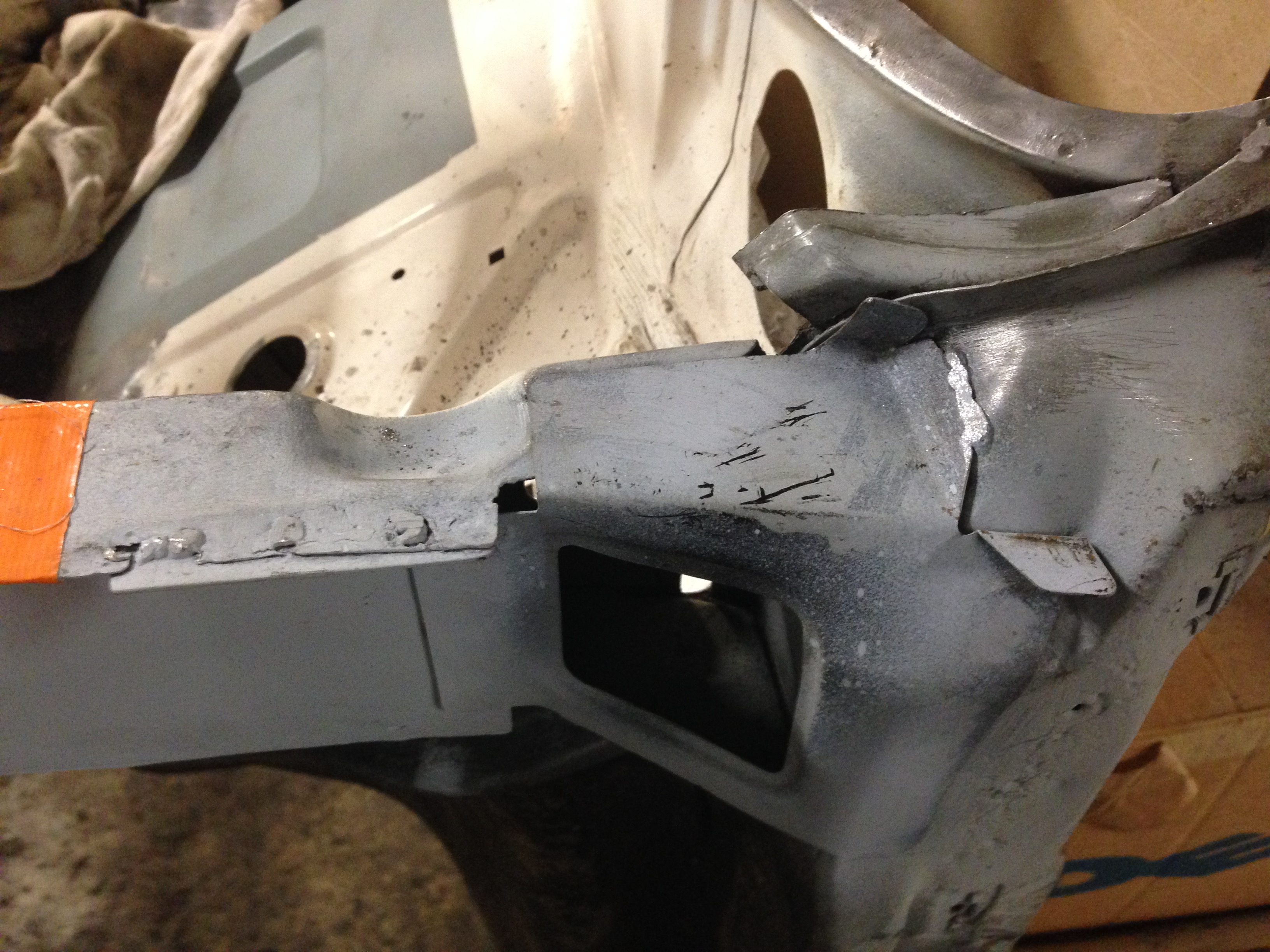

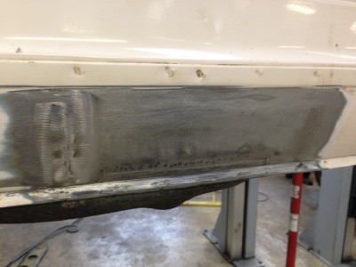

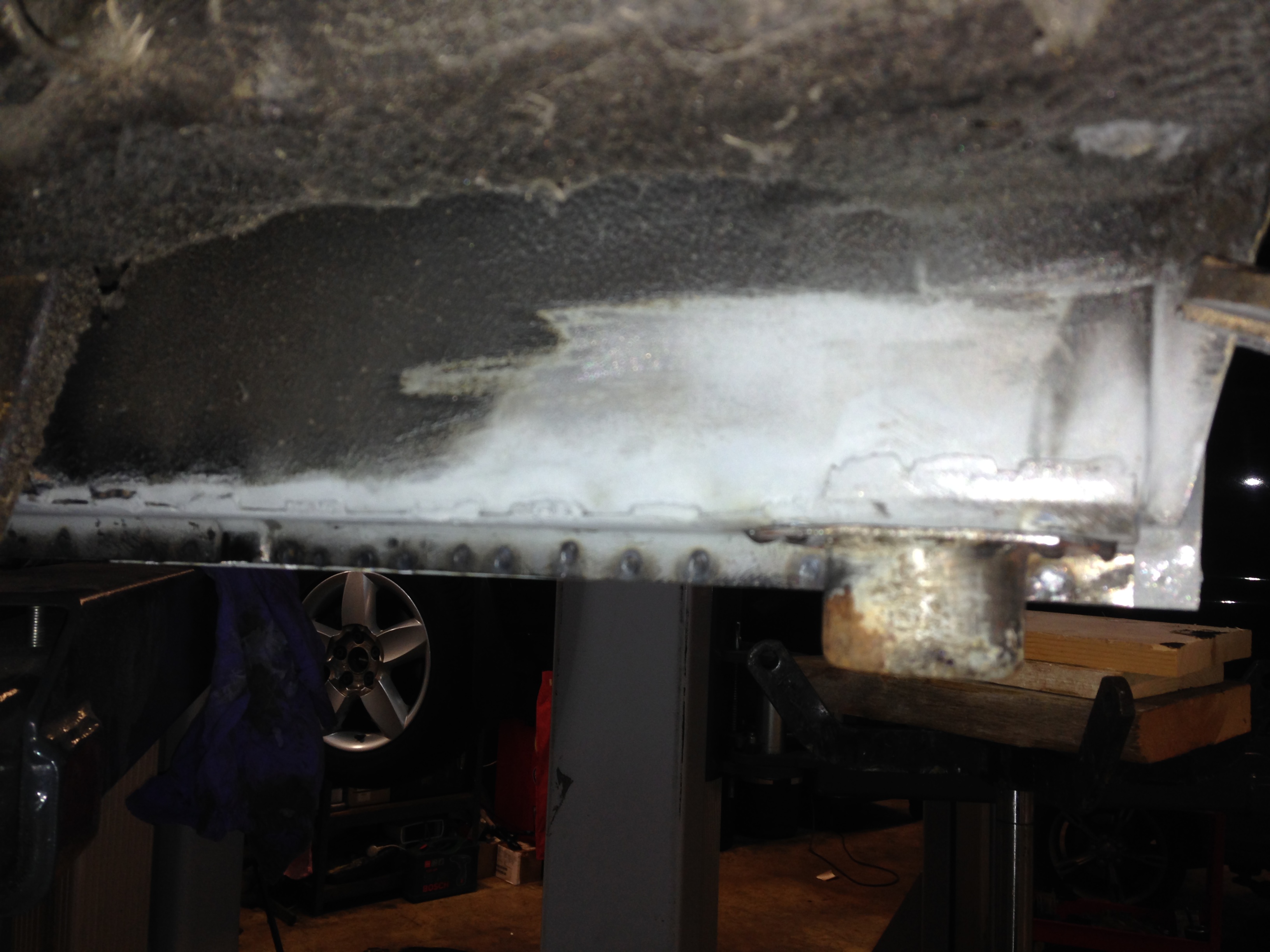

On to the next bit now - the drivers side sill was not too bad and also the rear arch had been repaired to a higher standard this side - had made some effort to repair the inner arch as well this side - looks like the outer arch this side will be able to be left in place with a new inner arch section from my complete inner wheelarch panel

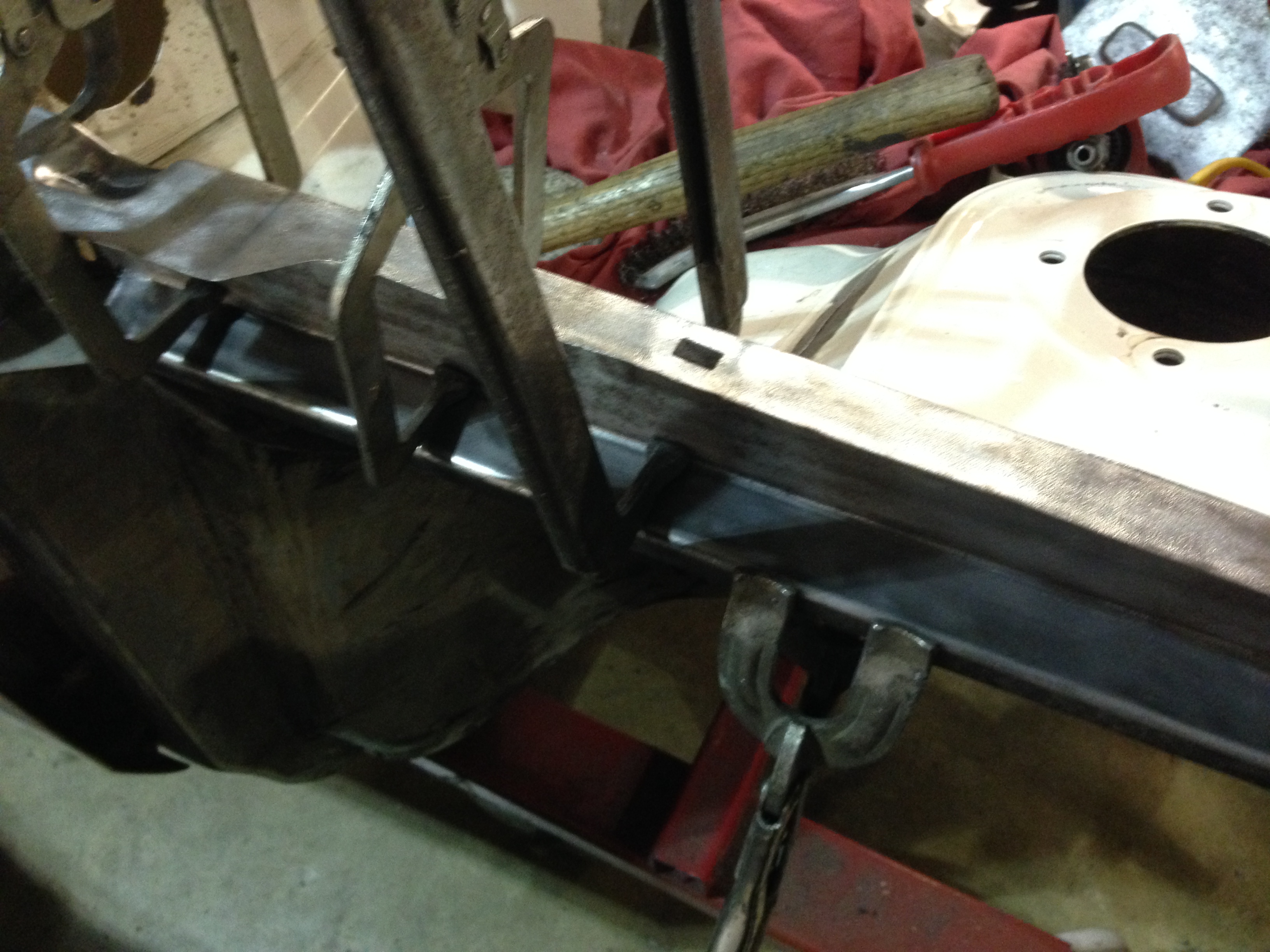

Same as the other side the inner panel was put in place first still using a section out the the new panel - the panel I had was a n/s one but easy enough to cut a section from it to suit
Then a section of the centre membrane fitted
Nearly there now with the fabrication/welding !!

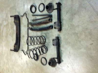

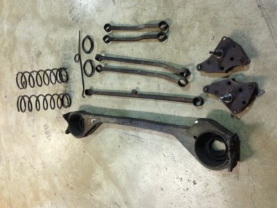

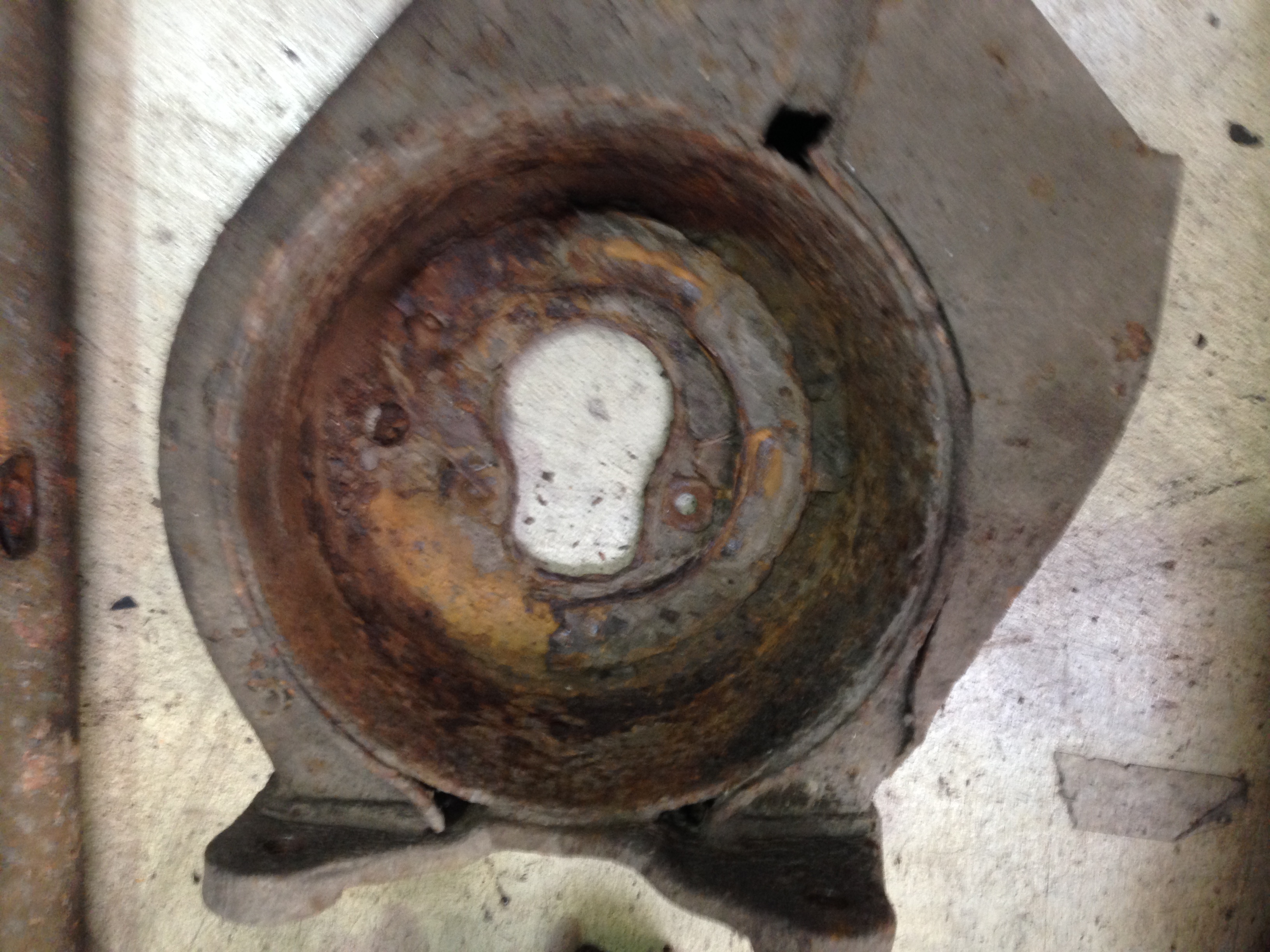

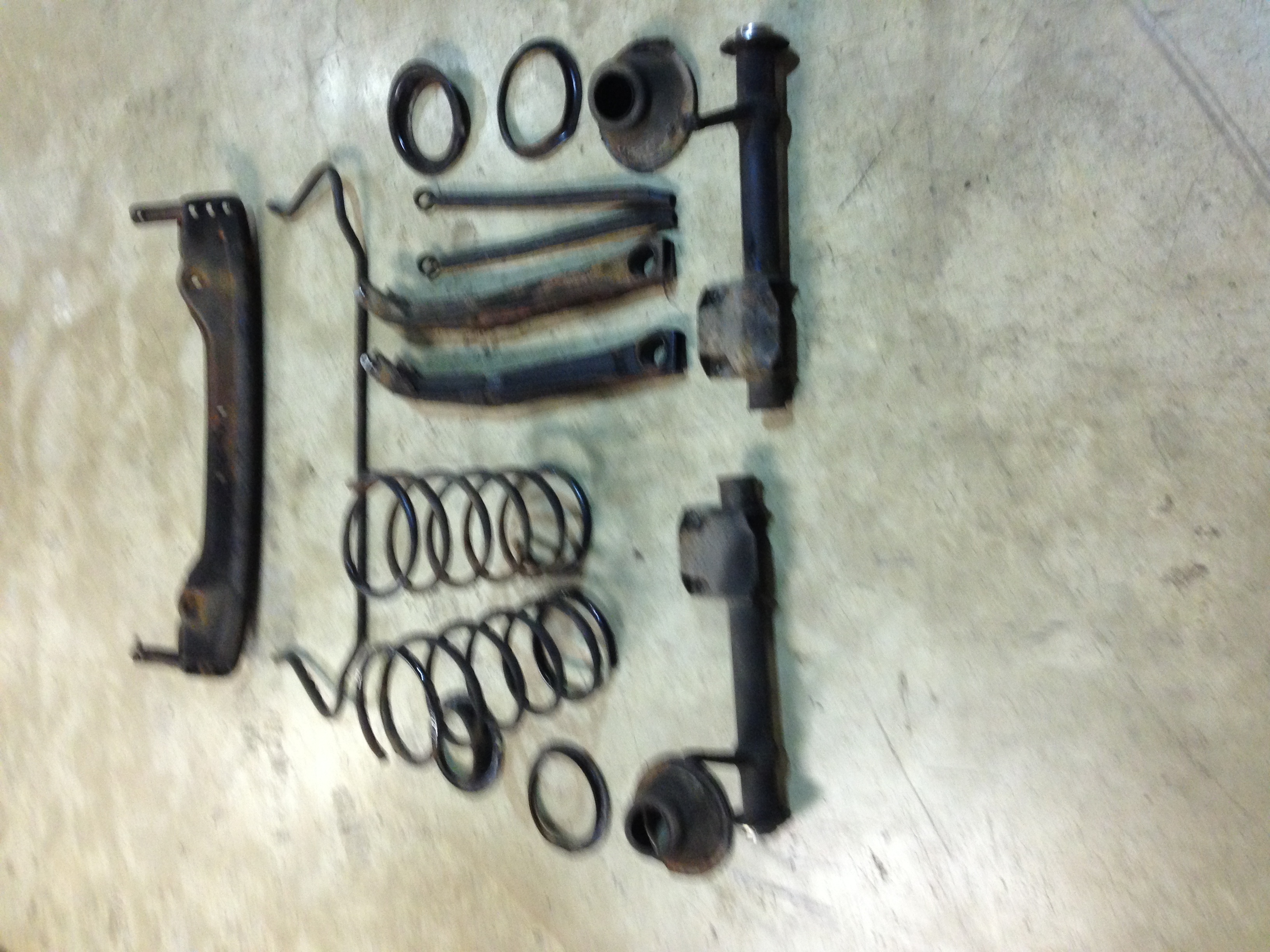

Not much else been done on the bodywork but have now got all the suspension fully stripped ready to go off to be powder coated

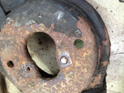

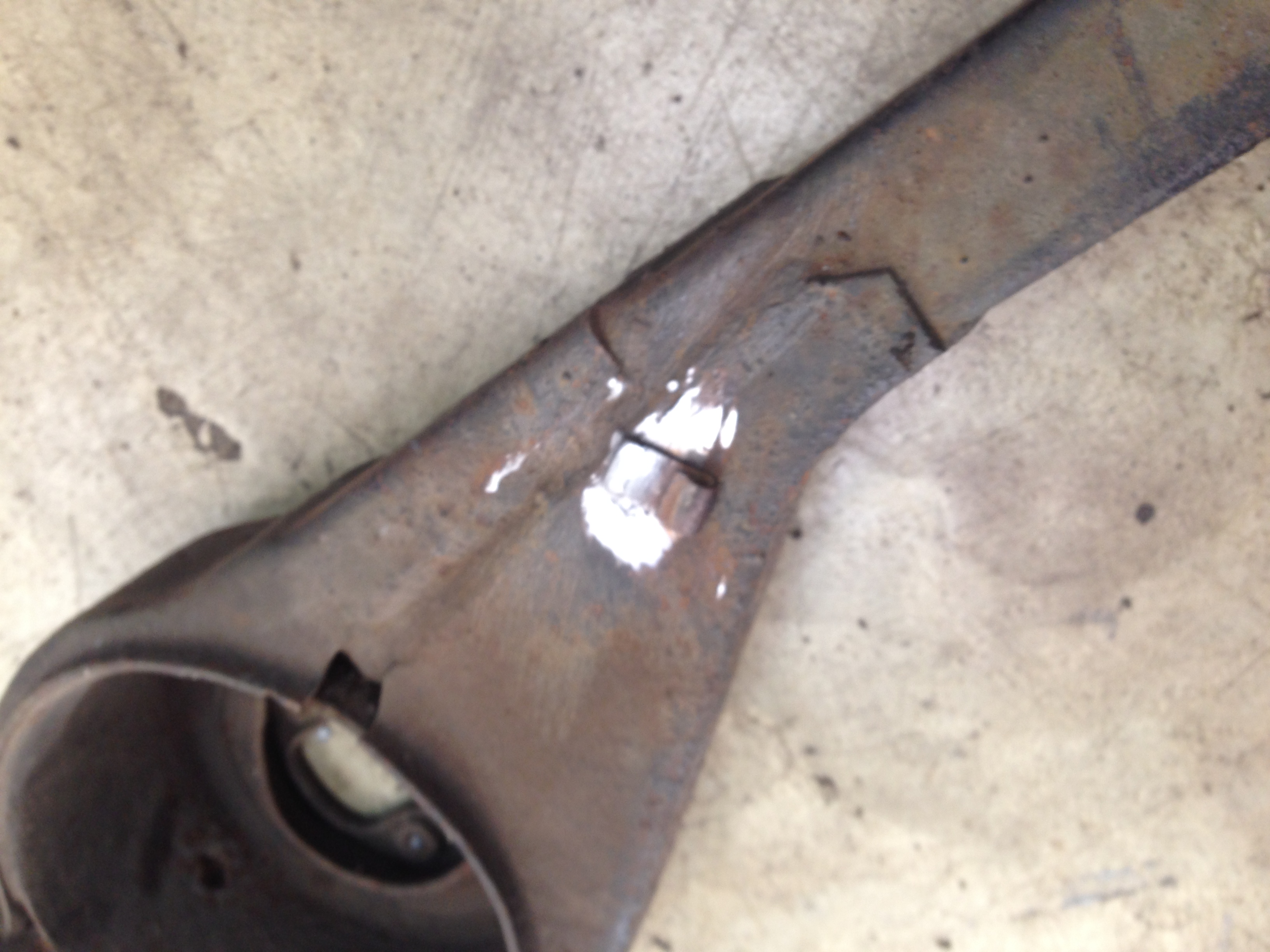

The original rear axle beam must have had water sitting in it as one of the spring seats looked like this
This was the only bolt that broke in the whole of the strip down
I have another good rear axle beam but one of the metal clips the holds the brake pipe in place had come adrift so this was cut off the old beam and welded into place
Old bushes removed from the suspension arms and all ready to go

Front suspension now fully stripped as well

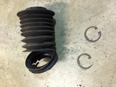

Only has one minor drama in stripping with the circlip in the bottom of one of the strut tubes - this side had the rubber boot split and I guess this had been letting the water in and it collects in the bottom of the strut
Ended up breaking the end off the clip but all other bits were ok in the end after a good clean up - had to grind the inside of the strut tube back to clean metal to get the damper insert out

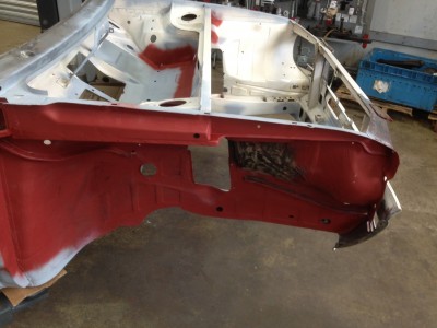

Quick update as I am still waiting to finish of the welding etc.
All the suspension parts and a few other items (pedal box,gearbox extension housing etc.) are now at the powder coaters and after me spending hours with the wire wheel all the nuts,bolts brackets etc. for the suspension have gone off the be replated.

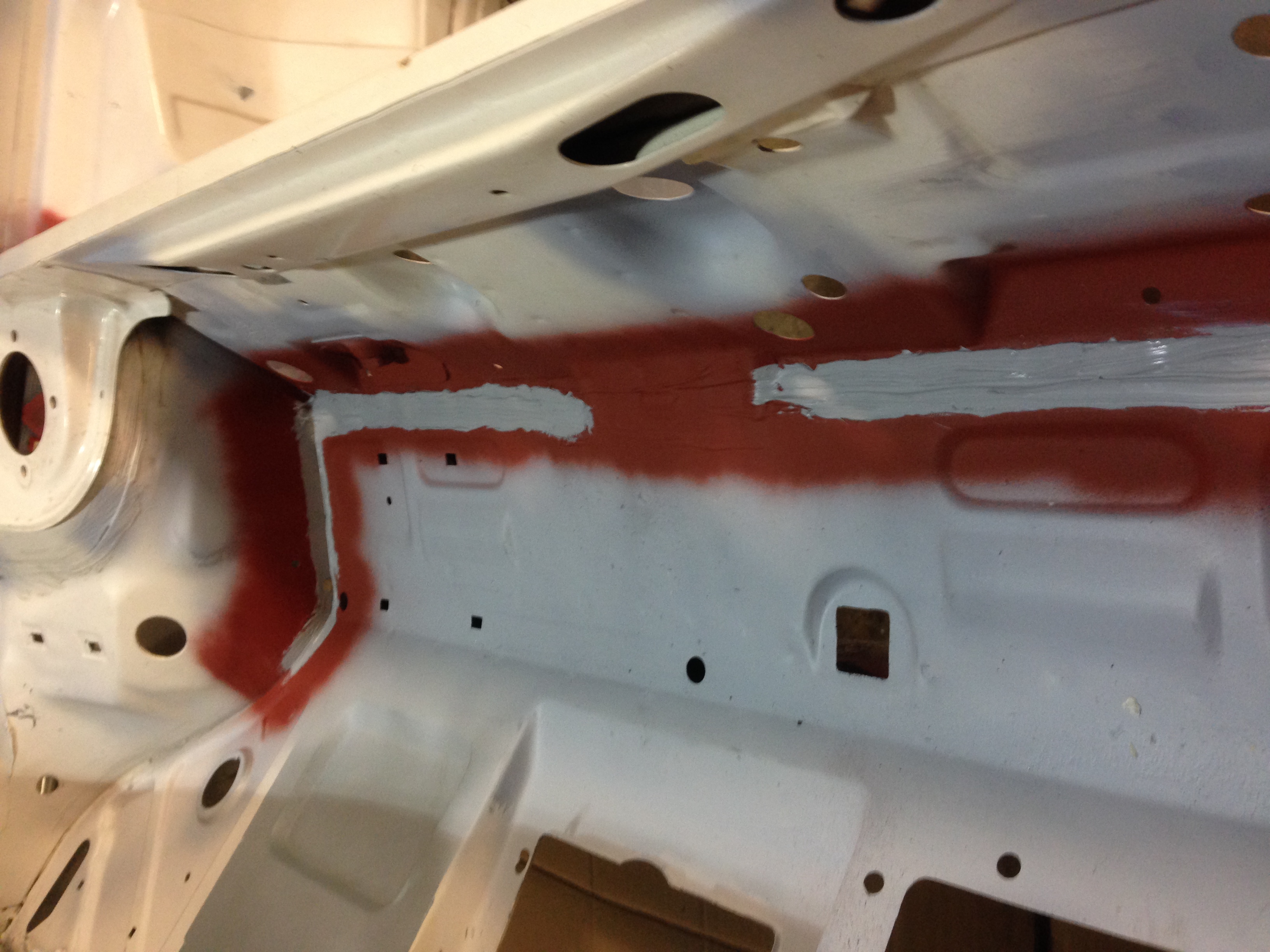

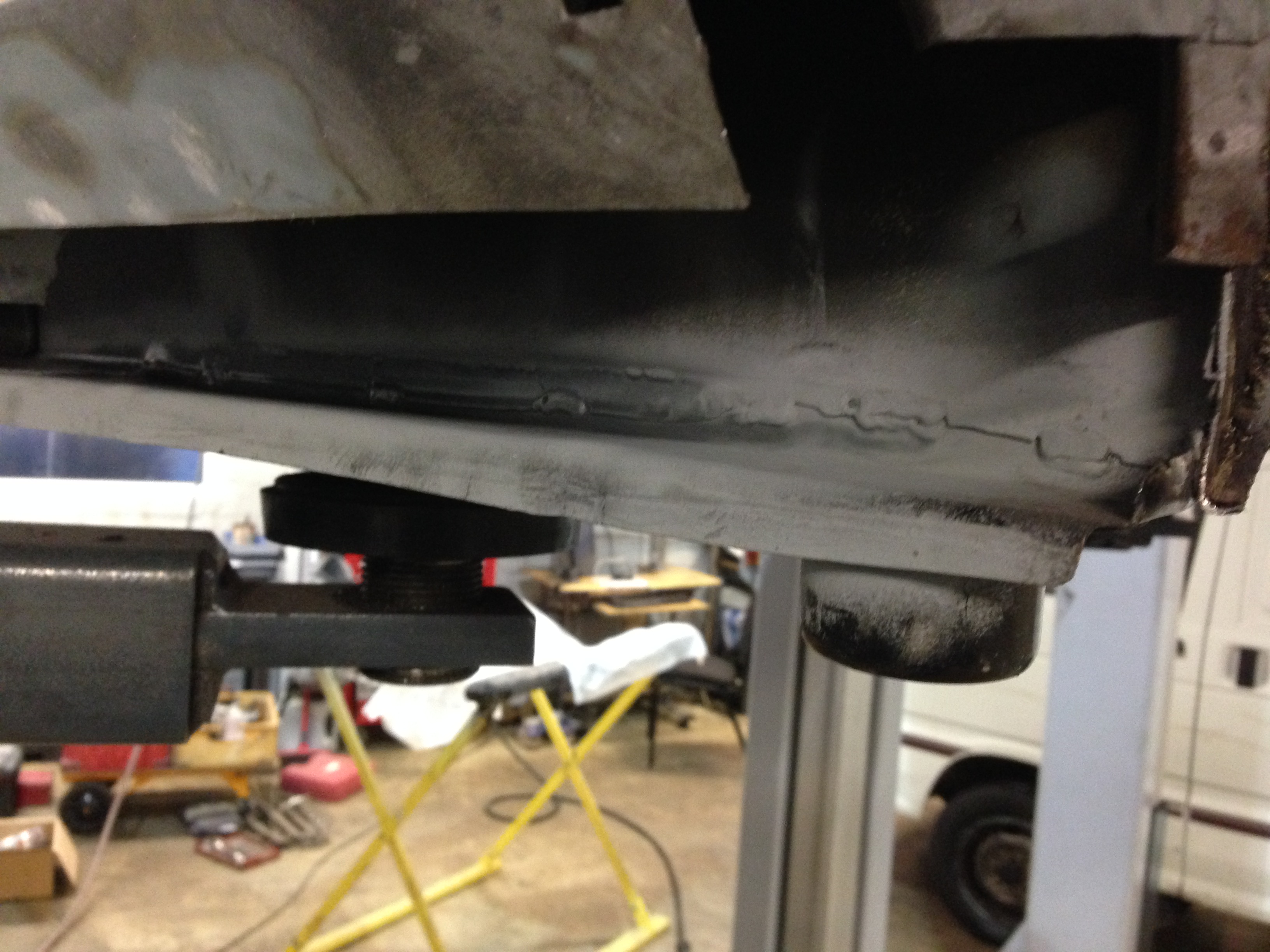

I have been doing some of the corrosion protection now
After stripping back to bare metal (been using a great tool for this - a MBX blaster - it has a toothed type of wire brush on what is a bit like a grinder tool - works really well) have then been painting with acid etch.
Followed this coat with some anti corrosion paint - then in all the new seams used some cavity wax which was then warmed up to let it flow in - followed by seam sealer - trying to make this look a bit messy - same as it was from the factory !
Also been making the holes in the new rear arches for the clips that hold the trims on - again this all takes time

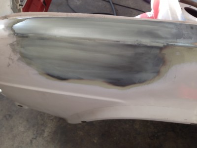

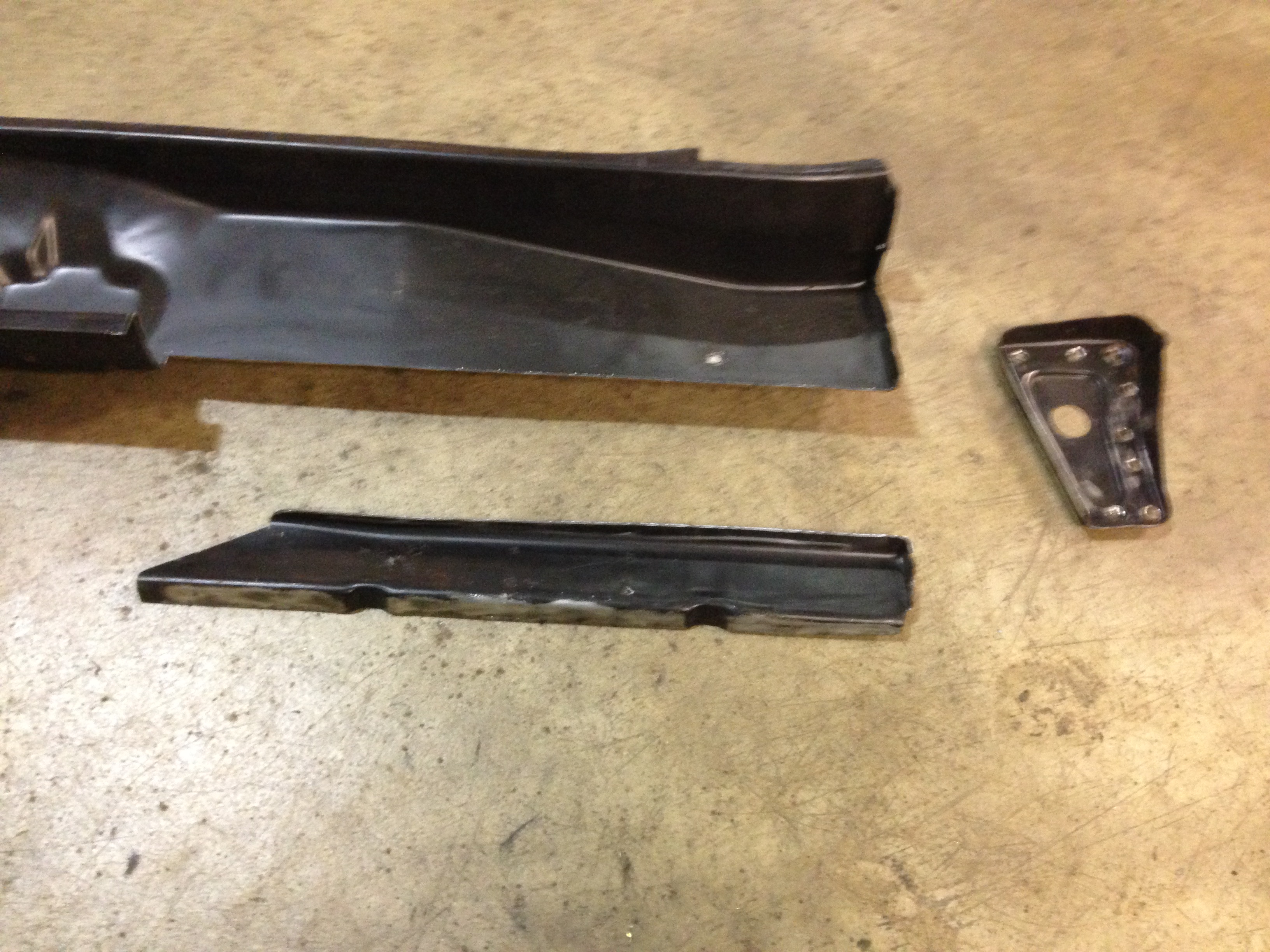

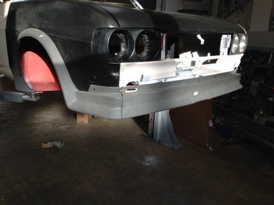

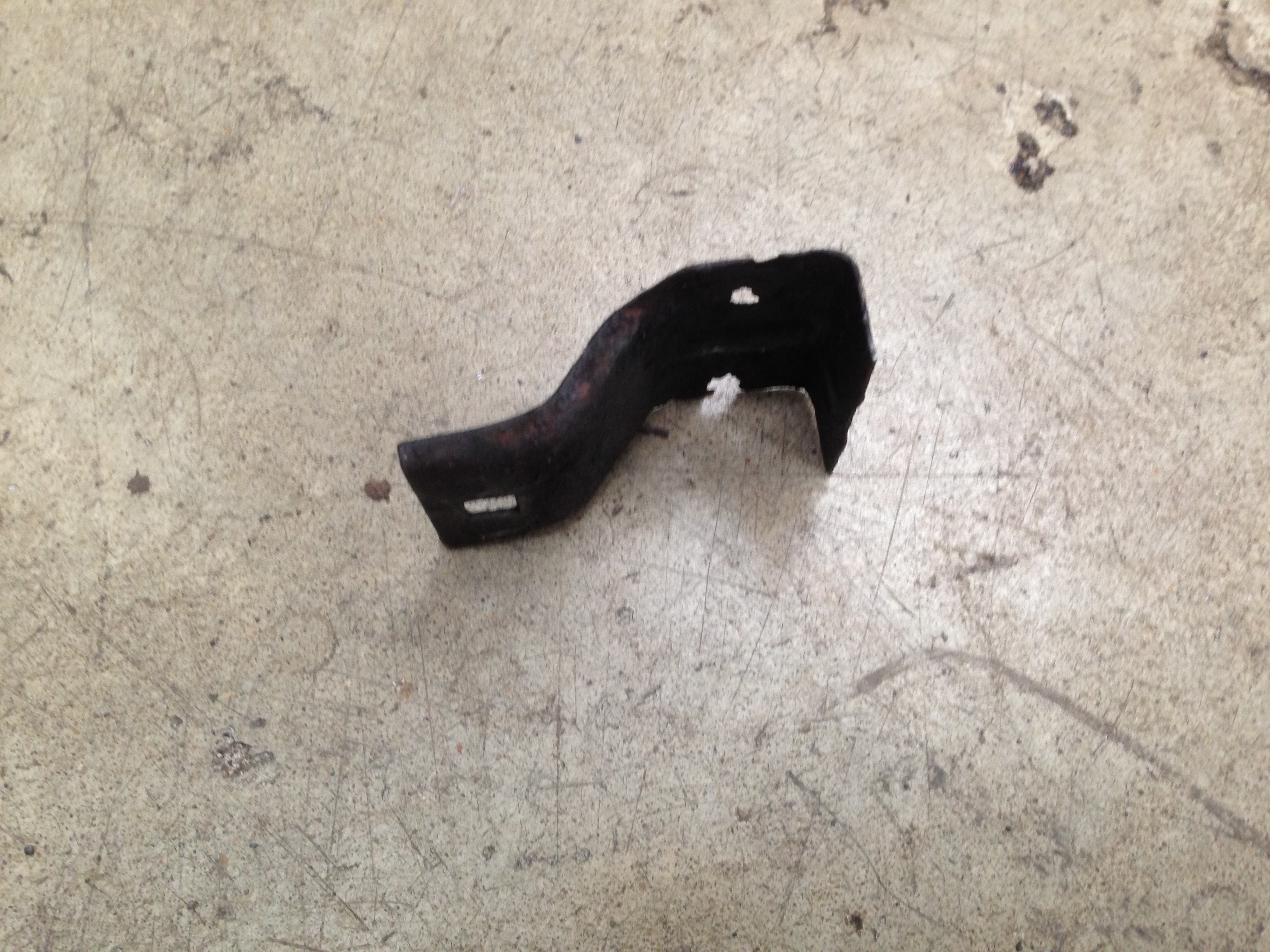

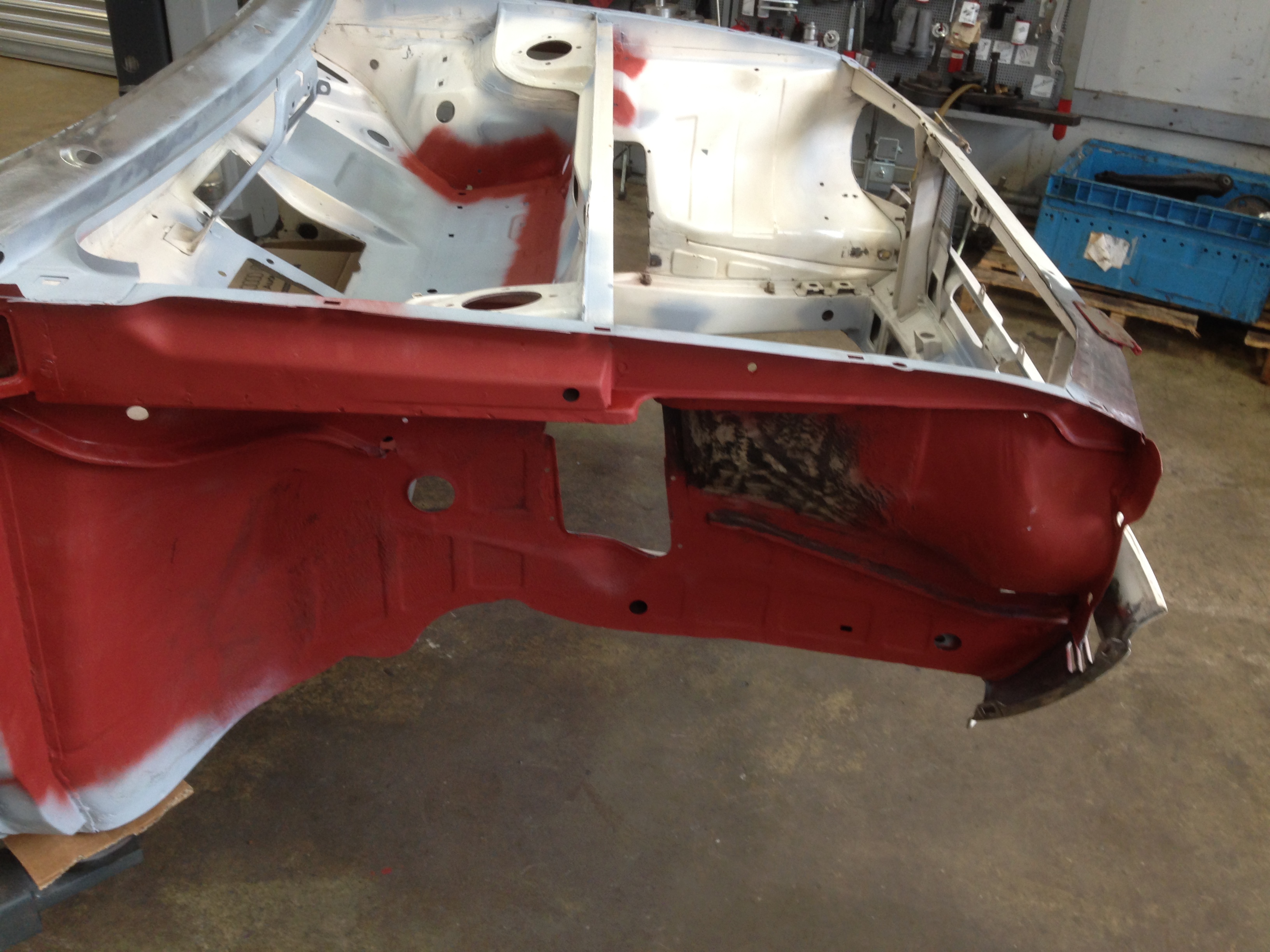

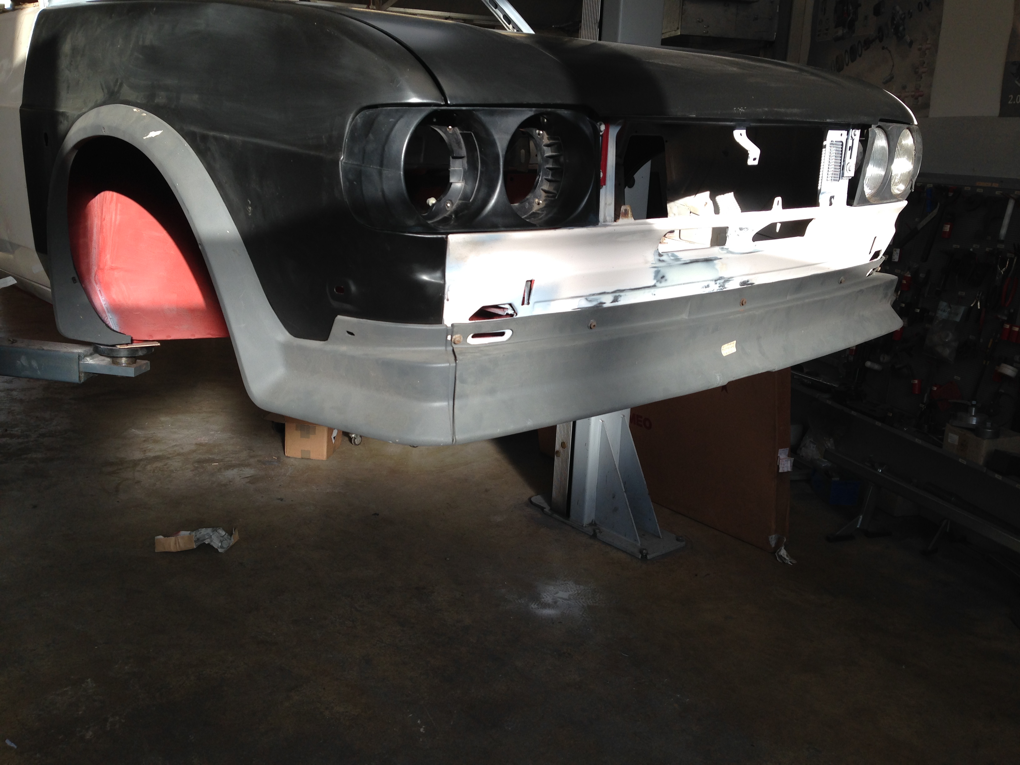

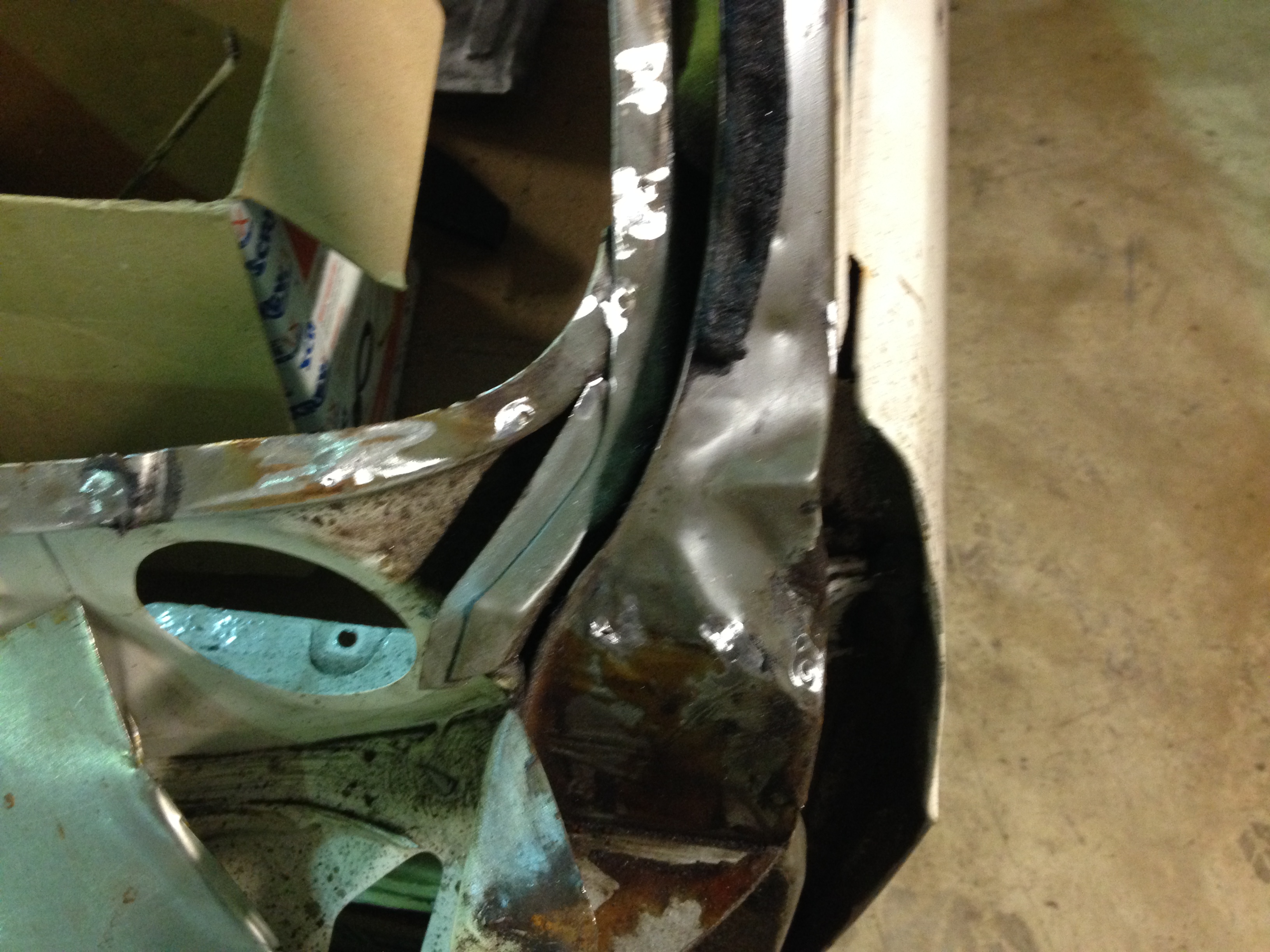

Body repairs have started again now - one thing I had noted thanks to Kev's thread is that the section of upper front panel that had been fitted was the wrong one !!
If you look back at the earlier picture and compare to the one below you will see why
The panel that I used first must be from an early car with the welded on bonnet hinges - the correct one is now fitted with then indent and hole to clear the bonnet bolts

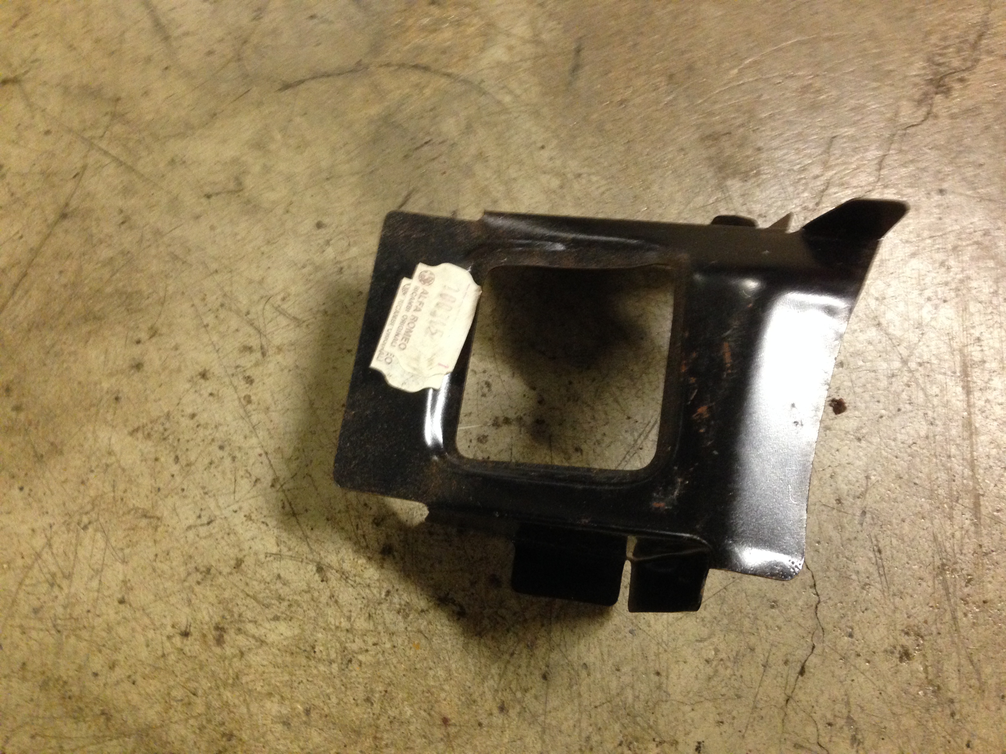

I had also found this rusty but not bent front spoiler bracket (thanks for the earlier offer of your one Kev)
Used this as a pattern to get the shape of my brackets straight again
I have now had a trial fit up of the front wings,bonnet,spoiler,wheel arch trims and headlights - just need to try the doors on now and see if all the gaps there are ok
Original left wing damage has been repaired so should be ready to be painted very soon now
